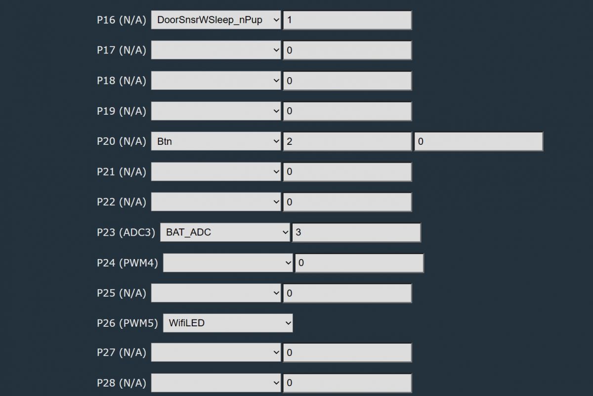

    Do you have battery relay pin set?
    I don't understand this. This is my pin setup.
    Screenshot showing pin configuration settings of an electronic device, with functions assigned to each pin.
    EDIT:
    I copied the pin settings from the Tuya PIR sensor, this had a battery relay pin.
    Now battery voltage measurement work as as expected.
  • Battery sampling pin is P23, switch is P17
    #32 20671570
    Posts: 14811
    Rate: 12977
    I am not an expert when it comes to battery driver, but you've posted this JSON in your previous post:
    	"samp_sw_pin":"17",
    	"max_V":"3000",
    	"min_V":"2200",
    	"samp_pin":"23",
    This means that sampling pin (ADC) is P23 and the sampling switch (Battery Relay) pin is P17.

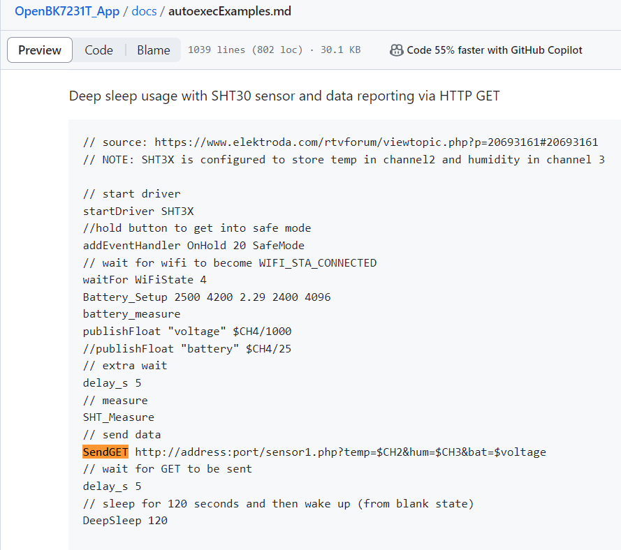

    Could I ask for an example of how to set the sensor in OBK so that when it wakes up, it performs a GET request to an external HTTP server?
  • #34 20951901
    Posts: 14811
    Rate: 12977
    All examples are here:
    If sending data via HTTP GET, search for "SendGET" on the website, for example:
    Screenshot of an example script using the SHT30 sensor and sending data via HTTP GET.
    Related forum post:
    https://www.elektroda.com/rtvforum/topic3945688-180.html#20693161
    The script was run by @@GUTEK@

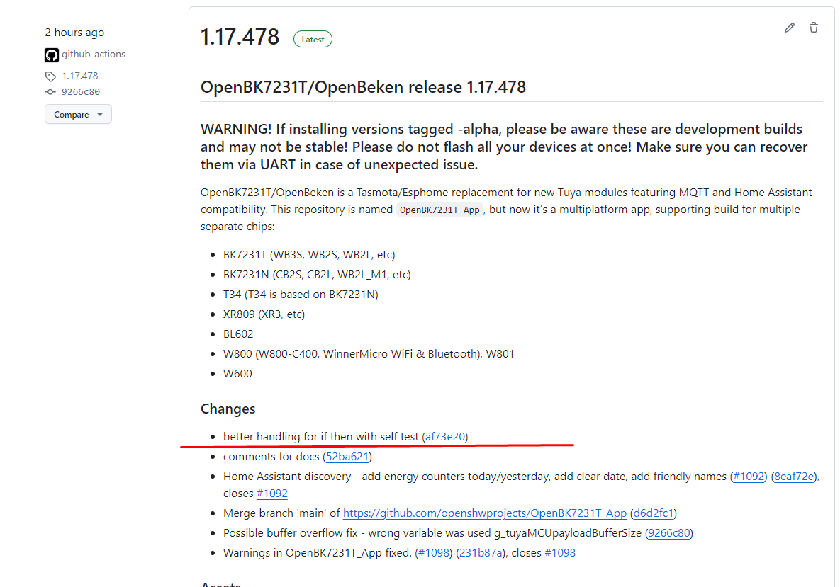

    If I replaced PinDeepSleep with the DeepSleep 43 200 command, is wake-up from the pin still available, but I have a control signal every 12 hours? in ESP, excitation from the pin was independent of the code, but I want to make sure :)
    Currently, DeepSleep will not be woken up from the pin because there was no such option in the SDK. Only recently a PR for the SDK appeared:
    https://github.com/openshwprojects/OpenBK7231N/pull/18
    And only in the future will I integrate it, then it will work as you write.
  • Deep sleep wake pin support added in SDK

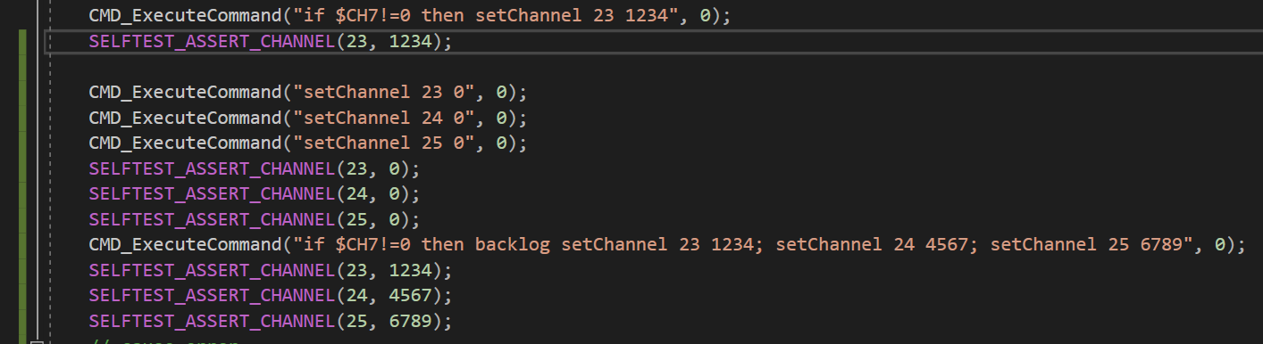

    @p.kaczmarek2 , so it will be correct:
    if $CH5!=$CH0 then backlog SendGET http://ip/sensor.php?doorSensor=1&sensor=$CH0&bat=$batteryLevel; delay_s 2
    You could divide these delay_s 5 into 5 delay_s 1 (with a loop or manually) and check this safe mode pin every second
    You`re right, but in its current form, you`d have to wait those few seconds while keeping it pressed. Alternatively, in nothing, you could blink the WiFi LED 3 times as confirmation of exiting the script to be sure that it is finished.
    It remains to follow the release change ;)

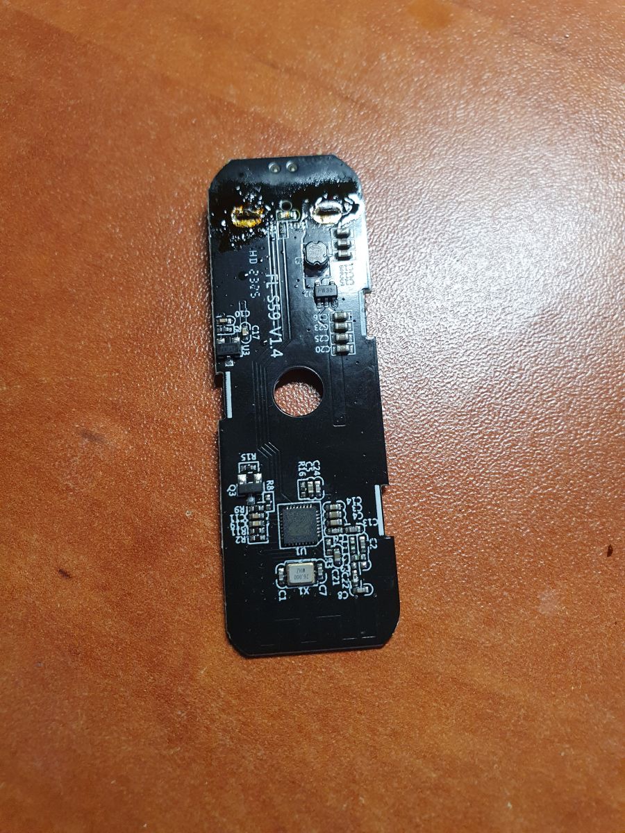

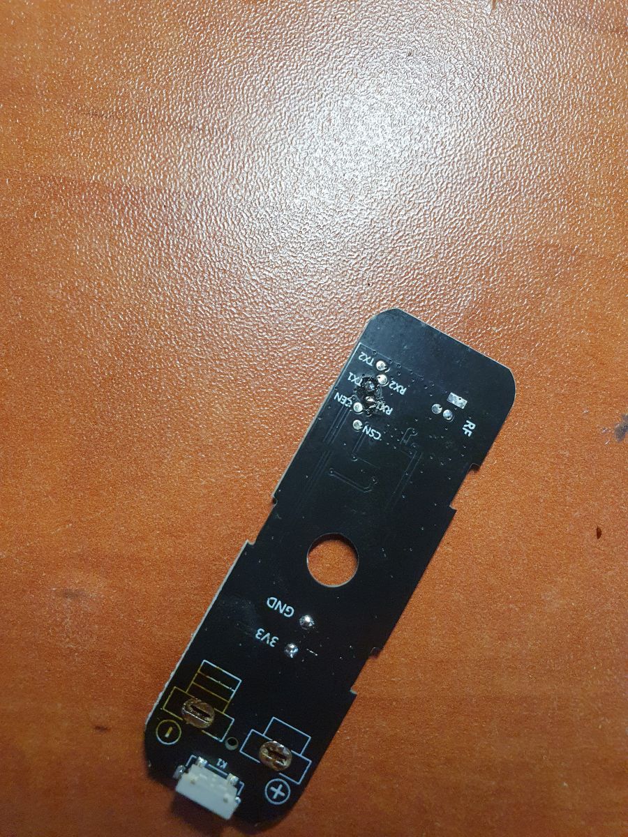

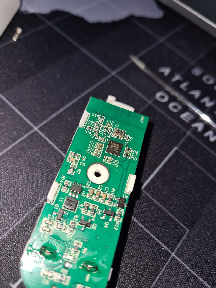

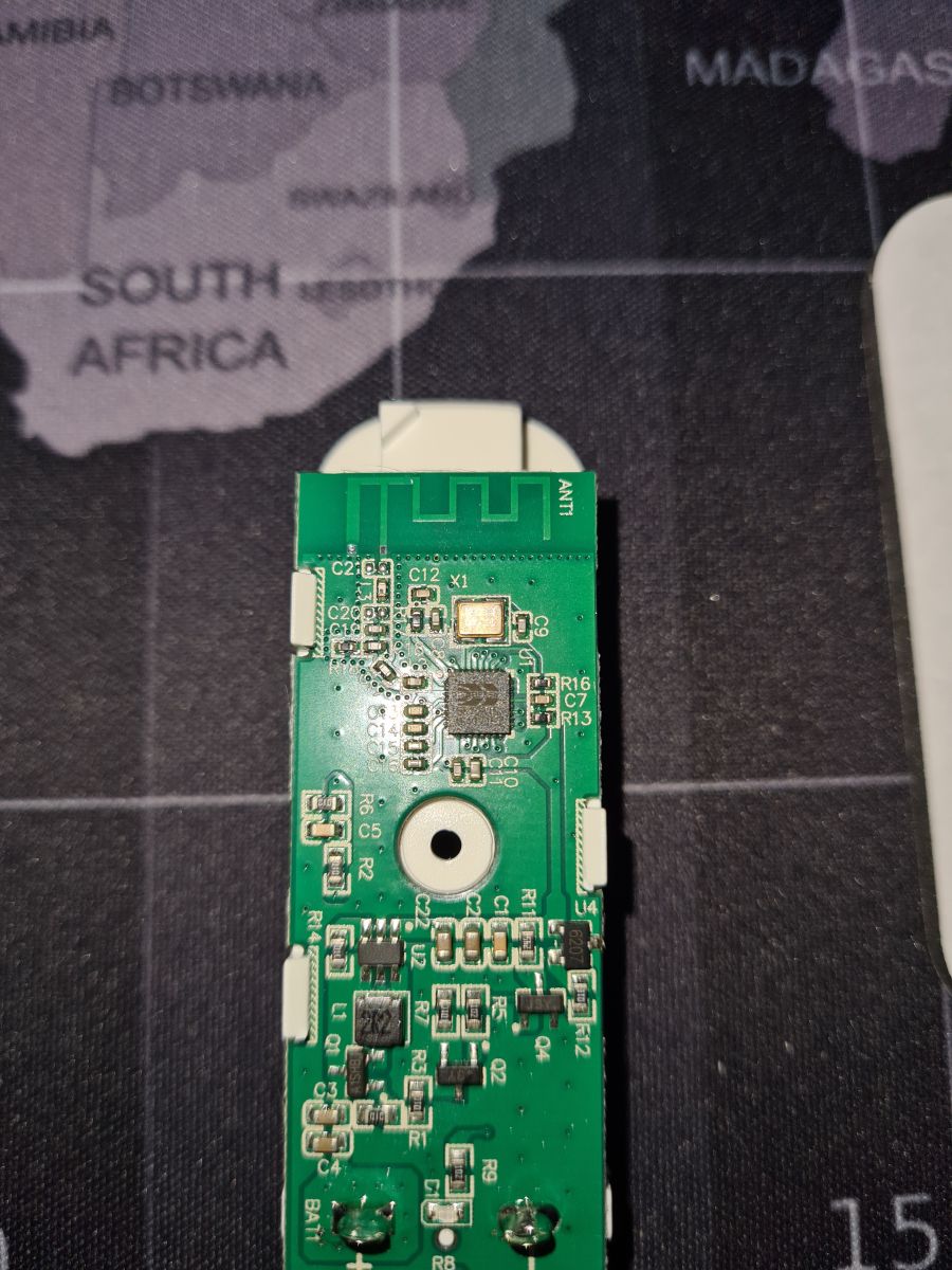

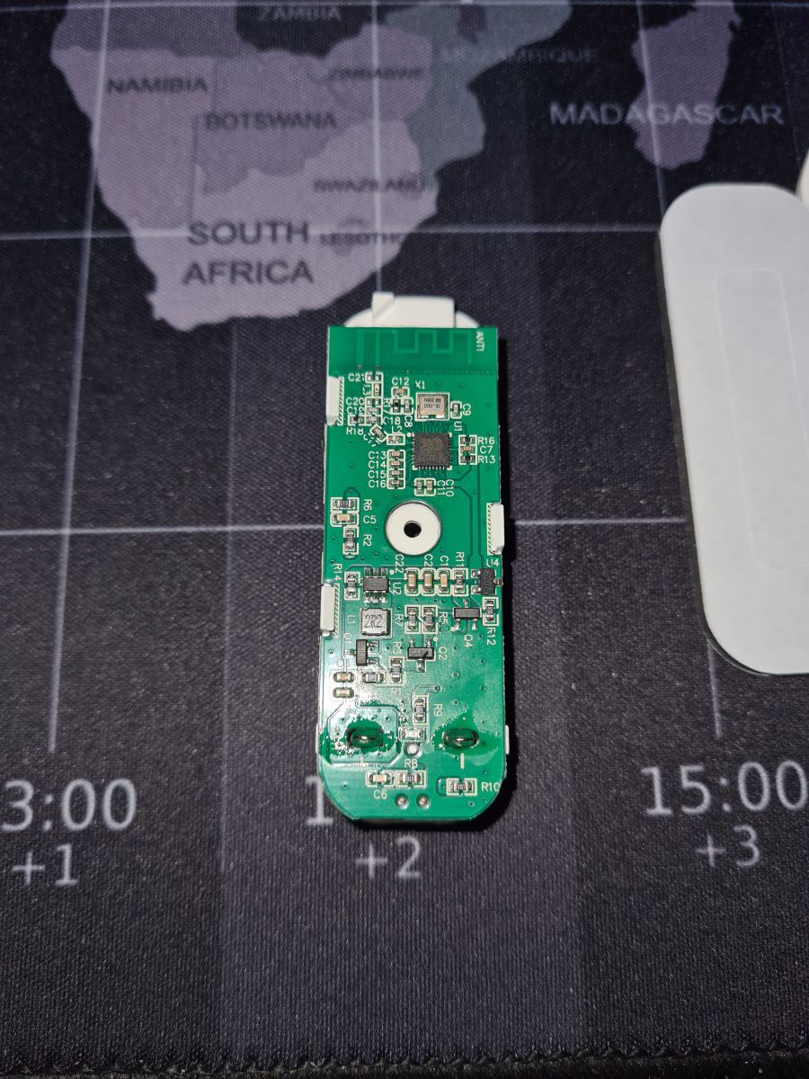

    Has anyone tried programming such a board? BK7231N looks good, but is it possible to solder the programmer somewhere other than the chip itself?
    Close-up of a PCB with a BK7231N chip. PCB board with BK7231N chip on a world map background. Close-up of a PCB featuring the BK7231N chip and electronic components.

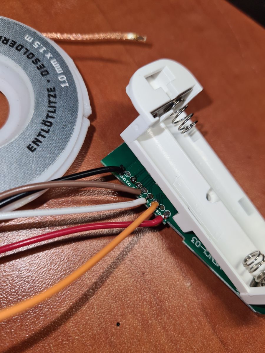

  • #45 20971881
    Posts: 14811
    Rate: 12977
    And on the other hand? Are there no pads on the other side of the PCB? You will need to unsolder the battery connector.
  • #46 20972260
    Mad_Maxs
    Posts: 81
    Indeed, after desoldering, there are pads on the other side
  • #47 20972263
    Posts: 14811
    Rate: 12977
    Can you post a photo?

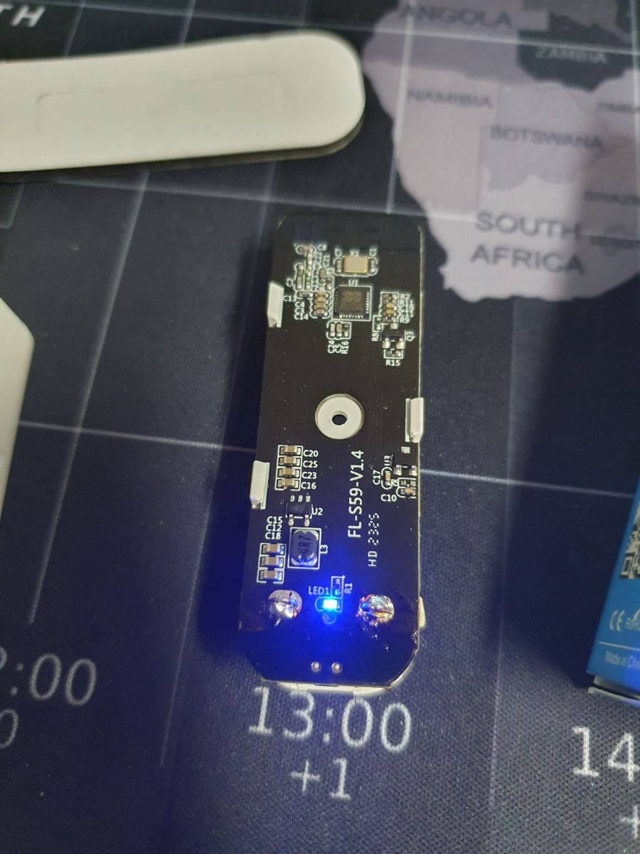

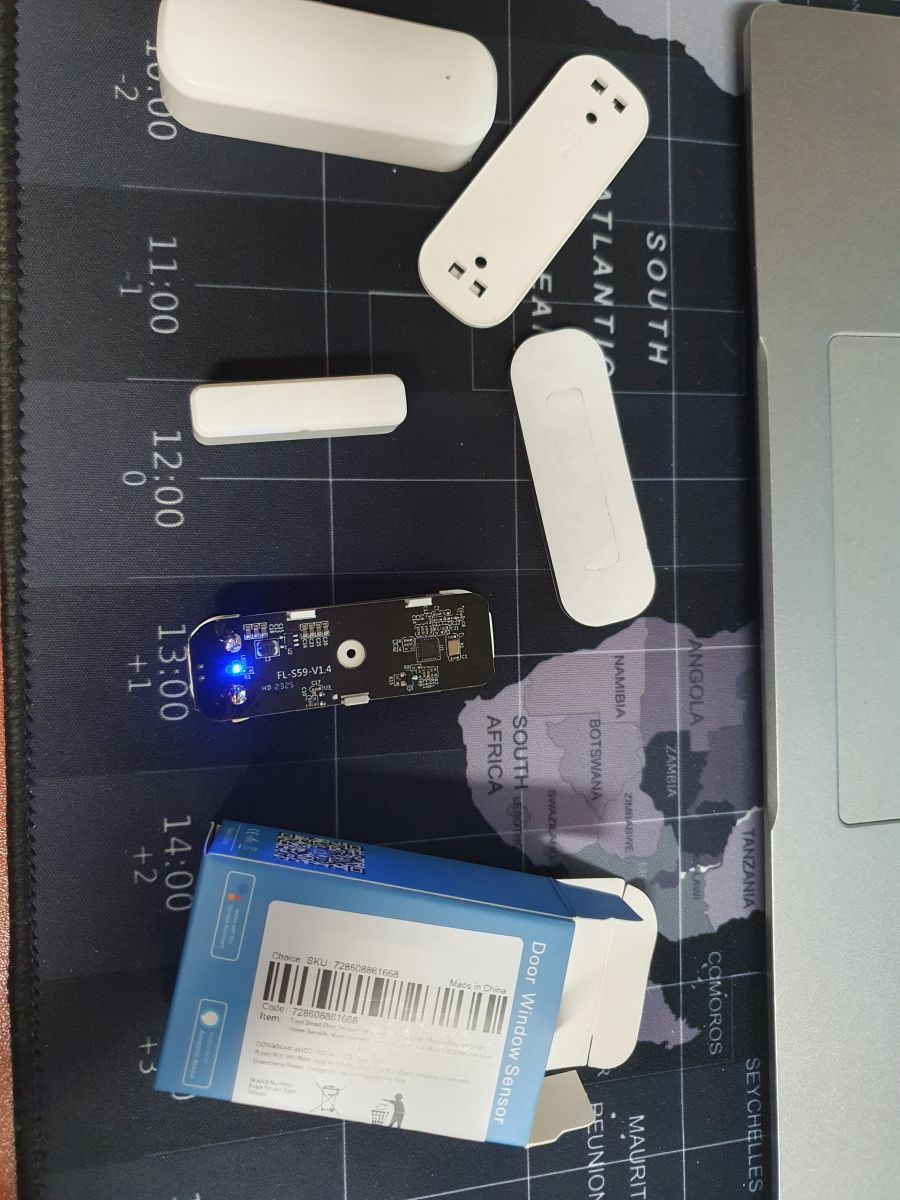

  • Magnet sensor still not waking from deep sleep
    #48 20972327
    Mad_Maxs
    Posts: 81
    Bright:
    Close-up of an electronic module with connected wires and a battery compartment.
    However, I have a strange problem: I loaded the pinout into it:
    I have a reading of the battery status, on channel 0 I see a change when the magnet changes position, and yet after switching to PinDeepSleep mode, the change in the magnet position does not wake him up
    //EDIT
    I found that the btn is pin 14, now when it sleeps, I can wake it up with the button, but it still doesn`t respond to the magnet.
    By the way, how can you calibrate the battery reading, because it`s a bit off with the meter ;)
  • Door sensor wake behavior depends on pin role and DSEdge
    #49 20972420
    Posts: 14811
    Rate: 12977
    Doesn`t changing the position of the magnet wake up the equipment only when, for example, "opening the door" or only when "closing" it, or does it not wake up at all?
    You must correctly select the pin role, i.e. DoorSnsrWSleep without pull up/down or DoorSnsrWSleep with pull up or pull down.

    #51 20972517
    Posts: 14811
    Rate: 12977

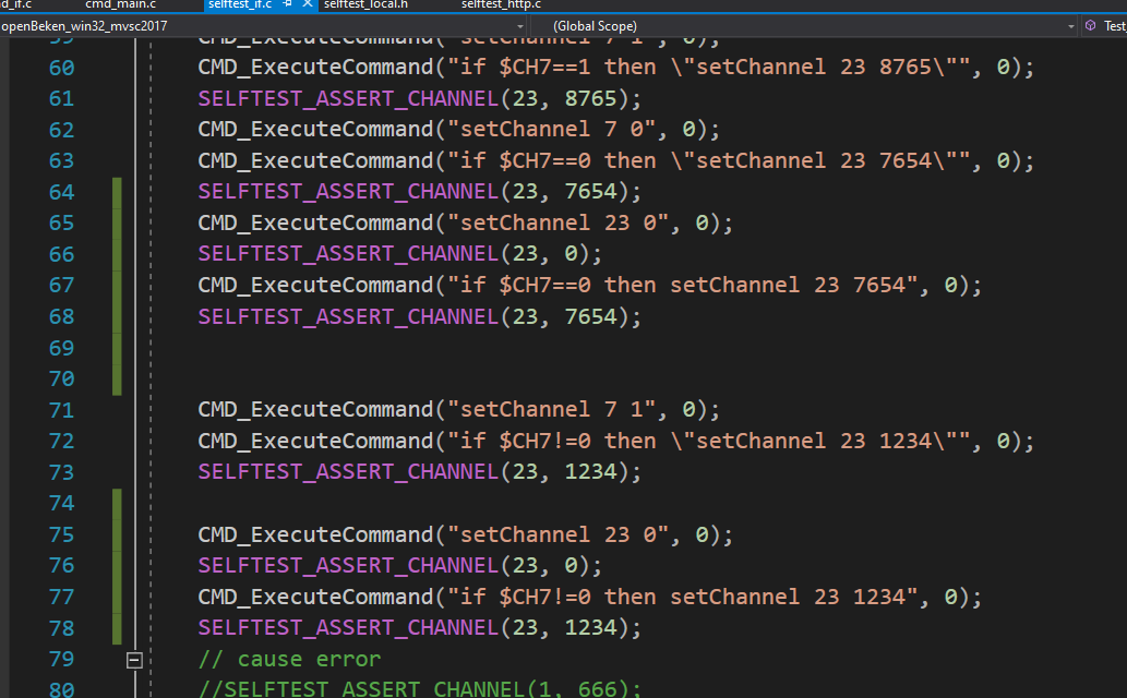

    Congratulations, you found an edge case in the if that was handled incorrectly by the parser. I posted an update, can you first disable deep sleep and then do an OTA to the version that will appear on Github in about 10 minutes (when it compiles)?
    EDIT: yes, an alias can help, but I also posted a fix for it on the repo so this problem won`t happen again, the automatic testing system will take care of it:
    Source code in a text editor showing various test commands and conditional statements in a programming language.

  • BK7231N sensor pinout and mesh range note
    #54 20973013
    Mad_Maxs
    Posts: 81
    A lot of these sensors for one WiFi network. How far will they be from the router?
    Difficult question, because I have a mesh :) max 10 meters to the nearest antenna. I have a dedicated vWlan for these gadgets :)
    MyFriend from China played a trick on me and out of 7 sensors, one was different :) the little one was sitting there so much that it was dying because of the battery, I destroyed it, but it worked:
    Electronic board of a Tuya door sensor with visible circuits and connectors on a brown background. Printed circuit board of a sensor with visible markings and a connector. Tuya Smart Door Sensor circuit board with BK7231N chip. Tuya Smart Door Sensor with parts spread out on a table. Close-up view of a circuit board with components, featuring a lit blue LED.

    How to add execute startup to the template? Because you need to enable the Battery and DoorSensor drivers, I also set DSEdge 1 in autoexec and turn off Flag 42 (but this is for consistency of configuration with previous sensors)

    From what I see, it didn`t get into 477, but into 478:
    OpenBK7231T/OpenBeken version 1.17.478 release information.
    Additionally, all automatic tests for this phrase pass correctly:
    Code snippet in a programming language with CMD_ExecuteCommand and SELFTEST_ASSERT_CHANNEL instructions.
