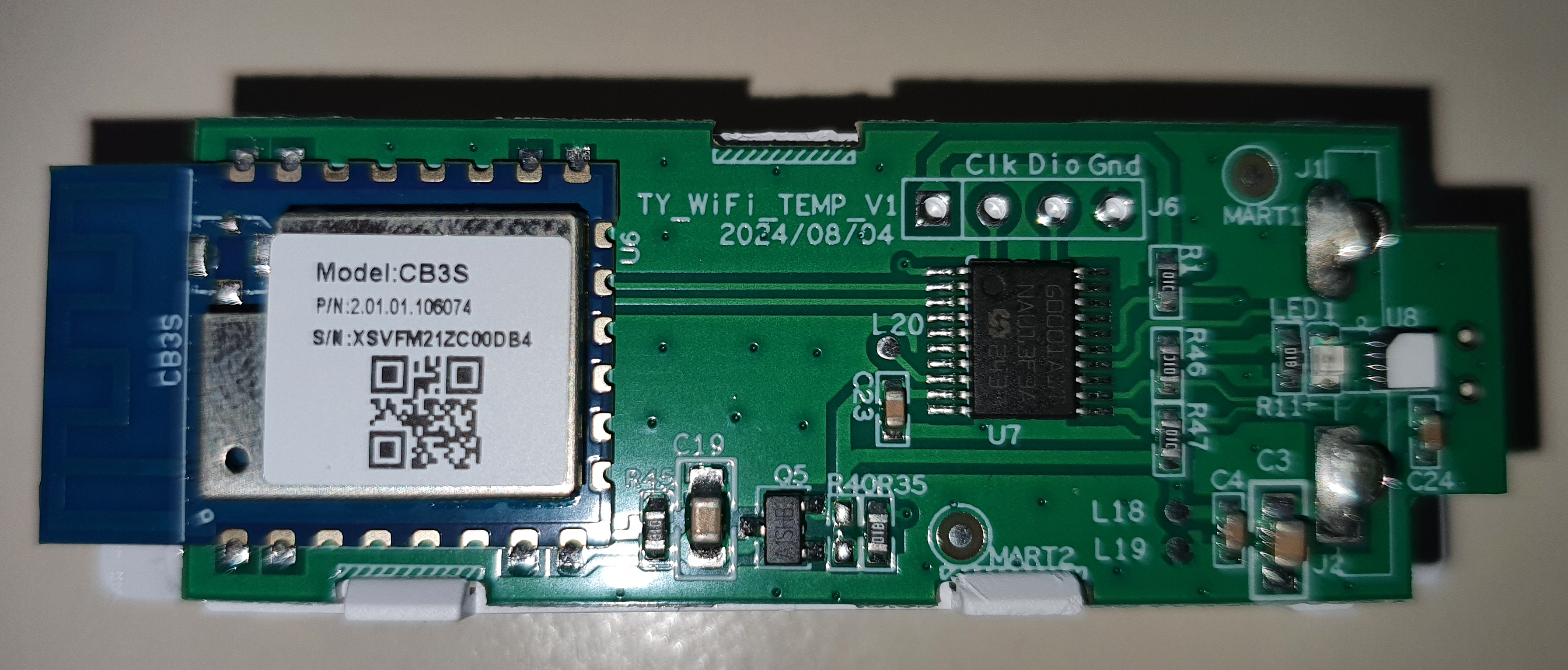

    My device looks like this:
    CB3S WiFi module on a green printed circuit board.
    It's from Aliexpress, this one, to be specific: Link

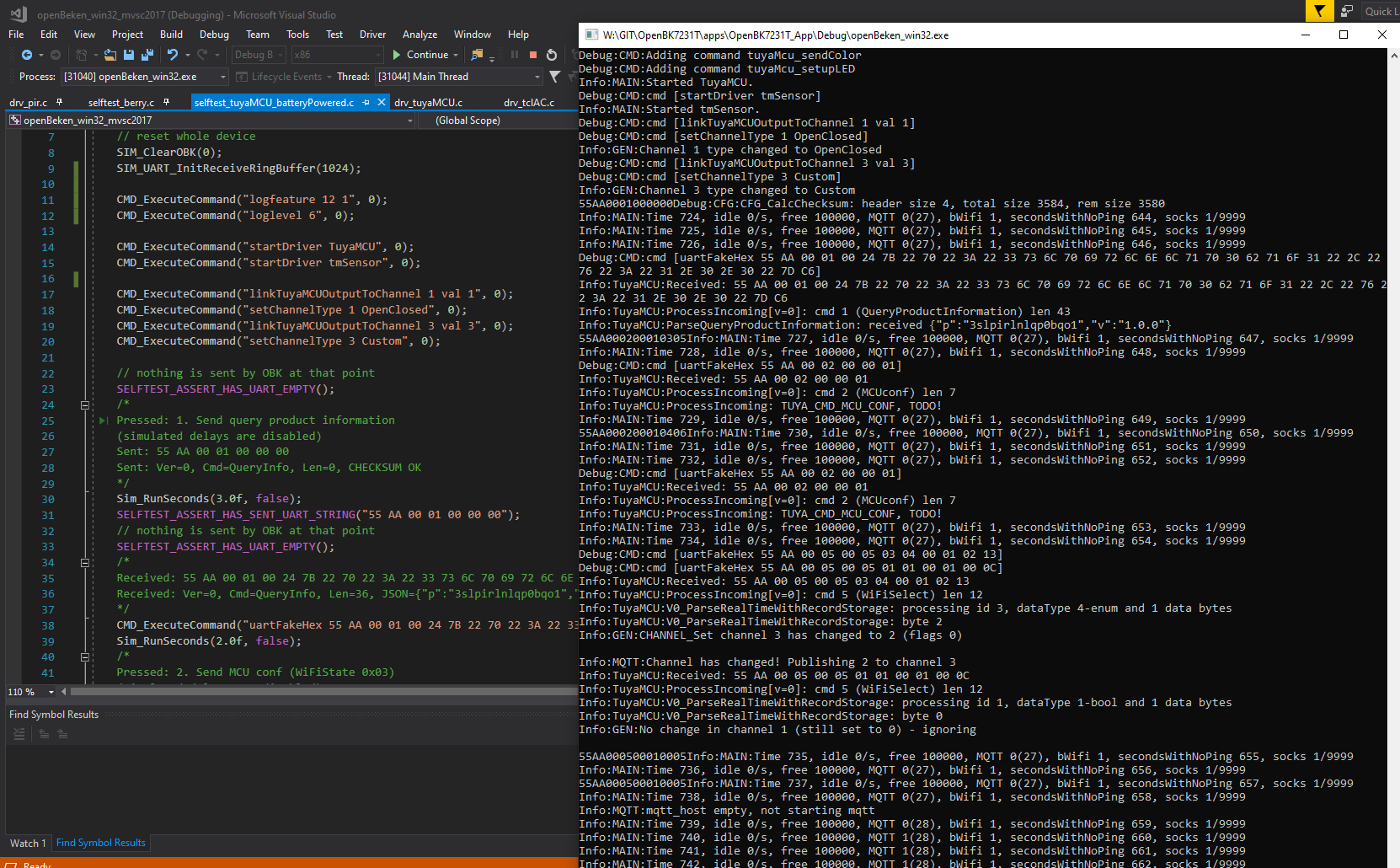

    Out of curiosity, I ran the same in the self test system, with hardcoded responsens from the MCU. Here is how log looks like:
    Screenshot of Visual Studio with source code on the left and a console window displaying debug logs on the right.
    Maybe I could add a debug log print to the point where OBK sends product info query (55 AA 00 01 00 00 00 ) ?

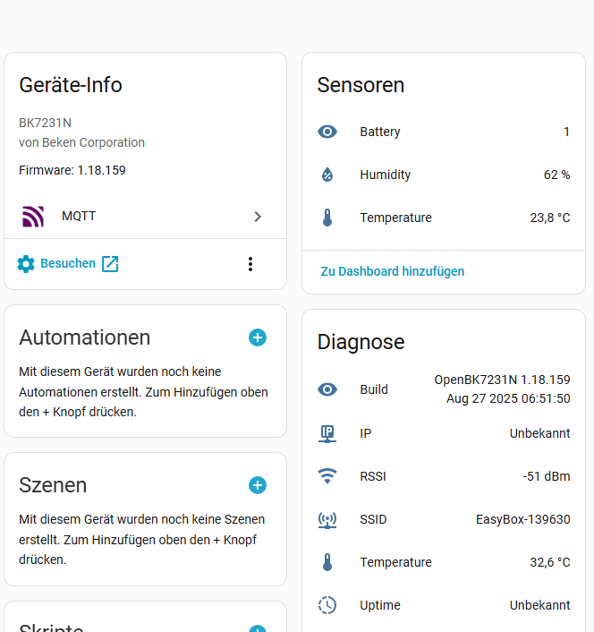

    BobUrban wrote:
    I was able to flash my device successfully with the MCU TX and RX connected.
    When it's powered now, it doesn't properly connect to Wifi, sometimes when I press the button it connects, but the openbk UI only is available for a few seconds.
    Is there anything I could try?
    Is there any recommended similar device to buy instead of this one?
    This is my device:
    PCB with CB3S module and various electronic components.
    This is the connections I used for flashing
    CB3S module with TXD1, RXD1, GND, and 3.3V pins connected.
    Hi there, I bought a similar one from Aliexpress , the board reads ZY-TH02-CB3S_V1.0 and 2025-01-18. Although this was my first experience with flashing such device I had nearly no problems doing so and I would like to tell what I did and what my experience is so far.
    First, I tried to get some serial output with the original Tuya-Firmware but without success, tried every possible baud rate but only got garbled text, tried on PuTTY and with the Arduino IDE serial monitor, any suggestions?
    Then I decided to flash with OBK. I connected like in the picture above. I did connect 3.3V and GND also directly to the Bat.-pins and used the Windows GUI Version, I did not desolder or cut anything. Only problem I had, was the device would start to sleep after some seconds while trying to back up the firmware.
    Don't know why, as I was powering CB3S directly on the pins?
    But I managed to flash with pushing the button every 2 or 3 seconds, then back up, erase and flash performed flawlessly.
    Interesting is, that after OBK is running now, the device did not go into sleep when I powered the CB3S directly, so I was able to do all the config in the web portal and was able to add the device to Home Assistant.
    Only problem I have still, is that if I use the module as intended running on battery (so powering it only via the bat.-pins) the device barely has enough time to transmit all data before starting to sleep. I already changed the flags to WiFi quick connect and used static IP, also decreased wait after boot from 5 to 1 second. Good thing is, sensor data is always sent (every 1 hour, or if data is changed more than a specific value), only the diagnostic data is missing most of the time.
    User interface screen of OpenBK7231N showing device info, sensor data, and system diagnostics.
    This is the startup config I got from a previous post:
    startDriver TuyaMCU
    startDriver tmSensor
    // dpID 27 is temperature div 10
    setChannelType 27 temperature_div10
    linkTuyaMCUOutputToChannel 27 val 27
    // dpID 46 is % humidity
    setChannelType 46 Humidity
    linkTuyaMCUOutputToChannel 46 val 46
    // dpID 101 is battery state - low(0), mid(1) and high(2)
    setChannelType 10 ReadOnly
    linkTuyaMCUOutputToChannel 101 enum 10
    setChannelLabel 10 Battery
    As I understand correctly, the device works like the following:
    - TuyaMCU wakes the CB3S module, then transmits its sensor values to it
    - CB3S sends the data via WiFi
    - ? CB3S tells the TuyaMCU that all data is sent ? Or is it a static timeout?
    - TuyaMCU cuts power to CB3S again
    Anybody could imagine why Tuya is using their MCU at all if you could do the logic completely with the CB3S only? Could it not be to save costs if you need an additional chip.
    Overall it works great though, and I liked getting OBK working without soldering at all as I have many of these and want to roll them out as easily as possible, so thanks for that firmware !

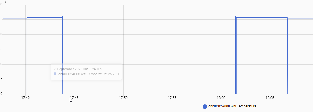

    sascha0171
    insmod wrote:
    I don't have any of them running, only two in storage. One untouched, one with mcu removed. The one with mcu removed gets incorrect data from sensor, and i didn't bother to calibrate it.
    Set mqtt_broadcastItemsPerSec to 9 in autoexec.bat and i suggest disabling diagnostics (unset flag 2 and flag 10).
    I disable diagnostics on every battery-powered devices i use.
    when I set mqtt_broadcastItemsPerSec to 9 or some other value below, the time is indeed enough to transmit all sensor and diagnostic data (left flag 10 enabled for testing). But I have a strange behaviour then, every time when the data is transmitted, it transmits a 0 first and some seconds later the true value, see below. As soon as I remove the mqtt setting it is normal again. No big deal though it still transmits diagnostic data from time to time.
    Also tried to set tuyaMcu_setBatteryAckDelay, but that seems to have no effect on the wakeup time, how would that work if there is no feedback to the TuyaMCU?
    Temperature chart from wifi sensor obk0C02A008 from 17:40 to 18:10
  • Delay TuyaMCU ack to extend wake time
    #147 21651952
    Posts: 14750
    Rate: 12866
    Ok, it is another known issue. You are most likely referencing to values read from MCU. But OBK transmits them first, and then reads them. So, work around is to set those channels to -1 in startup. That way sensor will remember previous values and then transmit them first....
    Alternatively, maybe we should add some simple mechanism to transmit channels that were actually ever set, at least once, what do you think, @insmod ?
    I think I said that there is no feedback from HA to OBK, not from OBK to TuyaMCU. OBK sends feedback (ack) to MCU when it receives data, so MCU knows it can go to sleep. You can delay it by setting tuyaMcu_setBatteryAckDelay in latest releases.

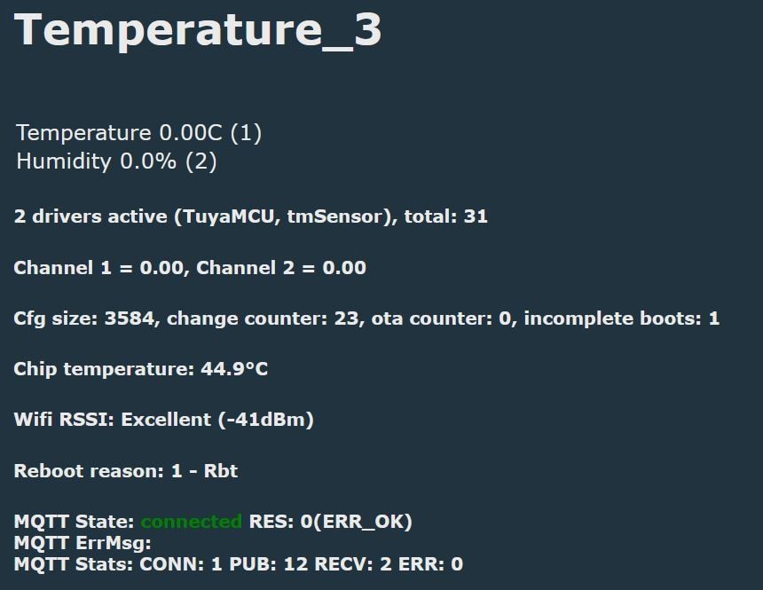

    my device always shows temperature 0 and hum as 0%. I tried few autoexecs from this thread but nothing works :( I have few identical looking devices but some of them have CHT8310 and others AHT20.
    I have problems only with that CHT8310. I have original firmware dump but I don't know how to extract pins from it. How can I discover proper pins or mappings?
    It is powered from main, but also tried on batteries.
    I'm using this autoexec now:

    Photo of my device:
    [BK7231N] [CB3S] [AHT20] TH01 Generic Temperature and Humidity Sensor Teardown
