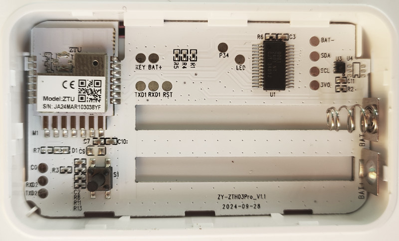

How do I finish the OpenBK autoexec setup for a TH01 temperature and humidity sensor with TuyaMCU?
Add the TuyaMCU-to-channel mappings, not just the two drivers: `startDriver TuyaMCU; startDriver tmSensor; setChannelType 1 temperature_div10; linkTuyaMCUOutputToChannel 1 val 1; setChannelType 2 Humidity; linkTuyaMCUOutputToChannel 2 val 2; setChannelType 3 ReadOnlyLowMidHigh; linkTuyaMCUOutputToChannel 3 enum 3; setChannelLabel 3 Battery` [#20516557][#20516646][#20845707] dpID 1 is temperature in tenths of a degree, dpID 2 is humidity, and dpID 3 is the battery state (low/mid/high) [#20516557][#20516646] For battery-powered operation, the Wi‑Fi module is controlled by the MCU, so initial setup often needs external 3.3 V to the Wi‑Fi module; for no-MQTT use, OBK can either use `tuyaMcu_defWiFiState 0x04` or an empty MQTT host field in newer builds [#20642216][#20931402]

    >>21703018 I've changed autoexec to:
    startDriver TuyaMCU
    tuyaMcu_setBaudRate 115200
    tuyaMcu_defWiFiState 4
    but it won't change anything, maybe these values are on other channels than 1 and 2? How I can find it?

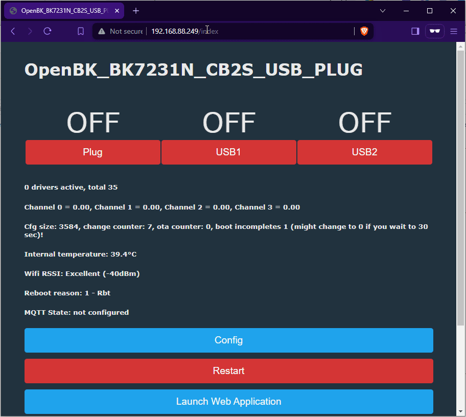

    OpenBK control panel showing Plug, USB1, and USB2 all turned OFF

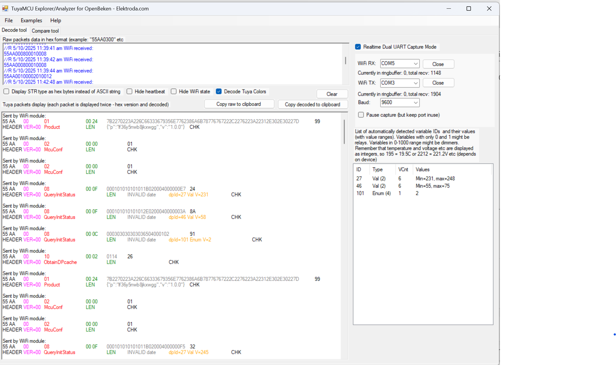

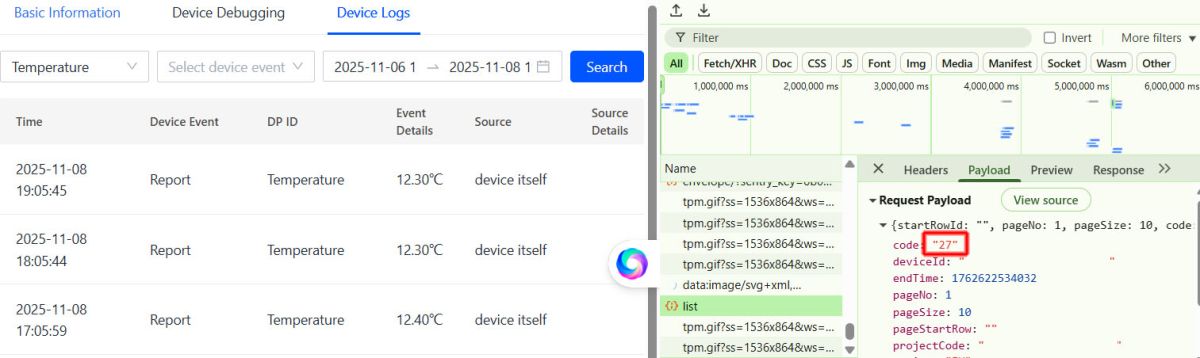

    patanronald
    Level 4  
    Posts: 7
    I have a Tuya TH01 Temp and Humidity sensor. Model is ZY-TH01-CBS3_V1.0 2025-1-07. I have captured the dpID from the device using TuyaMCU analyzer.
    Screenshot of TuyaMCU Explorer displaying UART packet analysis data.
    Screenshot of TuyaMCU Explorer showing UART packet decoding in hex and ASCII
    I tried to use the below code in the Autoexec.bat. The device won't send the things to MQTT and mostly showed zero in the temp and hum field. It will only update the values once and never send the updated values after that. I have the backup of the original firmware if you require this. This is a battery powered device with a MCU chip. Sensor sends the data and goes to sleep to save battery life will be my guess. I am able to flash it and connect to my MQTT server but the temp and humidity doesn't update as you expect when it running the Tuya firmware. I am not sure what I have done wrong. I am bit lost now after I did all the research on this forum to compile the information but not sure what I did wrong.
    startDriver TuyaMCU
    // dpID 27 is temperature div 10
    setChannelType 27 temperature_div10
    linkTuyaMCUOutputToChannel 27 val 27
    // dpID 46 is % humidity
    setChannelType 46 Humidity
    linkTuyaMCUOutputToChannel 46 val 46
    // dpID 101 is battery state - low(0), mid(1) and high(2)
    setChannelType 10 ReadOnlyLowMidHigh
    linkTuyaMCUOutputToChannel 101 enum 10
    setChannelLabel 10 Battery
    Should the config be like this? I am new to this so bear with me.
    startDriver TuyaMCU
    linkTuyaMCUOutputToChannel 46 val 2
    setChannelType 101 ReadOnlyLowMidHigh
    linkTuyaMCUOutputToChannel 101 enum 4
    setChannelLabel 101 Battery
    Thanks for the help.

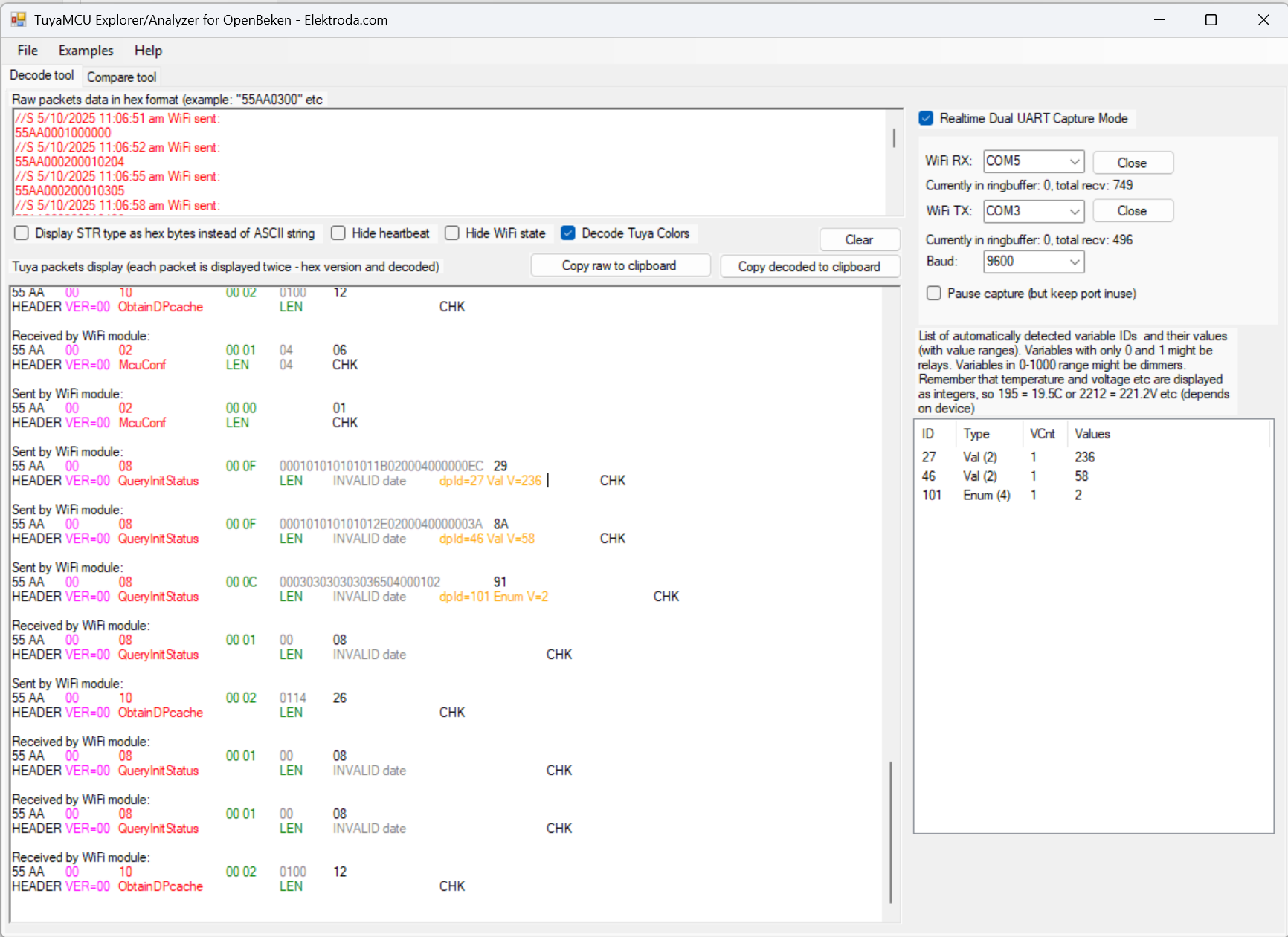

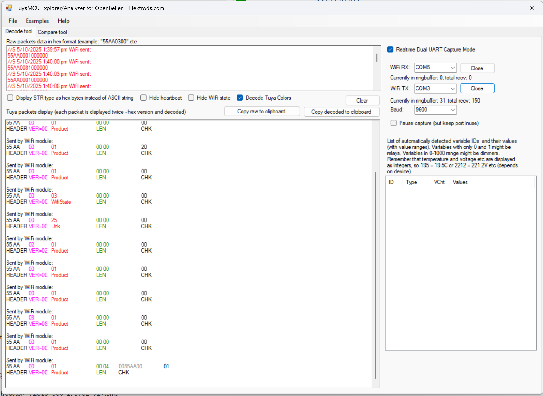

  • #154 21710365
    Posts: 14750
    Rate: 12866
    The basic approach here is to compare your traffic with original TuyaMCU traffic and see where it breaks.
    By the way, there is also an improved version of TuyaMCU driver proposed here:
    https://github.com/openshwprojects/OpenBK7231T_App/pull/1795

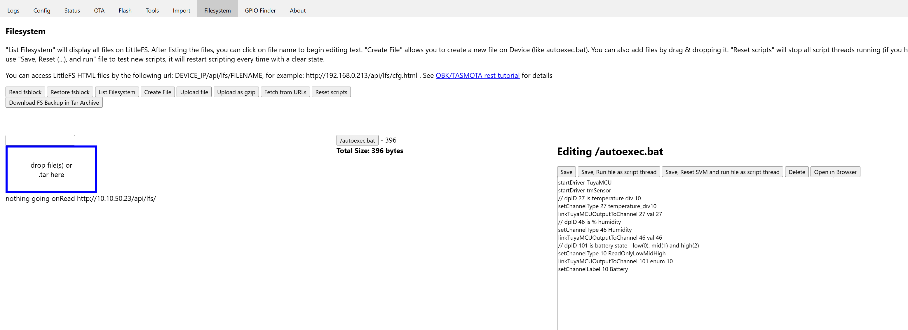

    #155 21710366
    patanronald
    Level 4  
    Posts: 7
    >>21710365
    What do you mean by this? How would I implement the new driver? Do you have any guide how to do this?
    How would I go about comparing the traffic with the original tuya traffic? Am I supposed to use the same analyzer software to see what is reported? If yes, I will flash the openbk firmware and test it again.

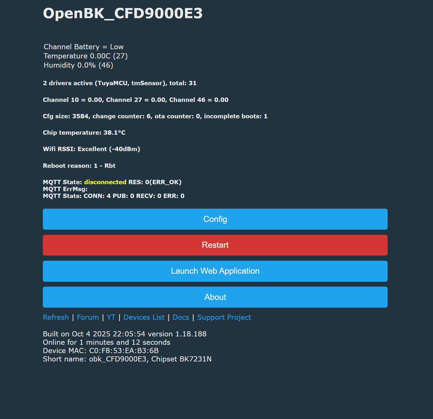

    Added after 1 [hours] 6 [minutes]:
    >>21710365
    I flashed the openopenbk version 1.18.188 and this is what i get. Looks like the MCU is not updating anymore with the values.
    OpenBK status screen showing sensor data and MQTT connection info
    Screenshot of TuyaMCU Explorer showing UART data decoding and configuration
    I am getting this in the logs

    Info:CMD:CMD_StartScript: started @startup at the beginning
    Info:MAIN:Started TuyaMCU.
    Info:MAIN:Started tmSensor.
    Info:GEN:Channel 27 type changed to temperature_div10
    Info:GEN:Channel 46 type changed to Humidity
    Info:GEN:Channel 10 type changed to ReadOnlyLowMidHigh
    Info:MAIN:Drv TuyaMCU is already loaded.
    Info:MAIN:Drv tmSensor is already loaded.
    Info:MAIN:Time 1, idle 214547/s, free 75816, MQTT 0(0), bWifi 0, secondsWithNoPing -1, socks 2/38
    Info:TuyaMCU:Received: 55 AA 00 01 00 24 7B 22 70 22 3A 22 6C 66 33 36 79 35 6E 77 62 38 6A 6B 78 77 67 67 22 2C 22 76 22 3A 22 31 2E 30 2E 30 22 7D 99
    Info:TuyaMCU:ProcessIncoming[v=0]: cmd 1 (QueryProductInformation) len 43
    Info:TuyaMCU:ParseQueryProductInformation: received {"p":"lf36y5nwb8jkxwgg","v":"1.0.0"}

    Added after 9 [hours] 19 [minutes]:
    @p.kaczmarek2
  • #156 21710627
    Posts: 14750
    Rate: 12866
    Maybe OTA removed autoexec.bat
  • autoexec.bat loads but sensor data still missing
    #157 21711224
    patanronald
    Level 4  
    Posts: 7
    @p.kaczmarek2
    How can i check that? I did create autoexec.bat using the application because it wasn't there after the flash.
    Editing autoexec.bat file in Tasmota UI with configuration script visible
    This hasn't helped the situation though. Any other tips?
    I did something and autoexec.bat loaded now but the results hasn't changed. Here is the logs.
    Info:CFG:####### Boot Count 86 #######
    Warn:CFG:CFG_InitAndLoad: Correct config has been loaded with 8 changes count.
    Info:MAIN:Main_Init_Delay
    Info:MAIN:Using SSID [IoT]
    Info:MAIN:Using Pass [none]
    Error:HTTP:Created HTTP SV thread with (stack=2048)
    Info:MQTT:MQTT_RegisterCallback called for bT obk_CFD9000E3/ subT obk_CFD9000E3/+/set
    Info:MQTT:MQTT_RegisterCallback called for bT bekens/ subT bekens/+/set
    Info:MQTT:MQTT_RegisterCallback called for bT cmnd/obk_CFD9000E3/ subT cmnd/obk_CFD9000E3/+
    Info:MQTT:MQTT_RegisterCallback called for bT cmnd/bekens/ subT cmnd/bekens/+
    Info:MQTT:MQTT_RegisterCallback called for bT obk_CFD9000E3/ subT obk_CFD9000E3/+/get
    Info:MQTT:MQTT_RegisterCallback called for bT homeassistant/ subT homeassistant/+

  • TuyaMCU dPID mapping for temperature, humidity, battery
    #159 21712395
    patanronald
    Level 4  
    Posts: 7
    @fjk
    Try my autostart.bat config from here. Your bin file has the following dpID's as below. Hope you can get yours going? Any chance you can take a picture of PCB board?
    startDriver TuyaMCU
  • Working TuyaMCU channel mapping for TH01 sensor
    #160 21712870
    fjk
    Posts: 21
    >>21710040 >>21712395
    This code finally works for me:
    startDriver TuyaMCU
    I'm tried to extract values with TuyaMCU analyzer but it crashes when I choose file to analyze, and BKFlasher shows no info about dpID's

    @fjk I am glad it works for you. I was able to get all the dpIDs but doesn't work for me. The sensor doesn't wake up and update the temp and humidity for me.
    Looks like your board is different to mine but same dpIDs.
  • #162 21712966
    fjk
    Posts: 21
    >>21712873 Maybe try on battery power, I read that sometimes sensors shows zero on main power.
  • #163 21713542
    patanronald
    Level 4  
    Posts: 7
    @fjk I tried powering it using battery and external power using the battery terminals. No luck. Do you mind sharing what you have done in your setup?
  • #164 21715131
    fjk
    Posts: 21
    >>21713542 I'm only use that config mentioned above, I tried to extract channels with TuyaMCU analyzer but it crashes. I tried lot of configs and finally this one which channels 27 and 46 works. Maybe you have different channels?

  • LocalTuya tool reveals Tuya device datapoints
    #166 21745509
    Bulloro
    I apologize if this has been posted somewhere else on the forum; at least I didn't see it in this thread.
    I was having a hard time determining the dpIDs of several different Tuya devices when I finally discovered this: LocalTuya Device Datapoints
    The prerequisites are a Tuya developer account and the device in question must have been connected to the Tuya Cloud. After that, all you need is a browser.
    Device temperature logs and network request details showing code “27”

    Those TH-versions with Display (like this TH03 Pro: Link) are not supported, I guess?
  • Zigbee version uses ZTU module, not WiFi
    #168 21761982
    Posts: 14750
    Rate: 12866
    It depends on what you mean... you linked to Zigbee version, that one:
    [BK7231N] [CB3S] [AHT20] TH01 Generic Temperature and Humidity Sensor Teardown
    It has ZTU module, it's Zigbee module, it can't connect to WiFi.
    Or are you asking about WiFi TH's with LCD screen? I think they work in OBK:
