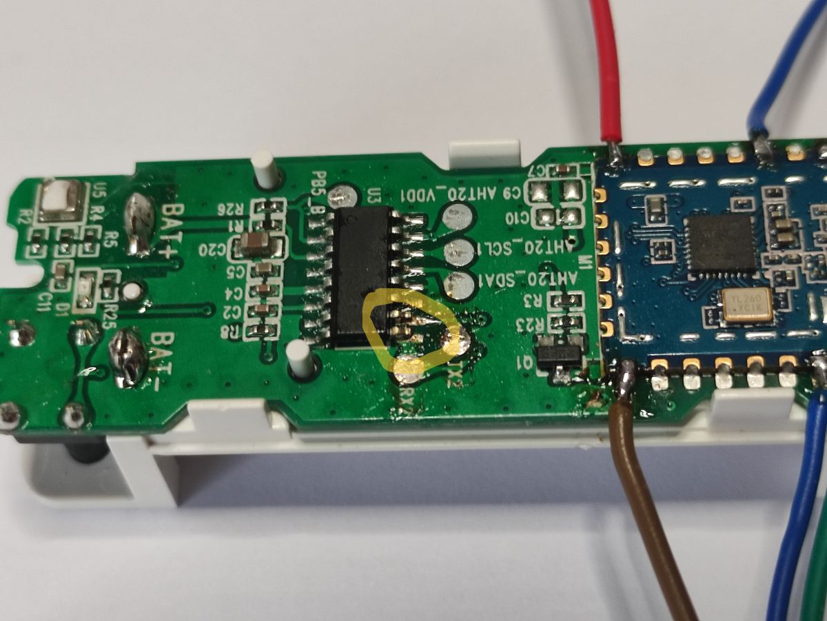

    >>20910745

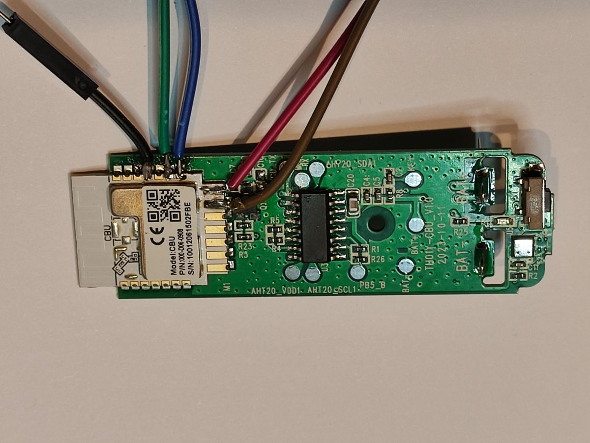

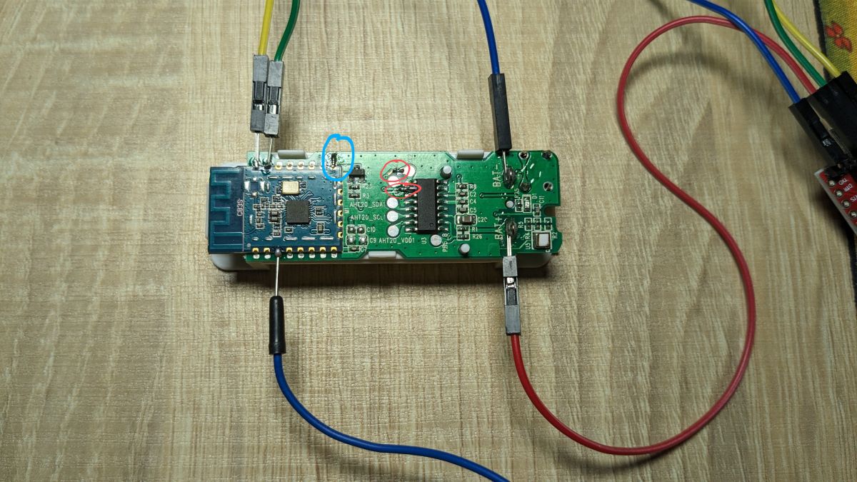

    p.kaczmarek2 you are right. After cutting of the RX and TX traces at the Tuya MCU, I was able to flash with the Windows flasher.Close-up of a PCB with a yellow marking around an integrated circuit.
    Now I have the same problem as grericht and maxen0815 Post #31 to #39. We don't get any useful data on any channel... all are set to 0!!!
    I think that our TH01 sensor is nearly similar to DeDaMrAz but it is different. The PCB is different: we don't have the hole in the middle and the Tuya MCU is 90 degrees offset.
    My only two logs are:

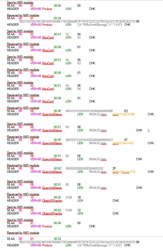

  • #62 20922691
    Wen2024
    Posts: 19

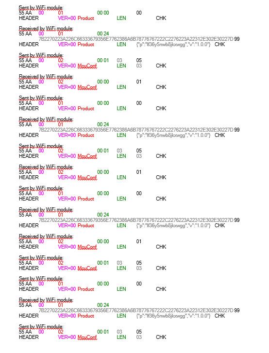

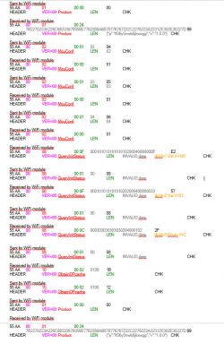

    Screenshot of Tuya TH01 communication analysis using TuyaMCUAnalyzer.
    Today I captured original Tuya TH01 communication with TuyaMCUAnalyzer. See pic and attached txt file. Very good tool!!!!
    • TuyaOrgCommunication.txt (8.22 KB) You must be logged in to download this attachment.

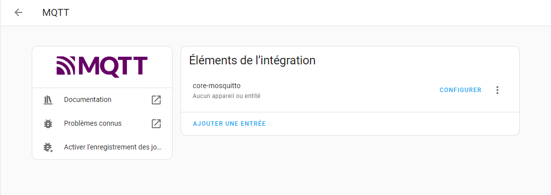

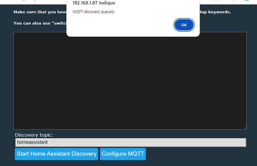

    Hello, I have a problem connecting to Home Assistant.
    MQTT is connected but there is nothing on HA.
    In "Home Assistant configuration" there is nothing written, is this normal?
    Thank you for your help, I couldn't find anything even if I started from the beginning.

  • External power and MQTT required for discovery
    #65 20923288
    Posts: 14750
    Rate: 12866
    @Wen2024 , just to be clear, do you test it by letting it to power itself up on its own? You should not power the WiFi module externally!
    i am asking because I saw that kind of behaviour in the past when I was tampering with the sensor on my own.
    Second question: Do you have MQTT configured? This will wait for your MQTT to connect, so... so you need to have MQTT.
    @gabybriet the YAML code field can be empty, it will still work if you press the Discovery button
  • OpenBeken TH01 communication captured with TuyaMCUAnalyzer
    #67 20923325
    Wen2024
    Posts: 19
    Hello p.kaczmarek2,
    I supply the modules during the tests via the original battery + and - pins.
    I have not configured MQTT because I want to send the data to my server. This works very well with simulated values...
    Screenshot showing communication between the WiFi module and OpenBeken TH01.
    This is captured OpenBeken TH01 communication with TuyaMCUAnalyzer. Flashed with Version: 1.17.408. No MQTT

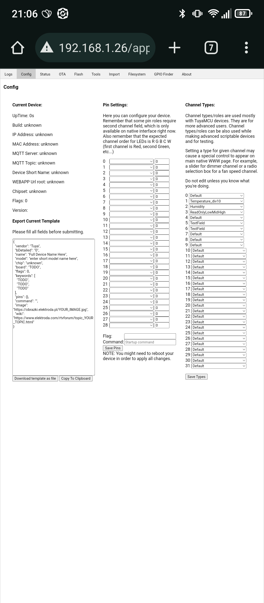

    This autoexec.bat:
    startDriver tuyaMCU
    startDriver tmSensor
    linkTuyaMCUOutputToChannel 1 val 1
    setChannelType 1 temperature_div10
    linkTuyaMCUOutputToChannel 2 val 2
    setChannelType 2 Humidity
    linkTuyaMCUOutputToChannel 3 val 3
    setChannelType 3 ReadOnly
    Added after 4 [minutes]:
    Thank you for photos gabybriet. This is the same PCB as mine.

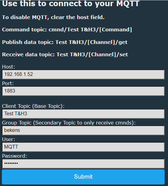

  • #68 20923343
    gabybriet
    Broker options window with fields for MQTT configuration. MQTT connection configuration form with fields to fill in. @p.kaczmarek2 I press the Discovery button, a window opens but nothing happens on HA.
    Maybe a bad configuration?
    I am a beginner.

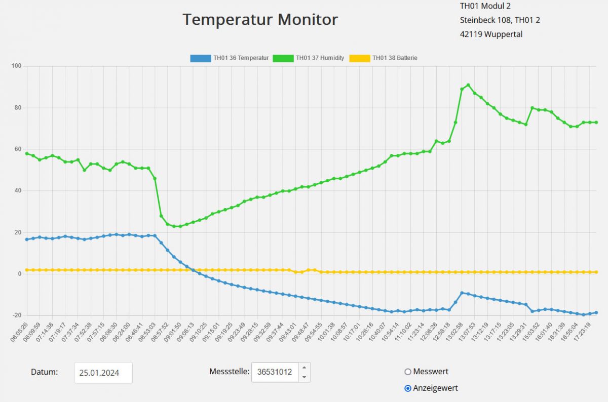

    #70 20928454

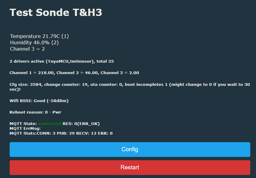

    Wen2024
    Posts: 19

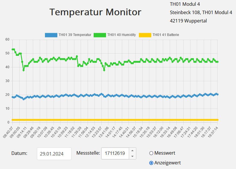

    Hello, I have installed a local Mosquitto MQTT broker on a Windows machine and it runs. I am able to send data to my HTTPS server:
    Temperature monitoring graph showing temperature, humidity, and battery status with labels and time data.
    For testing, this is OK, but I need this functionality without the additional MQTT broker. If the TuyaMCU driver is started, communication always takes place with the MQTT broker. That can't be switched off, can it? Any help is welcome. Thank you!
    Added after 17 [minutes]:

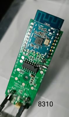

    Hello divadiow (post 51),
    I have flashed such a module and it behaves analogously to the other modules in this article:
    Close-up of an electronic module with several wires attached to a PCB on a white background.
    Best regards, Wen2024

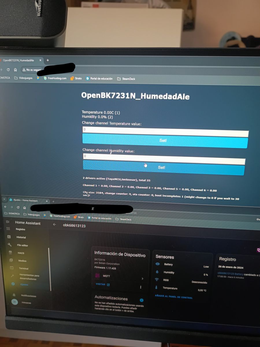

  • Boards connect briefly but report 0 values in Home Assistant
    #71 20930089
    nacxoffw
    Posts: 13

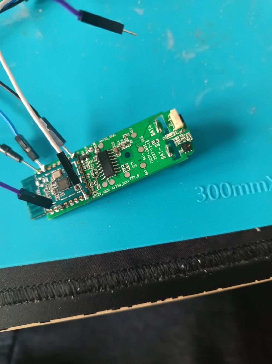

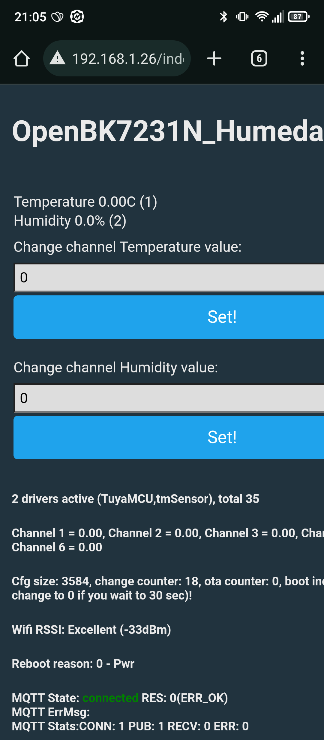

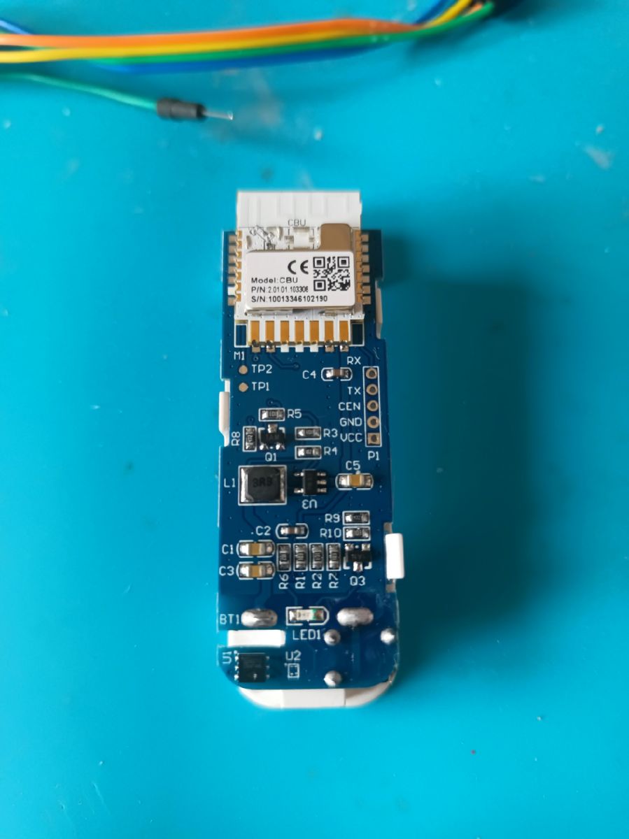

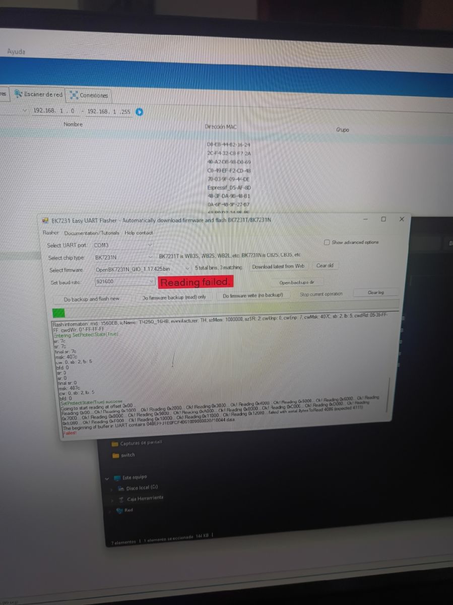

    Hi, I have a similar board but without shared RX/TX pinouts and with easy solder points. After all the process (flash, config wifi, names, autoexe, and MQTT), it's alive in Home Assistant but shows 0 values!!
    Can you help me? Electronic module with components and connector Computer screen displaying OpenBK7231N and Home Assistant software, showing temperature and humidity settings.
    Added after 1 [hour]:
    Another question :)
    Besides, I have two of these boards.
    Both lose the connection on every try after a few seconds. I do the CEN short very quickly. One time, the read process finished but the checks fail. Any tip?
    Thanks!
    Close-up of a green circuit board with connected wires. Computer screen showing Reading failed message in the BK7231 flashing program.

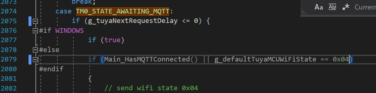

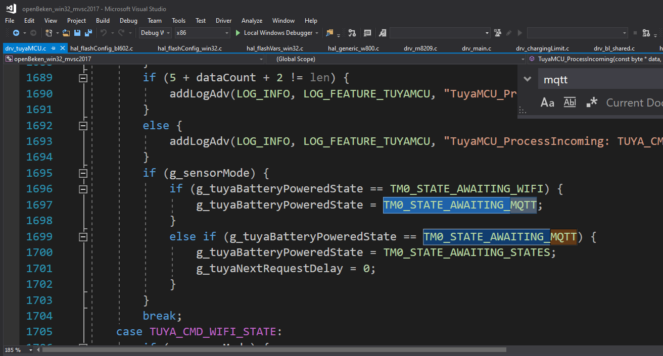

    Well, you don't need MQTT for Tuya smart app, but you need a cloud connection. So, OpenBeken, instead of connecting to cloud, waits for your MQTT to connect:

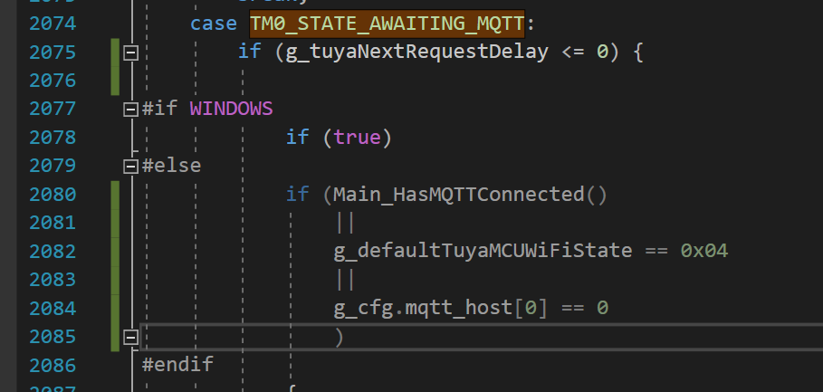

    Screenshot of Visual Studio editor displaying source code of the OpenBeken application.
    We even have an enumerator for that - this specific state is called TM0_STATE_AWAITING_MQTT, that's where your device hangs.
    This is required by TuyaMCU because we need to know when we are ready to report data to MQTT.
    In order to work without MQTT, we would need to slightly alter our TuyaMCU driver. It's possible, but it's debatable how should we do it. Maybe some kind of flag or a time out...

    Hello p.kaczmarek2,
    I would prefer the flag. The module start wouldn't lose any time due to the timeout and it is probably more error resistant at slow WIFI. Could the flag solution work like this:
    autoexec.bat:
    // FLAG_NO_MQTT == true
    SetFlag 999 1
    startDriver tuyaMCU
    drv_tuyaMCU.c:
    else {
    addLogAdv(LOG_INFO, LOG_FEATURE_TUYAMCU, "TuyaMCU_ProcessIncoming: TUYA_CMD_MCU_CONF, TODO!");
    if (g_sensorMode) {
    if (g_tuyaBatteryPoweredState == TM0_STATE_AWAITING_WIFI) {
    g_tuyaBatteryPoweredState = TM0_STATE_AWAITING_MQTT;
    if (FLAG_NO_MQTT == true) {
    g_tuyaBatteryPoweredState = TM0_STATE_AWAITING_STATES;
    g_tuyaNextRequestDelay = 0;
    else if (g_tuyaBatteryPoweredState == TM0_STATE_AWAITING_MQTT) {
    break;
    Best regards,
    Wen2024

    Why do you think that a flag is better than a check for empty MQTT hostname?
    It would work exactly the same, but it would be more intuitive.
    The code would just check if MQTT hostname is set, and if not, it will proceed, it will work just like the flag solution you proposed.
  • #77 20931344
    Wen2024
    Posts: 19
    Yes, you're right. It's easier to understand.
    That was a misunderstanding. I tried out what happens when the field is empty and sent you the logs.
  • Set tuyaMcu_defWiFiState 0x04 or leave MQTT hostname empty
    #78 20931402
    Posts: 14750
    Rate: 12866
    I've checked the code again, and you know what? We could just have set the default Wifi state to 0x04 and it would have worked anyway.
    Code snippet in an editor with highlighted lines and comments.
    Still, here is a new version, it's more intuitive anyway:
    Snippet of code in a text editor showing logic for setting Wi-Fi and MQTT states.
    Here is the commit:
    https://github.com/openshwprojects/OpenBK7231...mmit/e226c8c0806f8d6b8fa64e118ef0b245c0be758a
    So, to sum up, if you want to use tmSensor device without MQTT, you need to do one of two things:
    Option 1: add to script:
    Option 2: make sure that your device has MQTT hostname field empty
    Without any of this, the device will wait until MQTT connects...

  • TH01 runs without MQTT hostname configured
    #84 20935196
    Wen2024
    Posts: 19
    Hello p.kaczmarek2 (post #78),
    I have flashed my TH01 modules with your modified version 1.17.427. I left the MQTT hostname field empty
    and here is the result:
    Graph monitoring temperature, humidity, and battery status with TH01 device.
    The TH01 device runs without MQTT connection!!!
    Next, I need to work on the big variation in the data acquisition interval. In the first test they are between 1:58 and 6:56 minutes.
    Thank's a lot for your work,
    @Wen2024

  • Suspected pinout issue causing zero sensor data
    #85 20958744
    nacxoffw
    Posts: 13
    Hi, after a lot of work flash is done @Wen2024!
    Now it's working BUT data is always zero...
    Screenshot of the OpenBK7231N_Humedad interface showing temperature 0.00°C and humidity 0.0%. Screenshot of a device configuration interface showing IP address and pin settings.
    Electronic board with CB3S module
    Maybe pinout? But... I don't read anywhere to set it.
    I have find this thread https://www.elektroda.com/rtvforum/topic4024423.html#20968680 but without more info...
