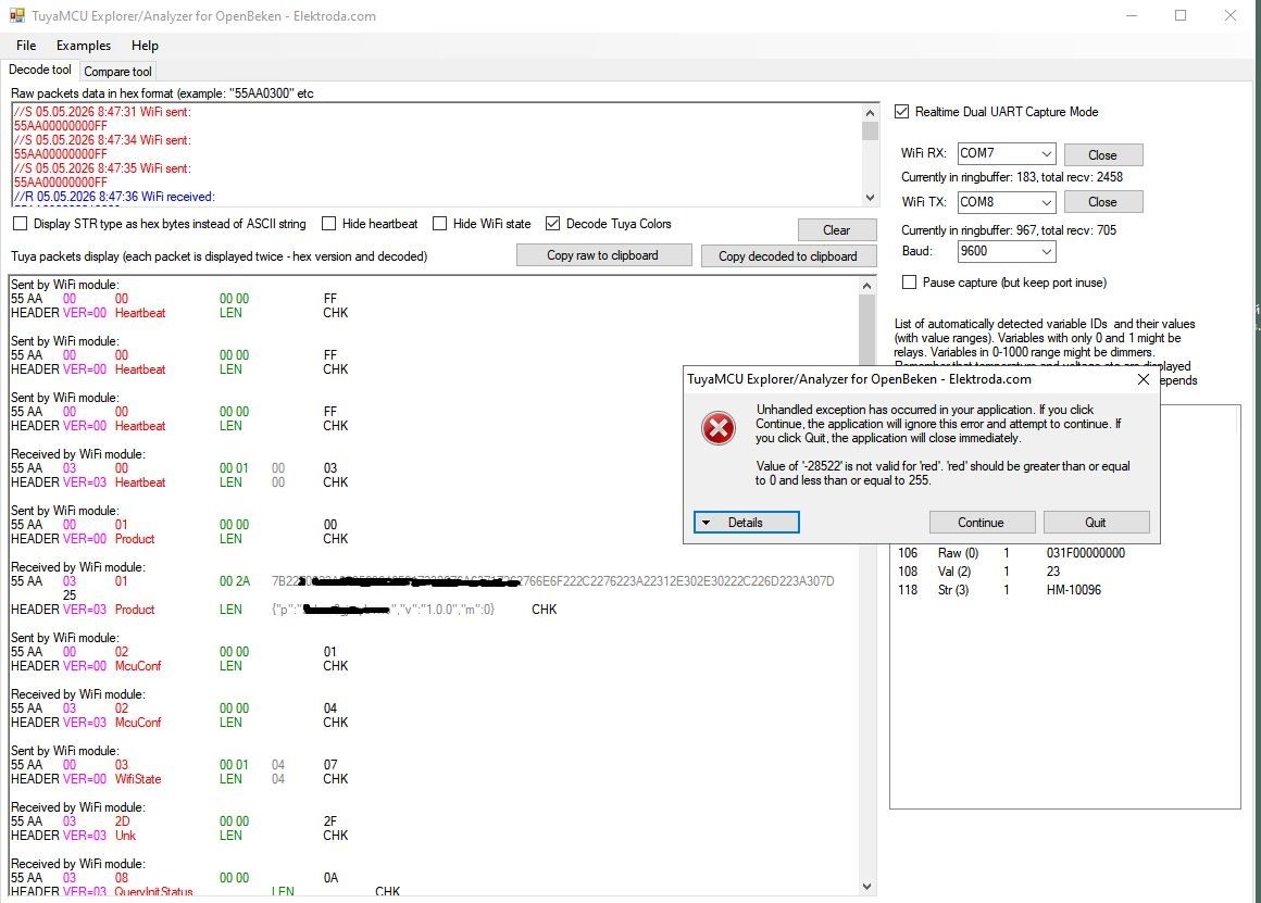

  • #32 21835478
    io2345
    Posts: 273
    Rate: 7
    To tell from the photo in post #2 both CH340 USB-Serial-Adapters have the RX-Line connected to the device (one on MCU RX and one on MCU TX). Is that correct?
  • #33 21835480
    DeDaMrAz
    Posts: 621
    Help: 34
    Rate: 130
    Correct, you can also use something like CH342 that has 2 UART's on single chip and single USB for convenience.
  • #34 21835523
    io2345
    Posts: 273
    Rate: 7
    Thank you. My problem is, that my two CH340 have power on the RX-Line. The newer one has 3,4V, the older one has even 5,2V. Can I get around that by simply using inline resistors, or can small capacitors help?
  • #35 21835641
    DeDaMrAz
    Posts: 621
    Help: 34
    Rate: 130
    Technically they have voltage, and that is normal - problem will be if you attach 3v3 UART to 5V device and vice versa.
  • #36 21896716
    alekslevchuk69
    TuyaMCU analyzer - UART packet decoder for Tuya devices - dpID detector
    I am getting the following error while retrieving data from the module
