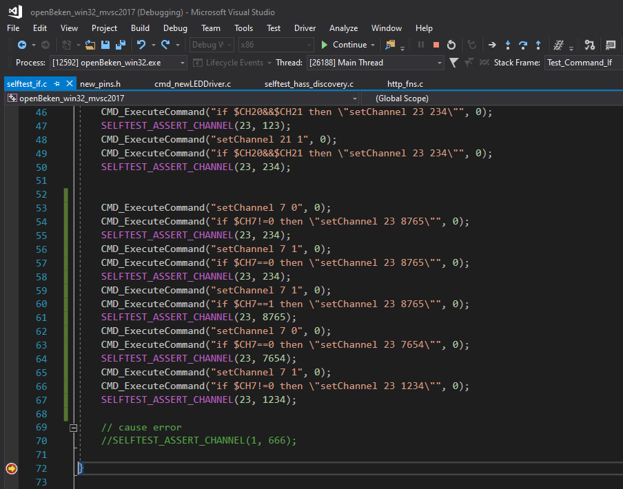

    I am trying to execute the following logic:
    if "CH7" is set to a high state through mqtt, then insert the following code "linkTuyaMCUOutputToChannel 18 val 6 1", otherwise - do not execute
    if - works improperly regardless of whether the condition is met or not, it still performs the function
    Spoiler:
    waitFor MQTTState 1
    // extra delay, to be sure

  • #32 20747501
    Posts: 14770
    Rate: 12913
    Following syntax seems correct. I tested in self-test and it passes correctly:
    Screenshot of Visual Studio code editor showing a C code snippet in the openBeken_win32_msvc2017 project.
    How do you know that CH7 is received from MQTT by the time you execute the code?
    TuyaMCU might don't want to wait for MQTT to go online....
    Maybe keep ch7 in flash and receive it in one session and use in next session?

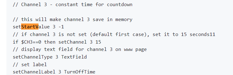

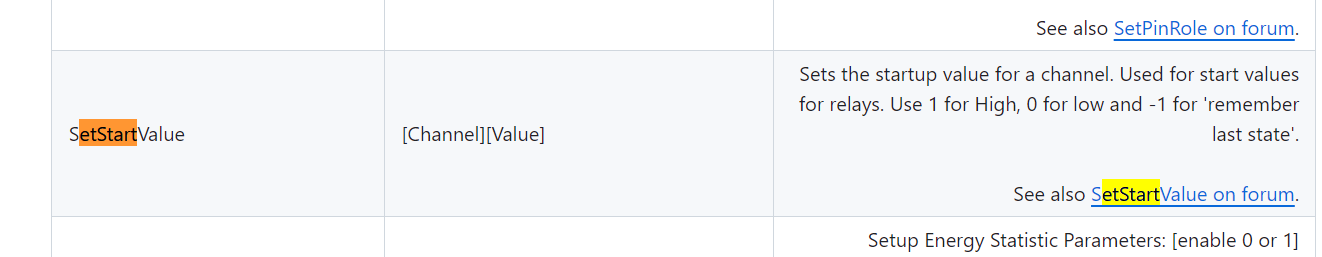

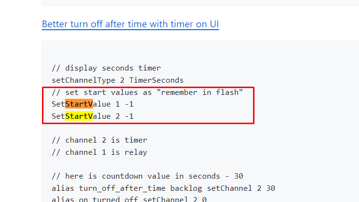

  • Use start value -1 to persist channel state
    #44 20973103
    Posts: 14770
    Rate: 12913
    dotkach wrote:
    how can you save the state of the channel in flash memory?
    Wen2024 wrote:
    you had asked the question: "How can you save the state of the channel in flash memory?
    If you set start value for given channel, for example, set start value of channel 2 to -1, it will remember the previous value.
    Screenshot of a table showing the SetStartValue function and its description.
    So, if you set channel 2 to 123 and reboot, it will be still 123.
    See also:
    Code snippet with settings for initial channel values. Screenshot of code setting initial channel values in a script.

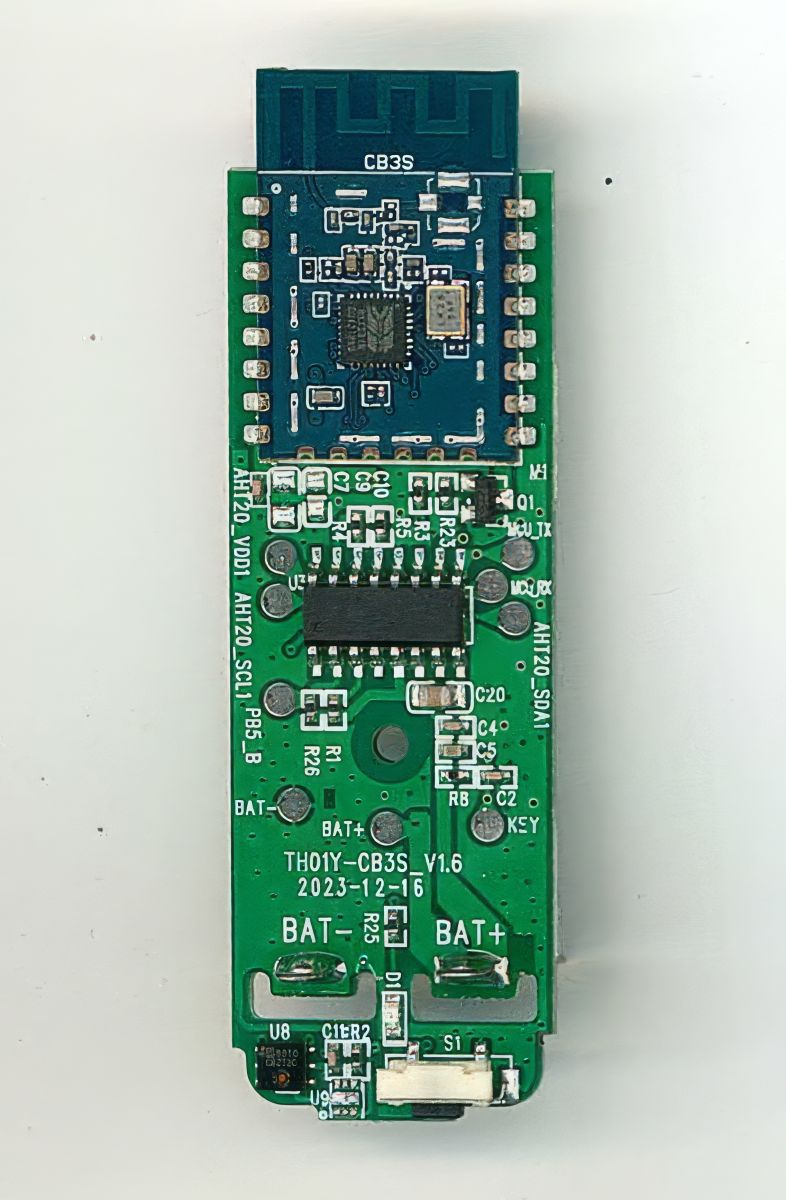

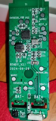

  • Alternate UART flashing procedure for CB3S/BK7231N
    #47 21233509
    xPawelski
    Hello Lads,
    I've found a new way to flash this device (2.1.8 ver from tuya app) without cutting uart traces.
    I've had serious troubles with flashing it over cloudcutter. It was very slow and leaving it overnight also failed.
    After dozens of unsuccessful tries with BK7231 GUI Flash Tool and with hid_download_py I've finally learned the procedure:
    1. Used BigTreeTech BTT Writer 1.0 and BK7231 GUI Flash Tool for that.
    2. Connected green PCB's BAT+ to 3.3v, BAT- to GND, TX to TX and RX to RX (yes, that's not a mistake)
    3. Turned on Flag 26 - [UART] Use alternate UART for BL0942, CSE, TuyaMCU, etc in order to automatically enter flashing mode.
    4. Downloaded latest OpenBeken QIO
    5. Baud rate set to 1500000 (the faster the better, it increases chances of successful flashing during that short window)
    You have to repeatedly press reset button during the flashing in order to prevent device from sleeping.
    Sadly, it's still impossible to configure device after that. In battery mode AP is up for maybe 2 minutes and goes down immediately after connecting to it.
    In order to configure it, you need to power CB3S (blue PCB) directly with VCC (3.3V) and GND pins. That way AP stays forever.
    Now my problem is that even after using correct autoexec.bat (that's with tuyamcu and tmsensor drivers, dpId's 1/2/3) my sensors are not working. They are showing 0.0000 values, even over the MQTT.
    There are no TuyaMCU logs whatsoever.
    After that many attemps I've flashed device without any backup so I don't have factory params anymore.
    CB3S electronic module on a green PCB with BAT+ and BAT- markings.

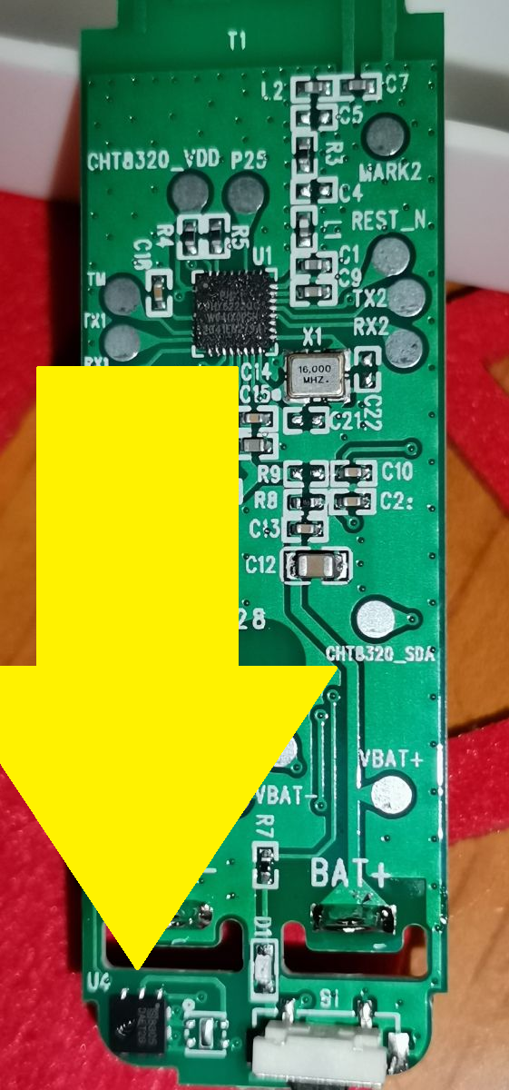

    Witam, który element w tych czujnikach temperatury
    View of a temperature sensor circuit board with component markings. wifi TUYA odpowiada za pomiar temperatury?
  • #50 21330698
    Posts: 14770
    Rate: 12913
    U4 is temperature/humidity measuring chip:
    Close-up of a circuit board with electronic components, highlighted by a large yellow arrow.
  • #51 21330744

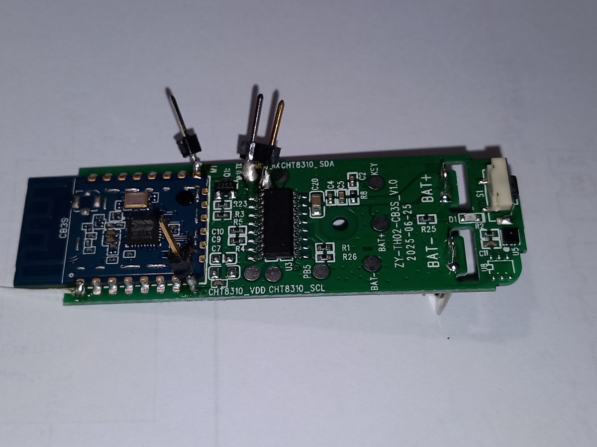

  • OpenBeken autoexec works only with 3.3 V supply
    #58 21772323
    helmutbayerlein
    Hello, I have a similar problem with my TH01, which uses a CHT8310 T/H-Sensor.
    TH01 board with CB3S module and CHT8310 sensor, showing soldered connections.
    Openbeken (1.18.213) could be flashed without problems and I wrote this as autoexec.bat:
    startDriver tuyaMCU
    startDriver tmSensor
    linkTuyaMCUOutputToChannel 1 val 1
    setChannelType 1 Temperature_Div10
    linkTuyaMCUOutputToChannel 2 val 2
    setChannelType 2 Humidity
    But for operation, I always have to connect 3.3V to the CB3S module and the Temp and Hum values show always 0. Chip temperature shows 39.9°C. I guess, the Tuya chip isn't working correct, althought it sends data via serial.
    Do I need some other config except autoexec.bat (flags 10 and 19 are active)?
    Any help is welcome!

Which chip on the TH01 temperature and humidity sensor PCB actually measures temperature and humidity, such as SHT30, CHT8310, or U4?
The temperature and humidity sensor is the small sensor IC marked as U4 on the PCB photo, and the original analysis identifies the measured device as SHT30 over I2C. Later variants may use a CHT8310 T/H sensor. The MCU, not the CB3S, reads this sensor and then sends values through TuyaMCU dpIDs. [#21330698]
