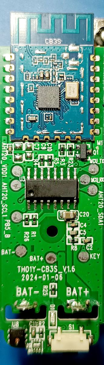

  • #64 21838821
    150219v8
    Posts: 46
    I got a board with different PCB layout and different MCU. On the back side are no more parts, only batteries.
    Close-up of a PCB with a CB3S module and markings BAT+ and BAT-.
