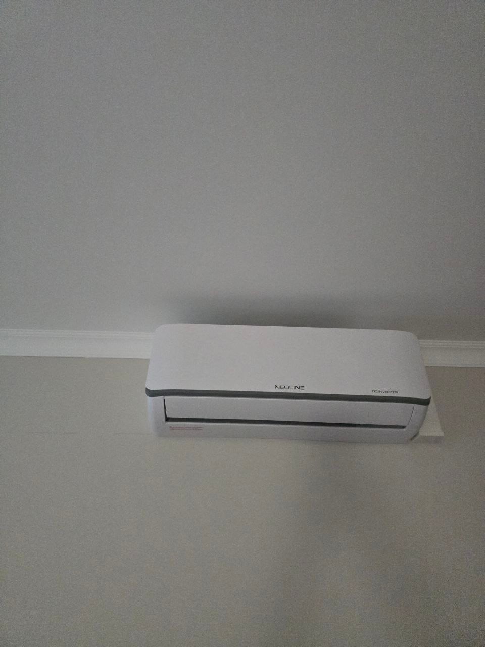

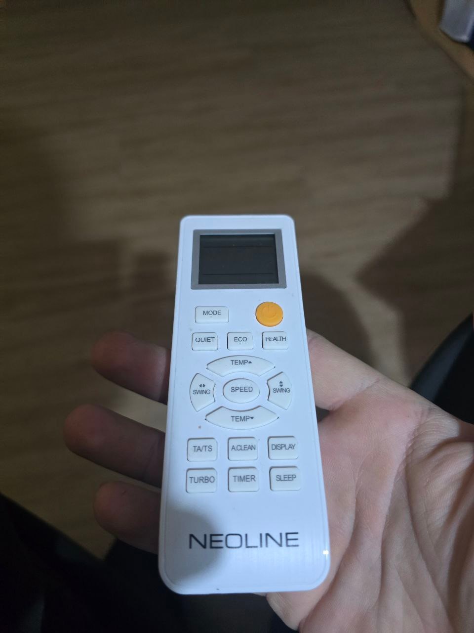

    Hi,
    I'm having an issue with the S06. I have successfully flashed OpenBeken onto the device and it works perfectly to receive the codes of 1 remote (Fan) but not able to receive the codes on my Air Conditioner (AC) remote at all.
    My understanding is that if the device is unknown, RAW IR Codes would be captured/received in the logs, and this happened with the Fan Remote IR Codes but the AC codes are not captured at all in the logs.
    Can someone help me with this? Is there a solution available or is it better to just return the remote?

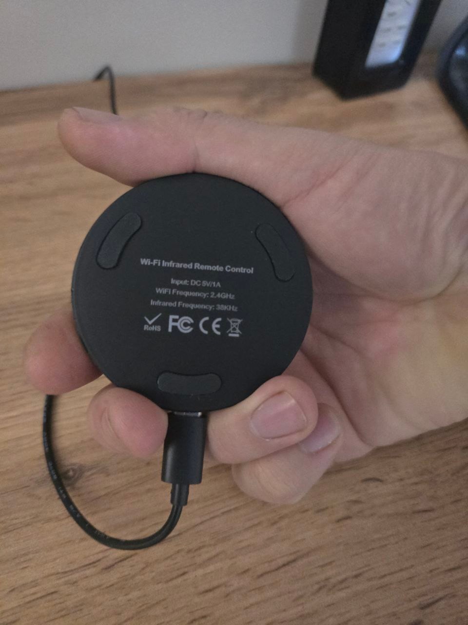

    ysdiego
    Hi people
    First and foremost, I want to thank you for your contributions to the open domotics community. I read a lot, thought a lot, and pulled lots of hair out of my head.. and I could finally flash my S18 mini remote.
    Sadly my happiness waned on the testing face. Although it reads and sends IR codes successfully, it practically has no range. I don't know if I shorted something when soldering the signal wires or if there's some obscure setting to increase the transmit power.
    Thanks in advance!

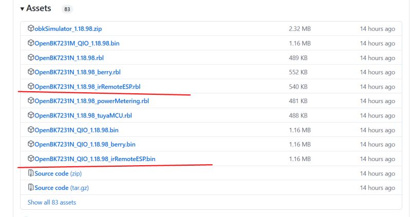

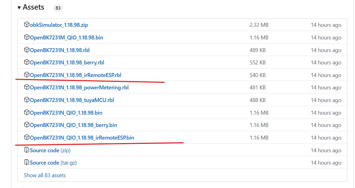

    Important update - obk irremoteesp fork is in builds now:
    https://github.com/openshwprojects/OpenBK7231T_App/releases
    A list of downloadable files from a repository, mainly binary and RBL files for OpenBK7231N versions, highlighted by red lines.
    @ysdiego what is the tuya config of your device?maybe you need to set one pin to high to enable sending?

What is the irRemoteESP OpenBeken build, and when should I use it instead of the standard firmware for AC remote support?
Use irRemoteESP when the standard build receives basic remotes but fails on AC protocols. "irRemoteESP" is an OpenBeken firmware variant that integrates an alternate IR library, adds broader air-conditioner protocol support, and can improve decode results for remotes that appear as unknown in standard builds. The thread first referenced it as a forked build, then confirmed it was added to OpenBeken releases in May 2025. [#21539309]
How do I create an OpenBeken event so one IR remote button triggers an IRSend command to control another device?
Create an event handler that matches the received protocol and code, then calls IRSend. One working example in the thread used startDriver IR, setFlag 1 1, and addEventHandler2 IR_NEC 0xC7EA 0x17 IRSend NEC 0x0 0xA8. The trigger side logged a Roku NEC code, and the destination device accepted IRSend NEC 0x0 0xA8 manually. If the event fires but the target device does not react, test repeat bits or the exact pressed/released variant. [#21714593]
