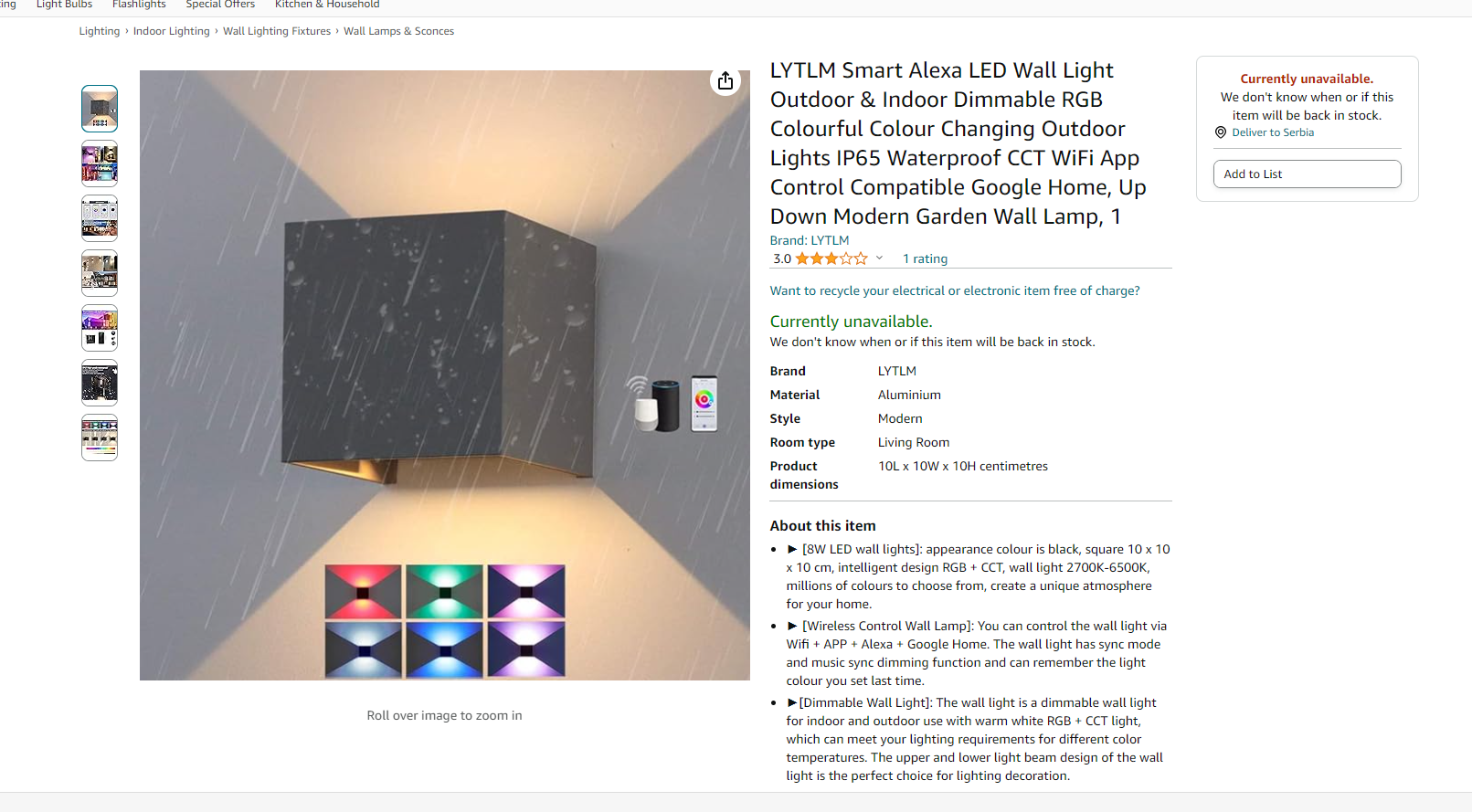

    Modern RGB LED wall light displayed on a product page. Amazon product page for SNADER Smart WiFi LED Lamp, currently unavailable.
    This is the reason we are asking for someone to sell and send them to us, apart from it being unavailable they are not sending it to Serbia unfortunately.

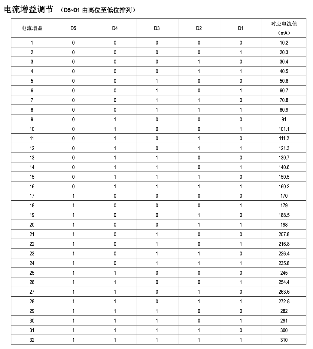

    #38 20983095
    femboozle

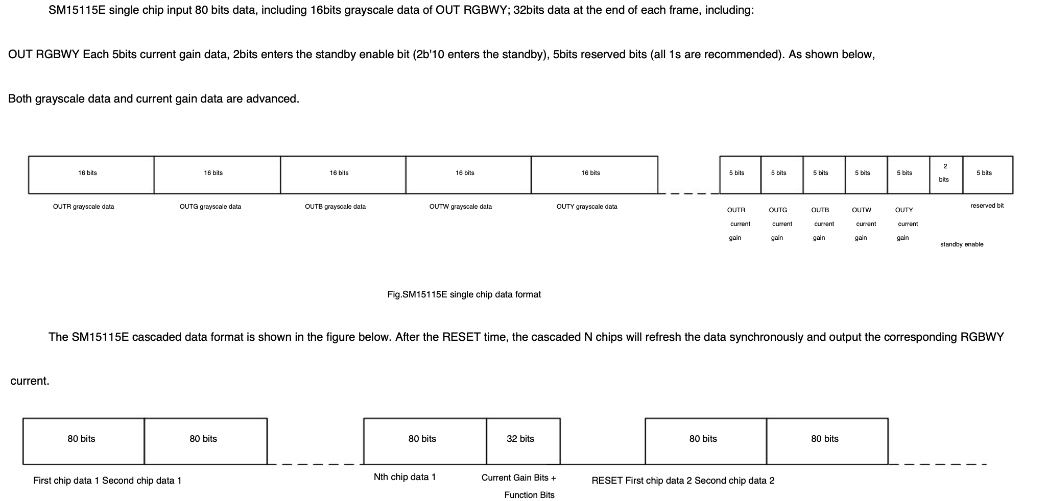

    Hopefully I can help out a bit. There's 80 bits data (16 bits grayscale per channel) + 32 bits at the end of each frame which corresponds to the current limit for each channel (5 bits per channel). In case of the SM15155E, this goes from 10 to 300 mA. Last 7 bits are standby enable and some reserved bits (recommended to keep 11111). I am not sure what the bits should be for the SM15115E, but here's what it looks like for the SM15115E which goes from 10 to 60 mA:
    Table showing current gain and corresponding current values for different bits.
    Diagram of SM15115E chip data format with bit and channel descriptions.
    Let me know if I can be of any more help
  • #39 20983153
    Posts: 14754
    Rate: 12875
    Where did you get all that info? That looks very useful. This will save us some time from reverse engineering.
  • #40 20983185
    femboozle
    I use the SM15115E for one of my projects, it's a great IC. Datasheet contains some translation errors
    • SM15115E_IBSSZZV1.0_产品说明书 (2).pdf (910.32 KB) You must be logged in to download this attachment.

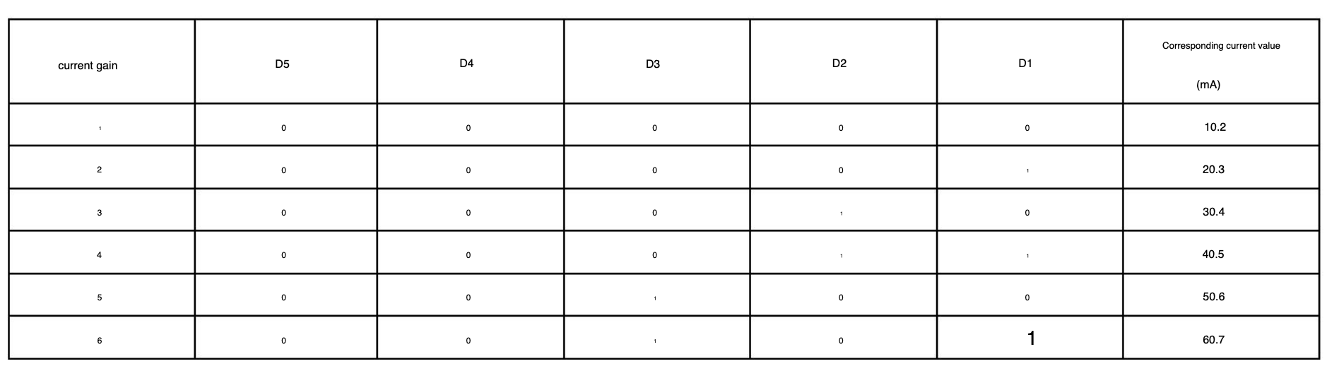

  • #42 20989648
    femboozle
    Here's the current table for the SM15155E:
    Table showing various current values for combinations of bits D5-D1.

    With all the information above I think I would be able to add full support for this chip very fast.

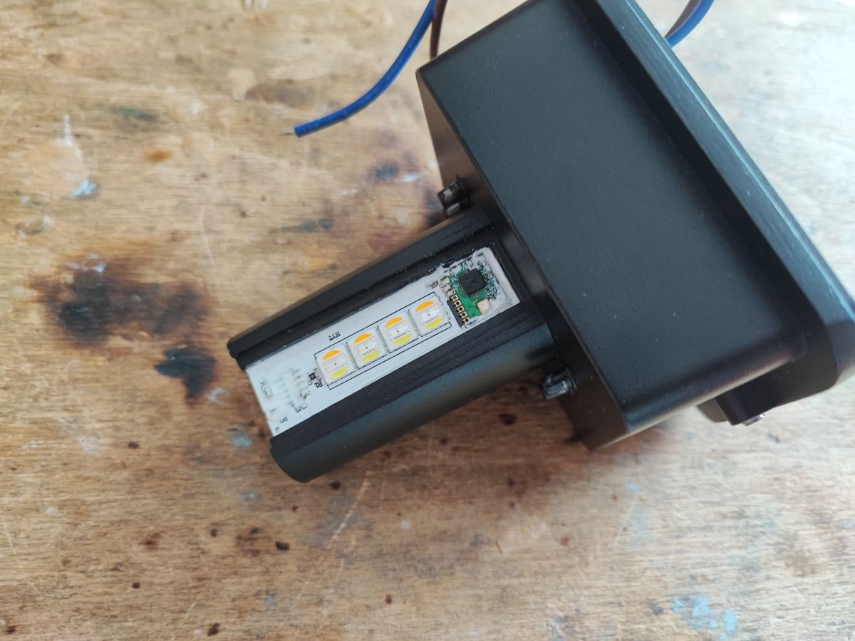

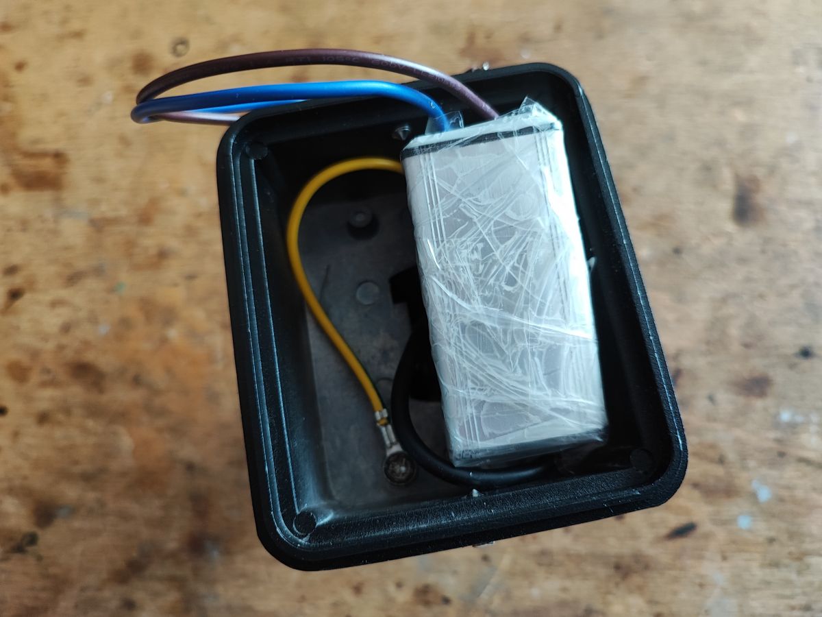

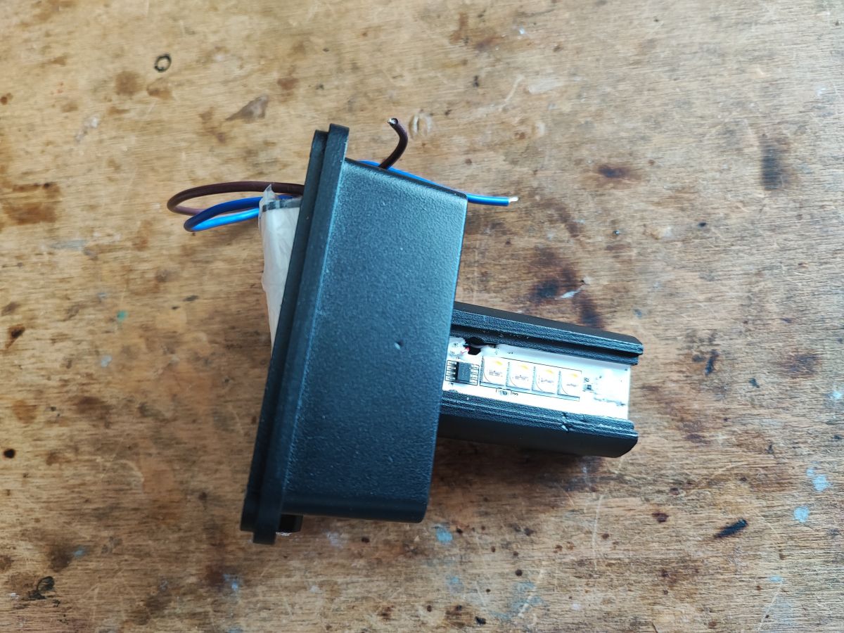

    There was a slight delay with the package due to the post office issues (it was sent as untracked and it stuck at post office until I asked myself....) but here is the light:
    Black plastic socket with exposed wires on a wooden table. Image of the inside of a black plastic box with several wires and a component inside. Close-up of an LED lighting device on a wooden surface.
    I haven't yet managed to look into it, it might take a week or so, but at least I have it on site now.

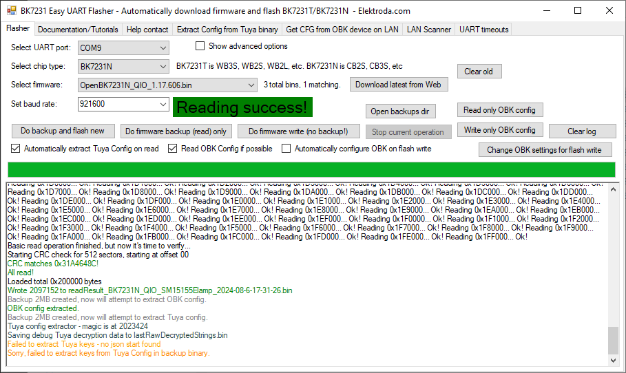

    Posts: 14754
    Rate: 12875
    Hey @HalliHallo , is the light you've send me flashed with OBK or still on Tuya?
    Added after 1 [hours]:
    ok i attached wires
    Screenshot of BK7231 Easy UART Flasher showing successful configuration reading.

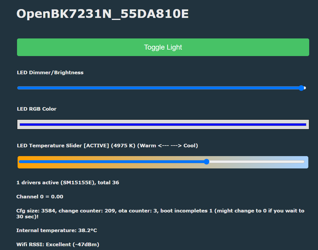

    I'm separating SPI DMA LED backend before introduction of SM15155E driver: https://github.com/openshwprojects/OpenBK7231T_App/pull/1263
    Added after 10 [hours] 53 [minutes]:
    It seems to be working on my side:
    Screenshot of an LED control interface using OpenBK7231N, showing sliders for adjusting LED brightness, RGB color, and LED temperature.
    startDriver SM15155E
    LED_Map 0 1 3 2 4
  • #53 21121695

How do I use OpenBeken commands like startDriver SM15155E and LED_Map to control a 5-channel RGB+CCT lamp correctly?
Start the native driver, then set the channel order for your lamp. The working example in the thread was:
  1. startDriver SM15155E
  2. LED_Map 0 1 3 2 4
  3. Verify RGB, warm white, and cold white outputs. That map matters because the physical lamp wiring did not follow the default logical channel order. Once the native driver and mapping were correct, the developer reported that it "seems to be working" on the real lamp hardware. [#21115906]
WS2812B vs SM16703P vs SM15155E — which protocol is closest for reverse engineering a Tuya smart wall lamp, and where do the differences matter most?
WS2812B looked closest in pulse timing, but SM15155E needed its own implementation. The thread measured about 350 ns / 1150 ns and explicitly compared them with WS2812B and SM16703P, concluding SM16703P did not match well enough. The biggest differences were not only pulse widths. SM15155E also uses 5-channel data with 16-bit grayscale per channel and trailing control bits for current and standby. Those frame-level differences are where reuse attempts broke down. [#20789559]
Why won’t WLED run directly on a BK7231N smart wall lamp, and what alternatives are practical for testing the LED protocol?
WLED will not run directly because the lamp uses a BK7231N, not an ESP-compatible target expected by typical WLED builds. The thread explicitly said you "can't flash WLED on the chip you have" and suggested an ESP-compatible board like a NodeMCU only for external protocol experiments. For this lamp, the practical path was OpenBeken plus protocol reverse engineering, because the unresolved issue was the SM15155E signaling itself, not just firmware branding or UI. [#20827693]
What troubleshooting steps help when an OpenBeken-controlled SM15155E lamp boots into inconsistent colors or only partially responds to brightness changes?
Treat inconsistent color at boot as a protocol issue first. The thread reported green on about 95% of boots, occasional red, and brightness changes working only about 50% of the time during SM16703P experiments. Start by checking driver selection, channel count, and timing assumptions. Then test repeatable raw frames instead of app control. If behavior changes between reboots, do not assume hardware damage; in this case, unstable timing and incomplete frame meaning caused the partial response. [#20778910]
How can I safely probe or modify a mains-powered smart wall lamp with separate power-supply and LED boards without damaging the LEDs or risking electric shock?
Work only with the low-voltage side exposed, and isolate the power-supply board from your probing routine. The teardown states the large housing contained the power supply with 230 V input, while the LED side carried 3.3 V, ground, and LED power across separate boards. That split helps, but it does not remove mains risk. Do not scrape, solder, or scope the device while energized unless you know which section is low voltage. The thread author fully disassembled the lamp before tracing connections with a simple voltmeter. [#20778847]
What was still missing after the timing was decoded for SM15155E support in OpenBeken, and how was the remaining reverse engineering completed?
After timing capture, the missing piece was the meaning of the individual bytes in the SM15155E frame. One developer stated they already had the timings and a per-byte decoder, but still did not know what the bytes meant. Later, another contributor supplied the frame structure: 80 grayscale bits + 32 control bits, including current-limit mapping. With that information and the physical lamp in hand, the OpenBeken team finished the driver and showed it working with startDriver SM15155E. [#20990095]
