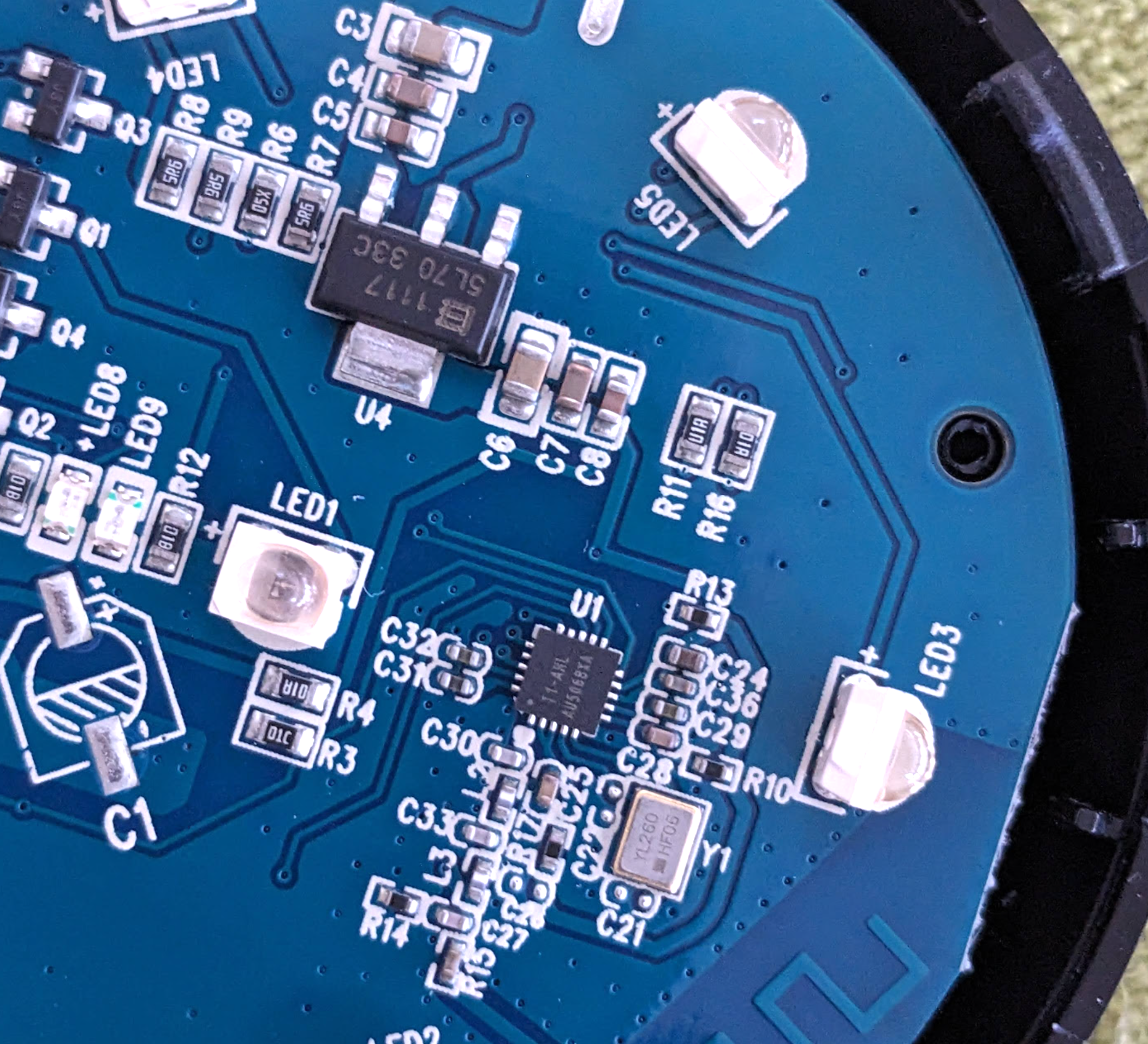

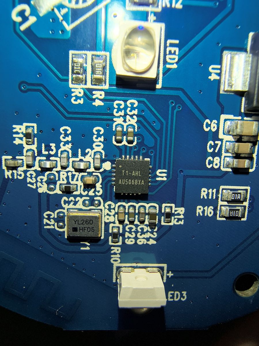

    Hi, I've bought an IR blaster which was supposed to be the "IRC03" one, from here https://aliexpress.com/item/1005006989554373.html

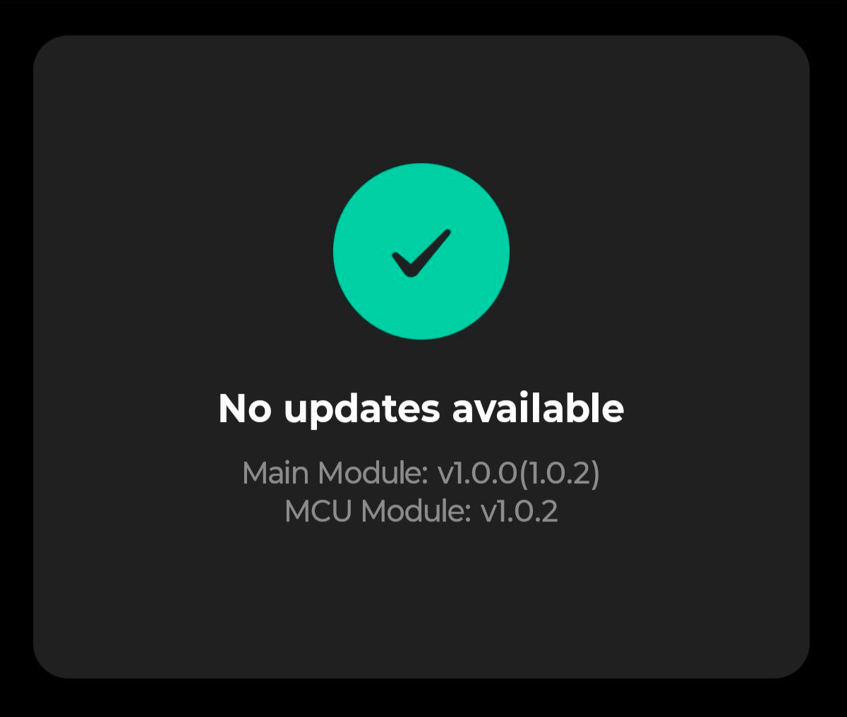

    but it has a totally different chip, which I can't find any information about on the internet, in place of the BK7231N. It reads T1-AHL AU5068XA or AUS068XA. Is it possible to flash esphome to it? When connected to tuya app, it shows firmware v1.0.0(1.0.2)
    Tuya app message: no updates available, module version 1.0.0 (1.0.2)

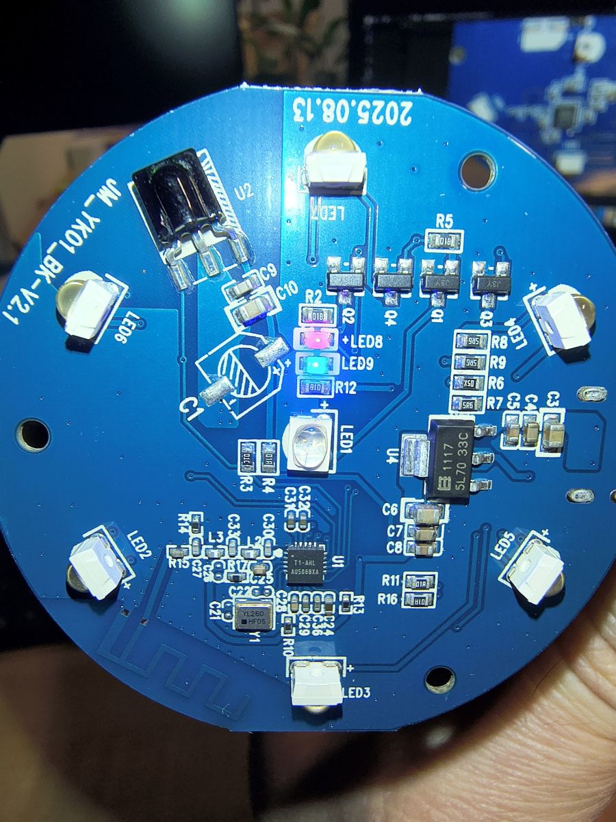

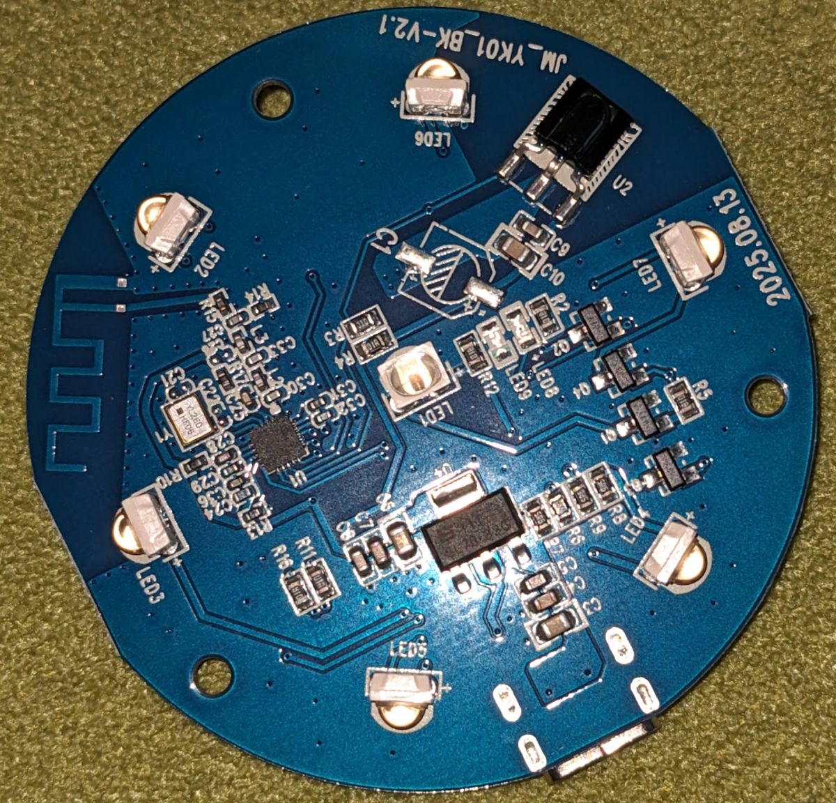

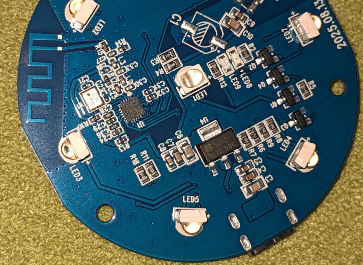

    I have also received 2025.08.13
    Close-up of blue PCB with LEDs and various small electronic components
    Round blue PCB with LEDs, ICs, SMD components, and visible circuit traces.
    Round blue PCB with LEDs, ICs, and a serpentine wireless antenna on green surface
    Close-up of a blue PCB with surface-mounted LEDs and electronic components
    the old versions were tuya cloudcutter compatible, not sure about this one...?

How do I identify whether an Aliexpress 'IRC03' IR blaster actually contains a BK7231N, BK7238/T1, or some other Tuya chip revision?
Sprawdź nadruk na samym układzie scalonym po otwarciu obudowy, bo nazwa aukcji nie wystarcza. Wątek pokazuje co najmniej dwa warianty: starszy egzemplarz z BK7231N oraz nowszy z oznaczeniem T1-AHL, które uczestnicy powiązali z BK7238. Jeśli widzisz T1/BK7238 zamiast BK7231N, procedura i zgodność z firmware będą inne. [#21733400]
