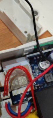

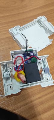

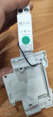

    mvz0209
    Disassembled smart Wi-Fi relay with “VA protection” label visible on casing
    Close-up of smart relay interior with exposed circuit board and colored wires.
    Disassembled plastic casing with electronic components on a wooden surface
    Computer screen showing Bad CRC! error and firmware writing log.
    Hi! I can't flash a smart starter to a din rail. The t1-u-HL chip. Gives the following error:
    CRC mismatch!
    Send by BK 0xB1F27228, our CRC 0x69DCC8B9
    Maybe you have wrong chip type set?
    Writing file data to chip failed.
    I have several devices. And I can't flash any of them. Please help me, friends
    ESP32 module with connected wires in front of a development board and laptop
    Added after 3 [hours] 34 [minutes]:
    Please tell me how I can select only the BK7238 chip in the flasher, and not all BK7231T chips?
  • #12 21722607
    Level 36  
    not sure what this means. You can only select one chip mode at a time in Easy Flasher
    Screenshot of BK7231 Easy UART Flasher with BK7238 chip selected and idle status
    T1-U-HL is BK7238
  • #13 21722611
