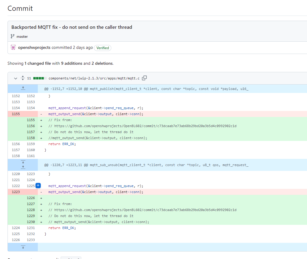

    @beloborodom in the past days I also integrated a threading fix for MQTT from LWIP library that was also applied to BL602 in the past and also helped:
    https://github.com/openshwprojects/OpenLN882H/commit/15fde0f403e408eab6ffa31d0e5711e97c37afe2
    GitHub commit view showing a fix for MQTT in the LWIP library.

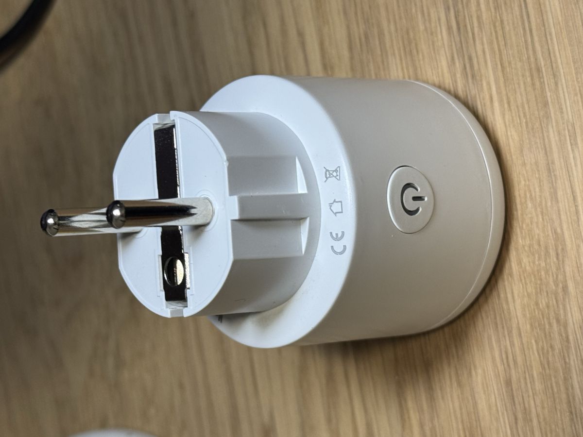

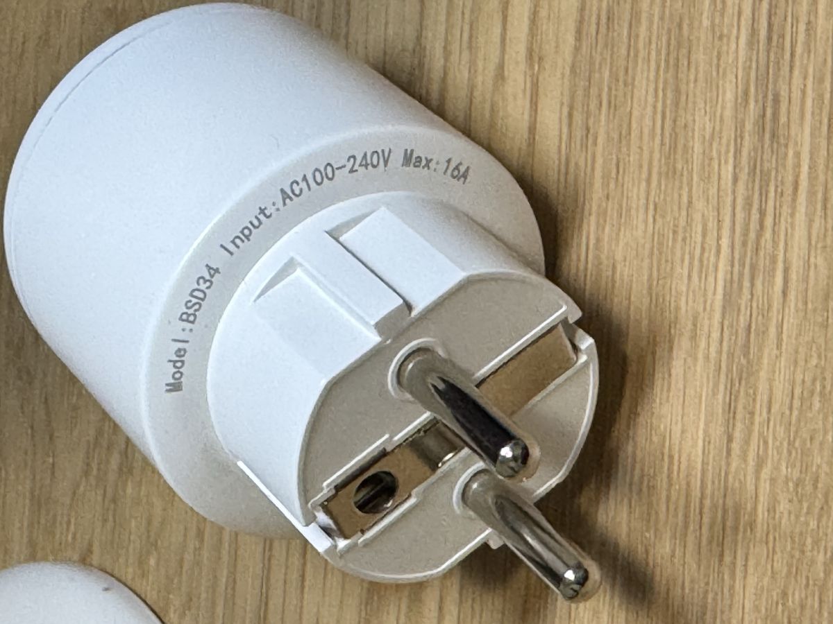

    #36 21438406
    andraskszabo
    Level 4  
    Posts: 10
    They look exactly the same, see pictures. They were sold under SURFOU branding on Amazon.
    The modules are CBS2 by the way...
    I bought them as a 4er pack and they did not even had the same charge of modules. two were "normal" CBS2s and two were those, where the pin marking were swapped (I guess on purpose...)
    Close-up of an electrical plug labeled model BSD34 on a wooden surface.
    White smart plug on a wooden table.
