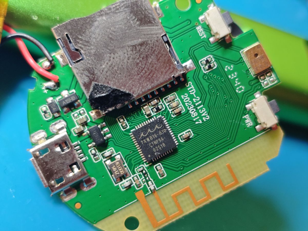

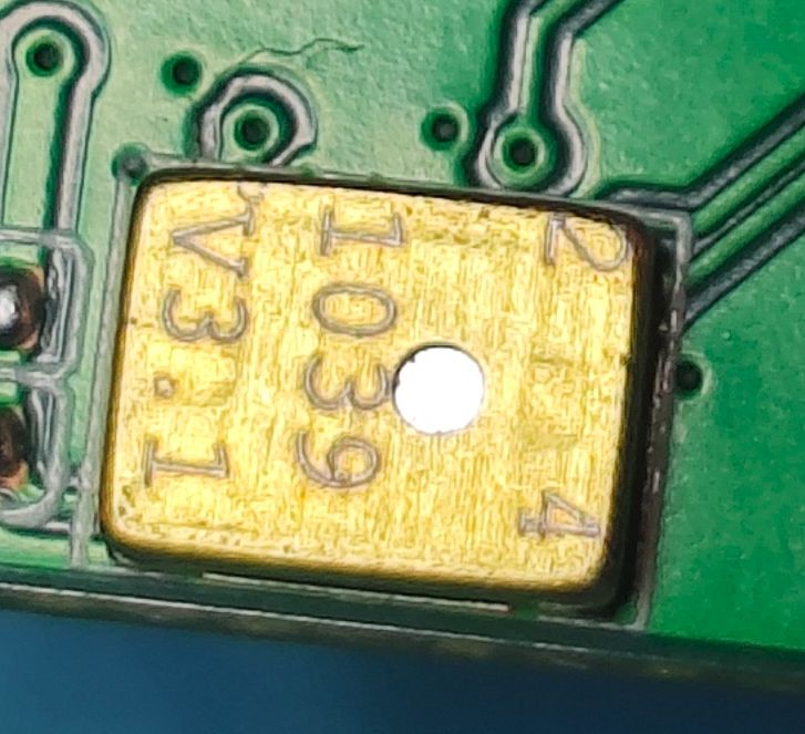

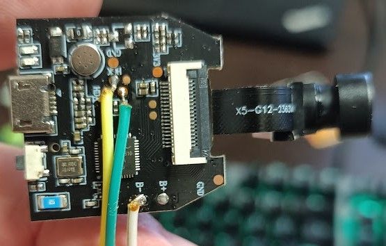

    something a little different. TXW816-810
    Close-up of a PCB with electronic components and a micro USB port
    MEMS microphone?
    Close-up of a gold electronic component labeled V3.1 1039 on green PCB

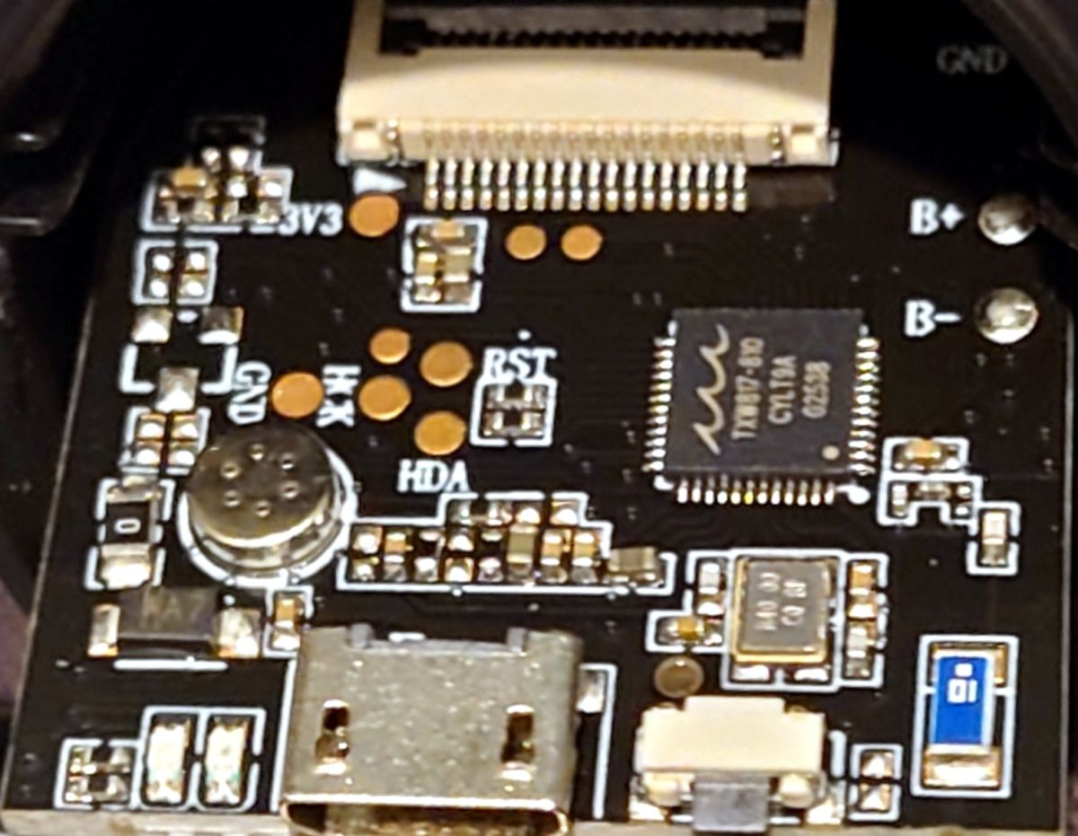

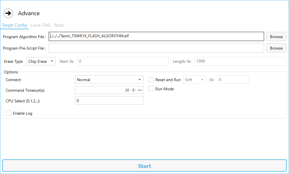

    obviousbullwhip

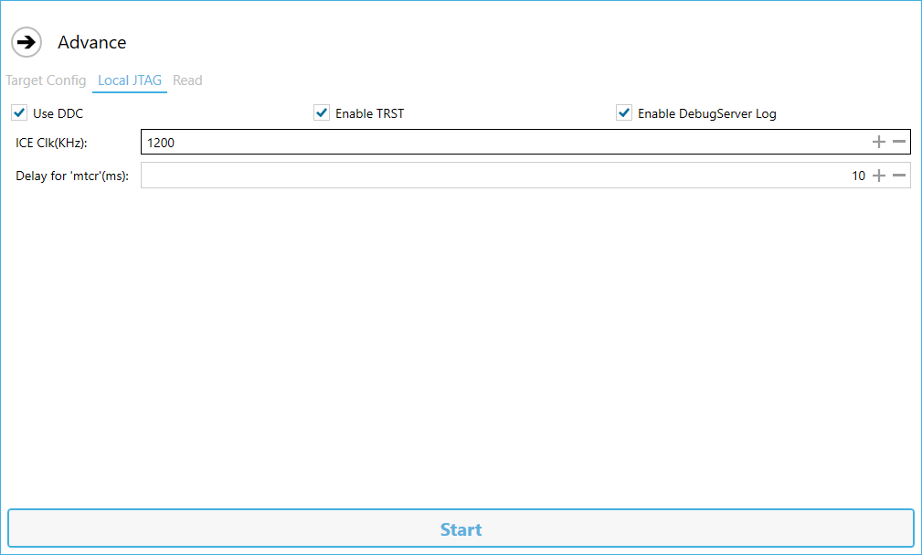

    I have a TXW817-810 based A9 with a blue PCB (IOT_V1.2, D250609) that uses ZIOT (i.e. the same board earlier used by @d1nuc0m), but I have been less successful.
    After successful flashing OpenTXW81X_1.18.221.bin (or the Taixin demo firmware txw81x_v2.5.2.6-31320_2025.5.25_IOT_AT_PC6-PC7.bin) using the C-SKY Flash Programmer, "nothing happens." I.e., after restarting the camera, the "mode" light comes on momentarily, but there is nothing written to serial output (at 115200 or 921600 baud) and there is no Wi-Fi access point.
    Reflashing the original firmware returns the camera to normal operation.
    At times I encounter "flash driver error 55555555", and often firmware writes don't actually succeed (even though they successfully "verify"), so I am manually reading back the binary and comparing against the original to confirm a successful write, so I am sure that I *am* writing successfully, especially as I can reflash the original firmware.
    Can anybody offer any suggestions?
    Thank you
  • Suggesting lower IceClk speed and chip erase

    odd.

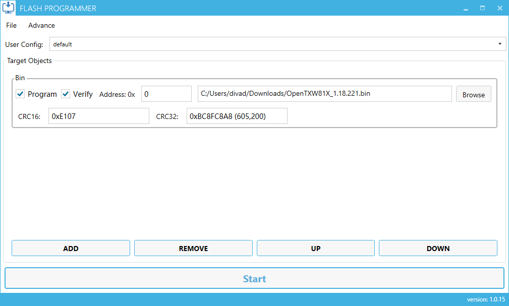

    "flash driver error 55555555" always means no boot for me but "success" after write/verify has always meant a booting firmware. Have you tried a lower IceClk speed?
    Added after 14 [minutes]:

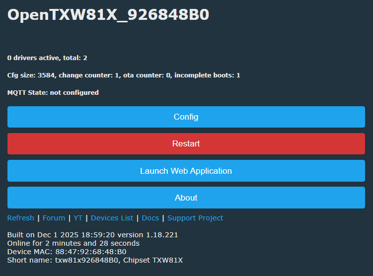

    confirming latest release OpenTXW81X_1.18.221.bin does still work
    Web interface of OpenTXW81X showing configuration and restart buttons
    Flash Programmer window with a loaded binary file ready for flashingJTAG programming config window with FLASH algorithm file and erase optionsScreenshot of Local JTAG settings with DDC, TRST, and DebugServer Log enabled
    STM32 microcontroller with wiring connected to a black power module on a desk
    Added after 17 [minutes]:
    do you have "chip erase" selected?
  • Need a minimal UART hello world firmware
    #187 21768828
    obviousbullwhip
    Yes, definitely odd. I do need a lower IceClk in order to get successful writes (and I know they're successful because I can read them back again), but the only firmware that seems to do anything is the original firmware.
    Does anybody have a "hello world" application that only writes to the UART and does nothing else? Maybe that will work...
    P.S. Yes to chip erase. My screens match your screenshots.

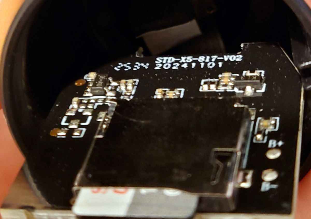

    neagix

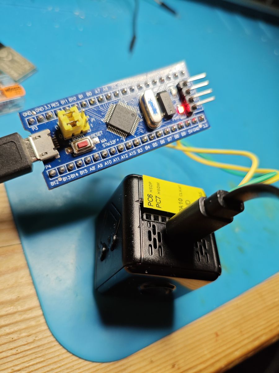

    This is my X5; the board is STD-X5-817-V02 20241101 with a TXW817-810 chip and it uses the Z-IOT app.
    Close-up of a circuit board with electronic components and a USB port
    Close-up of a PCB labeled STD-X5-817-V02 with date code 20241101
    If I understand correctly, this board has JTAG but not serial, and I'd use JTAG to dump or flash the firmware. Did anyone else already dump the original firmware for this model?
    I would be interested in modifying the existing firmware and reflashing it, like this project, and trying the open-source firmware.
    Is there somewhere a summary of what is supported on the open-source firmware?
    Thanks!
    Blue-pill emulates C-SKY programmer for TXW817-810 cameras

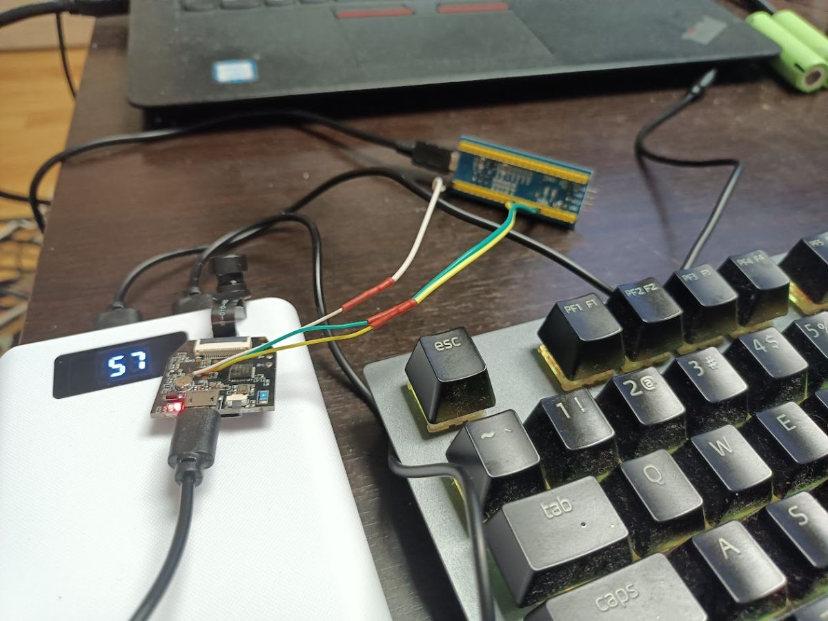

    1. to program the TXW817-810 we need a C-SKY Flash Programmer, which can be emulated by a "blue-pill" circuit.
    Small circuit board with wires next to a keyboard; display reads “57”.
    The procedure is described in https://www.elektroda.com/rtvforum/topic4120455.html
    and to accomplish it we need the following:
    hardware - STM32F103C8T6 "blue pill" and a cheap J-Link clone
    software - I downloaded J-link from https://www.segger.com/downloads/jlink/
    firmware - https://github.com/cjacker/cklink-lite-fw-con.../blob/main/cklink_lite-2.36_for-stm32f103.hex

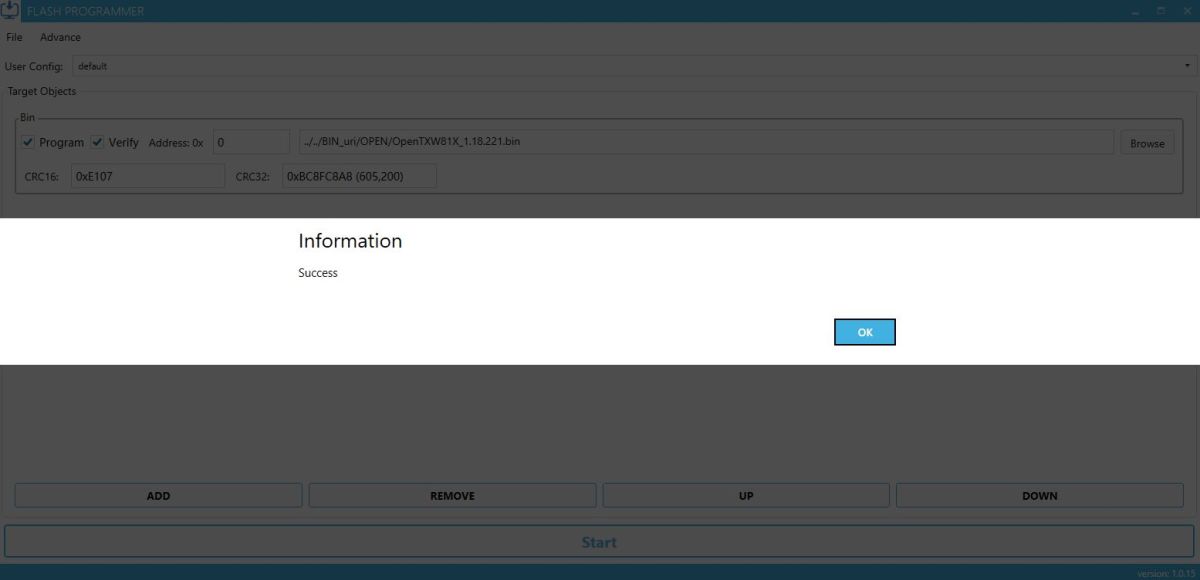

    connect the J-Link clone to the "blue-pill"
    with J-link we will write cklink_lite-2.36_for-stm32f103.hex in the blue-pill and thus we will have a usable C-SKY Flash Programmer.
    2. Download and install C-SKY from https://github.com/openshwprojects/FlashTools/tree/main/C-SKY
    The procedure is described in https://www.elektroda.com/news/news4123724.html
    We make a backup of the original firmware of the camera "just in case"
    We write OpenTXW81X_1.18.221.bin and thus we will have an accessible camera from the local network
    Screenshot of Flash Programmer showing an “Information” dialog with “Success” and an OK button

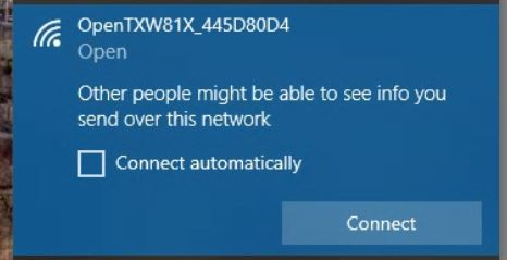

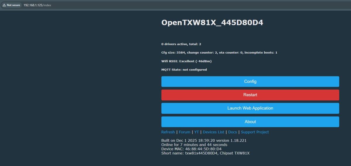

    3. After we have written the new firmware, the camera will be visible with SSID OpenTX81X_xxx as AP.
    Wi‑Fi connection dialog for “OpenTXW81X_445D80D4” with a “Connect” button
    Its IP will be 192.168.4.1 We will connect to it and open a browser with this address http://192.168.4.1
    Screenshot of OpenTXW81X_445D80D4 status page with Config, Restart, and Launch Web Application buttons

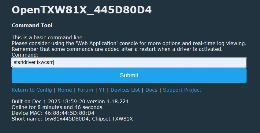

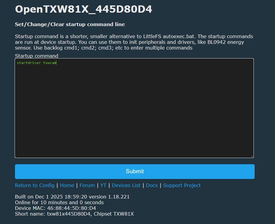

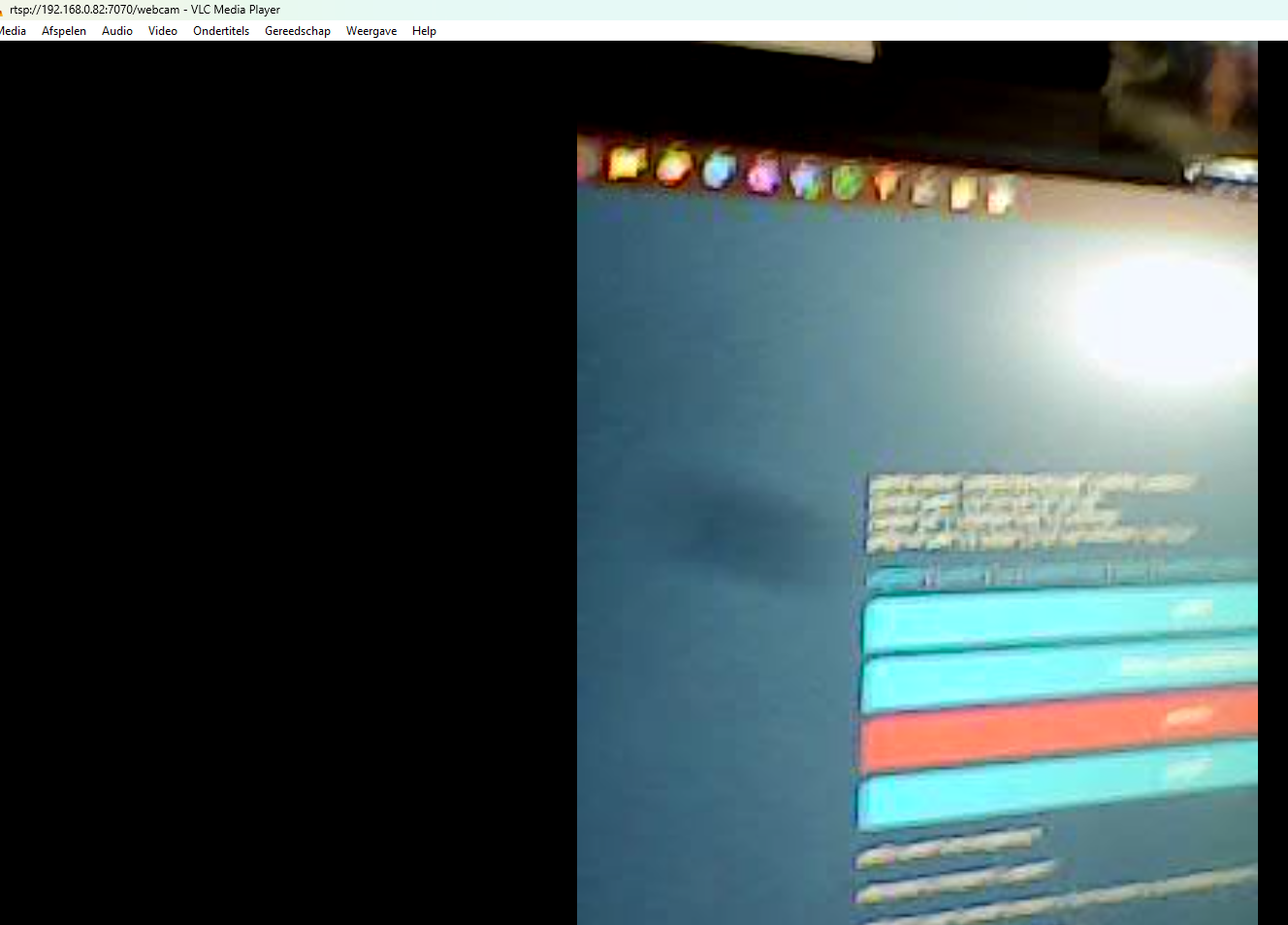

    To start the stream we will execute the custom command "startdriver TXWCAM" or we will execute it permanently in the "startup command".
    Screenshot of an OpenTXW81X page with a “Startup command” text box and a “Submit” button.
    Screenshot of OpenTXW81X Command Tool with a command input field and a Submit button.
    We will also configure our network from the "Configure WiFi & Web" menu, where we fill in our network SSID and password.

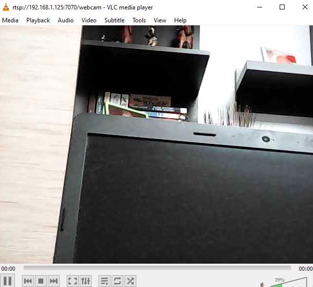

    This way the camera will be accessible (from VLC for example) at rtsp://{ip}:7070/webcam
    VLC screenshot showing a shelf with books and the lower edge of a monitor

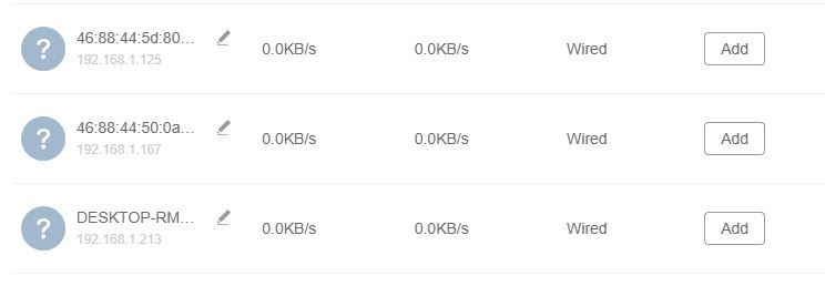

    -under no circumstances, the camera did not connect to my AC-600 router, dual band (2.4 and 5GHz) even though I filled in everything correctly, and the signal was very good, the distance being small, after the reset, I could not find the camera in the router interface. It was necessary to put an "extender" on it with which it worked instantly (by the way, the camera connected instantly in a test with a hotspot on the phone).

    >>21863902 And even stranger is the fact that after I connected the extender, the router shows me that the cameras are connected via wire. Thanks to @divadiow and others for the effort and sharing the experience
    Network device list with IP addresses, “Wired” status, and an “Add” button

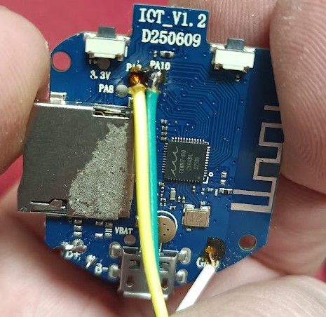

    Ok. Bought several of these: TXW817-810 based A9 with a blue PCB (IOT_V1.2, D250609)
    All flashed successfully, but I'm new to this. How to enable LEDs? ;-)
    Also, what I notice, they only work powered from USB? Doesn't the battery work? As soon as I unplug USB, Wi-Fi is gone...
  • #197 21870672

  • Solder fault prevented CKLink target connection
    #198 21870841
    pergolafabio
    Posts: 7
    d1nuc0m wrote:
    Hi, I got all the necessary - the STM32 is flashed and now shows as CKLink-Lite in device management, but when I try to run the flash programmer I get "Error - DebugServer Start error, can't connect to target"
    Maybe is the pinout wrong? I connected (A9/STM32) GND/GND, PA9/A5 and PA10/A1; both powered through USB
    The PIN layout is OK, I had the same issue, in my case it was a solder problem, once resoldered the one that wasn't soldered correctly, error was gone, it just means that the A9 can't be found to program

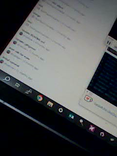

  • Camera quality limited by cheap A9 sensor hardware

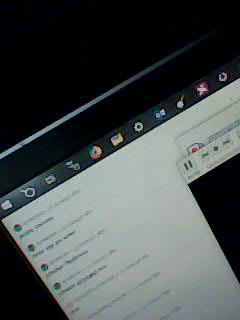

    i have these: TXW817-810 based A9 with a blue PCB (IOT_V1.2, D250609)
    indeed compared with ziot app and flash, it isn't that great indeed!!
    i had some older A9 cameras bought like 5 years ago, using Hidvcam, they had rtsp open out of the box, and quality was super!
    But below quality is normal? cause its really bad imo :)
