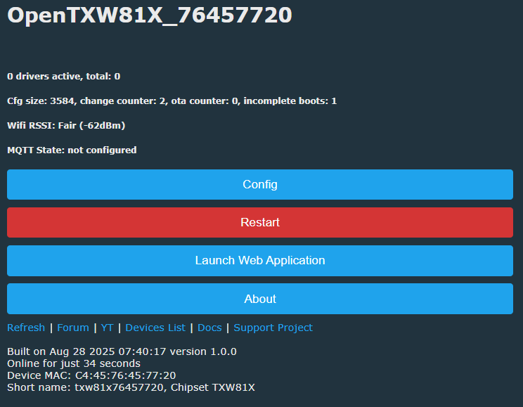

    Got it to connect to wifi.
    Camera is disabled for now
    OpenTXW81X network UI with active Wi-Fi and Restart button highlighted
    Spams NO FREE TCP_PCB, even if only 3 sockets are used...
    Info:MAIN:Time 95, idle 0/s, free 136928, MQTT 0(0), bWifi 1, secondsWithNoPing 24, socks 3/20

  • #66 21646955
    Posts: 5208
    Help: 446
    Rate: 914
    Dude that's awesome 👍🏻
    insmod wrote:
    NO FREE TCP_PCB!
    Hmm. Couldn't seem to shake this before either.

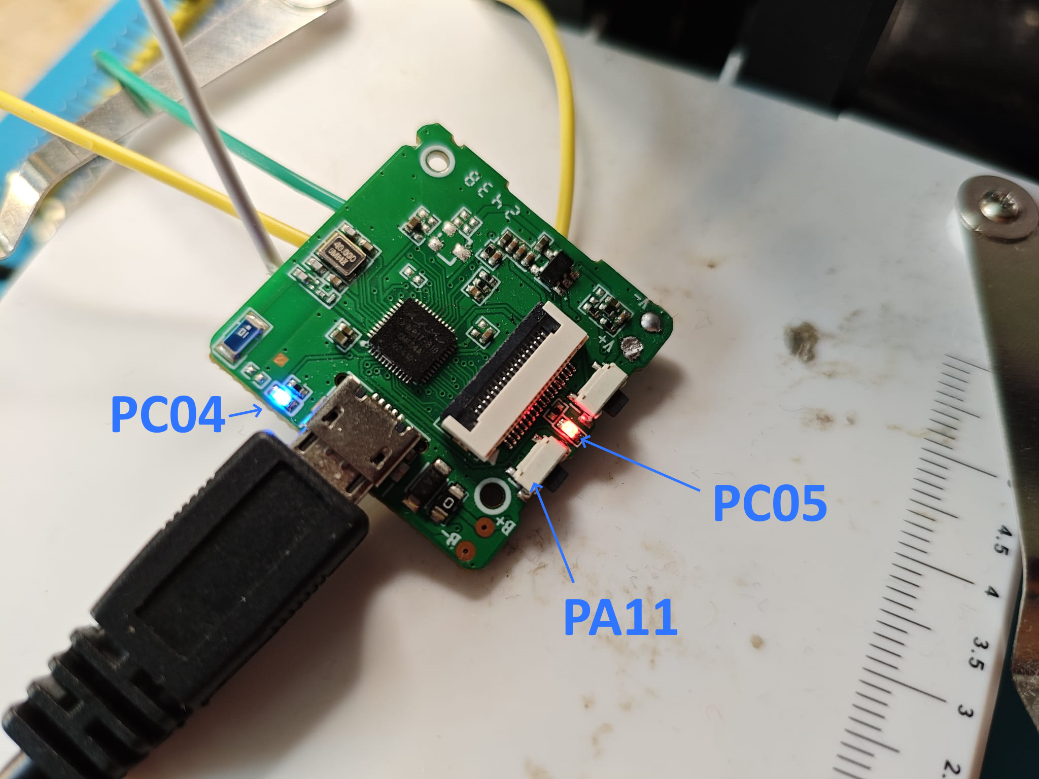

    Rate: 12875
    #68 21647019

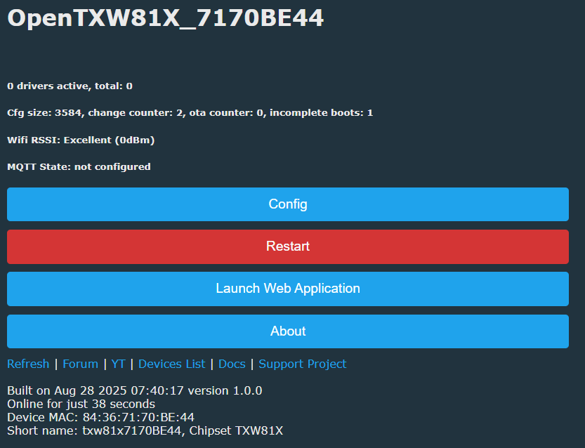

    OpenTXW81X boot log and flash sector errors

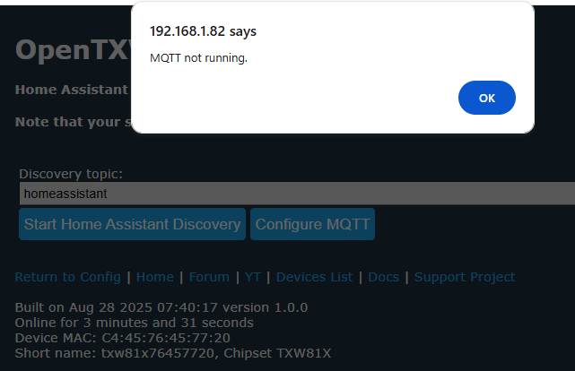

    #69 21647165
    Posts: 5208
    Help: 446
    Rate: 914
    Screenshot of the OpenTXW81X device web interface showing system details and control buttons.
    Added after 4 [minutes]:
    Browser alert message MQTT not running shown on the OpenTXW81X configuration web page.
    Added after 1 [hours] 15 [minutes]:
    wondering what you've set
    Code: C / C++
    to in lwipopts.h @insmod

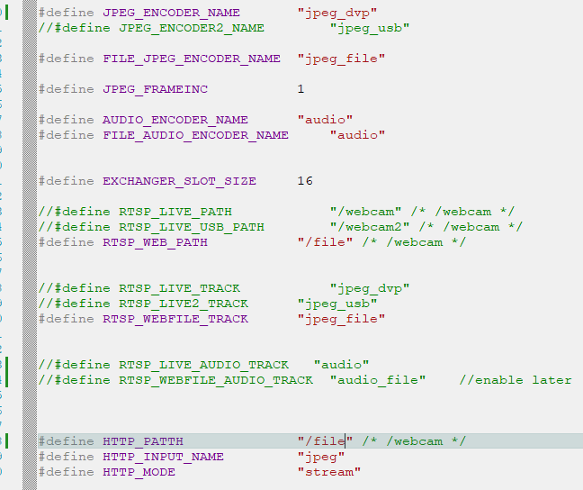

  • #72 21647266
    sebek2435
    Posts: 14
    Have you tried the rtsp webfile yet? Would be nice to be able to open the cam in a browser instead.
    Not really sure if that's how it works but would this setup work maybe?
    Screenshot showing configuration code for RTSP and HTTP settings, specifying video and audio stream paths.

    #73 21647318
    Posts: 5208
    Help: 446
    Rate: 914
    hmm. with a spook_config.h of this:
    Spoiler:
    #ifndef __SPOOK_CONFGIG_H__
    #define __SPOOK_CONFGIG_H__
    //#include <board_config.h>
    #define FRAME_HEAP 20
    #define SPOOK_MAX_FRAME_SIZE 0/*352*288*3*/
    #define SPOOK_PORT 7070
    #define JPEG_ENCODER_NAME "jpeg_dvp"
    #define JPEG_ENCODER2_NAME "jpeg_usb"
    #define FILE_JPEG_ENCODER_NAME "jpeg_file"
    #define JPEG_FRAMEINC 1
    #define AUDIO_ENCODER_NAME "audio"
    #define FILE_AUDIO_ENCODER_NAME "audio"
    #define EXCHANGER_SLOT_SIZE 16
    #define RTSP_LIVE_PATH "/webcam" /* /webcam */
    #define RTSP_LIVE_USB_PATH "/webcam2" /* /webcam */
    #define RTSP_WEB_PATH "/file" /* /webcam */
    #define RTSP_LIVE_TRACK "jpeg_dvp"
    #define RTSP_LIVE2_TRACK "jpeg_usb"
    #define RTSP_WEBFILE_TRACK "jpeg_file"
    #define RTSP_LIVE_AUDIO_TRACK "audio"
    #define RTSP_WEBFILE_AUDIO_TRACK "audio_file"
    #define HTTP_PATTH "/webcam" /* /webcam */
    #define HTTP_INPUT_NAME "jpeg"
    #define HTTP_MODE "stream"
    #define JPEG_FIFO_SIZE 3
    #define SCAN_DATA_OFFSET 0x253//0X265
    #define MAX_DATA_PACKET_SIZE 1440
    #define SPOOK_CACHE_BUF_LEN 1600
    extern unsigned int live_buf_cache[SPOOK_CACHE_BUF_LEN/4];
    typedef struct
    const char* sema_name; //sema name
    const char* rtp_video_name; //rtp流名字
    const char* audio_name;
    const char* thread_name;
    const char* stream_name;
    const char *jpg_name;
    const char* path;
    }rtp_name;
    #endif
    I do not get anything for
    192.168.4.1:7070/webcam
    ../webcam2
    ../file
  • #74 21647327
    sebek2435
    Posts: 14
    I would assume you also need to change this to match the web path. But if that doesn't work hopefully someone figures it out soon.
    You have already made so much progress though it's amazing. I can't wait to start tinkering with mine soon.

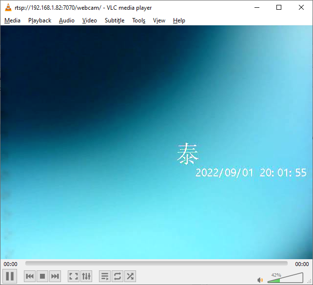

    insmod
    Posts: 1432
    Help: 168
    Rate: 455
    Build with camera and gpio
    Any idea where datetime and "thai" chinese symbol is drawn?
    My pins are PA06 red led and PA07 blue led.
    • APP.zip (369.86 KB) You must be logged in to download this attachment.
  • Watermark overlay appears in csi_v2.c and LEDs are mapped to pins 3 and 42
    #79 21647536
    Posts: 5208
    Help: 446
    Rate: 914

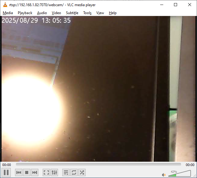

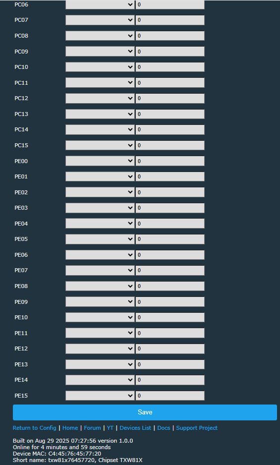

    sdk/lib/video/dvp/cmos_sensor/csi_v2.c
    Code: C / C++
    Added after 13 [minutes]:
    Screenshot from VLC displaying a webcam RTSP stream with a blue gradient background and timestamp.
    lots
    Screenshot of a microcontroller GPIO pin configuration web interface with dropdowns for each pin and a Save button.
    Added after 32 [minutes]:
    LEDs for me
    PCB with labeled pins PC04, PC05, and PA11, connected wires and illuminated LED indicators.

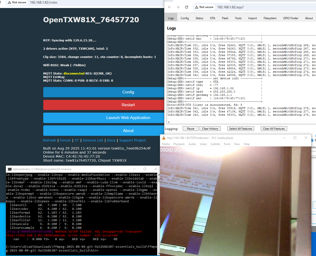

    Debug:CMD:cmd [ntp_timeZoneOfs 0:00]
    Error:CMD:cmd ntp_timeZoneOfs NOT found (args 0:00)
    Debug:CMD:cmd [waitfor wifistate 4]
    and later
    Debug:CMD:cmd [startdriver TXWCAM 55000]
    Debug:CMD:cmd [CAM_Show_Timestamp 1]
    Error:CMD:cmd CAM_Show_Timestamp NOT found (args 1)
    Manually entering them works fine.
  • #85 21647838
    Posts: 5208
    Help: 446
    Rate: 914
    Web UI and terminal screens showing NTP sync, system logs, and RTSP stream error
    are you getting ntp to retrieve time at all?
  • #86 21647850
    insmod
    Posts: 1432
    Help: 168
    Rate: 455
    >>21647838
    Not with local server. But, when i first tested it without setting server, it worked fine.

    yep OK. started manually instead before cam
    Camera frame with bright light and dark background, date and time overlay visible.
  • #88 21647861
    insmod
    Posts: 1432
    Help: 168
    Rate: 455
    NTP and commands started working for me.
    The problem was mutex. After i "stubbed" them, it started working.
    But, i don't know how safe it is.
    Added after 24 [minutes]:
    Fixed mutex, the error was mine.
    If mutex is taken successfully, it returns 0. I checked != 0.
    It's a surprise it worked at all.
