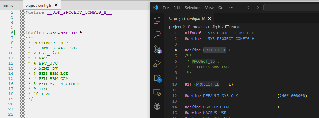

    hey cool cheers.
    I'll see if I can find something in project to toggle that may relate to psram.
    sebek2435 wrote:
    Here is a picture of my board in case you wanted to compare the pinouts:
    which TXW chip is yours? TXW817?

    sebek2435 wrote:
    I went with the FPV-v2.5.0.7 SDK
    ah. I guess yes
    Yes that's the chip I have.
    I don't see a define for it in the config file but you can add #define PSRAM_EN 1 in the project_config.file or in the compiler. I wasn't able to find any specific info about psram on the chip so I just left it all at default.

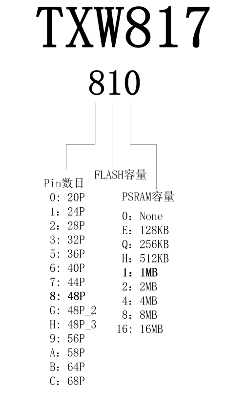

    cheers. will give a go. odd ours are different though.
    in full mine is TXW817-810 so 0k PSRAM
    TXW817-810 configuration table showing pin count, FLASH, and PSRAM options
  • #34 21644337
    sebek2435
    Posts: 14
    Ok, mine is the same. So I guess we need to disable PSRAM completely then. I'll have a look in a bit also.

    sebek2435 wrote:
    so I guess we need to disable psram completely then
    aye. I forgot about that helpful image. this is device I'm using: https://www.elektroda.com/rtvforum/topic4121456.html
    I'm away from home on laptop so just installing CDK etc
    Added after 47 [minutes]:
    hmm. seems NONE is already the selected.

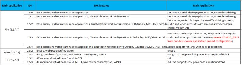

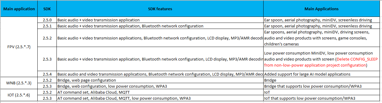

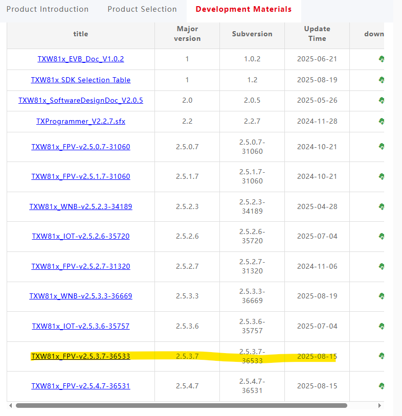

    Added after 53 [minutes]:
    latest 2.5.*.7
    TXW81x firmware version table with 2.5.3.7 entry highlighted on 2025-08-15
    Comparison table of SDK versions 2.5.* with features and target applications
    • TXW81x_FPV-v2.5.3.7-36533_20250815152643.zip (22.07 MB) You must be logged in to download this attachment.

    more PROJECT IDs in new SDK
    Two code editors showing project_config.h files with different project and customer IDs.

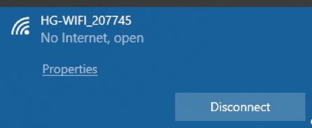

    Added after 1 [hours]:
    new SDK
    CUSTOMER_ID 9 - IPC
    Wi-Fi network HG-WIFI_207745 with no Internet, open status shown
    just adding more sensors and changing default IP then will report back. no sign of any cam init or web pages/rtsp life

  • ID 5 matches boot log and avoids DVP_EN issue
    #42 21645584
    Posts: 5208
    Help: 446
    Rate: 914
    ID 5 more closely matches the original boot log it seems. 9 didn't have DVP_EN.
    boot log of build, attached:
    log shows GC0312 being detected - presumably from GC0311 define added to ID 5 - https://www.elektroda.com/rtvforum/topic4121965.html#21583310
    • txw81x_fpv_v2.5.3.7-36533_2025.8.26_MINI_DV.bin (517.02 KB) You must be logged in to download this attachment.

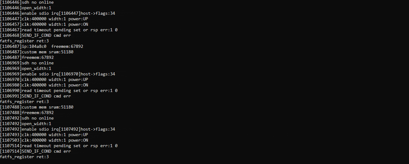

    not getting any rtsp or web page action yet. let me know if you want current state of project. can't remember all the things ive changed at this point.

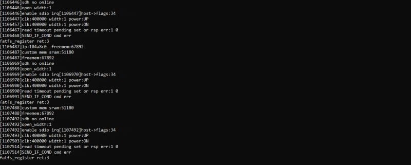

    will disable SD
    it's constantly logging
    animated
    Black console screen showing repeated SDIO initialization errors and CMD errors

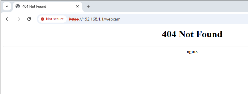

    Increasing lwIP TCP PCB pool to fix RTSP setup failures
    #46 21645618
    Posts: 5208
    Help: 446
    Rate: 914
    sebek2435 wrote:
    have you tried with an sd card in?
    negative. been focused on rtsp only for now.
    getting closer
    404 Not Found page shown in browser at 192.168.1.1/webcam
    Added after 18 [minutes]:
    when opening rtsp
    upping this in lwip to 16 because of NO FREE TCP_PCB! total:8

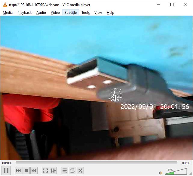

    Added after 9 [hours] 9 [minutes]:
    Close-up of a USB plug connected to a wooden object with a blue surface above
    • txw81x_fpv_v2.5.3.7-36533_2025.8.27_MINI_DV.bin (507.02 KB) You must be logged in to download this attachment.

    Yes! So you are able now to stream RTSP from TWX?

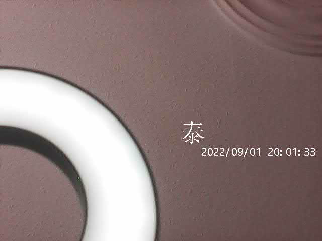

  • RTSP proof of concept on TWX camera
    #48 21645812
    Posts: 5208
    Help: 446
    Rate: 914
    correct. I need to make a repo starting with new SDK then layer some changes I've made on top as commits. I've lost track of what's been done. Lots of buffers and socket adjustments and things.
    No FS, no SD, no audio, no HTTP currently.
    It'd be good for others to see code changes
    no idea how one transforms this into OpenTXW81X. It's just an rtsp POC at this point.
    Shame most of these Taixin cams appear to be 1mb
    Added after 14 [minutes]:
    quality and frame rate is actually better than I expected
    ffplay info

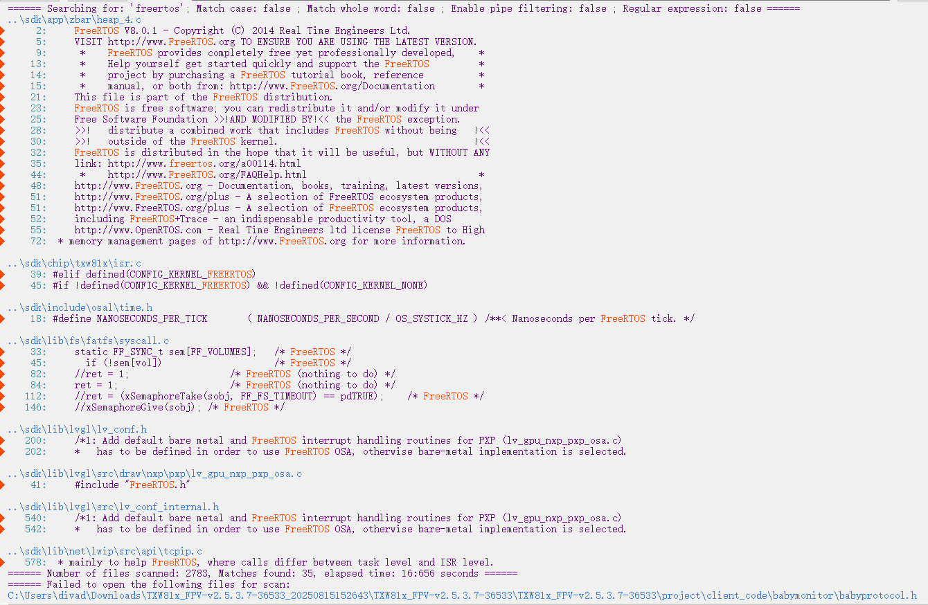

    all done in CDK
    Development environment with CDK open, showing firmware project and lwIP configuration code
    some mentions of freertos..
    Search results for FreeRTOS in project source code files on a code editor screen.
    insmod wrote:
    You've made me very interested.
    oh cool
    insmod wrote:
    Is CK-Link required? Or can i use J-Link/DAPLINK?
    I've had 0 success with J-Link. DAPLINK don't know. CK-Link only for me.

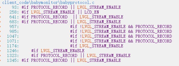

  • RTSP build boots but triggers lvd fault
    #53 21645938
    Posts: 5208
    Help: 446
    Rate: 914
    how to get one?
    I don't think I have record of exactly where unless I've linked in some of the TXW817 topics dotted around. As you know it's sometimes BK7252U/N, XF16, TXW81x
    it has LVGL as well? For which purpose?
    I assumed for display support. baby monitor with LCD?
    Screenshot of C code with multiple #if preprocessor directives for LVGL and PROTOCOL_RECORD

    still some issues of course

    Flashed your firmware, camera works for me.
    + camera from BK7252U cam works (GC0310 if i remember it right).
    OV7670 from doorbell is too big, can't fit it in.

    It will be hard to port it to OBK.
    There is no FreeRTOS. It uses Rhino RTOS instead.
    Check several SDKs - all of them use it.
  • #58 21646080
    Posts: 14754
    Rate: 12875
    Why do you think it will be hard? We basically need a main timer (every second), and a quick timer (25 ms?), both of them can be behind HAL. We also need HTTP server to work, but that's just a single place to stub... anything else?
  • #59 21646087
    insmod
    Posts: 1432
    Help: 168
    Rate: 455
    >>21646080
    Threads/tasks, semaphores, and that's just what i remember.
    OBK is tailored for freertos.
  • #60 21646113
    Posts: 14754
    Rate: 12875
    I wouldn't say that much, we don't really have that much of RTOS stuff in core OBK.
    So, that Rhino RTOS has no mutexes at all?
    We could also reduce threading a lot, if needed. For example, try ticking HTTP server with non-blocking sockets in the quick tick..
    I don't think we need much to get basics working.
