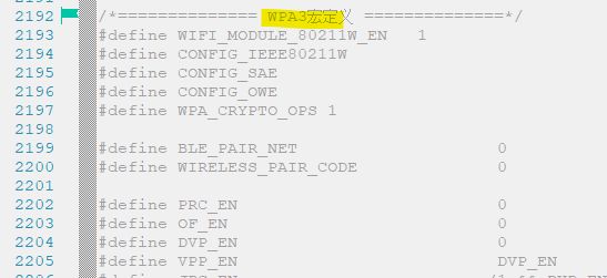

    would it be needed if WPA3 was ever desired?
    A table snippet showing TXW81X, manufacturer Taixin, and columns with a red X and a yellow question mark.
    seems to only be defined in customer ID 1 and 10 currently
    Screenshot of source code with highlighted comment WPA3宏定义.

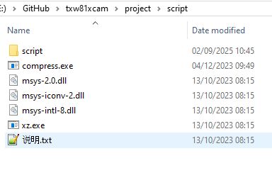

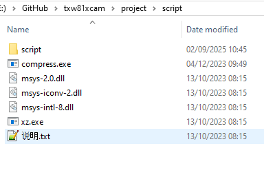

  • Script folder enables OTA firmware build
    #107 21651192
    Posts: 5208
    Help: 446
    Rate: 914

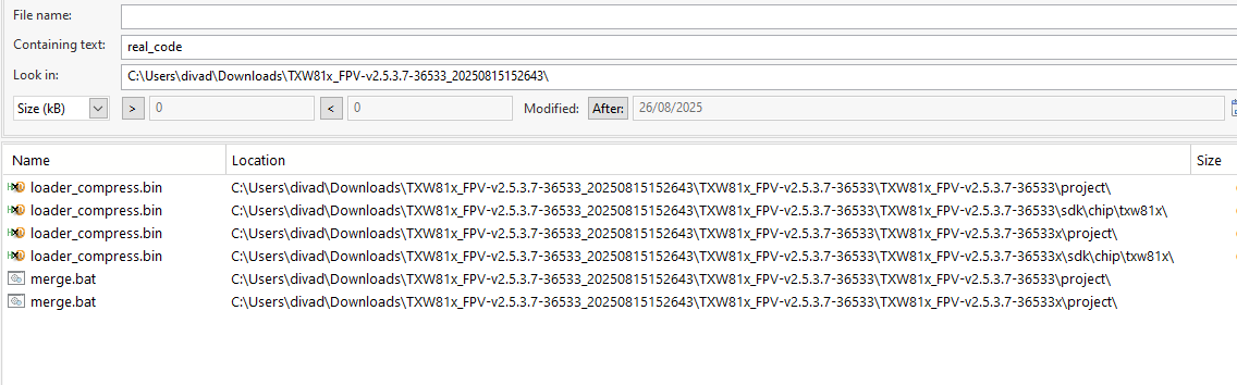

    I see yes, no sign but there is real_code string in:
    Search results for files containing real_code in the TXW81x_FPV firmware folder, showing loader_compress.bin and merge.bat files.
    if you extract script.7z to project\script
    Screenshot of the script folder in the project directory, showing executables and DLL files.
    it'll then do the OTA I think

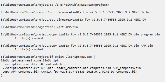

    my build is just finishing. doing more than it did without script folder
    Screenshot of Windows command prompt showing commands processing firmware for the txw81xcam project.
    Added after 3 [minutes]:
    taking ages. main app was done 7 minutes ago

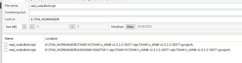

    ah OK OK :)
    Added after 19 [minutes]:
    Software window showing search results for files named real_code.BinScript in the E:\TXW_WORKINGDIR folder.
    • real_code.zip (510 Bytes) You must be logged in to download this attachment.
  • #110 21651265
    Posts: 5208
    Help: 446
    Rate: 914
    building with it now. it's just
