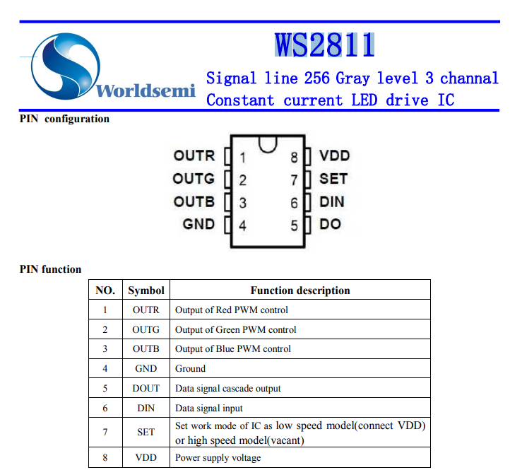

    Your device has WS2811 LED strips, that's the strip where SOIC chip controls 3 LEDs in a group. Here is WS2811 pinout:
    Pin diagram of the WS2811 chip with pin function description.
    So everything works as expected.

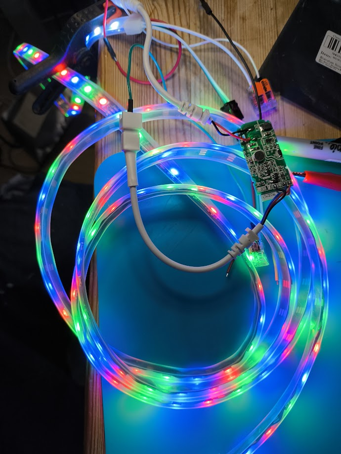

    I'm just playing with a new device that came today that is almost the perfect thing for OBK SPI LED control
    CBU. SPI LED connector. Toggle button. Connected but vacant IR pad for DIY expansion. 12-24v barrel connector. The only issue is that it outputs 12V and was advertised as being for WS2811. Easy enough to mod though.
    Here's my device running OBK and RGB full length static script. 120 WS2128B LED strip, external PSU.
    The image shows an RGB LED strip and a controller placed on a wooden table.

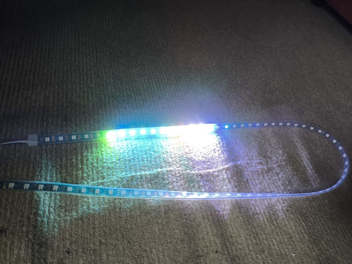

    #52 21099114
    Posts: 5220
    Help: 449
    Rate: 918

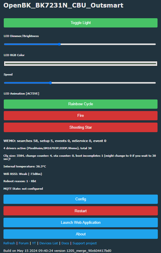

    it works.
    Screenshot of the user interface for the LED lighting controller OpenBK_BK7231N_CBU_Outsmart.

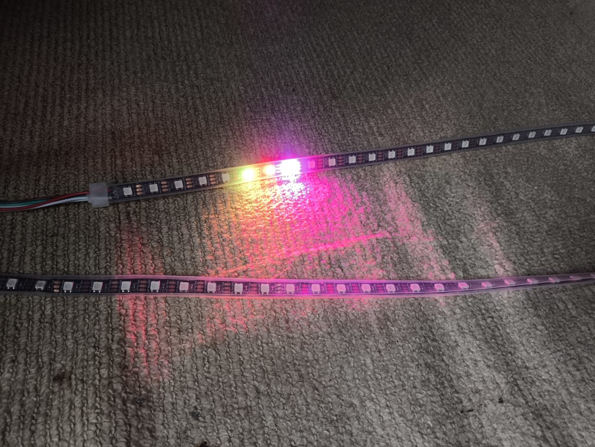

    autoexec for me
    curiously the last few LEDs are a bit static or off and each time you turn off the strip odd ones remain on
    Two LED strips on a carpet with several brightly lit bulbs of different colors. LED strip light illuminating in various colors on a carpeted floor. LED strip emitting various colors, arranged in a loop on a brown carpet.
    Added after 6 [minutes]:
    and the speed slider is reverse - left = faster. right = slower.
