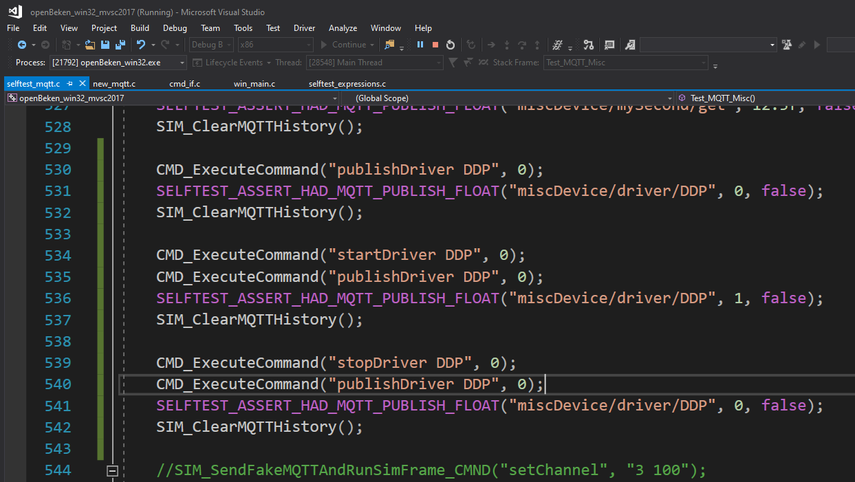

    Sure, but can you provide specifics? DDP driver may be running all the time, but light can be still controlled manually if nothing is sent via DDP. Do you want just an information whether given driver is running, or do you in fact want to check whether DDP is really currently active and in use, processing packets?
  • Request for MQTT state reporting of DDP driver
    #32 21692097
    teri928tv
    >>21692065 Thanks for the reply! I just mean if the DDP driver is active at all. Basically in my use case, I have a template switch in Home Assistant that sends startDriver/stopDriver commands to basically toggle DDP on/off for my device to put all my RGB lights into "light show mode."
    Specifically, I'm wanting to know if the DDP driver is running via MQTT, so I can use that as a 'state' in HomeAssistant for the template switch to track it's state correctly since DDP is reset on a reboot. Even something as simple as a binary value sent via MQTT if DDP driver is running or not.
    I'm new to OBK to be honest, and I'm coming from ESPhome. I'm really looking for any way to get more simple data available via MQTT about the drivers running, but ANY data about the DDP plugin over MQTT would be incredibly useful to me personally. I hope that makes sense. I'm forever thankful I found this project, but again I'm very new to OBK and I'm not sure what all is possible. I'll happily receive any direction.
  • Suggesting uptime check or MQTT request-response for DDP status
    #33 21693022
    Posts: 14770
    Rate: 12913
    Well, I can easily add this for you, but the question is, should we also have it in the main release? You can create your own version of OBK easily with online builds:
    https://www.elektroda.com/rtvforum/topic4033833.html
    Or maybe you can do just a work around. I think OBK publishes uptime value. So, if uptime becomes smaller than before, then it means that reboot happened.
    Do you just want to listen to a topic to know whether DDP runs? Or do you want a request-response approach, like with Tasmota , where you can publish to cmnd topic and receive status?
    Added after 13 [minutes]:
    Maybe something like this?
    DDP protocol - a way to create real-time LED animations via WiFi - OBK, xLights, configuration
    Then you can add this in autoexec.bat after waitFor MQTTState 1...
  • Request for DDP exit behavior and mode locking
