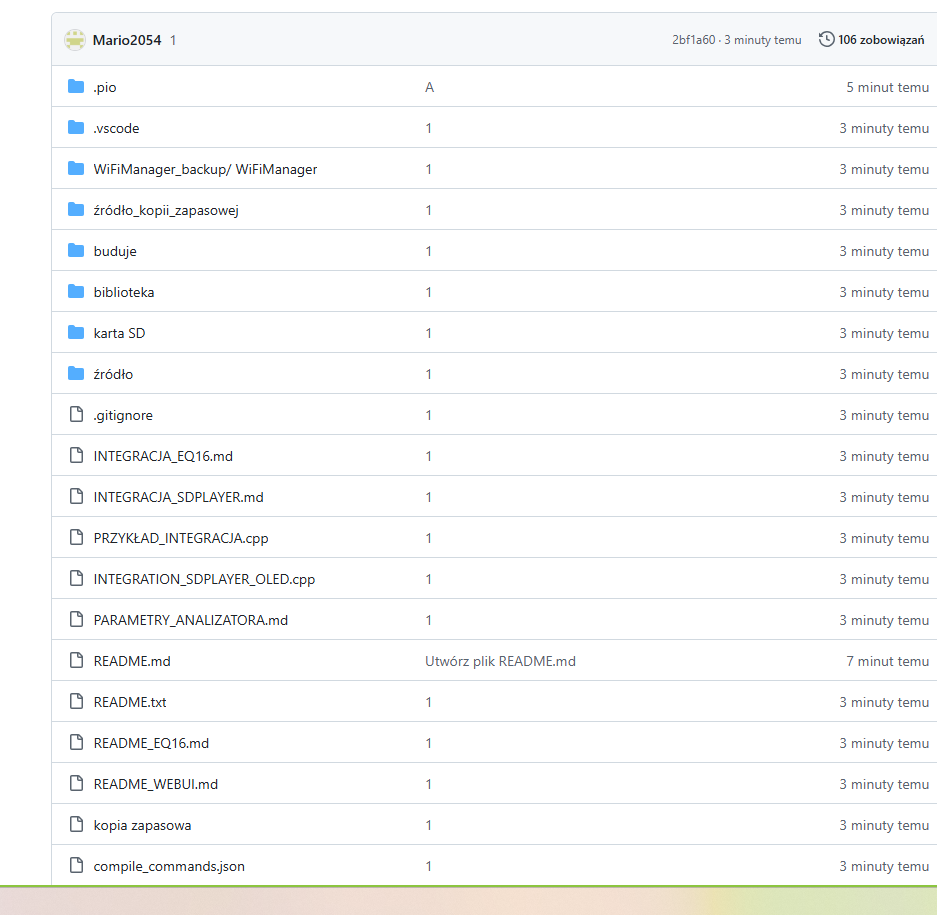

    I have added the whole platform project now it should be ok check it out
    PlatformIO project directory view with source files and documentation
  • Platformio isolates project libraries and avoids conflicts

    The difference between platformio and Arduino is that in pltaformio you can define libraries for each project separately, and in Arduino vice versa, one for all projects, hence the constant problems of people in this thread with compilation errors. Platformio itself downloads the appropriate versions of the libraries that are defined in platformio.ini so the user does not have to do anything :)
    I therefore recommend Visual Studio Code with platformio, it is great to write and use.

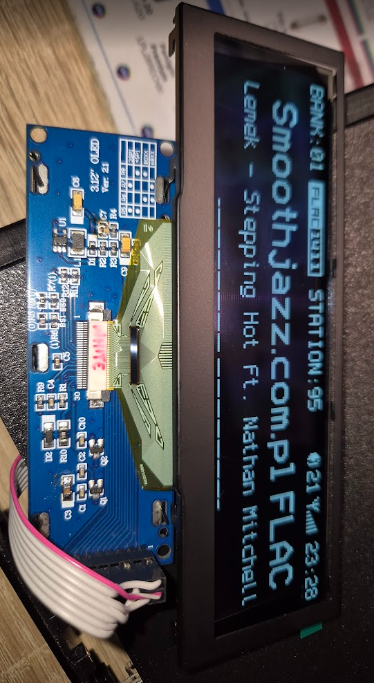

  • Open-Meteo weather fetch for ESP32-S3 radio

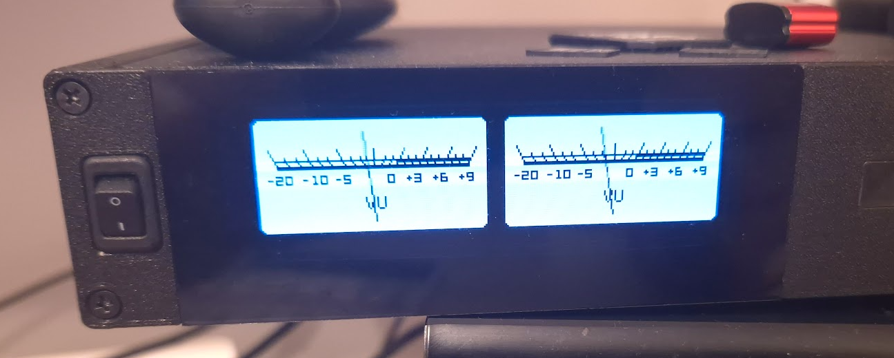

    Some "sneak peeks" of the direction of Evo development:
    How do you like such a VUmeter as in the photos ? In addition, a 5.5-inch OLED "glass" came my way. Incredibly large is this display ;) Unfortunately for such a large OLED to work properly it must have a VDD power supply of these 17V-18V. The inverter that the Chinese products use can't cope. They copied it from the small OLED 3.12 and there it is only 14V. The display will of course "light up" but it lacks the muses 30% brightness.

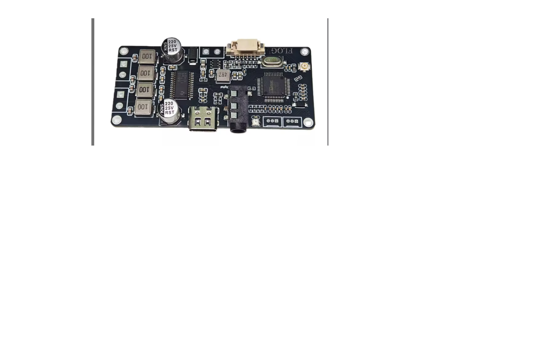

    A TAS5805 by Texas Instruments also landed on the workshop. It is a TPA3110 + PCM + DSP in one housing. Zero crackle, zero noise, zero interference. Everything goes via the digital bus and into the speakers. Configuration via i2c.
    Device front panel with two blue-backlit VU meters and a side rocker power switch OLED display showing Smoothjazz.com.pl FLAC station next to a blue electronics PCB Close-up of a blue PCB with an IC chip, capacitors, and green screw terminals
  • Increasing ESP32 audio buffer and spoofing user agent speeds station connect

    Robgold nice those uvmeters 😀 in the negative. You could make another display screen for such an option and I would leave the standard ones too. That's just my opinion. As for the OLED 5.5 I have a green one at my place it lights up quite a bit, I haven't measured the voltage on the inverter though....
    Greetings...
  • OLED plexiglass reduces brightness; VU meters added as display mode

    >>21829226 Hello,
    there is no player at the moment because the plan was to not have one at all and get rid of the card. In the latest version, I'm only using littleFS anymore (although card support is still possible). If I implement a player it will probably be in the web/app control version. For the moment, I have focused on improving the hardware perhaps switching to PCM5122.
    The TAS is an interesting integration because with a 12V or 24V power supply it allows you to drive decent monitors and listen to the radio in a room up to 15-20m2.
    Unfortunately I can't do everything at once. Professional work, hobbies, radio ;) Perhaps we will get to this player one day.
    Added after 4 [minutes]:
    >>21829228 If you have an OLED without plexiglass on the front then the difference in brightness is not so annoying but already the installation of a filter in the form of this plexiglass makes these power shortcomings visible. Unfortunately, the white 5.5" versions are only sold as "glass" at the moment.
    These VUs are added as another screen in displayMode. They look best on a yellow screen in my opinion.

  • Clarifying the 5.5-inch display and TAS5805 board

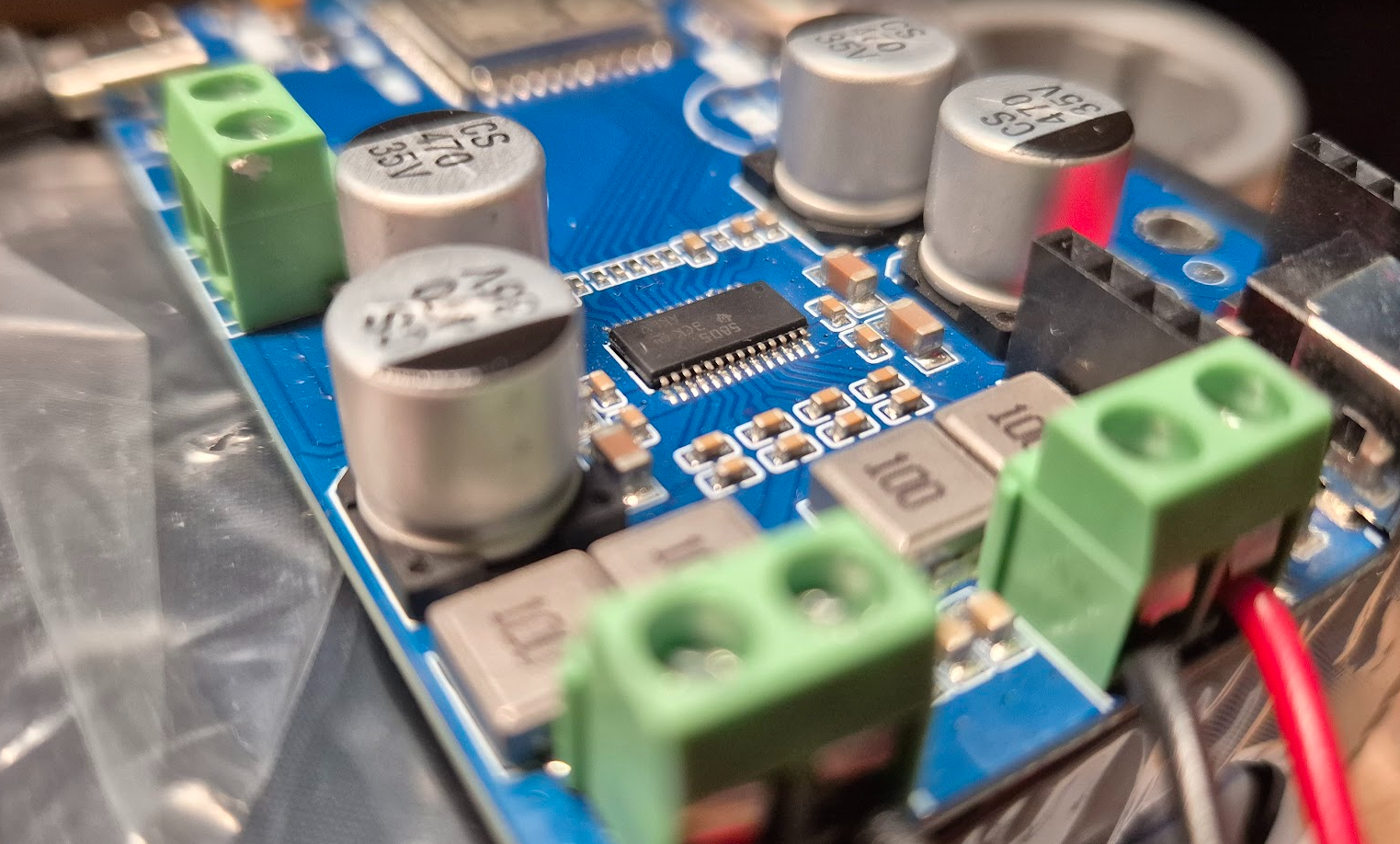

    #2220 21831446
    supsak
    Posts: 81
    Hi.
    I wanted to ask "Robgold". I'm curious about the large 5.5" display. Is it just glass, with no electronics?
    What type of display is it and where can you buy it?
    Thanks for your reply.
    Added after 18 [minutes]:
    And also what is the "TAS5805" plate? I think it's one like the one in the picture?
    I've only found one like that from a Chinese dealer, but it's just an amp + Bluetooth. The one you describe, if I understand correctly, still has a PCM5102 DAC built in?
    Electronic PCB module with micro USB port, audio jack, and SMD components on a white background
