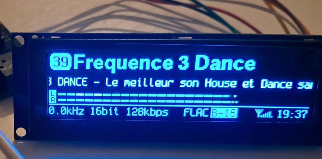

  • Questions about FLAC bitrate parsing and Kenwood remote codes
    #2134 21811776
    RonAd
    Posts: 26
    Great project EVO- respect to robgold!
    Two questions after the launch:
    Which files to replace in the libraries so that EVO correctly reads the bitrate and "density" of a file such as flac
    OLED screen showing streaming info of FLAC audio with bitrate and sample rate
    OLED screen showing FLAC audio stream and playback parameters
    I have installed esp32 version 3.3.3
    I have ordered a Kenwood remote control but I understand that nothing can be done when reading codes from Arduino remote control
    if it displays codes like : FF10EF , FFA25D.

  • FLAC bitrate errors come from station metadata
    #2148 21812914
    robgold
    Posts: 726
    Help: 10
    Rate: 290
    @RonAd I'm very glad you liked the project. You have a breakdown of the remote control functions on the GitHub page, Link there is a picture of the remote control with the functions described.
    Screens are switched by the button assigned to the "Src" function, i.e. rcCmdSrc
    All remote control commands assign yourself in file remote.txt on card or in SPIFFS memory (I think I still use this one in 3.19.53) because in the latest version I switched to LittleFS. If this file does not exist, the radio will assign you the "standard" settings under the Kenwood RC-406 remote control.
    Here is a link how such a file should look like: Link
    As for the erroneous bitrate on FLAC stations, this is not the fault of the radio or the audio library. It is the "negligence" of the radio stations, which, when adding a FLAC stream, do not change the rest of the settings on the Icecast server to it. I went through this issue with Mr. Peter from smoothjazz.com.pl, where it was corrected.
    Two words of explanation why this happens:
    If a station sends bitrate information in its metadata, the audio library does not analyse this value, trusts it to be true and simply sends this data as text to myAudioInfo() as bitrate. If the station is broadcasting 128kbps there because it hasn't changed this or has a common setting for the mp3 stream then the same erroneous data also flies for the FLAC stream. Only if the station from the Icecast server does not transmit any values (and this happens when FLAC has a variable bitrate) is the average value counted and displayed within a few seconds. Good Hi-Res CD Quality stations make sure that this data is true or as close to true as possible, such as: LIN Radio or the aforementioned Smoothjazz.com.pl.
    Here are a few examples where the bitrate is correct or possibly stored fairly correctly:
    Smoothjazz.com.pl http://bcast.vigormultimedia.com:8888/sjcomplflac
    Radio Linn Mix1 http://streams.radiomast.io/d0105650-c51c-4842-ae39-f97b329acd2a?token=UU9QJvCG
    Radio Paradise Global Mix http://stream.radioparadise.com/global-flac
    Futura.FM https://futura.fm/stream.ogg?ts=1699656027.325
    Dance Classics Radio http://vriezenet.nl:11051/dcflac
    Aida is an interesting radio because it broadcasts 24bit, 2000kbps and the data is correct:
    AIDAradio https://cdn05.radio.cloud:8128/AIDA-OMNIA-GAI
    Regarding the player:
    This is on the "wish" list but with a very low priority. I have a few other ideas that I want to add ...just not enough time to do it all.

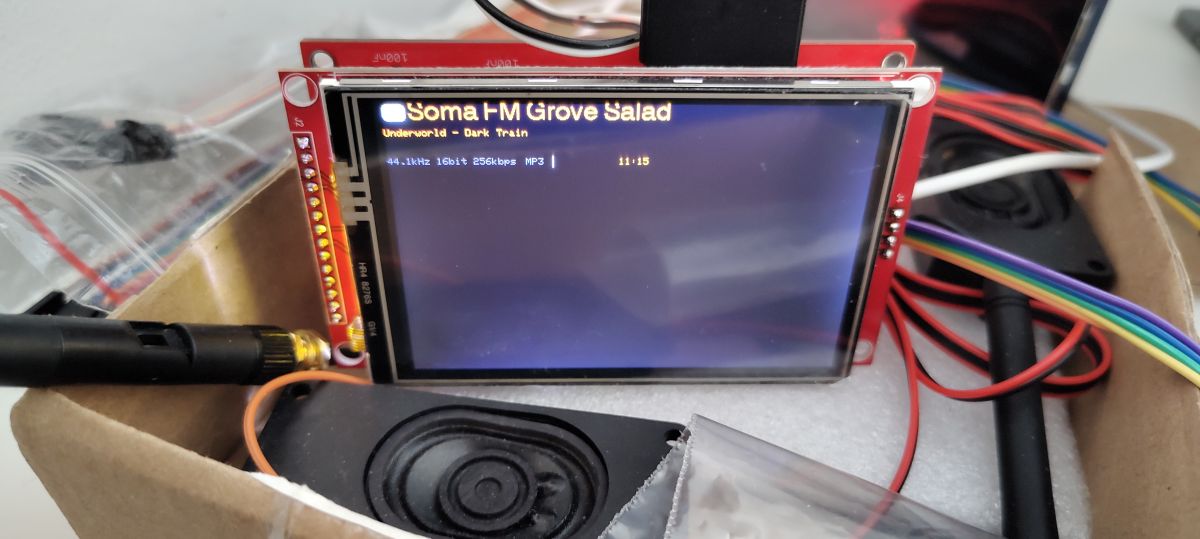

  • LovyanGFX brings ILI9488 support and color themes
    #2151 21816221
    N4d01
    Posts: 32
    Rate: 15
    ILI9488 display showing audio interface with track SomaFM Grove Salad
    Using the LovyanGFX library, I was able to fire up the EVO3 on the ILI9488.
    The library has many built-in drivers. Of the popular ones: SSD1322, ILI9488, ST7789.
    Maybe this is a good way towards adding support for more displays.
    Definitely need to embrace colour. In the picture you can see the 'leaven' of theme support.
    The bigger issue is fonts, scaling and placement of displays relative to display resolution.

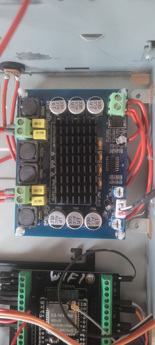

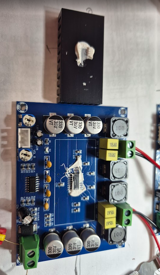

  • TPA3116 startup pop and speaker buzz issue

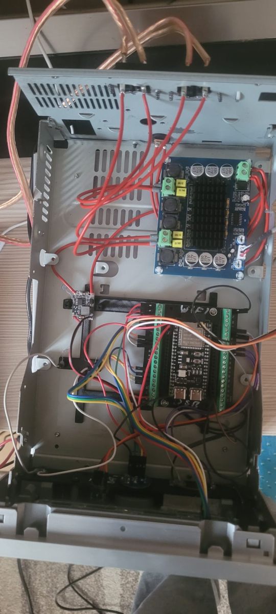

    #2154 21817356
    pawel_1980
    Posts: 16
    I have a problem with a TPA3116 amplifier.
    24V 5A power supply.
    After 1 is when switched on there is an immediate shot at the speakers. You can hear a buzz from the speakers.
    I have moved the power supply a little further and under the amplifier board. Underneath the amp I have a foil so that in the future I don't have some kind of short circuit.
    Fact I connected to one GND on the PCM5102A. But when I did the bridge it was still the same. Any ideas ?
    Interior view of a case with TPA3116 amplifier, wiring, and mounted electronic modules. TPA3116 amplifier board with red and multicolored wires inside a metal case TPA3116 amplifier module with connected power and signal wiring DAC PCM5102A module connected to TPA3116 amplifier with visible wiring PCM5102A module with signal wires connected and 3D-printed enclosure DAC PCM5102A module connected to TPA3116 amplifier with visible wiring PCM5102A module with signal wires connected and 3D-printed enclosure

  • Reduce noise by replacing the TPA board and adding soft-start mute
    #2156 21817439
    robgold
    Posts: 726
    Help: 10
    Rate: 290
    @pawel_1980
    Tidy up all wires, cable connections as short as possible. Also, eliminate the Tl074 preamp on the TPA board it makes a lot of noise. As I wrote you on prv, check if there is a real TPA under the heatsink at all. Even if there is a TPA chip then buy the original in TME from TI and replace it. There can be several sources of interference throughout the circuit. Particularly any inverters can sow ground. The original TPA plays GREAT.
    As a warning of what a "Chinese" TPA looks like:
    Audio amplifier circuit board with heatsink, capacitors, and an integrated chip
    They gave the coils correct as in the reference design 10uH, capacitors also 1uF. Tracks as if someone had designed something in the "RF-microwaves" before (all unrounded). In addition, the preamplifier is poorly designed. The signal enters the negative input and then there is a classic buffer from the second amplifier, but it no longer restores the inverted phase. Overall, a lot of improvement is needed. "Knocking" when switching on is a normal symptom, there should be a timer circuit on the SD (Shutdown) input of the TPA3110 or Mute (TPA3116) to allow a soft start.

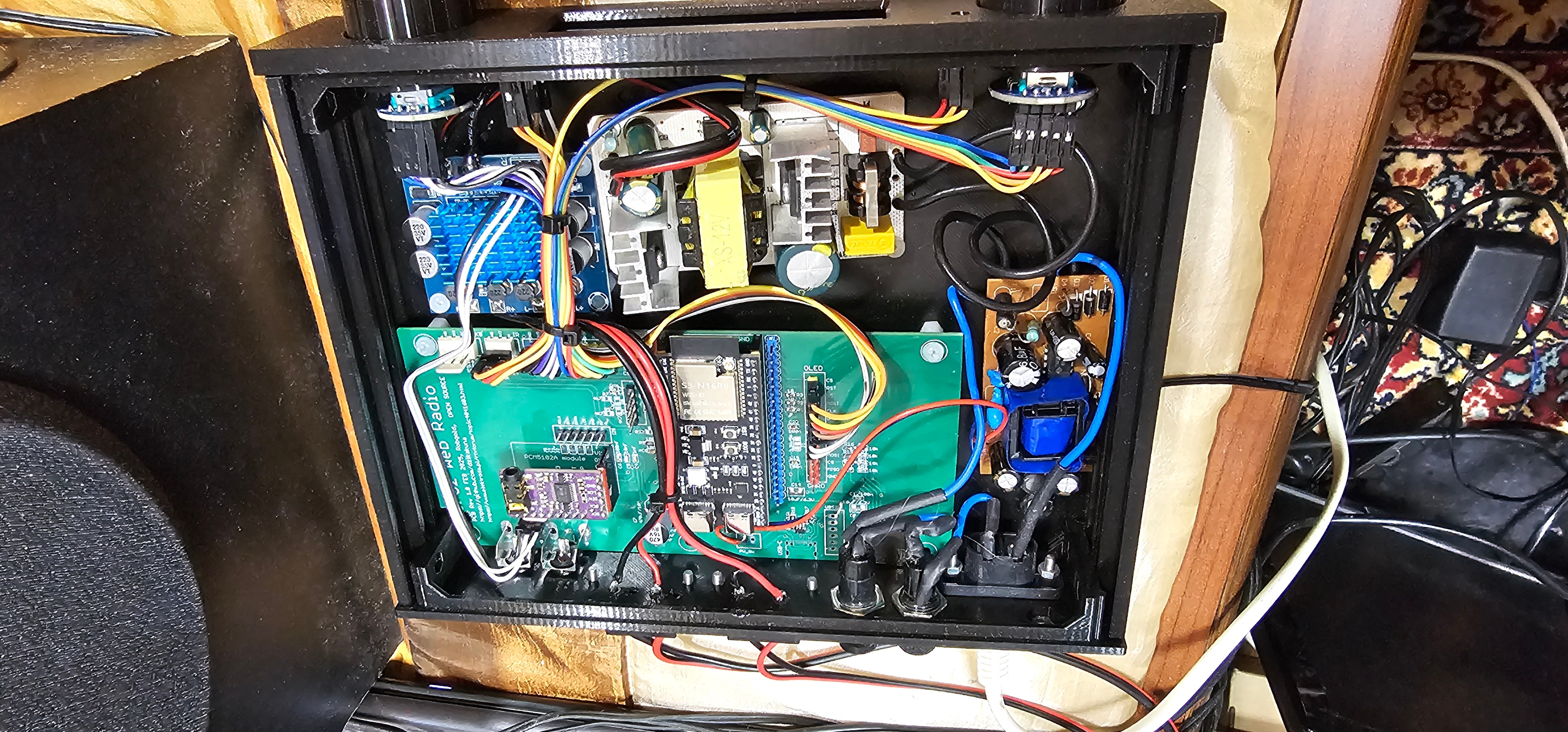

    ejcon
    Posts: 301
    Rate: 68
    At my place it looks like this. I had problems too, which is why the CPU and DAC chip got its power supply.
    • Internet radio and audio file player on ESP32-S3 20260123_163717.jpg (7.38 MB) You must be logged in to download this attachment.

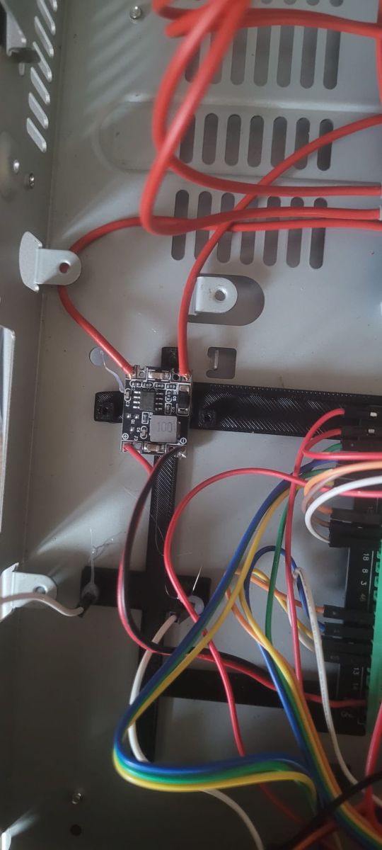

  • OLED inverter noise fixed with separate 18 V supply
    #2158 21817483
    robgold
    Posts: 726
    Help: 10
    Rate: 290
    A great deal of noise is introduced by the OLED inverter, it's just badly designed and it sows on everything after the ground. Sometimes it helps to isolate it with a small resistance to cut off these currents plus PCMa ground isolation. And best of all, bring a separate +18V supply to the OLED and the problem disappears.
    @ejcon in this TPA3110 on 1 leg our SD pin (will be connected to FAULT pin 2). It's worth adding a resistor there (I think it's 100k there) to control it from ESP and from the program control it then when there is a mute or start is complete silence.
  • #2159 21817504
    pawel_1980
    Posts: 16
    >>21817439 I plugged in another tpa3116 amplifier and it no longer hums. So this series amp is nothing to buy
  • #2160 21817511
