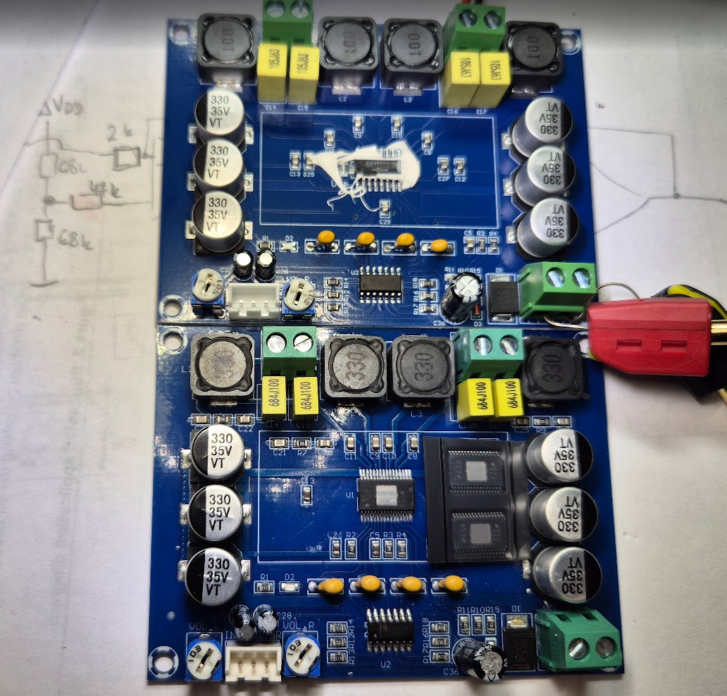

    Sure, I understand - I do not claim my opinion as an oracle. I just described my case and impressions after testing. For me as an "ordinary user" it is important that the new equipment works correctly after purchase without modifications and soldering. Those who can and like to fix - great, but not everyone has the time or skills to do so.
    I found a fix to improve the buzz in this XH-M543 series.
    https://github.com/v12345vtm/TPA3116D2/blob/m..._tpa3116d2-xh-m543_Sheet_1_20191123193718.pdf
    original 36dB is to high to use , and causes humm and hiss.
    Set to gain master 20db remove R3 (75k) change R4 to 5K6
    Additionally, TL074 can be omitted.

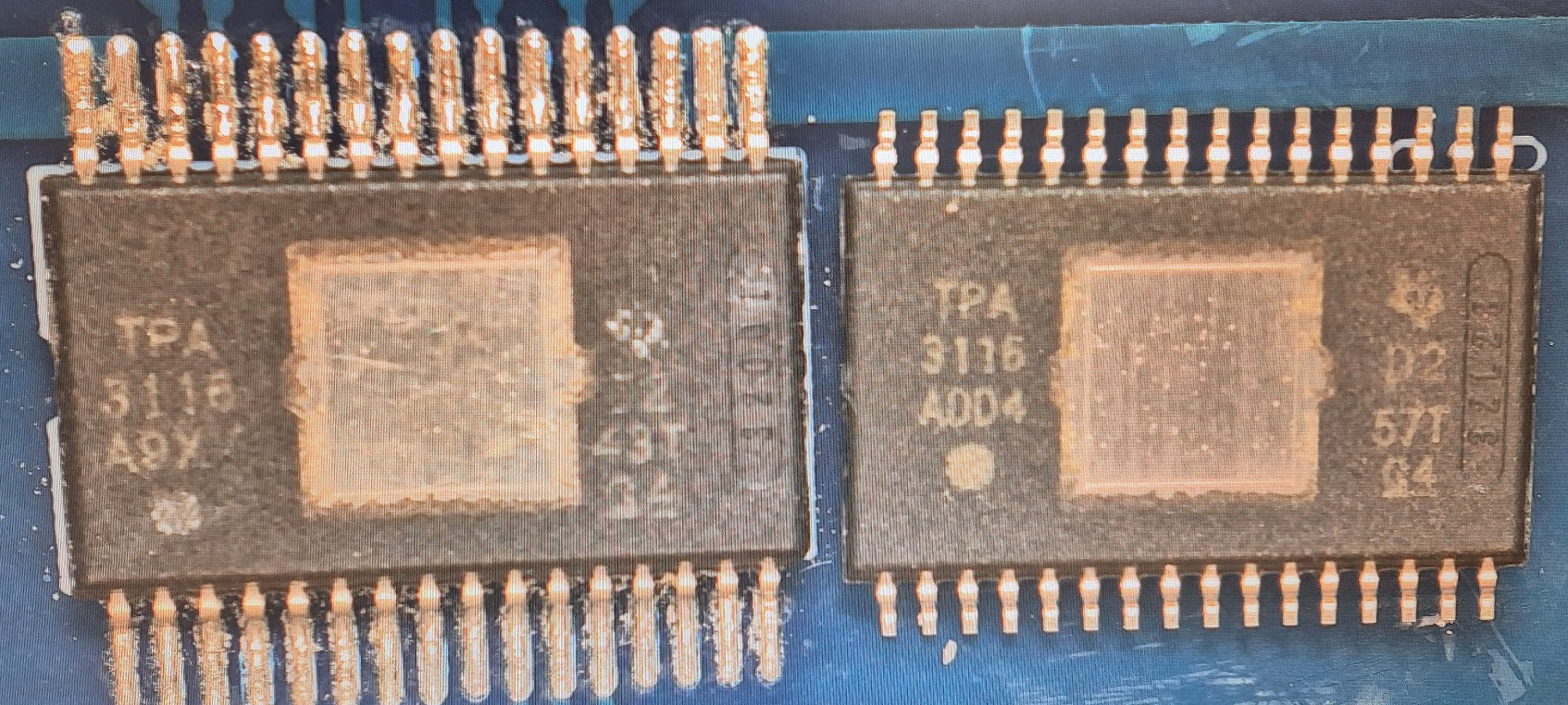

    @pawel_1980 Read the datasheet Link on the TI website. Much will become clear to you. The TPA has gain control, operating frequency, power limiter, fault outputs, shutdown, mute. In these modules from Ali everything is "rigid" and cheap to use as few resistors/connectors as possible. The standard setting on the TI EVM is 26dB. I recommend you take a look at the schematic: Link
    As an example that not every TPA is so bad, two supposedly identical modules from the outside unrecognisable, on the second one next to it lies the original TI chip.
    On the second one a picture from the microscope screen (because I took the card out so I took it with my phone) the "Chinese" vs the original TPA. The question is whether both are original or the one soldered so well fake ;) Easily found out in most of these fake ones can't withstand 24V power supply and this is how it will work in my place.
    Audio amplifier module on a blue PCB with components and terminal connectors Two TPA3116 chips on PCB under magnification, showing different surface markings
    GAIN pin setting:
    GAIN settings table for TPA with highlighted R1 and R2 resistor values
    On these settings (without TL074) I test it with the radio and it plays great. You just have to take care of the soft start (with control of the SD/MUTE pin) of the TPA so that there is no crackle and of course cut the inverters on the OLED.
    As a curiosity, look for diagrams of Marantz, Denon all sorts of DNP (Denon Network Player) there is such a display and they also, in order not to have problems, power the OLED directly from the main power supply 19V + diode, which means about 18.4V coming out. No local inverters.

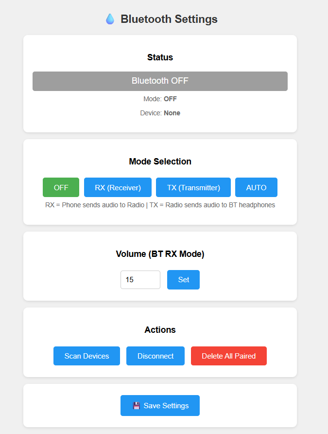

    The start of adding BT to the Evo3 service on SEP32 Wrom Traz just needs to be zipped into the soft.
    The sound is slightly delayed relative to the speakers the quality is super compared to the emitters.
    Bluetooth settings panel with Bluetooth OFF and mode set to OFF

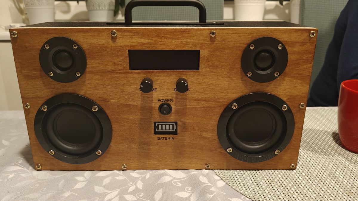

    >>21817631
    I built another radio 😁 but this time I just wanted it to be portable powered by a battery and have its own amplifier. It's to be used for Dad when he goes abroad for work, such a construction radio 🤪
    I used a TPA3110 and unfortunately there is a buzzing sound when powered together. At louder listening this is not audible however at volume around 2 it is audible. I have reduced the effect by using capacitors at the screen feed but it still occurs.
    The radio has now gone out into the world and I haven't had much time to make adjustments, but it will be back in a while and I'm curious to see what I can improve to eliminate the buzz.
    If the main culprit is the inverter in the screen then if I may ask it would be nice if someone could send some overview photo of how to remove/remove it.
    I have the power supply done at 12.6V and am wondering if using another step up inverter to this 19V would solve the issue.
    Regards.

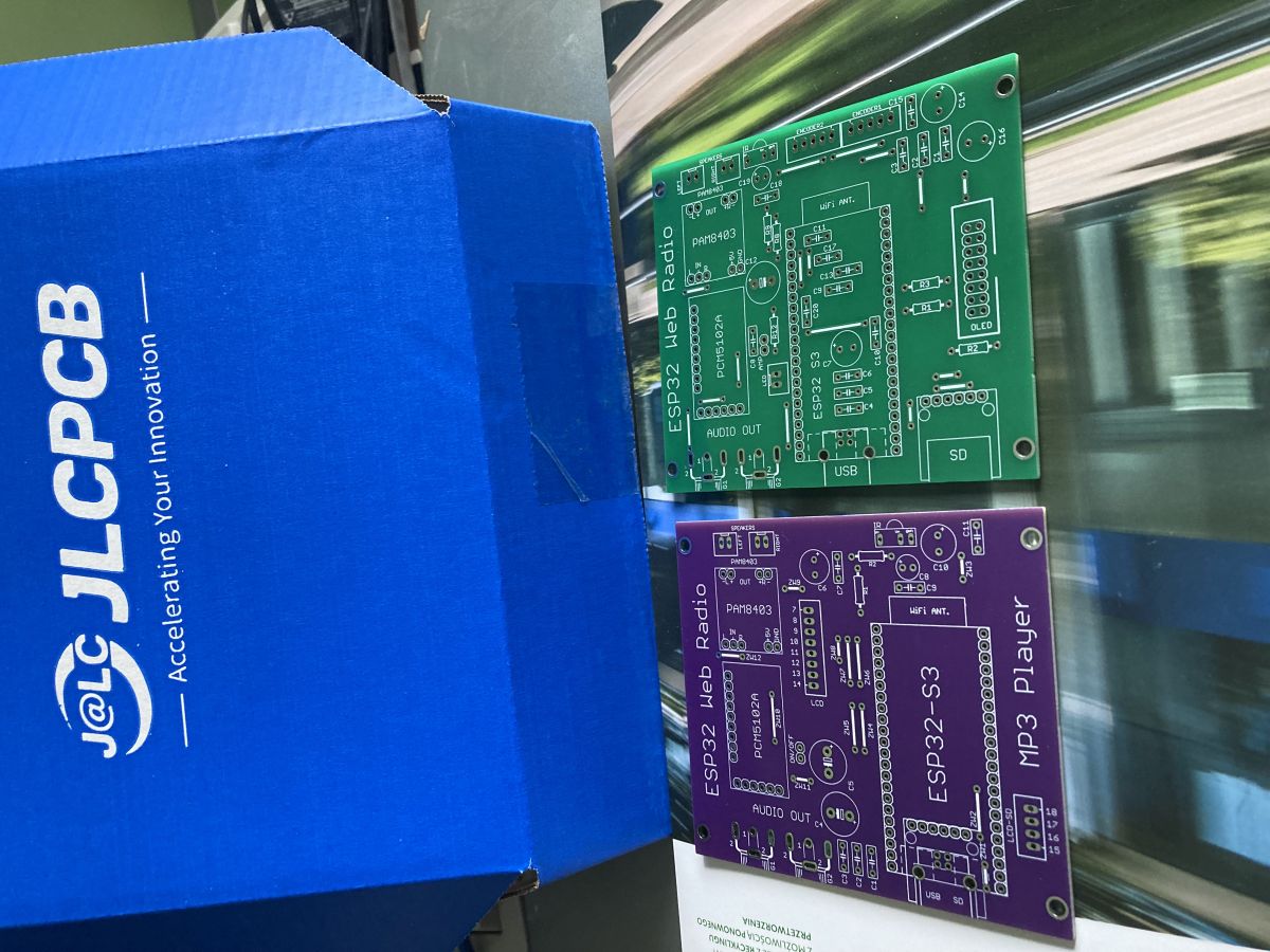

    Two ESP32 PCBs next to a blue JLCPCB box
    I overcame the ordering problems and already have the boards for the 2 versions of the radio. It didn't even take long.

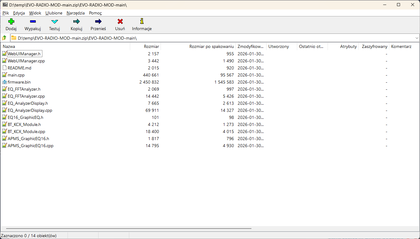

    ejcon wrote:
    Added new options in EVO3
    And where did this header file come from?
    Code: C / C++
    And where does it come from?

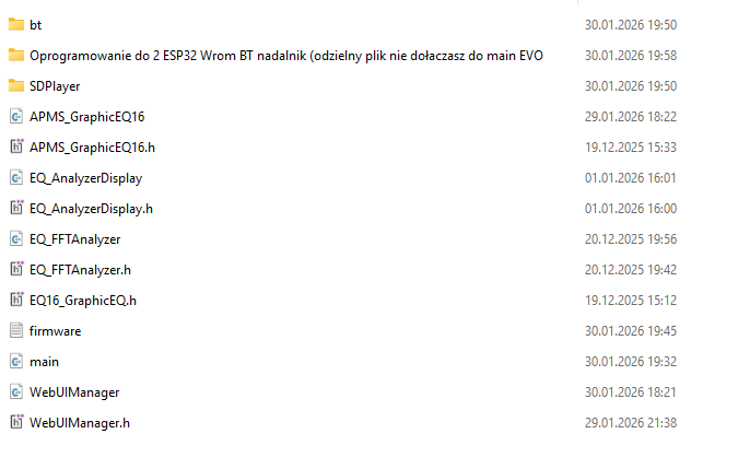

  • #2182 21824758
    ejcon
    Posts: 253
    Rate: 54
    Showing the whole project tree
    This is the file to remove the old project
    Added after 12 [minutes]:
    This is what the project should look like
    Folder view showing ESP32 project files including EQ analyzers and UI headers There is no need for a design
    Added after 1 [minute]:
    >>21824744 Not everything has moved on

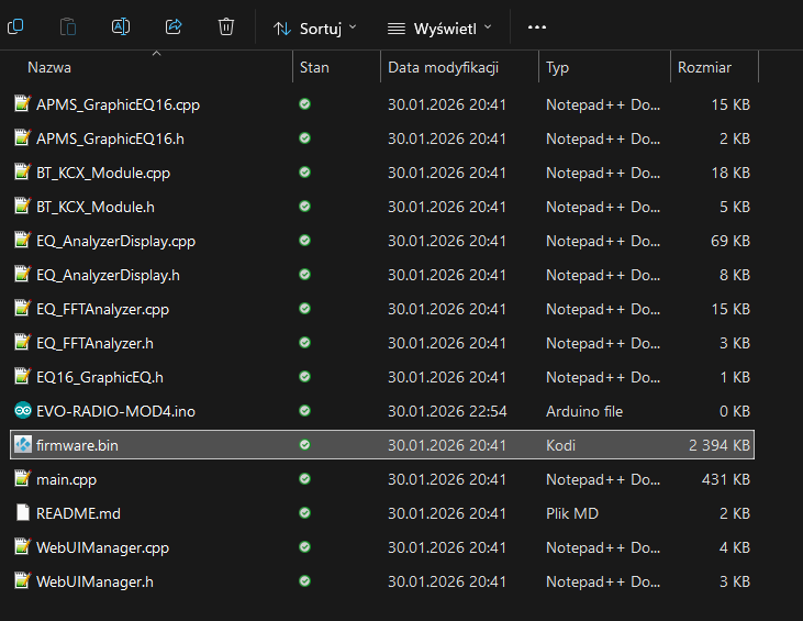

    Well, I don't have SDPlayer yet.
    And the tree has like files on github, and I compile under arduino
    Screenshot of an Arduino project folder containing source files and firmware.bin

    ejcon wrote:
    The design you have is like this
    Well now it is like this, when I copied it the first time it was just like this in the zip archive
    ZIP archive contents with C++ source, header files, and a firmware binary
    I will download again.

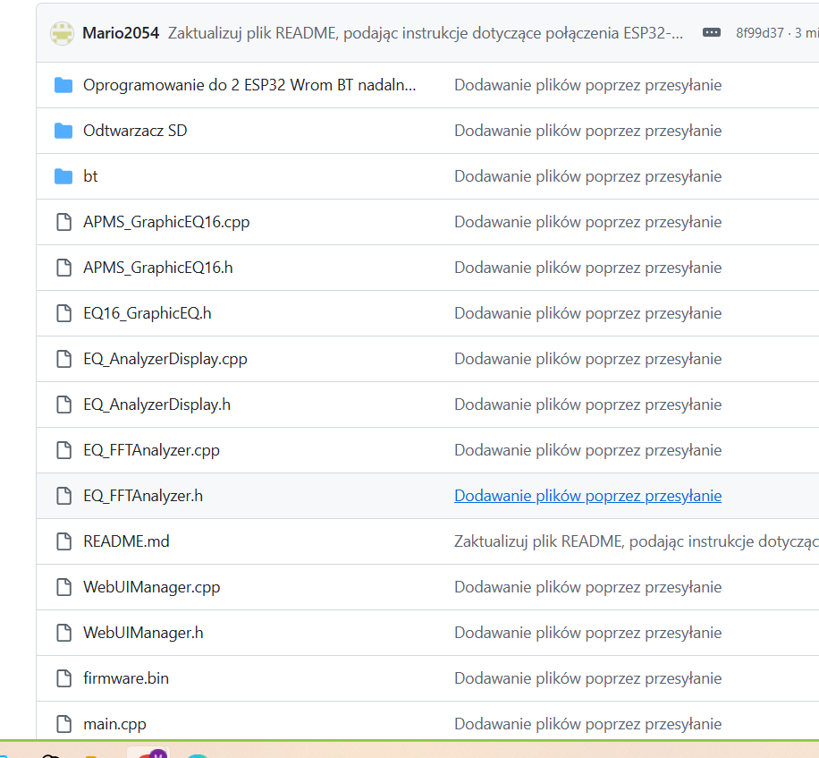

    >>21824768 This one is very simple with no fancy features, no window for weighing, operation with remote control and encoder, operation on the page but I have to improve the debugging. Generally works the player is to refine .
    >>21824780 download again from GitHub I recently changed I still added the zip as a whole file to the project src
    I can already see that in my case nothing will come of it. The old nightmares came back, although several versions compiled on Arduino.
    Code: C / C++
