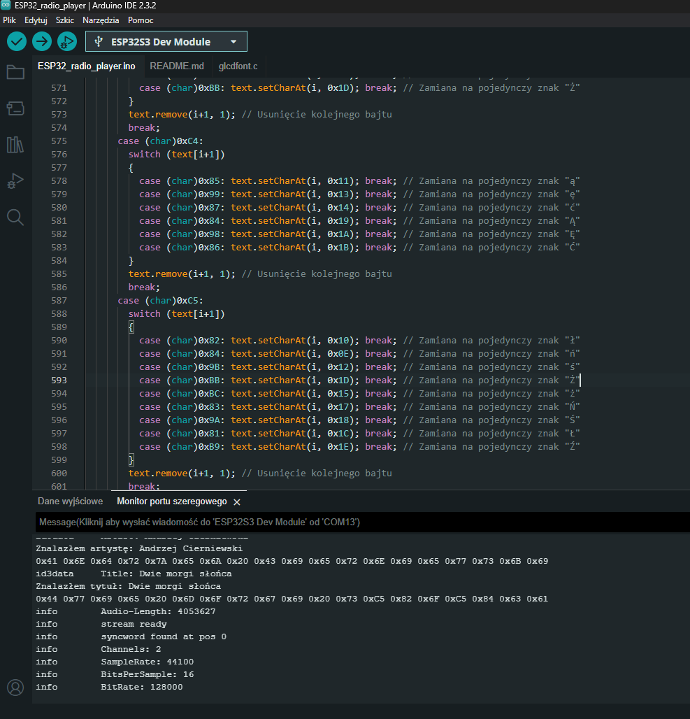

    @ytuskosiarski Thanks Tytus for the tips, I managed to handle it comprehensively on the switch, but I can already see that there will be more and more cases in the switch, probably depending on the character encoding standard when writing id3 tags using 2 bytes.
    Arduino IDE window with source code for ESP32 highlighting switch-case statements for ASCII character conversion. Audio player with LCD display playing a song by Urszula Sipińska. Electronic device with a display showing Radio MBOX, track Urszula - Malinowy Kr, and audio parameters.

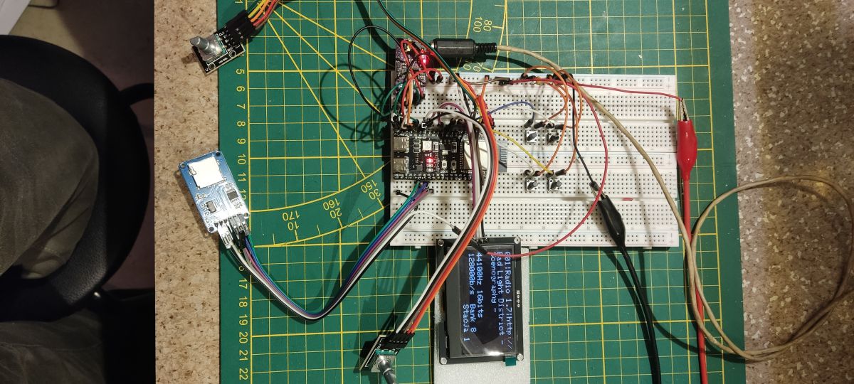

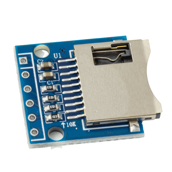

    I managed to get this radio working!!! For now, on the breadboard to figure out what`s going on. Proof in the photo. I have one problem: when the card reader is connected, the system does not start. However, you only need to unplug MISO for the radio to work after the reset.
    Second thing: I don`t know if it`s supposed to be like this, but the radio doesn`t remember the last station set after turning it off. He always starts with "Mega Dance Radio" Bank 1, Station 6. Such a memory would be very useful.
    Breadboard with electronic components, a display screen, and wires.

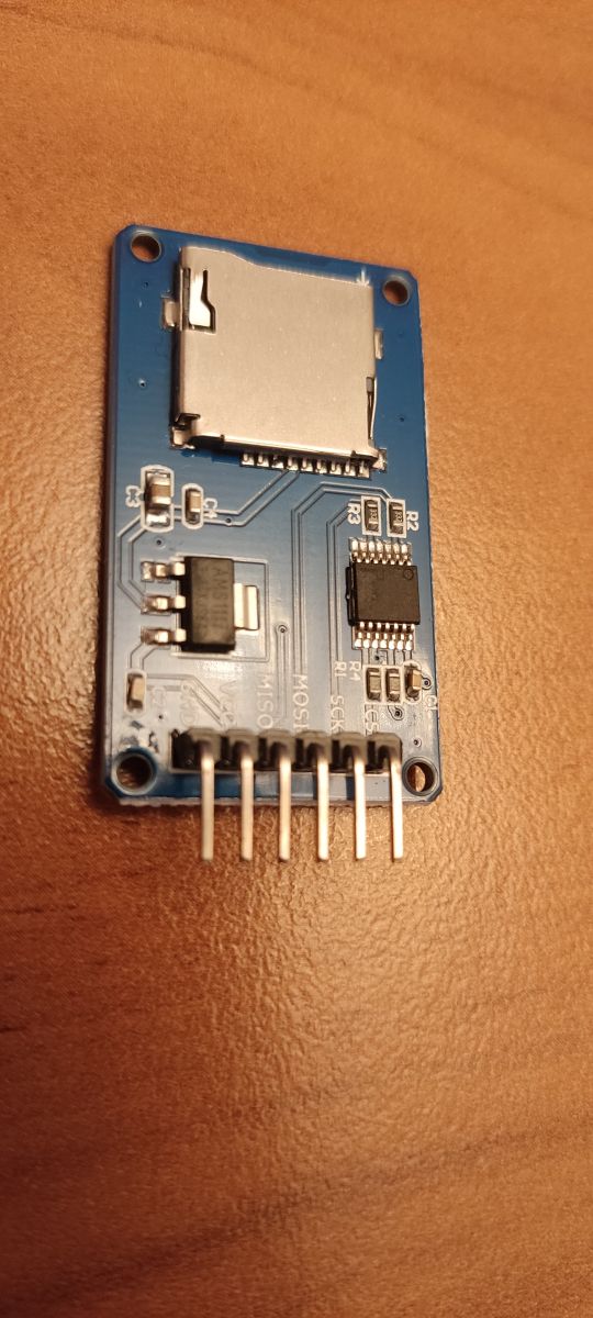

    @miroskop Show some better photos from both sides of this reader, because it is a more "active" module, mine only has 4 10k resistors and about 2 capacitors. Do you have any datasheet for this module?
  • Left encoder button causes several-second display pause
    #41 21022169
    miroskop
    Posts: 481
    Help: 65
    Rate: 65

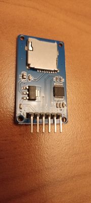

    I am attaching a photo of only one side because there is nothing interesting on the other.
    This is quite a popular module. It contains a 3.3V stabilizer and the LVC125A system. I have two such readers, but replacing them does not solve the problem.
    Electronic module with an SD card slot and several components on a circuit board.
    The radio has been playing continuously for several hours and nothing bad is happening, but the card reader is disconnected. Thank you for the opportunity to use your project!
    I still have a question: what is the button on the volume encoder for?
    And while we`re talking about buttons. For me, when I press the left encoder button while listening to the radio, there is a pause of several seconds and during this time the name of the artist disappears from the display. After a while, everything returns to normal.

    PS. my reader is an ordinary module:
    SD card reader module with a blue board and metal slot. SD card reader module with pin labels.

  • Set SPI MISO to pin 35 to avoid bootloader mode
    #45 21023304
    MAJSTER XXL
    Posts: 2064
    Help: 164
    Rate: 429
    @miroscope, you can test the MISO port assignment to pin 35, then connect, compile and run. In fact, I assigned pin 0 for MISO a bit risky. As my friend Tytus tells me: this adapter probably forces LOW on this pin and ESP32 then enters bootloader mode. During normal ESP32 boot, the BOOT pin should be on HIGH.
    https://docs.espressif.com/projects/esptool/e...sp32/advanced-topics/boot-mode-selection.html
    in line 17 of the program set:
    #define SPI_MISO 35

    Changing the pin for MISO helped. Everything works! However, I still bought a reader like yours due to better mounting to the front panel.

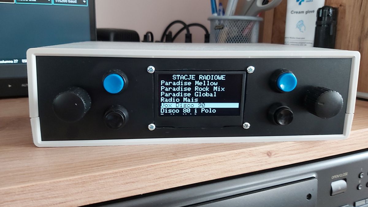

  • Free station selection added with right encoder
    #51 21027793
    MAJSTER XXL
    Posts: 2064
    Help: 164
    Rate: 429

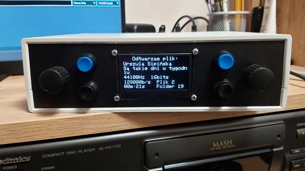

    We managed to download the time from the Internet, it is done once during setup, then the time is added using a 1 second timer and updated on the display every second. I also added free selection of stations from a given bank using the right encoder. It works like this:
    - while playing a station stream, press the right encoder button,
    - scroll up or down to the selected item from the list,
    - press the same button of the right encoder again, the program will start playing the selected station.
    I started doing the same to display a list of directories and freely select them with the left encoder - this still requires refinement.
    Small electronic device with a display in a casing, showing music information and settings. Front panel of an electronic device with a display showing radio stations and control knobs.

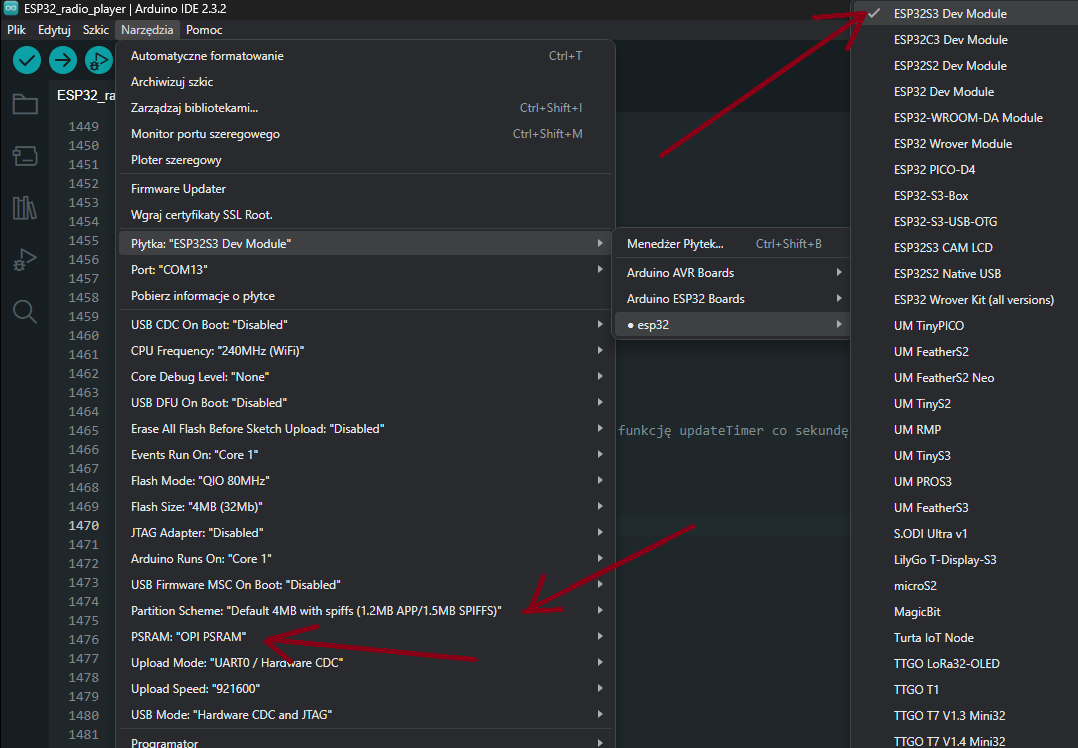

  • Suggesting serial diagnostics and noting A2DP memory limits
    #57 21035265
    MAJSTER XXL
    Posts: 2064
    Help: 164
    Rate: 429

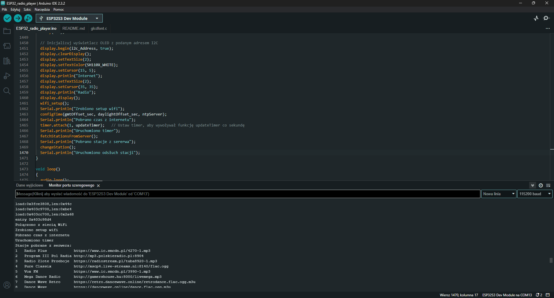

    @hevet question do you get http error code on serial terminal? You can literally only connect the ESP32 module with the display and check then, it will at least give you an answer whether you have a problem with connections to the peripherals. For diagnostic purposes, you can paste something to print something on the terminal`s serial - which will help find the cause of the problem. I added it to the sketch - you can download it from github, then paste the event log.
    I already have support for switching banks with an encoder, I thought I would add Bluetooth audio, but unfortunately it won`t work, adding BT libraries exceeds the program memory and, secondly, the A2DP protocol cannot be supported by this ESP32 module.
    Screenshot of Arduino IDE environment showing code for ESP32 module with a display.

    This is the entire log from the terminal
    ESP-ROM:esp32s3-20210327
    Build:Mar 27 2021
    rst:0x1 (POWERON),boot:0x8 (SPI_FAST_FLASH_BOOT)
    SPIWP:0xee
    mode :D IO, clock div:1
    load:0x3fce3808,len:0x44c
    load:0x403c9700,len:0xbe4
    load:0x403cc700,len:0x2a68
    entry 0x403c98d4
    Connected to the WiFi network
    WiFi setup done
    Time downloaded from the Internet
    The timer has been started
    Error downloading stations. HTTP Code: -1
    Stations downloaded from the server

  • #59 21035291
    MAJSTER XXL
    Posts: 2064
    Help: 164
    Rate: 429
    @hevet it`s hard to guess why your module is resetting, show us exactly what ESP32 board you have, compare the settings:
    Screenshot of Arduino IDE interface with highlighted board settings and ESP32 configuration.
  • #60 21035298
    hevet
    Posts: 347
    Rate: 47
    ESP32-S3 DevKitC-1 WROOM-1 N16R8 16MB FLASH WiFi Bluetooth USB-C module such a module, I have the settings as you provided, I have also updated the log above, please look again. I only have a display with ESP32S3 connected.
