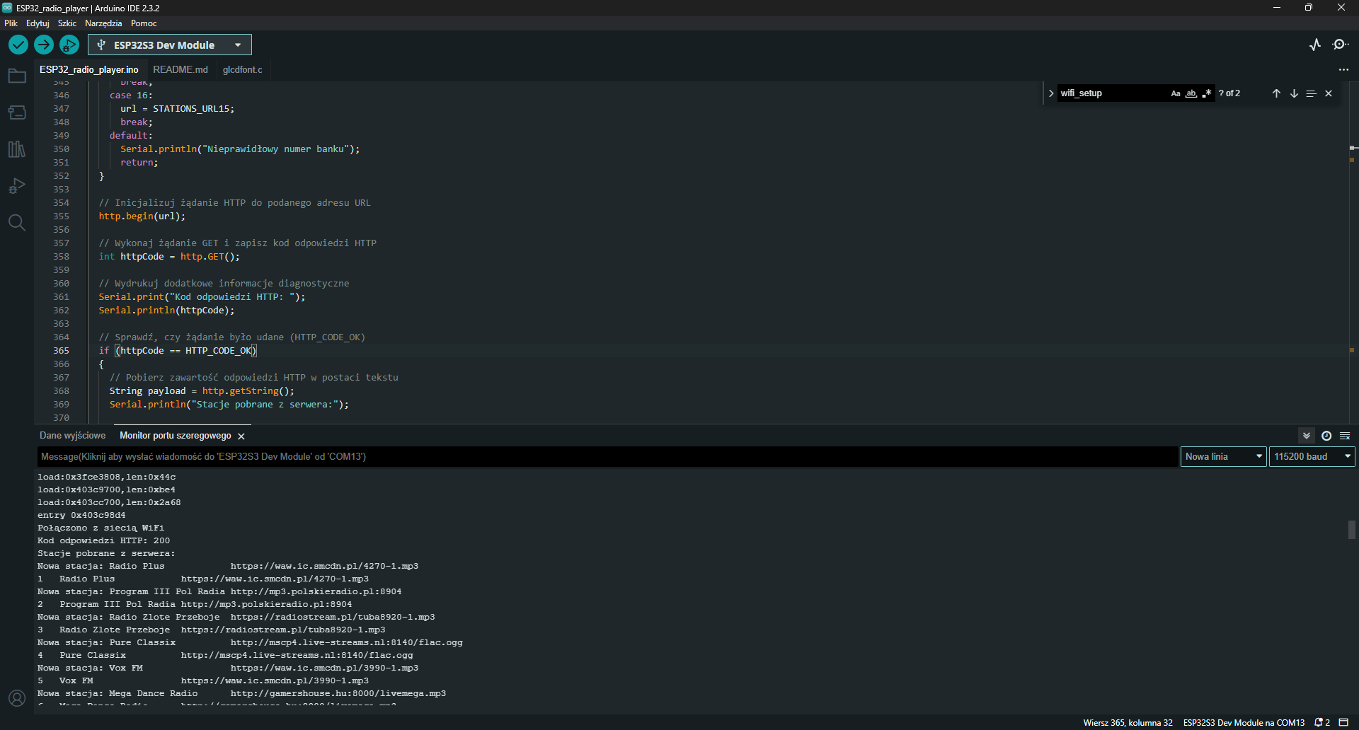

    @hevet I can`t help, on foreign forums they write that it may be a faulty ESP32 module, try some other examples with Arduino IDE on it, if it wants to work stably at all. These two large inscriptions appear on the display, as I understand it? Do you have the Arduino IDE in the latest version?

    @hevet see again, in the first phase of the connection to the server I added a GET request code to the serial terminal, for me the code is normally 200 and everything works.

  • #64 21036134
    hevet
    Posts: 346
    Rate: 47
    Unfortunately.
    Connected to the WiFi network
    HTTP response code: -1
    Error downloading stations. HTTP Code: -1
    Guru Meditation Error: Core 1 panic`ed (Double exception).

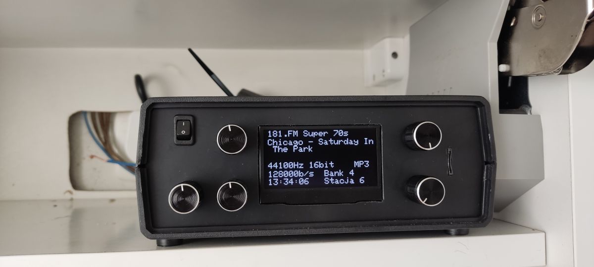

    miroskop
    Posts: 466
    Help: 65
    Rate: 62
    My radio is already working in the kitchen :)
    On the front panel, I placed three potentiometers on the left side of the display and two encoders on the right. The potentiometers are "Balance" (the upper one) and "Bass" and "Treble" (the two lower ones). I had to add timbre because I have ceiling speakers and without equalization they sound quite flat. Moreover, some stations boost bass and treble and others do not, so you have to interfere with the sound yourself. The correction is made on the KA2107 circuit because it takes care of everything that is needed ("Volume", "Bass", "Treble" and "Balance") and single potentiometers are enough, there is no need for stereo ones. Since "Volume" is on the encoder, so as not to duplicate them, I did not connect another potentiometer to the front panel. I only soldered the mounting potentiometer to determine the appropriate signal level. The power amplifier is a ready-made product from China: CS8673
    Once again, I would like to thank the creator for his work and sharing it on the forum!!!
    The photo shows a radio in a kitchen cabinet.
    Radio with a display and knobs in a kitchen cabinet

    @miroskop you made a beautiful cutout for the display and the SD card, did you press the display in or did you glue it somehow? Unfortunately, I couldn`t cut it so nicely, so I used screws. Ultimately, you can make a version with or without 4 buttons, because you can handle a lot of both encoders, and the buttons provide a direct jump function.

    I milled all the holes in the front plate on my own CNC milling machine. And the PCB too.

  • #80 21045463

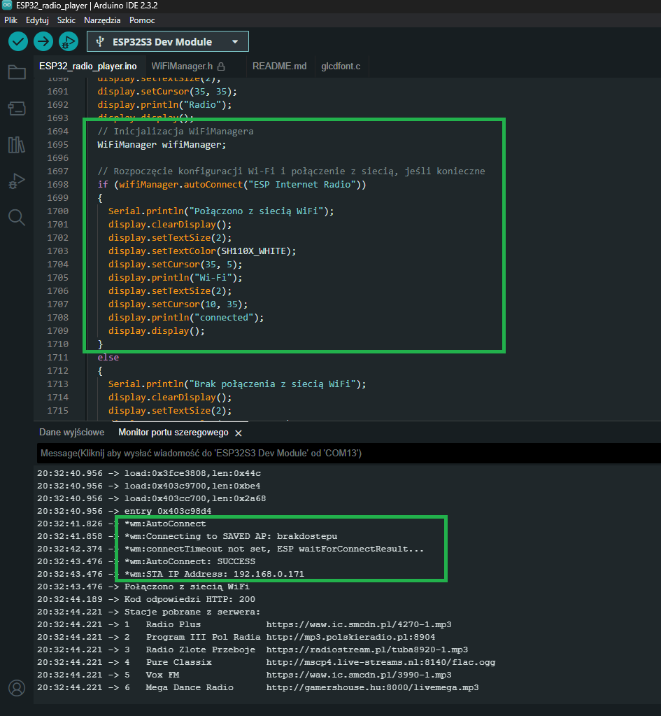

    hevet wrote:
    @MAJSTER XXL haven`t you thought about a different wifi concept? It`s about the WifiManager library from tzapu.
    I recommend this library. I have been using it for many years and it works reliably. I published some projects on elektroda. You can see - there is a tzap library everywhere.

  • #90 21049403
    MAJSTER XXL
    Posts: 2064
    Help: 164
    Rate: 429
    I added the WiFiManager library, removed WiFiMulti, basically added a few lines of code to the setup and now I can`t understand one thing - how is it possible that ESP32 connects via WiFi without providing the network name or password? During compilation, I changed the partition size to Huge APP because it did not fit the default partition.
    Screenshot of code in Arduino IDE for ESP32 with WiFiManager.
