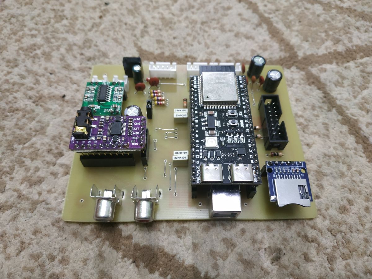

    In the file what I have provided are also pressings, you can make yourself a PCB by home method. In case of thermo-transfer you make only the bottom side and you have to use jumpers, in ready-made Chinese PCBs there are two layers and jumpers are already made on the top layer, you don't have to assemble them.
    This is how I made my prototypes.
    Three PCBs on a carpet: two white boards and one copper board, labeled “ESP32 Web Radio” with many holes.
    Prototype PCB with an ESP32 module, USB ports, microSD slot module, and pin headers
    Greetings...

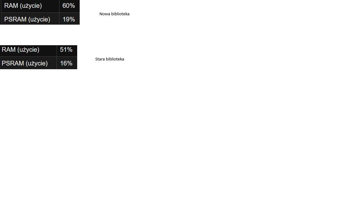

    I compared the performance of the new and old versions of the audio library for myself. The old version is the one before the eq changes, the new version from yesterday, the ram and psram consumption on RMF is at the levels seen below
    Screenshot comparing RAM and PSRAM usage: new library 60%/19%, old library 51%/16%

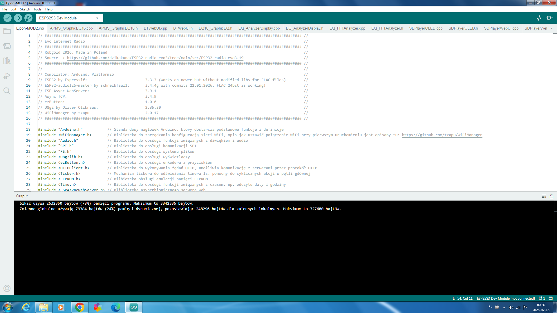

    Ejcona's latest MOD2 Arduino version v.3.19.70B.BT
    Compiles on Arduino
    Screenshot of Arduino IDE showing Ejcon‑MOD2 project for ESP32S3 and memory usage output after compiling
    The libraries are the same as in the original Robgol project
    Greetings ...

    >>21840082 This I can see going for the better...i.e. the new eq with DSP Espressif "eats" more resources and loads probably more on the CPU.
    @hevet I uploaded these new libraries, the volume is OK. I don't even hear/see a difference overall. Only the VU meter "gets crazy" because it has very high values on every station :/
