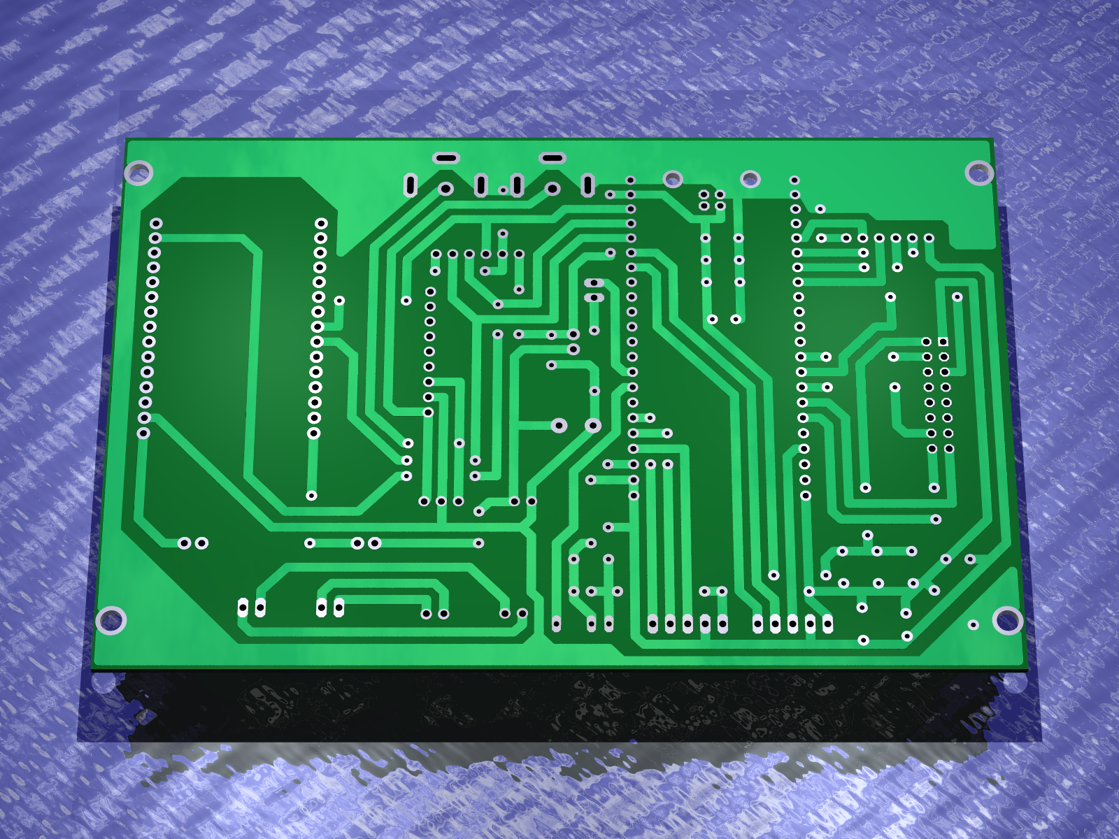

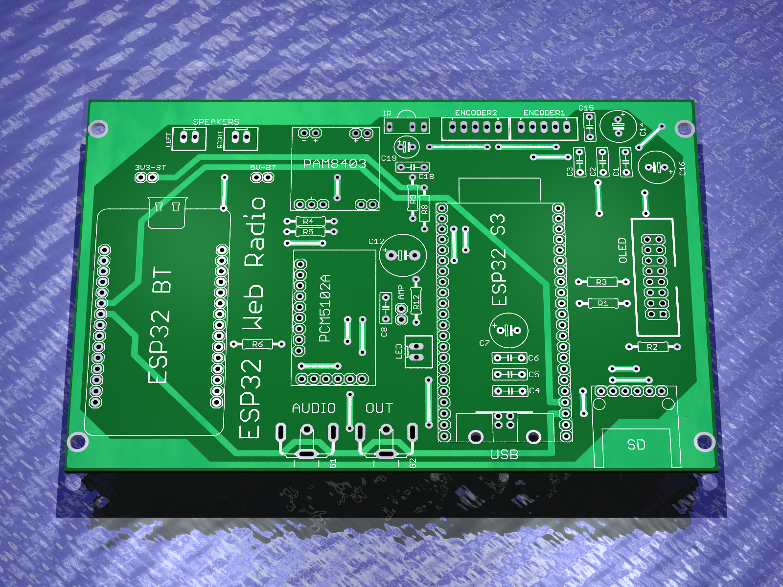

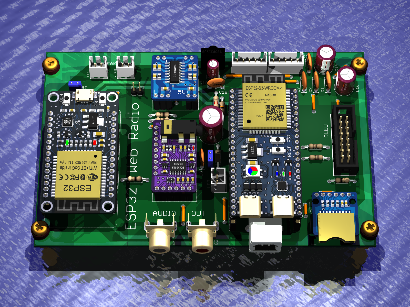

    Hello, for the radio with BT option by colleague ejcon I prepared a PCB, I did not test or order these boards, the radio itself was run on a previous version of the board with two encoders - and this PCB I extended with a second ESP32 BT module.
    3D render of a green PCB labeled for ESP32 modules, audio, USB, SD, and encoder connectors
    Bottom side of a green PCB with visible traces and through-holes on a blue background
    The jumper on the 3v3 and 5v PCB is the type of power connection to the second ESP32 BT module
    Ejcon as far as I know has a 3v3 connected power supply and I connected it to the radio via 5v - of course you only choose one connection either 5v or 3v3

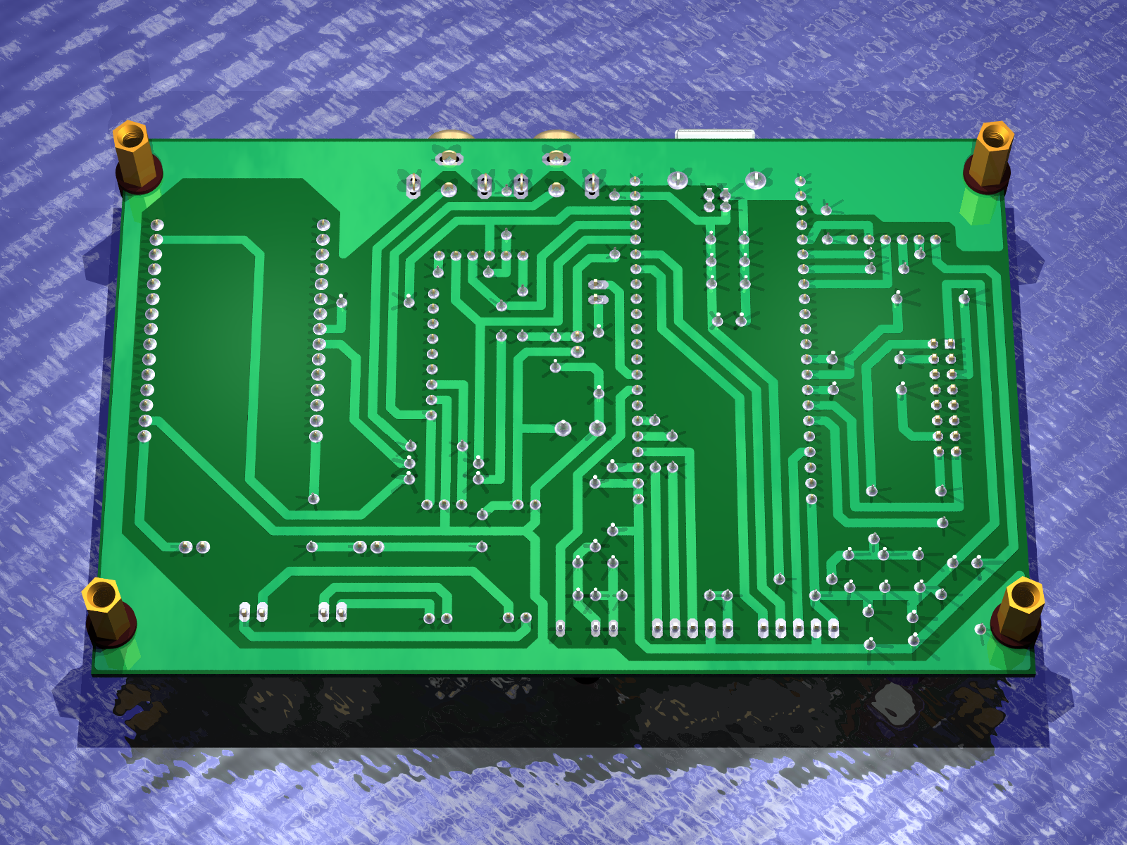

    This is what the PCB looks like after soldering
    PCB with ESP32 modules, RCA audio jacks, OLED header, and mounted electronic components
    Bottom side of a green PCB with many traces and solder points, plus four standoffs at the corners
    Please find attached the necessary design and gerber files to order from china.
    Connections on the PCB between the ESP modules
    ESP32 S3 BCLK (GPIO12) - ESP32 BT GPIO26
    ESP32 S3 WS/LRCLK (GPIO14) - ESP32 BT GPIO25
    ESP32 S3 DATA (GPIO13) - ESP32 BT GPIO22
    ESP32 S3 - ESP32 BT GND
    ESP32 S3 TX (GPIO20) - ESP32 BT RX2 (GPIO16)
    ESP32 S3 RX (GPIO19) - ESP32 BT TX2 (GPIO17)
    @ejcon can you check the RX / TX connections between the modules as you have on the softy made available as I wrote above because it is so on the PCB or vice versa ?
    ejcon wrote:
    The RX and TX connections may be swapped I don't remember how I programmed 19 and 20 ESP32S3 N16R8
    Greetings ...

    >>21835323 everything is correct it is ok

    I would be cautious about using these pins: ESP32 S3 TX (GPIO20), ESP32 S3 RX (GPIO19)
    ESP has USB on them. It's not the happiest solution to plug a UART in there.
  • #2256 21835675

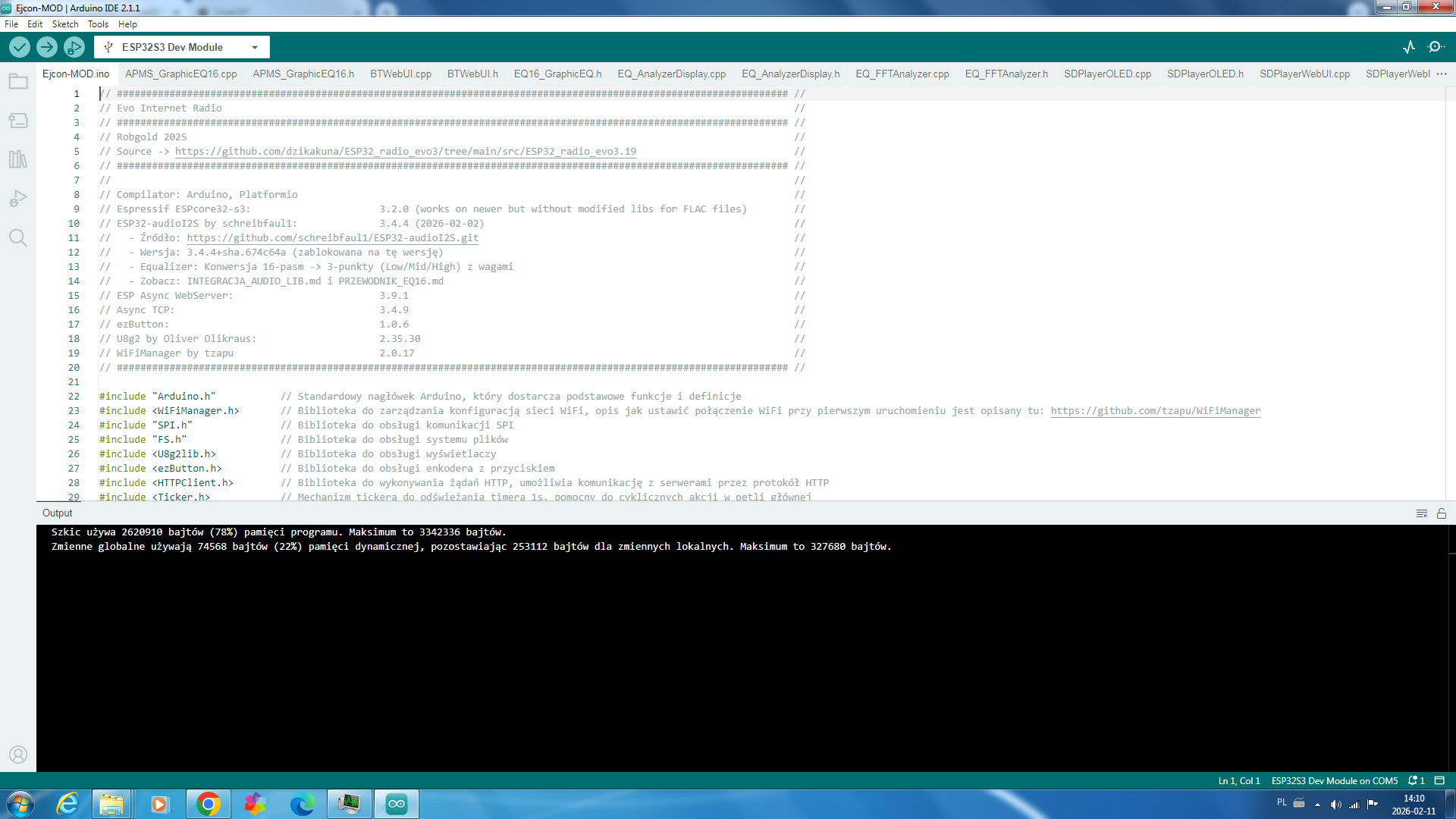

    >>21835323
    For the version of Ejcon-MOD (v.3.19.53.BT) I attach the version that is currently on the ejcon server - after my changes it compiles on the Arduino IDE
    Screenshot of Arduino IDE 2.1.1 showing Ejcon-MOD/ESP32 code and build output with memory usage
    Regards ...

    >>21835642
    I know it's not the luckiest circuit, but on other pins the uart didn't work
    Besides
  • ESP32-S3 UART pins can be reassigned freely

    >>21835750 How does it not work, did you do the assignment correctly ?
    https://docs.espressif.com/projects/esp-idf/e...e/esp32s3/api-reference/peripherals/uart.html
    Code: C / C++
    In the ESP32-S3 you have the GPIO Matrix you can assign this to yourself almost freely. Just because the "by default" configuration from ESP-IDF assigns something doesn't mean it has to be that way.
    The fact is, such a simple radio and you basically use all GPIO pins ;)

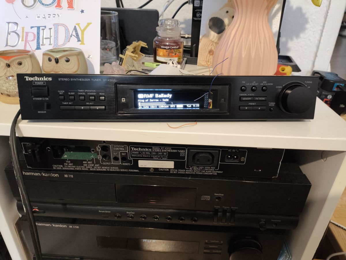

    Posts: 15
    Thank you very much for your reply. These 24 bit streams work, as an experiment, very well. i jumped to the latest version 3 days ago, having previously been on the previous version for a while, which I was very happy with for stability and responsiveness. A few days ago I started a project with a Technics tuner I had unearthed in the attic, unfortunately there is no numeric keypad for the channels, but the 17 buttons are there, so some functions can be output. The original was a 3 line matrix keypad, but I've cut it up and want to splice one ADC line. Just wondering whether to go with resistors or helitrims and tune the resistance to get fairly even spacing for stability. This is my project somewhere around half way to completion
    Technics ST-X302L tuner with lit display, on a shelf above Harman/Kardon audio components
    My question is, are you considering an SD card file player? I've tested a mod that does this and it's generally cool, only the graphical changes in that design compared to your style convention however dictate that I stay on your version as it's closer to my preferences. Best regards and thanks again for the information.

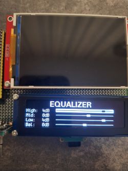

    Such a small modification for people with different levels in their ears. I encourage the creator of Evo radio to modify it.
    Two displays on a protoboard; the lower LCD shows “EQUALIZER” with sliders and dB values

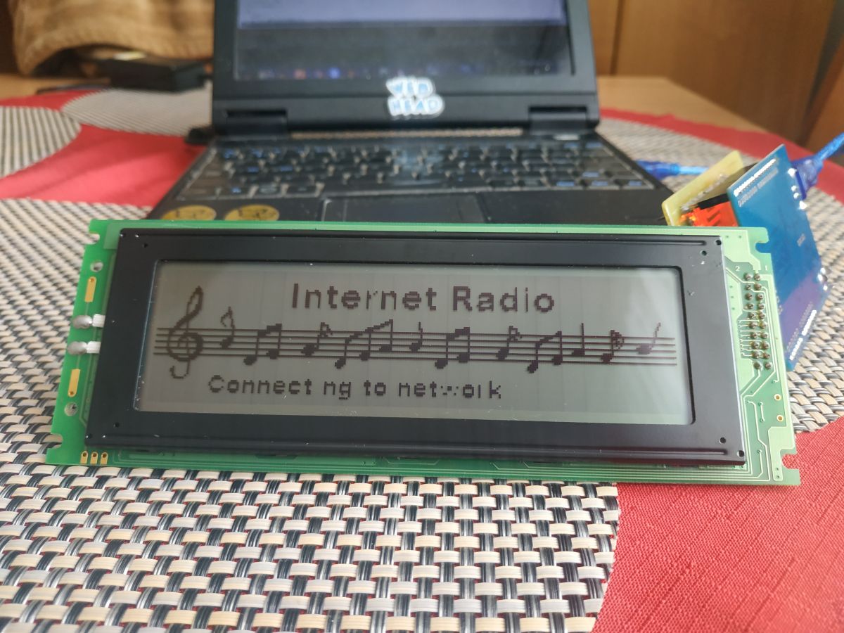

    Hello softy has evolved a lot since the early days.
    Theoretically everything can be done, but the replacement of 2x20 display is not supported and if someone would be tempted to change it would involve rewriting a lot of code and accepting the loss of a lot of information that is available in the case of graphic display. My first beginnings with this radio looked like this.
    LCD module showing “Internet Radio” and “Connecting to network” on a table, with a laptop in the background.
    As they say, nothing is impossible, but I would rather add a display like the one in the project than try anything else. Besides, I saw somewhere a project for 2004 internet radio.

    Recently I made available another version of PCB under the modification of colleague Ejcona it is a modification of Robgold's software but the modification adds the possibility of transmitting via Bluetooth for this version two ESP modules are used.
    Differences between Majster's and Robgold's software
    The Majster has an MP3 player from an SD card
    Operation only with remote control
    Colour LCD 320x480
    Robgold's colleague
    OLED display
    Operation via web page
    Remote control and two encoders or one configurable in software
    No MP3 player (for the moment)
    Possibility to operate the radio without SD card
    Greetings ...

    amrowek wrote:
    @DJCheester
    thanks for the reply...
    As far as the board is concerned I have relented when communicating with the Chinese on their site
    With which Chinese? Everything is in English, step by step, even in chrome you can translate the page into Polish.
    Seriously, if this is too much for you, then let it go, because then you will fail and only throw money down the drain.
  • #2277 21838287
    amrowek
    Posts: 244
    Rate: 10
    CodeBoy wrote:
    Seriously, if this is too much for you to handle, then let it go, because then you'll just end up throwing money down the drain.
    But on what, a radio with ESP or ordering from a Chinese?

    The Evo project is based on a single 256x64 OLED display type on some twin drivers (there is inside code in the latest version support for 128x64, but only in 1 mode).

    amrowek wrote:
    CodeBoy wrote:
    Seriously, if this is too much for you, then let it go, because then you will fail and just throw money down the drain.
    But on what, a radio with ESP or an order from a Chinese?
    If the problem for you is uploading the PCB file on the website, what do you want to do next?
    These are the basics of computer operation, and this radio then requires an environment to upload the rest, i.e. software, libraries etc.
