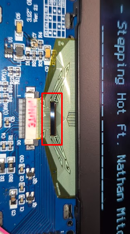

    @supsak Each display itself already has the electronics, the controller is on the connection tape. As this is a standard SSD1322 it fits the connector as well as the electronics from the "small" 3.12 inch display. As of today, it is not possible to buy a whole finished 5.5 inch display in white. The 'electronics' on the PCB itself is nothing more than a couple of capacitors and an inverter from 3.3V to 14V.
    The marked part is just the SSD1322 drivers on the ribbon connecting the display.
    Close-up of a PCB with a display flex cable and a red box highlighting a section near the connector
    The TAS5805 https://www.ti.com/product/TAS5805M is a 2x23W amplifier with PCM built in. It is simply a power amplifier with a ready made i2s input and speaker output. No additional PCM is needed. It quietly allows you to build an amplifier for a small room. The board in the picture is a project by a colleague Sonocotty https://sonocotta.com/louder-esp32/ version with ESP32-S3. I didn't want to design a PCB for testing this TAS, the TAS amplifiers themselves were sent to me by TI. It's hard to get them in our country lately or the stock is zero (TME).

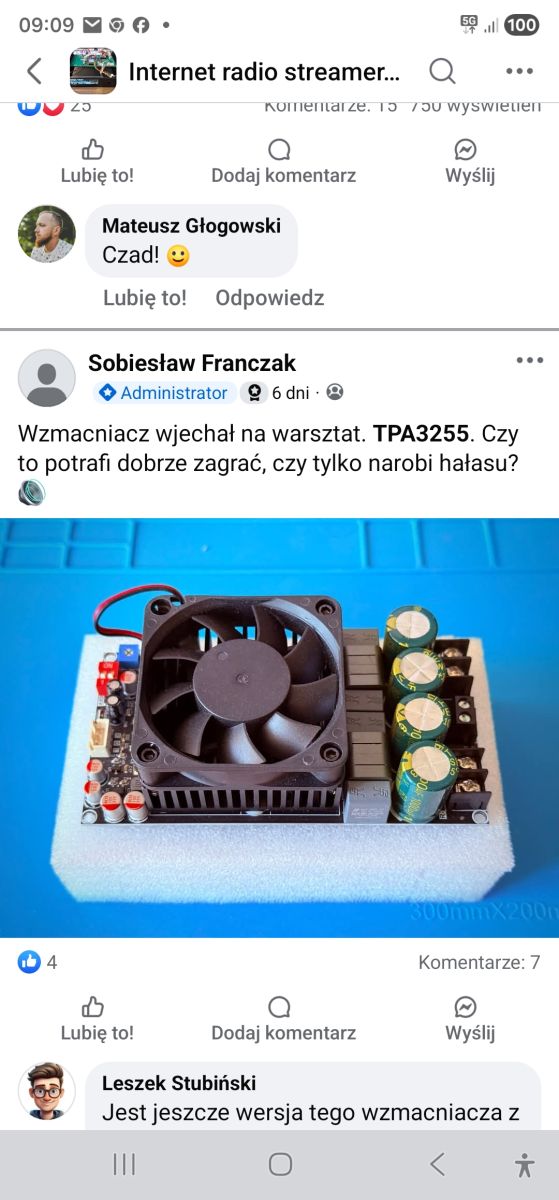

  • #2229 21832433
    ejcon
    Posts: 301
    Rate: 68
    On my mods all the flac never worked well. The administrator is
    Facebook post screenshot showing an amplifier board photo with a cooling fan and capacitors.

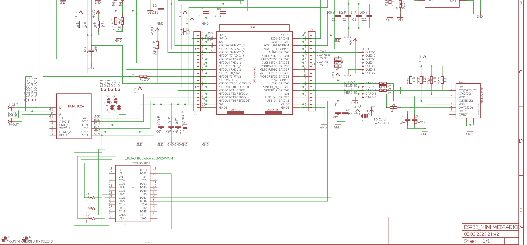

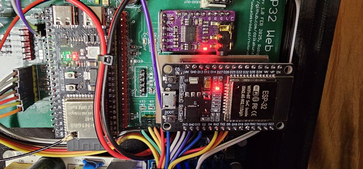

  • PCB modification enables Bluetooth audio on ESP32-S3
    #2234 21833304
    ejcon
    Posts: 301
    Rate: 68
    Small modification of bt handling by beetle
    Inside a device: PCB with wiring and ESP32 modules with lit LEDs Close-up of PCBs with an ESP32 module, a smaller board, and multicolored wiring; indicator LEDs are lit.
    I added a small modification to the pcb and we have BT working as someone would like the code posted on github
    And yes on the fim the sound from the speakers and bt is working there is reverberation drugs but little delay.
    Now it will be necessary to make corrections under sofcik 3.19.70
    The scheme is as follows
    Section of a PCB schematic showing an ESP32 module, OLED connectors, and an SD card socket
    • 20260208_173818.mp4 (132.47 MB) You must be logged in to download this attachment.
  • #2235 21833690
    boloteam 2.0

    >>21833304
    @ejcon a can you upload the schematic in higher resolution?
  • #2238 21834005
    ejcon
    Posts: 301
    Rate: 68
    You have the eagle diagram attached
    EAGLE schematic fragment showing ESP32, PCM5102A audio IC, OLED connections, and an SD card socket wiring
    • ESP32_MINI WEBRADIOV4 BT.sch (1.08 MB) You must be logged in to download this attachment.
  • #2239 21834014
    efi222
    Level 22  
    Posts: 779
    Help: 12
    Rate: 1219
    Thanks :)
    Already this *.png is great.

    RX and TX connections can be swapped I can't remember how I programmed 19 and 20 ESP32S3 N16R8
  • #2241 21834216
    efi222
    Level 22  
    Posts: 779
    Help: 12
    Rate: 1219
    I will be designing the board from scratch on developer modules so the pinout will definitely be different. But thanks for pointing out :)

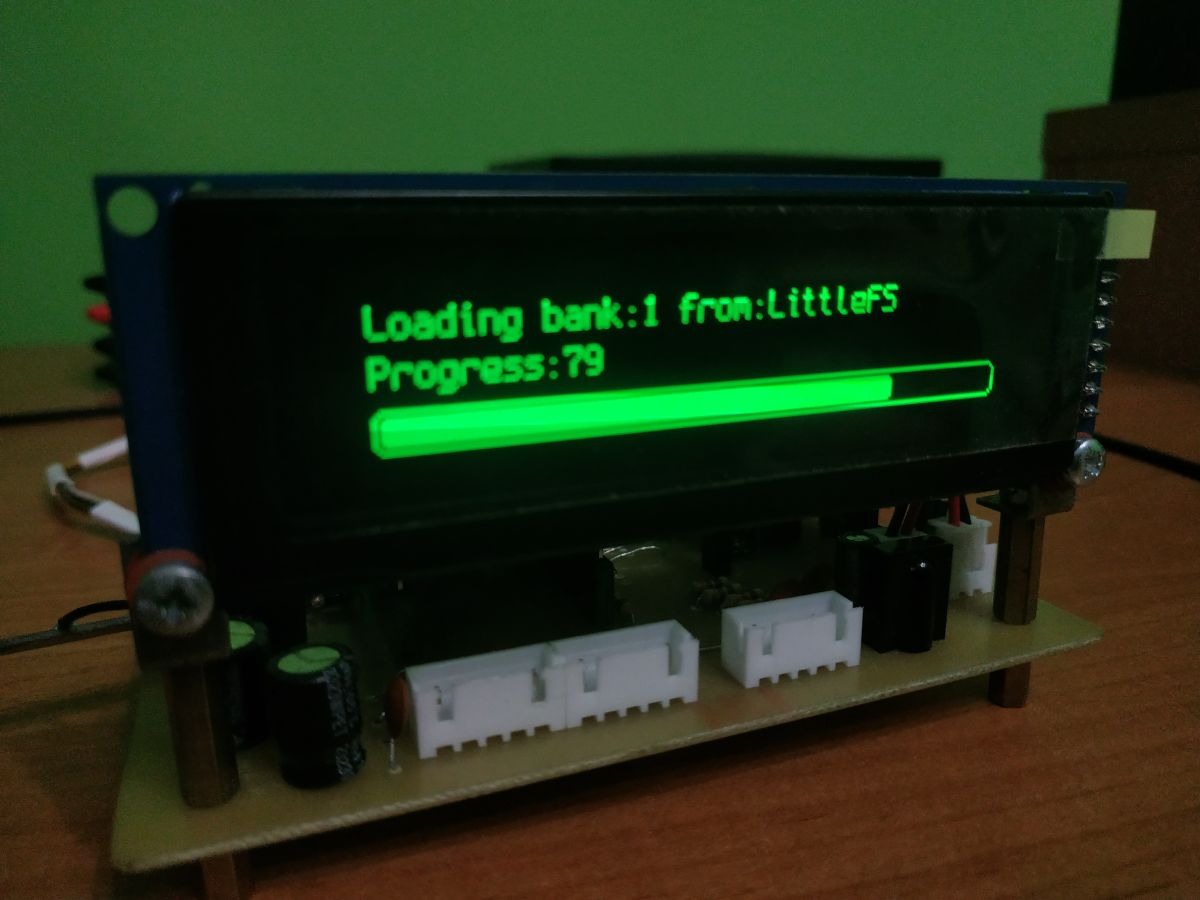

  • Remote control mapping file not being applied
    #2246 21834775
    DJCheester
    Level 28  
    Posts: 2089
    Help: 75
    Rate: 958
    Hi, I uploaded the latest sofcik kol Robgold the radio started with version 70 without a card at first read the bank from github the next start up already with LittleFS. I uploaded all the files I had before and interestingly it doesn't read the remote control and doesn't save the config, what could be wrong, I didn't upload the old config file but the radio created a new one. (The old file is the same) The remote control is read in the serial monitor correctly sees the button for example 00 ADR and CMD 19 and so I have in the remote.txt file only the radio displays in the serial monitor ADR 00 and cmd 19 that is correctly but adds another button, I think as if the radio did not see the txt file also have this?
    LCD on a circuit board shows “Loading bank:1 from:LittleFS” and a progress bar at 79 LCD showing “Evo Internet Radio” with green text, music staff graphic, and an IP address
    PS the new UV meters I don't have either (but I don't think they're in the sofa yet ?)
    Greetings...
  • #2247 21834783
    robgold
    Posts: 726
    Help: 10
    Rate: 290
    >>21834775 I will check this on version 70 in the evening, perhaps there is a 'bug' related to auto memory selection.
  • #2248 21834840
    RonAd
    Posts: 26
    At my place it reads remote .txt but from SD card and remote control works.
