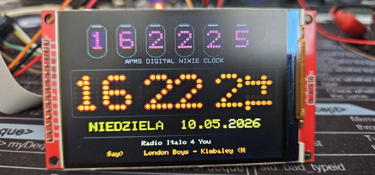

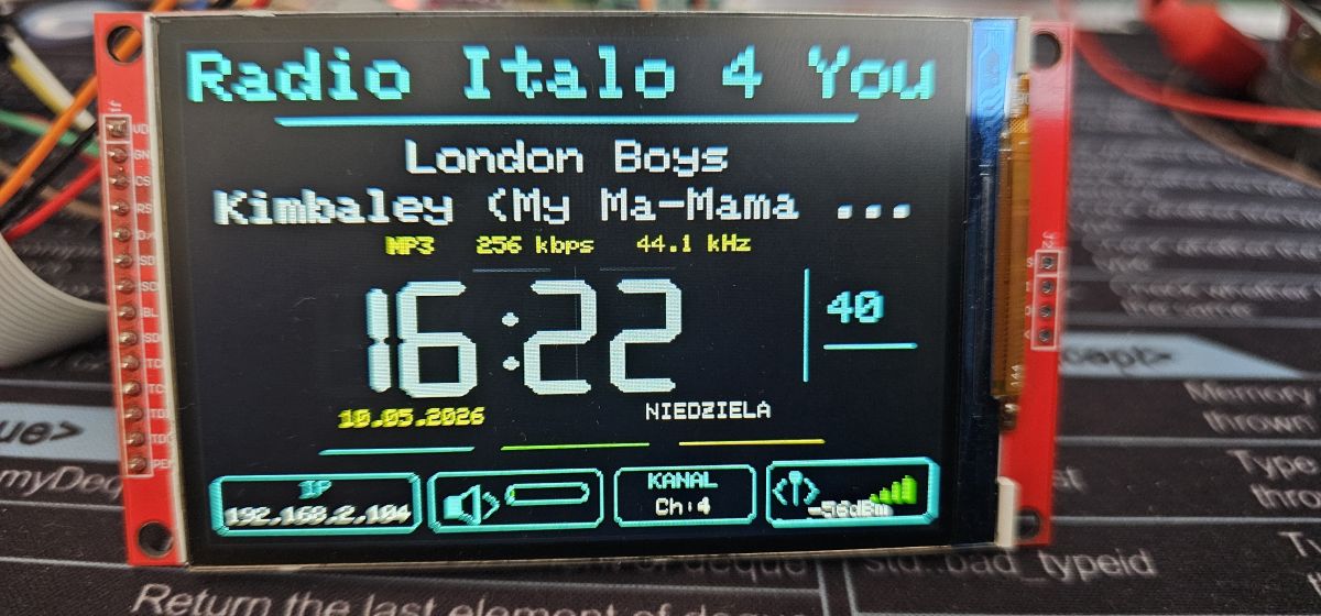

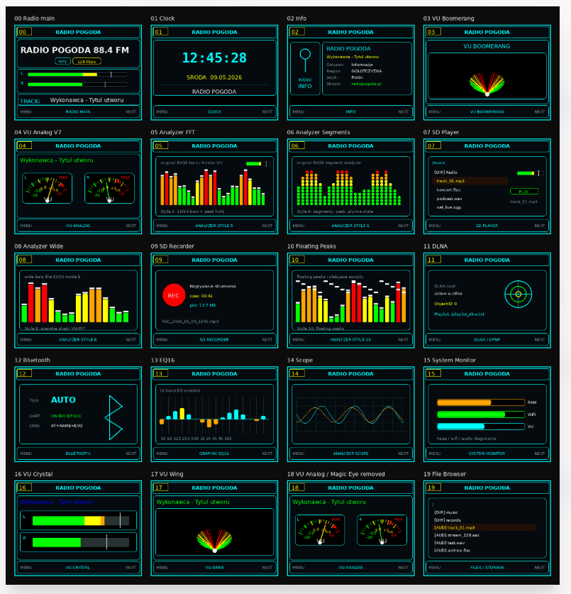

    New software version EVO3 MOD KOL .There is still a lot of room for improvement but you have a look for yourself . Version on Panel ILI9488 connections as before. Enjoy testing.
    The visual side looks like this
    Screenshot grid of 20 radio player UI panels with visualizers, clock, info pages, and menus.
    • EVO_Radio_Arduino_ILI9488_V7_WLASCIWY_META_AUDIO_LEVEL_COMPILE_FIX.zip (1.05 MB) You must be logged in to download this attachment.
  • Rotation change needed for ILI9488 and ST7796 panels

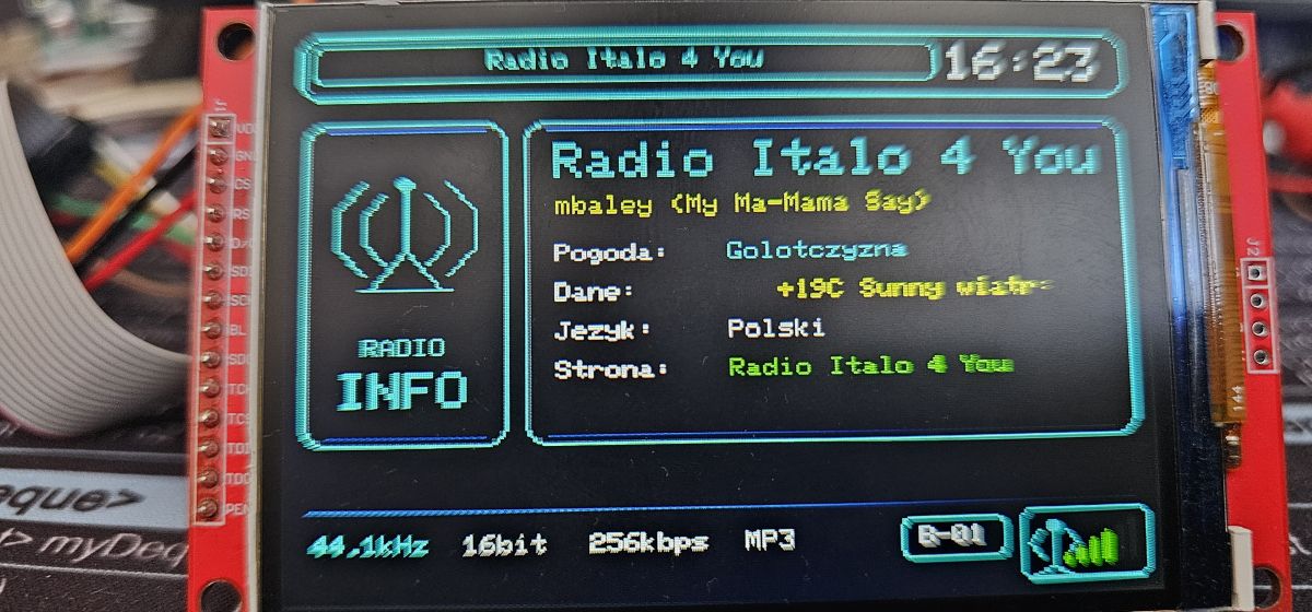

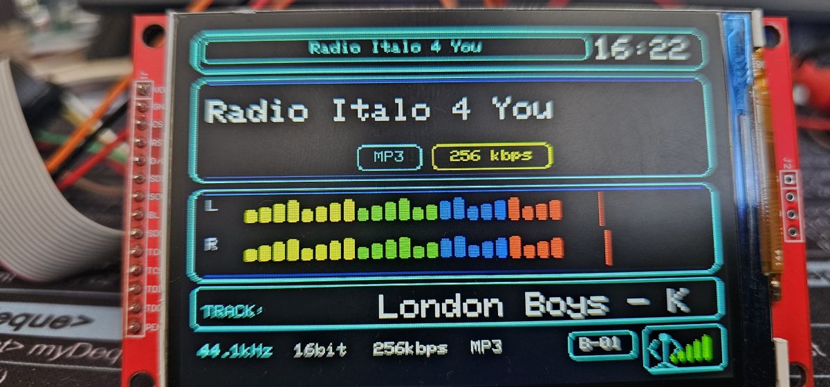

    NEW TOOLING EVO3 MOD COLOUR
    Internet radio and audio file player on ESP32-S3 Internet radio and audio file player on ESP32-S3 Internet radio and audio file player on ESP32-S3 Internet radio and audio file player on ESP32-S3 Internet radio and audio file player on ESP32-S3
    EVO_Radio_Arduino_ILI9488_V7_BT_ICON_ORIGINAL_SHAPE_FIX4 This option is already there
    WORKS ON PANELS ILI9488 AND ST7796 you have to change the rotation in the code because the image is rotated 180 degrees
    • EVO_Radio_Arduino_ILI9488_V7_FULL_ADOPTED.ino.merged.bin (16 MB) You must be logged in to download this attachment.
    • EVO_Radio_Arduino_ILI9488_V7_BT_ICON_ORIGINAL_SHAPE_FIX4.zip (1.07 MB) You must be logged in to download this attachment.
    • EVO_Radio_Arduino_ILI9488_V7_INFO_WEATHER_DANE_DEGREE_FIX.zip (1.07 MB) You must be logged in to download this attachment.

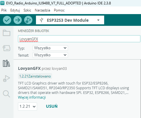

    And what kind of graphics? In terms of libraries?
  • #2644 21900347
    ejcon
    Posts: 301
    Rate: 68
    >>21900341
    LovyanGFX 1.2.21
    Audio Version 3.4.6
    Arduino IDE Library Manager showing “LovyanGFX” with version 1.2.21 marked as installed. LovyanGFX 1.2 audio version 3.4

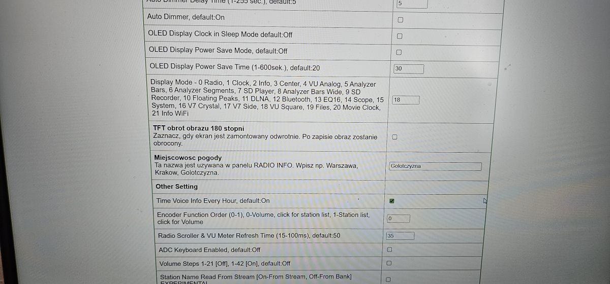

    markon7
    Posts: 13

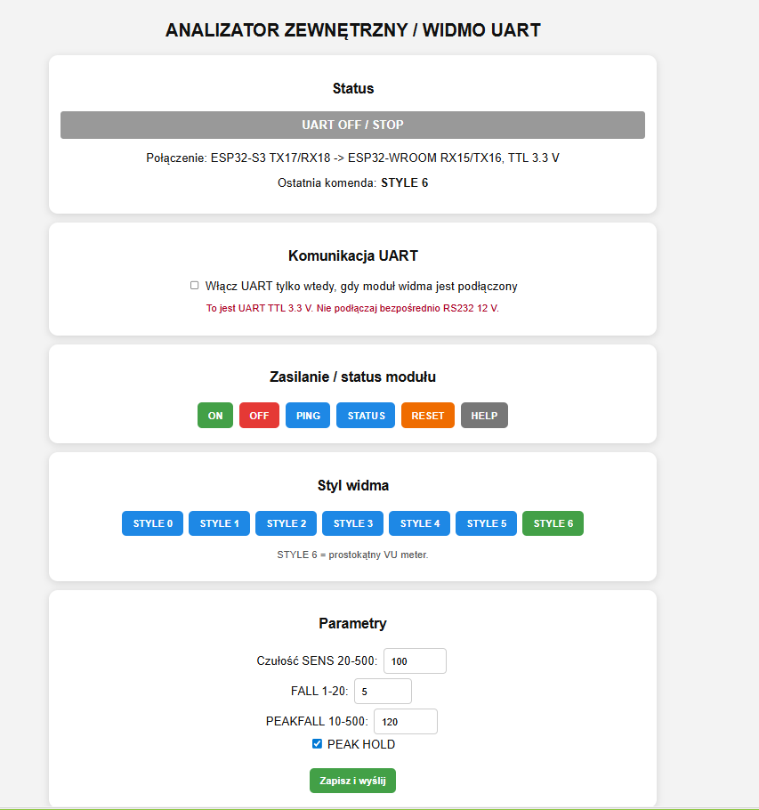

    >>21900366 well it looks nice, but .bin is for ILI9488 and I have st7796 and have a mirror image
  • 180-degree display rotation and TFT pinout for new firmware
    #2649 21900541
    ejcon
    Posts: 301
    Rate: 68
    In the web setting you have a rotation setting of 180 degrees, select it and update it, it works fine
    Web settings screenshot showing “TFT image rotation 180 degrees” and a “Weather location” field.

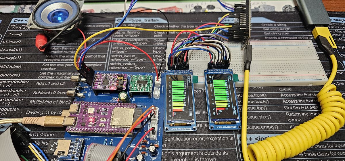

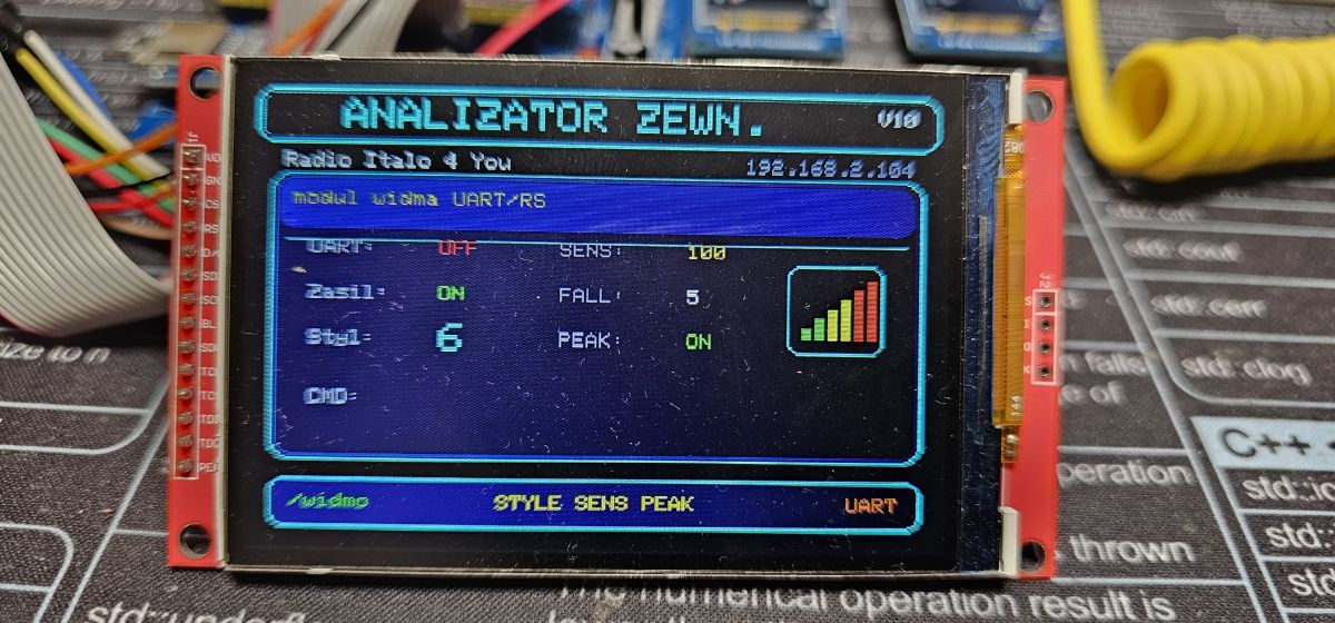

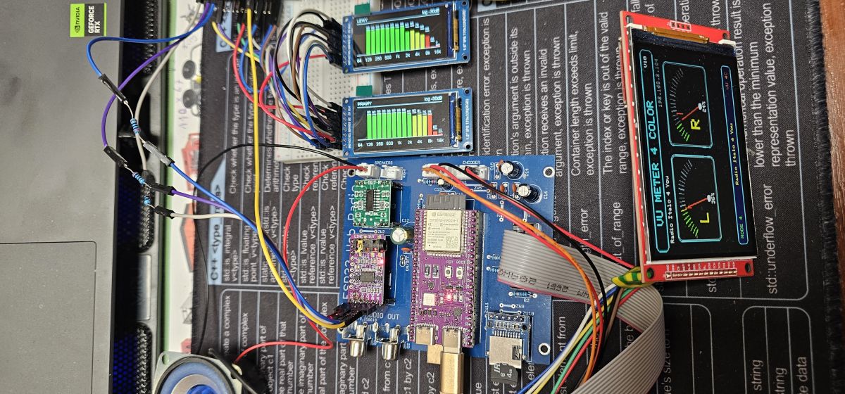

  • Dual ST7789 SPI wiring with UART and I2S pins
    #2655 21901277
    ejcon
    Posts: 301
    Rate: 68

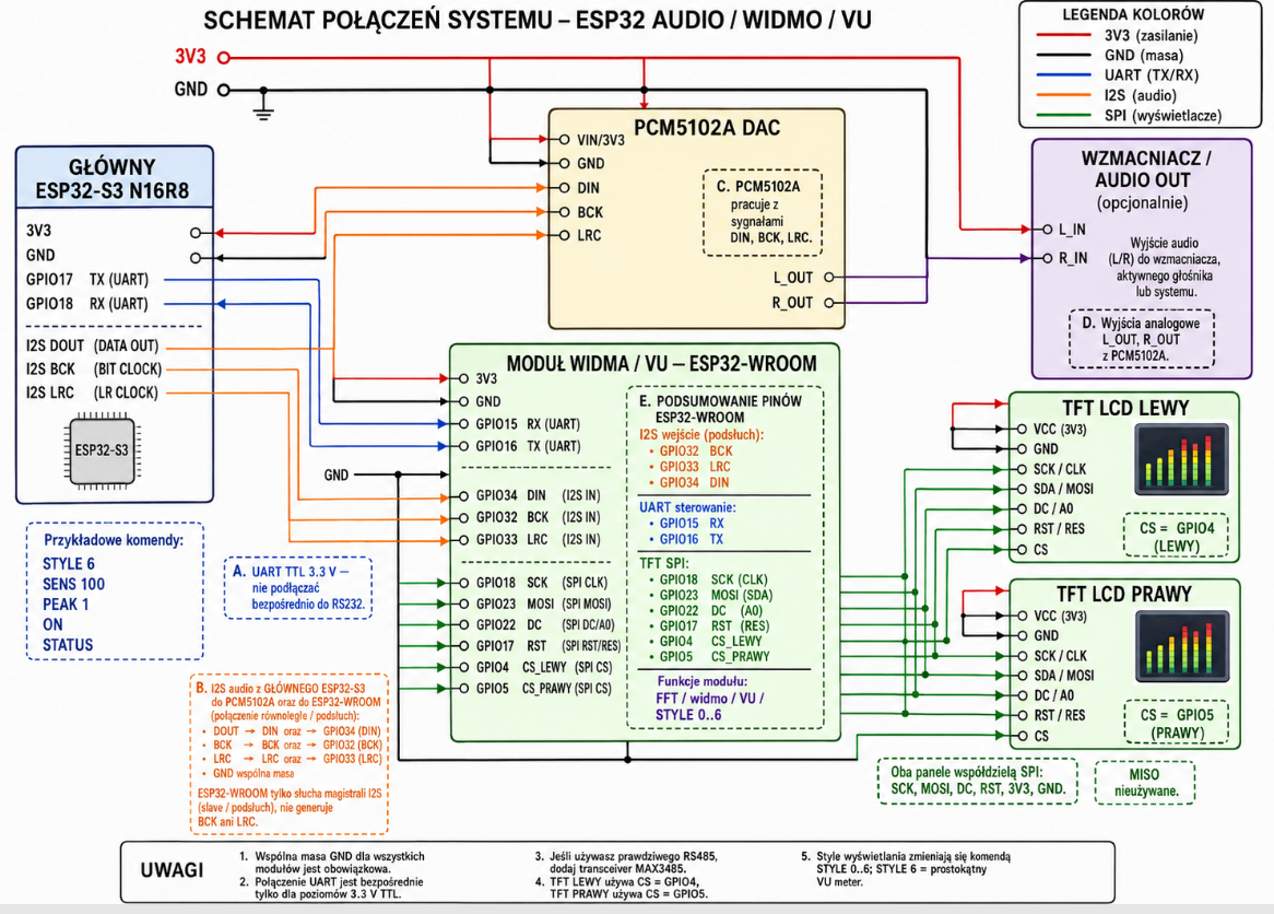

    >>21901191

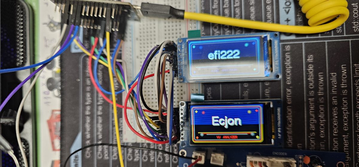

    Maybe something like this .
    Cod for the spectrum converted from the code of colleague efi222.
    Wiring diagram for ESP32 with PCM5102A DAC and two ST7789 TFT displays sharing an SPI bus
    Screenshot of “External Analyzer / UART Spectrum” control panel with buttons and parameters
    Connections:
    2. TWO TFT PANELS ST7789 1.9" 170x320
    Both displays share the same SPI bus. Only the CS pin differs.
    GPIO4 -> CS TFT left
    GPIO5 -> CS TFT right
    GPIO15 -> RX UART from master ESP32-S3
    GPIO16 -> TX UART to main ESP32-S3
    GPIO17 -> RST of both TFTs
    GPIO18 -> SCK of both TFTs
    GPIO22 -> DC of both TFTs
    GPIO23 -> MOSI both TFTs
    GPIO32 -> I2S BCK
    GPIO33 -> I2S LRC
    GPIO34 -> I2S DIN
    3V3 -> TFT and module power supply
    GND -> common groundTFT LEFT:

    I've been writing for a long time that this S3 from the radio is sweating from an excess of bits and bobs. A separate ESP for effects is a good direction. Audio over i2c in the spectrum is great as much as it is limited to one device.
  • Recompiling lwip for 2500 kbps FLAC playback
    #2659 21901459
    robgold
    Posts: 726
    Help: 10
    Rate: 290
    >>21901130 I agree 100%. Byers, blinkers ...great. However, this is INTERNET RADIO and the most important thing is that this streamer is able to correctly play back also such HiRes stations with FLAC codec. In 99% after starting the station no one looks at the display. we "fire up" our favourite station and off we go.
    This is why I am recompiling our own lwip libraries for the project, so that the radio plays correctly even up to 2500kbps/FLAC.
    @efi222 The approach with a separate analyser is spot on.

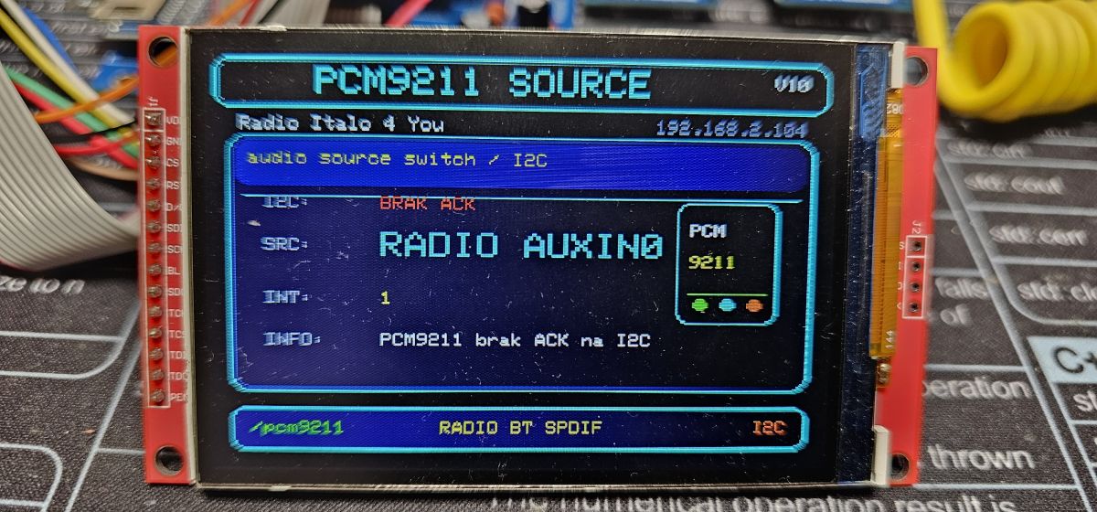

  • PCM9211 input mapping for radio and Bluetooth I2S
    #2660 21901465
    ejcon
    Posts: 301
    Rate: 68

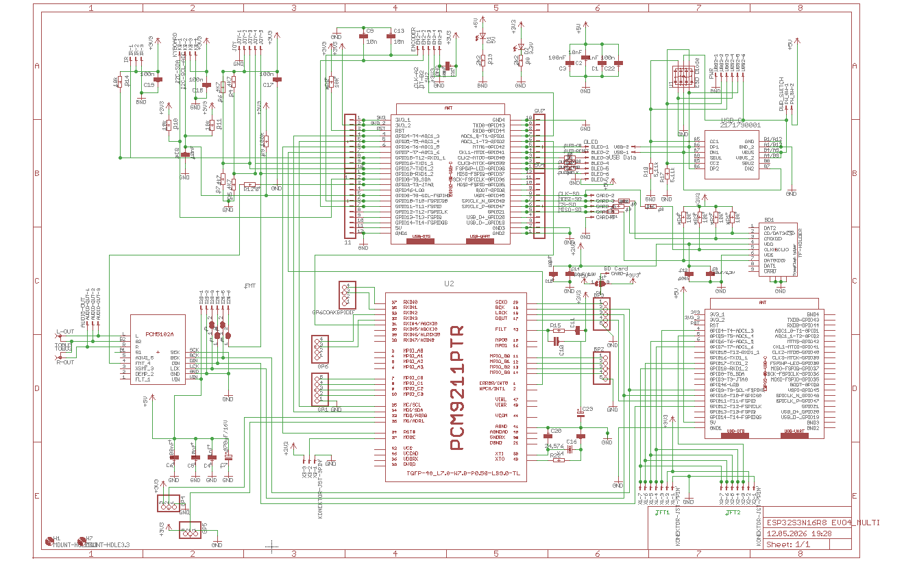

    What do you think about making a circuit as follows
    1 main processor ESP32 S3 N16R8 radio Evo3
    2.2 ESP32 S3 N16R8 processor Graphic equalizer with spectrum analyzer controlled from the main processor via uart
    3 BT AUDIO ESP32 WROM transmitter controlled from the main processor via uart2
    A PCM9211 could be added before the equalizer to feed other digital signals.
    1. Main audio structure
    ESP32-S3 EVO3 RADIO
    radio, Wi-Fi, web, TFT/OLED, SD, remote control, BT control
    | I2S raw from the radio
    | DATA / BCK / LRC / optionally MCLK
    v
    PCM9211
    source selection:
    RADIO I2S / BT I2S / SPDIF / AUX / future inputs
    | I2S selected source
    | DATA / BCK / LRC
    v
    ESP32-S3 N16R8 DSP
    equalizer 20 Hz ... 20 kHz
    preamp, limiter, spectrum analyser, VU
    | DATA after equalization
    | BCK and LRC common with PCM9211
    v
    PCM5102A DAC
    v
    audio amplifier
    1. ESP32-S3 EVO3 RADIO → PCM9211 as AUXIN0
    This is the correct connection for internet radio.
    ESP32-S3 EVO3 PCM9211 pin Name PCM9211 pin Function in project
    GPIO13 28 RXIN7 / ADIN0 I2S DATA from radio
    GPIO14 29 RXIN6 / ALRCKI0 I2S LRC / LRCK
    GPIO12 30 RXIN5 / ABCKI0 I2S BCK
    GPIO2 optional 31 RXIN4 / ASCKI0 I2S MCLK / SCK optional
    GND common ground
    So on the PCB describe it like this:
    PCM9211 AUXIN0 / RADIO
    pin 28 RXIN7/ADIN0 <- RADIO DATA
    pin 29 RXIN6/ALRCKI0 <- RADIO LRCK
    pin 30 RXIN5/ABCKI0 <- RADIO BCK
    pin 31 RXIN4/ASCKI0 <- RADIO MCLK optional
    Here an earlier description was good.

    4. PCM9211 → ESP32-S3 DSP
    This is the main output of the PCM9211. Here the pins are exactly as shown in your picture.
    PCM9211 pin Name PCM9211 ESP32-S3 DSP Function
    17 DOUT GPIO11 DATA IN to DSP
    18 LRCK GPIO10 LRC / LRCK
    19 BCK GPIO9 BCK
    20 SCKO test pad / MCLK / SCK optionally
    GND GND GND ground
    Description on PCB:
    PCM9211 MAIN OUT
    pin 17 DOUT -> DSP GPIO11 DATA_IN
    pin 18 LRCK -> DSP GPIO10 LRC
    pin 19 BCK -> DSP GPIO9 BCK
    pin 20 SCKO -> TP_SCKO / optionally DSP MCLK
    The PCM9211 has routing of DIR, ADC, AUXIN0, AUXIN1, AUXIN2 sources to the main output. Selection of the main output is via register 6Bh, and muting and Hi-Z is via registers 6Ah and 6Dh.
    ________________________________________

    Optical 2 DATA 32 RXIN3
    Optical 3 optional 31 RXIN4 / ASCKI0 if not using AUXIN0 SCK
    Optical 4 optional 30 RXIN5 / ABCKI0 if not using AUXIN0
    Optical 5 optional 29 RXIN6 / ALRCKI0 if not using AUXIN0
    Optical 6 optional 28 RXIN7 / ADIN0 if you do not use AUXIN0
    In our case RXIN4...RXIN7 are occupied by AUXIN0 RADIO, so for TOSLINK leave RXIN2 and RXIN3 realistically.
    7. Corrected netlist of the main audio path
    NET_RADIO_DATA:
    ESP32_EVO3 GPIO13
    PCM9211 pin 28 RXIN7/ADIN0
    NET_RADIO_LRCK:
    ESP32_EVO3 GPIO14
    PCM9211 pin 29 RXIN6/ALRCKI0
    NET_RADIO_BCK:
    ESP32_EVO3 GPIO12
    PCM9211 pin 30 RXIN5/ABCKI0
    NET_RADIO_MCLK_OPTION:
    ESP32_EVO3 GPIO2
    PCM9211 pin 31 RXIN4/ASCKI0
    NET_BT_I2S_MCLK_OPTION:
    BT_MODULE MCLK
    PCM9211 pin 7 MPIO_C0 / AUXIN1_SCK
    NET_BT_I2S_BCK:
    BT_MODULE BCK
    PCM9211 pin 8 MPIO_C1 / AUXIN1_BCK
    NET_BT_I2S_LRCK:
    BT_MODULE LRCK
    PCM9211 pin 9 MPIO_C2 / AUXIN1_LRCK
    NET_BT_I2S_DATA:
    BT_MODULE DATA_OUT
    PCM9211 pin 10 MPIO_C3 / AUXIN1_DATA
    NET_EXT_I2S_MCLK_OPTION:
    EXT_I2S MCLK
    PCM9211 pin 11 MPIO_B0 / AUXIN2_SCK
    NET_EXT_I2S_BCK:
    EXT_I2S BCK
    PCM9211 pin 12 MPIO_B1 / AUXIN2_BCK
    NET_EXT_I2S_LRCK:
    EXT_I2S LRCK
    PCM9211 pin 13 MPIO_B2 / AUXIN2_LRCK
    NET_EXT_I2S_DATA:
    EXT_I2S DATA
    PCM9211 pin 14 MPIO_B3 / AUXIN2_DATA
    NET_PCM9211_MAIN_DOUT:
    PCM9211 pin 17 DOUT
    DSP_ESP32 GPIO11
    NET_PCM9211_MAIN_LRCK:
    PCM9211 pin 18 LRCK
    DSP_ESP32 GPIO10
    PCM5102A LRC via jumper 0R
    NET_PCM9211_MAIN_BCK:
    PCM9211 pin 19 BCK
    DSP_ESP32 GPIO9
    PCM5102A BCK via jumper 0R
    NET_PCM9211_MAIN_SCKO_OPTION:
    PCM9211 pin 20 SCKO
    test pad TP_SCKO
    NET_DSP_DATA_OUT_EQ:
    DSP_ESP32 GPIO12
    PCM5102A DIN
    8. Note to the connection of the DSP with the PCM5102A
    Here I would leave the 0 Ω jumpers on the PCB, because we have two possible clock variants.
    Variant A, which we described:
    PCM9211 BCK -> DSP GPIO9 and PCM5102A BCK
    PCM9211 LRCK -> DSP GPIO10 and PCM5102A LRC
    DSP GPIO12 -> PCM5102A DIN
    This variant only works if the DSP correctly transmits DATA_OUT synchronised to the external BCK/LRCK.
    Variant B, safer to run:
    PCM9211 DOUT/BCK/LRCK -> DSP input I2S
    DSP generates its own BCK/LRCK/DATA -> PCM5102A
    For the first prototype PCB I recommend giving jumpers:
    JP_BCK_DAC:
    position 1: BCK with PCM9211
    position 2: BCK with DSP_TX
    JP_LRCK_DAC:
    position 1: LRCK with PCM9211
    position 2: LRCK with DSP_TX
    This way you won't get blocked if the ESP32-S3 DSP requires a separate I2S TX with its own clock.
    9. Corrected PCM9211 pin description for the schematic
    This is how I would describe the symbol in KiCad/Eagle:
    1 ERROR/INT0
    2 NPCM/INT1
    3 MPIO_A0
    4 MPIO_A1
    5 MPIO_A2
    6 MPIO_A3
    15 MPO0
    16 MPO1
    17 DOUT
    18 LRCK
    19 BCK
    20 SCKO
    21 DGND
    22 DVDD
    23 MDO/ADR0
    24 MDI/SDA
    25 MC/SCL
    26 MS/ADR1
    27 MODE
    28 RXIN7/ADIN0
    29 RXIN6/ALRCKI0
    30 RXIN5/ABCKI0
    31 RXIN4/ASCKI0
    32 RXIN3
    33 RXIN2
    34 RST
    35 RXIN1
    36 VDDRX
    37 RXIN0
    38 GNDRX
    39 XTI
    40 XTO
    41 AGND
    42 VCC
    43 FILT
    44 VCOM
    45 AGNDAD
    46 VCCAD
    47 VINL
    48 VINR
    This is consistent with your pinout from the picture and the TI table.
    10. Most important corrections from the previous description
    In the previous description it was confusing:
    pin 10 MPIO_C3 / ADIN1
    pin 8 MPIO_C1 / ABCKI1
    pin 9 MPIO_C2 / ALRCKI1
    Now we write it correctly:
    pin 10 MPIO_C3, post-configuration function: AUXIN1_DATA / ADIN1
    pin 8 MPIO_C1, function after configuration: AUXIN1_BCK / ABCKI1
    pin 9 MPIO_C2, function after configuration: AUXIN1_LRCK / ALRCKI1
    That is, for the PCB use the physical names MPIO_Cx and MPIO_Bx, and add the function after the slash as a logical description.
    In the end for your project it stays like this:
    RADIO from EVO3 -> AUXIN0, pins 28/29/30/31
    BT I2S -> AUXIN1, pins 7/8/9/10
    additional I2S -> AUXIN2, pins 11/12/13/14
    SPDIF coax -> RXIN0/RXIN1, pins 37/35
    SPDIF optical -> RXIN2/RXIN3, pins 33/32
    output to DSP -> DOUT/LRCK/BCK, pins 17/18/19
    i2C control -> SDA/SCL, pins 24/25
    reset -> RST, pin 34
    i2C mode -> MODE to GND, pin 27
    You can already transfer this version to the PCB schematic.
    Both TFTs together:
    GPIO18 -> SCK / CLK
    GPIO23 -> MOSI / SDA
    GPIO22 -> DC / A0
    GPIO17 -> RST / RES
    3V3 -> VCC
    GND -> GND
    TFT left:
    GPIO4 -> CS
    TFT right:
    GPIO5 -> CS
  • UART2 with bundled RX lines and command filtering
    #2661 21901477
    efi222
    Level 22  
    Posts: 779
    Help: 12
    Rate: 1219
    >>21901465
    Point 2 and 3
    If the uart is unidirectional one is sufficient Preferably UART2.
    In the receiving ESPs the RXs are bundled together.
    I have something similar done in another device with two ESP32s. I control them TX from the Esp8266 from the GUI.
    Only in the command headers you have to add to which ESP32 the command is flying to. And they receive all the commands and filter if it is to it.

    Spectrum software fix.
    Cod for the spectrum reworked from the code of colleague efi222.
    THANKS FOR A SHOOT OF GOOD WORK efi222
    Such a little gadget about the demo every time you run .
    A request not to remove this from the code .
    Breadboard prototype with wires and two blue LCD displays showing “efi222” and “Ecjon”
    TFT display showing “ANALIZATOR ZEWN.” menu on a red PCB, with cables and ribbon in the background.
    Tested
    Electronics test setup with circuit boards, wiring, and three color displays showing spectrum/VU meters Electronics prototype with wires and two small displays showing vertical signal level bars
    TFT screen showing “PCM9211 SOURCE” UI with “RADIO AUXIN0” message, surrounded by wires
    • widmo_analyzer_pio_32BIT.zip (16.94 MB) You must be logged in to download this attachment.
