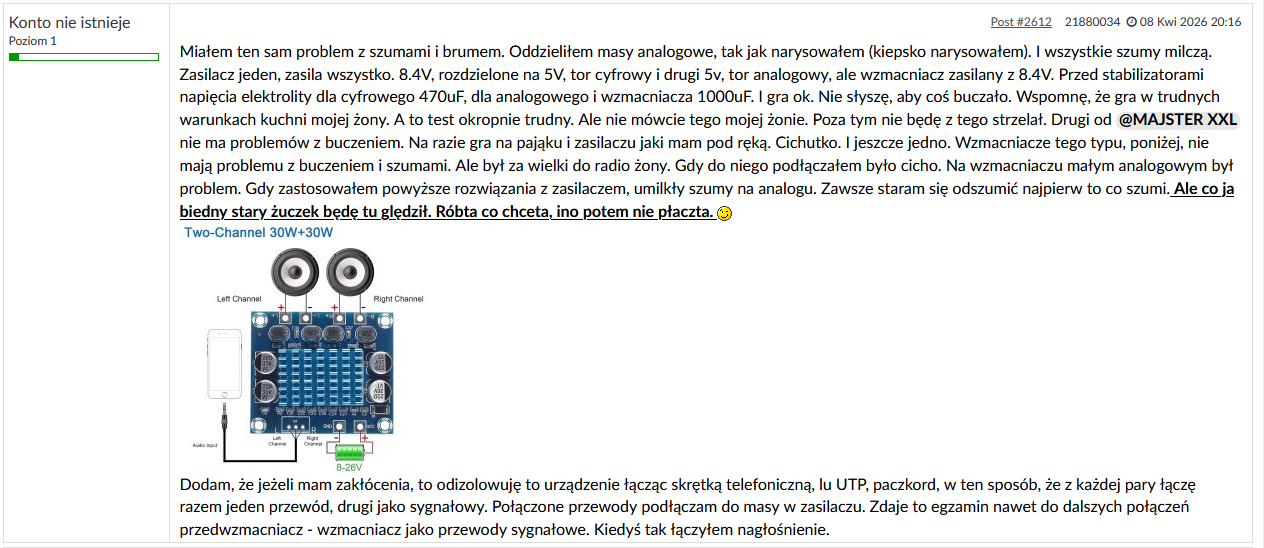

  • Separate analogue grounds and add supply decoupling
    #2612 21880034

    #2617 21881790
  • Ground routing can make or break EMI performance
    #2618 21881821
    ArturAVS
    Moderator
    Posts: 26397
    Help: 2302
    Rate: 7821

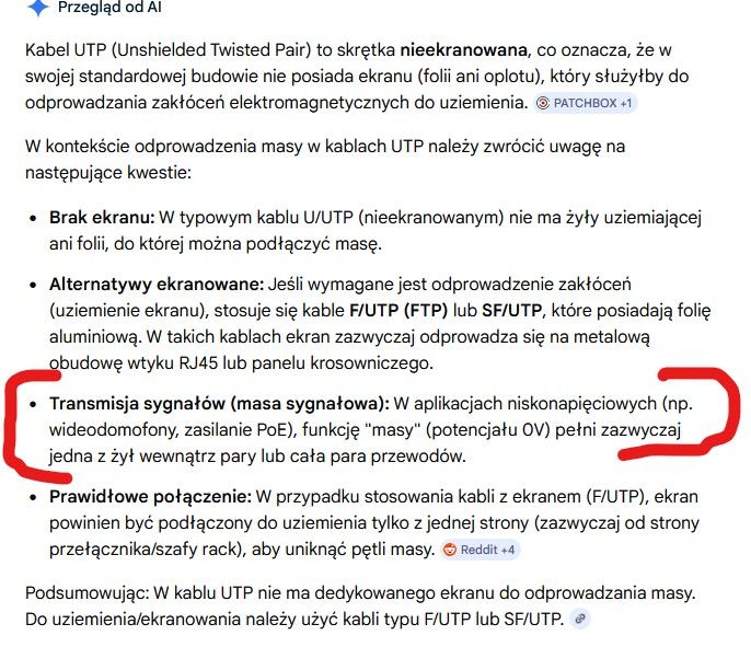

    kula350 wrote:
    the twist creates capacitance along its length and overall, at each point, drains the high pulses to ground.
    And where in the twisted pair do you get the ground? Unfortunately you are mistaken, it works on a completely different principle.
    kula350 wrote:
    Because if something is radiating, I don't put on ferrites that need to be tuned just
    Sorry, WHAT? What kind of tuning? Nothing is tuned (unless a fool), ferrites are made of materials suitable for the frequency. A core from a noise filter in an RF amplifier will behave completely differently.
    kula350 wrote:
    Ground routing is one way of dissipating that interference which passes right through them.
    This is the key! A wrongly routed ground can spoil a good project.

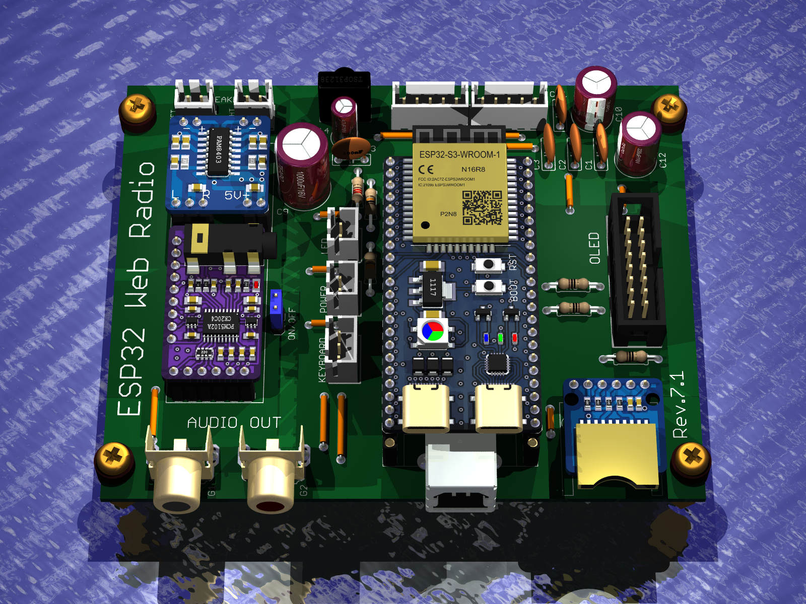

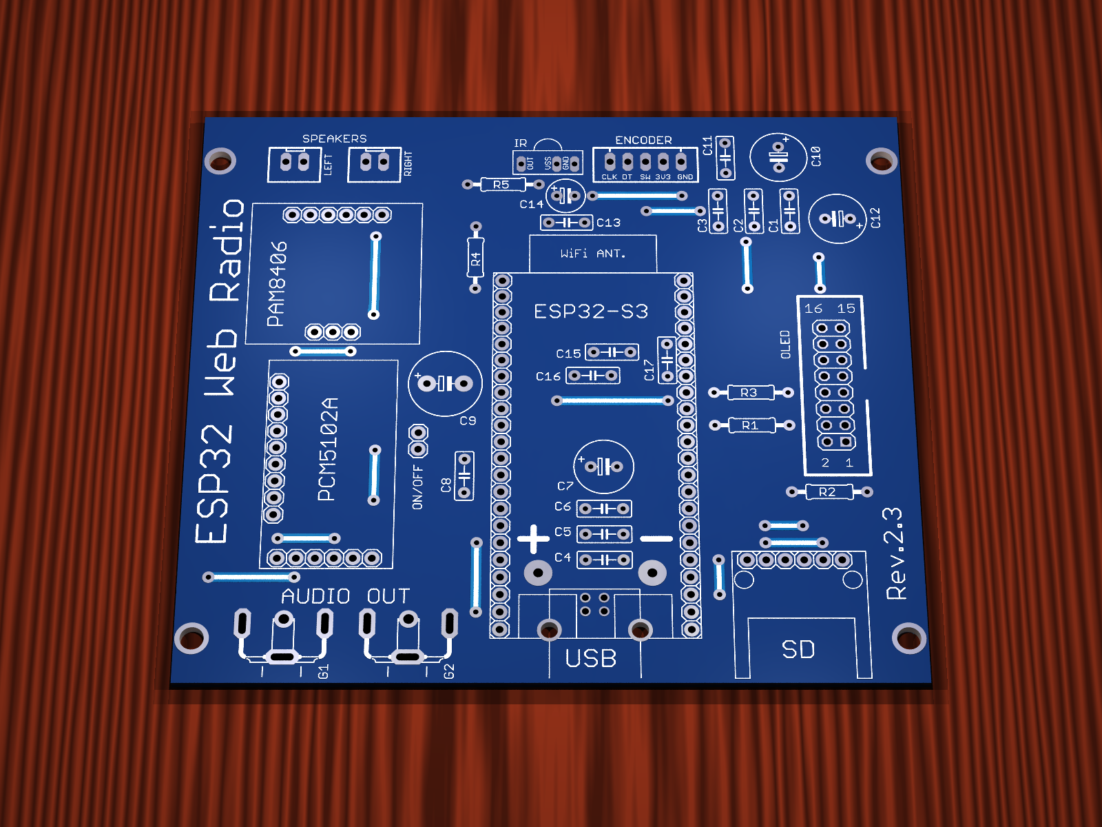

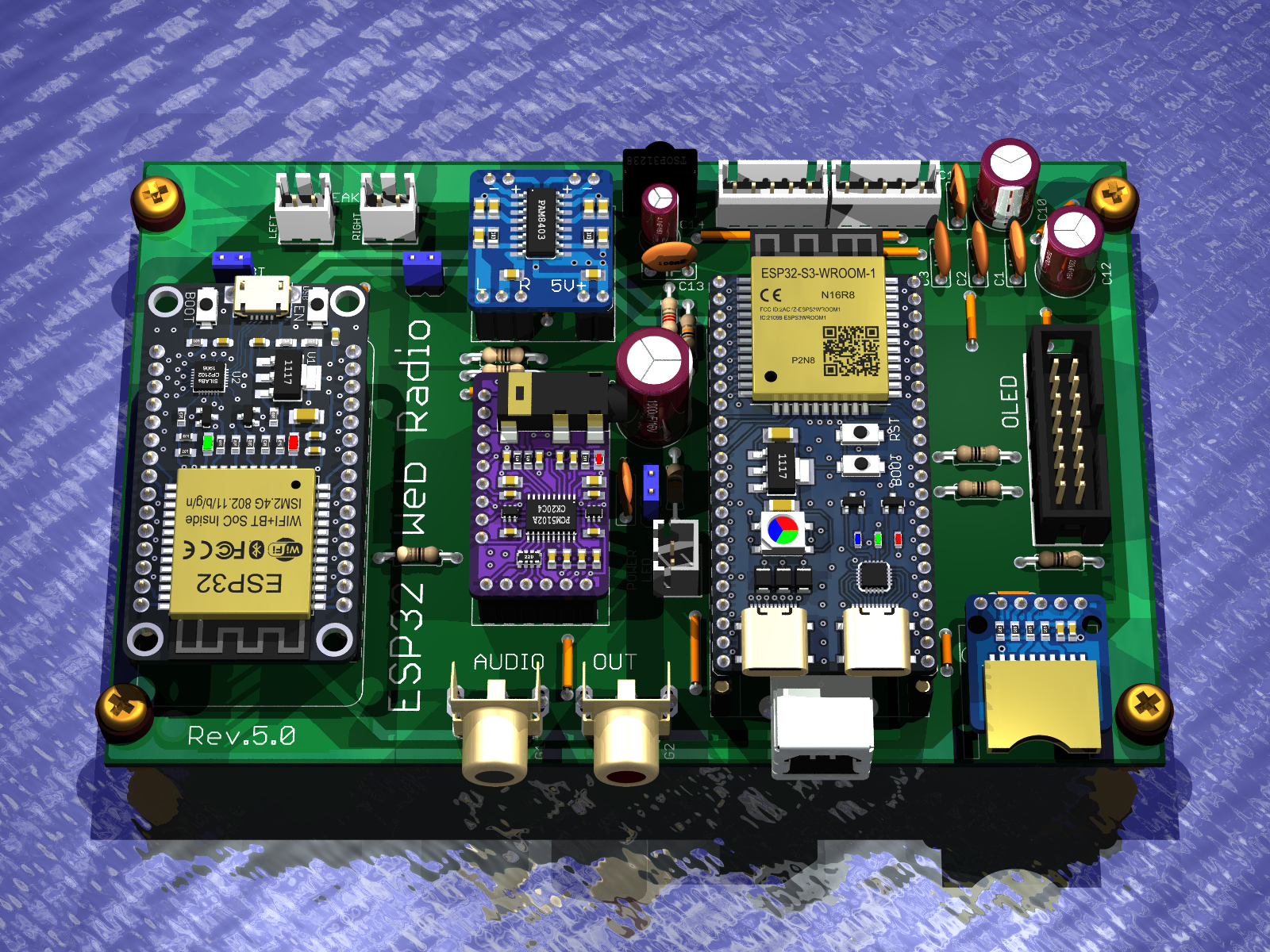

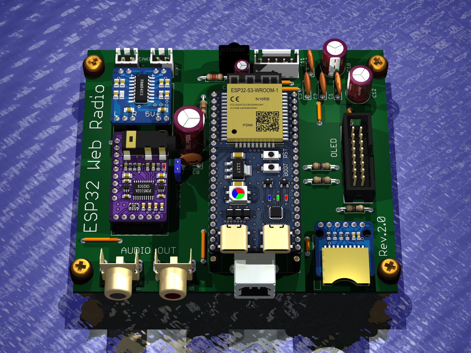

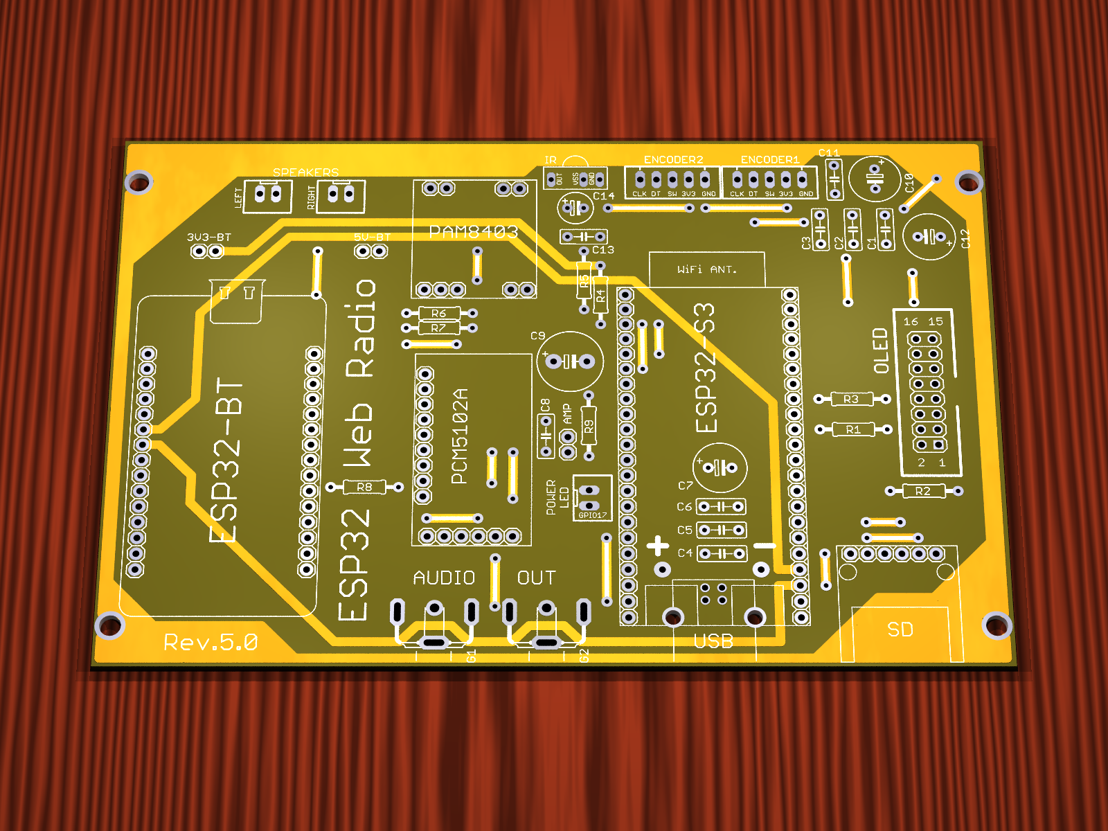

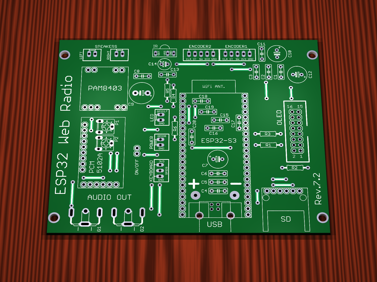

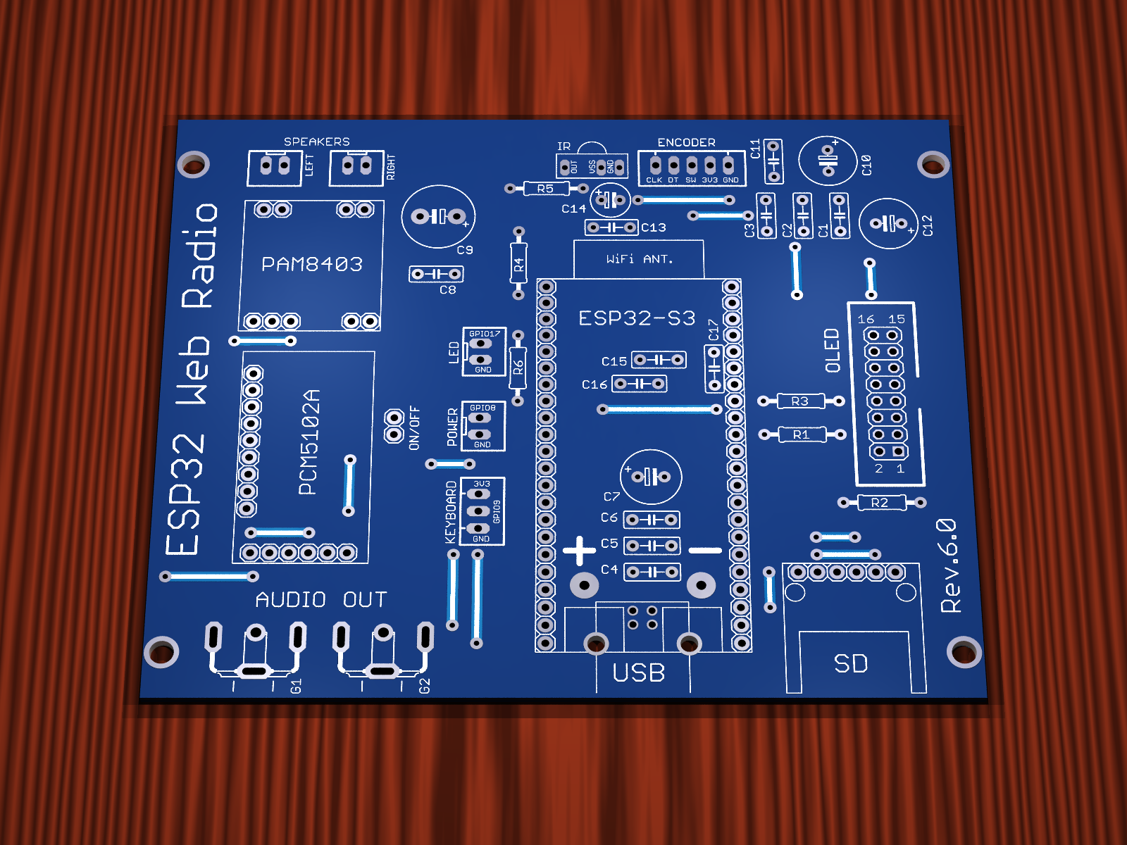

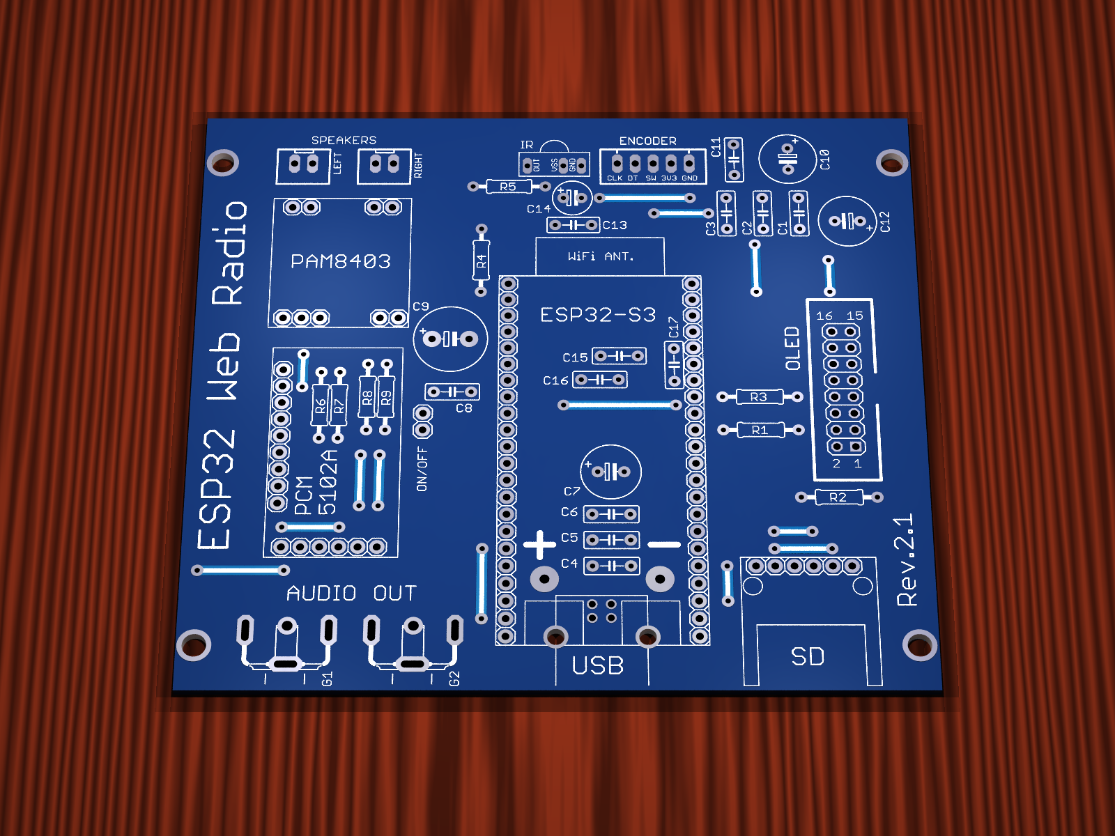

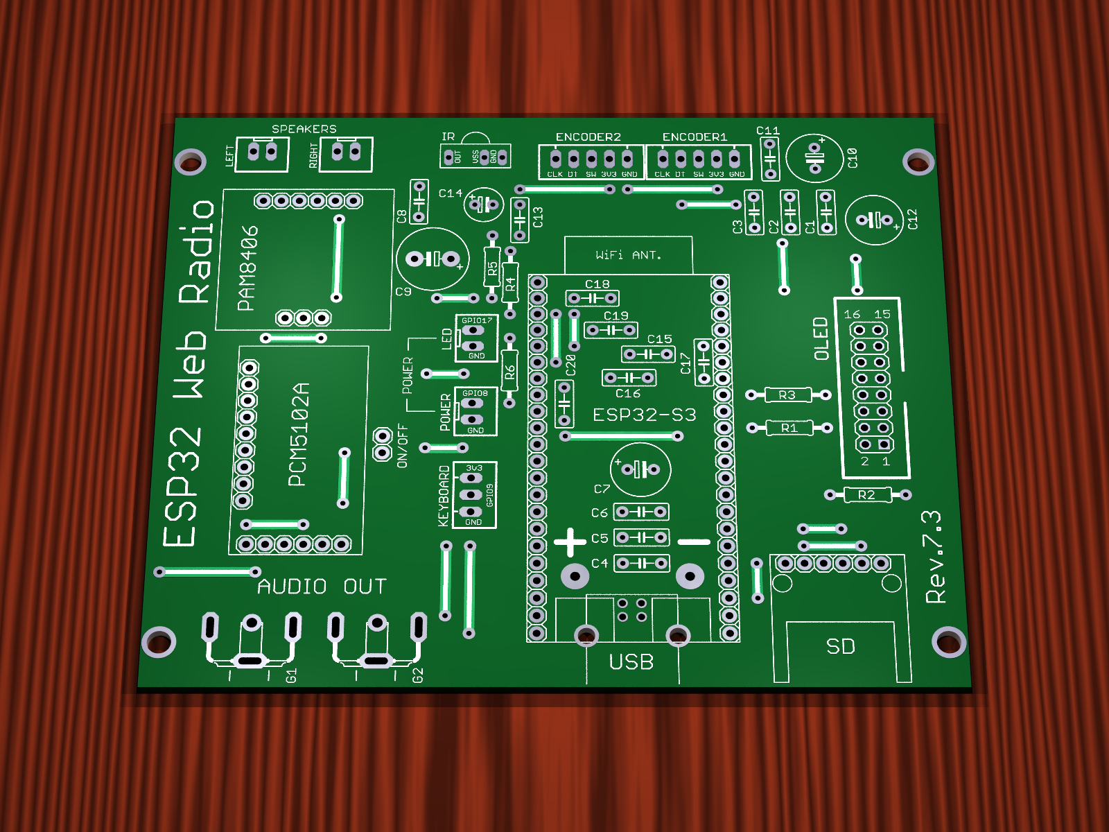

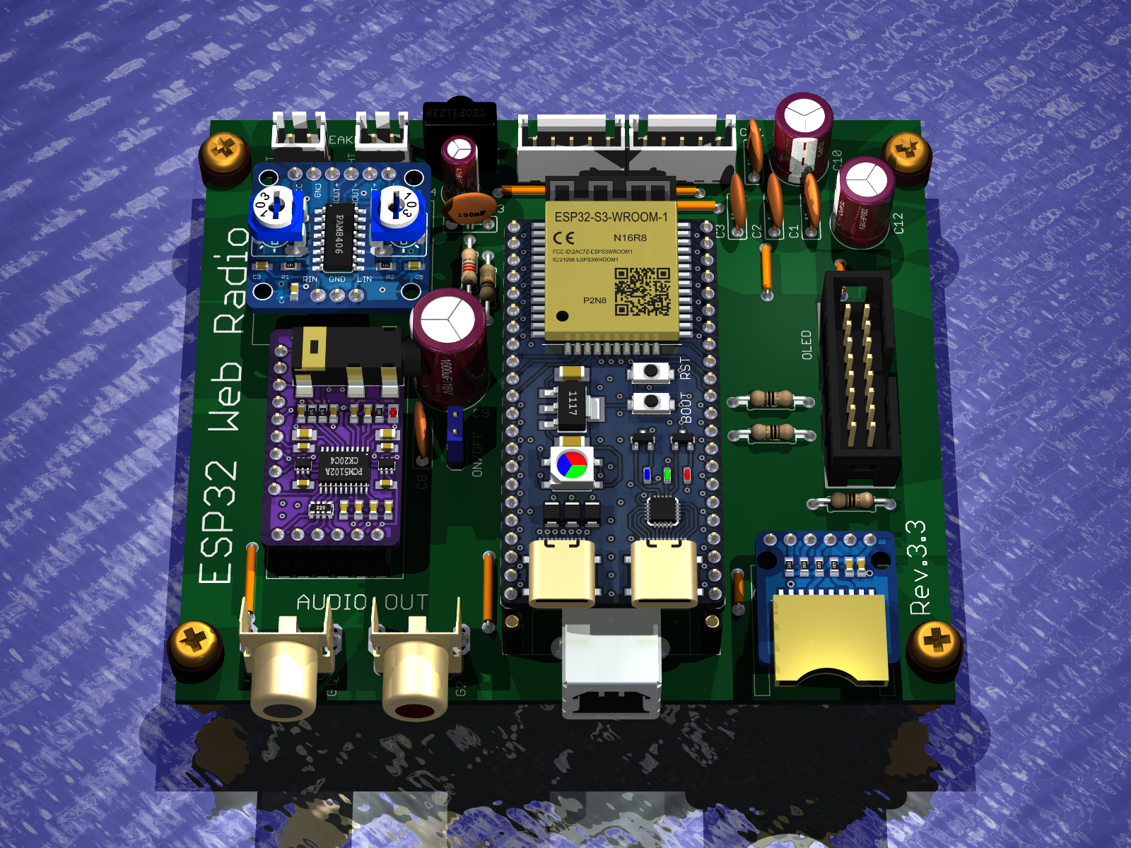

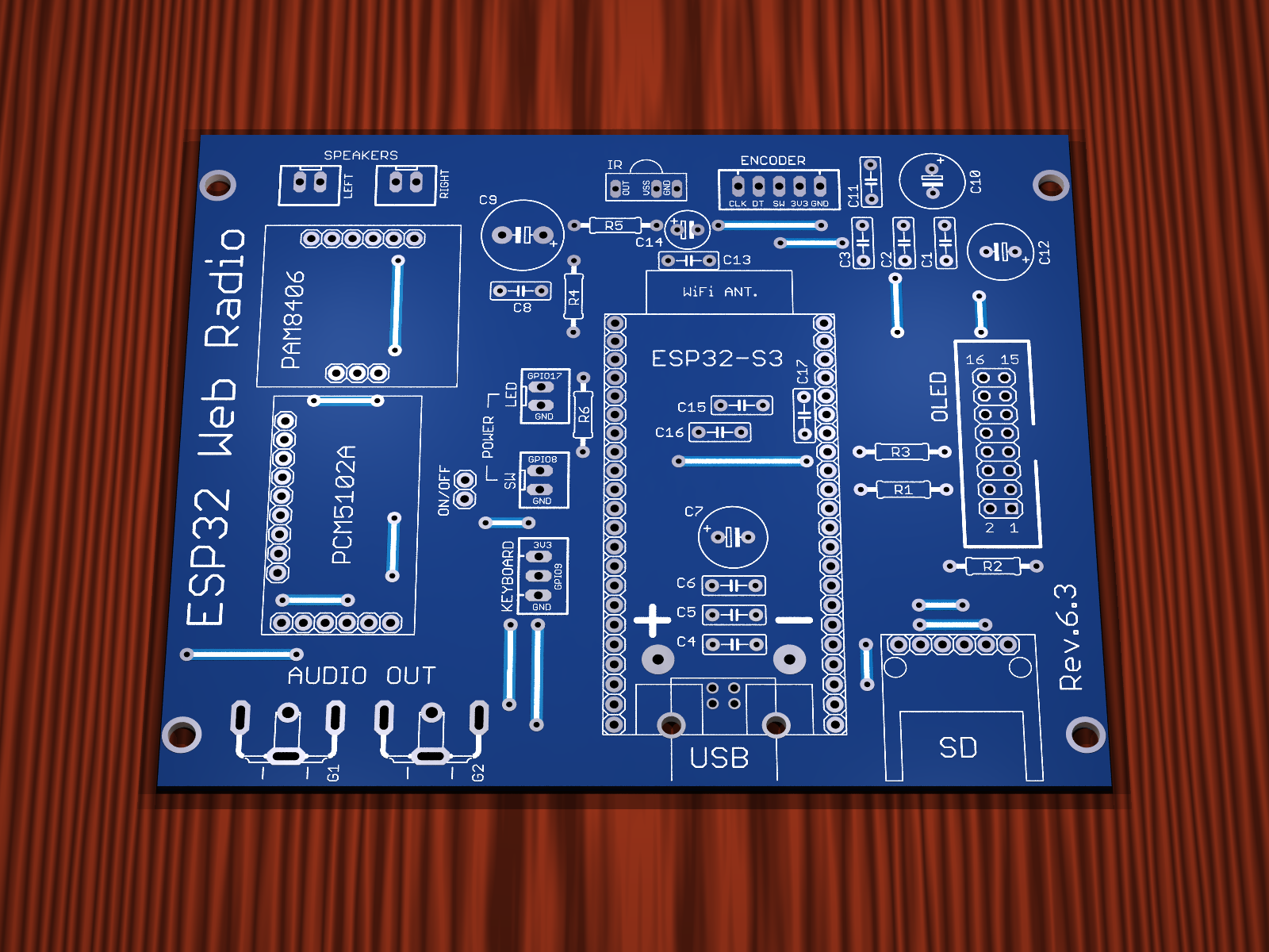

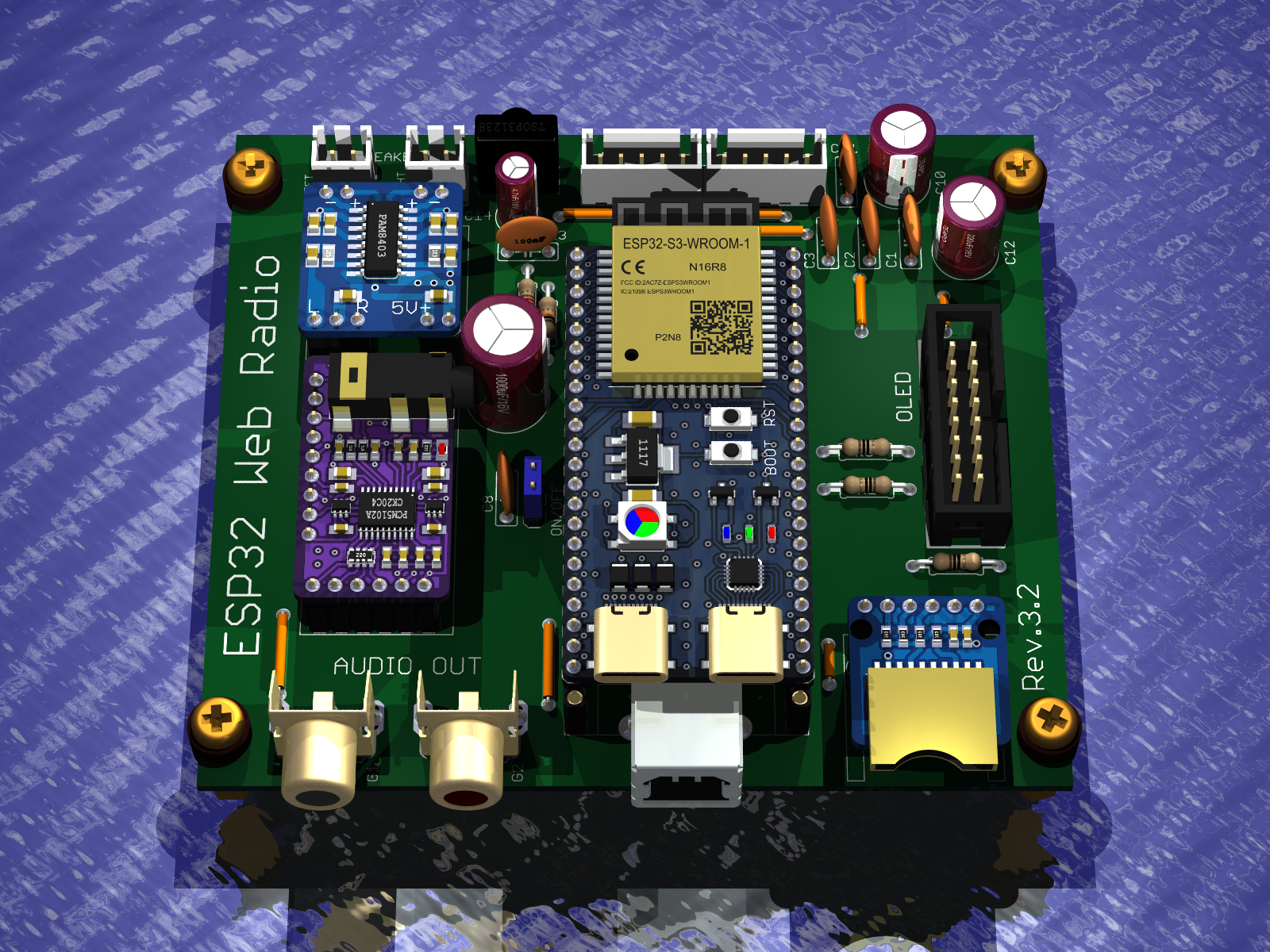

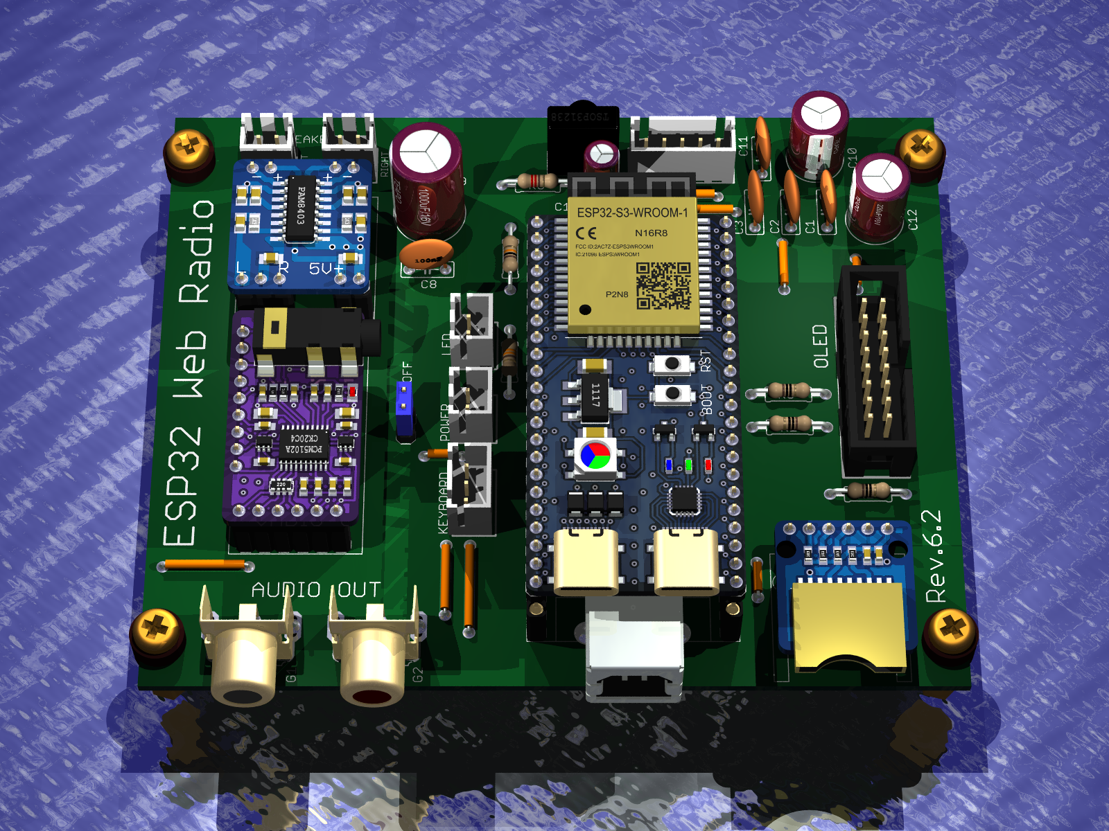

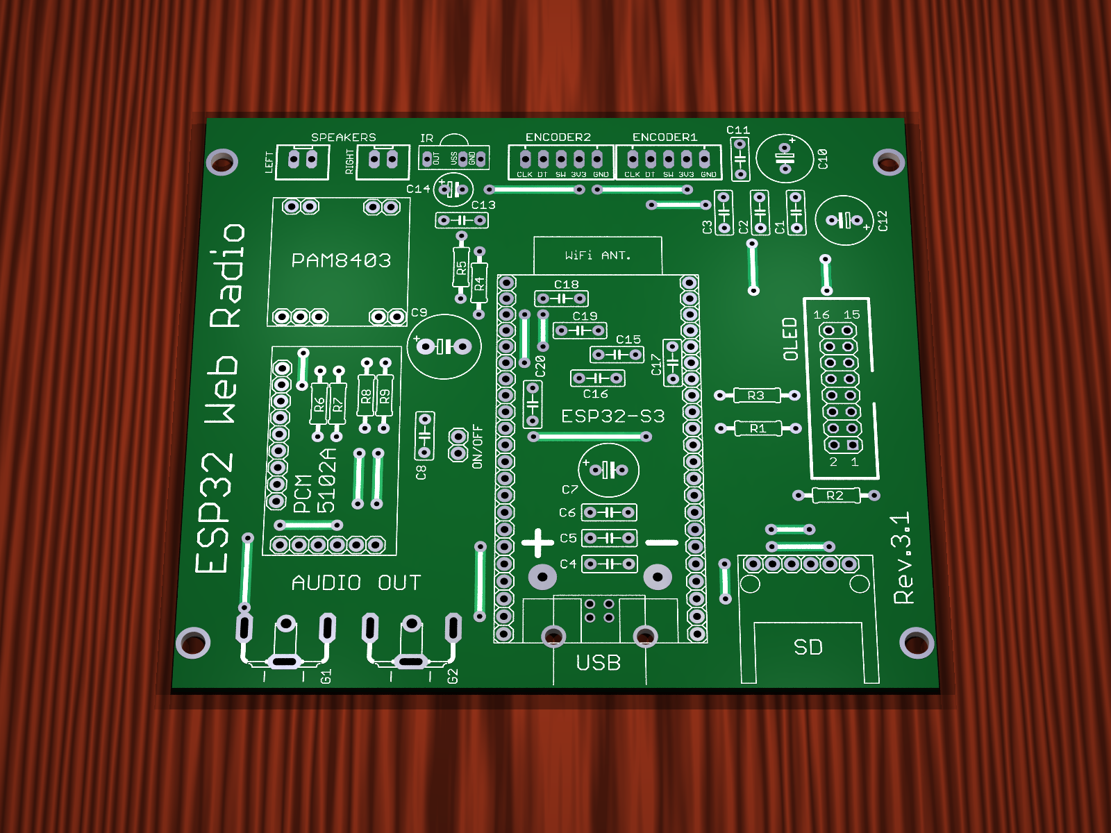

  • PCB revisions with encoder, amplifier, and audio level divider

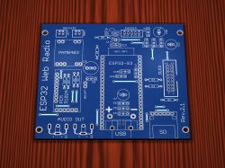

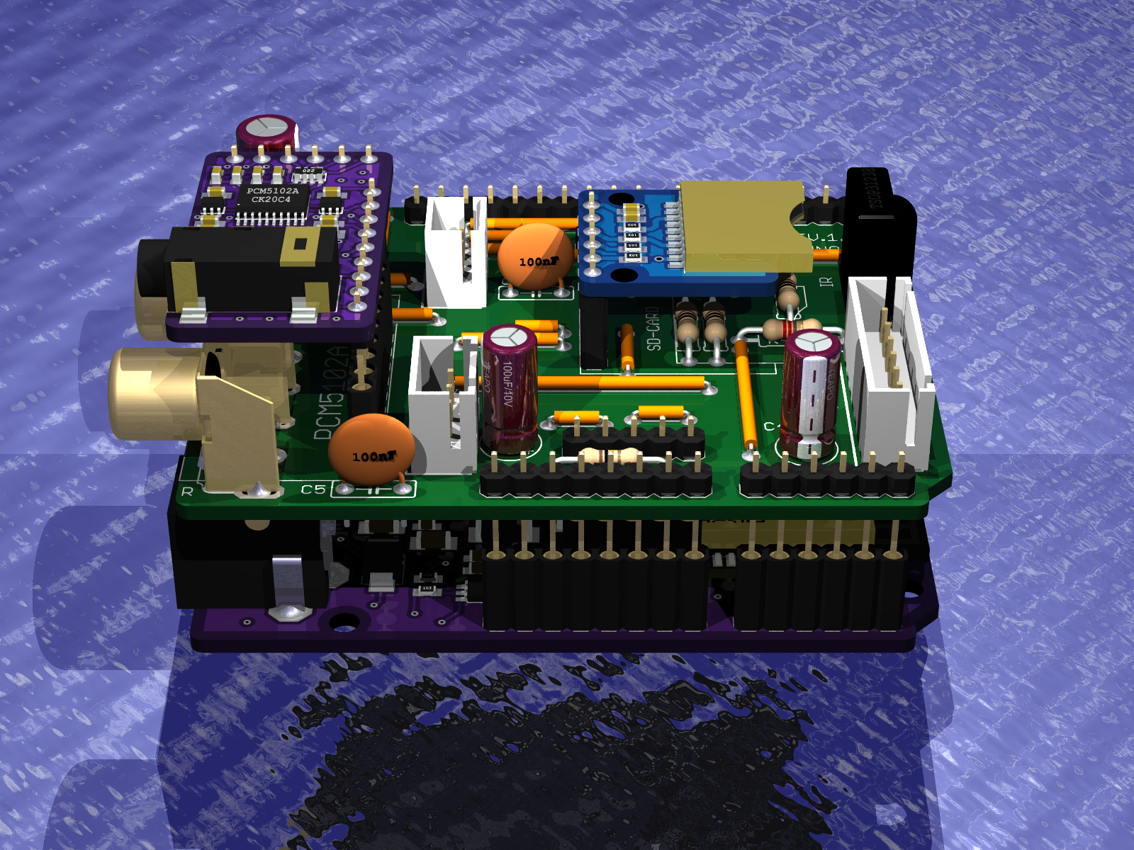

    #2629 21889272
    DJCheester
    Level 28  
    Posts: 2089
    Help: 75
    Rate: 958

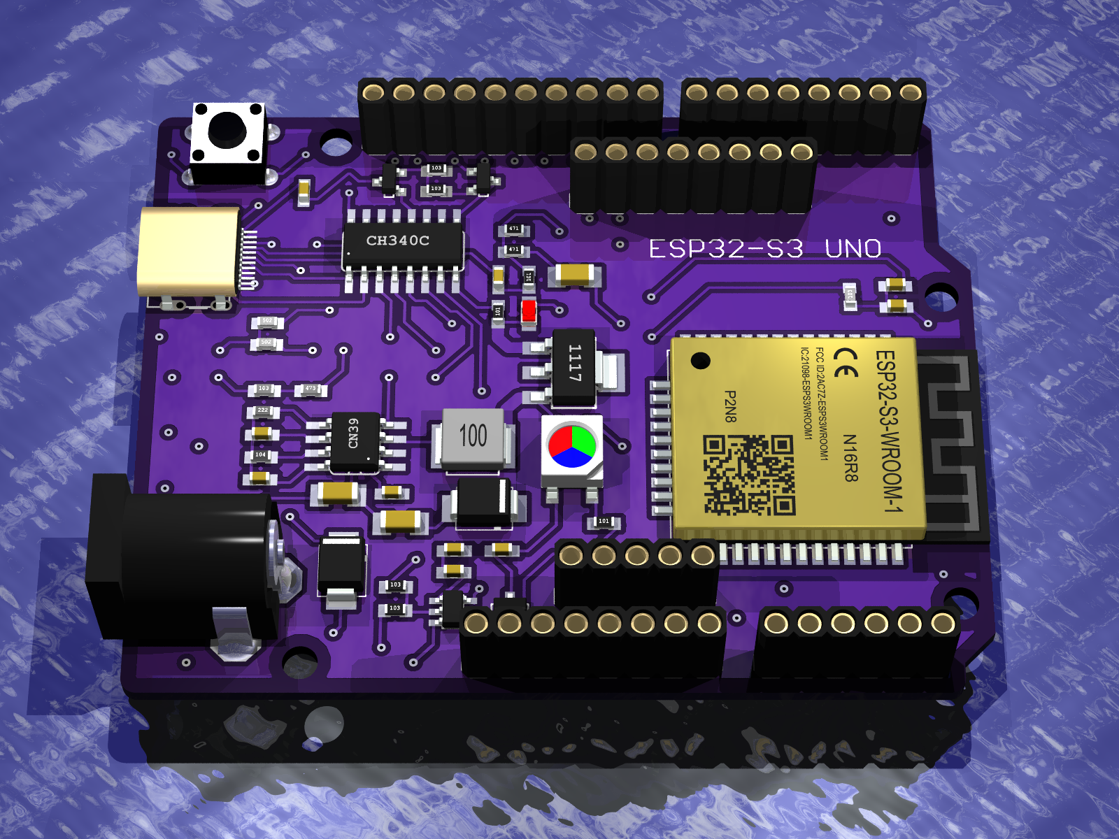

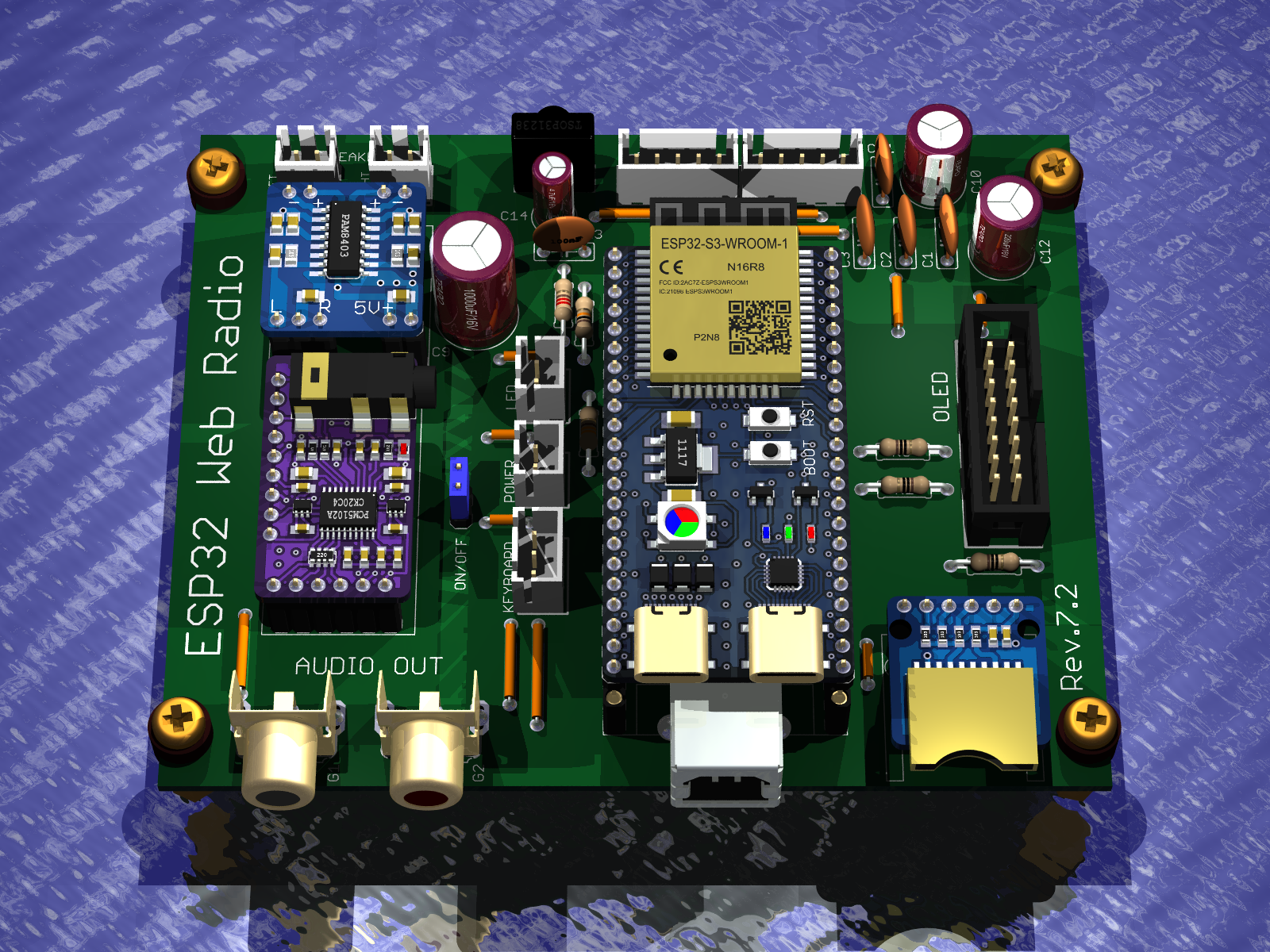

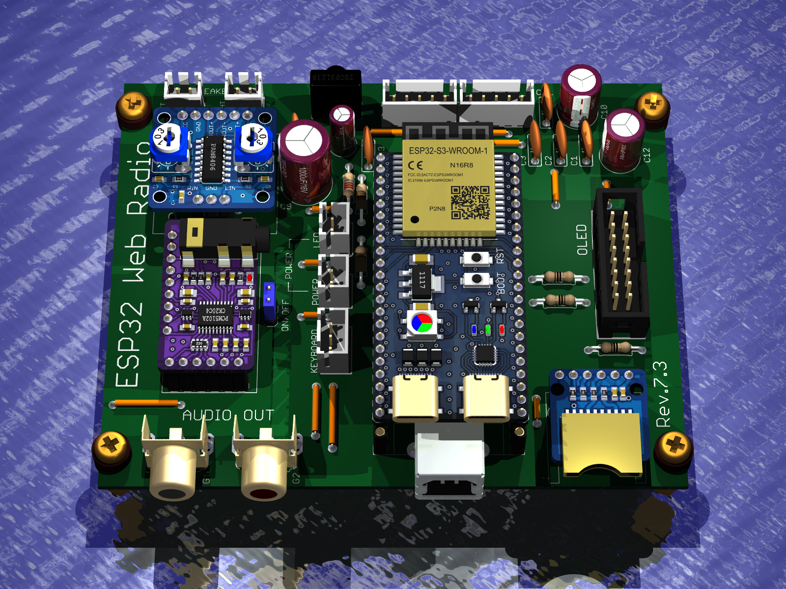

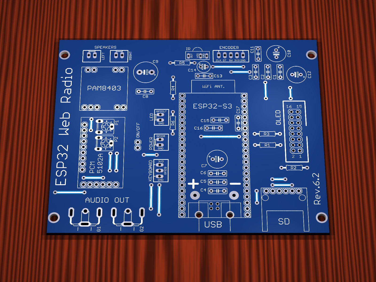

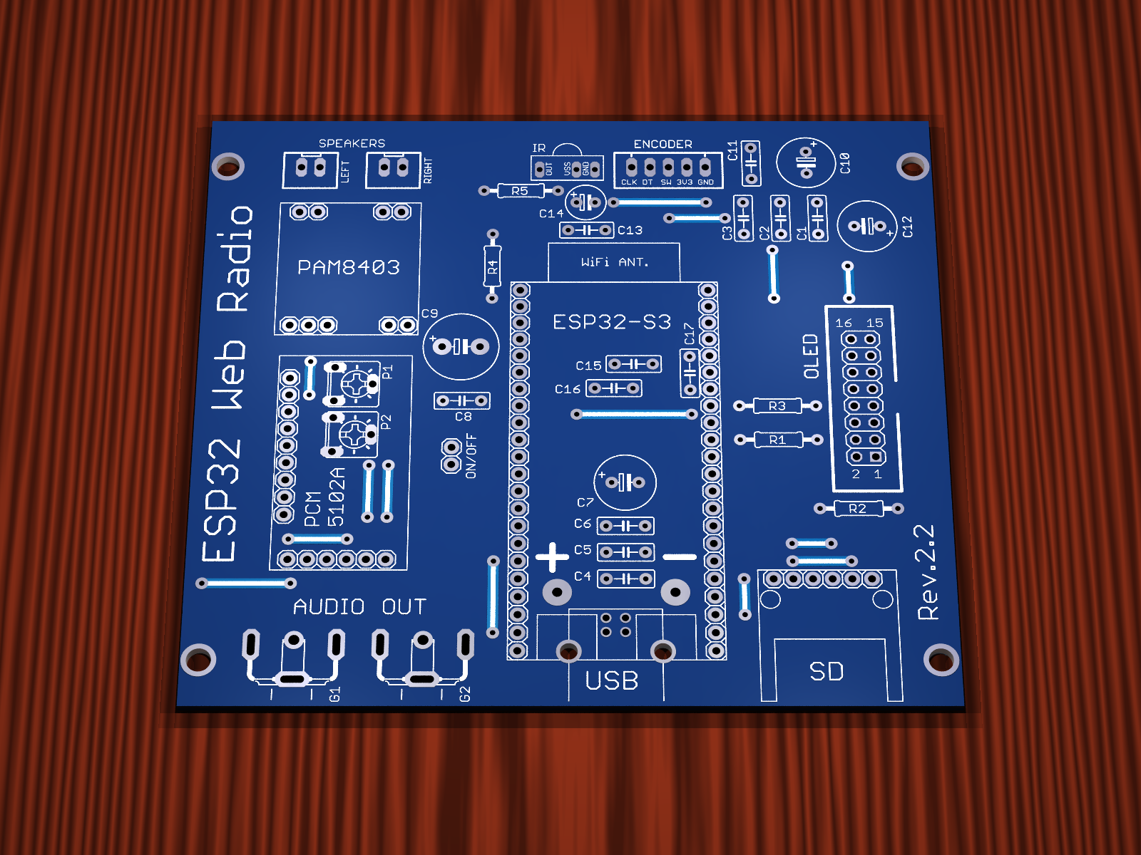

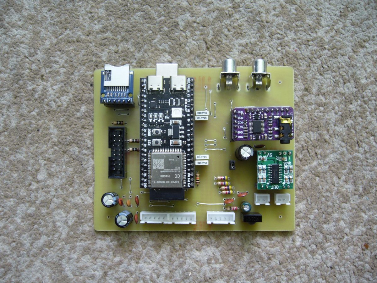

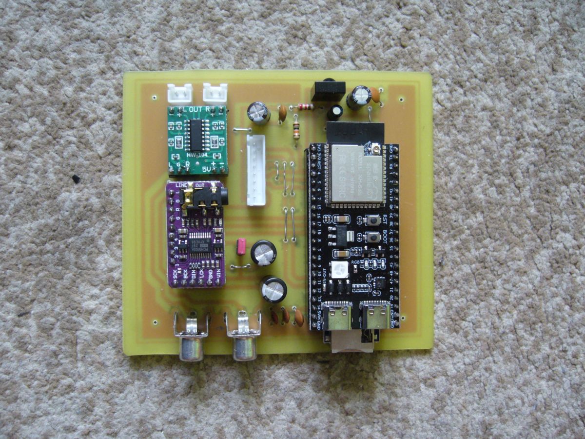

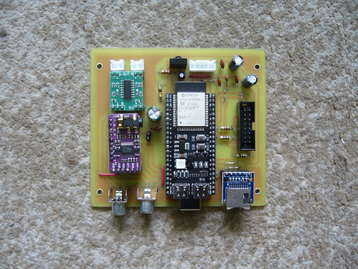

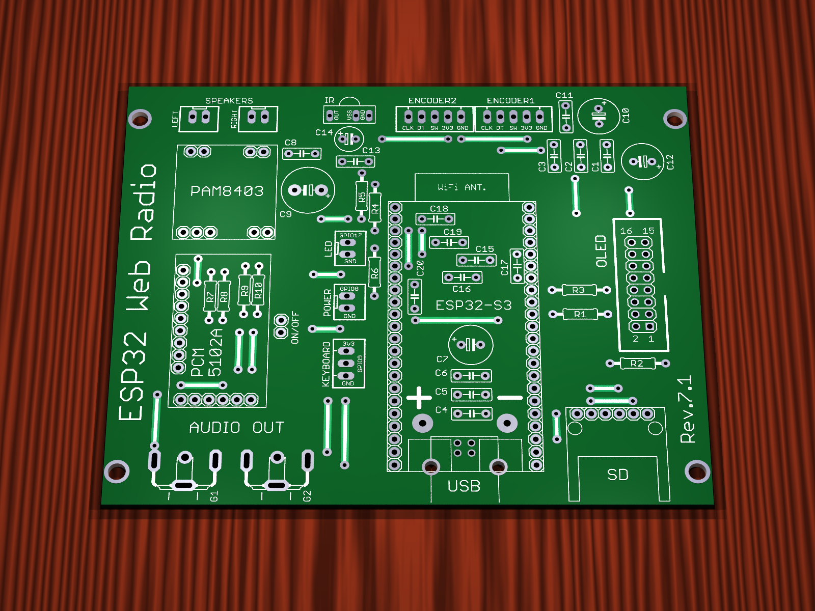

    Hello as a lot of questions about PCBs have come in on priv to me, I am attaching all the PCB versions I have prepared with short descriptions of the versions.
    The summer season is starting so other work takes precedence, so I am making available what I have.
    And yes, briefly the most important information and PCB versions below.
    Here we go ;)

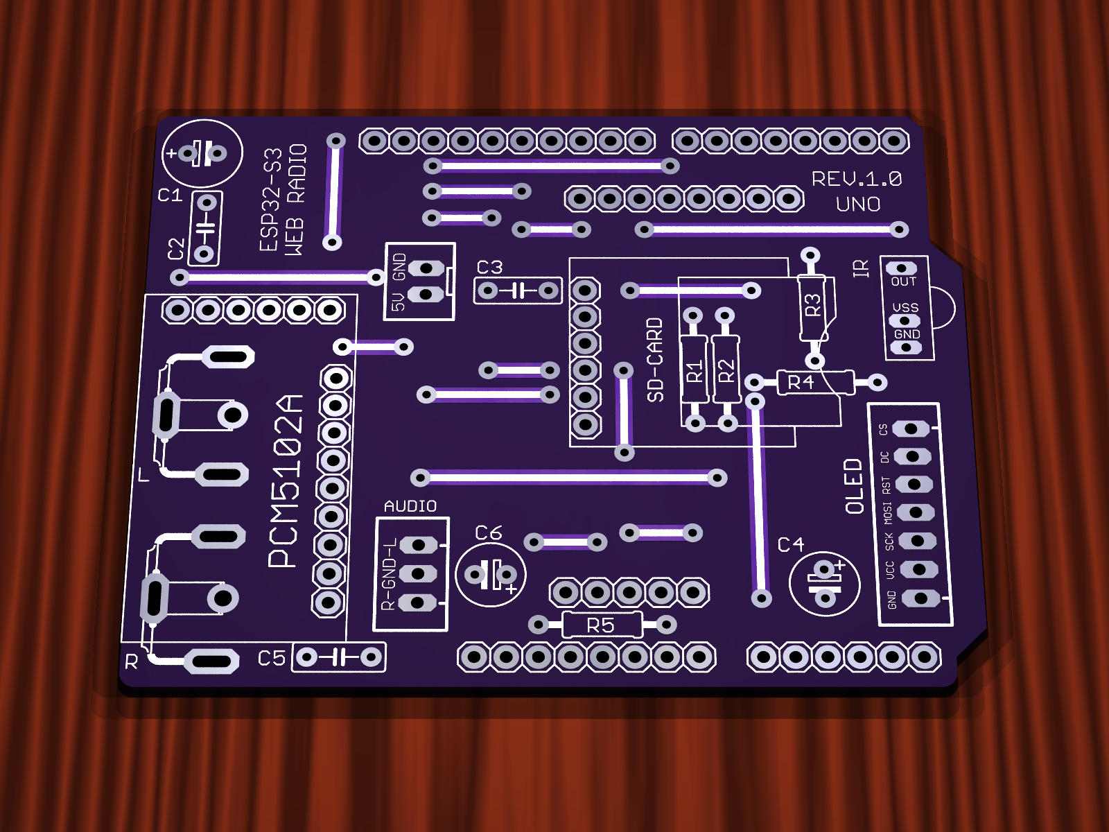

    Version Rev.1.0
    - PCB version without SMD components
    - Jumpers are made on the top layer of the PCB as tracks, so you don't need to assemble them in case of factory PCBs
    - Prepared for ESP32S3 Uno (PCB put on sandwich)
    - No encoder output
    - No audio amplifier
    - Audio output on Chinch sockets
    - TSOP31238 infrared receiver
    - 7-pin connector for OLED display
    - Connector 3-pin - audio output for external amplifier
    - Connector 2-pin - derived 5V power supply for external amplifier
    - Robgold's software upload
    - Dimensions - board size the same as the ESP32S3 UNO board - or Arduino UNO)
    Internet radio and audio file player on ESP32-S3 Internet radio and audio file player on ESP32-S3 Internet radio and audio file player on ESP32-S3

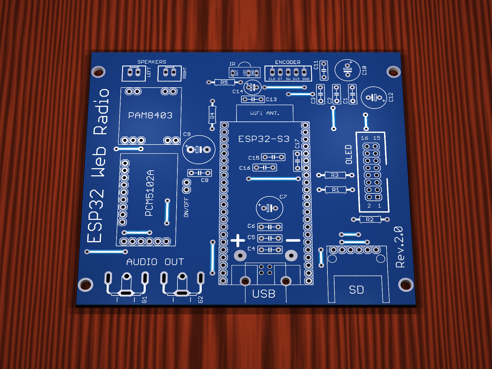

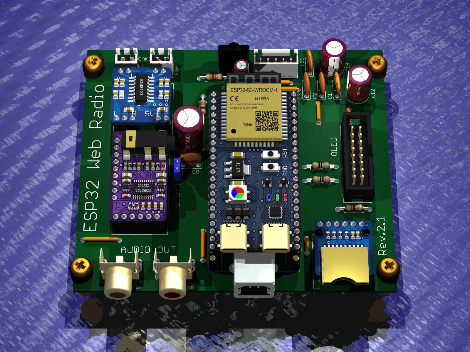

    Version Rev.2.0
    - The jumpers are made on the top layer of the PCB as tracks, so they do not need to be mounted in case of factory PCBs
    - PCB version with one encoder
    - 16-pin connector for OLED display
    - Audio amplifier PAM8403
    - Power supply USB printer socket
    - Robgold col's software upload
    - Dimensions 99.95mm x 88.54mm

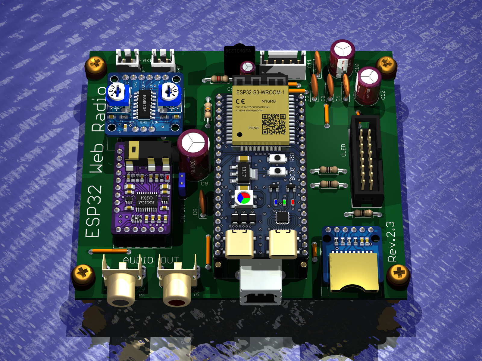

    Version Rev.2.1
    - Everything as in Rev.2.0
    - Added voltage dividers for the audio signal to reduce the audio level at the input of the PAM8403 power amplifier

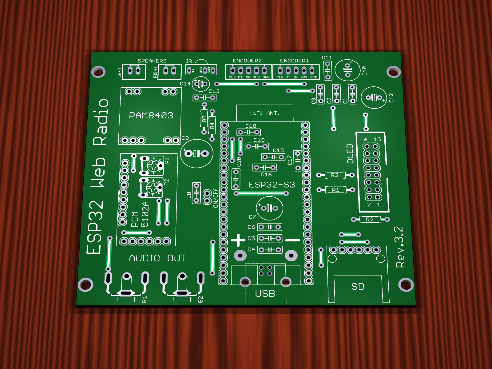

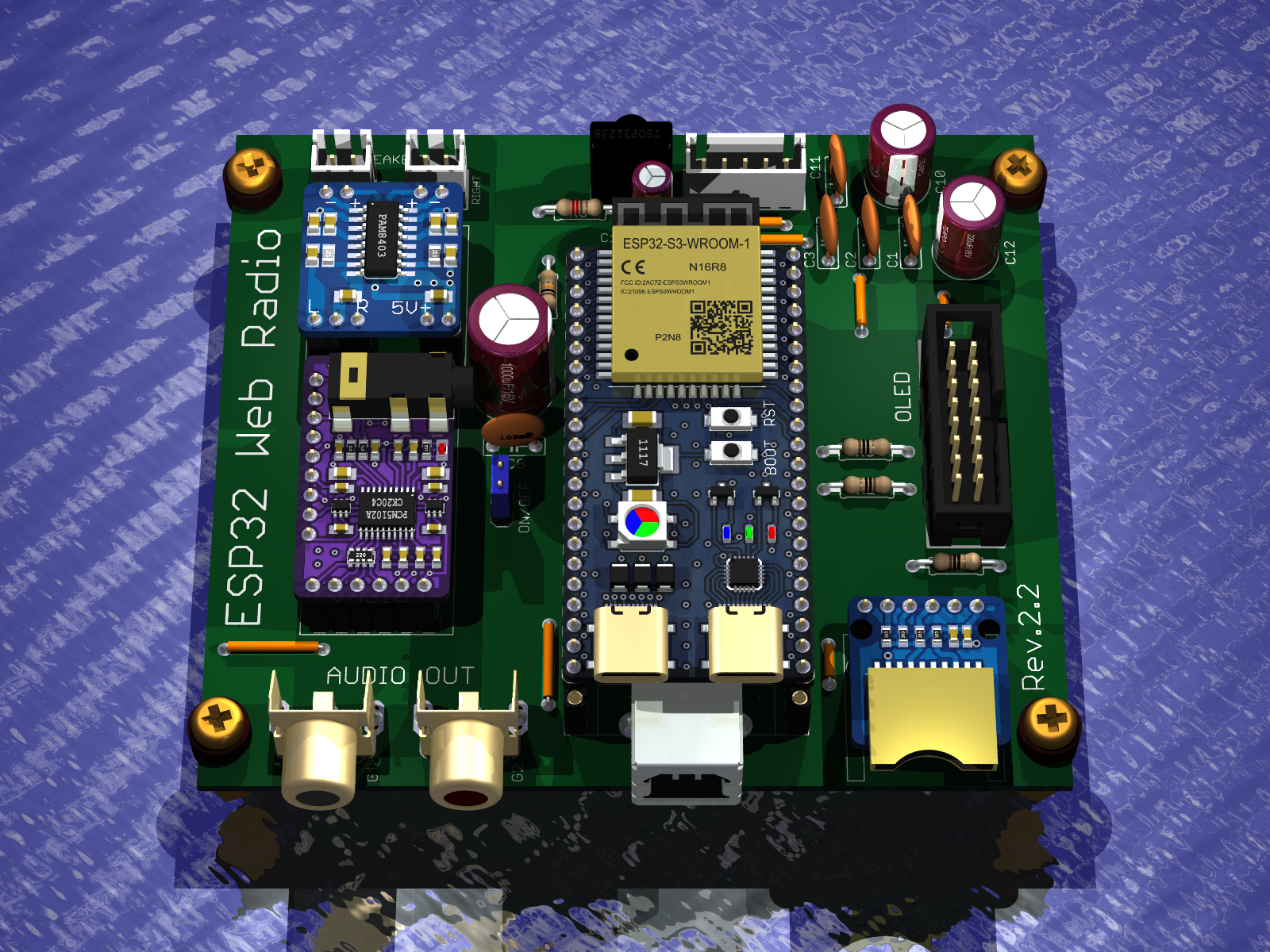

    Version Rev.2.2
    - Added potentiometers for the audio signal to adjust the audio level at the input of the PAM8403 power amplifier
    Version Rev.2.3
    - Power amplifier has been changed, PAM8403 has been removed and PAM8406 amplifier module has been used

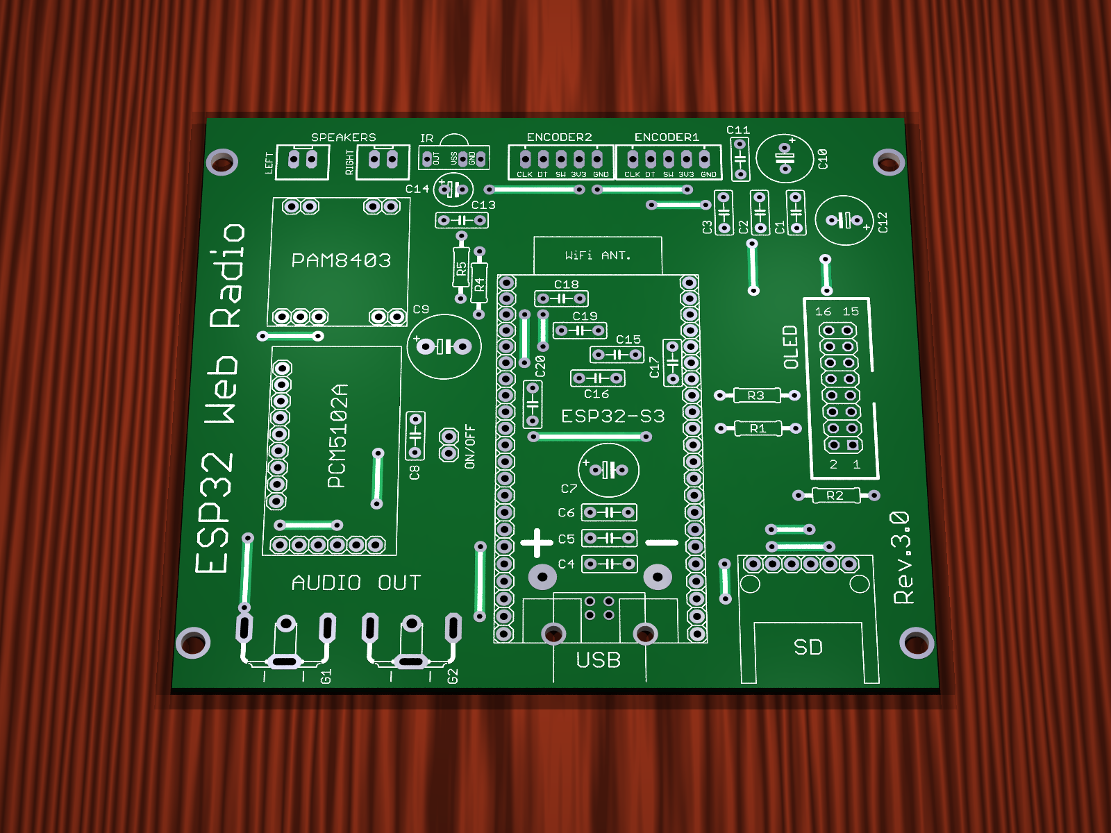

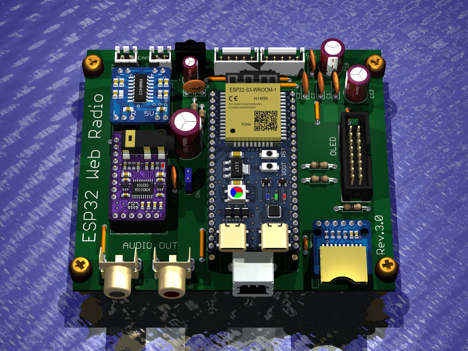

    Version Rev.3.0
    - Jumpers are made on the top layer of the PCB as tracks, so they do not need to be mounted in case of factory PCBs
    - PCB version with two encoders

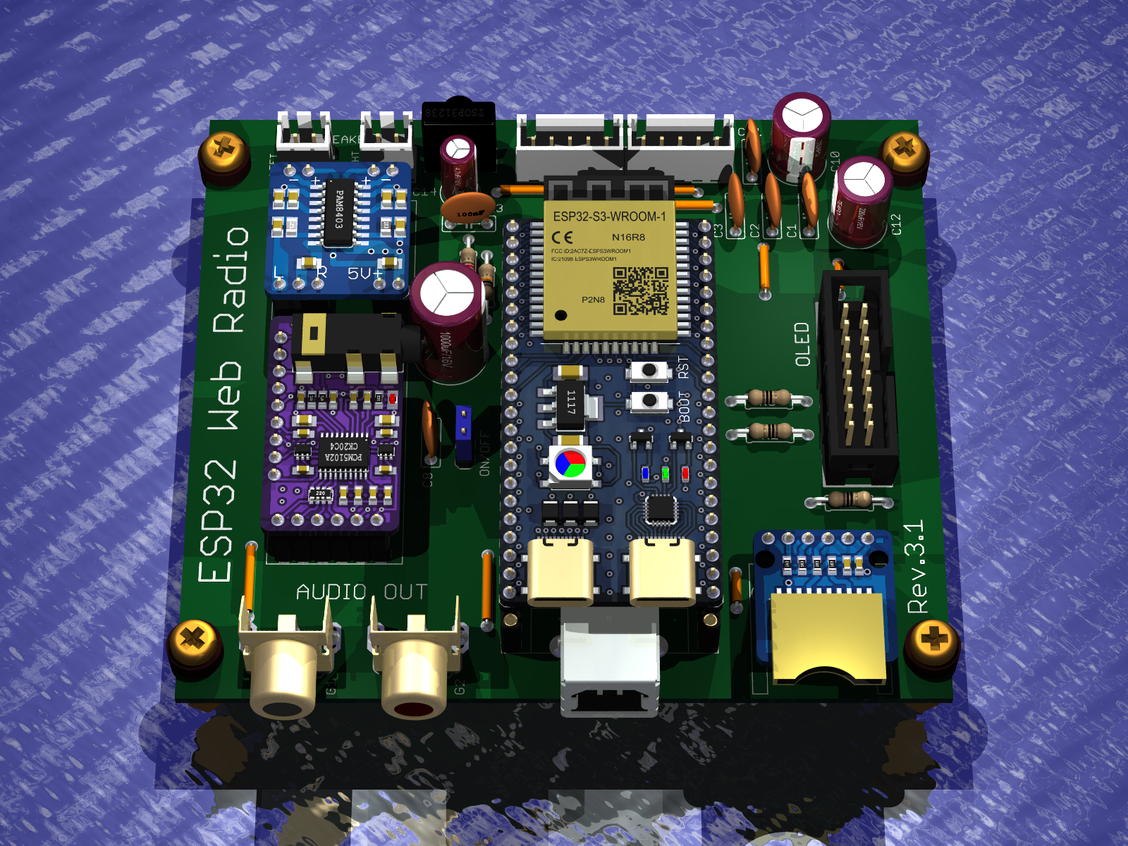

    Version Rev.3.1
    - Everything as in Rev.3.0
    - Added voltage dividers for audio signal to reduce audio input level power amplifier PAM8403
    Version Rev.3.2

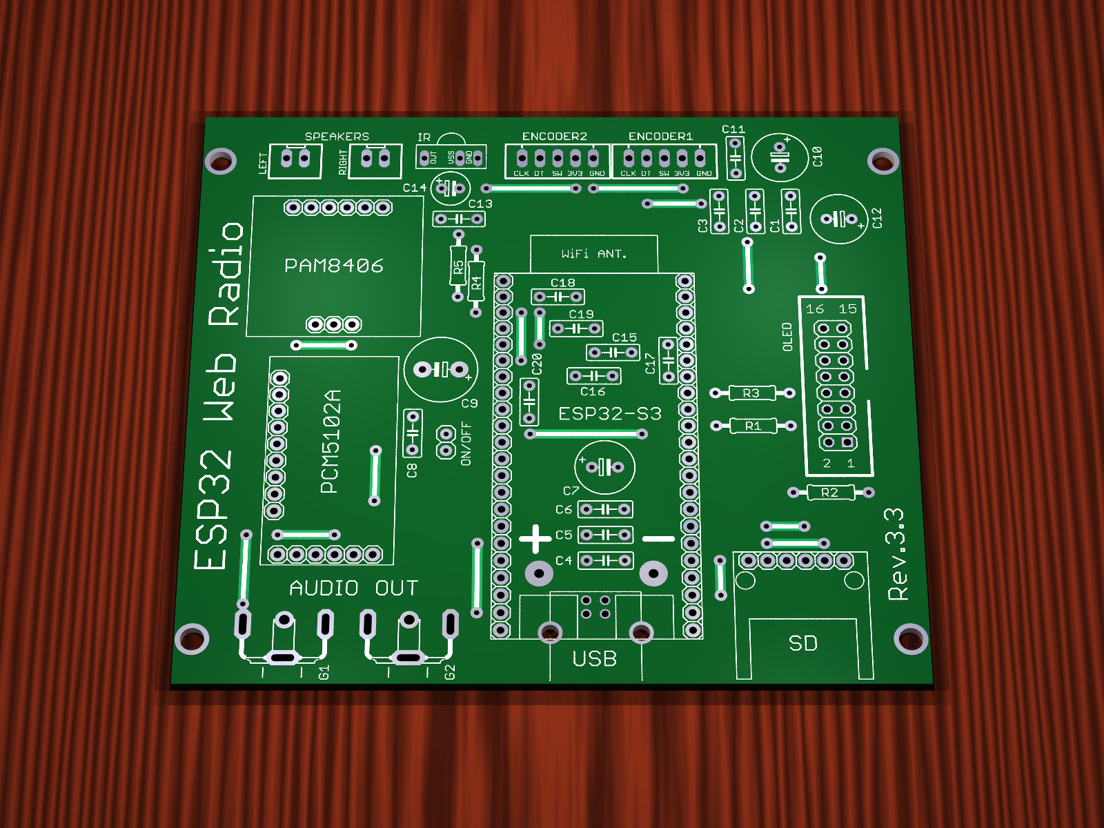

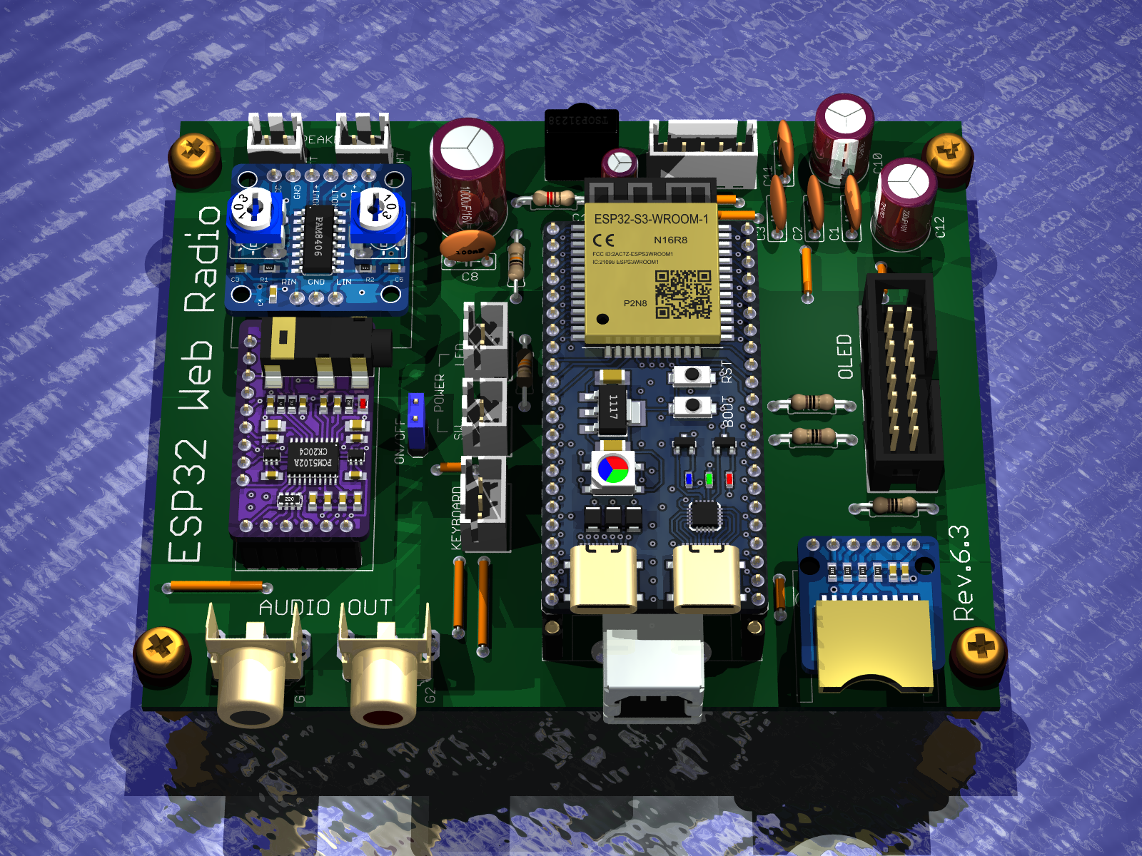

    Version Rev.3.3

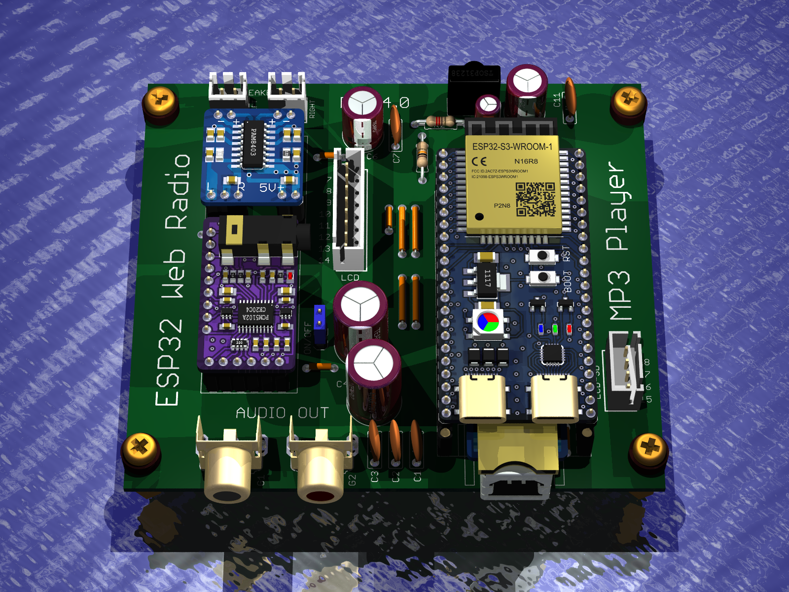

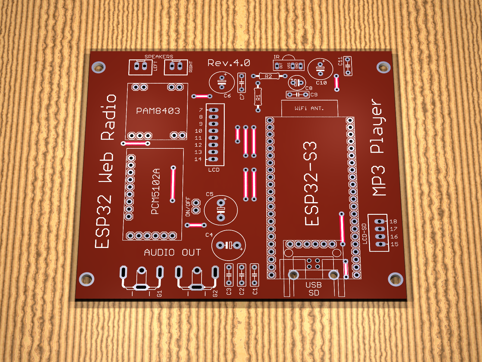

    Version Rev.4.0
    - The jumpers are made on the top layer of the PCB as tracks, so they do not need to be mounted on the factory PCBs
    - PCB version without encoders
    - Connector 8-pin for LCD display
    - 4-pin connector for SD card reader on display
    - Note: Do not use two card readers at the same time !!!
    - MAJSTER XXL software preload
    - Dimensions 98.04mm x 87.25mm
    Version Rev.5.0
    - Version contains two ESP32 modules the second one for BT transmission
    - Uploaded soft by kol Ejcon (mod of original soft by kol Robgold)
    - Dimensions 135.26mm x 88.27mm

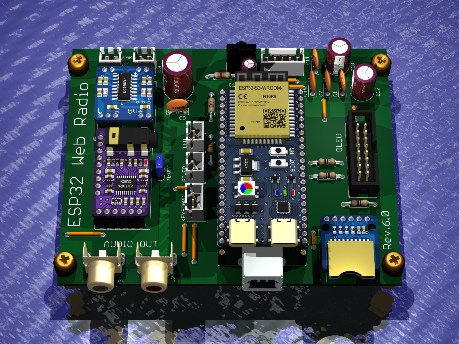

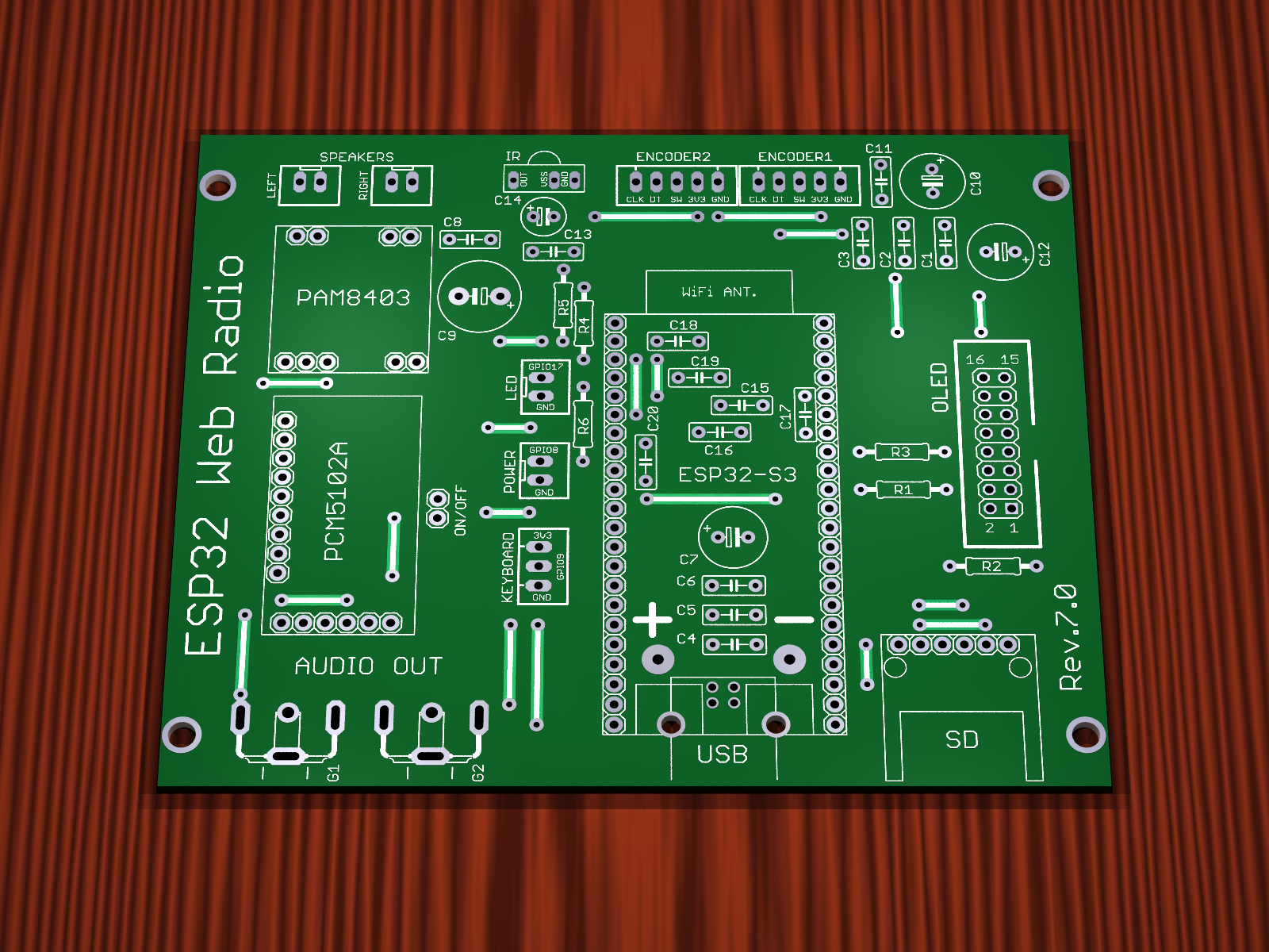

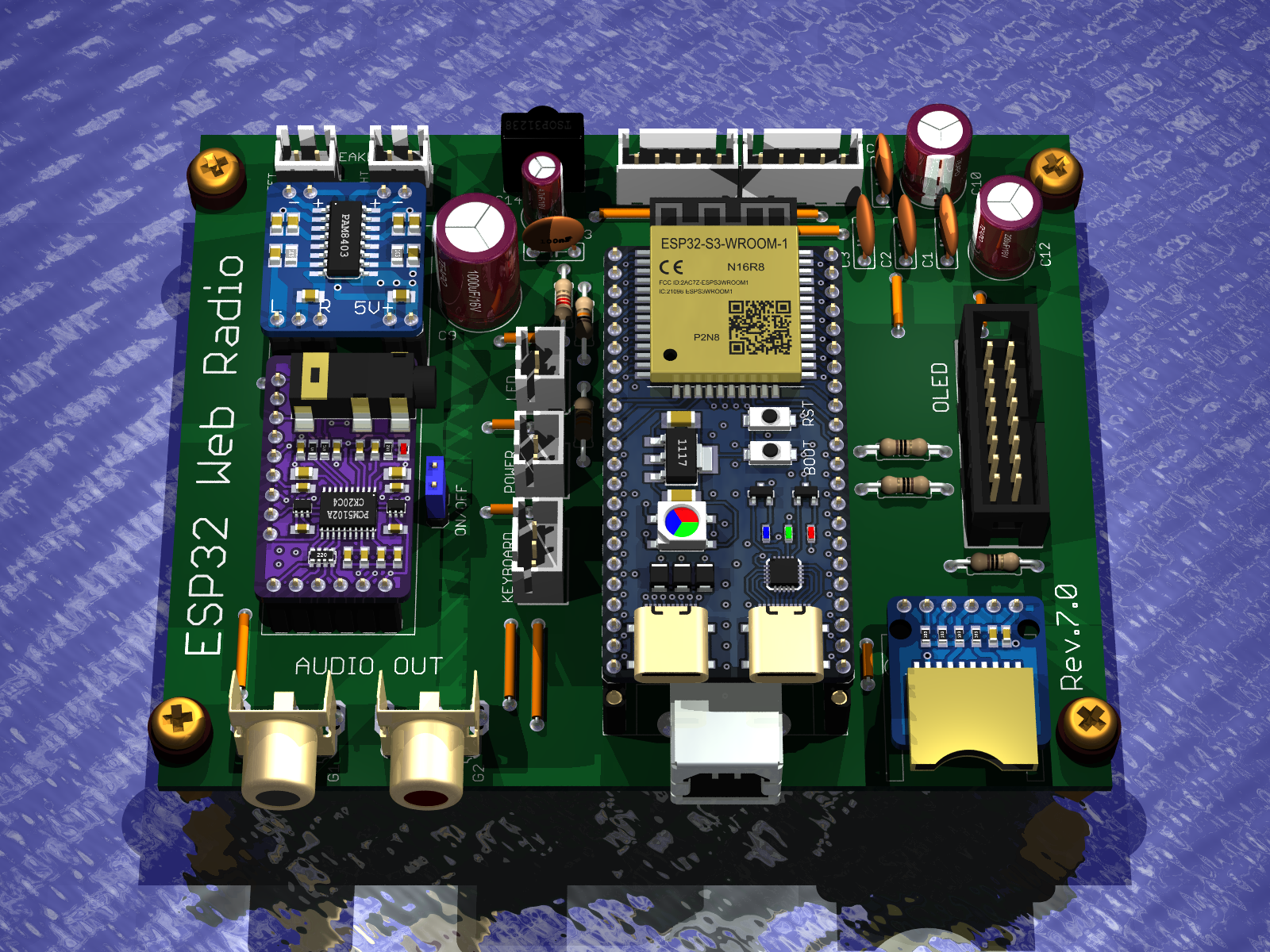

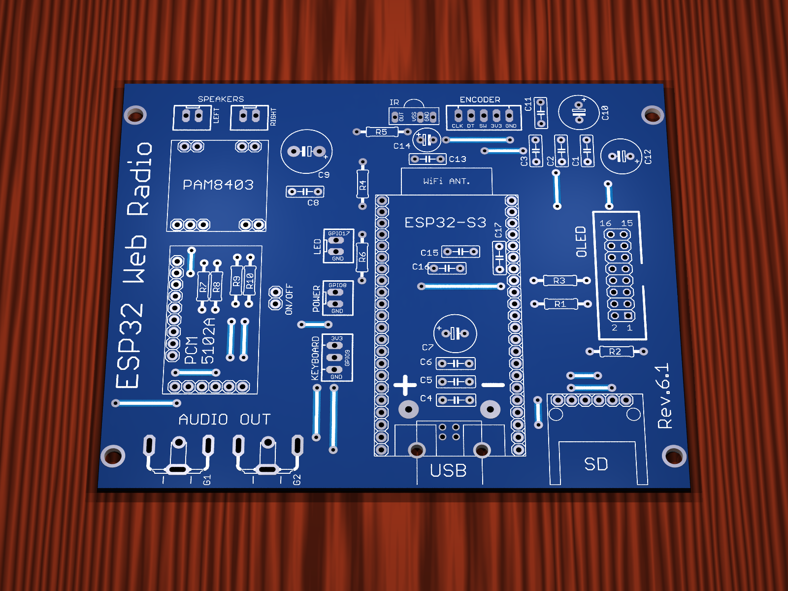

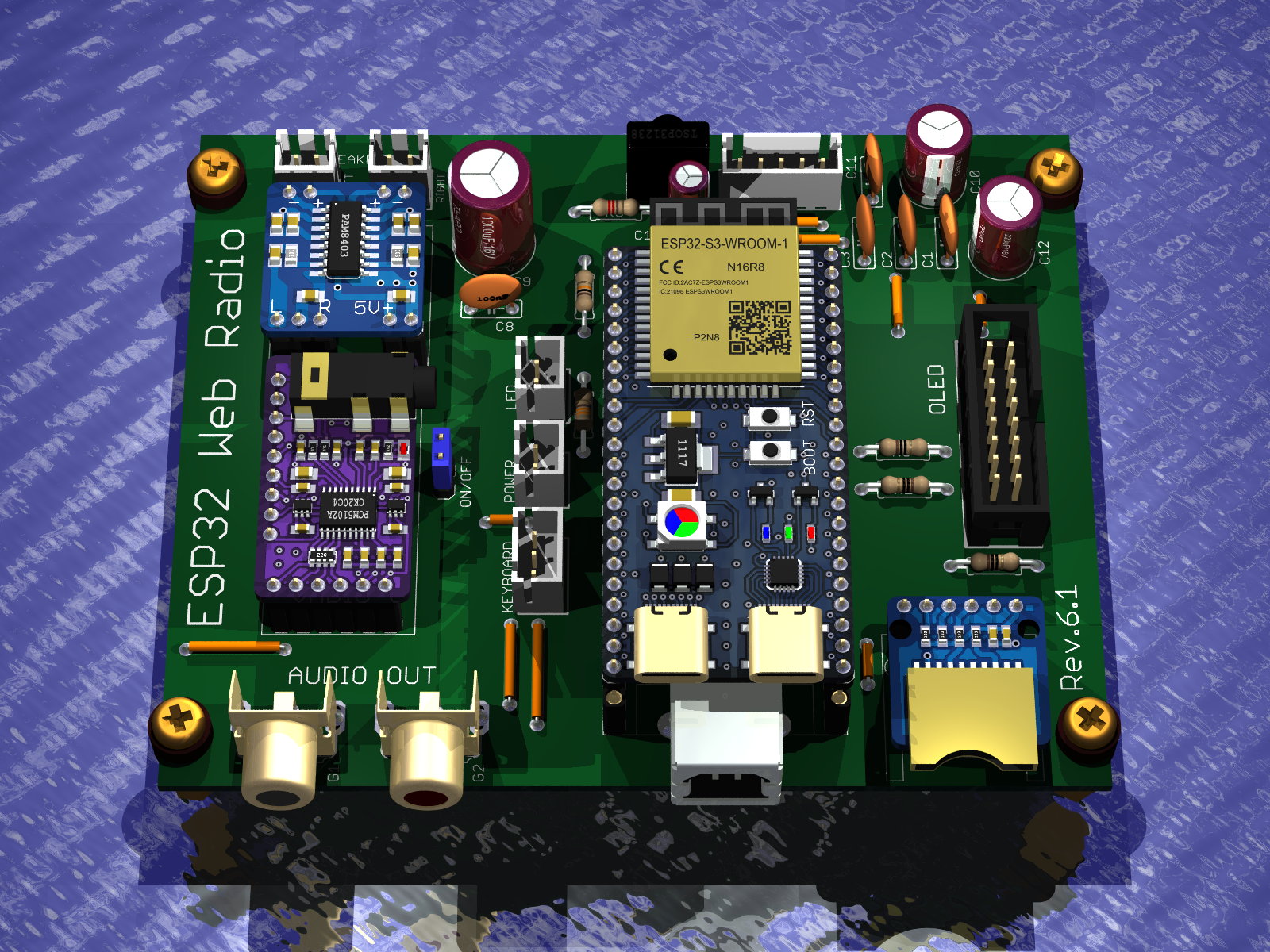

    Version Rev.6.0
    - Connector 2-pin for POWER LED
    - Connector 2-pin for POWER button
    - Connector 3-pin for ADC keyboard connection
    - Robgold software upload
    - Dimensions 108.84mm x 88.54mm

    Version Rev.6.2
    - Everything as in Rev.6.0
    Version Rev.6.3
    - Power amplifier has been replaced PAM8403 has been removed and PAM8406 amplifier module has been used
    Version Rev.7.0
    Version Rev.7.1
    - Everything as in Rev.7.0
    Internet radio and audio file player on ESP32-S3 3D render of “ESP32 Web Radio” PCB with ESP32-S3 module, OLED header, and RCA audio outputs
    Version Rev.7.2
    Version Rev.7.3
    That would be the gerber files in the bulk archive attached.
    Personally at my place I have the PCB versions Rev.1.0, Rev.2.0, Rev.3.0, Rev.4.0 running
    The other versions were created for the needs of electrode users, I did not personally assemble these versions.
    In all versions I included Eagle *.brd files
    No schematics, i.e. *.sch files, because when creating PCBs I work directly on *.brd files.
    Lists of elements for a given version are added in the form of an HTML file opened with a browser.
    Regards ....
    • ESP32 WebRadio PCB.zip (113.63 MB) You must be logged in to download this attachment.

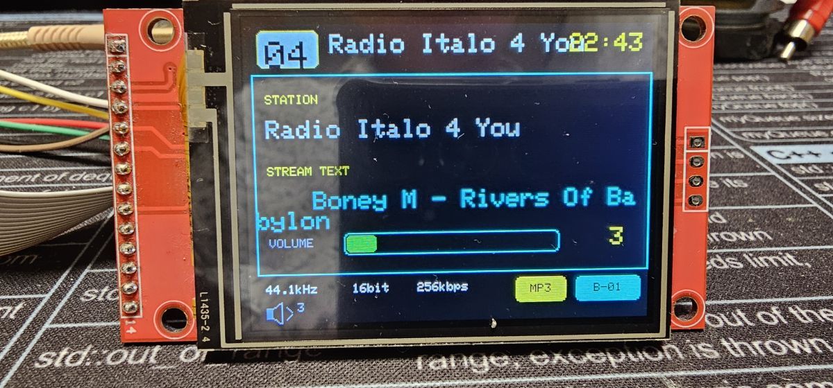

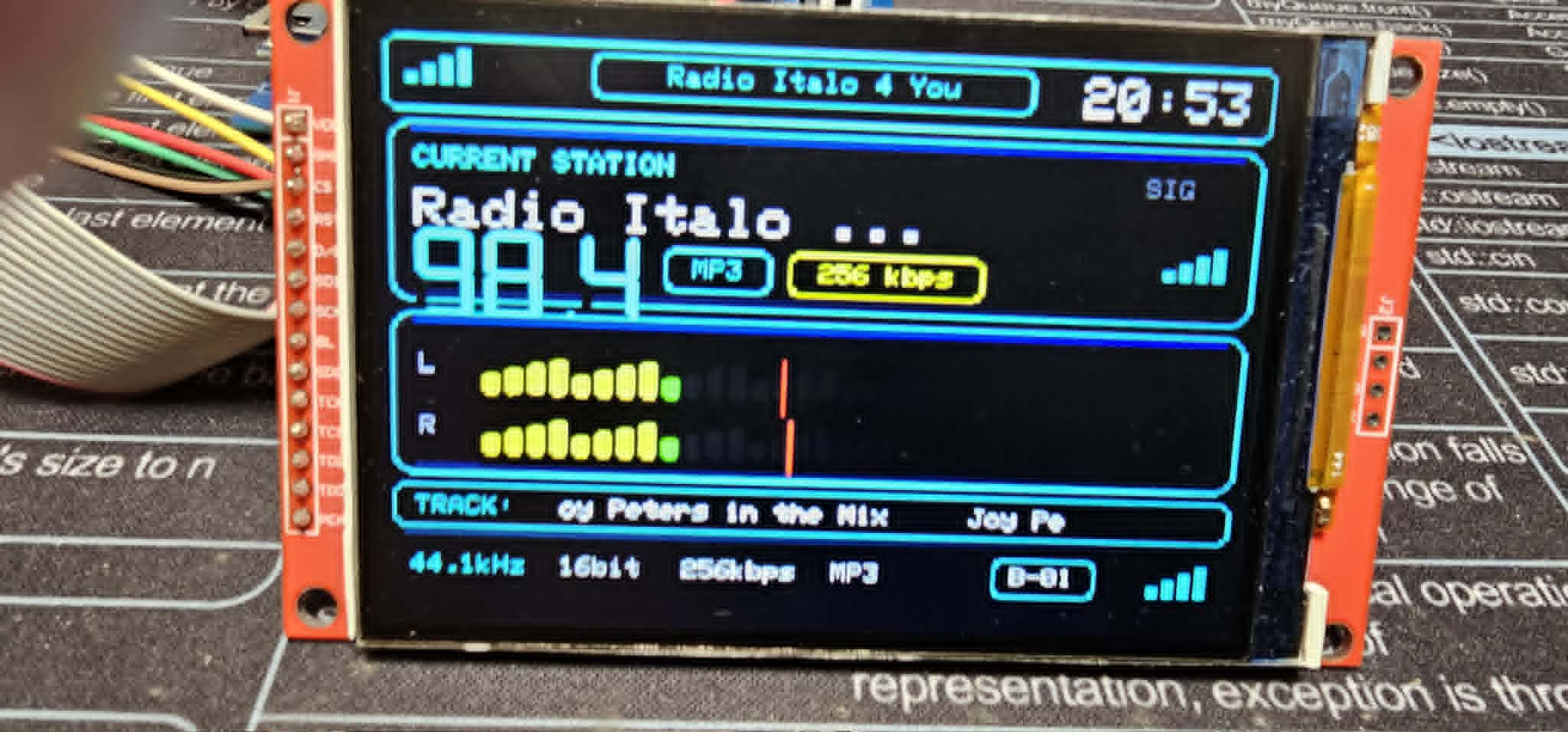

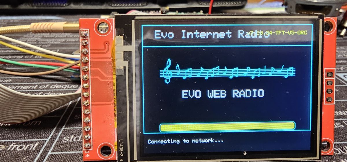

  • LovyanGFX software for ILI9341 color panel
    #2636 21892941
    ejcon
    Posts: 301
    Rate: 68
    We have EVO in colour so far very primitive but I encourage you to improve the panels from a visual point of view. Sofcik dedicated to the ILI9341 panel with the new LovyanGFX graphics bibiotech
    • EVO_Radio_Arduino_ILI9341_V5_ORIGINAL.rar (90.38 KB) You must be logged in to download this attachment.

  • Request for the PCB pinout from this revision
    #2638 21893056
    DJCheester
    Level 28  
    Posts: 2089
    Help: 75
    Rate: 958
    DJCheester wrote:
    Version Rev.4.0
    Did you keep the pinout from this PCB maybe ?
    Greetings ...

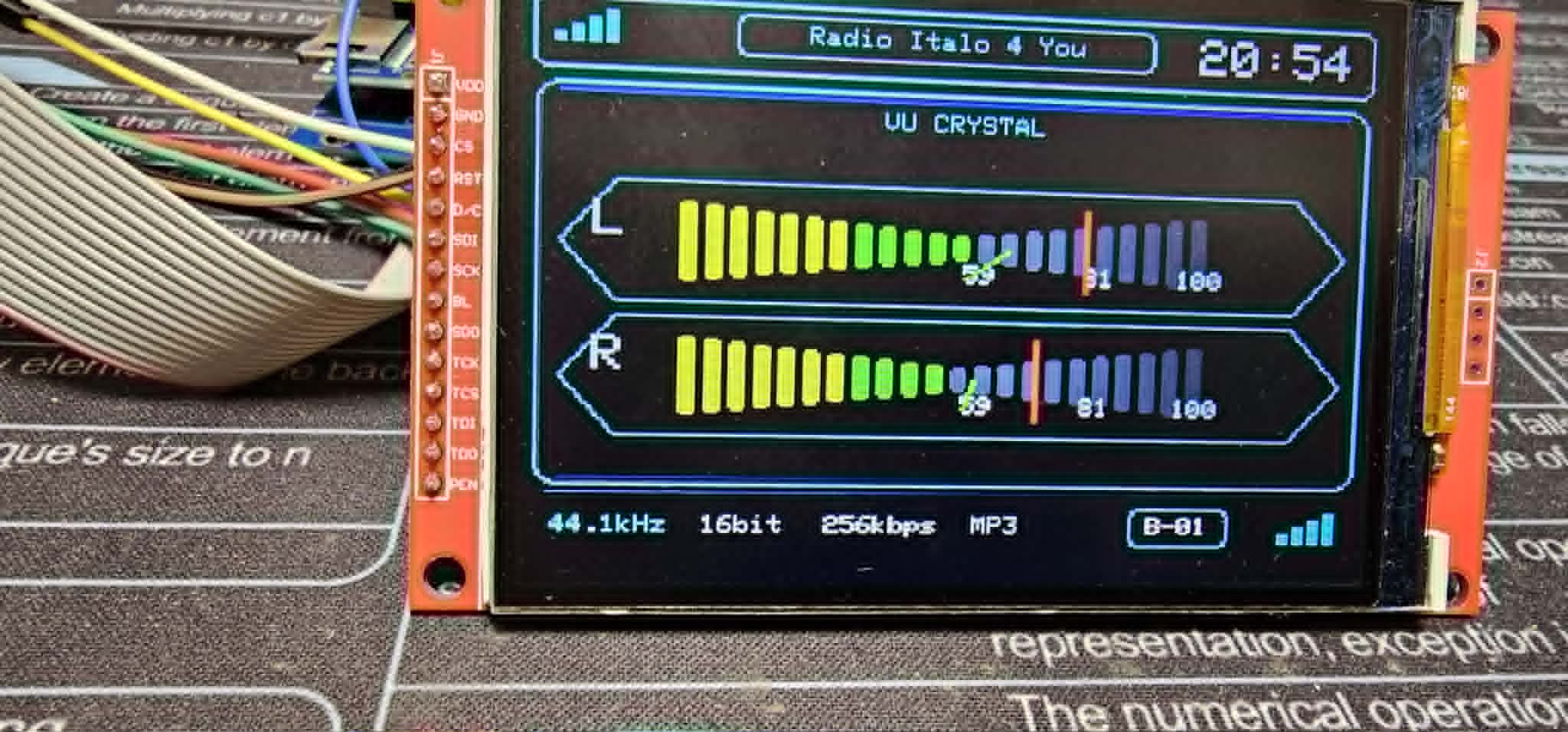

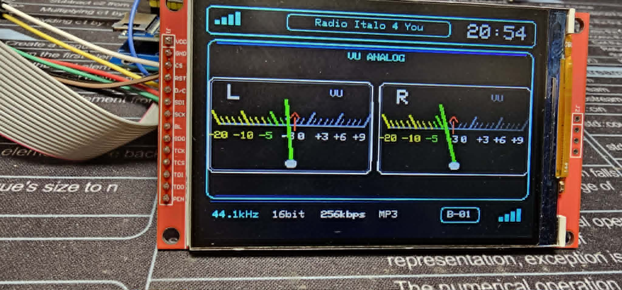

  • ILI9488 EVO panel pin mapping for ESP32-S3
    #2639 21893508
    ejcon
    Posts: 301
    Rate: 68
    I'll add a sofcik still warm for the ILI9488 EVO panel .
    ILI9488
    Connection to ESP32 S3 N16 R8 // -------------- OLED Display - pin definition -------------- #define SPI_MOSI_OLED 39 // MOSI pin (Master Out Slave In) for SPI OLED interface #define SPI_MISO_OLED -1 // no MISO for TFT display #define SPI_SCK_OLED 38 // SCK (Serial Clock) pin for SPI OLED interface #define CS_OLED -1 // CS residual screen to GND - dice on ILI9488 #define DC_OLED 40 // DC/RS screen on ILI9488 #define RESET_OLED 41 // RST screen on ILI9488
    • EVO_Radio_Arduino_ILI9488_V7_VU_FIXED_27MHz_RECOMMENDED.zip (112.22 KB) You must be logged in to download this attachment.
