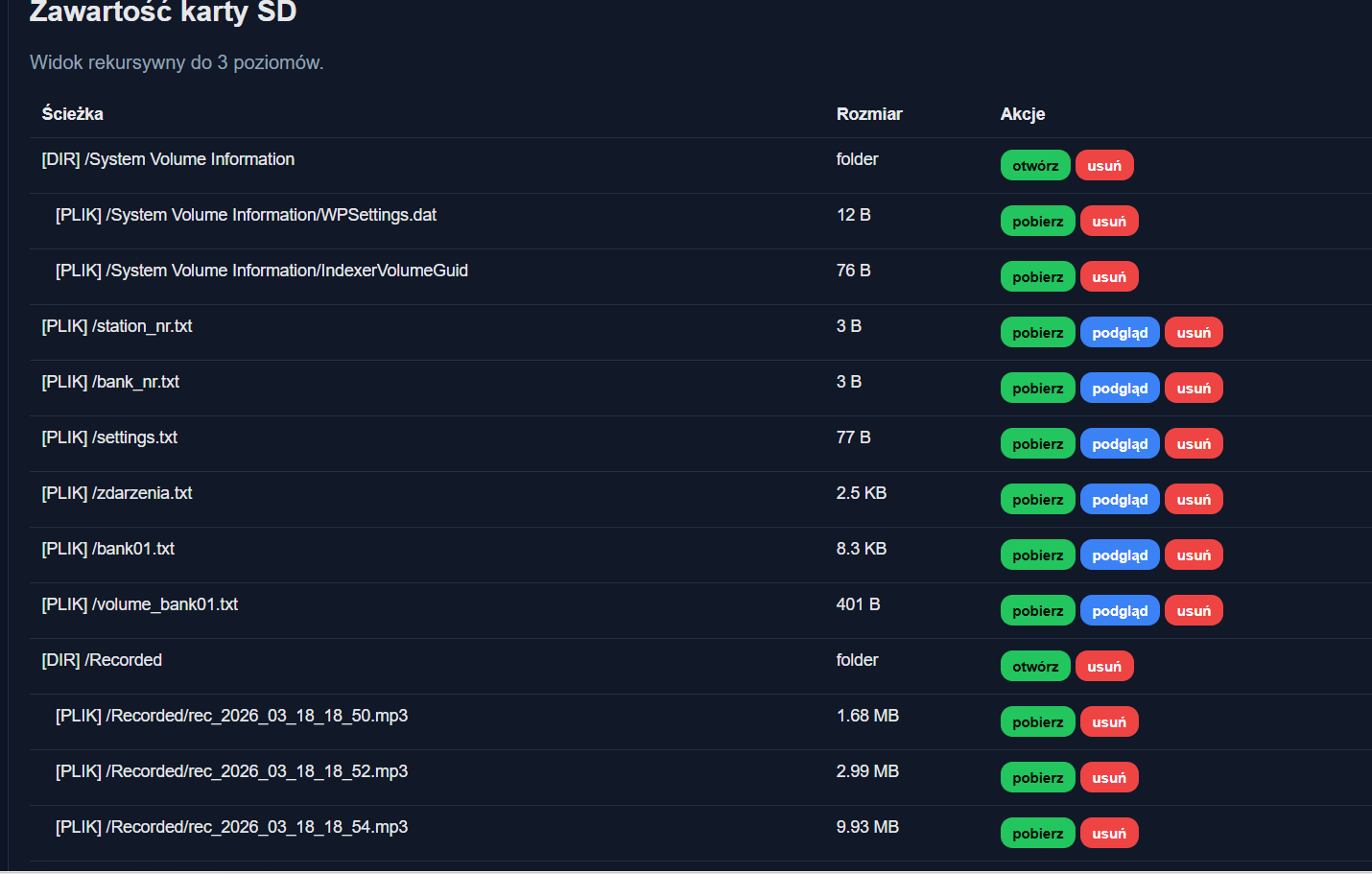

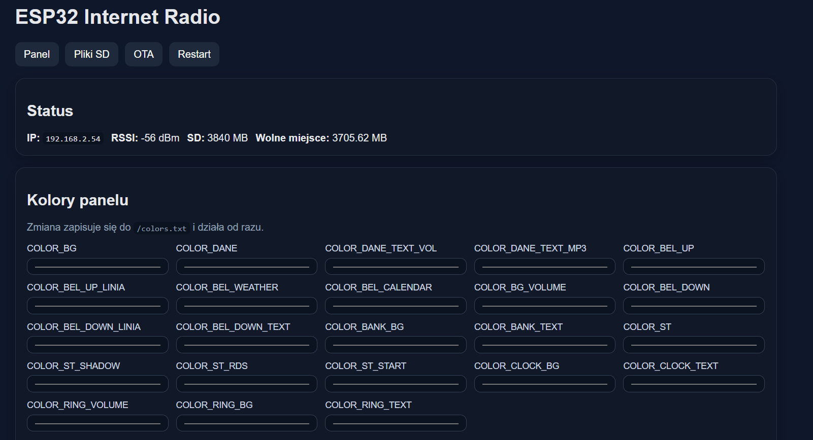

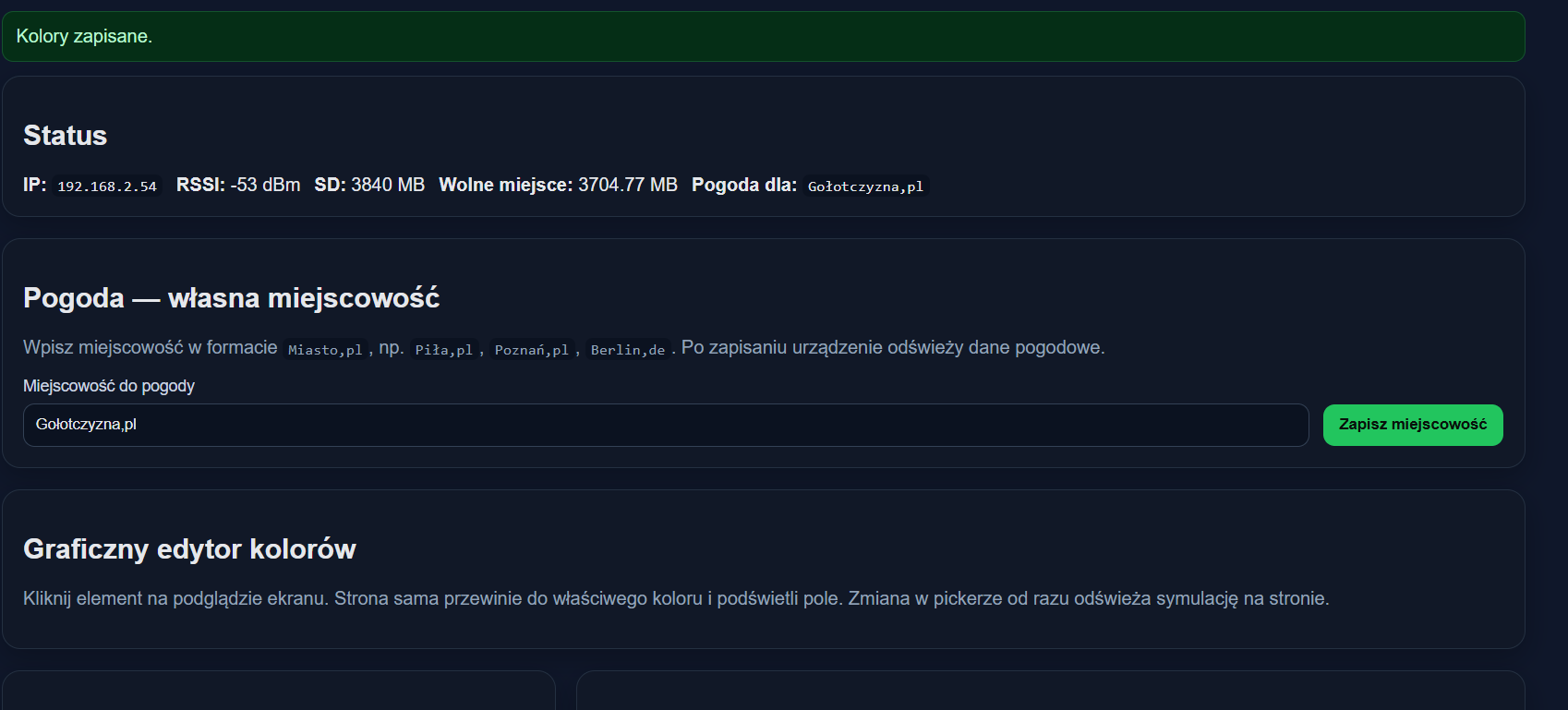

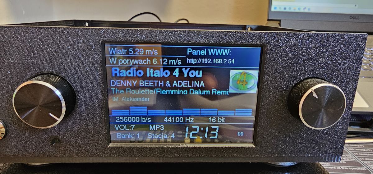

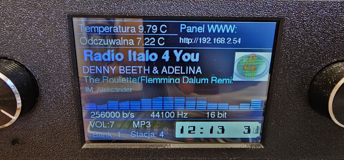

    My little redesign of the Majster softy added a bit of functionality.
    Screenshot of “SD card contents” page listing files with Open, Download, Preview, and Delete buttons.
    Screenshot of the “ESP32 Internet Radio” web panel with a Status section and a color settings form.
    you have the code to edit .

    @ejcon looks like you've implemented the file editor from Evo into the Majster version but following the trend in colour ;)
  • Final editor adds custom weather location support
    #2585 21871632
    ejcon
    Posts: 301
    Rate: 68
    Black device panel with two knobs and a screen showing Radio Italo 4 You and audio playback details Audio device display showing “Radio Italo 4 You,” track details, and temperature readings.
    >>21871537
    I needed to write off the station log files and somehow it worked out.
    Screenshot of a dark dashboard for custom weather location and device status
    Edit custom weather for a particular location.

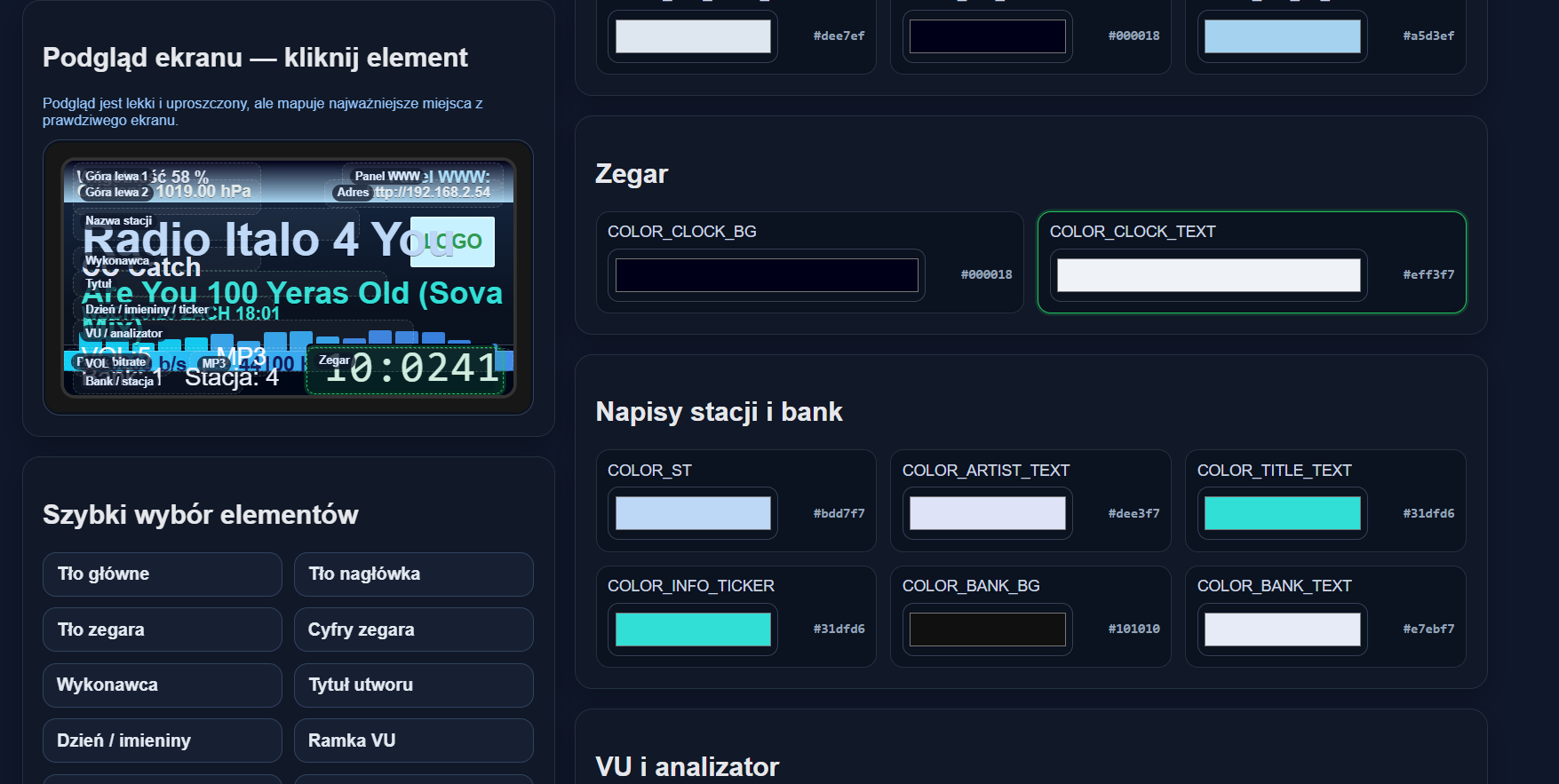

    Added after 3 [hours] 27 [minutes]:
    Here is the final version of the editor with additional features
    Thanks to MAJSTER XXL from soficki which I had the opportunity to tweak visually
    Dark editor UI with screen preview and color picker fields, including “Clock” and “Station and bank labels”.
    • ESP32_internet_radio_v3_ArduinoEDIT.zip (135.9 KB) You must be logged in to download this attachment.

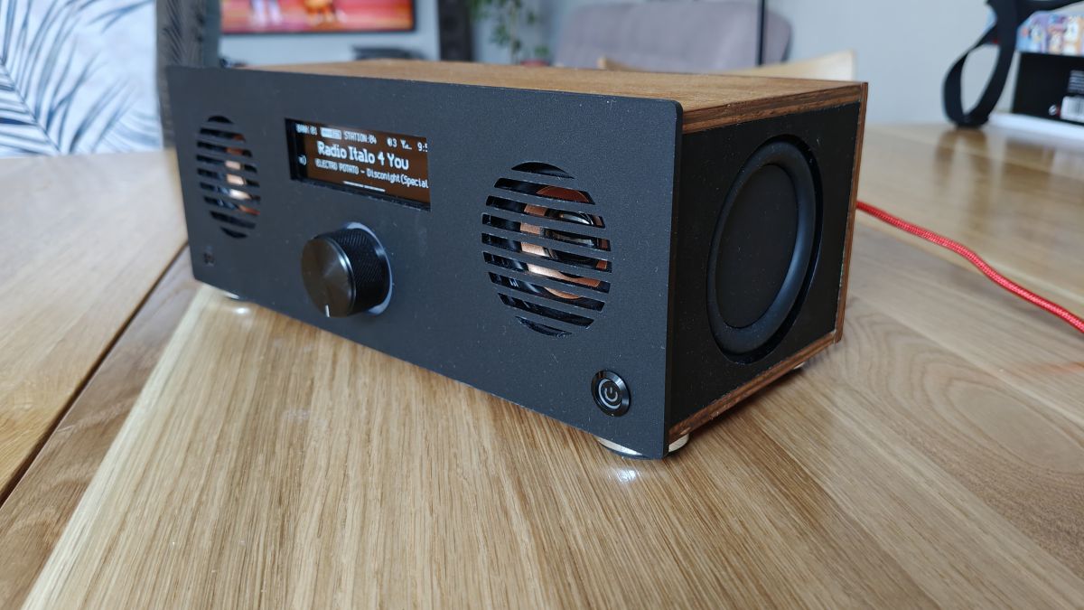

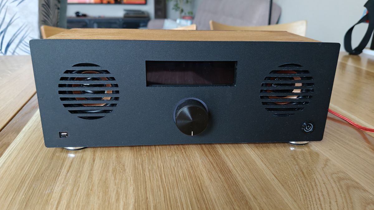

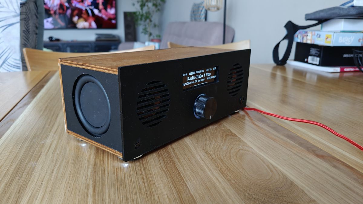

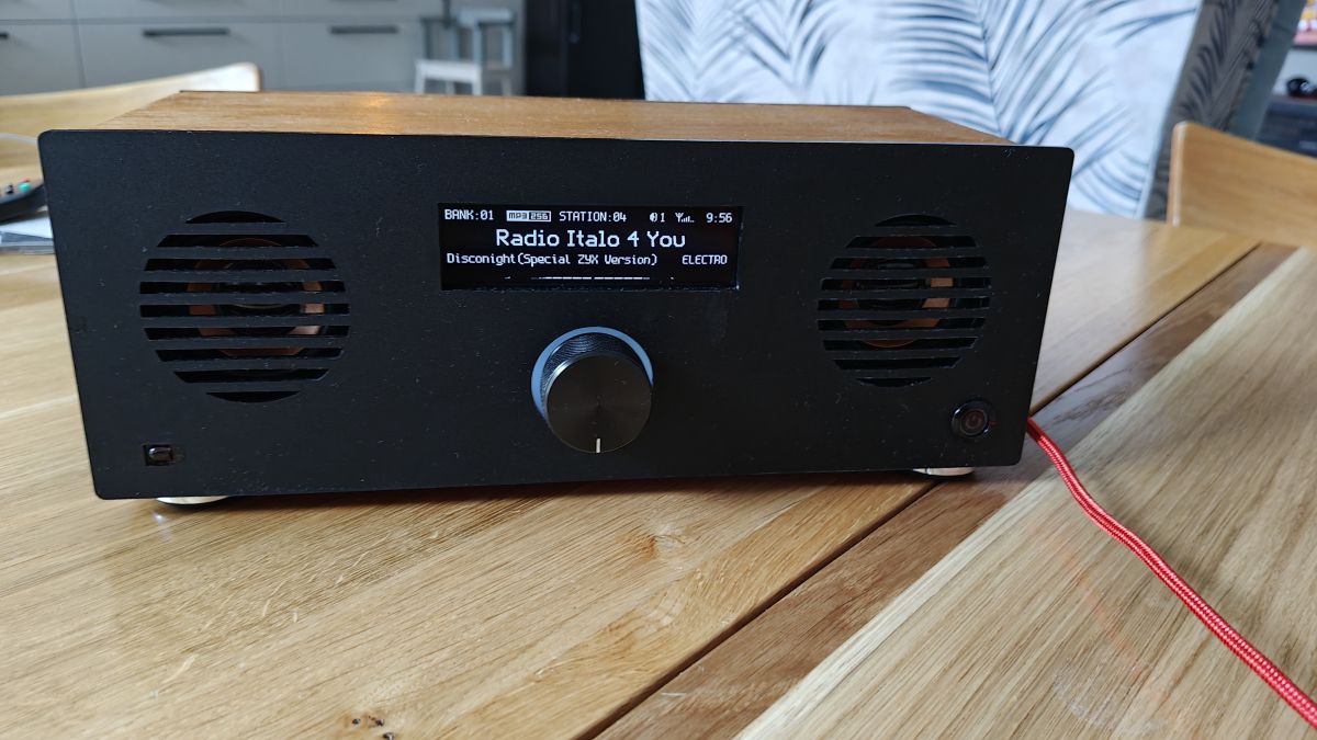

    Another Radio for a colleague ;)

    How do these rubber passive mebrans perform?
  • #2588 21872355
    dawidkosciesza
    Posts: 54
    Rate: 14
    >>21872345
    To have a perfect comparison one would have to build two identical ones with and without a membrane.
    But comparing to a similar radio I built earlier I have the impression that these diaphragms add a bit of that "bass".
    The sound is really pleasant and you can feel those low tones. Especially since the transducers are not from the high end but ordered from aliexpress ;)

    >>21872339 I am curious as to how you have printed the ring for the knob illumination. I have done a dozen different prototypes I have some of my solution but maybe it can be done even better.
    I also see that the status led landed in the knob and switch only in reverse polarity :)
    Front milled or do you have access to such a large printer ? Because it seems to be more than 256mm or maybe an illusion on the film ?
    It came out nice. About the diaphragms a colleague already asked, I'll just ask if you counted them or just put them together? In the sense of volumes for speakers and diaphragms?
  • Polycarbonate diffuser ring for encoder lighting
    #2590 21872375
    dawidkosciesza
    Posts: 54
    Rate: 14
    >>21872357
    I made the ring quite simply. I have polycarbonate light diffusers 2mm thick. I also cut the hole for the knob a little wider and pasted this diffuser on the other side with the encoder fitted. The diffuser distributes the light well so all I had to do was direct the two LEDs left and right onto it.
    The LEDs are exactly in reverse polarity. I took advantage of the "mistake" of my colleague supsak.
    I cut the front and the housing with a laser, I have a Longer RAY10. It allows a 40x40cm operation.
    However, the radio itself is exactly 25x10x12cm.
    The litre of the enclosure unfortunately can not be calculated as you do not know the parameters of the speaker, and unfortunately our Chinese friends rarely add them ;)
    I was mainly guided to keep the dimensions as small as possible but assisted by the knowledge of chataGPT. The most important thing is that the enclosure is tight, stable and I think that soundproofing also helps a lot.

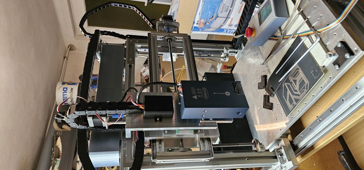

    >>21872375 The ring itself how to design it I know because I have :) These diffusers you have ready made or you cut from some type of plexi with laser ?

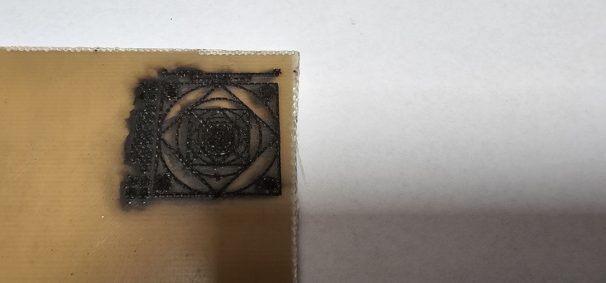

    Is 10W enough for cutting without burning the edges ? I'm thinking of buying some cheap laser and wondering what is worth investing in.

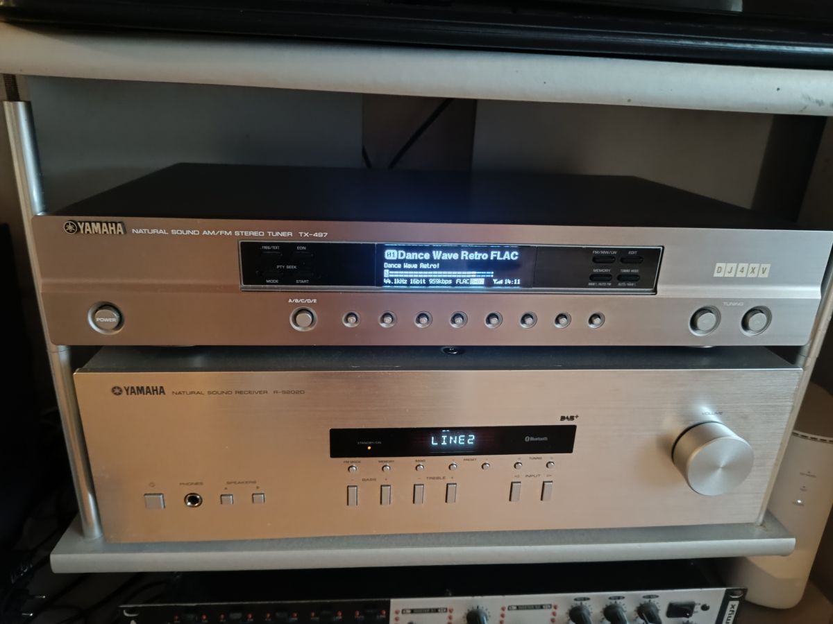

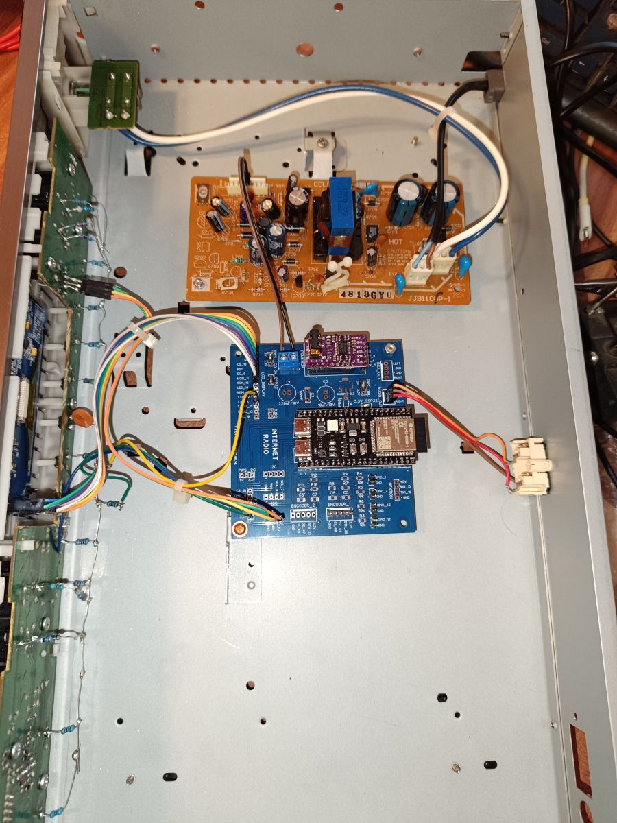

    JohnNagy
    Posts: 14

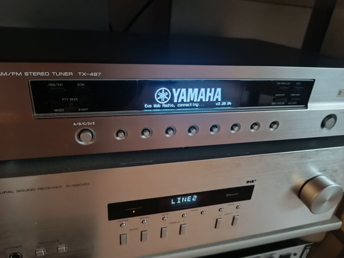

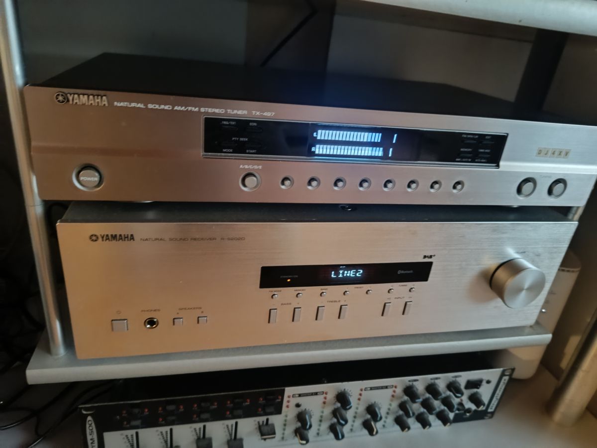

    Hello! I hope you don't mind me showing you my finished tuner. Thank you for the software. All buttons work, 19 of them. :-)
    It required a lot of filing and post-processing to cut plexiglass.
    Front panels of Yamaha TX-497 tuner and Yamaha R-S202D receiver with lit displays
    Yamaha TX-497 tuner above a Yamaha R‑S300 receiver on a shelf; displays show “Dance Wave Retro FLAC” and “LINE2”.
    Inside a metal enclosure with several PCBs and wires, including a blue board labeled “INTERNET RADIO”.
    Two silver Yamaha audio components on a shelf, with lit display and front-panel knobs

    You have to 80W this 10W Chinese it will not burn anything.

    >>21872538 You probably have a CNC design of some kind, because with a laser you don't carry any load. Looking at what colleague @dawidkosciesza has cut out, it seems that 10W also does the job. For "thicker" subjects I have a CNC.
  • #2595 21872645
    ejcon
    Posts: 301
    Rate: 68
    I didn't build it myself from scratch. The design is mine as well. It's 4-axis, it was supposed to be a multi-tasking cnc machine, I have a spindle alternating with a laser, I have a 20W and an 80W, you really don't do much with it, I use it for pcb, it doesn't even burn paint.
  • #2596 21872672
    robgold
    Posts: 726
    Help: 10
    Rate: 290
    >>21872645 And are you sure that it has 20 and 80W of power ? Have you measured it with something? With lasers it varies and 80W seems impossible in such a small box as in the picture. I would rather expect that this is a conversion from co2 laser to LED and then it is about 8-10W but maybe I am wrong.
  • 80W laser leaves clear 0.3 mm stainless mark
    #2597 21872707
    ejcon
    Posts: 301
    Rate: 68
    That's what the Chinese guy wrote, the optics were right at the beginning he was still burning the paint not badly but then it was just drugs that set it on fire so I don't believe the Chinese guy could burn something like that with that 80W for sure because it makes a pretty clear mark on the stainless steel with the engraving in the galvanizing is a fight of about 0.3mm so I'm just writing what I have and that's it

    As for the laser engraver this power is enough for me.
    I bought it on ali in promki for 600zl :D
    I cut mostly in 3mm plywood and 3mm black acrylic. The plywood and this acrylic goes in one cut. The 6mm plywood already has to go twice.
    As for other materials, you can't cut PCB, it burns too much. Acrylic in other colours has to be cut several times. White and blue are not affected by laser at all. From what I have read it is related to the colour of the laser beam.
    Mirrored surfaces should preferably be painted black and then engraved, and the paint washed off after processing. Care should be taken as without painting you can destroy the laser by reflecting the beam back to the head.
    @robgold here is a link to the diffuser I use, I cut it by machine because unfortunately it melts and burns under the laser.

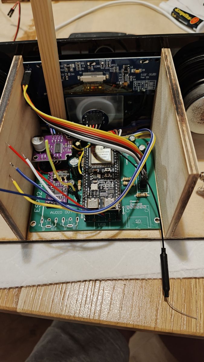

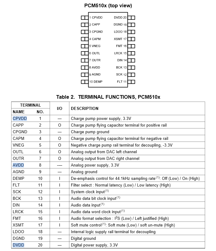

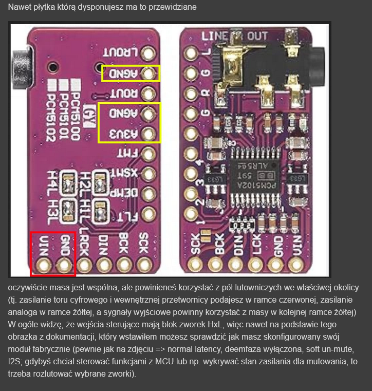

    Today I was struggling with a radio I made for my Dad. I had a big problem there with noise and screeching. The radio has a TPA3110 amplifier and is powered by a pack in series of 3x18650. A supply of about 12.6V goes to the amplifier and a step-down converter powers everything else.
    In my search for a solution I came across a post like this:
    https://forum.arturhome.pl/t/problem-z-dzwiekiem-esp32-tpa3110/13487/11
    The author of the topic as he wrote himself: "I got rid of the speaker farting by disconnecting the ground from the PCM module"
    Also I checked this trick today at my place and Eureka. All the noise and interference is gone!
    What do you guys think about this solution? I'm curious to know whether it affects the sound quality or the PCM operation?
    On that forum, someone also mentioned a separate 3.3V supply for the analogue section in the PCM5101.
    PCM510x pinout top view with a table listing terminal functions and descriptions.

    Specifically, what ground have you disconnected from the module, the one between the L and R channels or the one from the power supply or both? How does it work without GND ? Can you describe it ?

    >>21872947 I wrote here to insert a 10Ohm resistor in the PCM ground. I have the PCM itself done separately with a 3.3V supply for the digital and analogue parts. Unfortunately their grounds are tied together on one plane. Putting resistors into the speaker output is a no-go. How do you have this TPA amplifier ? The modules from Ali have a preamp inserted and it makes a lot of noise.

    The one with the resistor is what I've read, only it puzzles me how, in general, without a ground, Dawid's colleague connected it.

    Without the power ground, I left the bridge alone between SCK and GND. Apparently in that case the PCM then uses the ground between channels L and P. Sort of like a backwards ground from the amplifier.
    I was shocked myself that this worked.
    >>21873647
    You're right, it's hard to cut it out nicely, that's why he uses a trick like the one in the photo.
    Inside a wooden enclosure with a PCB, ESP32 module, and multiple connected wires

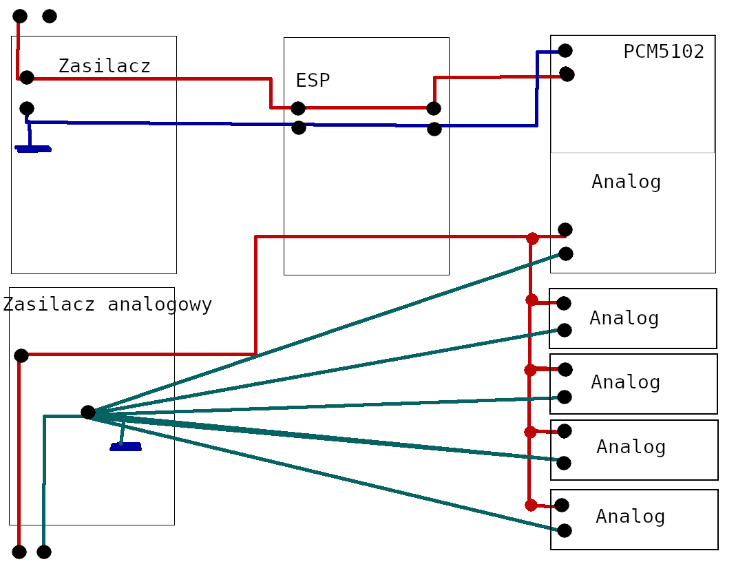

    I have a similar connection arrangement. PCM5102 - only the digital ground is connected. Then the analogue tone circuit and onto the TPA3110 amplifier. TPA - power supply ground only. This works without interference. Interestingly the signal wires are twisted single wires with a wire connected on one side to ground.

    efi222 wrote:
    I have a similar connection arrangement. PCM5102 - only digital ground connected.
    Ladies and Gentlemen. I was preparing the board gerbers today and noticed that I incorrectly stated earlier that the analogue ground is unconnected. Both grounds are shorted. I apologise for misleading you.

    >>21874839 Yes there are two grounds but both are connected and not at the power supply but on the PCMa board. This makes it very easy to create unnecessary ground loops for yourself. In the original Evo board there are still problems with the OLED inverter despite leading them out separately.
    https://github.com/dzikakuna/ESP32_radio_evo3/blob/main/Photos/ESP_radio_rev1.0_PCBvis2.png

  • Separate analog and digital grounds at the supply point

    As you can see, the SCK pin is supposed to be to ground. If someone pulls this wire to minus and at the same time the other wire as GND and God forbid still AGND or the RCA sockets to GND, then problem ready, because digital and analogue ground are already shorted on the DAC board.
    My version of the PCM5102 board has extra solder fields for the SCK jumper to ground. So I only have one GND wire to the PCM5102 board.
    By the way, you can also skip the FMT connection from the ESP32 - when configuring the PCM5102 board, set the FMT jumper to L, which is to ground.
    If we still have a silent buzz, inserting a 220uH choke (140mA, R_DC=5ohm) in series with the PCM5102 ground and power supply can help.
    The SPI bus is also a possible source of noise. Here, increasing the value of the series resistors to 22-33 ohms will help. In my case, 10 ohm resistors are sufficient.
    And one more note - the prototype is at my place connected to an external HiFi amplifier, input impedance 1MOhm.
