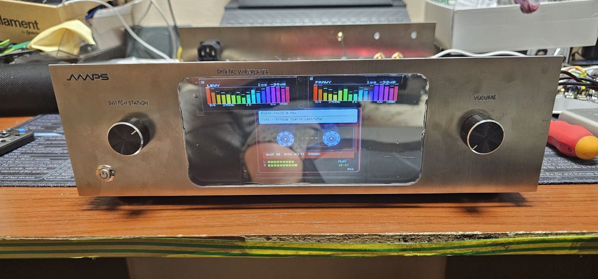

  • #2792 21942797
    ejcon
    Posts: 300
    Rate: 68

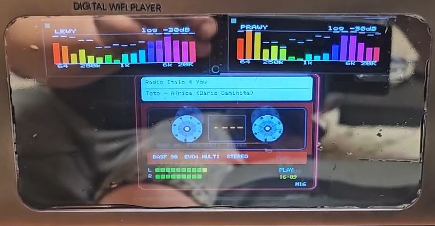

    >>21938600
    Metal audio front panel with screen and two knobs on a workshop bench
    This is how it looks at the moment – I still need to change the glass to tinted glass
  • #2793 21942812
    robgold
    Posts: 726
    Help: 10
    Rate: 290
    >>21942797 I’d go for bigger knobs. Although, for me, I think I’ll always associate this layout with Safari 5, which is why I’m so keen on sticking with a single encoder all the time ;)

  • #2796 21943684
    ArturAVS
    Moderator
    Posts: 26382
    Help: 2301
    Rate: 7819
    @ejcon, change the labels on the analysers. Not 250k, but 250Hz. :D
  • #2797 21943689
    ejcon
    Posts: 300
    Rate: 68
    >>21943684
    Thanks, I didn’t realise – I suppose I need to have a bit of a rest if I’m making mistakes like this

  • #2798 21943704

    Not that I’m criticising your work in any way. You’ve put a lot of effort into it, and a ‘mistake’ like this does spoil the effect, unfortunately. Why do you want to change the front to a tinted/smoked finish? How did you cut out that ‘piece of glass’?

    This is milled polycarbonate with a film applied to it
  • #2800 21943714
    ArturAVS
    Moderator
    Posts: 26382
    Help: 2301
    Rate: 7819
    If it weren’t for those jagged outer edges… It would be brilliant! I’d also change the font on the cassette to one that’s 2–4 pixels larger and set it to Bold. That would improve the readability.
  • Suggesting tinted glass and rear-mounted panel window
    #2801 21943809
    efi222
    Level 22  
    Posts: 779
    Help: 12
    Rate: 1218

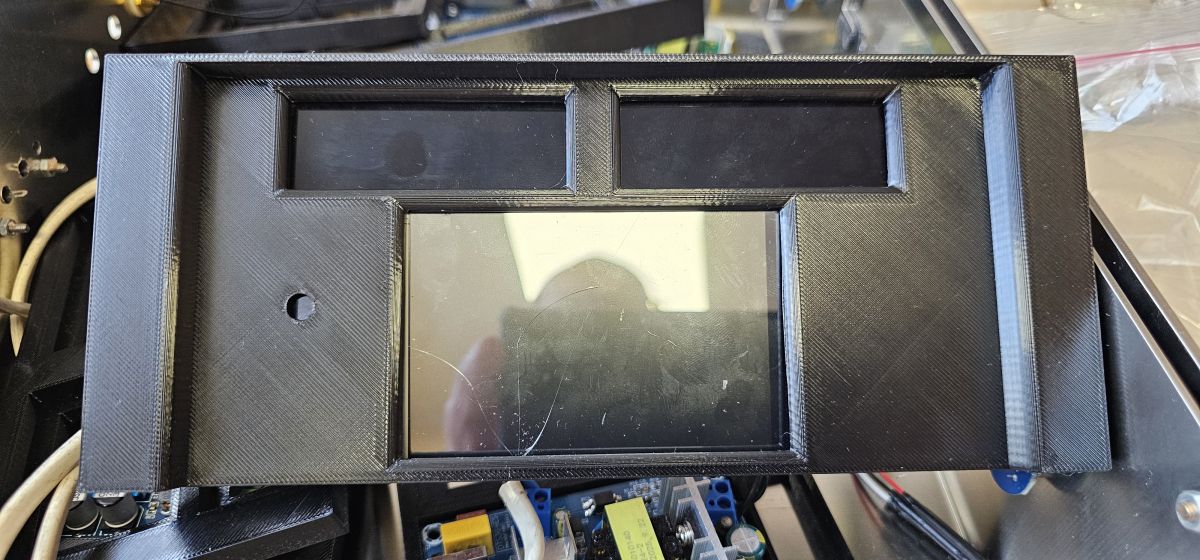

    If the ‘window’ in the front panel is larger than the displays, the purpose of the tinted glass is to conceal the interior of the case. In such cases, I also use additional black masking with cut-outs for the active area of the display.
    In the photo of the panel, light is reflected off the glass. However, from a different angle, the contents of the case will be visible.
    Unless, of course, this is intentional :)
    @ejcon, how thick is the front panel? If it’s reasonably thin, might it be easier to fit a piece of glass larger than the window behind the cut-out?

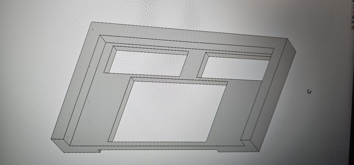

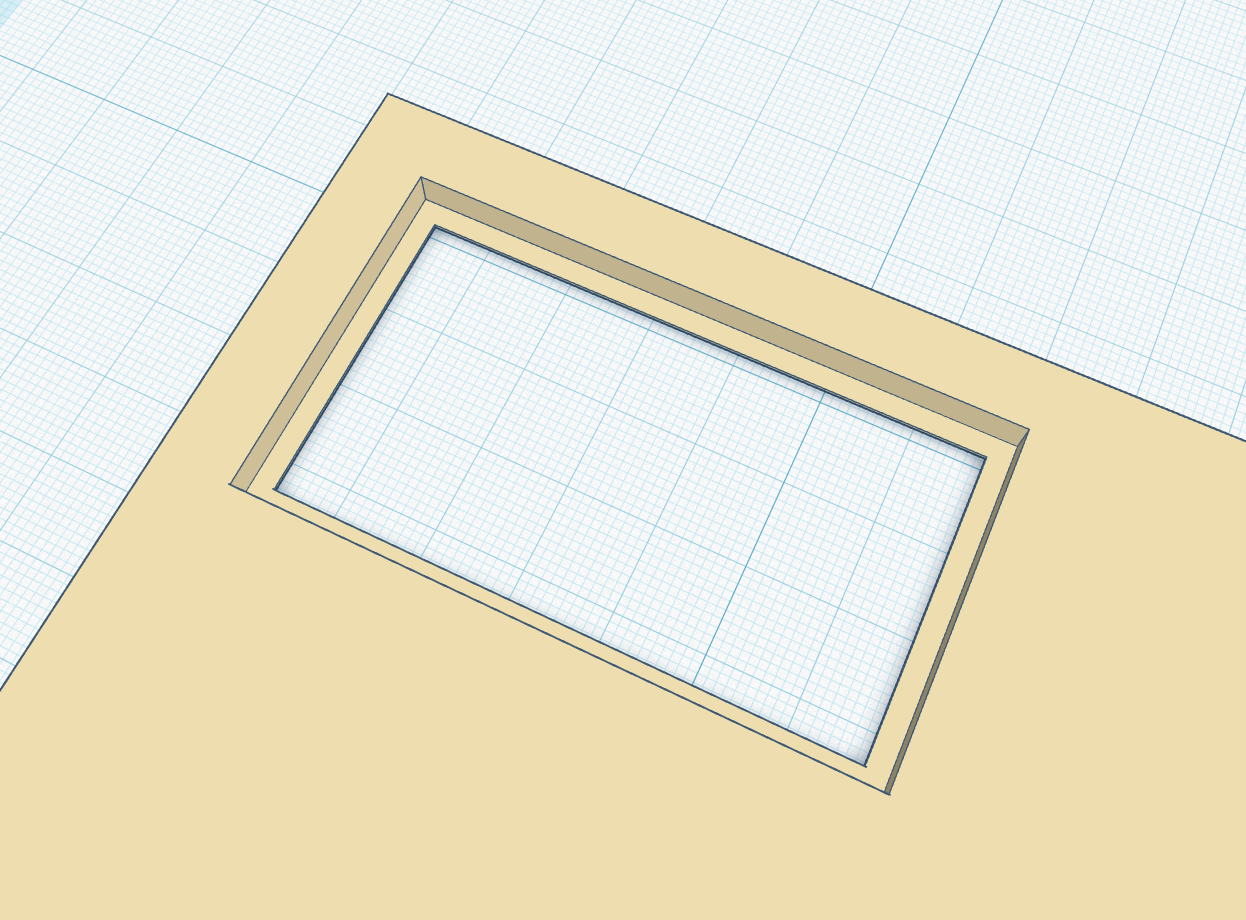

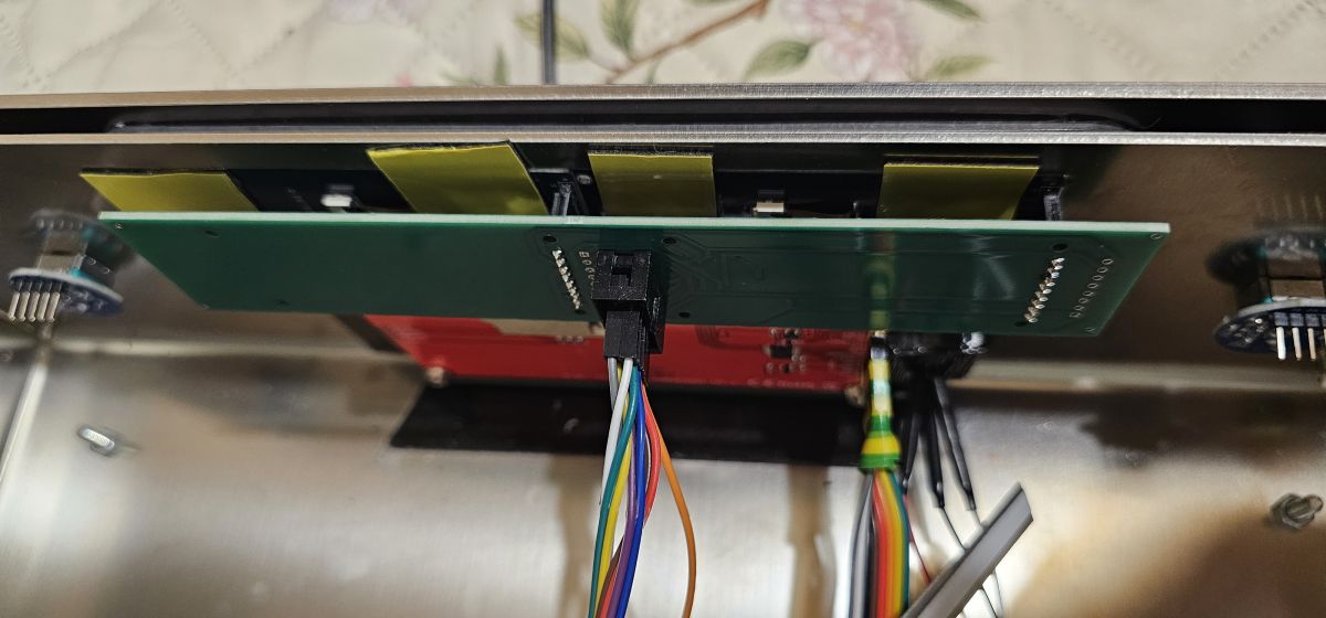

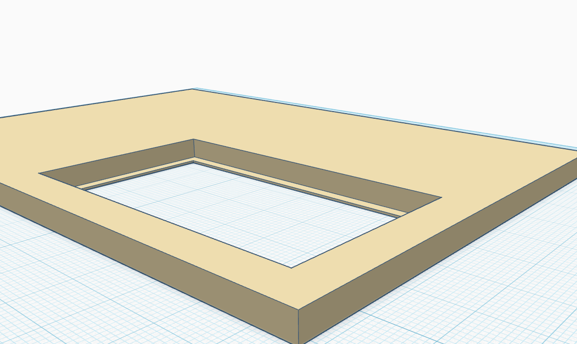

    Bottom view of a green PCB with a connected multicolored wire bundle inside a metal enclosure
    Screenshot of a 3D model of a rectangular panel with several rectangular cutouts
    >>21943809
    The panels will be printed on a printer, but I need to send the files to a mate as I haven’t bought a printer yet.
  • Display recess modified with 0.4 mm frame cover

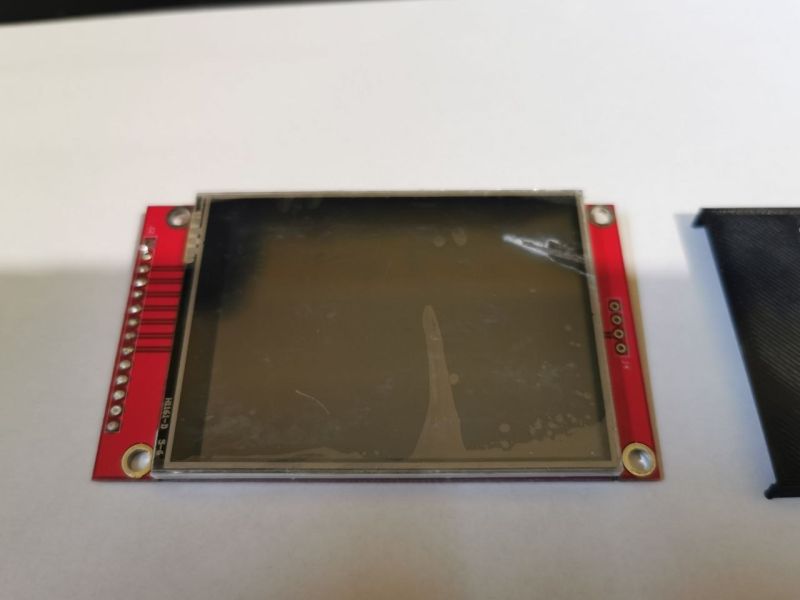

    #2803 21943855
    efi222
    Level 22  
    Posts: 779
    Help: 12
    Rate: 1218

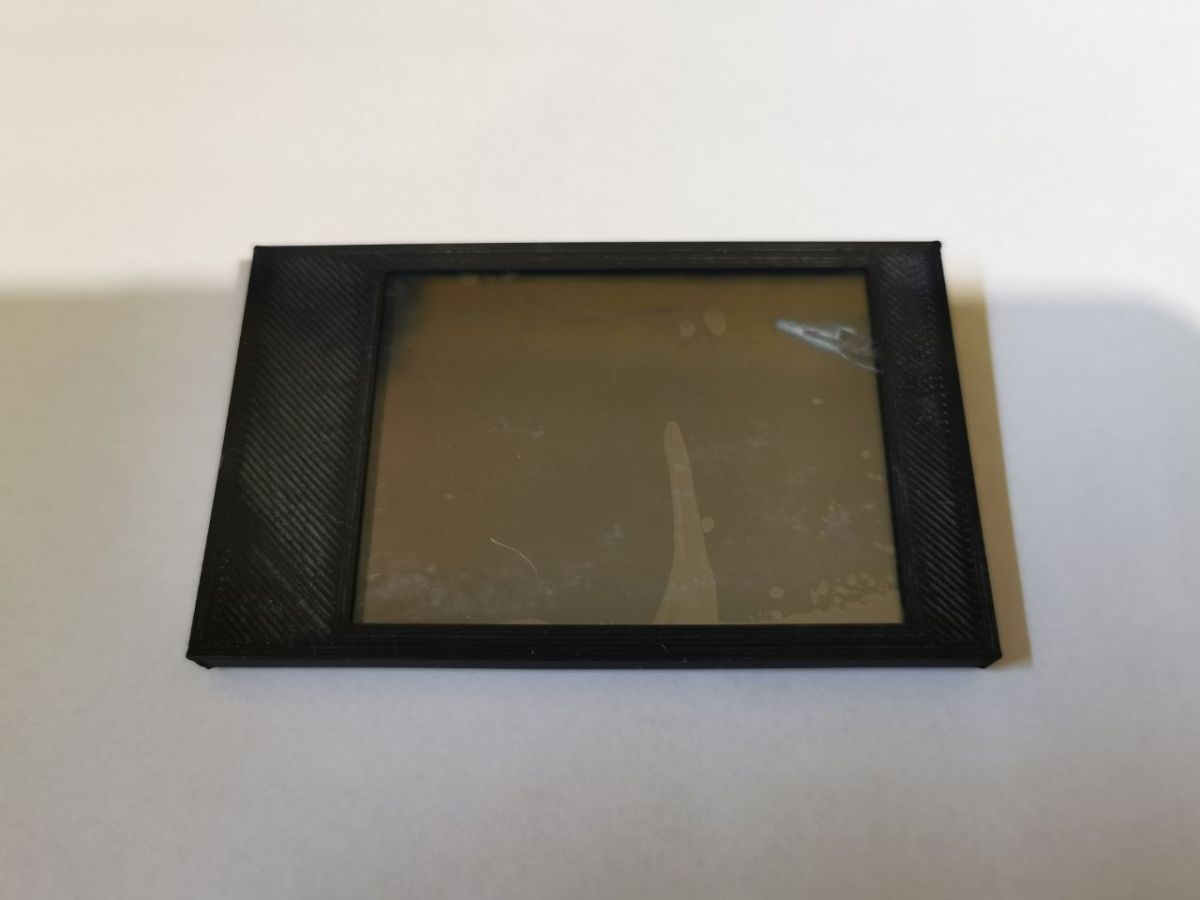

    I would suggest modifying these recesses to accommodate the displays. An additional 0.4 mm thick frame
    The deeper recess accommodates the entire display. An additional thin cover conceals the display outside the active part of the screen.
    It works well for me.
    Black rectangular plastic bezel with an inserted display on a light background

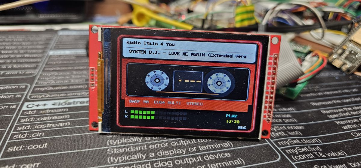

    @ejcon. Also, the direction in which the tape moves inside the cassette is the wrong way round.
    In other words, the movement is fine, it’s just that the spools are spinning the wrong way round.

    The cartridge code – so these codes will be a compiled version for the ‘Elektroda’ group; those who’ve earned it will get it for free, whilst others, unfortunately, won’t. For you, it’ll be the full version with a licence; after installation and sending certain parameters, you’ll need to enter the licence details. It might not be fair, but I didn’t go to all that trouble just for someone to sell my work.
    Added after 7 [minutes]:
    >>21943934
    Already corrected and speed reduced.
