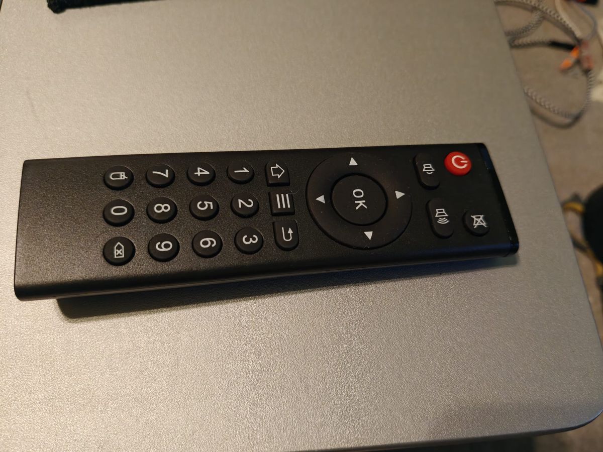

  • NEC protocol required for remote support

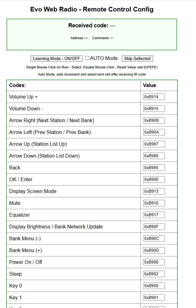

    #2736 21917401
    robgold
    Posts: 726
    Help: 10
    Rate: 290
    >>21917205 The fact that a particular remote works on yoRadio does not mean it will work here. What is important is the NEC protocol. Any other protocol is not supported by our radio projects.
    @DJCheester The codes are assigned on the website (settings -> remote set), there is a special learning mode for this. It is no longer necessary to enter anything manually into the remote.txt file
    Activate the learning mode, click on a button and the radio automatically saves the data.

  • NEC-only remotes with learning mode setup
    #2737 21917564
    DJCheester
    Level 28  
    Posts: 2089
    Help: 75
    Rate: 958
    robgold wrote:
    >>21917205 Just because a particular remote works on yoRadio does not mean it will work here. What is important is the NEC protocol. Any other protocol is not supported by our radio projects.
    Screenshot of Evo Web Radio remote control configuration with learning mode and a codes/value table
    Good to know I'm still stuck on 3.19.70 and there were no such bits and pieces there.
    Greetings...
