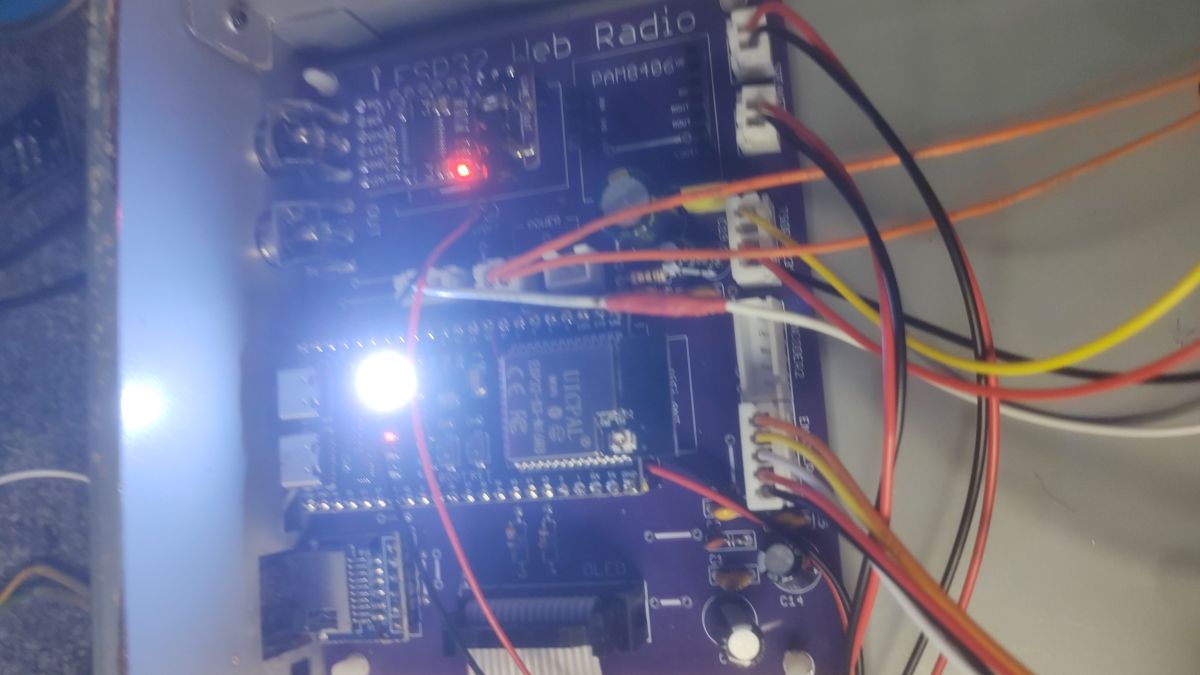

    I’ve added a PAM8406 amplifier to the PCB from @DJCheester’s project, but unfortunately there’s no sound coming from the speakers.
    The volume is set to halfway; when I turn it up to maximum using the remote, the ESP resets after a short while.
    With the previous version of the PCB fitted with a PAM8403, there were no issues with sound coming from the speakers.
    What could be the problem? I’ve tried two PAM8406 amplifiers.

    >>21920661
    Is there any sound coming from the PCM5102 output?
  • Reversed pin header blocked audio signal
    #2768 21920699
    grzes_dst
    Posts: 79
    Rate: 7
    @efi222
    There is sound on the PCM5102 and the radio connected to the stereo system is working normally.
    Voltage measured at the PAM pins is 4.4V; of course, the power supply wires to the PAM amplifier are connected to the board.
    Only a faint hum can be heard in the speaker.
    It looks as though the audio signal isn’t reaching the amplifier.
    EDIT:

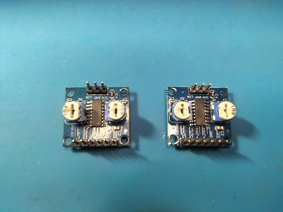

    The problem has been solved; the Chinese manufacturer had soldered the pin header the wrong way round; once reversed, it worked.
    Here’s a photo for reference, so that anyone ordering this and experiencing a similar problem can check whether any pins have been soldered in the wrong way round.

    grzes_dst wrote:
    The Chinese guy soldered the pin header the wrong way round
    Are the pin descriptions incorrect? Because as far as I can see, all PAM8406s are mounted identically.
  • #2770 21920812
    grzes_dst
    Posts: 79
    Rate: 7
    I’ve just been looking at AliExpress, and in the photos they all have the pins facing upwards, just like in my photo.
    The best thing would be to buy one to solder on; that would sort the problem.
    When mounting the PR with the pins facing downwards, the Vcc, Gnd and speaker output pins are not reversed.

    grzes_dst wrote:
    I’ve added a PAM8406 amplifier to the PCB for @DJCheester’s project, but unfortunately there’s no sound coming from the speakers.
    With the previous version of the PCB, which had a PAM8403 fitted, there were no problems with sound coming from the speakers.
    What could be the problem? I’ve tried two PAM8406 amplifiers:
    Hello everyone, I’ve been away for a bit – the PAM8406 is mounted on the PCB with the pins facing upwards. When buying the module, you need to re-solder the gold pins from the underside, i.e. beneath the PCB, so that when plugged into my radio PCB, the pins are on top.

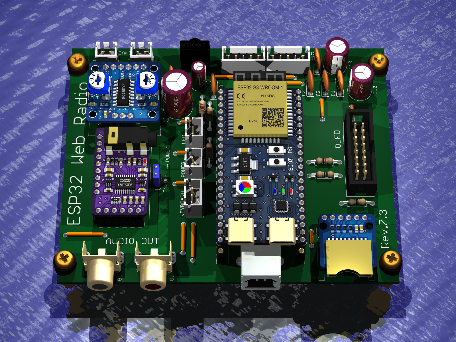

    Could you take a photo of that PCB with the PAM8406 and add it to the thread? I designed that PCB but haven’t tested it myself.
    I don’t know which board the chap was using; versions 2.3, 3.3, 6.3 and 7.3 are available for the Pam 8406 amplifier.
    The Pam is mounted as shown in the 3D diagram
    3D render of a PCB with ESP32‑S3‑WROOM‑1 module, PAM8406 amplifier, OLED header, and audio RCA outputs

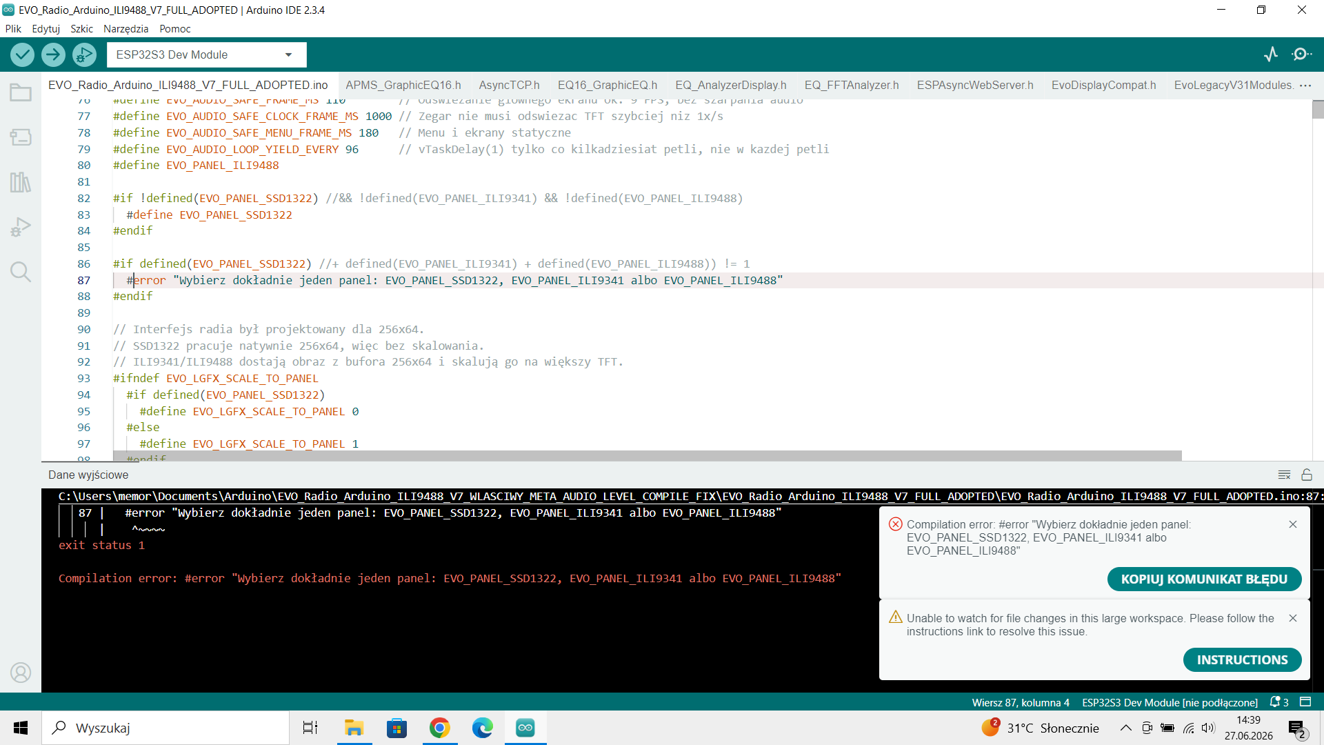

    Where and on which line do I need to select the display type?
    Arduino IDE screenshot with #define EVO_PANEL_ILI9488 and a compile error asking to select exactly one display panel

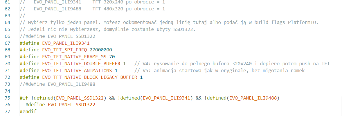

    >>21928698
    Here’s your choice: you can choose the ILI9341 shown in the photo (currently selected) or the ILI9488; the ST7796 also works with this one Code screenshot showing #define EVO_PANEL_ILI9341 selected with TFT settings and Polish comments.

    I wanted to use SSD1322, but when I select this display, I get this error.
    With others, it compiles fine.

    This directive from line 86 is a bit odd.
    After selecting EVO_PANEL_SSD1322 earlier,
    the compiler should stop compiling.

    This software was tested for TFT screens – NOT OLED. If you have an OLED screen, you’ll need different software; this one probably won’t work.
  • #2780 21928942
    wieslaw6504
    Posts: 13
    Thanks, otherwise I’d have had a right old struggle.

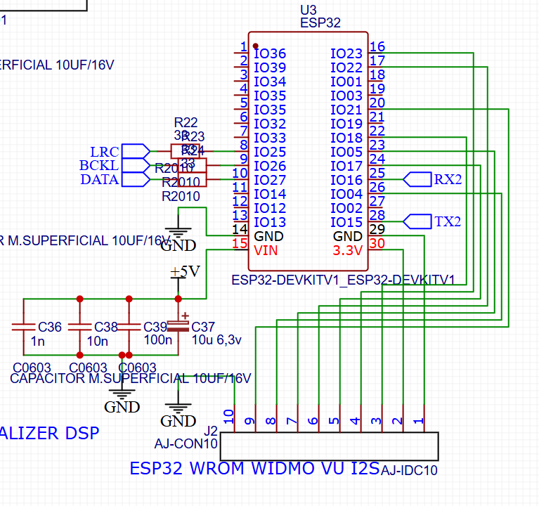

    We’ve finally managed to get the EVO4 MULTI up and running.
    This is what it looks like now. The system consists of 4 ESP32 processors
    1. Evo3 internet radio project with graphics added for the TFT display
    2. A 12-band equaliser with a range of ±16dB
    DSP equaliser as a panel for the TFT display
    3. Spectrum and VU meters
    4. Bluetooth audio transmitter.
    The whole system operates via I2S.

    Project diagram
    This is what the entire project looks like, with all its functions.

    >>21941257 I must have a leak on my computer, since you have the Evo4 version, which I’ve never shared with anyone because it’s still very much in the prototype stage ;)
  • #2787 21941397

    Why not skip straight to the Evo5 then? Leave the Evo4 to ejcon 😀 The bloke’s had a right go with just the ESP and LCD 😀.
    Actually, it’s quite possible that a PCB ‘my way’ for ejcon’s Evo4 will be ready this autumn.
