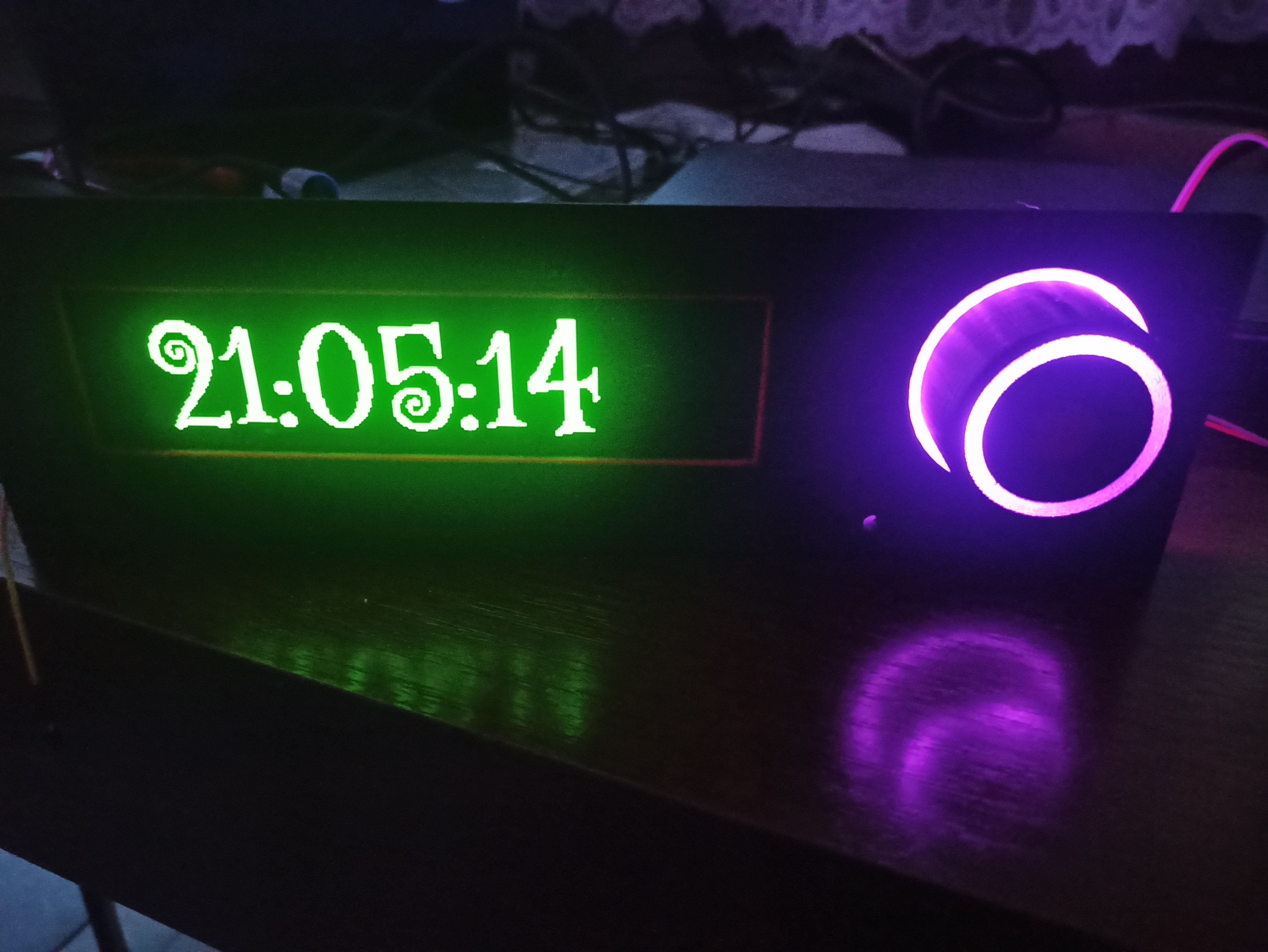

    @nouki The clock mode has one fundamental flaw. The display is of the OLED type. Displaying a static image for long hours will affect its lifespan. As for the power supply, have you connected a jumper on the ESP board to make the 5V from the USB appear on the VCC 5V pin ? If you don't do this then there won't be those say 5 or 4.9V there and then indeed the PCM won't start. For the whole circuit including the OLED there is enough current from the USB port (the radio circuit does not draw more than 500mA).
  • Screen blanking as a workaround for display burn-in

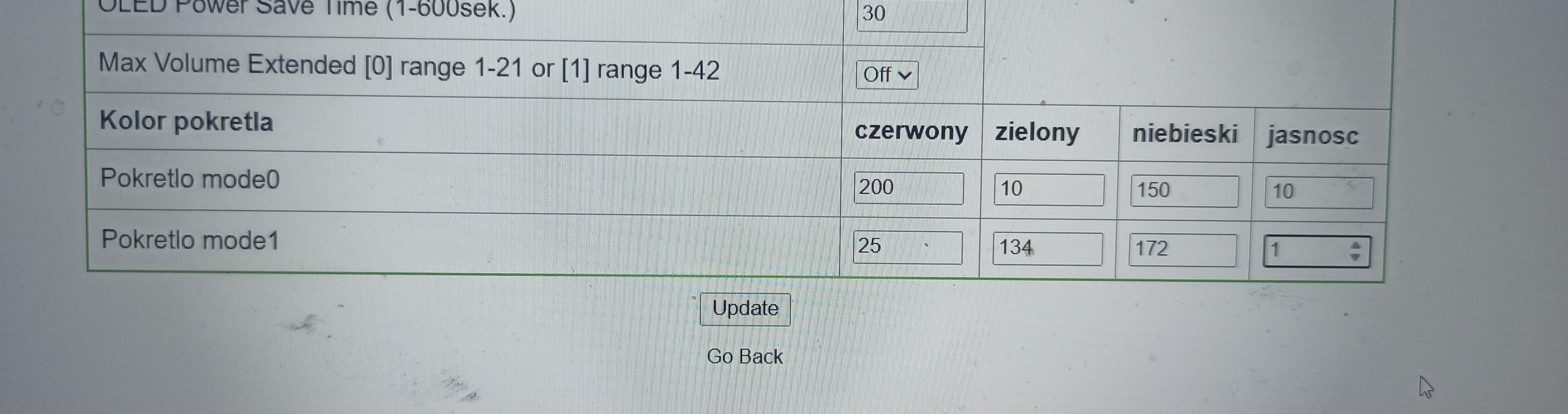

    Rate: 98
    For this we make the clock the width of say 3 pix and move it left right from time to time. When listening to, say, a station named xxx, there is also a field which stays in one place all the time. As well as the mode with the larger clock it also stays in the same place. Unless it's moving and I can't see it. Partly screen blanking solves the problem as long as it is enabled.
    The power supply is irrelevant because on a quick usb start up and ultimately it is taken from the bottom board so this is my oversight . My bottom board needs over 6v to work properly.
    I added the RGB knob and clock as a quick fix.
    Any hints from someone with a more advanced ...Unfortunately the last time I wrote something was a couple of years ago when esp was coming in and I was playing with atmega and the smaller brothers.
    I made a change like this
    Code: Arduino
    And now the radio resets itself every so often, or goes into a continuous reset loop when I type configArray[32].
    In addition, the variables at %d1-%d8 read normally and the rest is written to the card correctly (sending from the page) but inserts the numbers 101,102...or some 24xx .
    It seems to me that this could be related to addressing but I am too weak :) .
    Thanks

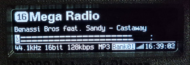

    I envied a bit the guys who have yoRadio that their VUmeter always works by 1px and not by a whole segment of 8px, and I also made such a VUmeter in our radio. Additionally there is a Peak&Hold dash. Do you want such a version ? :) .
  • #1226 21573305
    robgold
    Posts: 726
    Help: 10
    Rate: 290
    I have uploaded 3.18.06 on GitHub with the new VUMeter with peak & hold function.
    Audio device display showing radio station, song title, VU meter, and audio file parameters. .
