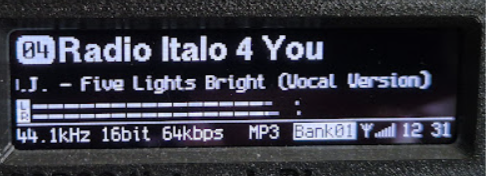

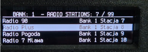

    I have uploaded on GitHub version Evo 3.8.12 Link What's new ?
    1. "smooth" mode has been added to the VU indicators,
    2. new look for "mode 0 and mode 2",
    3. new look for the station list,
    4. improved recovery mode response to the encoder,
    5. The web page in the configuration now shows the recommended "default" values,
    6. station name reading directly from steam - Experimental function,
    7. new font for station name display,
    8. changed the name of the ESP32 to Evo. The radio reports on the network under the name: http://evoradio.local/
    AD1.
    Now cool slowly rising and falling. The option is configurable in the menu. To make it work, you need to run it so that a new config.txt file is overwritten on the card or in SPIFFS memory.
    AD2
    there is no second hand, the colon in the clock flashes, I have reverted to displaying the full name "FLAC" instead of "FLC".
    AD3
    The header displays the current bank and separation line. Eventually I will change the stream files so that I don't keep the station number and bank in them.
    AD6
    you can enable yourself to read the station name directly from the stream for testing. Unfortunately this will incorrectly still generate station lists on the web. Also not all radios generate their name correctly in the stream. More for fun/testing I will probably remove this in future editions.
    In the case of providing the radio with a link to the stream via www (there is such an option in the stream editor), the radio will just display the above mentioned name from the stream instead of the
    the existing abbreviation on the OLED display: "URL"
    AD7
    This is a font from the same family, only slightly narrower, so that in future it will be possible to display 1-2 characters more in the station name itself.
    Compilation as usual under Arduino and Platformio. Source file and bins on GitHub. Enjoy testing.

    Hello everyone. New version uploaded.
    In mode 0 and 2 with the message ...No audio stream !... minute and second clock is visible, not hour and minute.
    I see some new mode == 3.
    Reading the station name directly from steam when changed in the options via the page, does not save or change the value. No such options in saveConfig and readConfig in the code.

    I uploaded version 3.18.13 it should be OK. Actually with the "no audio stream" message there was a problem. Thank you for pointing that out.
    Regarding mode 3, I have an idea to change the layout but it's still in the design phase at the moment.
    It is an experimental feature, plugged in for testing. There is no record. I removed it because the feature will be removed 99% of the time anyway.
    Its usefulness does not seem to make sense at the moment due to the need to distinguish between stations transmitting 'station name' and the dynamic generation of a list of stations for the web server.
