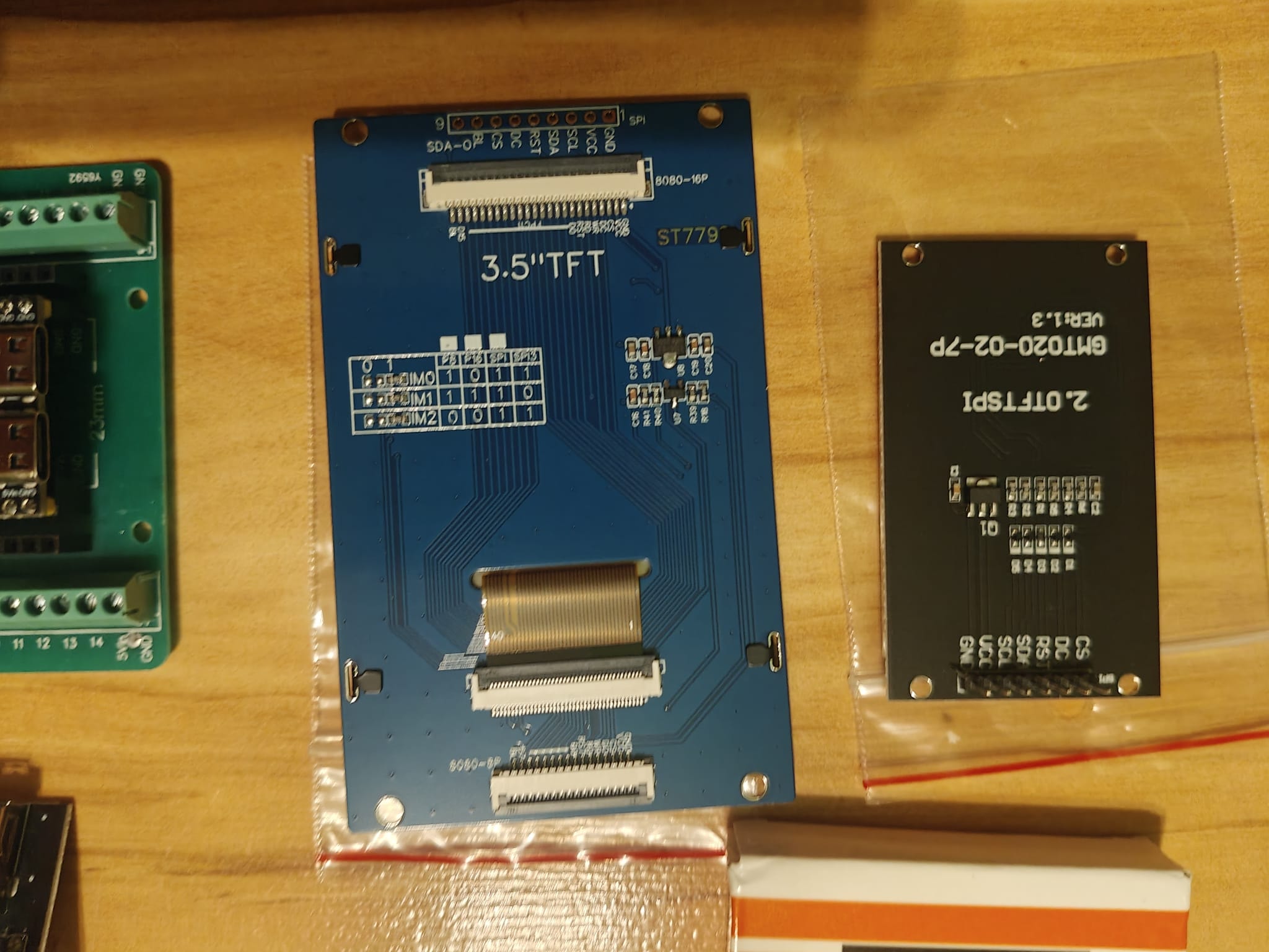

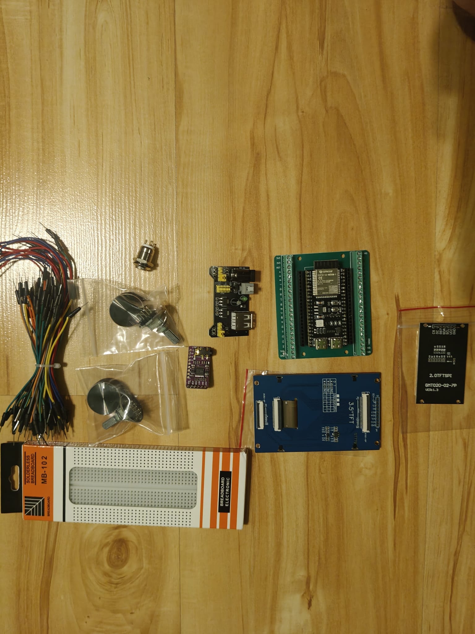

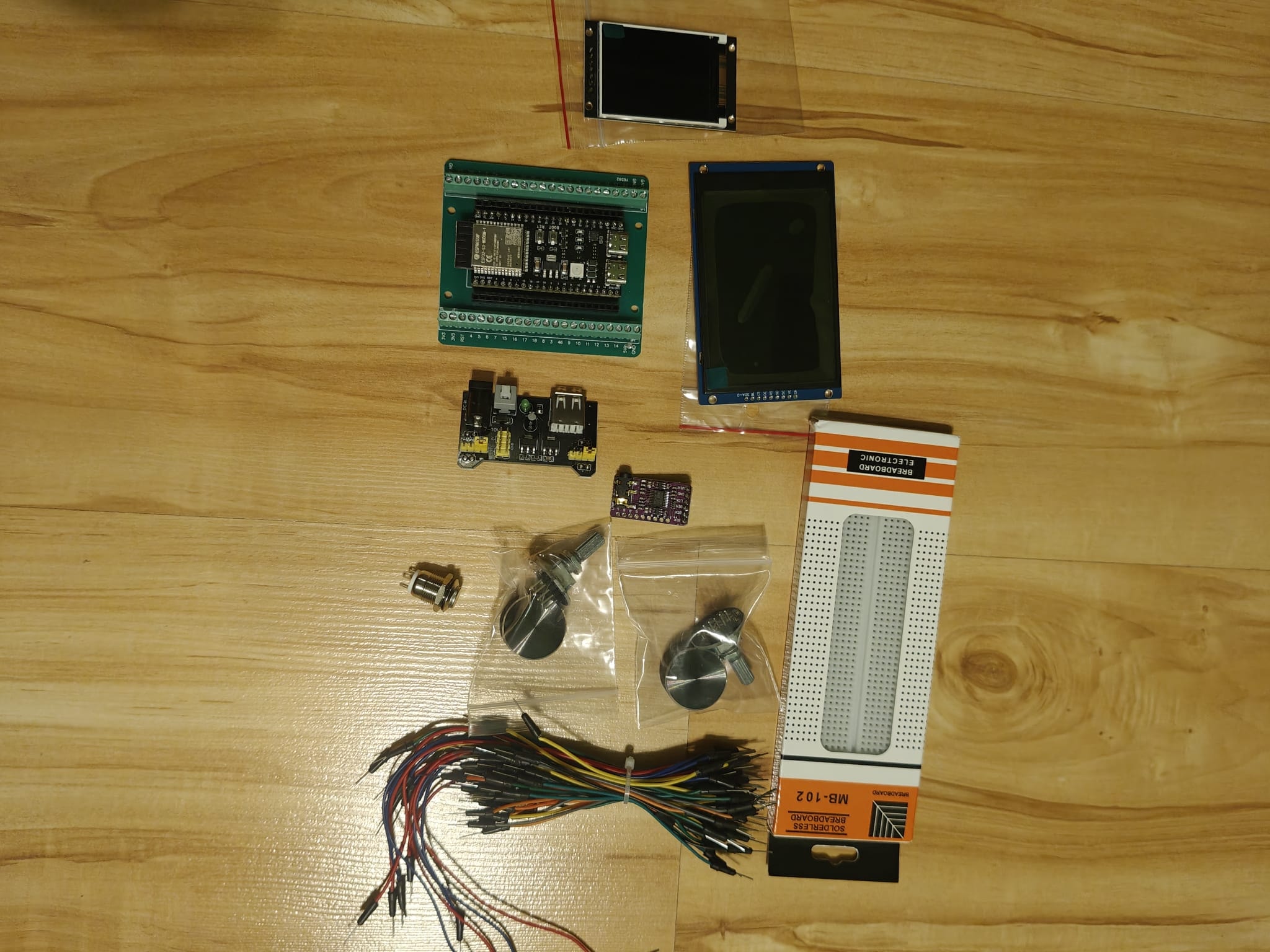

    amrowek
    Posts: 239
    Rate: 10
    I have read and watched and.... I decided to take a chance. For the moment I have
    2 screens, because first on the smaller one and then, if it works out, I'll struggle with the bigger one. For the moment... what kind of power supply for this grandpa?
    • Internet radio and audio file player on ESP32-S3 3.jpeg (260.19 KB) You must be logged in to download this attachment.
    • Internet radio and audio file player on ESP32-S3 2.jpeg (327.32 KB) You must be logged in to download this attachment.
    • Internet radio and audio file player on ESP32-S3 1.jpeg (338.61 KB) You must be logged in to download this attachment.

    These displays are not for this project.
    Eh then what display is suitable for this project?
  • #1270 21640115
    amrowek
    Posts: 239
    Rate: 10
    Hm on the fejs in the YoRadio Polska group, ST7996 displays are running on an ESP 32S3
  • #1271 21640121
    hevet
    Posts: 346
    Rate: 47
    But this is not a topic about Yoradio, you haven't read as I wrote.
  • #1272 21640185
    DJCheester
    Posts: 2049
    Help: 75
    Rate: 949
    Buddy amrowek this project has two types of display specified and if you want to build this radio then I recommend getting a display for this project the prices are not cosmic, you connect everything according to the schematic diagram you win the soft and run.
    It is logical that ESP can handle another display in another project, all you need to do is use a good library and you can display what you want, but the software on this page is written for dedicated displays.
    Unless you are a programmer and you are good at it, there are sources available in this thread and if you feel up to it, rewrite the software for a new display and then add something to this topic.
    Best regards...

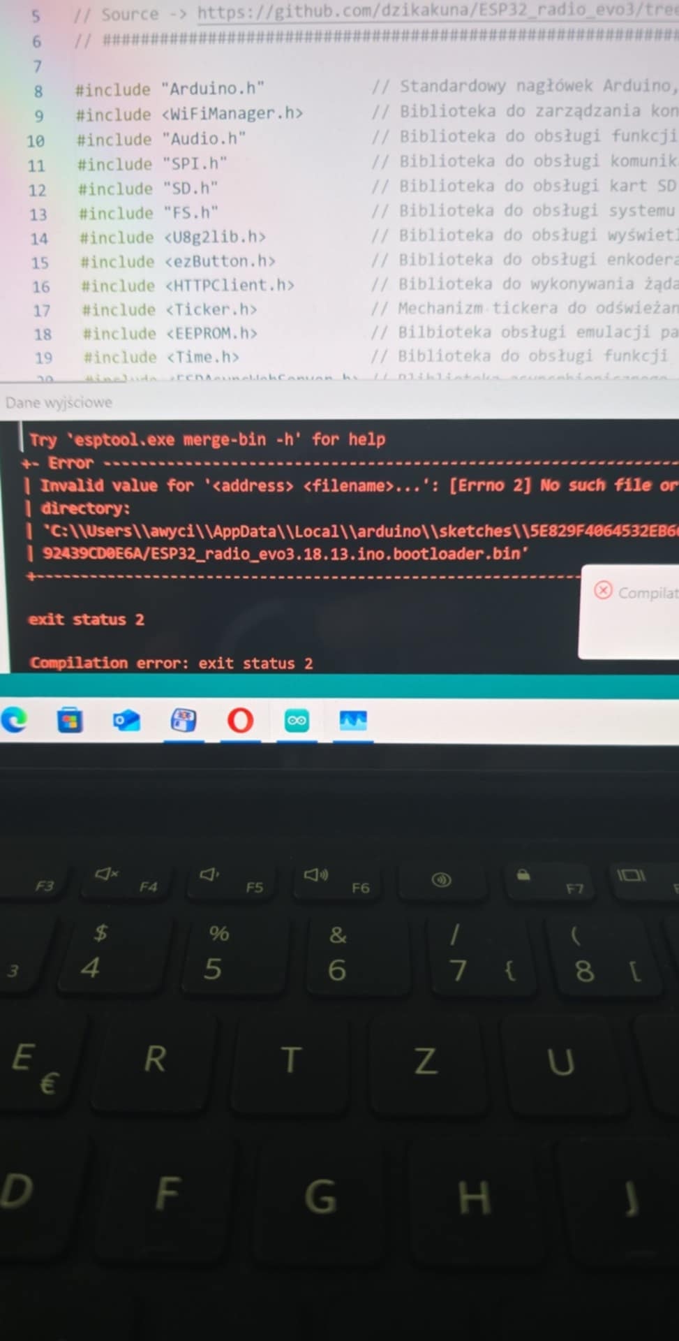

    Has anyone encountered something like this. A buddy is getting this error.
    • Internet radio and audio file player on ESP32-S3 f36d885f-7ae2-45e3-b1a7-ba0f924627fb.jpg (91.01 KB) You must be logged in to download this attachment.

    @nouki have a colleague go to your drive to the folder:
    c:username<user_name>appDataLocalAppData.
    and will delete all folders in that location. These are temporary files - it is likely that something has been saved there incorrectly.
    If you can't see the folder then have it turn on show hidden folders.
    After deleting the files, it's good to restart the Arduino IDE and start uploading again.

    Ok, gentlemen, don't hit me... I thought it was basically the same ... project, because both here and there the same board and dac and only somehow the screens differ. Is there then a chance to implement a colour display into this project?
  • #1280 21644362
    DJCheester
    Posts: 2049
    Help: 75
    Rate: 949
    To use a different (colour) display, you would first need to see if it is supported by the u8g2lib library used in this project, if so, you would need to define the pins for that display in your software and use a different connection (hardware), but that's not the end of the story, the hardest part in my opinion is to rewrite the code (lines) that are responsible for the positioning of the lettering and display elements, and modify it with colour information. The question is whether these other displays have the same or a different resolution, because if different, then you have to arrange it somehow sensibly on the screen. As currently (in my opinion) nicely done by colleague Robgold.
    A difficult task (at least for me), but not impossible. If I have written something wrong, please correct others (more experienced) - I am also learning some things.
    Best regards...

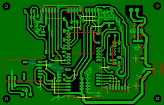

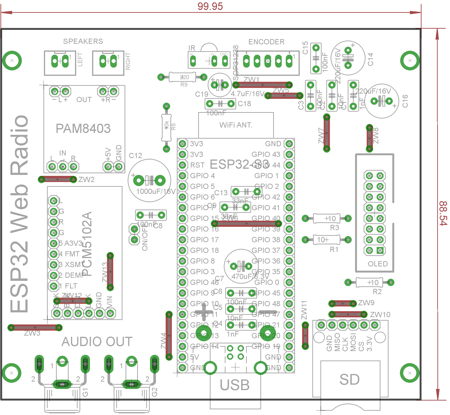

    Might be useful - version for SSD1322.
    PCB layout design with multiple signal traces, version for SSD1322 display
    • pcb_oled.zip (76.1 KB) You must be logged in to download this attachment.
  • #1285 21653510
    Slawek K.
    Level 35  
    Posts: 3015
    Help: 259
    Rate: 1299
    It is not possible to make a two-layer ? these bridges look unprofessional to say the least, since nowadays in general few people make the tiles themselves and most order from China.
  • #1286 21653527
    AdamC
    Posts: 1006
    Help: 138
    Rate: 242
    pepepe1 posted the pcb and you should rather thank him and here you are complaining.
    I suggest you do a professional design and post instead of complaining.
    Which despite good intentions and a professional pcb will not save you from the disgruntled.

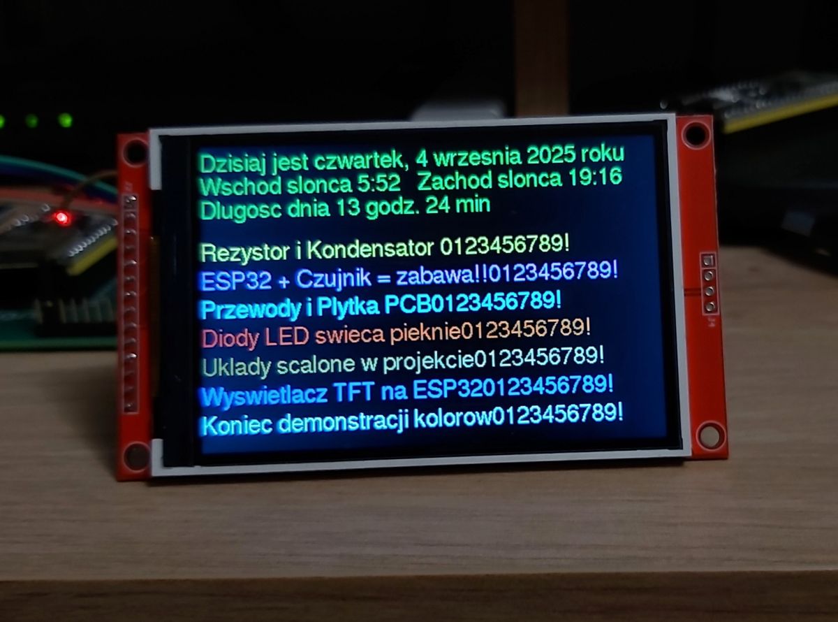

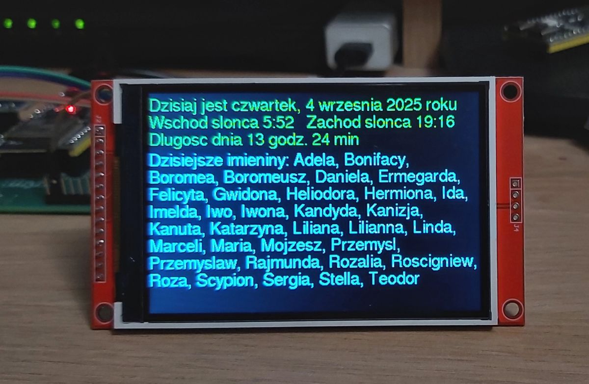

    I've taken on another version of the project, this time on the ILI9488 display, the FreeSans12pt7b font fits me quite nicely here.
    Can someone please adapt the header file with bitmaps of Polish uppercase and lowercase diacritical characters Ą Ć Ę Ł Ń Ó ¶ Ź Ą ć ń ó ¶ ź ż
    so that it can be handled by Adafruit_GFX.h ?
    file attached
    Code: C / C++
    Colorful Polish text displayed on a TFT ILI9488 screen .
    The calendar card is in abundance today:
    Color LCD ILI9488 displays date, sunrise and sunset info, and name days

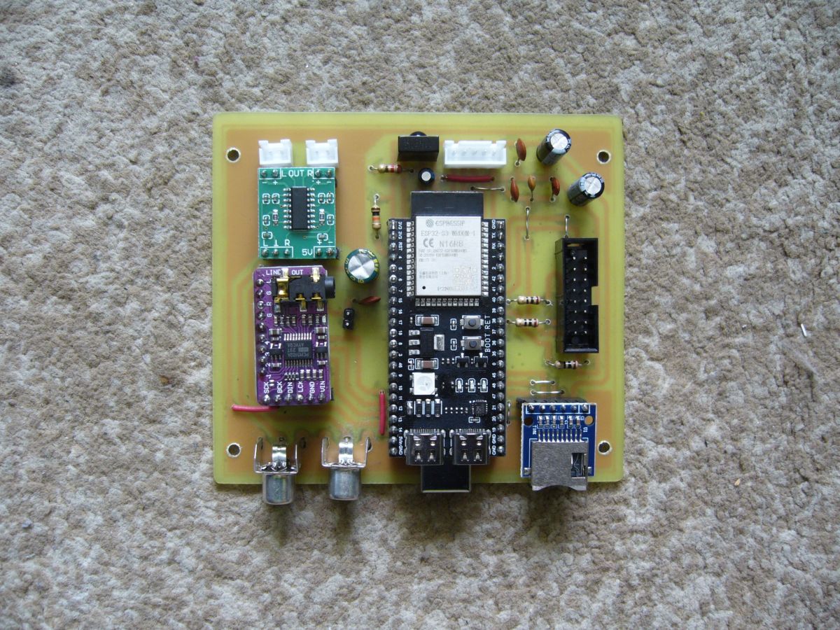

  • #1289 21653866
    pepepe1
    Posts: 72
    Rate: 128
    >>21653753 the board is to do in half an hour and difficult to mess up: large, wide paths etc. As one alternative to put together on a factory development board, or a factory ordered one from the Chinese.
    I will try a professional approach to the case - inspiration:
    Black electronic panel with wooden base and analog voltage meters .
  • #1290 21653900
    DJCheester
    Posts: 2049
    Help: 75
    Rate: 949

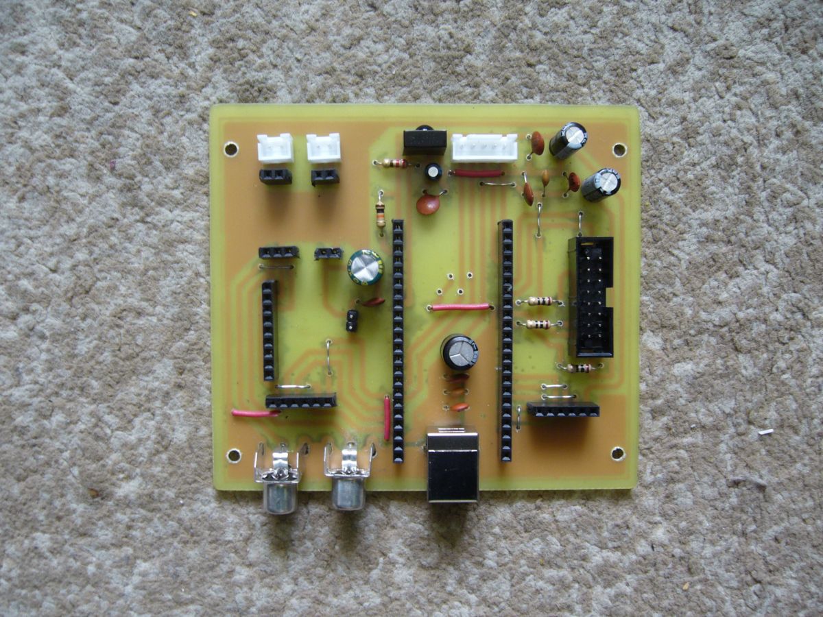

    Slawek K. wrote:
    AdamC wrote:
    pepe1 posted the pcb and rather should be thanked and here the complaining.
    I suggest you make a professional design and post it instead of complaining.
    A colleague is confusing complaining with constructive comments.
    Greetings
    Hello I am in favour of developing the project and thanks to colleague pepepe1 for adding something of his own to the project, if someone can do better what is the harm in making a project and posting it.
    Slawek K. wrote:
    It is not possible to make a double layer ? these bridges look unprofessional to say the least, since nowadays in general few people make the boards themselves and most order from China.
    Sławek colleague I do bridges on boards in the version rewired, it has its advantages because I still do the boards with a thermal transfer and as pepepe1 writes it is half an hour and the board is ready.
    ESP32 Web Radio PCB layout with labeled components and jumpers .
    PCB layout view with ESP32, PAM8403, WM5102A components and signal traces
    The board under the Robgold colleague's version of the radio checked (Gerber attached) an electrode colleague ordered in China from this Gerber and everything works and fits.
    If you are doing a thermal transfer then one side is enough and you do the jumpers with wires and if you decide to order from China then the jumpers are factory made on the second layer so no need to wire.
    Also attached is a brd file you can generate yourself a pdf file for thermal transfer or use the one in the attachment
    This is how the radio looks assembled and running on the board
    Assembled PCB with ESP32 module and various electronic components
    Assembled single-sided PCB with electronic components on a carpet
    Regards ...
