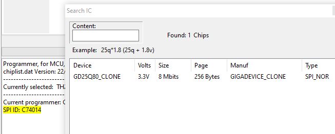

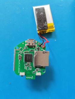

    today's arrival - another XF16 A9 - same PCB as before, the same 1mb flash chip markings on recent A9 above - CF TJ25Q08M
    PCB with electronic components and a lithium-polymer battery on a blue background. Printed circuit board with electronic components, micro USB socket, ribbon connector, and microphone.
    familiar flash ID C74014. Neo detection name from my own import.xml
    Screenshot of memory programmer software showing detected GD25Q80_CLONE chip at 3.3V.
    dumps https://github.com/openshwprojects/FlashDumps...mits/f4149235555af79af280bf61abb642e41ac55f0d
    HxD says UART and SPI identical

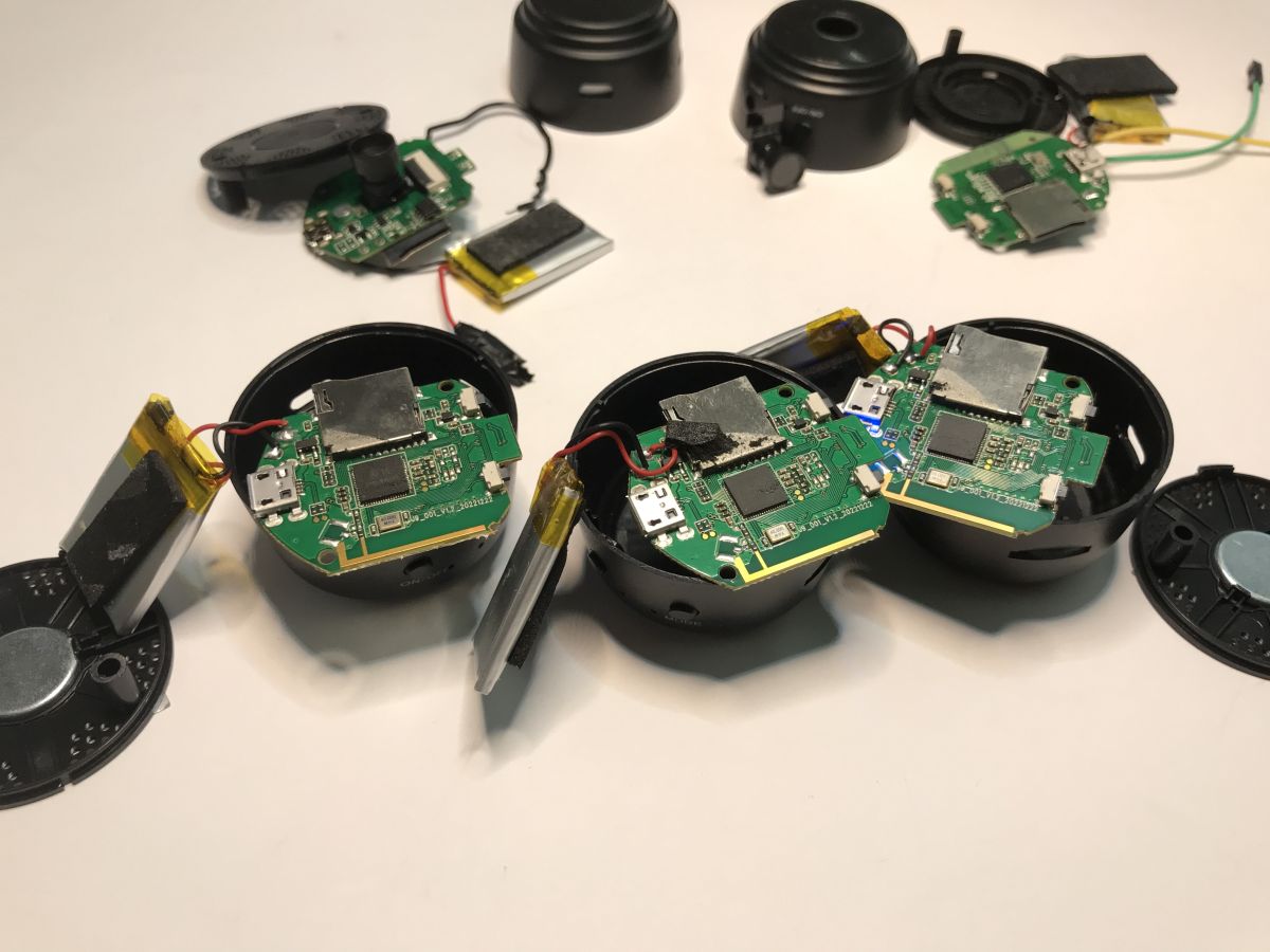

    I've got 3 today, all the same version as you:
    Three disassembled IP cameras with exposed electronics and Li-Po batteries.
    Three disassembled camera modules with visible PCBs and lenses, along with housing parts and batteries on a white surface.
    Close-up of a camera circuit board with visible lens, T25S80 flash memory chip, and connectors.
    Camera module with lens, circuit board, and connectors shown in close-up.
    Close-up of a camera circuit board with lens, T25S80 flash chip, and a lit blue LED.

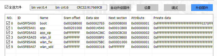

    Well, it seems it's hard for me to get another version. Maybe we should try something. For example... take offsets from here:
    Screenshot of a firmware configuration utility, showing details of six binary sections with addresses, sizes, and attributes.
    and enter them to OpenXR872\project\image_cfg\image.cfg
    Also, would that camera boot from 1MB flash but non-factory one? I mean, take another 1MB flash chip from a laptop or something, flash OBK to it, will it boot?

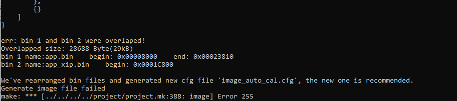

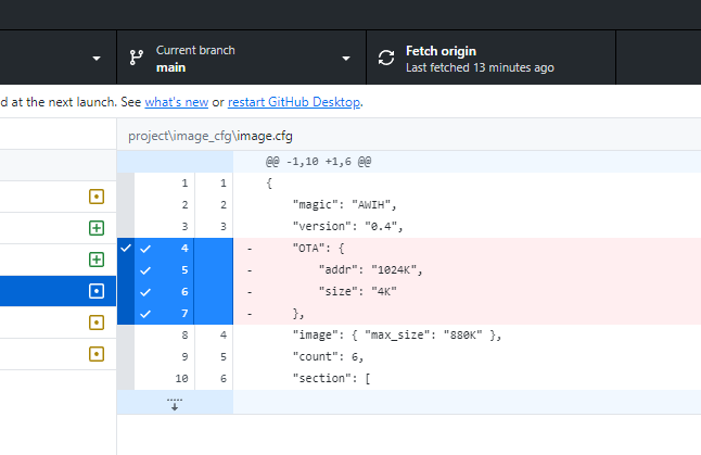

    Ok I can't do the same format as in factory firmware, unless I turn off some things
    Screenshot showing a diff of the image.cfg configuration file, highlighting changes in flash_offs values across several sections.
    Screenshot of a console error message showing bin file overlap during firmware image generation.
    Added after 3 [minutes]:
    Wait, why our image cfg has OTA at offset 1024?
    A fragment of a JSON configuration file with the OTA section highlighted, showing address 1024K and size 4K.
  • #125 21530544
    Posts: 5208
    Help: 446
    Rate: 914
    oh. that sounds problematic if BL is checking there..?
  • Partition overlap caused image generation failure

    I don't know, I would expect at least an error message on UART.

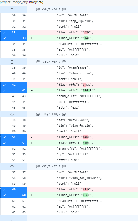

    I am trying to enter partition table as in backup, but after moving app_xipapp_xip.bin futher down in flash, I got this:
    err: bin 4 and bin 5 were overlaped!
    Overlapped size: 6708 Byte(7kB)
    bin 4 name:wlan_fw.bin    begin: 0x000CA800    end: 0x000D2A34
    bin 5 name:wlan_sdd_40M.bin    begin: 0x000D1000
    We've rearranged bin files and generated new cfg file 'image_auto_cal.cfg', the new one is recommended.
    Generate image file failed

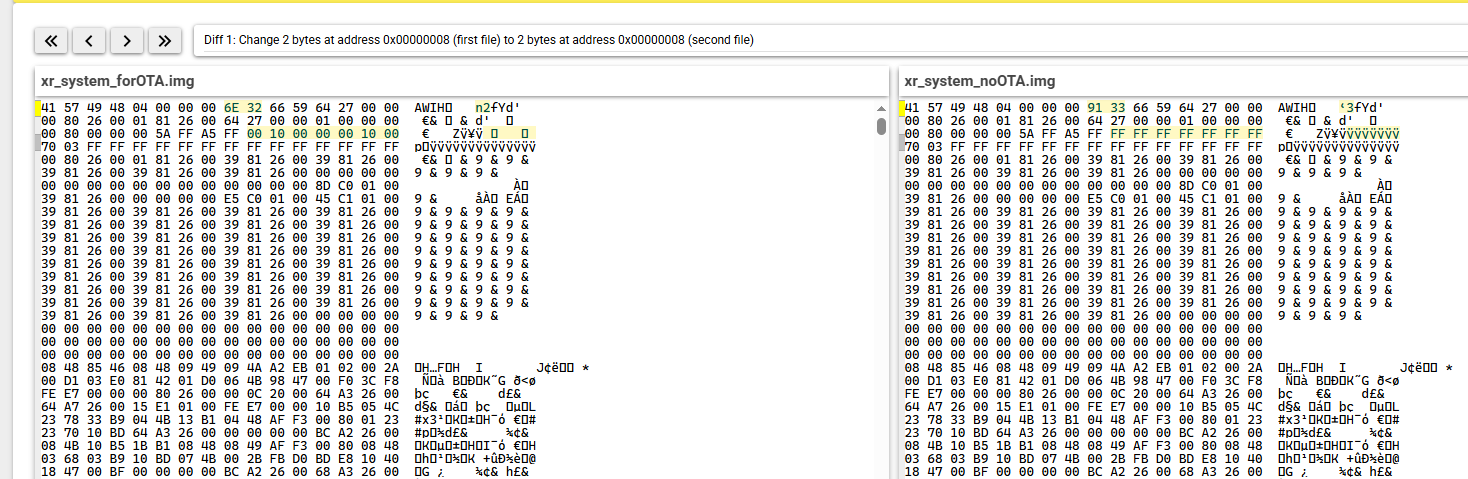

    I will give up with offsets for now, and I will give you build without OTA to check.
    Added after 8 [minutes]:
    Attaching two builds, second with OTA section removed:
    Screenshot of a code editor showing differences in a configuration file.
    Comparison of two binary files in a hex editor, highlighting byte-level differences.
    • to_ota_or_not_to.zip (886.5 KB) You must be logged in to download this attachment.
  • OTA image fails on 1 MB flash
    #127 21530564
    Posts: 5208
    Help: 446
    Rate: 914
    ota was the problem.
    to be clear, xr_system_noOTA.img boots on 1mb flash

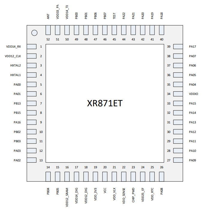

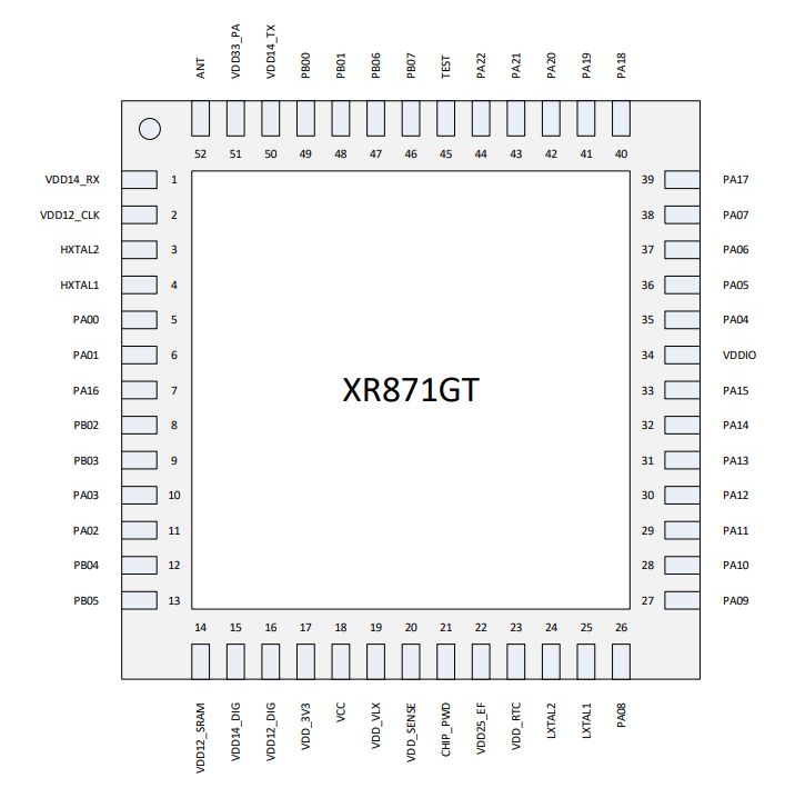

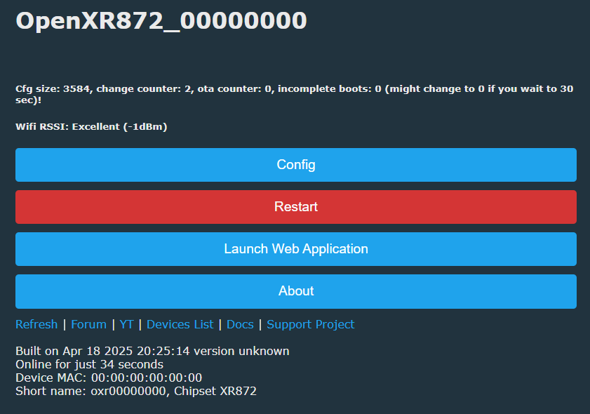

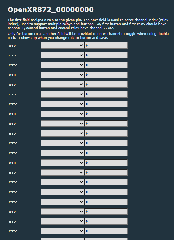

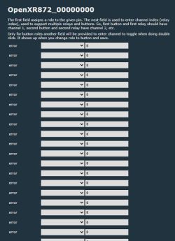

    not sure what should come first tbh, I guess all the pins? How would it work? Configure the most number of pins for XR872 and then see which control pins on XF16?
    Screenshot of a device configuration panel with multiple error fields and dropdown menus.
    RSSI. Powersave, ADC/battery, loads of things I guess.
    Also do you build for 2mb+ with OTA, assuming most XR871s are larger, but provide a no-OTA XF16 1mb version too?
    OpenXR872 device control panel with configuration, restart, and web app launch buttons.

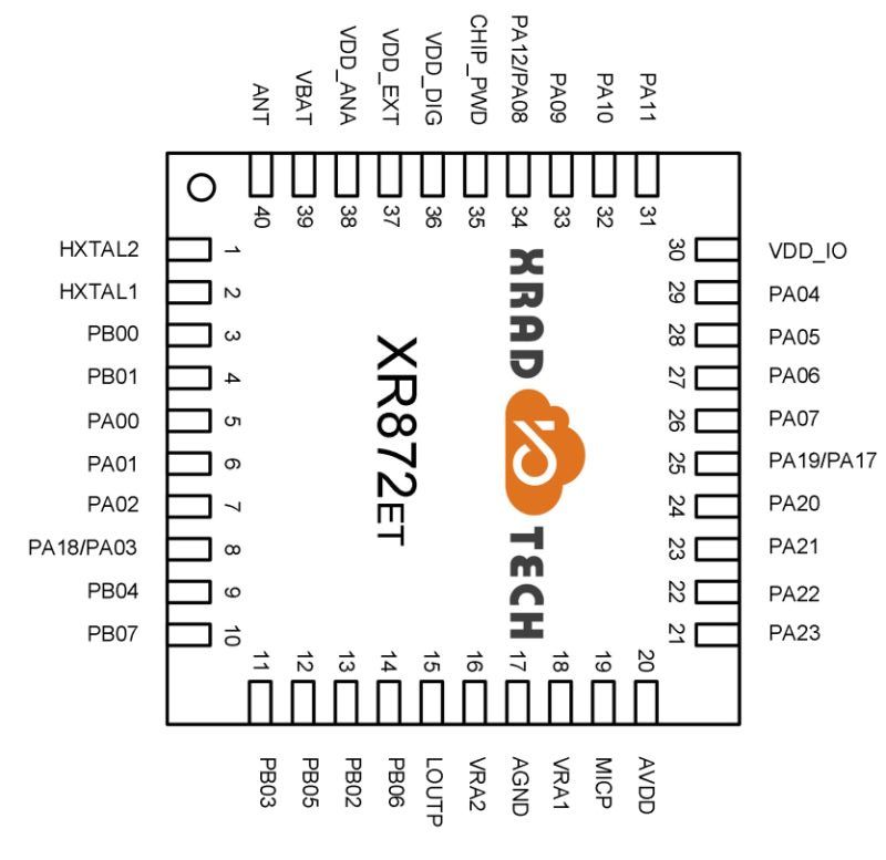

  • Camera pinout and sensor match questions
    #130 21530761
    Posts: 14754
    Rate: 12876

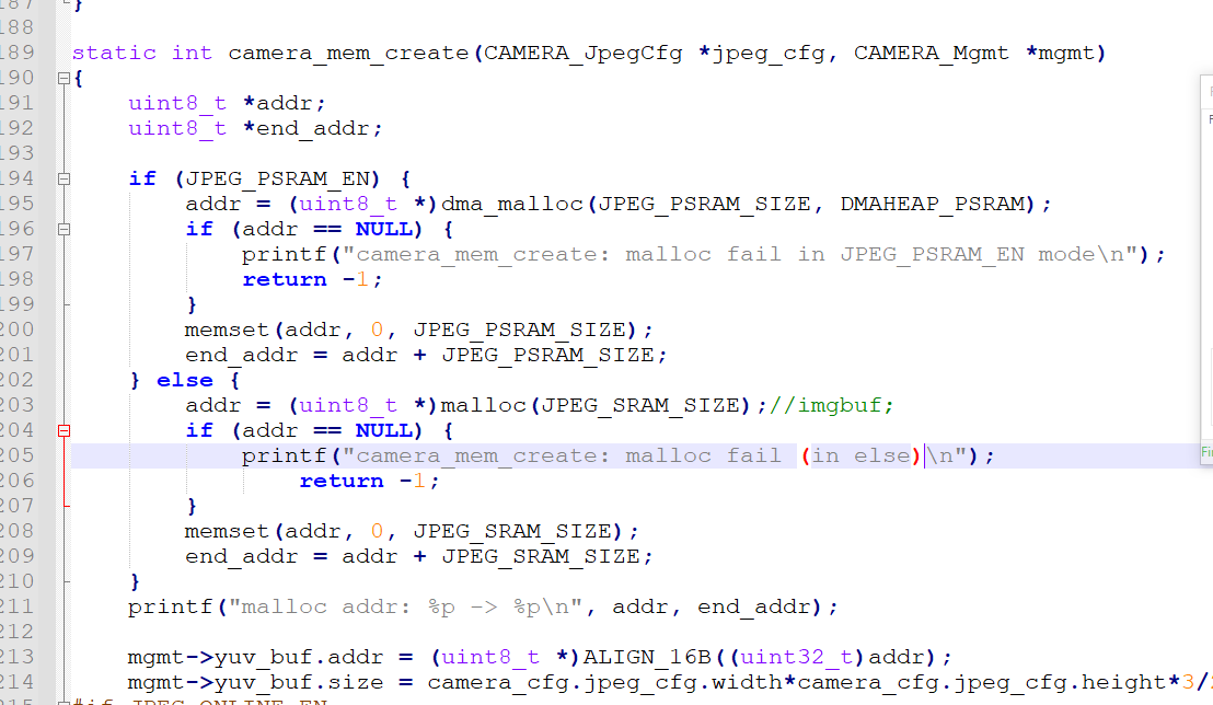

    I've been also wondering whether this driver matches the camera we have:
    https://github.com/search?q=repo%3Aopenshwprojects%2FOpenXR872%20camera&type=code
    https://github.com/openshwprojects/OpenXR872/...76418953/project/common/cmd/cmd_camera.c#L153
    Are those pins matching our board?
    Code: C / C++
    Do these sensors match?
    Code: C / C++

  • #132 21530863
    Posts: 14754
    Rate: 12876
    do we have GC0329C or GC0328c datasheet?
  • #133 21530893
    Posts: 5208
    Help: 446
    Rate: 914
    nope. only GC0308

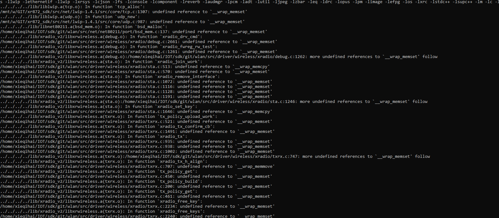

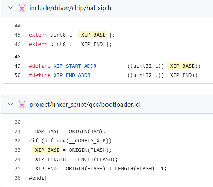

    Hm, this is the sample for camera, it's called jpeg:
    tester@DESKTOP-7SD9MUK:/mnt/w/GIT/OpenXR872/project/example/jpeg/gcc$ make image
    Compilation error in terminal with multiple references to undefined function `__wrap_memset`.
    This doesn't look hard to fix
    I added to main.c:
    Code: C / C++
    only those errors remain:
    ../../../../lib/libchip.a(hal_spi.o): In function `HAL_SPI_Close':
    /mnt/w/GIT/xr872_sdk/src/driver/chip/hal_spi.c:929: undefined reference to `HAL_DMA_Stop'
    /mnt/w/GIT/xr872_sdk/src/driver/chip/hal_spi.c:930: undefined reference to `HAL_DMA_Stop'
    ../../../../lib/libchip.a(hal_spi.o): In function `HAL_SPI_Receive':
    /mnt/w/GIT/xr872_sdk/src/driver/chip/hal_spi.c:1029: undefined reference to `HAL_DMA_Stop'
    ../../../../lib/libchip.a(hal_spi.o): In function `HAL_SPI_Transmit':
    /mnt/w/GIT/xr872_sdk/src/driver/chip/hal_spi.c:1109: undefined reference to `HAL_DMA_Stop'
    ../../../../lib/libchip.a(hal_dcache.o): In function `HAL_Dcache_IsCacheable':
    /mnt/w/GIT/xr872_sdk/src/driver/chip/hal_dcache.c:58: undefined reference to `__XIP_BASE'
    /mnt/w/GIT/xr872_sdk/src/driver/chip/hal_dcache.c:58: undefined reference to `__XIP_END'
    ../../../../lib/librom.a(rom_core.o):(.ram_table+0x138): undefined reference to `__XIP_BASE'
    ../../../../lib/librom.a(rom_core.o):(.ram_table+0x13c): undefined reference to `__XIP_END'
    ../../../../lib/xradio_v2/libwlan.a(wlan.o): In function `wlan_ap_sta_info':
    /home/xieqihai/IOT/sdk/git/wlan/src/net/wlan/wlan.c:452: undefined reference to `wpa_ctrl_request'
    ../../../../lib/xradio_v2/libwlan.a(wlan_ctrl.o): In function `wlan_start':
    /home/xieqihai/IOT/sdk/git/wlan/src/net/wlan/wlan_ctrl.c:300: undefined reference to `wpas_start'
    /home/xieqihai/IOT/sdk/git/wlan/src/net/wlan/wlan_ctrl.c:306: undefined reference to `hostapd_start'
    /home/xieqihai/IOT/sdk/git/wlan/src/net/wlan/wlan_ctrl.c:314: undefined reference to `wpa_ctrl_open'
    ../../../../lib/xradio_v2/libwlan.a(wlan_ctrl.o): In function `wlan_stop':
    /home/xieqihai/IOT/sdk/git/wlan/src/net/wlan/wlan_ctrl.c:329: undefined reference to `wpas_stop'
    /home/xieqihai/IOT/sdk/git/wlan/src/net/wlan/wlan_ctrl.c:335: undefined reference to `hostapd_stop'
    /home/xieqihai/IOT/sdk/git/wlan/src/net/wlan/wlan_ctrl.c:341: undefined reference to `wpa_ctrl_close'
    collect2: error: ld returned 1 exit status
    make: *** [../../../../project/project.mk:327: jpeg.axf] Error 1
    I can see HAL_DMA_Stop in code, why would it be missing https://github.com/search?q=repo%3Aopenshwprojects%2FOpenXR872%20HAL_DMA_Stop&type=code
    _XIP_BASE is undefined probably because of the lack of _XIP_BASE
    Fragments of two code files showing the definitions and assignments of XIP addresses in C and linker script.
    Added after 5 [minutes]:
    Ok another idea. I don't have that much time for playing, but maybe I could just put camera calls in OBK project?
    Code: C / C++
    Well, it actually compiled with test call to HAL_GC0328C_Suspend - no linker errors.
  • #135 21530909

  • #136 21530910
    Posts: 14754
    Rate: 12876

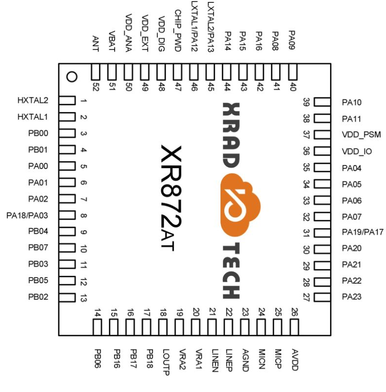

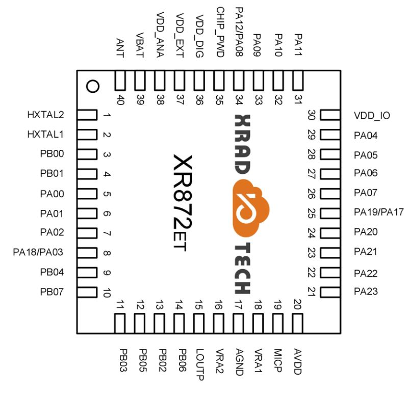

    Ah, we don't actually know the GPIO pinout of XF16?
  • #137 21530911
    Posts: 5208
    Help: 446
    Rate: 914
    no! only XR872
    I've tried quite a lot to :(

  • Memory allocation likely fails in camera_mem_create
    #142 21530934
    Posts: 14754
    Rate: 12876
    Wait I will add better printfs:
    Screenshot showing a C source code snippet implementing a memory allocation function for a camera.
    Added after 6 [minutes]:
    It probably fails here:
    Code: C / C++
    I don't see any external PSRAM chips so it probably uses heap path. So it fails to alloc JPEG_SRAM_SIZE bytes.
    JPEG_SRAM_SIZE can have different values:
    https://github.com/search?q=repo%3Aopenshwprojects%2FOpenXR872%20JPEG_SRAM_SIZE&type=code
    In my sample I used:
    Code: C / C++
    180kB, but here they use 100kB:
    https://github.com/openshwprojects/OpenXR872/...f76418953/project/common/cmd/cmd_camera.c#L67
    Let's try with 100kB
    Better logging file attached:
    • notsure4.zip (397.62 KB) You must be logged in to download this attachment.

  • XR872 camera capture fails from heap exhaustion
    #146 21530962
    Posts: 14754
    Rate: 12876
    Well the alloced buffer is obviously to small for target size. I didn't check that, I just trusted the size from the camera sample and it's obviously too small.
    Ok I attached one camera, I will give it few more tries on my side
    Added after 12 [minutes]:
    Im confused.
    size 460800
    [cmd ERR] camera_mem_create():167, aadr exceeded
    for 640 x 480 this code needs 460 800 RAM, but XR872 is said to have 416KB SRAM. It supports external PSRAM, but it's not present in A9 cameras. So, how do they take 640x480 image there?
    Added after 4 [minutes]:
    __CONFIG_JPEG: Required option. Enables the JPEG module and must be enabled.
    __CONFIG_JPEG_SHAR_SRAM_64K: Optional. Configures the amount of memory to allocate for JPEG usage. This option must be enabled when the image height exceeds 576 or the width exceeds 720.
    __CONFIG_PSRAM: Optional. Enables PSRAM in the project. Must be enabled if the project uses PSRAM functionality.
    __CONFIG_PSRAM_CHIP_OPI32: Optional. Configures the type of PSRAM.
    Added after 28 [minutes]:
    el! @ 5255 sec
    Will call my_camera_init_exec
    Will call camera_mem_create
    camera_mem_create will malloc
    heap exhausted, incr 122888, 0x258674 >= 0x257c00
    camera_mem_create: malloc fail 122880
    Will call HAL_CAMERA_Init
    [HAL WRN] I2C wait semaphore failed, i2c ID 0
    GC0328C sccb read error
    GC0328C Init error!!
    [CAMERA ERR] HAL_CAMERA_Init():362, sensor config fail
    [cmd ERR] my_camera_init_exec():199,  init fail
    Will call my_camera_cap_one_image_exec
    Will call HAL_CAMERA_CaptureImage
    [CAMERA ERR] HAL_CAMERA_CaptureImage():437, not init
    [cmd ERR] my_camera_cap_one_image_exec():216, cap one image failed
    Will call my_camera_deinit_exec
    [CAMERA ERR] HAL_CAMERA_DeInit():386, not init
    Hello wordsald! @ 9322 sec
    Hello wordsald! @ 10322 sec
    Added after 31 [minutes]:
    Had to do SPI recover, interestingly enough NeoProgrammer detected:
    SPI ID: 5E3214
    Currently selected:  ZB25WD80 [3.3V] 8 Mbits, 1 Mbytes
    Added after 11 [minutes]:
    Tried second I2C:
    [HAL WRN] I2C wait semaphore failed, i2c ID 1
                                                                          GC0328C In
    it error!!
  • Yuv buffer unnecessary in online JPEG mode

    We need to find GPIO of the camera. Is XR871 GPIO matching XR872:?
  • #149 21531043
    Posts: 5208
    Help: 446
    Rate: 914
    hmm. no, it seems...
    Pinout diagram of the XR871GT integrated circuit in LQFP package. Pinout diagram of the XR871ET integrated circuit in a QFN52 package.
    Top view of the XR872ET chip pinout diagram from XRAD Tech with labeled pins. Pinout diagram of the XR872AT microcontroller with labeled pins.
  • #150 21531055
    Posts: 14754
    Rate: 12876
    Well, XTAL (oscillator) pin positions seems to match, so why do you think that XR872 pinout does not match XF16? Pin 52 (antenna) also seem to match.
