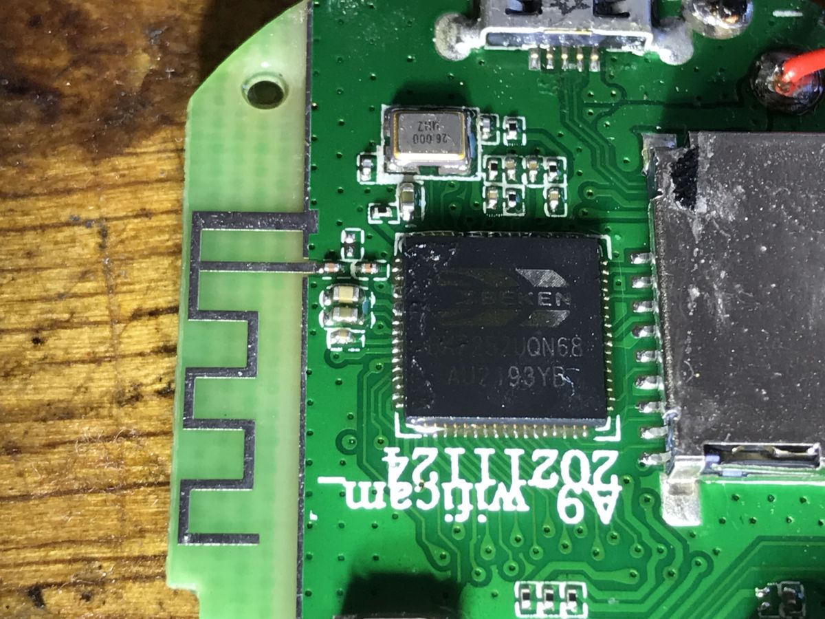

    Ah, I see. Maybe I misunderstood. I was under the impression that you are flashing incorrect factory image. Strange.
  • #92 21524807
    Posts: 5052
    Help: 438
    Rate: 893
    yes very weird. need someone else with an A9 to have a go.
  • #93 21524831
    Posts: 14611
    Help: 654
    Rate: 12624
    I think I still have those two pads near the MCU shorted. The ones we suspected may be needed for bootloader. But it shouldn't change anything. And "Hello world" ran for you, right?
  • #94 21524835
    Posts: 5052
    Help: 438
    Rate: 893
    nope. nothing but factory runs for me

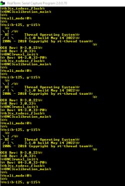

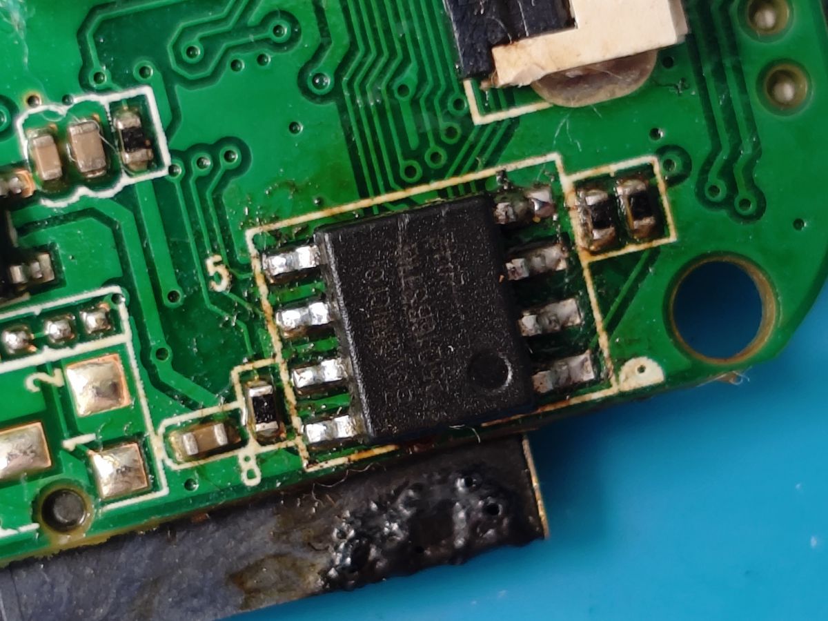

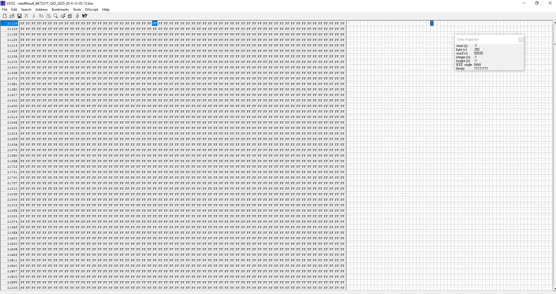

    I remember that some time ago you reported you got this "invalid size" message:
    divadiow wrote:
    second bin gives me this again
    Do you get anything like that on OBK port?
    Do you have any other flash chip? Can you check if original firmware and OBK would run from other flash chip? It should not matter, but still....
  • #96 21525075
    Posts: 5052
    Help: 438
    Rate: 893

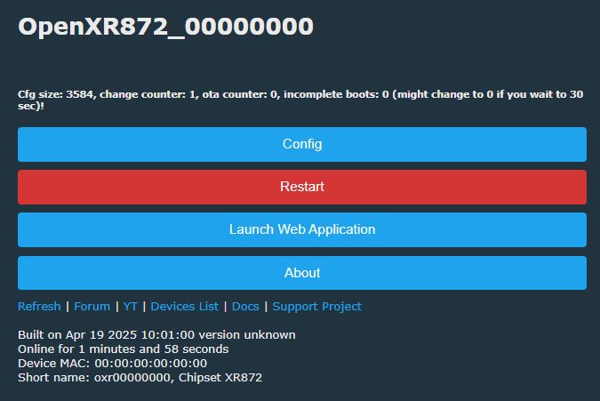

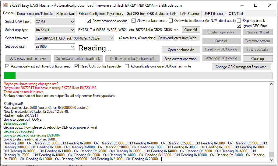

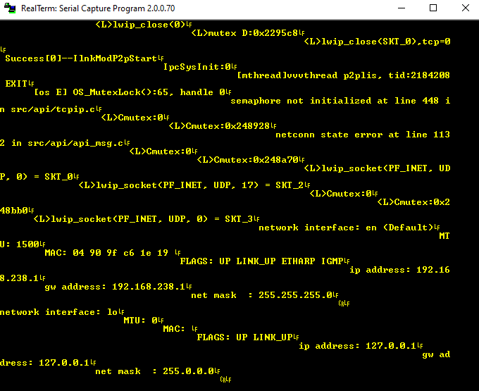

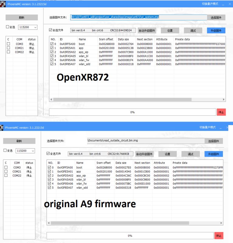

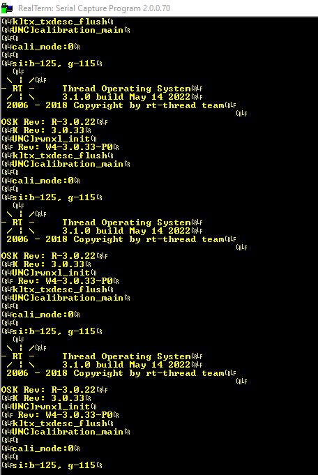

    no output ever on OBK port or demos. only ever factory boots.
    yes. I have tried both 1mb flash chips from 2x A9 cams and I have just this second flashed your factory dump to a Boya 2mb chip and it boots. I am about to try OBK port to 2mb over uart to see if it's any different.
    first boot of your dump:
    Added after 6 [minutes]:
    did you ever capture OBK boot log on your A9? I am curious about any CPU clock or crystal differences.
    My physical oscillator is 40 Mhz and I note this in the factory boot log for me
    Added after 15 [minutes]:
    maybe nevermind. I see yours is the same from Hello, World demo boot log https://www.elektroda.com/rtvforum/topic4074636-60.html#21523195
    oh ffs. 2mb flash chip is fine.

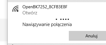

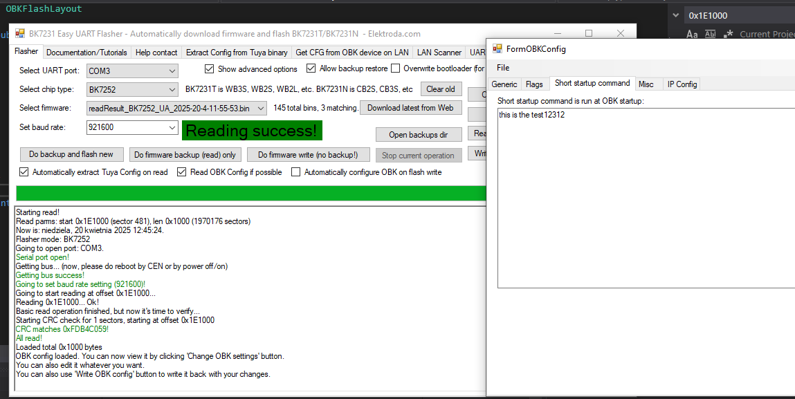

    Screenshot of the OpenXR872 interface showing buttons labeled “Config,” “Restart,” “Launch Web Application,” and “About.”
    and OBK boot to AP

    divadiow wrote:
    oh ffs. 2mb flash is fine.

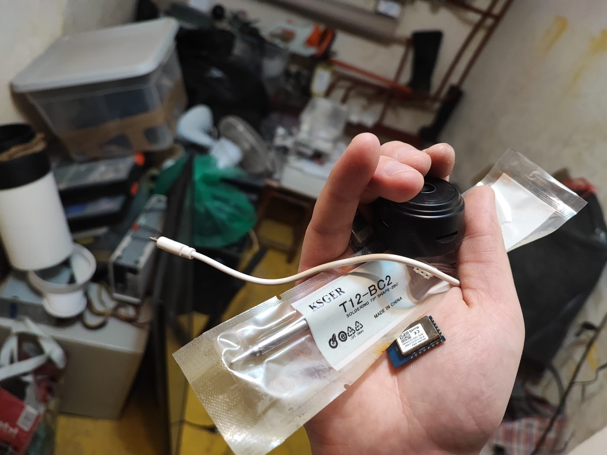

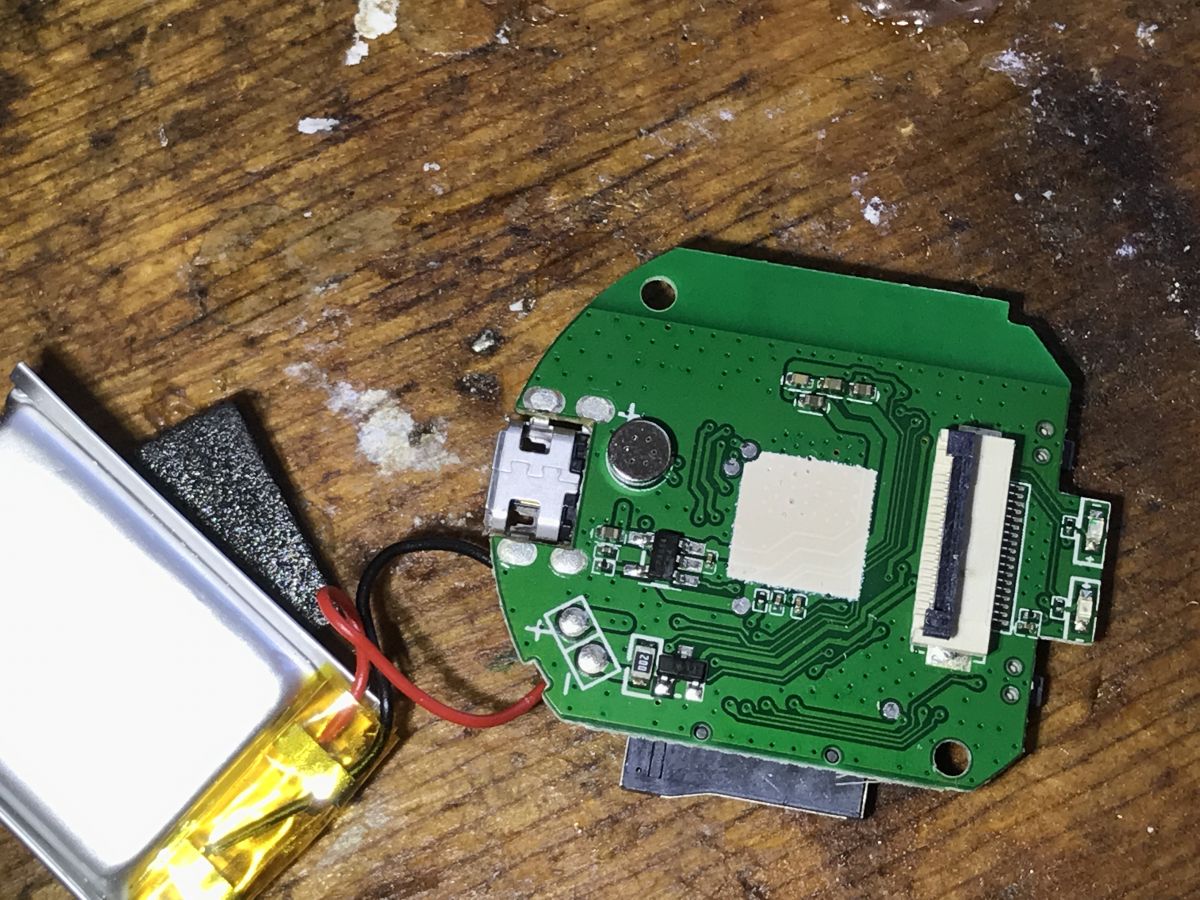

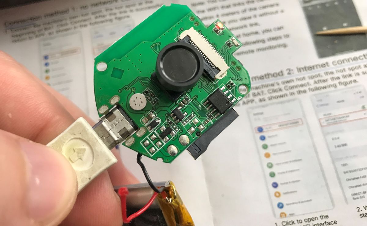

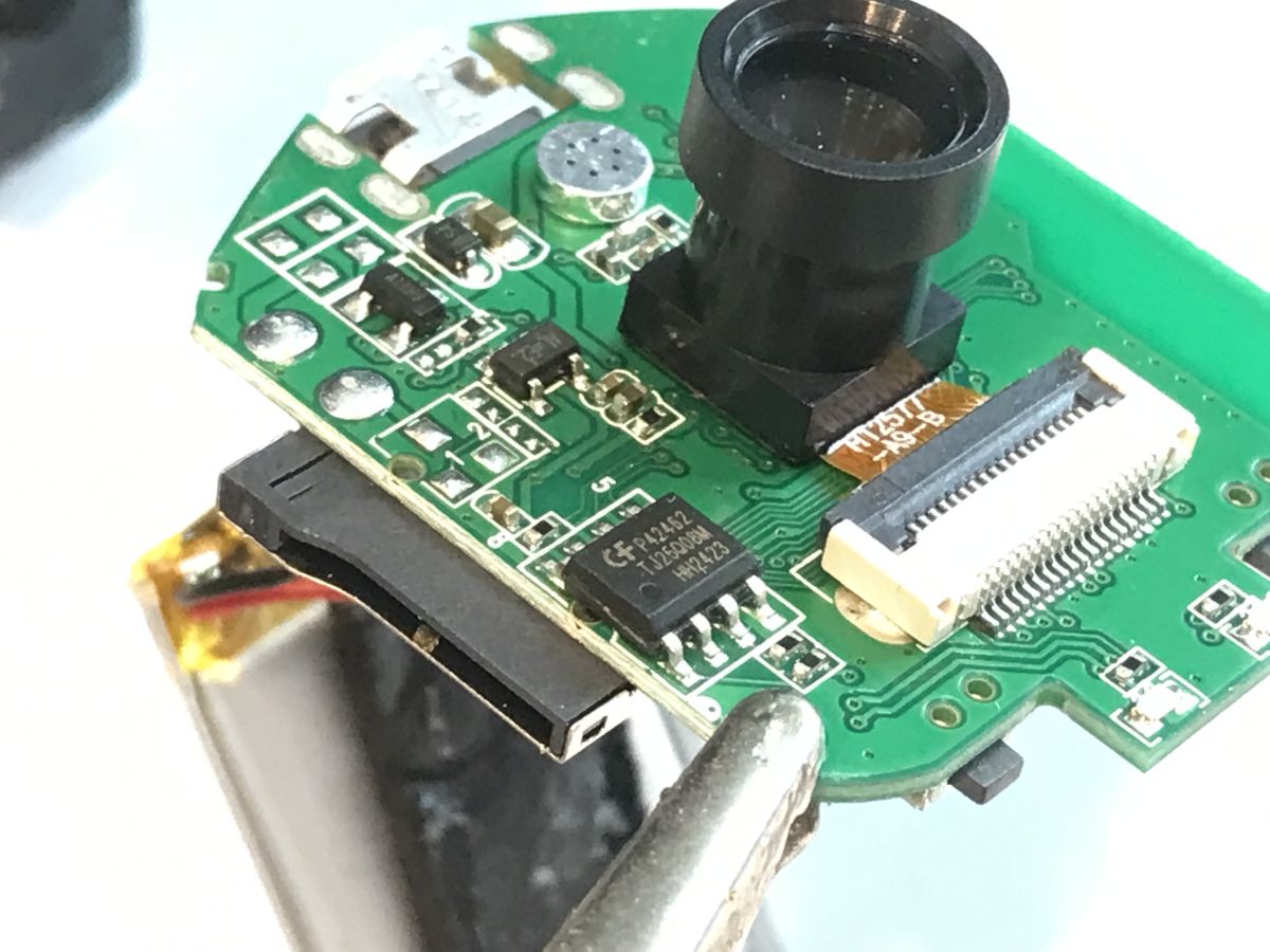

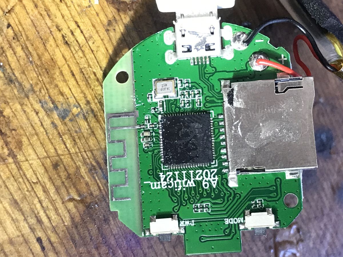

    Are you saying that you transplanted flash to 2MB chip (other chip) and then OBK works? Well, it's not good, we were hoping to be able to run OBK out of the box...

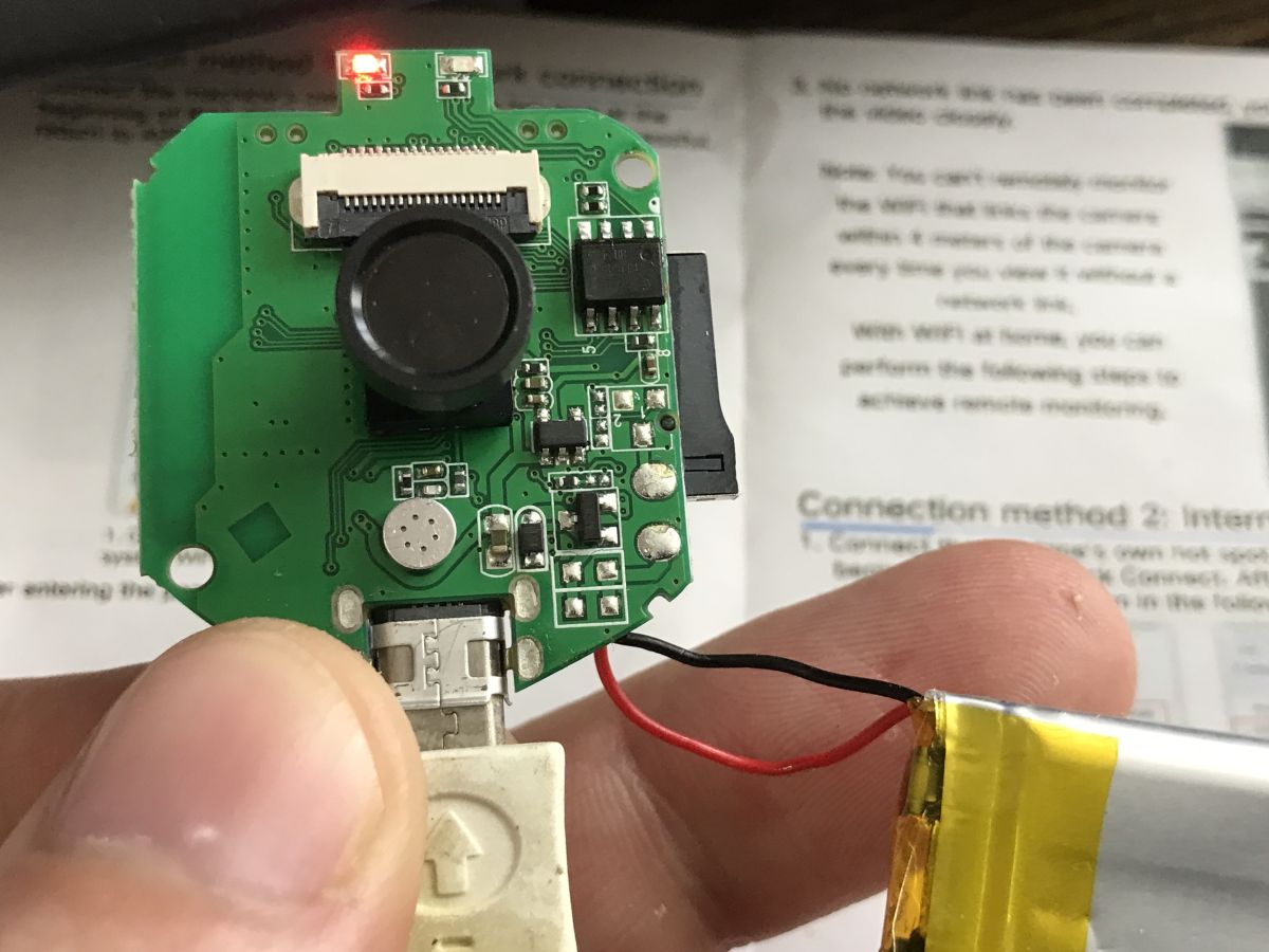

    I've found another A9 camera, an old model, in the basement:
    A hand holding a KSGER T12-BC2 soldering tip, a black electronic component, and a small electronic module.
    I will check it in a moment
  • #98 21525111
    Posts: 5052
    Help: 438
    Rate: 893
    correct. 2mb chip soldered to A9 right now boots OpenXR872
    Close-up of a green printed circuit board with a visible black integrated circuit and copper traces.
    maybe you have BK7252 after all if it's old..

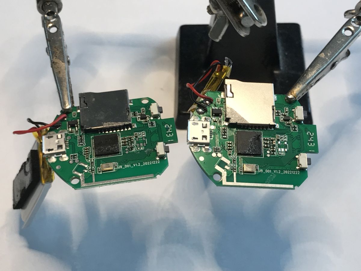

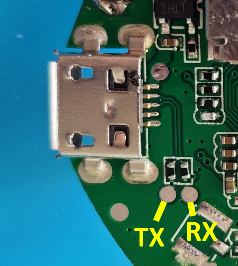

    It's BK7252, do you happen to know the pinout? I can't find log output, but again, maybe flash port is different than log...
    Close-up of a green printed circuit board with visible electronic components and a PCB antenna.
    Close-up of a circuit board with electronic components, micro USB connector, and microSD slot.
    Printed circuit board with micro USB port, connector, and Li-Po battery attached.
    Added after 4 [minutes]:
    Looks like I have: https://github.com/daniel-dona/beken7252-opencam/issues/7
    Added after 35 [seconds]:
    BK7252UQN68

    boot log:
    - RT -     Thread Operating System
     / | \     3.1.0 build May 14 2022
     2006 - 2018 Copyright by rt-thread team
    OSK Rev: R-3.0.22
    SDK Rev: 3.0.33
    [FUNC]rwnxl_init
    IP Rev: W4-3.0.33-P0
    [bk]tx_txdesc_flush
    [FUNC]calibration_main
    rfcali_mode:0
    tssi:b-125, g-115
    xtal_cali:25
    [FUNC]ps_init
    [FUNC]func_init_extended OVER!!!
    start_type:0
    lwIP-2.0.2 initialized!
    igmp_mac_filter add 224.0.0.1 01:00:5E:00:00:01
    beken wlan hw init
    drv_pm_init
    [I/FAL] RT-Thread Flash Abstraction Layer (V0.4.0) initialize success.
    msh />cmd 1:3
    cmd 1:3
    cmd 1:3
    SD File System initialzation failed!
    [I/FAL] The FAL MTD NOR device (filesystem) created successfully
    LFS Filesystem initialized! filesystem ==> /flash0
    bk_misc_check_start_type=0,gDcOrBattery=1
    cVersion=1_1_2_36
    cVersion=1_1_2_36
    00000000: FF FF FF FF FF FF FF FF FF FF FF FF FF FF FF FF  ................
    00000010: FF FF FF FF FF FF FF FF FF FF FF FF FF FF FF FF  ................
    00000020: FF FF FF FF FF FF FF FF FF FF FF FF FF FF FF FF  ................
    00000030: FF FF FF FF FF FF FF FF FF FF FF FF FF FF FF FF  ................
    00000040: FF FF FF FF FF FF FF FF FF FF FF FF FF FF FF FF  ................
    00000050: FF FF FF FF FF FF FF FF FF FF FF FF FF FF FF FF  ................
    00000060: FF FF FF FF FF FF FF FF FF FF FF FF FF FF FF FF  ................
    00000070: FF FF FF FF FF FF FF FF FF FF FF FF FF FF FF FF  ................
    00000000: 7B 22 4D 41 43 5F 41 44 44 52 22 3A 22 63 30 30  {"MAC_ADDR":"c00
    00000010: 31 30 32 30 30 30 30 31 31 22 2C 22 50 52 4F 44  102000011","PROD
    00000020: 55 43 54 5F 4B 45 59 22 3A 22 42 41 54 31 38 30  UCT_KEY":"BAT180
    00000030: 38 32 33 49 4F 5A 52 43 22 2C 22 50 52 4F 44 55  823IOZRC","PRODU
    00000040: 43 54 5F 53 45 43 52 45 54 22 3A 22 38 39 79 65  CT_SECRET":"89ye
    00000050: 79 69 75 72 79 69 65 75 72 79 75 65 69 75 72 22  yiuryieuryueiur"
    00000060: 2C 22 44 45 56 49 43 45 5F 4E 41 4D 45 22 3A 22  ,"DEVICE_NAME":"
    00000070: 4E 55 47 5A 4C 41 22 2C 22 44 45 56 49 43 45 5F  NUGZLA","DEVICE_
    sysmode=0,t=998
    sending broadcast_deauth failed vif_entry == NULL
    sysmode=1,t=1001
    cmd 1:3
    cmd 1:3
    cmd 1:3
    SD Card initialzation failed!-->ret=-1:0
    video_transfer_main entry
    video transfer send type:3, open type:1
    2----open I2C2
    chNmb=8,sensor=0,gUsedCam=abc09
    camera_intfer_init=0:abc09,a5a50003-a5a50005
    cmd 1:3
    cmd 1:3
    read frame time out
    cmd 1:3
    Soft_AP_start
    [saap]MM_RESET_REQ
    [bk]tx_txdesc_flush
    [saap]ME_CONFIG_REQ
    [saap]ME_CHAN_CONFIG_REQ
    [saap]MM_START_REQ
    [csa]csa_in_progress[0:0]-clear
    mm_add_if_req_handler:0
    hapd_intf_add_vif,type:3, s:0, id:0
    apm start with vif:0
    ------beacon_int_set:100 TU
    set_active param 0
    [msg]APM_STOP_CFM
    update_ongoing_1_bcn_update
    vif_idx:0, ch_idx:0, bcmc_idx:2
    mm_set_vif_state_req_handler
    uap_ip_start
    configuring interface uap (with Static IP)
    using static ip...
    please use rtthread dncp start server
    [DHCP] dhcpd_start: ap
    [DHCP] ip_start: [192.168.1.100]
    [DHCP] ip_end: [192.168.1.254]
    [DHCP] dhcp_server_start(): starting new DHCP server
    [DHCP] dhcp_server_start(): starting DHCP server
    def netif is no ap's netif, sending boardcast or no-subnet ip packets may failed
    start watch dog
    rt_hw_wdg_start time=10000 threshold=500
    closesocket: invalid s=0
    [E/NTP]: ERROR no such host
    cur_time is 0.
    gParam.bFlagServerHello==0
    read frame time out
    read frame time out
    read frame time out
    read frame time out
    read frame time out
    read frame time out
    read frame time out
    read frame time out
    read frame time out
    read frame time out
    read frame time out
    read frame time out
    read frame time out
    read frame time out

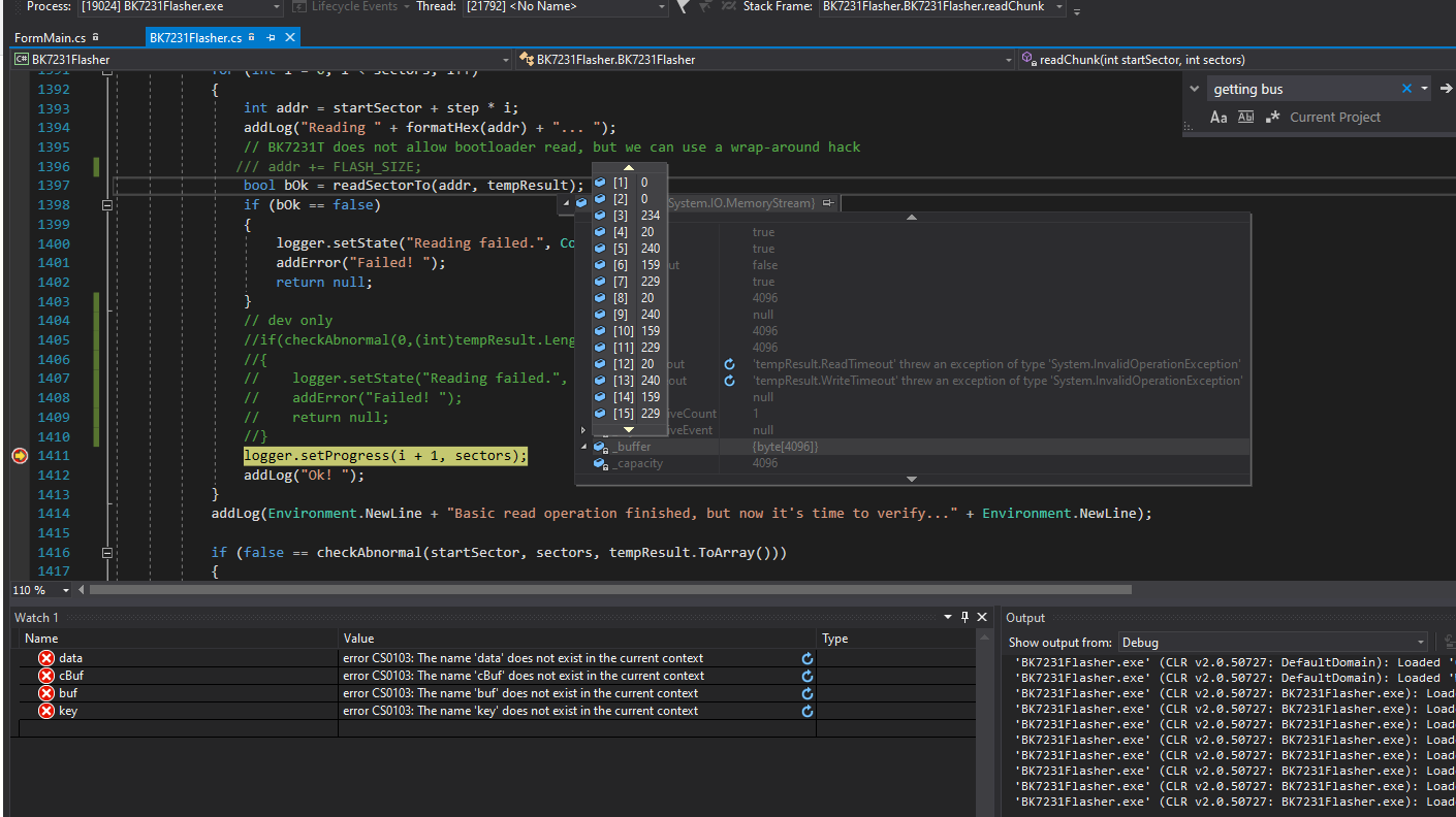

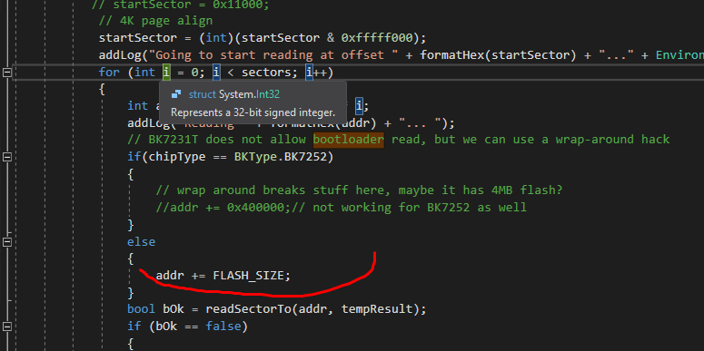

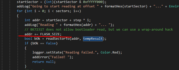

    I think i know why read might fail:
    A fragment of source code in C#, with the line addr + FLASH_SIZE; highlighted.
    Added after 55 [seconds]:
    i've solved the case:
    Screenshot of Visual Studio environment with open C# code in debugging mode.

    @insmod here is comparison between our partitions and A9 firmware:
    Comparison of flash partition layouts in PhoenixMC tool for OpenXR872 and original A9 firmware.
    I have no idea what to do more, but I could try to 1:1 copy their layout.

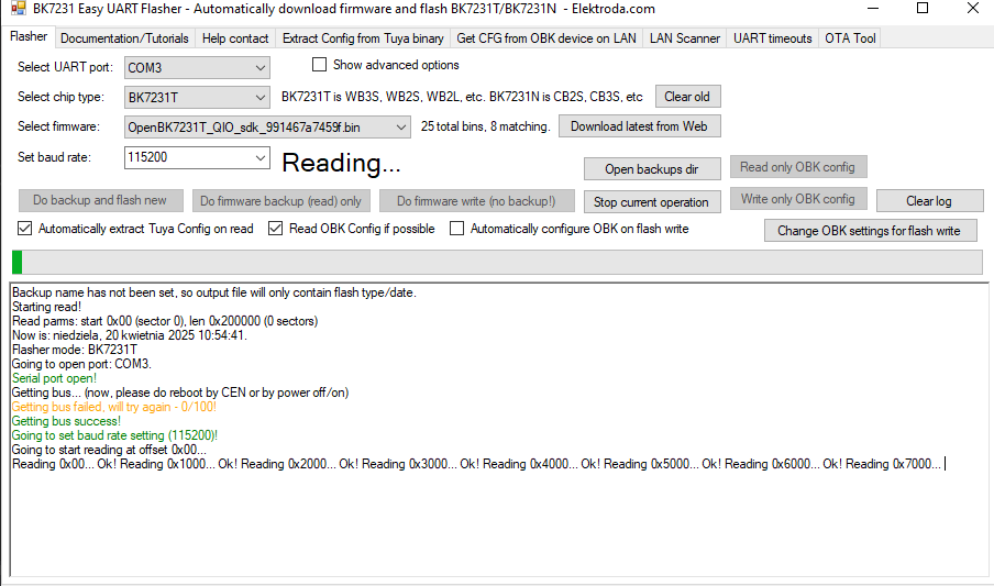

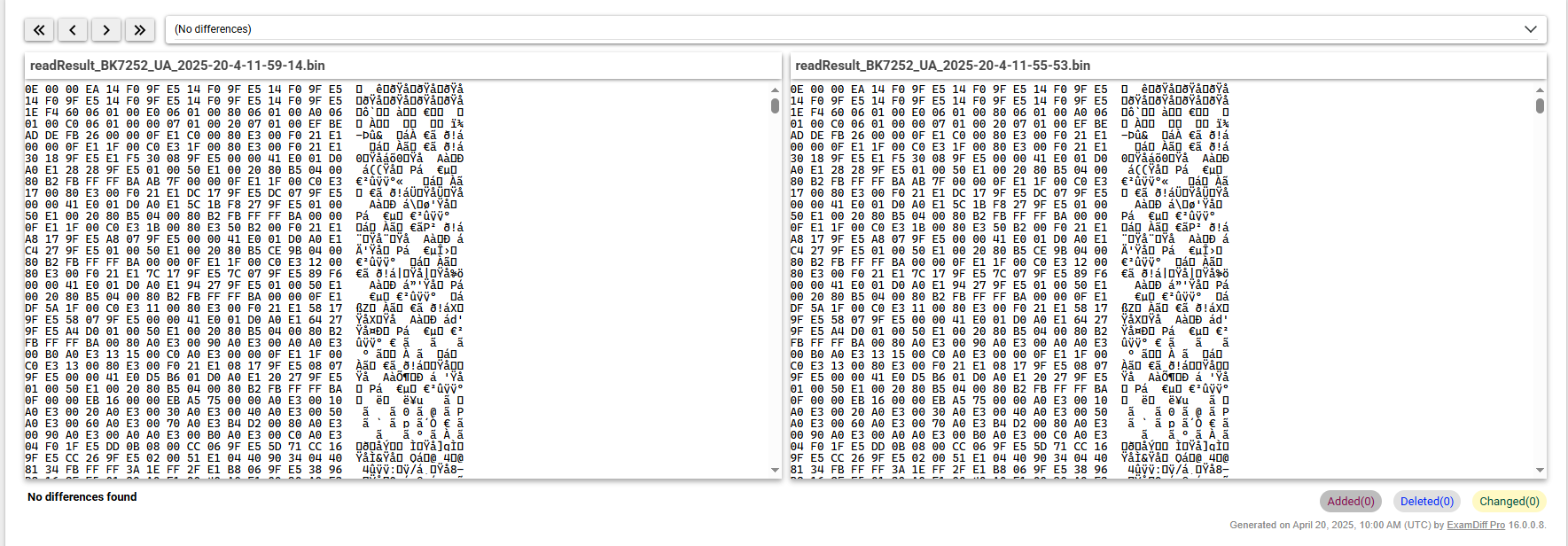

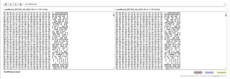

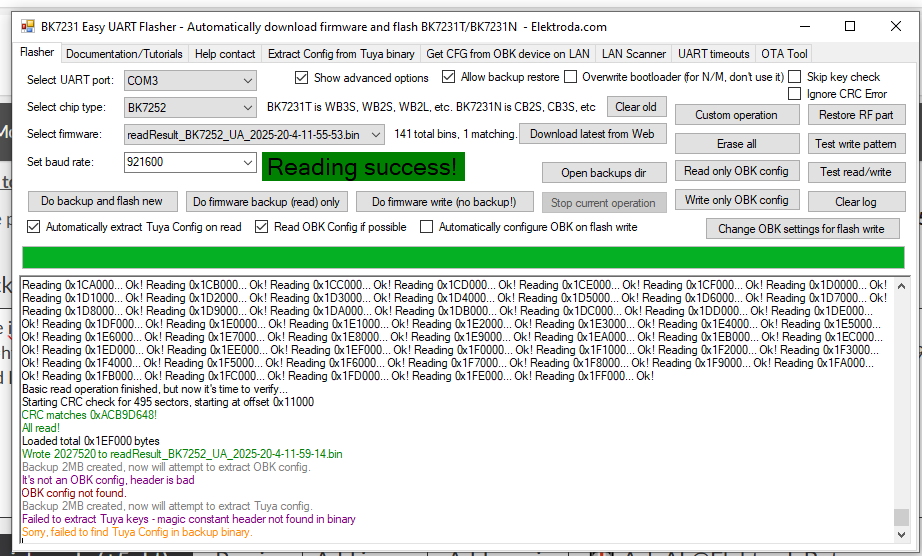

    Here is a comparison of first read and then write and read in BK7252 mode (check latest commits):
    Comparison of two binary files in ExamDiff Pro showing no differences.
    Read log:
    Screenshot of BK7231 Easy UART Flasher with a Reading success! message and memory read details.

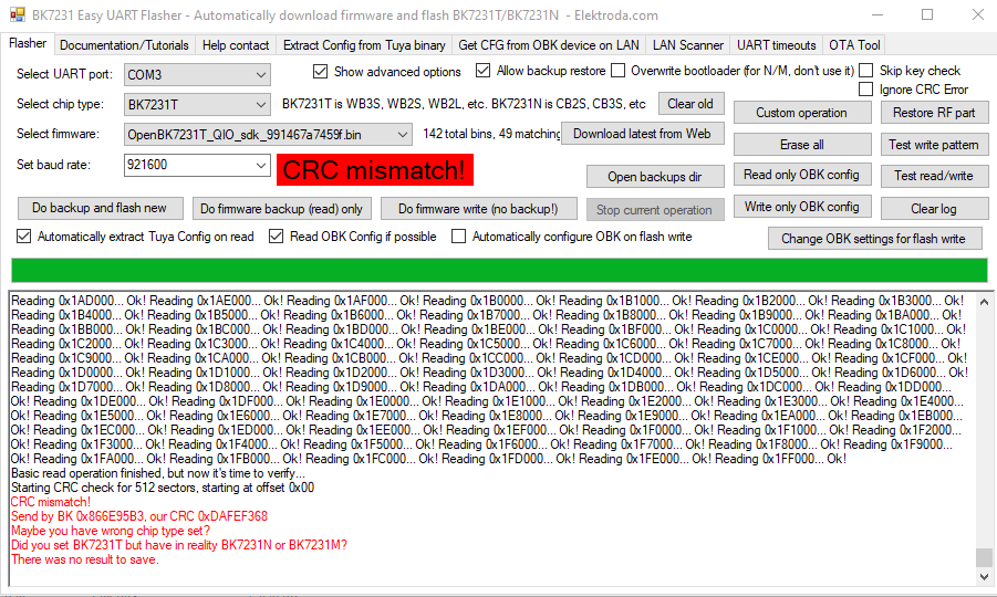

    Here is read attempt in BK7231T mode - CRC fails:
    Screenshot of the BK7231 Easy UART Flasher program with a “CRC mismatch!” error message.
    If I enable ignore CRC Error and just check created file:
    Screenshot of BK7231 Easy UART Flasher software reading flash memory of a device via COM port.

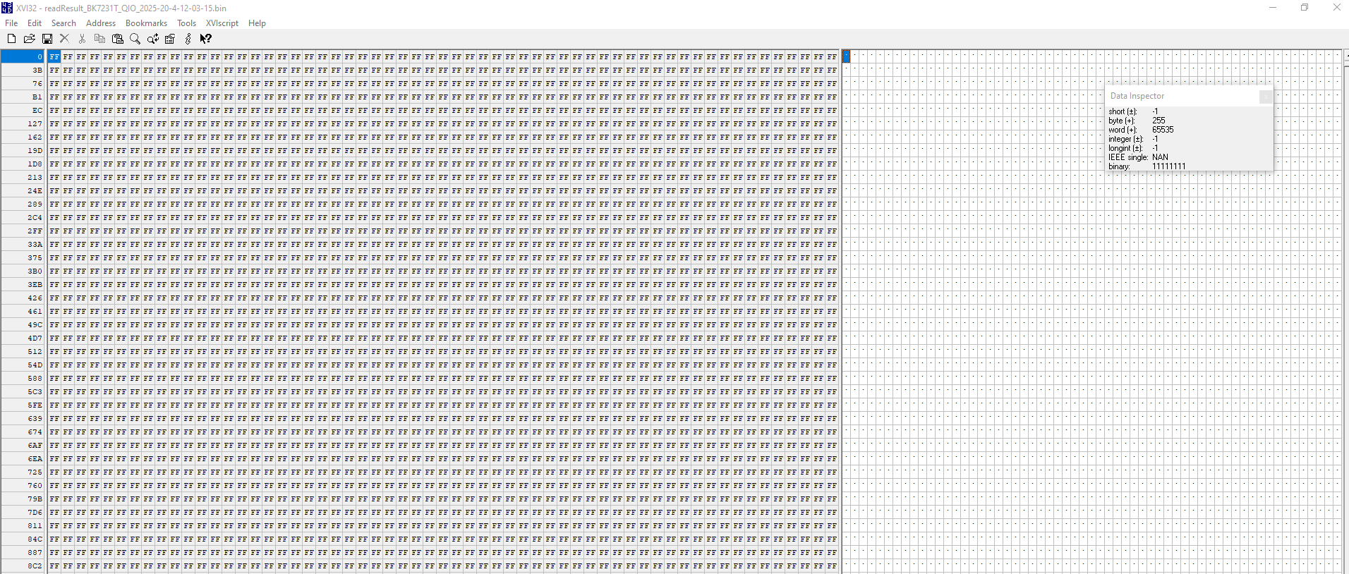

    Created file has 0xFF bootloader:
    Screenshot from XVI32 showing a binary file filled with hexadecimal FF values.
    and it's full of 0xFF, even if I go futher than bootloader:
    Screenshot of the HxD editor showing a binary file filled with hexadecimal FF values in every cell.
    @insmod is your file correct, both bootloader and remaining data? So you're saying that in your case, this code fragment works?
    Screenshot of a code editor showing C++ code with comments and highlighted elements.

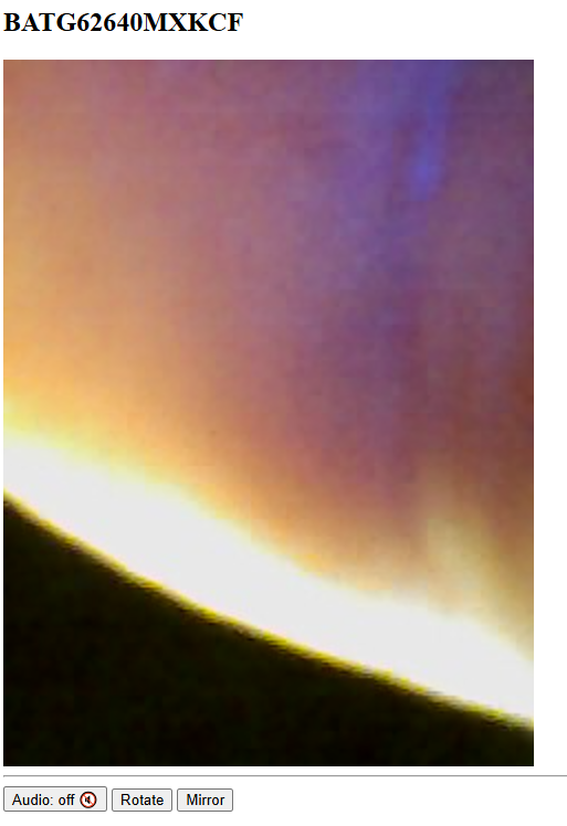

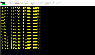

    Btw strange thing - it stuck in such boot loop after flash tests:
    A RealTerm window showing system boot logs and diagnostic messages in textual form.
    but once I disconnected UART wires, I got AP back:
    Wi-Fi icon and the text BAT180823IOZRC on a light gray background.
    and it works:
    RealTerm window with repeated “Bad frame time out” messages on a black background.

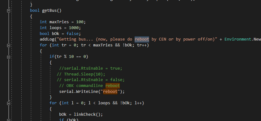

    My conclusions so far:
    - I can read and write BK7252 firmware with Easy flasher only in BK7252 mode, the "wrap around 2MB hack" used for BK7231T causes my BK7252 to lock itself and return 0xff on each read
    - written back BK7252 firmware may not fully boot if I dont disconnect uart
    - in our flasher, I don't need to do power on/off cycle to do flash operation, maybe this "uart reboot" send works
    A fragment of C# code with the word reboot highlighted.
    Backup:
    https://github.com/openshwprojects/FlashDumps/commit/b52dbd6579eec97b94533ce9b0094b130fa082be
    Any builds to try?

    But I have tried to use "wrap around hack" with 4MB flash size (as seen on my screenshot) and it failed as well.

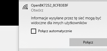

    I flashed UA. It again didn't want to boot with UART connected, but then I disconnected it and repowered.
    Wi-Fi connection window for OpenBK7252_8CFB3E8F with Connect automatically option and Connect button.
    Wait, it dies as soon as I connect UART? AP is gone. Let's try again without connecting UART.
    Strange, no AP now, and it's not battery - battery is disconnected.
    Ok I got it back:
    A window showing an attempt to connect to the Wi-Fi network OpenBK7252_8CFB3E8F on a Windows computer.

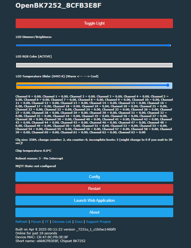

    It already has settings?
    Screenshot of OpenBK7252 control panel for LED management with brightness, RGB color, and temperature sliders.
    No flags are set, no pins, but it shows LED controller. Strange.

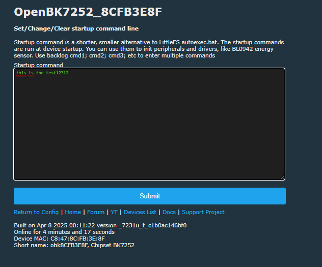

    Ok so I added a command:
    Web interface screen of OpenBK7252 with a startup command field and a Submit button.
    In BK7231T mode, obv:
    Screenshot of BK7231 Easy UART Flasher program with error message Only 0xff bytes read! in red.
    In BK7252 (I pushed a fix):
    Screenshot of OBKFlashLayout software showing a successful configuration read from a BK7252 device and OBK configuration window.

    @divadiow how brand new camera with battery attached and power via USB should behave? My new ones have red light on all the time and no reaction to buttons.
    Close-up of a printed circuit board with electronics and a camera, held between fingers.
    I managed to get flash read, will post in a moment
    Close-up of a printed circuit board with electronics and a camera module.
    Two printed circuit boards with mounted electronic components held by metal laboratory clamps.
    Firmware: https://github.com/openshwprojects/FlashDumps/commit/9519d4e6079f0a81cbe40ac50c774bc211a7a747
    PhoeniX MC can read via UART but no log output and no AP on stock firmware.
    Added after 3 [minutes]:
    I disconnected battery:
    Close-up of a circuit board with a connected micro USB cable and a mounted camera lens.
    Blue LED blinks. Log output is present. AP is on:
    Screenshot from RealTerm showing system logs and network interface information.
    Wi-Fi icon and text BATF087779AABAB.
    Added after 24 [seconds]:
    Voltage on battery was 4V, that is measured in circuit, before I disconnected.

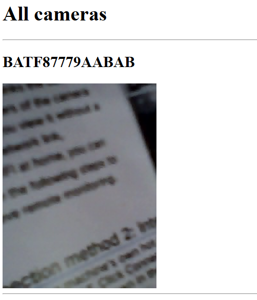

    Exploit works.
    Blurry section of a page with text, seen through a webcam.
    Boot log (with WiFi connection):
    [bl ERR] main():629, build:20:38:52
    [FD I]: mode: 0x4, freq: 48000000Hz, drv: 0
    Password:PMA: mode select:e
    wlan information ===================================================
    firmware:
        version : R-XR_C10.08.52.64_01.80 Jul  6 2019 20:05:10-P01.46-R
        buffer  : 12
    driver:
        version : XR_V02.05
    PMA: wlan mode:a
    platform information ===============================================
    XRADIO Skylark SDK 1.2.0 Jun 20 2024 10:58:31
    sram heap space [0x21f37c, 0x25fc00), total size 264324 Bytes
    cpu  clock 240000000 Hz
    HF   clock  40000000 Hz
    sdk option:
        XIP           : enable
        INT LF OSC    : enable
    mac address:
        efuse         : a0:17:f1:fd:ac:4e
        in use        : 04:90:9f:c6:1e:19
    StartupState:0
    network_connected.g726
    language
    net_failed.g726
    qrcode.g726
    reset.g726
    wait.g726
    gpio_grp=0,gpio_bit=21
    led drv init
    check vol
    [mthread]Create task:vbat(stack:2048),prio:3,ret:0
    XXXX task:vbat
    [ERR] __mci_irq_handler,575 raw_int:100 err!
    [ERR] SDC err, cmd 8,  RTO
    [ERR] sdc 402 abnormal status: RespErr
    [ERR] int err 100
    [ERR] SDC err, cmd 55,  RTO
    [ERR] int err 100
    [ERR] int err 100
    [ERR] int err 100
    [ERR] int err 100
    [FS ERR] fs_ctrl_mount():102, mmc scan fail
    <-500119_192428 rt_sd_dev.c:264>SD File System initialzation failed! errno
    [mthread]Create task:sdcardth(stack:2048),prio:3,ret:0
    XXXX task:sdcardth
    err cmd:use_fw_rate_policy
    vif=0, rts_threshold = 3000
    ssid is NULL. AP
    <wifi>lpdtim:10, lplis:10
    [mthread]Create task:wifitask(stack:4096),prio:3,ret:0
    XXXX task:wifitask
    [XRADIO_INTERNAL_CODEC] AMIC set volume Level-[7]
    [XRADIO_INTERNAL_CODEC] AMIC set volume Gain-[39]
    wifi task run
    rtuid:BATF-087779-GHJJL1N,FGIIKI
    en1: CTRL-EVENT-TERMINATING
    WAR join_status:0
    mean_vol=4200
    firmware:
        buffer  : 12
    driver:
        version : XR_V02.05
    interface name: en1
    Using interface en1 with hwaddr 04:90:9f:c6:1e:19 and ssid "AP-XRADIO"
    [XRADIO_INTERNAL_CODEC] LINEIN set volume Level-[1]
    [XRADIO_INTERNAL_CODEC] AUDIO_IN_DEV_ALL set volume Gain-[0]
    [XRADIO_INTERNAL_CODEC] Route(cap): amic Enable
    en1: interface state UNINITIALIZED->ENABLED
    en1: AP-ENABLED
    en1: AP-DISABLED
    [net INF] msg <wlan connected>
    [net INF] netif is link up
    [net INF] bring up netif
    [net INF] netif (IPv4) is up
    [net INF] address: 192.168.238.1
    [net INF] gateway: 192.168.238.1
    [net INF] netmask: 255.255.255.0
    WLAN CONNECTED
    vif0, AP/GO mode THROTTLE=38
    [net INF] msg <network up>
    NETWORK UP
    <L>Cmutex:0
    <L>Cmutex:0x2295c8
    <L>lwip_socket(PF_INET, UDP, 17) = SKT_0
    en1: interface state ENABLED->DISABLED
    [net INF] msg <wlan disconnected>
    [net INF] netif is link down
    WLAN DISCONNECTED
    <L>Cmutex:0
    <L>Cmutex:0x226680
    <L>lwip_socket(PF_INET, UDP, 17) = SKT_1
    Using interface en1 with hwaddr 04:90:9f:c6:1e:19 and ssid "BATF087779AABAB"
    ---->detect sp0828
    {0xfd, 0x00},
    {0x1c, 0x00},
    {0x30, 0x00},
    {0x0f, 0x2f},
    {0x10, 0x2f},
    {0x12, 0x7f},
    {0x13, 0x2f},
    {0x15, 0x7f},
    {0x16, 0x0f},
    {0x22, 0xe0},
    {0x26, 0x08},
    {0x27, 0xe8},
    {0x28, 0x0b},
    {0x32, 0x00},
    {0xfd, 0x00},
    {0x31, 0x00},
    {0xd8, 0x58},
    {0xd9, 0x58},
    {0xda, 0x58},
    {0xdb, 0x58},
    {0x36, 0x00},
    {0x5f, 0x11},
    {0xe0, 0x00},
    {0xe1, 0xdc},
    {0xe2, 0xb0},
    {0xe3, 0x00},
    {0xe4, 0x2e},
    {0xe5, 0x00},
    {0xe6, 0x2b},
    {0xb7, 0x3c},
    {0xb8, 0x50},
    {0xfd, 0x01},
    {0x25, 0x1a},
    {0x26, 0xfb},
    {0x28, 0x61},
    {0x29, 0x49},
    {0x31, 0x64},
    {0x32, 0x18},
    {0x4d, 0xdc},
    {0x4e, 0x53},
    {0x41, 0x8c},
    {0x42, 0x57},
    {0x55, 0xff},
    {0x56, 0x00},
    {0x59, 0x82},
    {0x5a, 0x00},
    {0x5d, 0xff},
    {0x5e, 0x6f},
    {0x57, 0xff},
    {0x58, 0x00},
    {0x5b, 0xff},
    {0x5c, 0xa8},
    {0x5f, 0x75},
    {0x60, 0x00},
    {0x2d, 0x00},
    {0x2e, 0x00},
    {0x2f, 0x00},
    {0x30, 0x00},
    {0x33, 0x00},
    {0x34, 0x00},
    {0x37, 0x00},
    {0x38, 0x00},
    {0x39, 0x01},
    {0x3a, 0x07},
    {0xfd, 0x00},
    {0x33, 0x0f},
    {0x51, 0x3f},
    {0x52, 0x09},
    {0x53, 0x00},
    {0x54, 0x00},
    {0x55, 0x10},
    {0x4f, 0x08},
    {0x50, 0x08},
    {0x56, 0x70},
    {0x57, 0x10},
    {0x58, 0x10},
    {0x59, 0x10},
    {0x5a, 0x02},
    {0x5b, 0x02},
    {0x5c, 0x20},
    {0x65, 0x03},
    {0x66, 0x01},
    {0x67, 0x03},
    {0x68, 0x46},
    {0x69, 0x7f},
    {0x6a, 0x01},
    {0x6b, 0x04},
    {0x6c, 0x01},
    {0x6d, 0x03},
    {0x6e, 0x46},
    {0x6f, 0x7f},
    {0x70, 0x01},
    {0x71, 0x05},
    {0x72, 0x01},
    {0x73, 0x03},
    {0x74, 0x46},
    {0x75, 0x7f},
    {0x76, 0x01},
    {0x7f, 0xa0},
    {0x80, 0x00},
    {0x81, 0xe0},
    {0x82, 0xed},
    {0x83, 0xa6},
    {0x84, 0xed},
    {0x85, 0xfa},
    {0x86, 0xba},
    {0x87, 0xcc},
    {0x88, 0x30},
    {0x89, 0x33},
    {0x8a, 0x0f},
    {0x8b, 0x00},
    {0x8c, 0x1a},
    {0x8d, 0x29},
    {0x8e, 0x41},
    {0x8f, 0x62},
    {0x90, 0x7c},
    {0x91, 0x90},
    {0x92, 0xa2},
    {0x93, 0xaf},
    {0x94, 0xba},
    {0x95, 0xc4},
    {0x96, 0xce},
    {0x97, 0xd6},
    {0x98, 0xdd},
    {0x99, 0xe4},
    {0x9a, 0xea},
    {0x9b, 0xf1},
    {0xfd, 0x01},
    {0x8d, 0xf8},
    {0x8e, 0xff},
    {0xfd, 0x00},
    {0xca, 0xcf},
    {0xcb, 0x07},
    {0xcc, 0x04},
    {0xce, 0xff},
    {0xcf, 0x10},
    {0xd0, 0x20},
    {0xd1, 0x00},
    {0xd2, 0x1c},
    {0xd3, 0x16},
    {0xd4, 0x00},
    {0xd6, 0x1c},
    {0xd7, 0x16},
    {0xdd, 0x6c},
    {0xde, 0xa0},
    {0xb9, 0x00},
    {0xba, 0x04},
    {0xbb, 0x08},
    {0xbc, 0x10},
    {0xbd, 0x20},
    {0xbe, 0x30},
    {0xbf, 0x40},
    {0xc0, 0x50},
    {0xc1, 0x60},
    {0xc2, 0x70},
    {0xc3, 0x80},
    {0xc4, 0x90},
    {0xc5, 0xa0},
    {0xc6, 0xb0},
    {0xc7, 0xc0},
    {0xc8, 0xd0},
    {0xc9, 0xe0},
    {0xfd, 0x01},
    {0x89, 0xf0},
    {0x8a, 0xff},
    {0xfd, 0x00},
    {0xe8, 0x30},
    {0xe9, 0x30},
    {0xea, 0x40},
    {0xf4, 0x1b},
    {0xf5, 0x97},
    {0xec, 0x53},
    {0xed, 0x78},
    {0xee, 0x47},
    {0xef, 0x6c},
    {0xf7, 0x70},
    {0xf8, 0x5b},
    {0xf9, 0x64},
    {0xfa, 0x4f},
    {0xfd, 0x01},
    {0x09, 0x31},
    {0x0a, 0x85},
    {0x0b, 0x0b},
    {0x14, 0x20},
    {0x15, 0x0f},
    {0xfd, 0x00},
    {0x05, 0x00},
    {0x06, 0xfe},
    {0x09, 0x02},
    {0x0a, 0x4d},
    {0xf0, 0x47},
    {0xf1, 0x00},
    {0xf2, 0x59},
    {0xf5, 0x72},
    {0xfd, 0x01},
    {0x00, 0xac},
    {0x0f, 0x5a},
    {0x16, 0x5a},
    {0x17, 0x9c},
    {0x18, 0xa4},
    {0x1b, 0x5a},
    {0x1c, 0xa4},
    {0xb4, 0x21},
    {0xb5, 0x3b},
    {0xb6, 0x43},
    {0xb9, 0x40},
    {0xba, 0x4f},
    {0xbb, 0x47},
    {0xbc, 0x45},
    {0xbd, 0x43},
    {0xbe, 0x42},
    {0xbf, 0x42},
    {0xc0, 0x42},
    {0xc1, 0x41},
    {0xc2, 0x41},
    {0xc3, 0x41},
    {0xc4, 0x41},
    {0xc5, 0x70},
    {0xc6, 0x41},
    {0xca, 0x70},
    {0xcb, 0x0c},
    {0xfd, 0x00},
    {0xfd, 0x00},
    {0x32, 0x15},
    {0x34, 0x66},
    {0x35, 0x40},
    {0x1b, 0x07},
    SP0828 Init Done
    en1: interface state DISABLED->ENABLED
    en1: AP-ENABLED
    lednum:0
    --drvled_flash :(0,1,5,5,1,5,5)
    WAR [WSM] Drop frame (0x0008).
    [net INF] netif is already up
    WLAN CONNECTED
    [mthread]Create task:vtask(stack:3072),prio:3,ret:0
    XXXX task:vtask
    [mthread]Create task:atask(stack:3072),prio:3,ret:0
    XXXX task:atask
    [mthread]Create task:thdImage(stack:2048),prio:3,ret:0
    XXXX task:thdImage
    [mthread]Create task:RT_REC(stack:2048),prio:3,ret:0
    XXXX task:RT_REC
    [mthread]Create task:MD_TH(stack:2048),prio:3,ret:0
    XXXX task:MD_TH
    [mthread]Create task:p2plis(stack:10240),prio:3,ret:0
    XXXX task:p2plis
    [mthread]Create task:CameraTest(stack:2048),prio:3,ret:0
    XXXX task:CameraTest
    [mthread]Create task:NetCheck(stack:2048),prio:3,ret:0
    XXXX task:NetCheck
    sp0828 not support update bitrate
    sp0828 not support update venc
    task_aenc_stream runing
    set ircut color
    {0xfd, 0x00},
    [mthread]vvvthread NetCheck, tid:2181344 EXIT
    /camera_test.txt does not exist!
    [mthread]vvvthread CameraTest, tid:2182304 EXIT
    {0x62, 0x00},
    {0x63, 0x80},
    {0x64, 0x80},
    {0xff, 0xff},
    [mthread]vvvthread thdImage, tid:2182164 EXIT
    drop video frame:5
    drop video frame:4
    drop video frame:3
    drop video frame:2
    drop video frame:1
    <RTW>WiFi ap start ok:BATF087779AABAB, 0, 11
    wifi task exit
    [mthread]vvvthread wifitask, tid:2182804 EXIT
    [IpcP2pStart][  83]p2p starte,bP2pStarted=[0]
    p2pID:BATF-087779-AABAB
    DataRW_Init bufferSize=32
    <L>lwip_close(0)
    <L>lwip_close(0)
    <L>mutex D:0x2295c8
    <L>lwip_close(SKT_0),tcp=0
    Success[0]--IlnkModP2pStart
    IpcSysInit:0
    [mthread]vvvthread p2plis, tid:2184208 EXIT
    [os E] OS_MutexLock():65, handle 0
    semaphore not initialized at line 448 in src/api/tcpip.c
    <L>Cmutex:0
    <L>Cmutex:0x248928
    netconn state error at line 1132 in src/api/api_msg.c
    <L>Cmutex:0
    <L>Cmutex:0x248a70
    <L>lwip_socket(PF_INET, UDP, 0) = SKT_0
    <L>lwip_socket(PF_INET, UDP, 17) = SKT_2
    <L>Cmutex:0
    <L>Cmutex:0x248bb0
    <L>lwip_socket(PF_INET, UDP, 0) = SKT_3
    network interface: en (Default)
    MTU: 1500
    MAC: 04 90 9f c6 1e 19
    FLAGS: UP LINK_UP ETHARP IGMP
    ip address: 192.168.238.1
    gw address: 192.168.238.1
    net mask  : 255.255.255.0
    network interface: lo
    MTU: 0
    MAC:
    FLAGS: UP LINK_UP
    ip address: 127.0.0.1
    gw address: 127.0.0.1
    net mask  : 255.0.0.0
    mean_vol=4100
    xr_newassoc(): link_id:0 mac:e4:b3:18:f6:91:cc
    en1: STA e4:b3:18:f6:91:cc IEEE 802.11: associated
    en1: AP-STA-CONNECTED e4:b3:18:f6:91:cc
    <L>Cmutex:0
    <L>Cmutex:0x241820
    <L>lwip_socket(PF_INET, TCP, 1) = SKT_4
    <L>lwip_close(4)
    <L>mutex D:0x241820
    <L>lwip_close(SKT_4),tcp=0
     ../../../../project/demo/ilnk_demo_et_1mflash/ilnk_ipc/src/IpcCbEvent.c cbEvenNoteFun 92
    [cbEvenNoteFun][ 100]LibEvent->eType-------------->LIB_EVENT_SESSION_STATUS
    p2pSession[privilege=0,status=1,peerAddr=]
    -------------->SESSION_CONNECTED_BY_P2P
     ../../../../project/demo/ilnk_demo_et_1mflash/ilnk_ipc/src/IpcCbSys.c cbSysCtrlFun 475
    [cbSysCtrlFun][ 509]SysCtrl->ctrlType-------------->SYS_CTRL_TYPE_USRCHK
    firstRTT=124,srtt=992
     ../../../../project/demo/ilnk_demo_et_1mflash/ilnk_ipc/src/IpcCbAv.c cbAvCtrlFun 302
    [cbAvCtrlFun][ 305]AvCtrl->ctrlType-------------->AV_CTRL_TYPE_V_PARAM_SET
    [_VideoParamSet][ 142]cbVideoParamSet_t: channel 0 param:[1,2]
    VIDEO_PARAM_TYPE_RESOLUTION
    [cbAvCtrlFun][ 305]AvCtrl->ctrlType-------------->AV_CTRL_TYPE_VID_START
    ret[-1][errno:12][retry:0]---XqSckSendto
    WAR Multicast delivery timeout.
    hm ilnk_demo_et_1mflash
    Added after 28 [minutes]:
    I can read and write flash repeatedly via PhoenixMC. There is no need for opening the case, but @divadiow is right. OpenXR872 somehow fails to boot (no output?) on stock 1MB chip. I would never expect that.

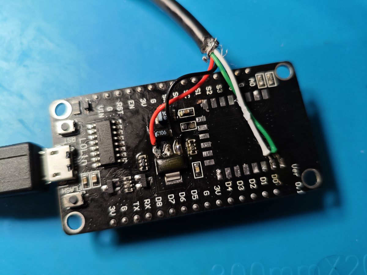

  • #116 21528571
    Posts: 5052
    Help: 438
    Rate: 893

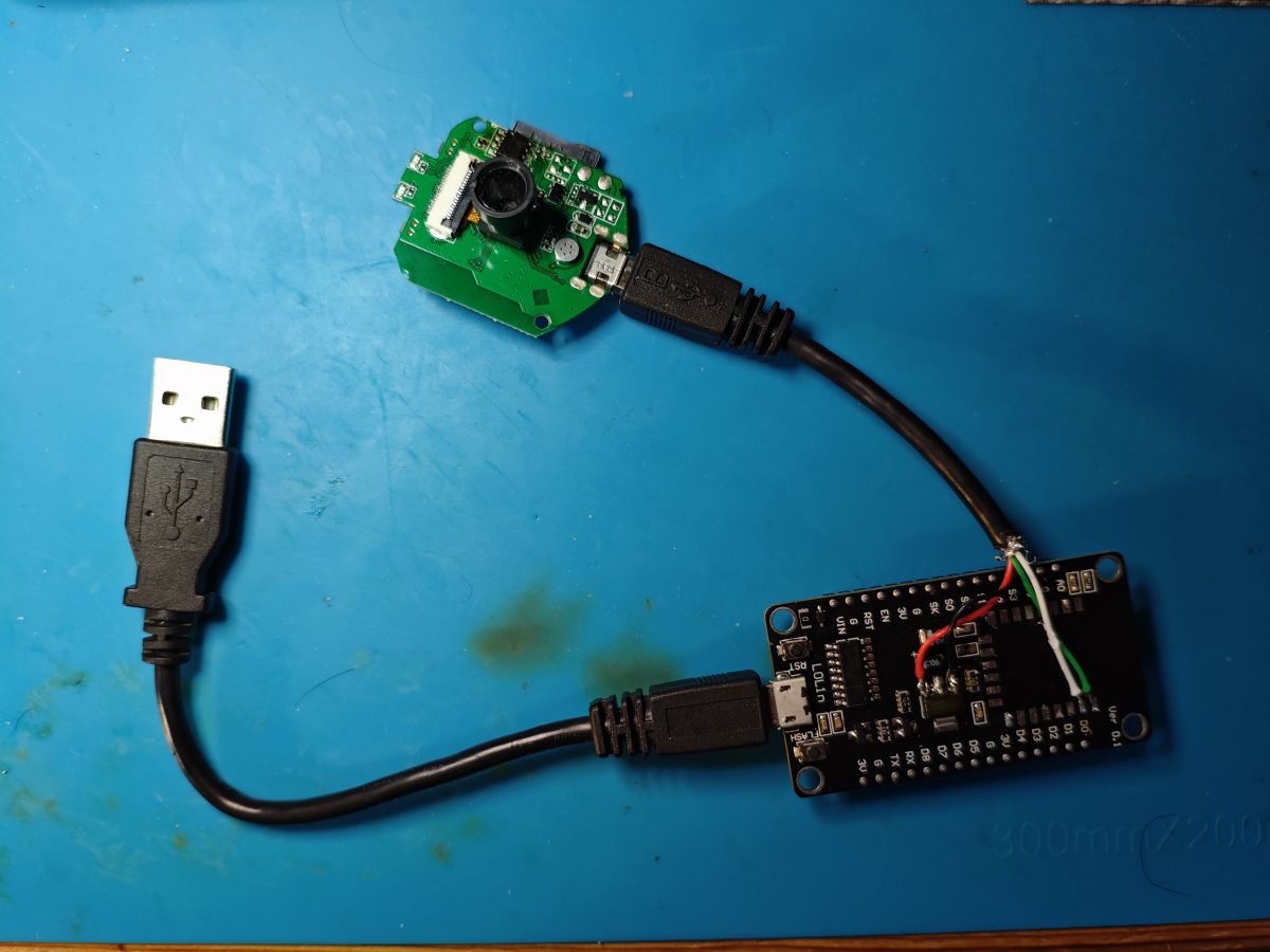

    UART access via USB;
    I made a version of this too for easy XF16 A9 cam backup/flash, even with cam unopened. I'll provide detail assuming some people may come direct to this message wanting to know how it can be done.
    I had a NodeMCU/ESP8266 with module removed. CH340 and LDO still work. I cut the USB-A end off a micro-USB cable, stripped the ends and soldered it up like so:
    NodeMCU/ESP8266 board with USB cable wires soldered to it; visible wires are red, black, white, and green. NodeMCU board connected to a camera PCB using a modified USB cable with exposed wires.
    Making use of the 5V from USB input on the AMS1117-33, GND and then RX/TX pads where the module was.
    Green USB D- ---> NodeMCU GPIO1 pad
    White USB D+ ---> NodeMCU GPIO3 pad
    Red USB VCC ---> AMS1117-33 5V leg
    Black USB GND ---> AMS1117-33 GND leg
    USB shielding not connected (potential for ground loop - is that correct?)

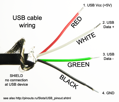

    visual aids:
    Photo of a USB cable with stripped wires: red, white, green, and black, labeled as power, data, and ground. Diagram of ESP8266 module pins with labeled functions and colored signal names.Diagram showing AMS1117 chip with labeled pins: ADJ/Ground, Input, Output.
    I'll tidy it up, insulate, secure etc for repeat use. The same could be made smaller I guess with USB-TTL adaptor with 5V header. Camera draw doesn't appear to be an issue, for me anyway.
    The actual backup and flash of XF16 is basically then this guide without needing to ground either PB02 or PB03 but go straight to backup steps: https://www.elektroda.com/rtvforum/topic4115856.html
    Probably worth adding that this is correct for A9s that appear to route their RX/TX through USB pins, as seen on the PCB here:
    Close-up view of a PCB with a micro USB port and labeled TX and RX pads.

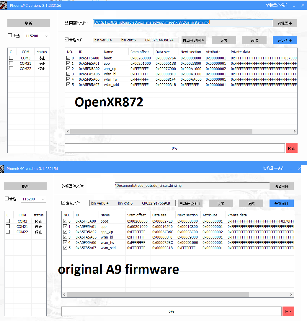

    an you confirm - you can read and write flash via UART, if you flash OpenXR872 it does not boot, but you can still recover via UART, right? No CH341 needed? or at least it's that way for me.
    this is still true for me. 1mb flash and OpenXR872 = no boot. 2mb flash soldered in + OpenXR872 = boots.
    I can recover factory firmware from flash backup over UART, yes. I have one in front of me now, with 1mb flash, that I have flashed back to factory and it is booting into A9 app and broadcasting AP
    Wi-Fi signal icon and the text BATD049321CKYWL on a gray bar.
    I'll do some firmware comparisons, first I will setup David Ventura's cam-reverse thing

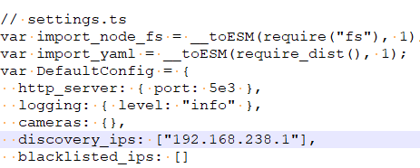

    That camera exploit has one issue. It seems you can't choose interface IP for pair operation due to the some mistake in code.
  • #120 21528742
    Posts: 5052
    Help: 438
    Rate: 893
    oh. I changed in bin.cjs
    A fragment of a TypeScript configuration file with IP addresses and server settings.
    but I have now paired to router AP and am using yaml from cam-reverse readme
    Blurry image with purple, yellow, and black areas, without clear details or recognizable objects.
