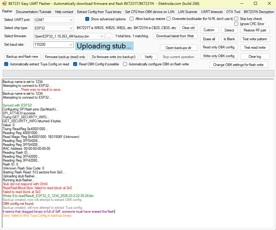

    Just tried to read ESP32-C3 with various speeds but this is as far as it will go, talking about mini boards
    Screenshot of BK7231 Easy UART Flasher showing “Uploading stub” and a console log with errors
  • #242 21847030
    Posts: 14763
    Rate: 12896
    I will try and fix in a moment

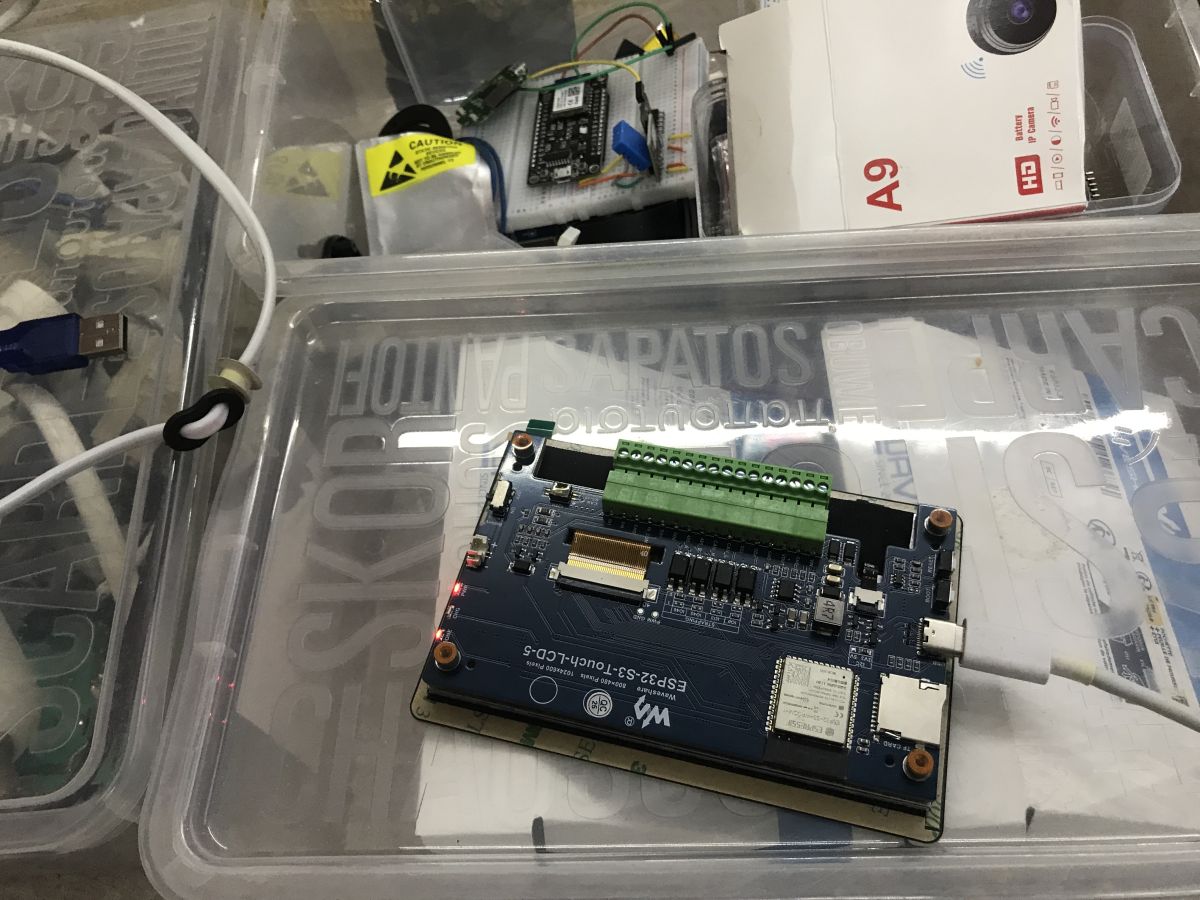

    ESP32-S3 Touch LCD-5 development board with green terminal block in a clear plastic storage box
  • #244 21847041
    Posts: 14763
    Rate: 12896

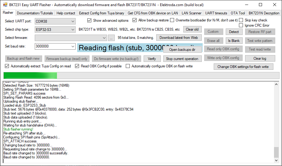

    ESP32-S3 support pushed, not sure yet about C3, if I have one.
    Screenshot of BK7231 Easy UART Flasher showing a flash read log for an ESP32-S3 device.

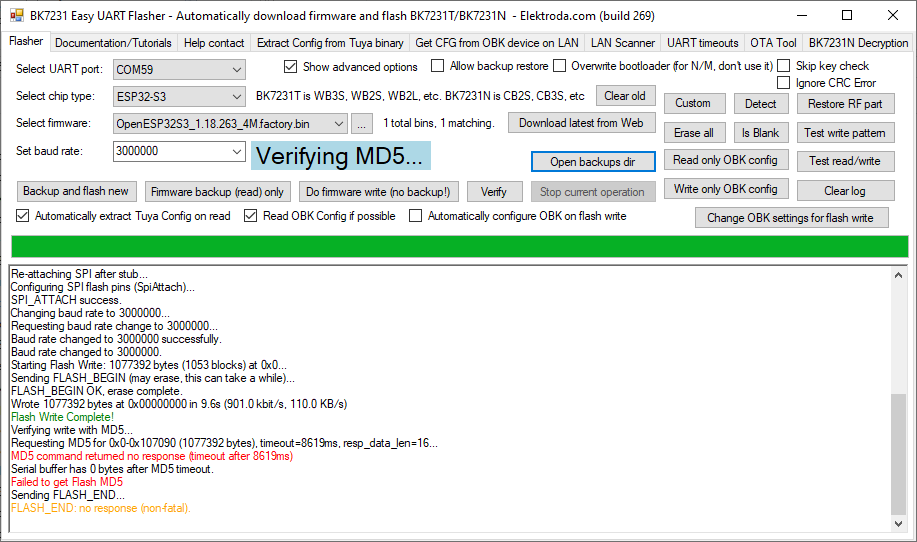

  • #245 21847044
    Posts: 5215
    Help: 448
    Rate: 917
    divadiow wrote:
    the answer
    also answers why json and not bins like the others :)
    Added after 22 [minutes]:
    works.
    Screenshot of BK7231 Easy UART Flasher showing “Verifying MD5…” and a log with error messages.

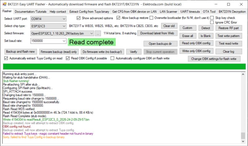

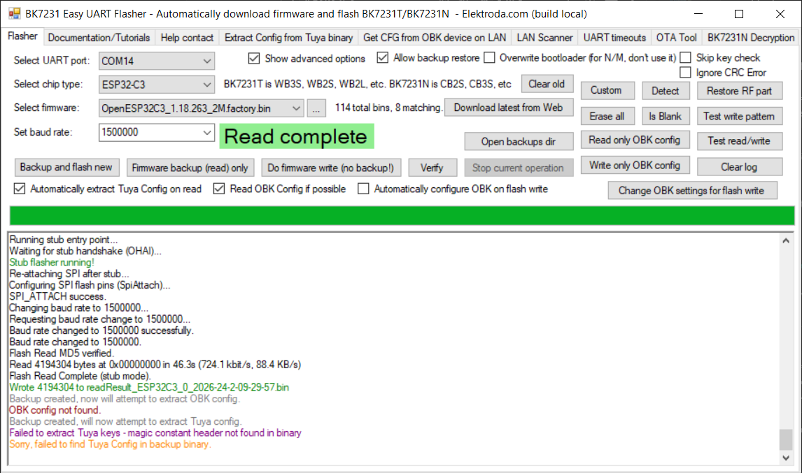

  • #246 21847220
    Posts: 14763
    Rate: 12896
    C3 added as well:
    Screenshot of BK7231 Easy UART Flasher showing “Read complete” and a read-operation log.
