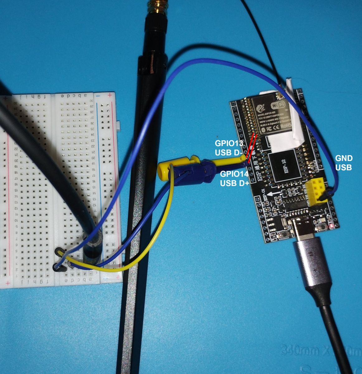

  • ESP32-C5 boots and flashes with esptool --no-stub
    #216 21655897
    max4elektroda
    Posts: 758
    Help: 49
    Rate: 189

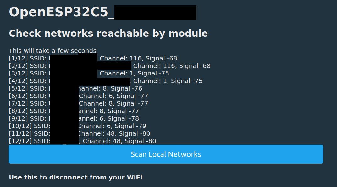

    insmod wrote:
    it boots fully and creates connectable AP.
    Wifi scan sees 5ghz networks.
    My C5 also arrived. Had some problems how to connect for some tests but came up with the idea to fit it into my universal adapter.
    Needed some paper to fit (though it should be 18mm as WROVER module), so right row is isolated, but the left row connects o.k.
    ESP-12 module connected to breadboard with signal wires on blue surface
    To get infos or flash I used esptool with "--no-stub" (else got "A fatal error occurred: Unable to verify flash chip connection (No serial data received.)."

    AP is only in 2.4GHz Wifi, but in scan I see 5GHz APs (Channel 116)
    ESP32C5 interface showing detected Wi-Fi networks with channels and signal levels

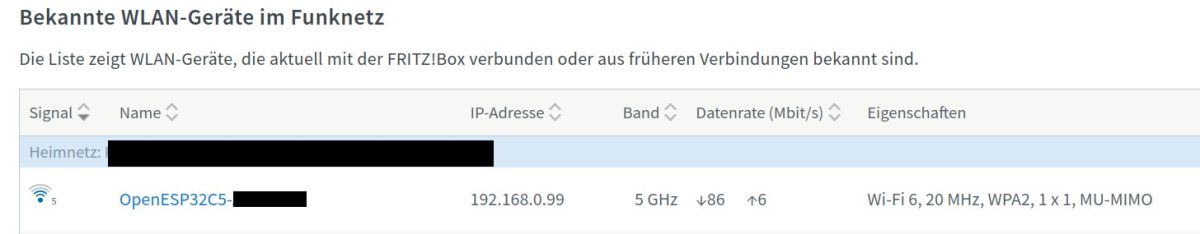

  • 5 GHz Wi‑Fi works on the ESP32 module
    #218 21655918
    max4elektroda
    Posts: 758
    Help: 49
    Rate: 189
    Connection in 5GHz Band works:
    List of known WLAN devices connected to the FRITZ!Box network
    divadiow wrote:
    Did yours come with anything on it?
    I didn't test, but there are 3 more ;-)

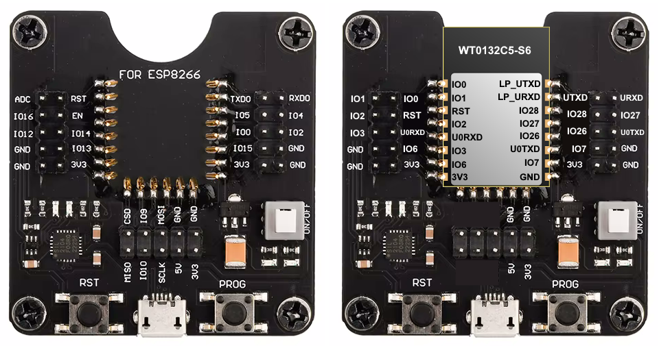

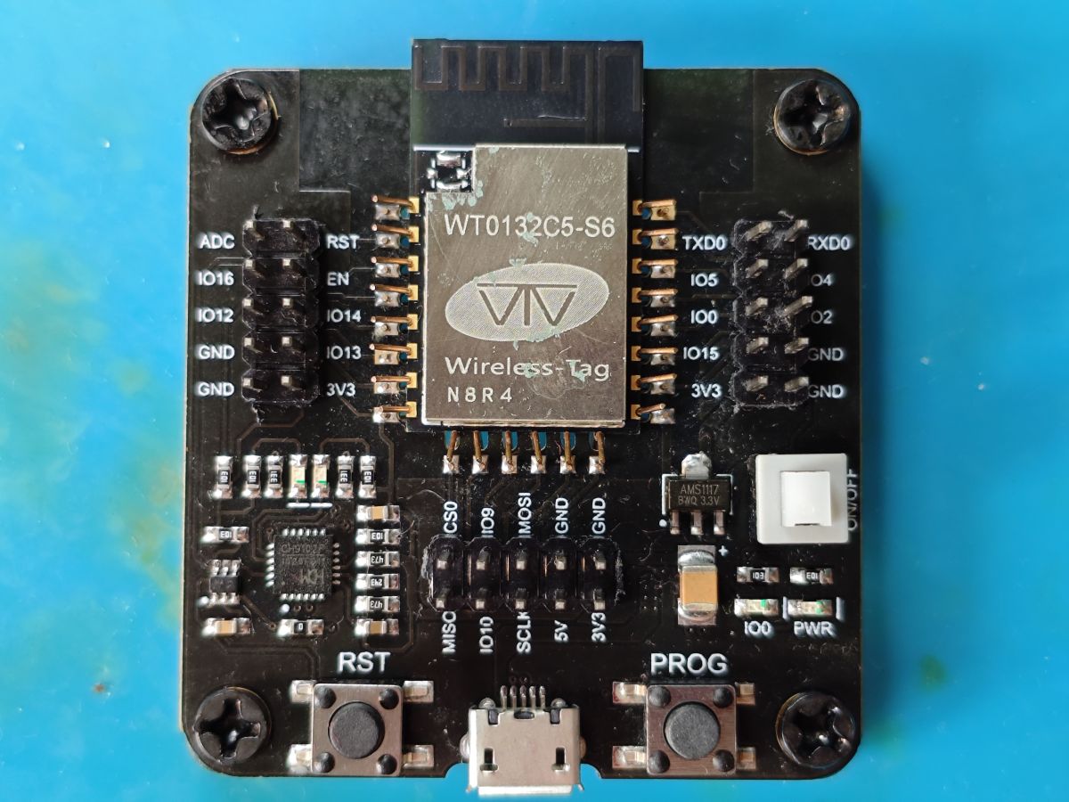

  • ESP32-C5 detected with 8MB flash and UART download mode
    #219 21655969
    Posts: 5215
    Help: 448
    Rate: 917
    >>21655908
    to add my 2 cents.
    esptool 5.0.2. IO28 low to get into UART download mode. U0TXD/U0RXD to flash
    Two development boards with pin headers and micro USB marked FOR ESP8266 and WT0132C5-S6
    Wireless Tag TWT0132C5-S6-N8R4
    this module shipped with blank flash.
    esptool -b 2000000 write-flash 0 OpenESP32C5_1.18.171_4M.factory.bin

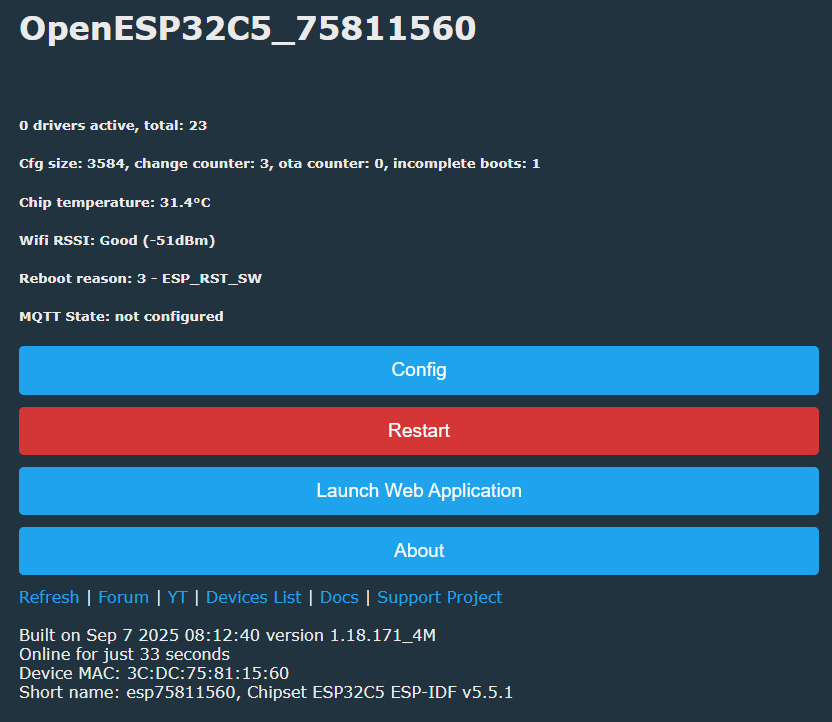

    OpenESPC5 first boot
    Spoiler:
    ESP-ROM:esp32c5-eco2-20250121
    Build:Jan 21 2025
    rst:0x1 (POWERON),boot:0x1f (SPI_FAST_FLASH_BOOT)
    SPI mode:DIO, clock div:1
    load:0x408556b0,len:0x1710
    load:0x4084bba0,len:0xd9c
    load:0x4084e5a0,len:0x3198
    entry 0x4084bbaa
    I (23) boot: ESP-IDF v5.5.1 2nd stage bootloader
    I (23) boot: compile time Sep 7 2025 08:11:39
    I (24) boot: chip revision: v1.0
    I (25) boot: efuse block revision: v0.2
    I (27) boot.esp32c5: SPI Speed : 80MHz
    I (31) boot.esp32c5: SPI Mode : DIO
    I (35) boot.esp32c5: SPI Flash Size : 4MB
    I (38) boot: Enabling RNG early entropy source...
    I (43) boot: Partition Table:
    I (45) boot: ## Label Usage Type ST Offset Length
    I (52) boot: 0 otadata OTA data 01 00 00009000 00002000
    I (58) boot: 1 nvs WiFi data 01 02 0000b000 00005000
    I (65) boot: 2 app0 OTA app 00 10 00010000 001d0000
    I (71) boot: 3 app1 OTA app 00 11 001e0000 001d0000
    I (78) boot: 4 lfs Unknown data 01 82 003b0000 00050000
    I (85) boot: End of partition table
    I (88) boot: No factory image, trying OTA 0
    I (92) esp_image: segment 0: paddr=00010020 vaddr=420d0020 size=342b8h (213688) map
    I (136) esp_image: segment 1: paddr=000442e0 vaddr=40800000 size=0bd38h ( 48440) load
    I (147) esp_image: segment 2: paddr=00050020 vaddr=42000020 size=cdf84h (843652) map
    I (292) esp_image: segment 3: paddr=0011dfac vaddr=4080bd38 size=0ca40h ( 51776) load
    I (303) esp_image: segment 4: paddr=0012a9f4 vaddr=40818780 size=04f8ch ( 20364) load
    I (308) esp_image: segment 5: paddr=0012f988 vaddr=50000000 size=000a4h ( 164) load
    I (314) boot: Loaded app from partition at offset 0x10000
    I (341) boot: Set actual ota_seq=1 in otadata[0]
    I (341) boot: Disabling RNG early entropy source...
    I (351) MSPI Timing: tuning success, best point is index 4
    I (351) MSPI Timing: Flash timing tuning index: 4
    I (352) cpu_start: Unicore app
    I (375) cpu_start: Pro cpu start user code
    I (376) cpu_start: cpu freq: 240000000 Hz
    I (376) app_init: Application information:
    I (376) app_init: Project name: OpenBeken
    I (380) app_init: App version: 1.18.171_4M
    I (384) app_init: Compile time: Sep 7 2025 08:12:21
    I (389) app_init: ELF file SHA256: 9c3ccd3d6...

    ESP32C5 device web interface with system data and action buttons
    Added after 17 [minutes]:
    MQTT connects and I can toggle fake LED from HA without crash (unlike ESP8266)

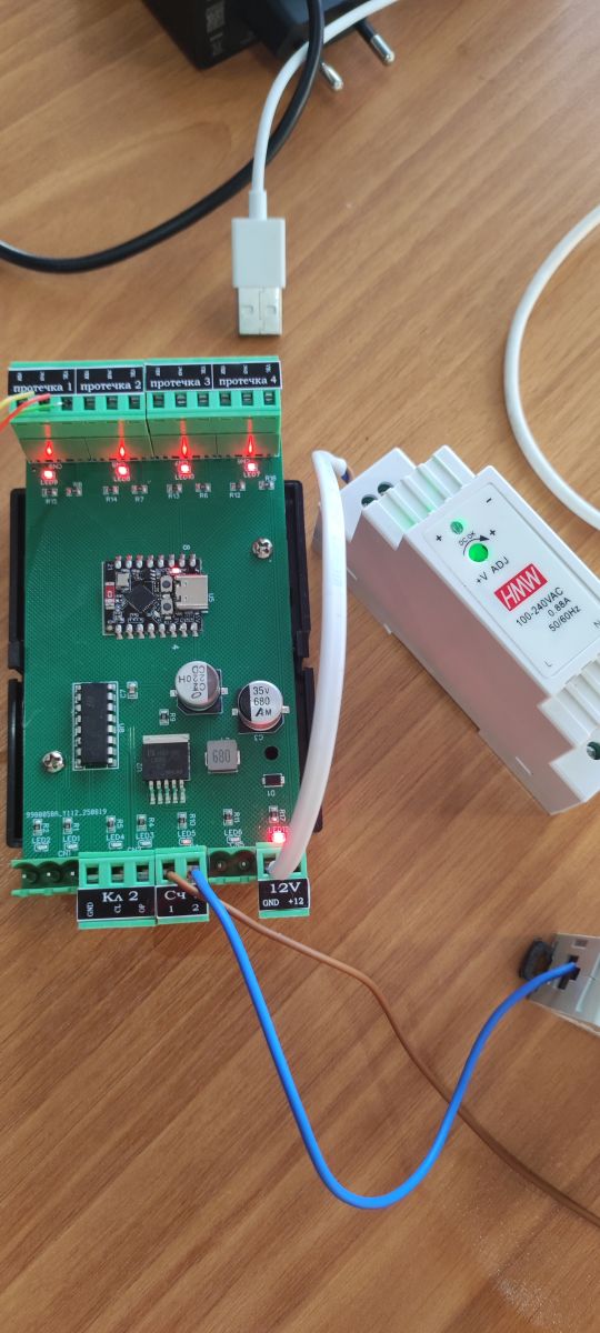

    Posts: 20
    Hello! I wanted to try flashing my ESP32-C3 device on openesp. This is a 4-sensor leak controller. When there is a leak, 2 valves close. The "IF" operator doesn't work; the controller reboots and provides an access point. Everything works well on the Beken chips. Here's the script:
    Electronic module with power supply and red indicator LEDs turned on
    setChannelType 11 Toggle
    setChannelLabel 11 "Kran1"
    setChannelType 12 Toggle
    setChannelLabel 12 "Kran2"
    alias krans1_reset backlog setChannel 1 0; setChannel 2 0
    alias krans2_reset backlog setChannel 3 0; setChannel 4 0
    alias kran1_open backlog setChannel 1 1; delay_s 5; setChannel 1 0
    alias kran1_close backlog setChannel 2 1; delay_s 5; setChannel 2 0
    alias kran2_open backlog setChannel 3 1; delay_s 5; setChannel 3 0
    alias kran2_close backlog setChannel 4 1; delay_s 5; setChannel 4 0
    addChangeHandler Channel11 == 1 backlog krans1_reset ; kran1_open
    addChangeHandler Channel11 == 0 backlog krans1_reset ; kran1_close
    addChangeHandler Channel12 == 1 backlog krans2_reset; kran2_open
    addChangeHandler Channel12 == 0 backlog krans2_reset; kran2_close
    Does not work.
    addChangeHandler Channel8 == 1 if $CH6==1 then "setChannel 11 1" Does not work.
    addEventHandler OnChannelChange 8 if $CH6==1 then "setChannel 11 1" Does not work.

    #234 21798097
    mvz0209
    Posts: 20
    Thank you, you're right — that's how it works...
    addChangeHandler Channel11 == 1 backlog setChannel 1 0; setChannel 2 0; setChannel 1 1; delay_s 5; setChannel 1 0
    addChangeHandler Channel11 == 0 backlog setChannel 1 0; setChannel 2 0; setChannel 2 1; delay_s 5; setChannel 2 0
    addChangeHandler Channel12 == 1 backlog setChannel 3 0; setChannel 4 0; setChannel 3 1; delay_s 5; setChannel 3 0
    addChangeHandler Channel12 == 0 backlog setChannel 3 0; setChannel 4 0; setChannel 4 1; delay_s 5; setChannel 4 0
    What's the solution to make it work reliably? Write a script in Berry?

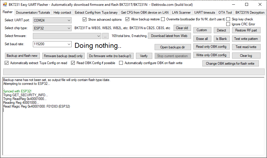

    Just testing and fooling around for now:
    BK7231 Easy UART Flasher interface with connected ESP32 device
    F01D83 -> ESP32

    >>21818678
    I thought about it, but considering how much code is needed and how many esp variants there are, i decided against it.
    If baud is different from 115200, it fails on C2. Works on 32, C3, C5, C6, C61, S3
