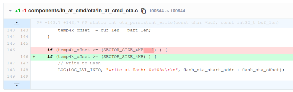

    Ah, they also found one of the bugs in OTA I recently discovered (after days of trying to isolate the problems with OTA and firefox):
    divadiow wrote:
    3. Fix the problem that the address may be calculated incorrectly during OTA file download and writing to flash
    Code snippet showing a fix changing the condition in an if statement.
    But they still don't see that data got from HTTP in rare cases could fill internal 4k buffer twice, which caused the main crashes during OTA.

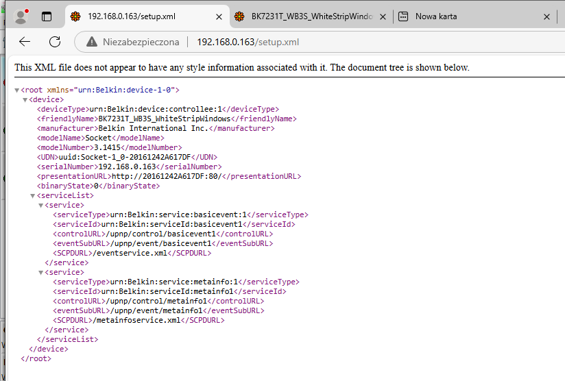

    Is it possible to enable the Wemo support for the LN882 like some of the other devices have? I can execute this command "backlog startDriver SSDP; startDriver Wemo" and it says OK but Alexa does not discover it. MQTT works fine. I use this feature with some BL602 devices I have and it works correctly. Great work supporting these other chips that aren't esp8266 and ESP32.
  • Checking whether setup.xml works on the device
    #293 21360764
    Posts: 14770
    Rate: 12913

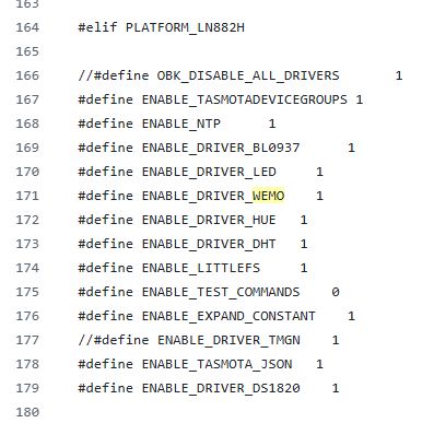

    I think you can use online builds system to try compiling LN882H with WEMO driver:
    https://www.elektroda.com/rtvforum/topic4033833.html
    Wait a second, I've just checked and it seems it's already enabled in the main tree:
    A code snippet configuring drivers for the LN882H platform.
    This means that you need to do some debugging.

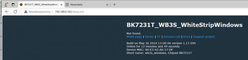

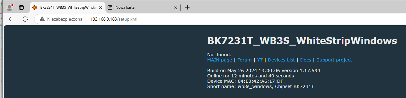

    WEMO driver reqisters following handlers:
    Code: C / C++
    They are not present when driver is not run:
    Screenshot of a webpage at URL 192.168.0.163/setup.xml displaying Not found message.

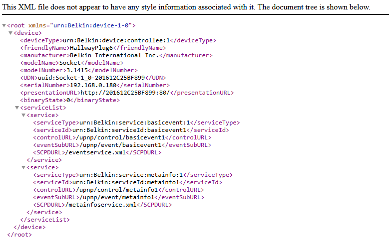

    but once you start a driver, you can visit them easily:
    http://192.168.0.163/setup.xml
    Screenshot showing an XML file with Belkin device data on a web page.
    So, my first question is - is the setup.xml working on your device?

  • #295 21371400
    jhatter55
    >>21360764 Sorry for just getting back to this. Yes Setup.xml works on the device and it looks like yours minus the different device name and ip address but Alexa does not discover it like it did for the BL602 device.
    Screenshot of an XML file showing Belkin device data.
