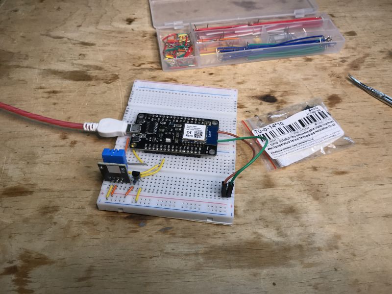

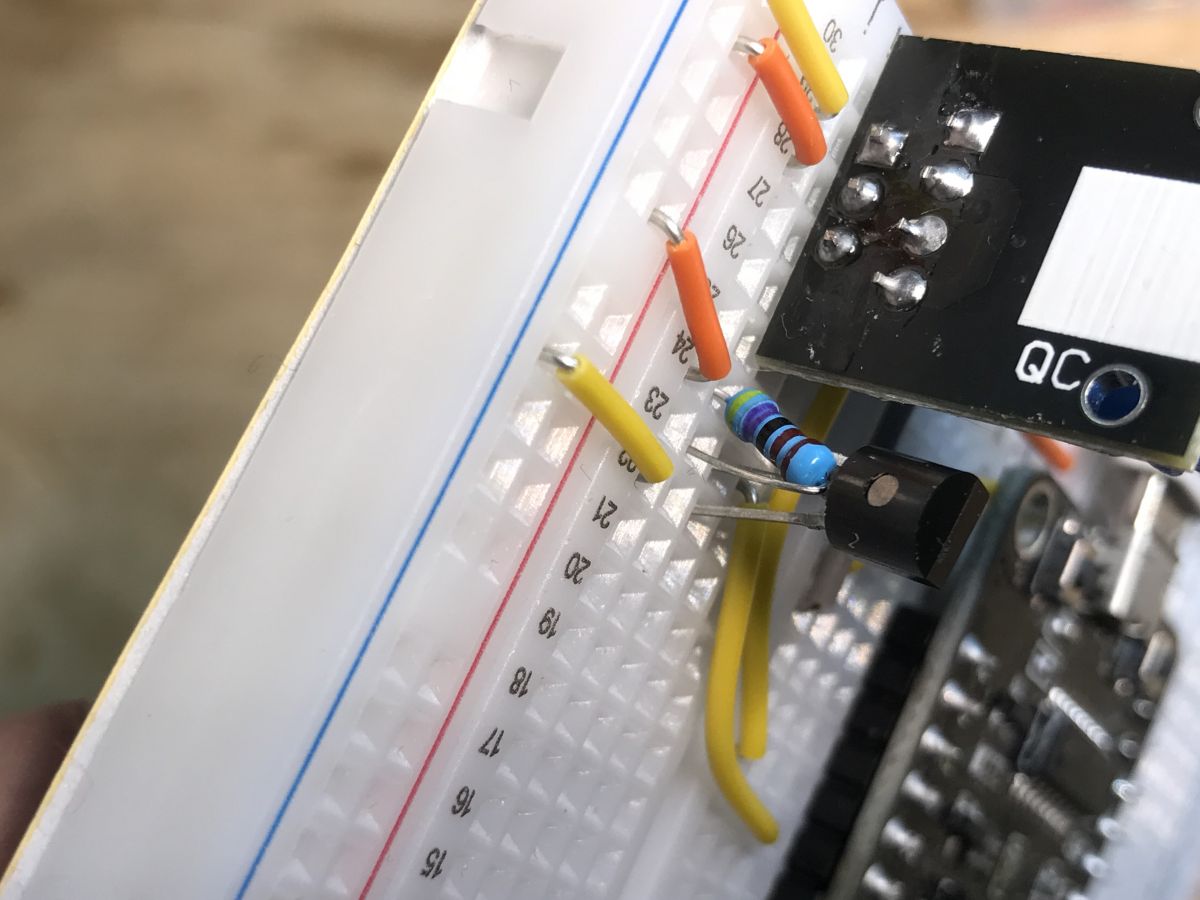

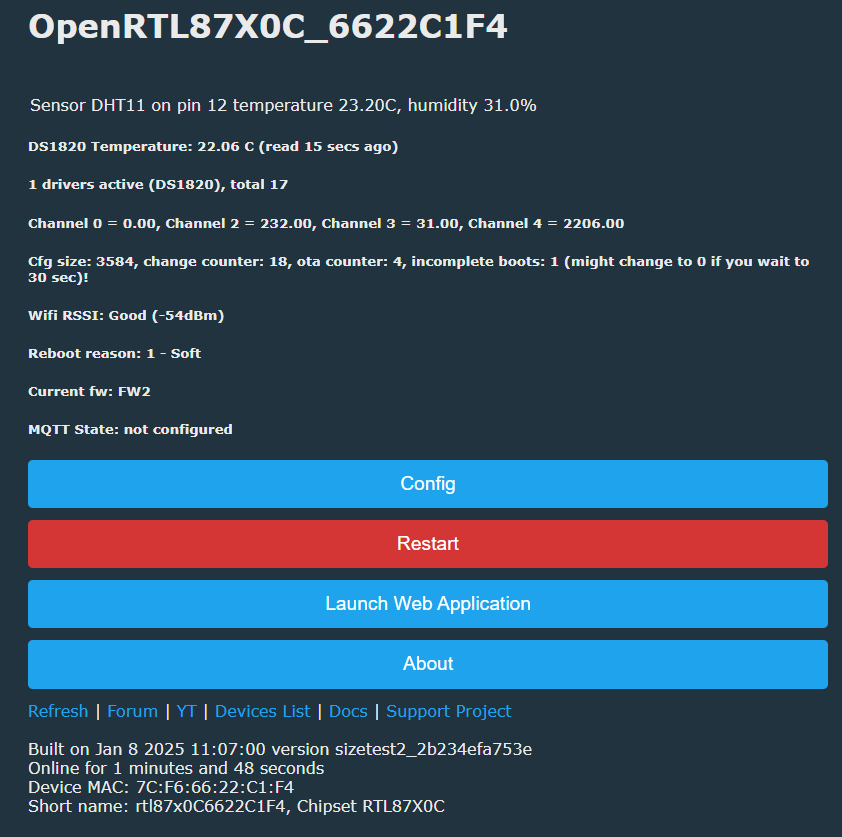

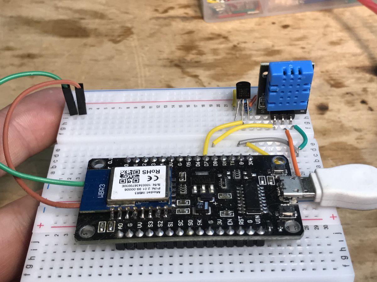

    We're still this on our TODO list. For now, I'm testing with DS18B20:
    OpenRTL87X0C user interface displaying sensor information and configuration options.

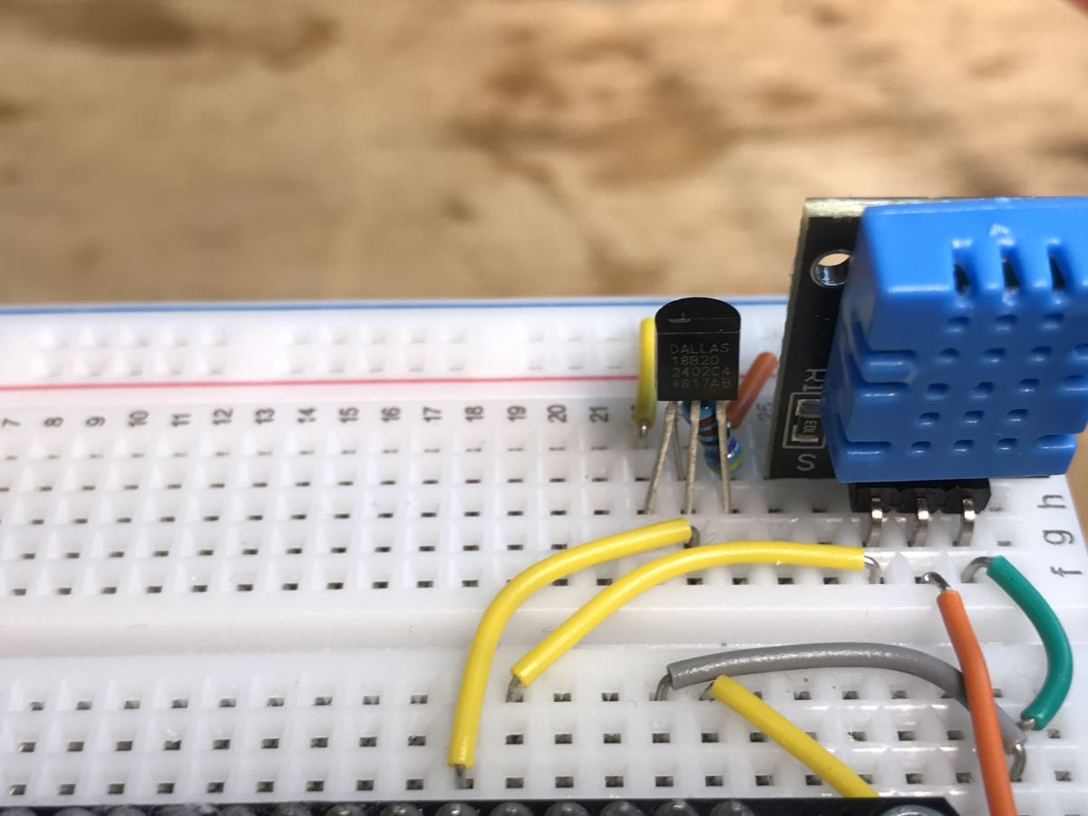

    Test setup:
    Test setup with DS18B20 sensor on a breadboard.
    Electronic test setup on a breadboard with DS18B20 sensor and DHT11 module.
    Breadboard with DS18B20 and DHT sensors placed next to each other, connected with colored wires.
    Close-up of a DS18B20 temperature sensor mounted on a breadboard with connected wires and a resistor.

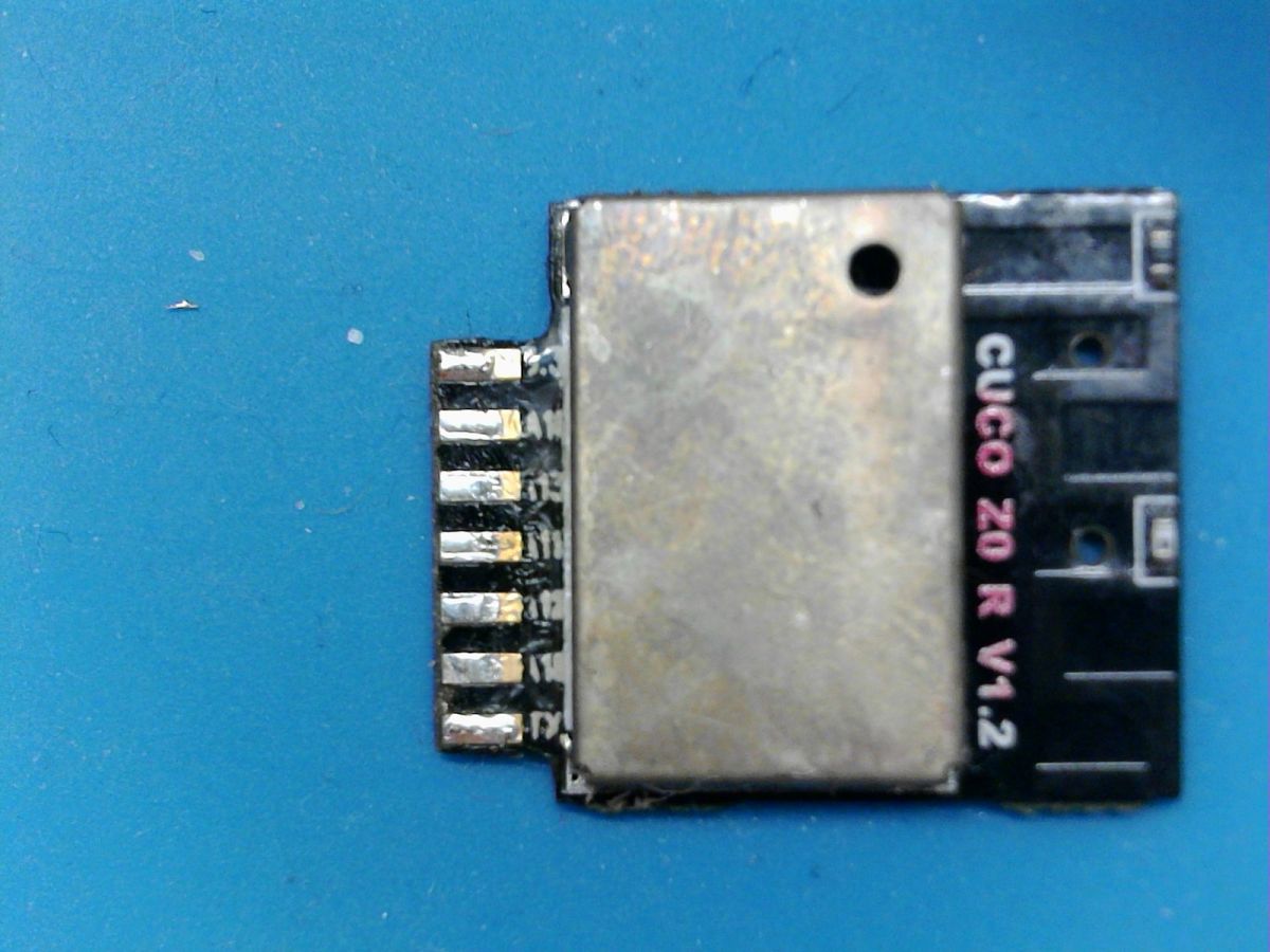

    nemetila
    I have used your guide on a Gosund SP1 Power Monitoring(BL097) Plug with the CUCO-Z0-R-V1.2. FR module(RTL8710CF chip) and it's working! To enter download mode: connect the RX and the IO0 pins to 3.3V. The two LEDs, the button, the relay are working. The BL097 seems working, but it requires calibration.
    == Rtl8710c IoT Platform ==
    Chip VID: 5, Ver: 3
    ROM Version: v3.0
    Test Mode: boot_cfg1=0x20
    Download Image over UART2[tx=16,rx=15] baud=115200

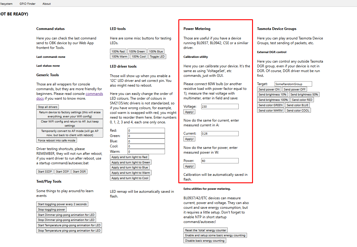

    Posts: 14755
    Rate: 12881

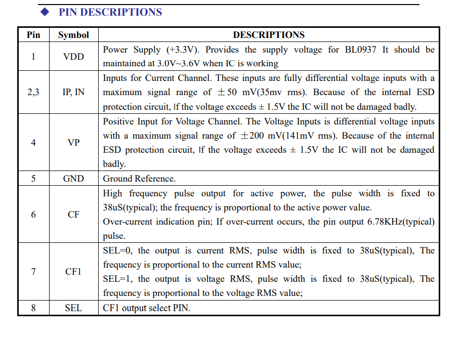

    BL0937 can be easily calibrated in a similiar way we do it in Tasmota, so with VoltageSet/PowerSet/CurrentSet commands. Futhermore, if you have device already paired with your WiFi, you can instead simply use our Web App wrapper in the Tools tab, there is a calibration GUI as well:
    Device calibration interface in a web application, showing the power metering section.
  • #35 21390055
    nemetila
    >>21390039
    Thank you, I found the Calibration utility, I will try it later.
    BL0937 calibration matches BL0942 within 1–2%

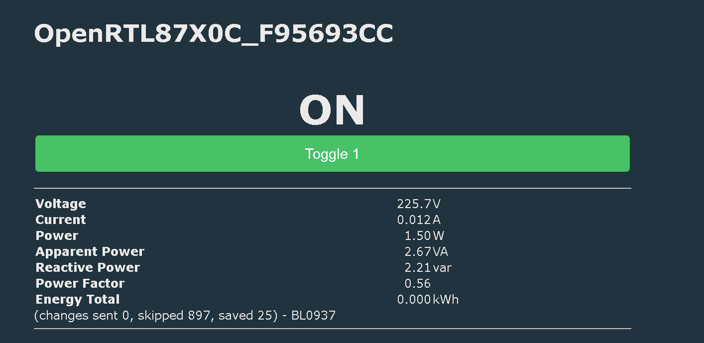

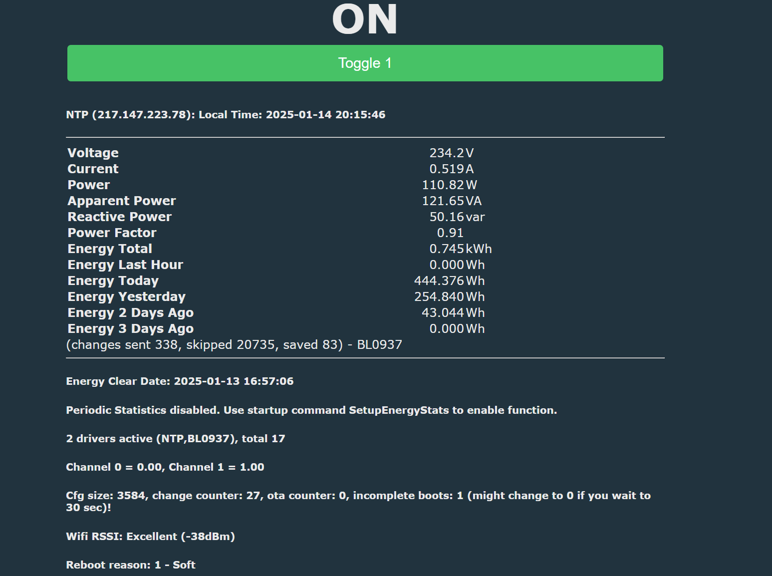

    #36 21393106
    nemetila
    >>21390055
    BL0937 calibration seems working (done with 250W bulb).
    Comparing with Gosund EP2(BL0942) Load: LCD TV+Denon Amplifier:
    - Voltage and Current are almost the same (1-2% difference)
    - Power factor BL0942 : 1.0 vs BL0937 : 0.9
    Measurement device screen displaying electrical energy data.

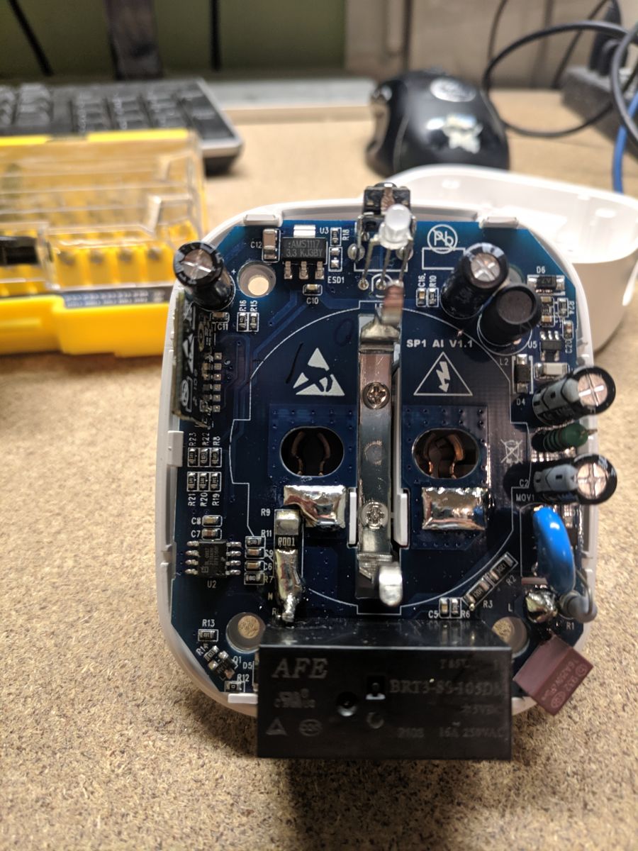

    Some images from the SP1:
    Electronic module CUCO Z0 R V1.2 on a blue background.
    Close-up of a circuit board with visible traces and markings on a blue background.
    Image of the interior of an SP1 electronic device showing the circuit board and components.

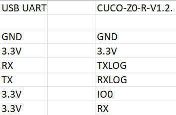

  • Flashing pinout and OpenBeken template for WBR2/WBR3/WBRU/W701-VA2-CG

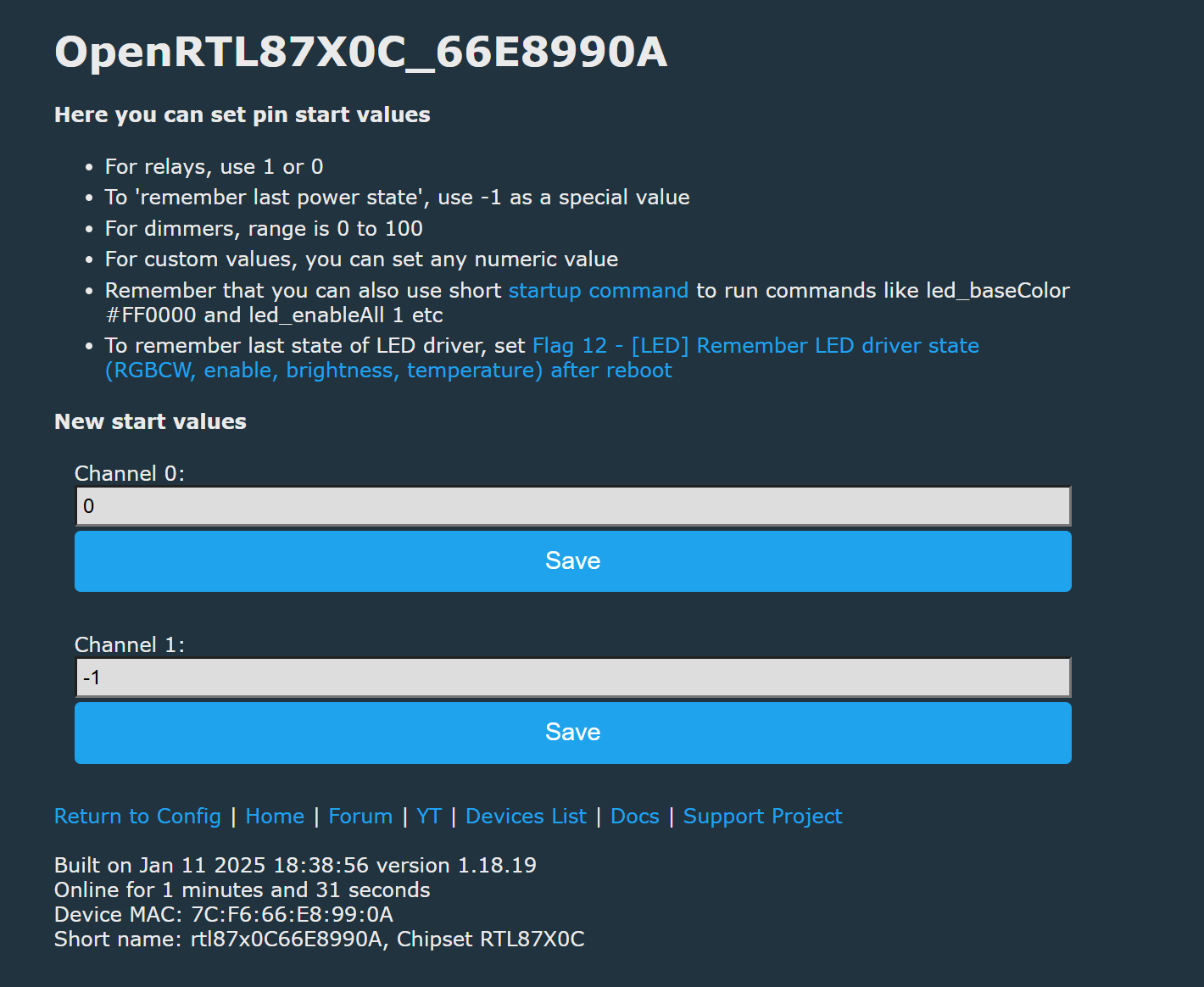

    #38 21394332
    nemetila
    >>21394225
    Flashing pinout:
    Table comparing pins of USB UART and CUCO-Z0-R-V1.2
    Template:
    rtl87x0C66...-44-47.zip (493 bytes)You must be logged in to download this attachment.
      "vendor": "Tuya",
      "bDetailed": "0",
      "chip": "RTL87X0C",
      "board": "TODO",
      "flags": "1024",
      "keywords": [
        "TODO",
        "TODO",
        "TODO"
      "pins": {
        "3": "Rel;1",
        "4": "BL0937SEL;0",
        "11": "WifiLED_n;0",
        "13": "Btn;1",
        "14": "LED_n;1",
        "17": "BL0937CF;0",
        "18": "BL0937CF1;0"
      "command": "",

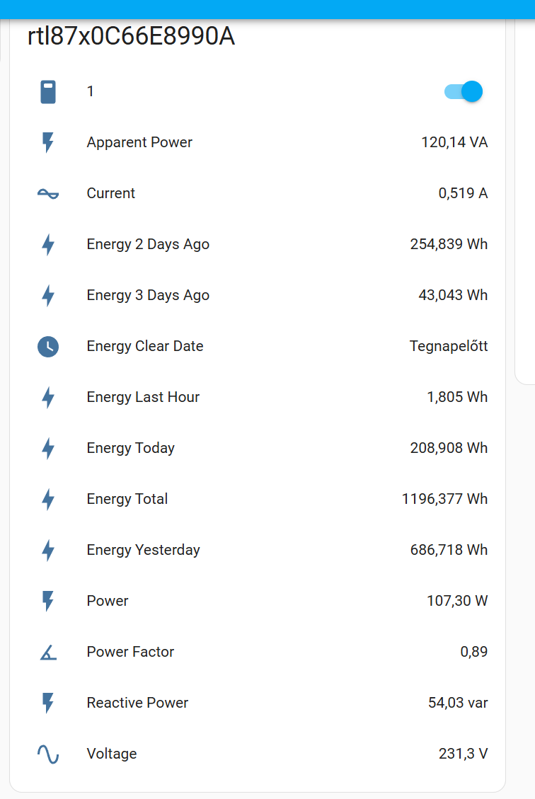

    I set relay: "remember last power state"
    OpenRTL87X0C user interface with pin settings and new start values
    autoexec.bat:
    startDriver BL0937
    startDriver NTP
    ntp_timeZoneOfs 01:00
    PowerSave 0
    VCPPublishIntervals 60 60
    MQTT and Home Assistant Discovery is OK:
    Screenshot of energy monitoring results in Home Assistant.

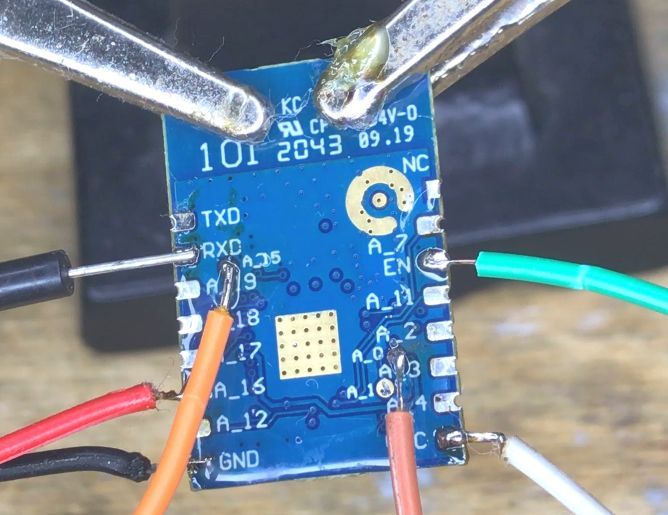

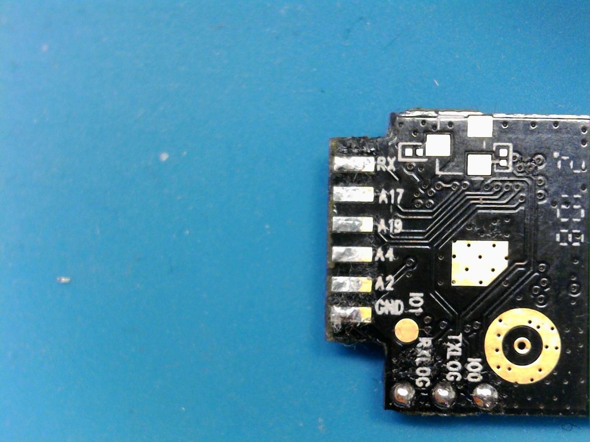

  • Need for A0 and A15 access when flashing WBR3
    #44 21420024
    itsmaxdd
    i'm about to buy a Beca BHT-006GCLW which is supposed to have a WBR3 chip.
    I like the device aesthetically but i'm a bit drawn back by the fact i have to desolder the MCU to use it away from tuya or similar things.
    Do you think that with a dremel one could drill the back side of the board to expose A0 and A15 through the PCB?
    Here it is suggested that the only pin on the back needed to flash is the A0, is that true or do we also need A15? I guess that since it is the LOG_TX it is quite mandatory?
    https://github.com/libretiny-eu/libretiny/issues/235#issuecomment-1875967472
  • #45 21420124
    Posts: 5212
    Help: 446
    Rate: 914
    Yes, A15, A16 and A0 are all needed to programme RTL8720CF as seen in image in first post
    Close-up of RTL8720CF electronic module with connected wires.

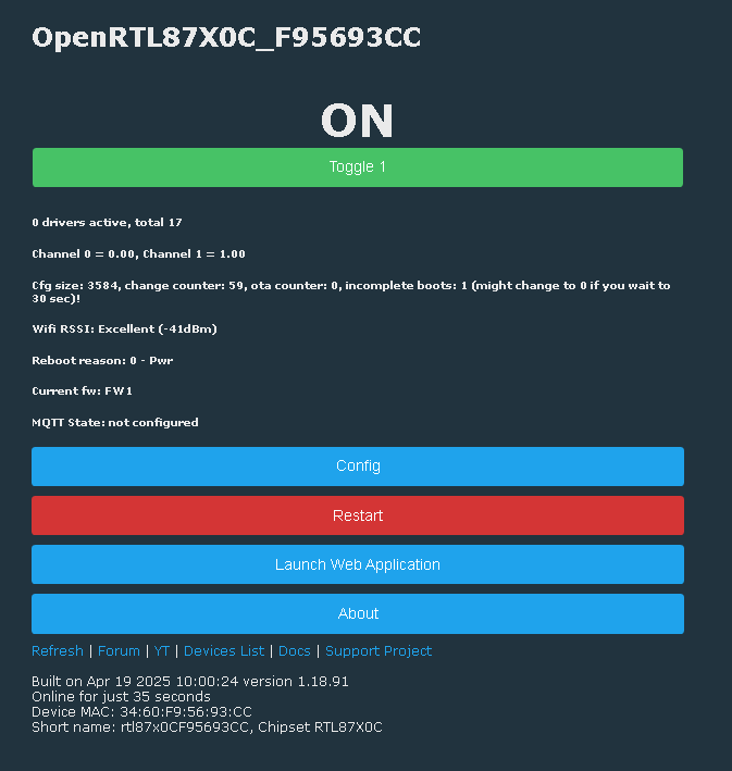

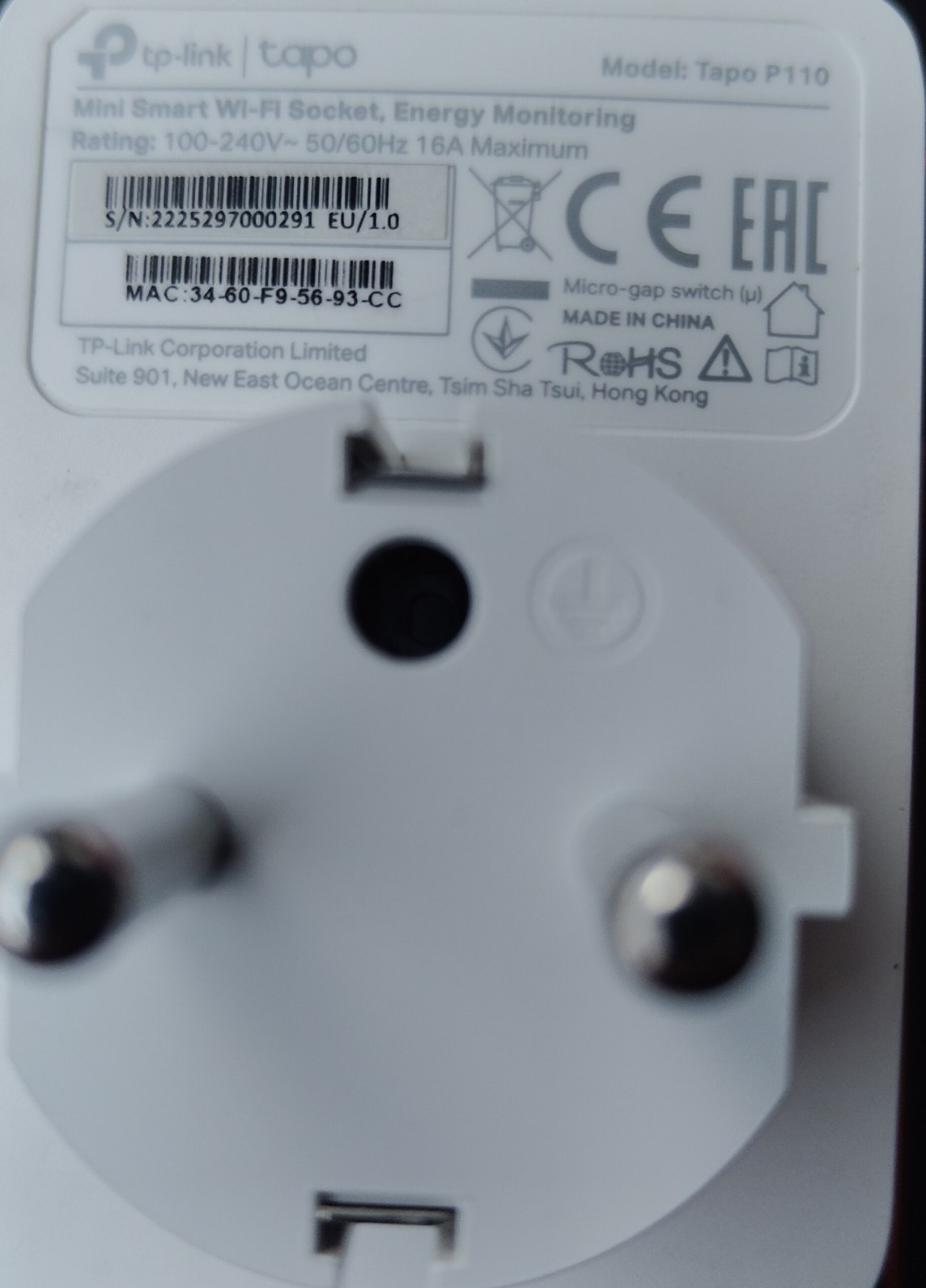

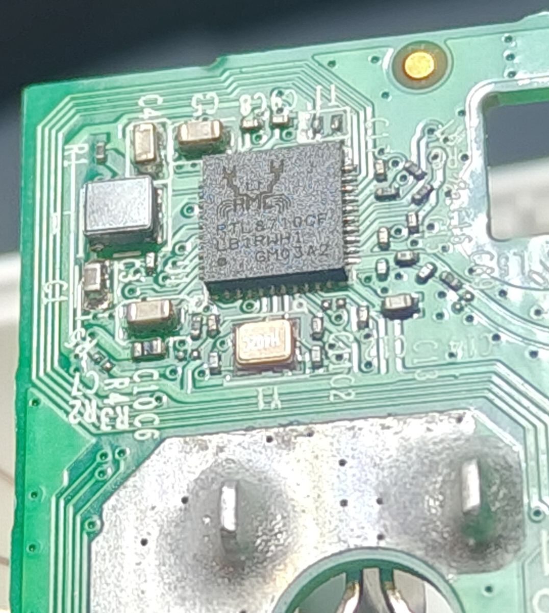

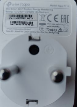

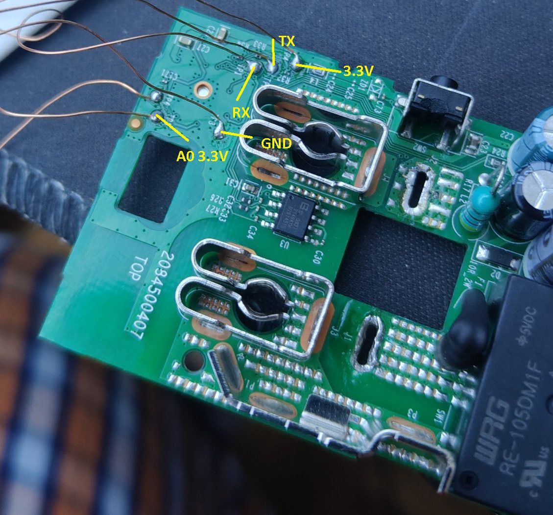

  • Tapo P110 flashed with RTL8710CF and pin mapping shared
    #53 21531209
    kalikum
    Posts: 9
    Hi everyone,
    Following the information I found https://www.elektroda.com/rtvforum/topic4097185.html, I was able to flash version 1.18.91 of the RTL8710CF chipset onto my Tapo P110. I'm sharing the pins where the connections go. I made the mistake of not documenting the power control pins before assembling and closing it, so if anyone has this information, we could complete the setup.
    I only have this image
    PCB with marked connection points: TX, RX, GND, AO 3.3V, 3.3V – labeled in yellow.
    Webportal
    Screenshot of the OpenRTL87X0C device control panel showing device status, buttons, and technical details.
    Template not complete yet:
      "vendor": "Tuya",
      "bDetailed": "0",
      "chip": "RTL87X0C",
      "board": "TODO",
      "flags": "1024",
      "keywords": [
        "TODO",
        "TODO",
        "TODO"
      "pins": {
        "12": "Rel;1",
        "17": "Btn;1",
        "18": "LED_n;1",
        "19": "LED;1"
      "command": "",
    I am very sorry to don't have more details of the process I followed, I thought it too late. :(
    Thank you very much for all the information you posted, without you literally this could not be done.
    Sorry if there is any grammatical error, I use translator

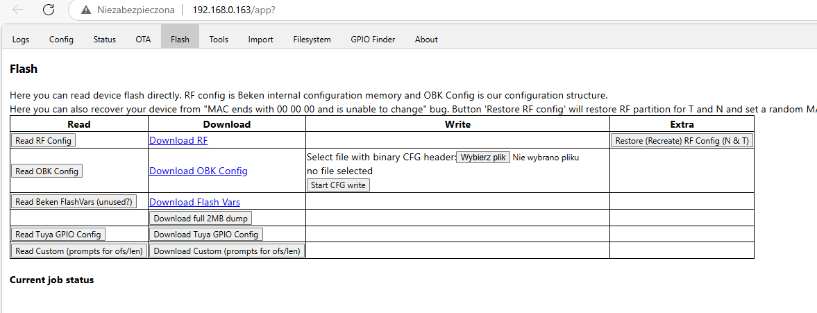

  • #54 21531212
    Posts: 14755
    Rate: 12881
    Maybe we could try to read the device Tuya config via the Web App? I'm not sure if the offset is updated there. Still, we also have that option to read full 2MB. That would certainly include your SSID and so on, but could also include the Tuya config.
  • #55 21531222
    kalikum
    Posts: 9
    Can it be done without opening the switch or welding cables? I have thought about buying another and documenting it well, although I don't know when I could do it.
    If I do, I will share it, I am sure.
  • #56 21531234
    Posts: 14755
    Rate: 12881
    It is done in software, but I am not sure if it's implemented on this Realtek yet. I am talking about flash read option in the web app:
    Screenshot of an IoT device management panel at 192.168.0.163, Flash tab, showing options to read, download, and write configuration files.
  • #58 21531614
    kalikum
    Posts: 9
    >>21531234
    Thanks, I'm going to check
    >>21531238
    No, it's a tapo p110 EU but with the chip RTL8710CF
    Close-up view of the back of a TP-Link Tapo P110 smart plug with visible markings and prongs.
  • Tapo P110 RTL8710CF pinout and template update
    #59 21537845
    kalikum
    Posts: 9
    >>21531209
    Little update.
    Template:
    Chip on Tapo P110 RTL8710CF
    Close-up of a Realtek RTL8710CF microchip on a green PCB with visible electronic components.
    Consumption operation, Not calibrated yet .
    Device control panel screen with voltage, current, and power information.

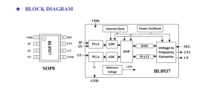

    Finally I have disassembled and followed the ways to the chip.
    Block diagram and pinout of the BL0937 chip in SOP8 package.
    Table describing the pin functions of the BL0937 IC, listing pin numbers, symbols, and detailed descriptions.
    Thanks again for information.
