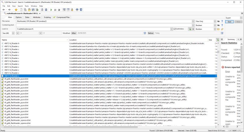

    where's that exact file from btw? I've not found it yet in all the zips and repos ive downloaded

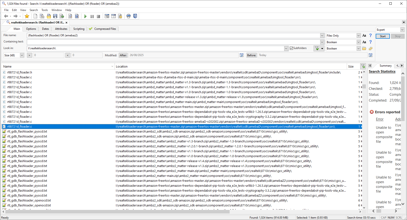

    ah ok ta. trying to find alternatives
    WBR2, WBR3, WBRU, W701-VA2-CG pinout, datasheet, flashing for Home Assistant
    Added after 1 [hours] 2 [minutes]:
    what's this? RTL-D floader source?

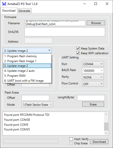

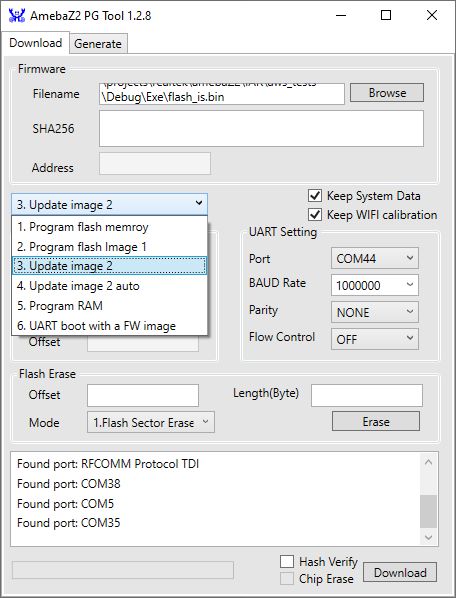

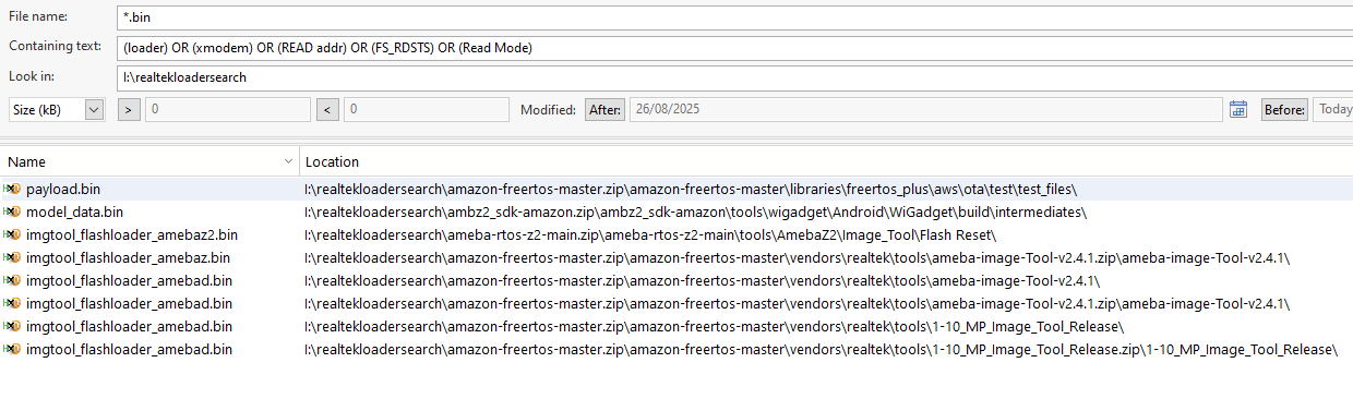

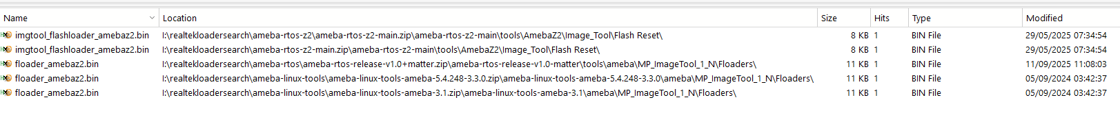

    are these pgtool flash options interesting/seen before?

    But it's completely different from other RTLs, and then there's this
        def read(self, length):
            self.logger.debug(sys._getframe().f_code.co_name)
            self.logger.info("don't support read ...")
            return False
    Plus there is such a thing as different flash pins.
    PG Tool tooltip shows that it would be set automatically, but i don't see it in python code.

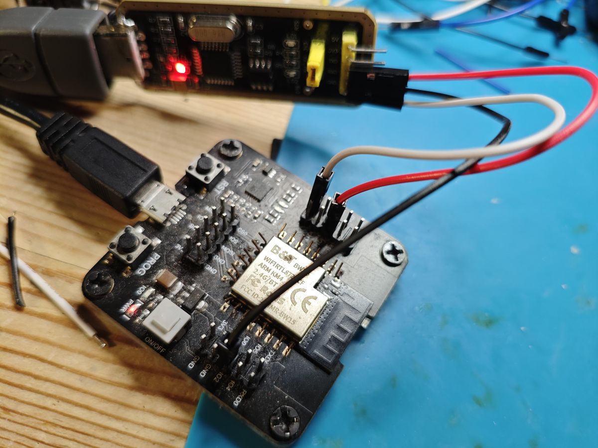

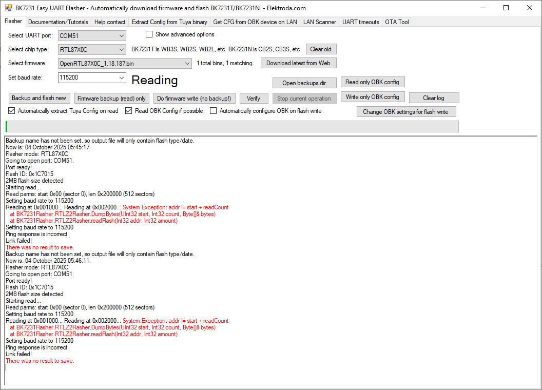

    still win10 here. but wouldn't a move to .net 4.8 be a good move anyway?
    just playing with Z2. not got it to complete read yet though. BW15 module.
    Screenshot of BK7231 Easy UART Flasher showing a flash read error
    ESP32 development board with wired connections and a USB programmer on a workbench
    EF also quits unexpectedly a lot - if port is in use, Z2 not in uart downloade mode, starting new read operation after previous failed one (stop operation is greyed out but GUI allows new read/write when previous failed read/write still looks to be in progress)
    Other read tool completes but see these a few times
    I'll mix it up with different Z2 rig.

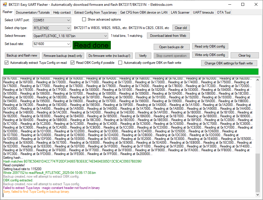

    Added after 17 [minutes]:
    same setup. got a read success at 921600
    Screenshot of BK7231 Easy UART Flasher with memory read operation completed

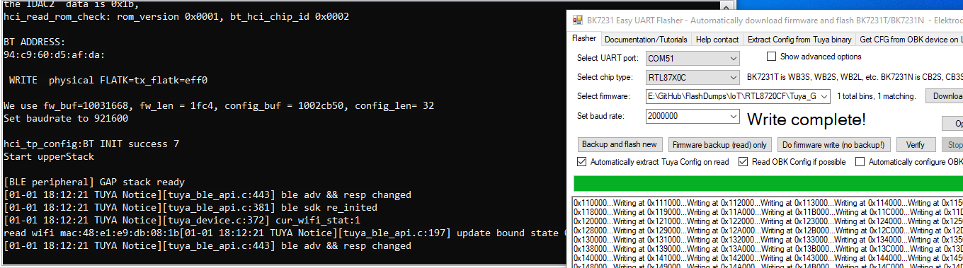

    Added after 3 [minutes]:
    nice. drag and dropped Tuya dump. flashed and boots OK
    Bluetooth log console and BK7231 Easy UART Flasher with Write complete! message

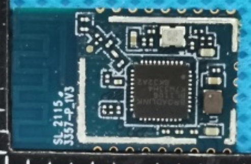

    Broadlink RM4C mini, module - 3357-P_1V3, chip - BL1106
    115200 baud
    == Rtl8710c IoT Platform ==
    Chip VID: 5, Ver: 3
    ROM Version: v3.0
    == Boot Loader ==
    Dec  9 2020:20:15:00
    Boot Loader <==
    == RAM Start ==
    Psm type 0 active data 26
    Psm type 1 active data 187
    targetFWaddr e8000 currentFWaddr 10000

    >>21714597
    Electronic module with microchip labeled BROADLINK on a blue PCB
    cool. were you angling for an RDA5981 with BroadLink purchase?
  • #118 21714704
    insmod
    Posts: 1432
    Help: 168
    Rate: 455
    >>21714651
    I've already had it for a year, and only remembered about it today.

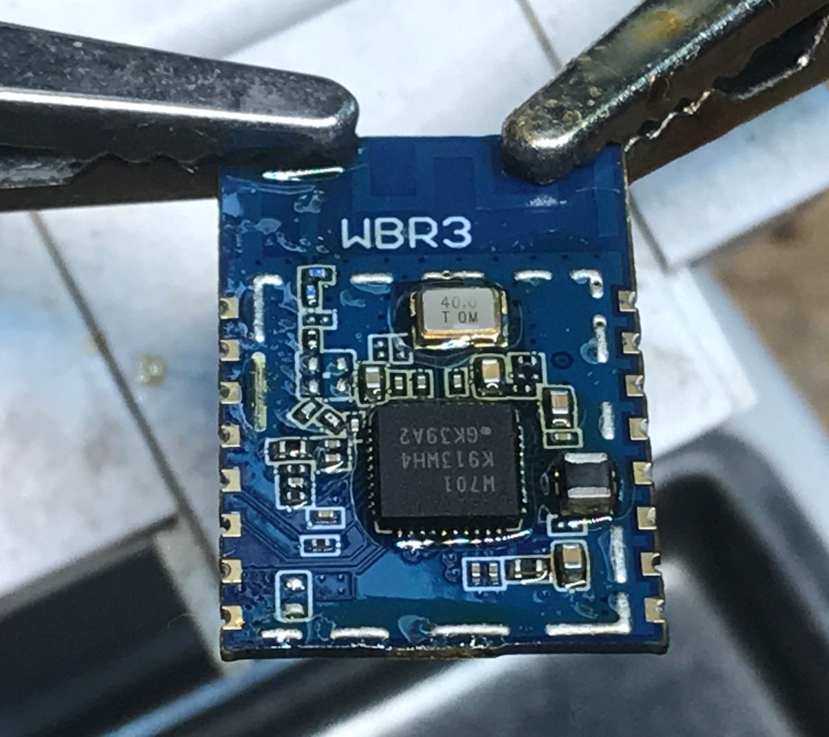

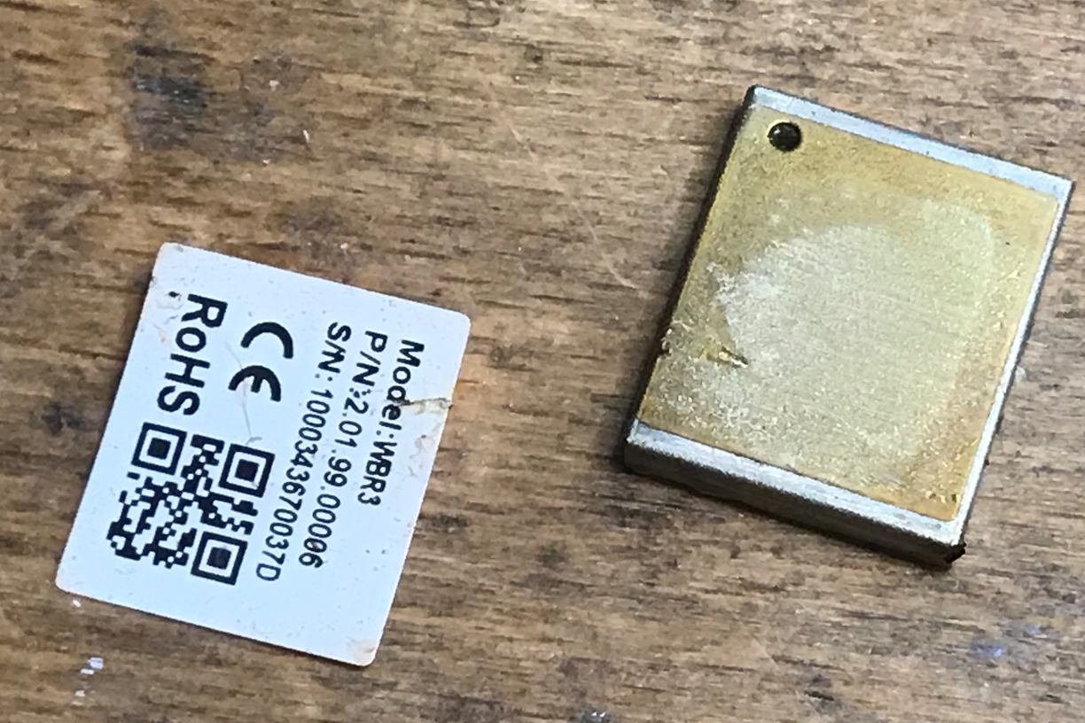

    And here's WBR3 closeup without shielding:
    WBR3 electronic module with visible ICs and side soldering pins
    (I am clearing up old photos so I decided to post it here :D)
    Added after 26 [seconds]:
    WBR3 electronic module with detached identification label on wooden surface
