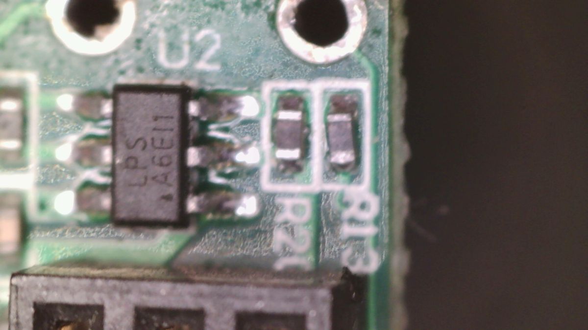

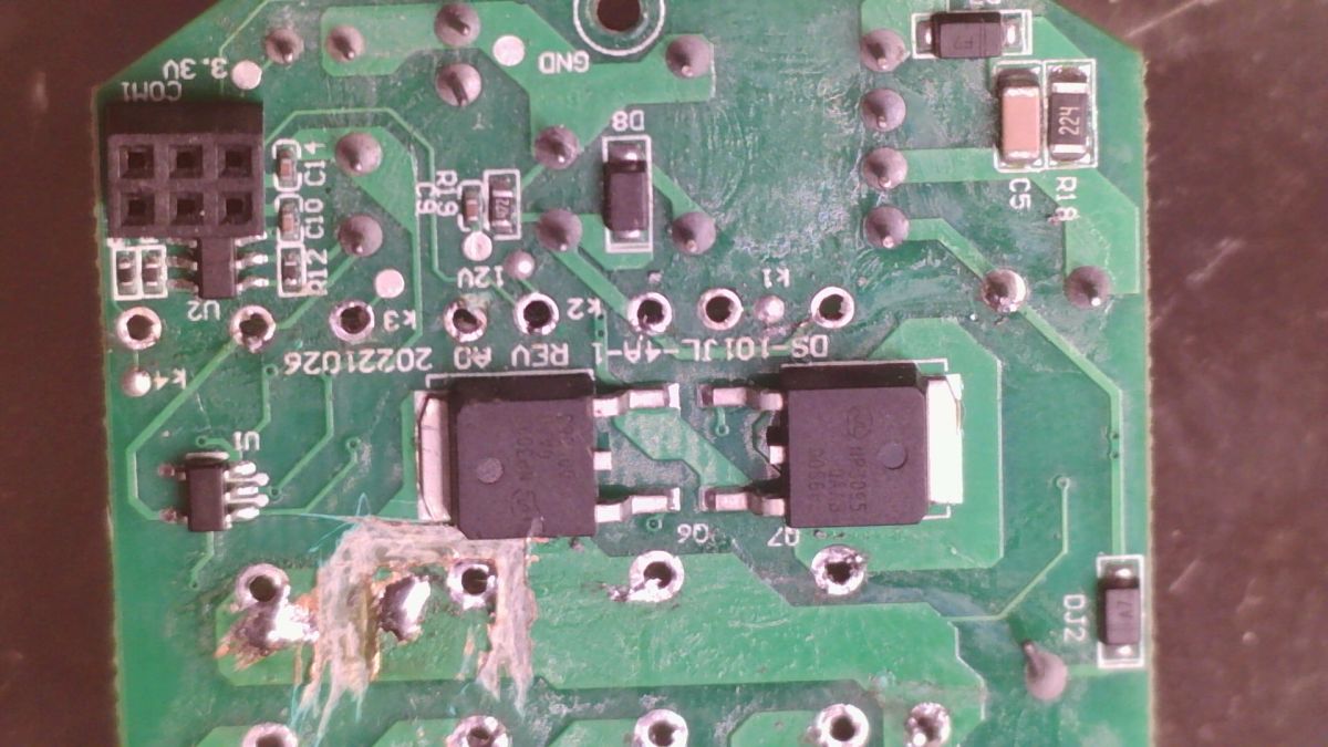

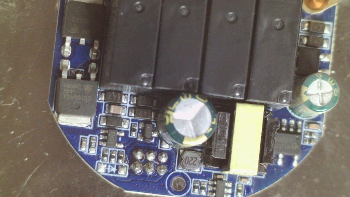

    out of curiosity, i've already had 4pcs die. The inverter died in all of them, probably the 7142s, hard to say. you can't see from any of the components "burned", nothing heats up. The 12v voltage is 0 or 1.5v, depends on the piece.
    i counted that only 3v3 died, and I was supposed to insert something stronger, and here lame.
  • #42 21800993
    Posts: 14515
    Help: 651
    Rate: 12518
    And not a capacitor? On Tuya or after the firmware change, was PowerSave 1?
  • #43 21801004
    chemik_16
    Posts: 1000
    Help: 74
    Rate: 127

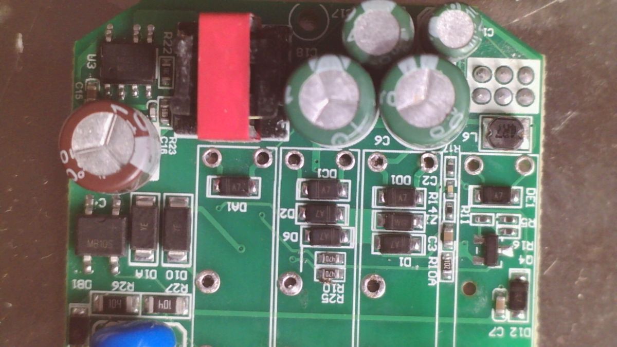

    which capacitor ? 400v (and there is 300v on it) looks ok, diodes too
    here i have just reworked mine, i just had lighting, roller blinds, outdoor lighting each with a different differential ;p
    Close-up of a PCB with electronic components and signs of burn damage Close-up of a PCB with electrolytic capacitors, 4R7 inductor, and SMD components
    Added after 58 [seconds]:
    ps neat little relays
    FANHAR W18-1AST DC12V relay on a metallic surface
    on some there was a power save, on others not. One converted to esp32c3. Either way it would have been the 3v3 that died rather than the main inverter.
    ps2.
    here's a 4gang with a round can, interestingly it's exactly the same schematic and components, just arranged differently on the PCB
    Close-up of an electronic module with relays, capacitors, and an inductor.

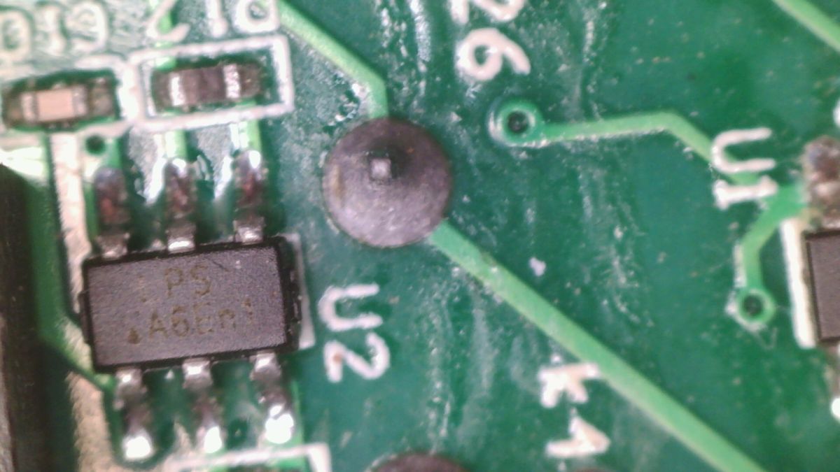

    i'll also add that towards the end of its life, as I look at the HA logs, it scored frequent reboots, even several times a minute.
    Added after 59 [minutes]:
    well, i suspected a bit about this IC on the oscilloscope and you can see that it is alive, it generates 30v in front of the trafo and has 4-5v on the power pins.
    i took a closer look at 3v3 and in fact on all of them it has a point in exactly the same place, I thought it was some kind of Chinese mark :) after desoldering 12V it works
    Close-up of an A6E1 LPS chip labeled U2 next to SMD components R21 and R13 on a PCB Close-up of PS A6EI1 integrated circuit on a PCB marked U2
    A6EI1, I can't find the note, it's probably not a linear stabilizer ? on the other hand the coil 4R7

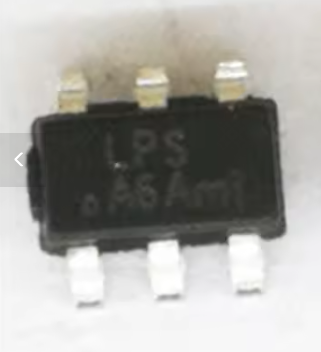

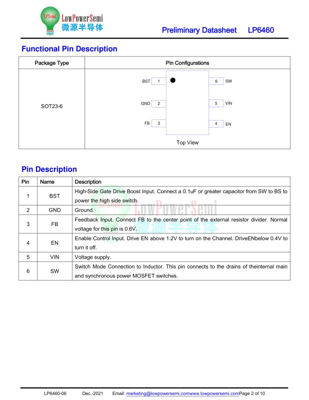

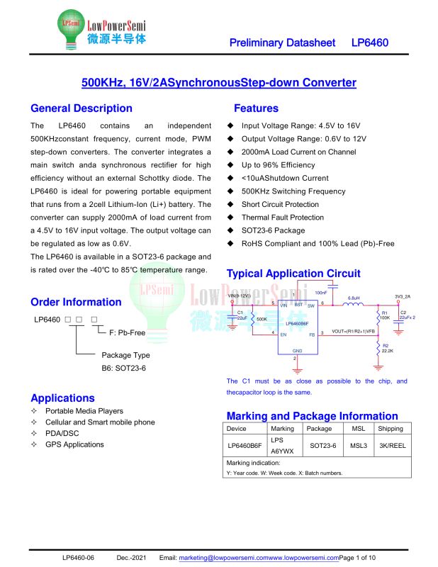

    Perhaps something similar to this:
    Black SOT23-6 IC with “LPS A6Am1” marking on the package
    10PCS/LOT LP6460 SOT23-6 marking is LPS A6*** LP6460B6F new original
    Btw there's a rule of thumb - if it's a 12V relay, it's step down, and if it's 5V, it's LDO.
    LP6460 datasheet page showing description, features, and application circuit Pinout diagram and pin function table for LP6460 in SOT23-6 package Block diagram of LP6460 chip with labeled inputs, outputs, and voltage ratings
    Added after 53 [seconds]:

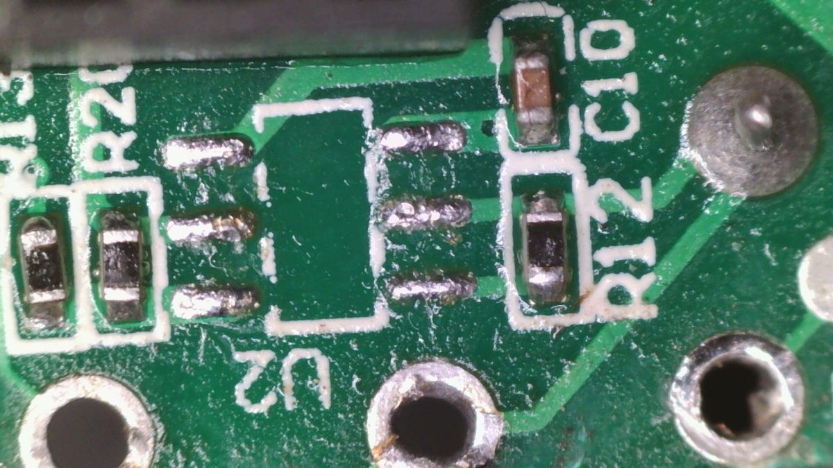

    Does the "fingerprint" - ground, input, output - does it match?
  • #45 21801321
    chemik_16
    Posts: 1000
    Help: 74
    Rate: 127
    centre left = ground
    centre right = 12V
    ?                3v3 (vout)
    GND          12v (vin)
    Close-up of a PCB with missing IC chip, exposed solder pads, and nearby SMD resistors
    so it looks similar
    i knocked it out, put in a 360 mini inverter module, with a 22k resistor it gives me 3v4, maybe it will live longer.
    but if it's like you write it was even better. At 2A it's about 6W, it shouldn't burn up ....
