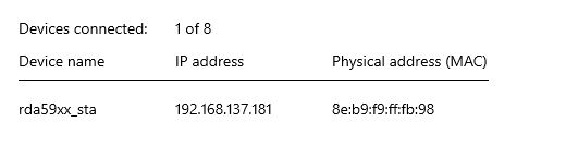

  • OpenRDA5981 boot log confirms firmware startup
    #94 21700302
    Posts: 5214
    Help: 448
    Rate: 916
    insmod wrote:
    https://github.com/NonPIayerCharacter/OpenBK7231T_App/actions/runs/18007127807
    omg
    (unnecessarily long log - AP wasn't ready and it didn't seem to try connecting again after boot)
    RDA 5981AM/Broadlink BL3335-P - Generic/nobrand 15W RGBW B22 Bulb - basic teardown

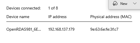

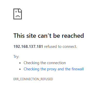

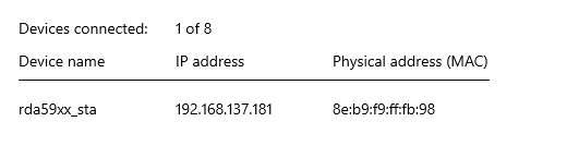

    congrats. gui still dies seconds after connecting, but wifi save/sta is a step.
    logs don't show anything beyond
  • AP mode fails to save after GUI crash

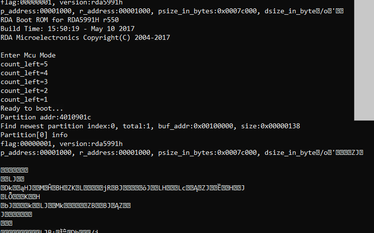

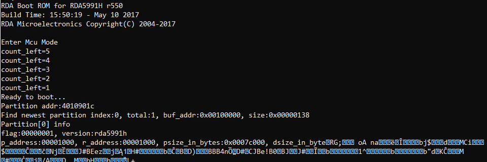

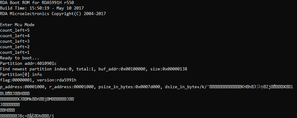

    when gui dies:
    insmod wrote:
    https://github.com/NonPIayerCharacter/OpenBK7231T_App/actions/runs/18007843832
    it's back to not saving/AP

    RDA Boot ROM for RDA5991H r550
    Build Time: 15:50:19 - May 10 2017
    RDA Microelectronics Copyright(C) 2004-2017
    Enter Mcu Mode
    count_left=5
    count_left=4
    count_left=3
    count_left=2
    count_left=1
    Ready to boot...
    Partition addr:4010901c
    Find newest partition index:0, total:1, buf_addr:0x00100000, size:0x00000138
    Partition[0] info
    flag:00000001, version:rda5991h
    p_address:00001000, r_address:00001000, psize_in_bytes:0x0007c000, dsize_in_bytes H) F ----------------maclib task
    OpenRDA5981, version _gcc6

  • #98 21700329
    Posts: 5214
    Help: 448
    Rate: 916
    insmod wrote:
    https://github.com/NonPIayerCharacter/OpenBK7231T_App/actions/runs/18008161608
  • #100 21700340
    Posts: 5214
    Help: 448
    Rate: 916
    insmod wrote:
    https://github.com/NonPIayerCharacter/OpenBK7231T_App/actions/runs/18008554600
    RDA5991H boot log with initialization messages and corrupted characters
  • Boots on RDA5991H but settings do not save
    #102 21700345
    Posts: 5214
    Help: 448
    Rate: 916
    insmod wrote:
    https://github.com/NonPIayerCharacter/OpenBK7231T_App/actions/runs/18008810986
    boots. no saving
  • OpenRDA5981 firmware boots and registers commands
    #104 21700354
    Posts: 5214
    Help: 448
    Rate: 916
    insmod wrote:
    https://github.com/NonPIayerCharacter/OpenBK7231T_App/actions/runs/18009005594
    back to AP
    Enter Mcu Mode
    count_left=5
    count_left=4
    count_left=3
    count_left=2
    count_left=1
    Ready to boot...
    Partition[0] info
    p_address:00001000, r_address:00001000, psize_in_bytes:0x0007c000, dsize_in_byte B2 ) ----------------maclib task
    Enter Mcu Mode
    count_left=5
    count_left=4
    count_left=3
    count_left=2
    count_left=1
    Ready to boot...
    Partition[0] info
    p_address:00001000, r_address:00001000, psize_in_bytes:0x0007c000, dsize_in_byte B3 5    o2 SH  I ----------------maclib task

  • OpenRDA5981 firmware boots and connects to Wi-Fi
    #106 21700362
    Posts: 5214
    Help: 448
    Rate: 916
    insmod wrote:
    https://github.com/NonPIayerCharacter/OpenBK7231T_App/actions/runs/18009224620
    saves. connects to wifi. status change - 4
    Spoiler:

    Debug:GEN:+--------------- net device info ------------+
    Debug:GEN:|netif type : STA |
    Debug:GEN:|netif rssi = -50 |
    Debug:GEN:|netif ip = 192.168.137.179 |
    Debug:GEN:|netif mask = 255.255.255.0 |
    Debug:GEN:|netif gateway = 192.168.137.1 |
    Debug:GEN:|netif mac : [9e:63:6e:fe:55:22] |
    Debug:GEN:+--------------------------------------------+
    Info:MAIN:Time 11, idle 0/s, free 72891, MQTT 0(1), bWifi 1, secondsWithNoPing -1, socks 2/8
    Info:MAIN:Time 12, idle 0/s, free 72891, MQTT 0(1), bWifi 1, secondsWithNoPing -1, socks 2/8
    Info:MAIN:Time 13, idle 0/s, free 72891, MQTT 0(1), bWifi 1, secondsWithNoPing -1, socks 2/8
    Info:MAIN:Time 14, idle 0/s, free 72891, MQTT 0(1), bWifi 1, secondsWithNoPing -1, socks 2/8
    Info:MAIN:Time 15, idle 0/s, free 72891, MQTT 0(1), bWifi 1, secondsWithNoPing -1, socks 2/8
    Connected devices list showing one device with name, IP address, and MAC address
  • #108 21700376
    Posts: 5214
    Help: 448
    Rate: 916
    insmod wrote:
    https://github.com/NonPIayerCharacter/OpenBK7231T_App/actions/runs/18009614142
    RDA Boot ROM boot screen showing partition info and hexadecimal data
  • #110 21700397
    Posts: 5214
    Help: 448
    Rate: 916
    ooh ok. sounds.. better? freetos more familiar I guess..
  • OTA compression build with stubbed heap stats
    #111 21700412
    insmod
    Posts: 1432
    Help: 168
    Rate: 455
    But it's hard and practically impossible without having module on hand.
    I'll use ota compression from there though.
    https://github.com/NonPIayerCharacter/OpenBK7231T_App/actions/runs/18010964628
    stubbed free heap and disabled heap stats.
    Added after 48 [minutes]:
    With ota and powersave
    Ota shouldn't work, but it might.
    https://github.com/NonPIayerCharacter/OpenBK7231T_App/actions/runs/18012236298
    Debug heap: https://github.com/NonPIayerCharacter/OpenBK7231T_App/actions/runs/18012556678

    #112 21700633
    Posts: 5214
    Help: 448
    Rate: 916
    insmod wrote:
    initial boot, client join AP, browser attempt tried - no Gui (as is often the case until another reboot and retry)
    Spoiler:

  • RDA5991H boot fails with HardFault at flash boot
    #114 21700881
    Posts: 5214
    Help: 448
    Rate: 916
    insmod wrote:
    https://github.com/NonPIayerCharacter/OpenBK7231T_App/actions/runs/18025895541
  • RDA5991H boot log shows invalid firmware image
    #116 21700890
    Posts: 5214
    Help: 448
    Rate: 916
    insmod wrote:
    https://github.com/NonPIayerCharacter/OpenBK7231T_App/actions/runs/18028062788
  • GUI accessible briefly before firmware crash
    #118 21700896
    Posts: 5214
    Help: 448
    Rate: 916
    insmod wrote:
    https://github.com/NonPIayerCharacter/OpenBK7231T_App/actions/runs/18028229652
    ah ha. gui accessible straight away but then dies quickly
    Spoiler:
    Enter Mcu Mode
    count_left=5
    count_left=4
    count_left=3
    count_left=2
    count_left=1
    Ready to boot...
    Partition[0] info
    p_address:00001000, r_address:00001000, psize_in_bytes:0x0007d000, dsize_in_byte j (----------------maclib task
    OpenRDA5981, version rda5981_674bf34fad1c
