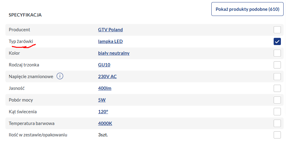

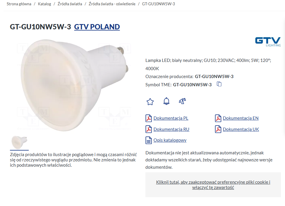

    Good point, that's what I was wondering before publishing this topic, whether to allow myself to use terms that are incorrect but present in the trade, or to leave them out completely. There is a similar situation with those ubiquitous "light bulbs" which are essentially not "light bulbs". On the one hand, it's clear that stupid mistakes shouldn't be duplicated, but on the other hand, what if people are typing "LED bulb with GU10 thread" into a search engine en masse? As I looked online, it's repeated time and time again....
    Although here I have to admit that one of the more 'serious' shops still holds the standard and doesn't get 'bulbised':
    White LED bulb with GU10 base and detailed technical information. .
    And no, okay, there's a "bulb type" too :D
    LED lamp specification with bulb type highlighted.
