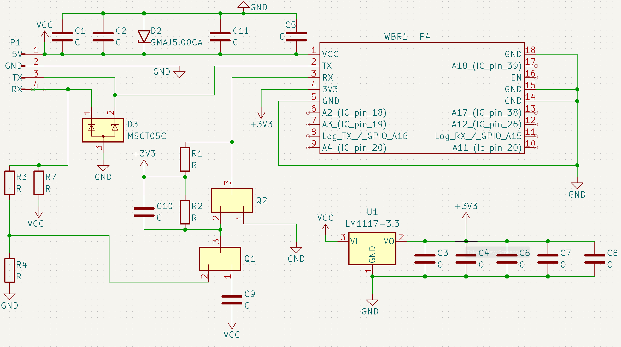

    It's connected to pin 2 & 3, on the RX there is a level shifting circuit to go from 5V to 3V3 logic and then there is transient voltage protection on power and TX/RX lines. Looks straightforward.
    Here is the schematic I traced. (note since this was just a trace I did not try to figure out the resistor, capacitor, or transistor values)

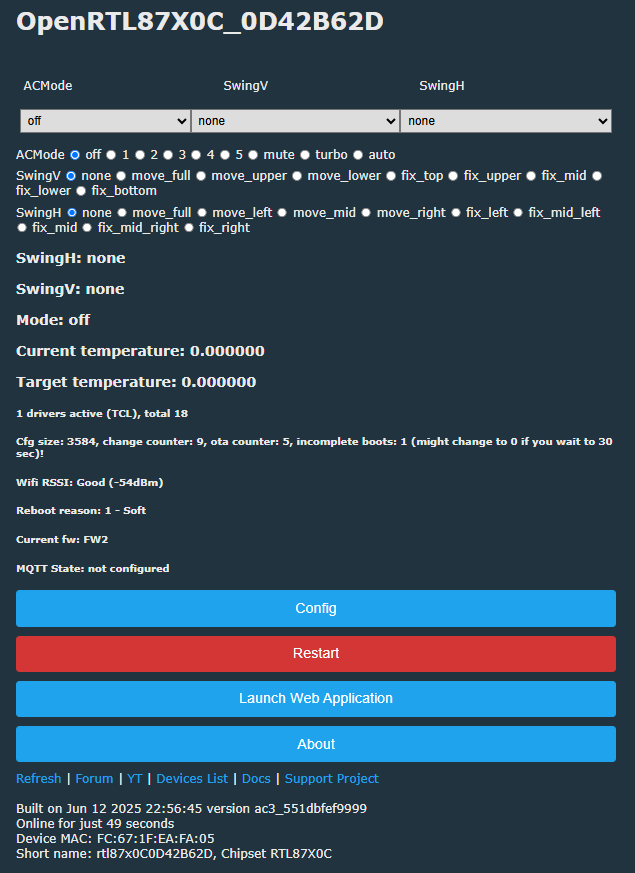

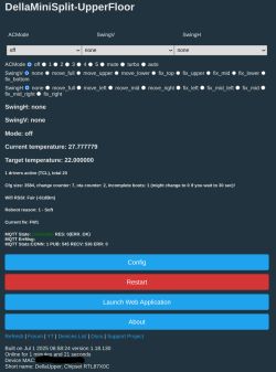

  • #186 21578748
    AbidingOhmsLaw
    Posts: 24

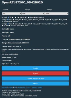

    Here is the firmware as read from the device and a screenshot of the web page

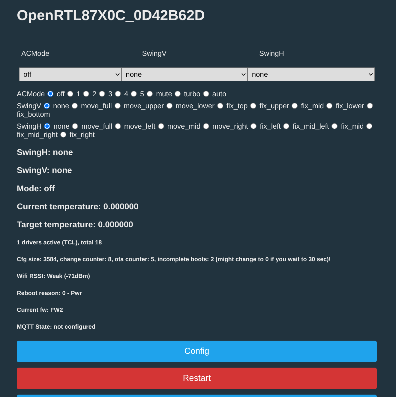

  • #187 21578849
    Posts: 5107
    Help: 441
    Rate: 902
    Request for Help – Flashing Della Minisplit WiFi Module (WBR3 on TCWBRCU1)

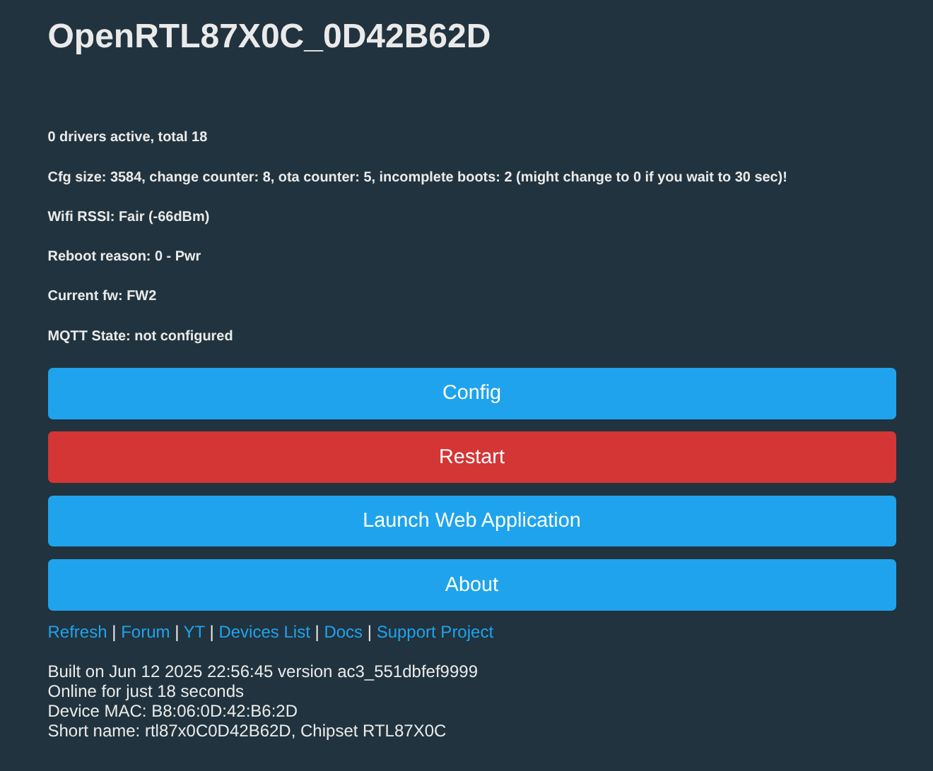

    flashed backup to same devices as above. driver does start
    Added after 20 [minutes]:
    OK on 3rd device too - BW15. I've tried pulling all low/high in GPIO dr to no difference. hmm
    Added after 3 [minutes]:
    >>21566741 I don't think I see evidence in posts to say you've de-soldered WBR1 - but is that an option if not already tried?
  • #188 21579183
    AbidingOhmsLaw
    Posts: 24
    @divadiow Nope the WBR1 is still soldered to the TCLWBR module that I found has its own data sheet on the Tuya site
    https://developer.tuya.com/en/docs/iot/tclwbr-datasheet?id=Kcqmpgs2yc5c6
    The module is only providing power and level translation to the WBR1, I would not think that should cause an issue with the UART. When I flash the stock Tuya firmware back to the module it works and I get the expected output on the UART pins.

    I managed to reproduce the issue on a much earlier build. (march 27 dev build)
    If RX is connected to GND (likely in this case), or, i assume, the packet arrives at the precise moment uart is configured, it crashes.
    >>21579183 Ignore this warning, this is OBK configuration area preparing (formatting, only on first boot).
  • #190 21579198
    AbidingOhmsLaw
    Posts: 24

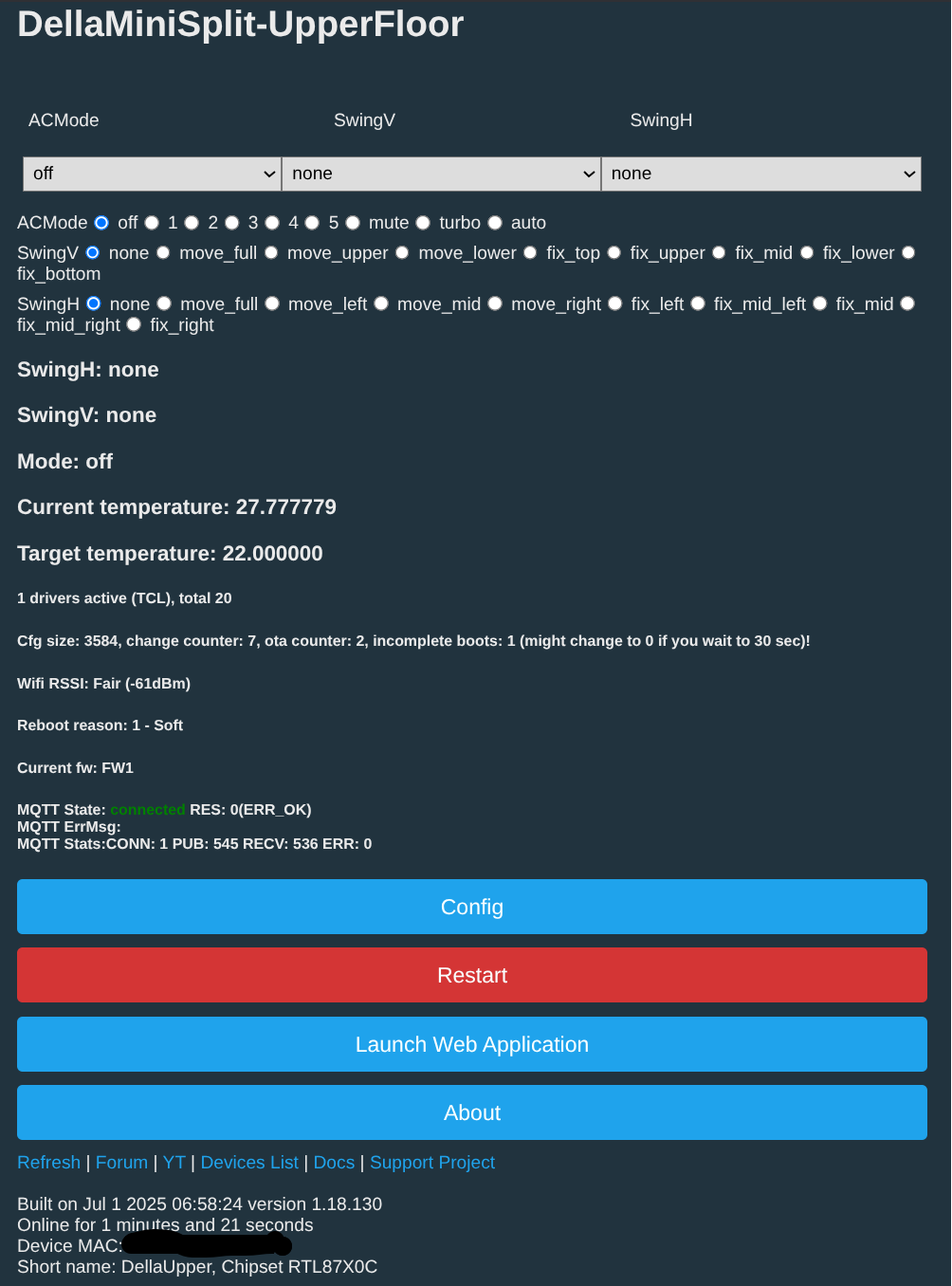

    _____________________________________IT WORKS___________________________________________
    And it is my fault :(
    OK so I while trying to think this out I realized that I have been powering the WBR1 directly to the 3V3 power pin and not via the 5V connector on the TCLWBR board (that has a 3v3 regulator). Looking over the datasheets on the WBR1 I realized that 3V3 AND VCC must be connected and I was not connecting VCC under test since you don't need it to flash. I disconnected the 3v3 from the WBR1 and connected 5v to the TCLWBR board and bingo it works!!!
    Added after 8 [hours] 40 [minutes]:
    Got both units fully set up now! I don't mind the delay between changing a setting and the HA card changing, and actually like that it is confirming the change. One this I have noticed, and I think it's with the HA card not OBK or driver, is that the temp on the card is displayed with a tenths digit and the unit will round up or down if you set a temp that is not on the zero for the tenths place.

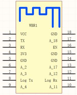

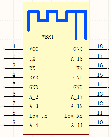

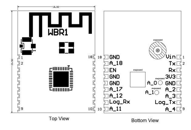

    In some of the documentation they refer to pin 1 as VCC
    There is also this "Application note" (Attached) that seems to indicate that pin 1 must also be tied to the power rail. The interesting part is that on the datasheet site indicates that pin1 may be 3V3 or 5V or used as a UART pin? (odd and I did not see other mention of that)
    Pin number     Symbol     I/O type     Function
    1              Vin        P            UART_TX, Power supply conversion (5V or 3.3V)
    The TCLWBR adaptor board that is in my units has a 3V3 regulator in it and supplies Pin 1 with 5V and Pin 4 with 3V3

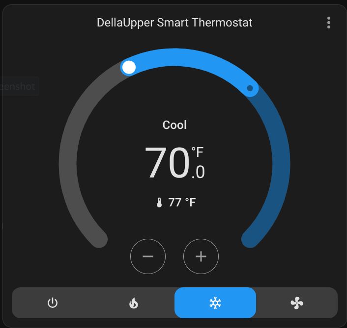

    Also I am using Fahrenheit, This is the shot showing the HA card with tenths
    When setting it, if you stop at a temp above over .5 above it will go to the next whole digit up, and if you stop at .5 or lower it goes to the next lower whole digit (typical rounding). It's not that bothersome. I like the delay for the settings, I am taking that as, when I send a setting the HA card is not changing until the MQTT topic comes back with the new settings. I like that confirmation as I won't be in the garage when I am remotely settings the units and wont have the unit's direct feedback.

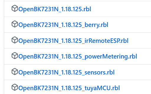

    I'm afraid we can't really add this driver to main release. It's too large and we already have LFS being overwritten on OTA on multiple occasions.
    We have online build system configuration option instead: https://www.elektroda.com/rtvforum/topic4033833.html So it can be enabled by obk_config.h by any user via Github.
    We also have OBK variants:
    Maybe I could include this driver in variants...
    Unless... I'm not sure how much space is actually left on WBR3 ( W701-VA2-CG /RTL8720CF) - @insmod, what do you think? Could we get away with enabling this driver globally and what happens on this platform when size limit is hit?
