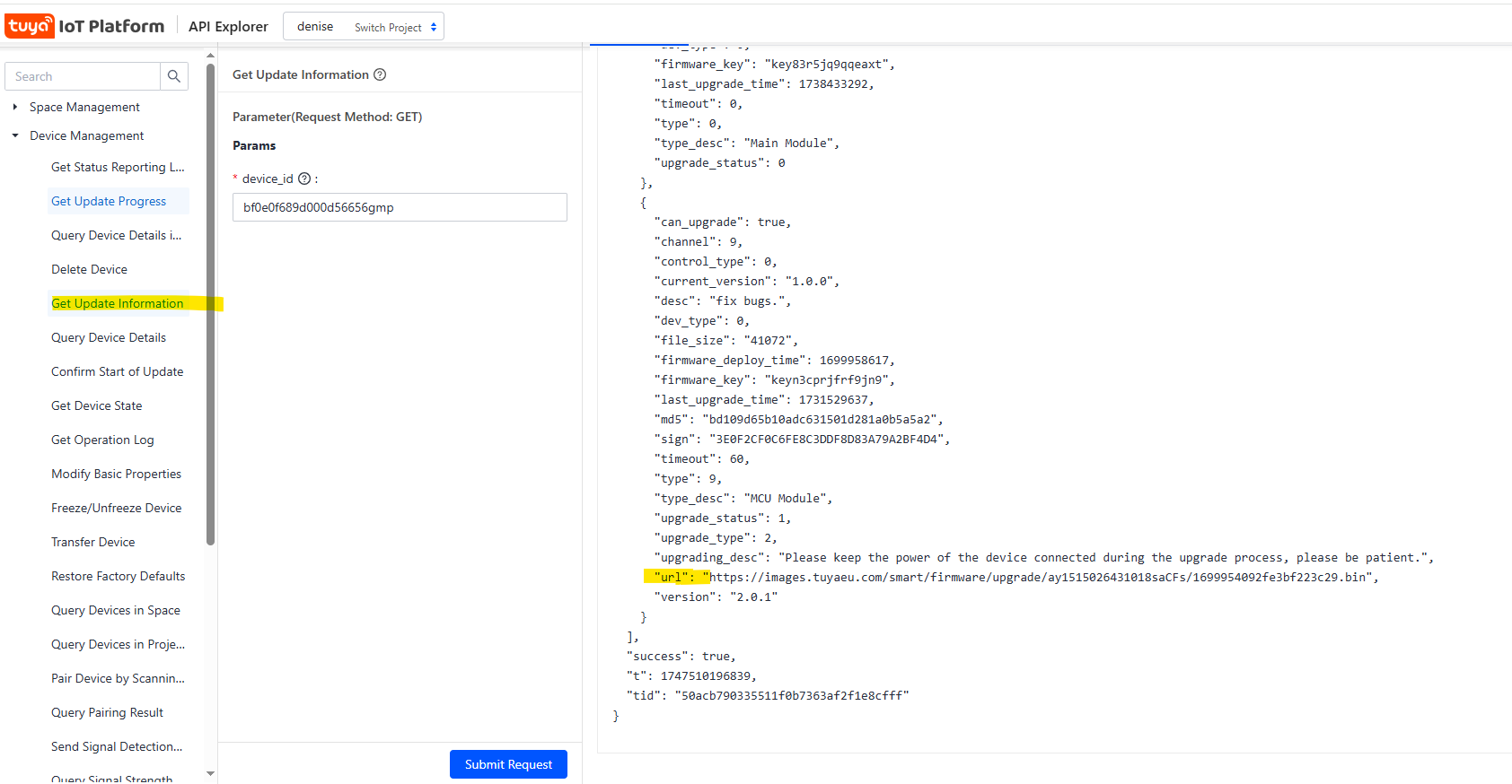

    Thanks @divadiow, that makes sense. I'm still pretty new to this kind of reverse engineering so I really appreciate your insights. Is there anything I can do on my end to help confirm which product key the module is using?
  • #62 21552191
    Posts: 5236
    Help: 450
    Rate: 920

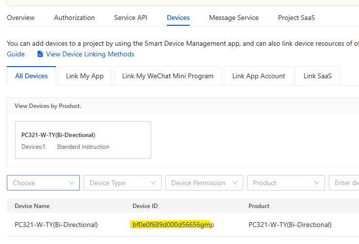

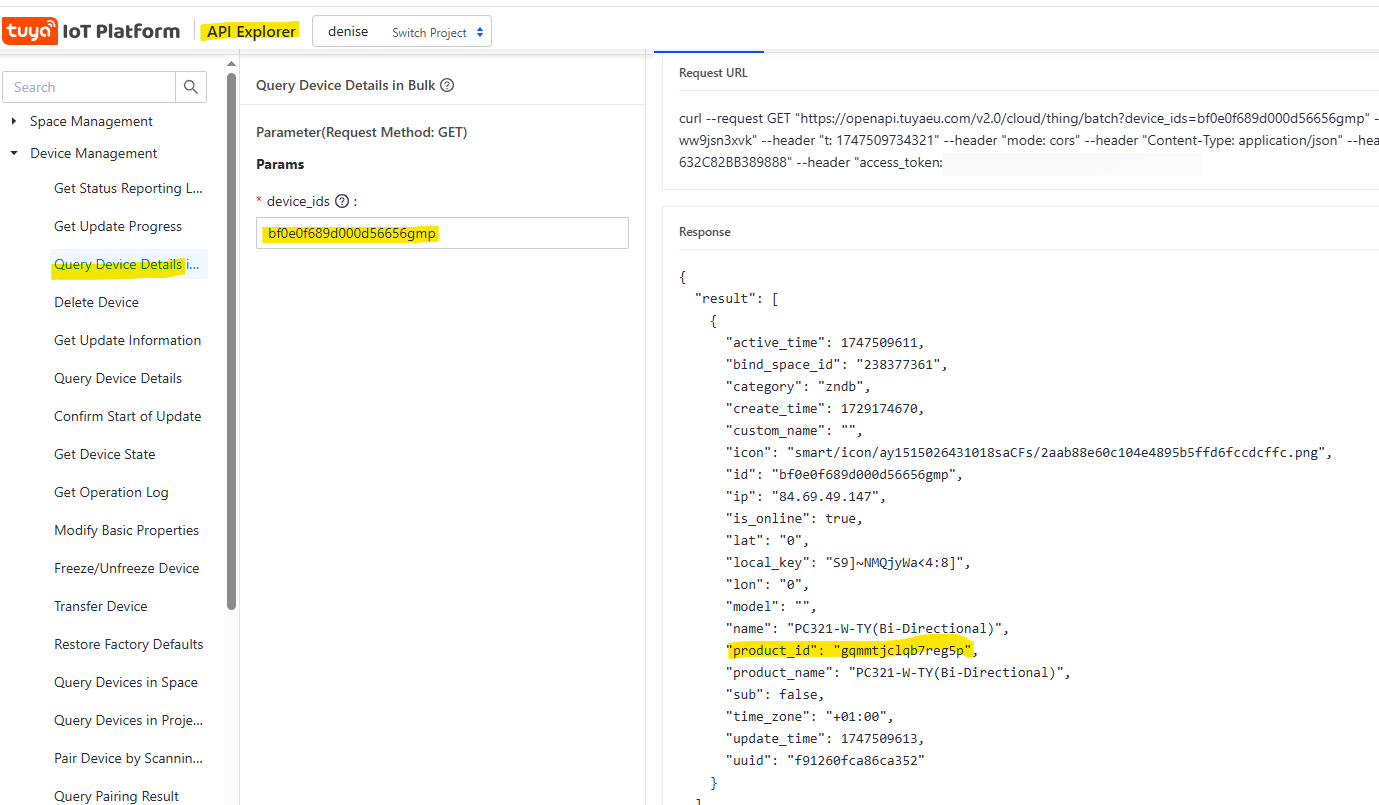

    Assuming you have a Tuya dev account linked to your app and the Della is still paired, it'll be in the API explorer under here
    Screenshot of Tuya IoT Platform showing an API request for device details and a JSON response with device information.
    That device_ids is this in your cloud project device list
    Screenshot of device management panel with a highlighted device ID.

  • #64 21552197
    Posts: 5236
    Help: 450
    Rate: 920
    ah very good. cool
    any update urls returned when you check update info?
    Tuya IoT Platform panel with API Explorer open, showing the Get Update Information section.

    #65 21552202
    dressyspider
    Posts: 83
    Rate: 10
    Checking. I had the other info handy, but need to pull this one.
    Edit:
    No URLs
    Get Update Information:
      "result": [
          "channel": 0,
          "control_type": 0,
          "current_version": "1.0.14",
          "dev_type": 0,
          "firmware_key": "keynuxqpvy4cag75",
          "last_upgrade_time": 0,
          "timeout": 0,
          "type": 0,
          "type_desc": "Main Module",
          "upgrade_status": 0
          "channel": 9,
          "control_type": 0,
          "current_version": "1.0.0",
          "dev_type": 0,
          "firmware_key": "",
          "timeout": 0,
          "type": 9,
          "type_desc": "MCU Module",
          "upgrade_status": 0
      "success": true,
      "t": 1747510451295,
      "tid": "e85569ad335511f0a8a396867ed24c6e"

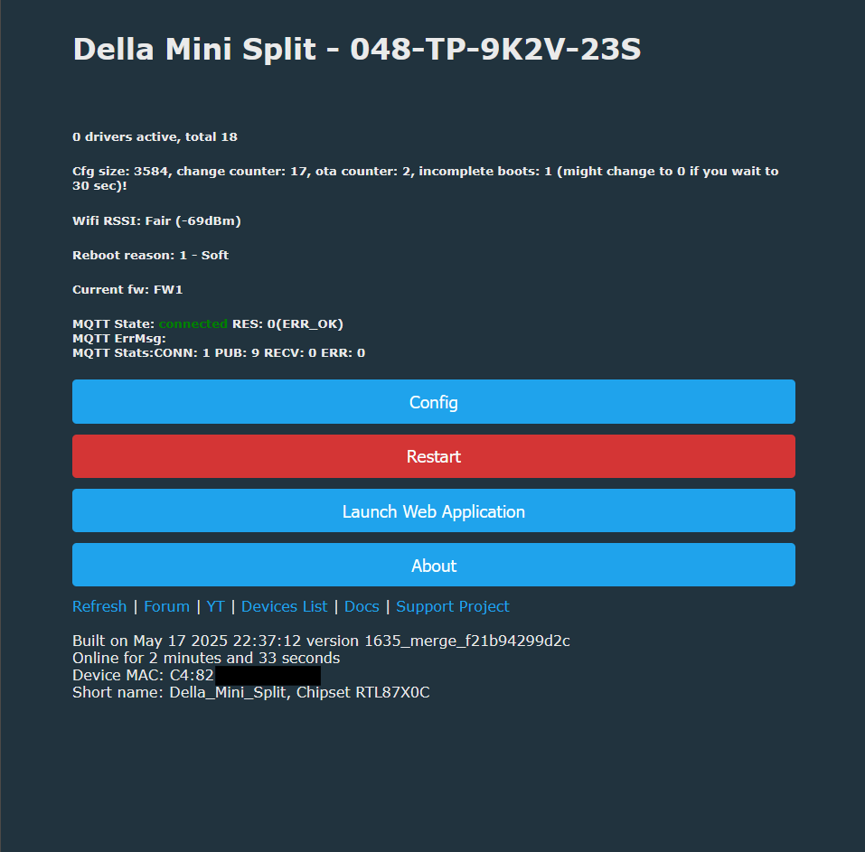

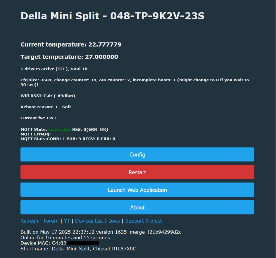

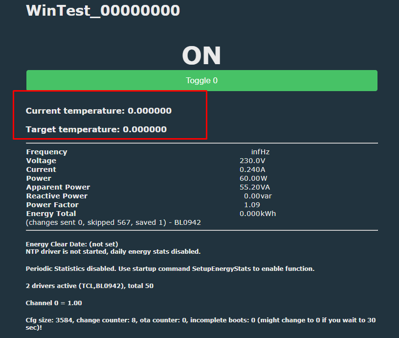

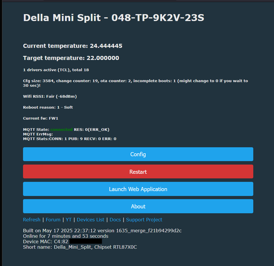

  • #70 21552338
    Posts: 14797
    Rate: 12954

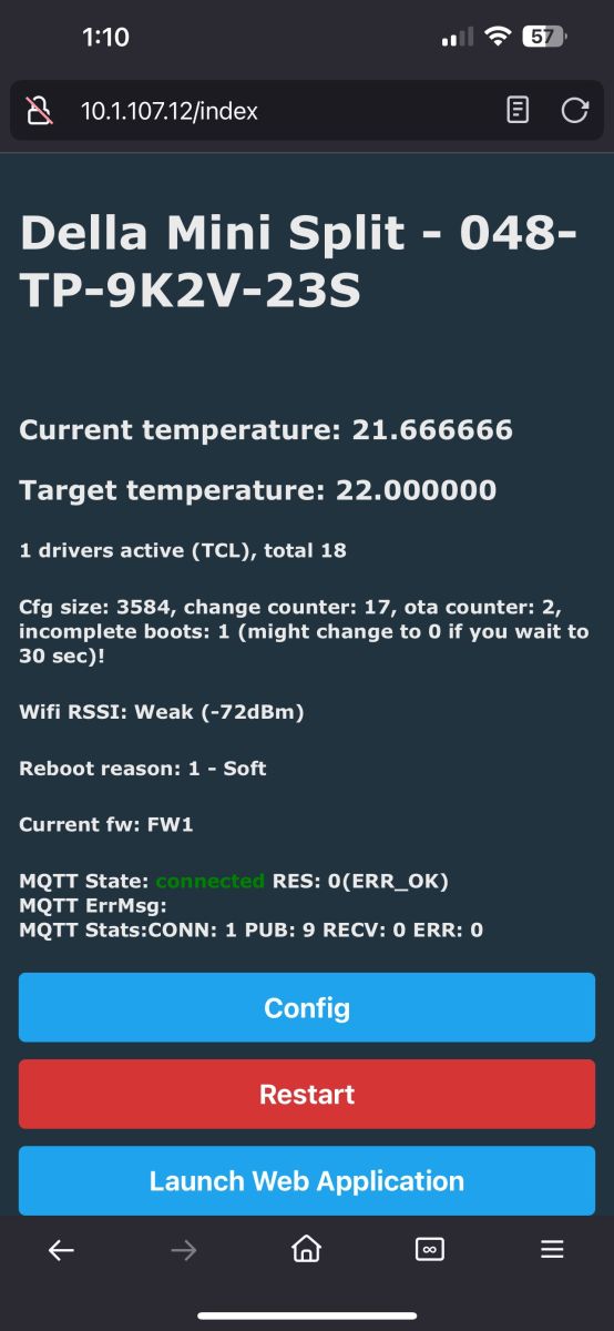

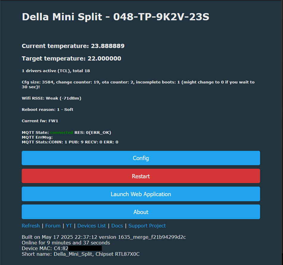

    I've pushed a new version. It should read current and target temperature:
    Screenshot of a device control interface showing ON state, temperatures at zero, and electrical parameters.
    There is a new command - TargetTemperature [Number]
  • Temperature display mismatch in TCL driver testing
    #71 21552350

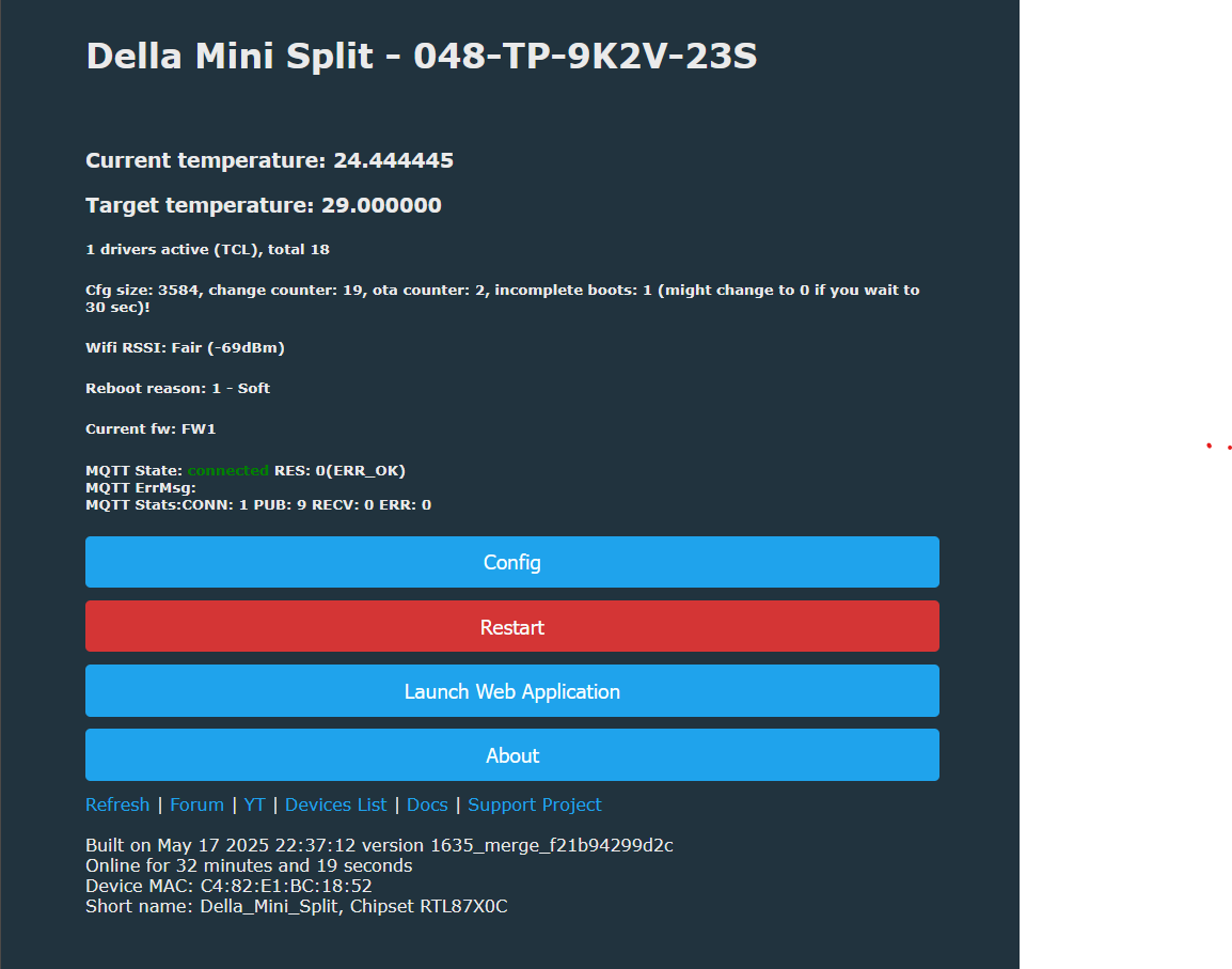

    dressyspider
    Posts: 83
    Rate: 10
    I will be home soon and can test. Is the number in Fahrenheit or Celsius?
    Edit:
    I tested the latest OTA from this build:
    GitHub Actions Artifact
    I'm not sure how to get the temperature show...
    Control panel of the Della Mini Split device with configuration, restart buttons, and device status information.

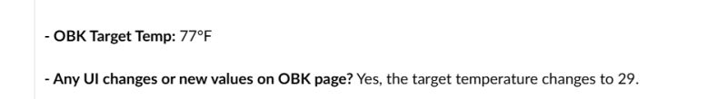

    Steps Taken (Unit started powered OFF):
    1. Flashed OTA
    2. Restarted the module
    3. Ran: startDriver TCL
    4. Ran ACMode 1
    5. Ran: TargetTemperature 75 - The unit showed "81" on the display
    6. Ran: TargetTemperature 77 - The unit showed "84" on the display
    7. Ran: ACMode 0
    Observation: Unit powered on in "cool" mode. When changing the temperature, the number input did not match what the display on the unit was showing.

    Warn:EnergyMeter:build_set_cmd: sizeof(get_cmd_resp_t) = 61, sizeof(m_set_cmd.data) = 35, sizeof(m_set_cmd.raw) = 35
    Info:CMD:[WebApp Cmd 'TargetTemperature 75' Result] OK
    Info:CMD:[WebApp Cmd 'TargetTemperature 77' Result] OK

  • Temperature range is 16 to 31 degrees
    #72 21552449
    Posts: 14797
    Rate: 12954

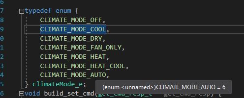

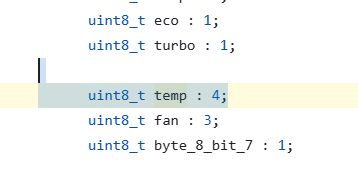

    There is no TCL driver running on your screenshot. Temperature should only show once the TCL driver is started.
        traits.set_visual_min_temperature(16.0);
        traits.set_visual_max_temperature(31.0);
        traits.set_visual_target_temperature_step(1.0);

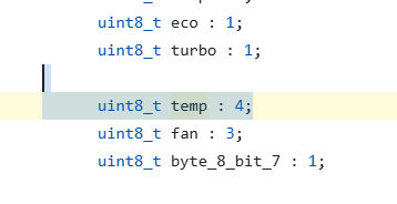

    Temp is just 4 bits in that protocol:
    A code snippet in C showing a struct with uint8_t bit fields, with the temp : 4 line highlighted.
    They subtract 16 from value:
          get_cmd_resp.data.temp = uint8_t(temp) - 16;
    So the input range is 16 to 31 and they convert it to 0 to 15 which matches 4 bit value.
    Try temperature like from range 16 to 31 (in degrees)

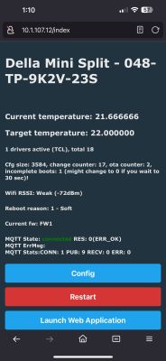

    dressyspider
    Posts: 83
    Rate: 10
    You’re right. Sorry about that. Here is one from my phone and it’s there. Looks like it’s displaying in Celsius.
    Screenshot of the Della Mini Split air conditioner control panel showing current and target temperature with configuration options.
    Edit:
    Just a quick clarification, earlier I said that the temp was showing incorrectly on the unit. I meant on the actual mini split.

    I set the temp to 75F. The display on the mini splits indoor unit changes to 81… in what I assume is Fahrenheit.

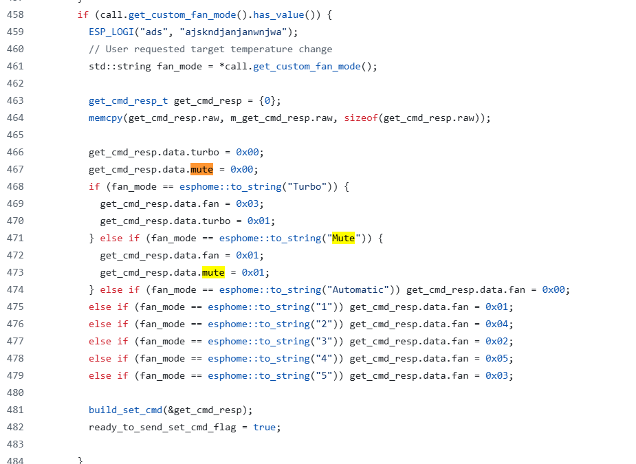

    I am not sure, but you probably need to use ACMode command with the value number matching 'auto' as shown few posts before and then set temperature, I guess...
    Screenshot of code fragment showing climate mode enumeration, with CLIMATE_MODE_COOL highlighted.

    OpenBeken TCL Driver Test Log — Della Mini Split
    Overview:
    1. Enable TCL driver
    2. Power on mini split
    3. Set fan speed to 3

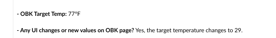

    4. Set target temperature to 75°F
    5. Set target temperature to 77°F
    6. Power off mini split
    1. Reboot WBR3 from OBK dashboard
    Action Taken: Restarted from OBK interface
    - Any immediate changes on physical device? No

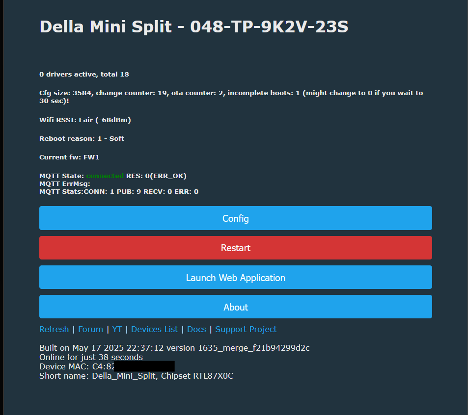

    - OBK UI:
    Device control panel screen for Della Mini Split with status details and configuration buttons.
    2. Start TCL driver
    Command Used:
    startDriver TCL
    - Any UI changes or new values on OBK page? Yes. Current temperature and target temperature are displayed in Celsius.
    - OBK Logs:
    Info:MAIN:Time 199, idle 0/s, free 94784, MQTT 1(1), bWifi 1, secondsWithNoPing 130, socks 2/21
    Info:MAIN:Started TCL.
    Info:CMD:[WebApp Cmd 'startDriver TCL' Result] OK

    - OBK UI:
    Della Mini Split control panel displaying temperature and device status.
    3. Power on mini split
    Command Used:
    ACMode 1
    (sets unit to "Cool")
    - Physical Unit Display: Indoor unit beeps, then starts power on sequence. Display says "72" as that is the last temperature set prior to shutdown. The air being moved is clearly being cooled.
    - Is unit visibly running (fan, compressor)? Indoor fan is running at last set speed. Outdoor unit fan and compressor start.

    - OBK UI:
    Della Mini Split control panel showing temperature, connection and system status.
    4. Set fan speed to 3
    Command Used:
    FANMode 3
    - Physical Display/Fan Behavior: Indoor unit beeps. In this case, the fan speed slowed to speed 3.
    - OBK Logs:

    - OBK UI:
    Della Mini Split control panel showing temperatures, WiFi and MQTT status, and buttons for config and restart.
    5. Set target temperature to 75°F
    Command Used:
    - OBK Target Temp: 75°F
    - Any UI changes or new values on OBK page? Yes, the target temperature changes to 27.
    - Physical Display/Fan Behavior: Indoor unit beeps, then the display changes to "81".
    - Is cooling behavior as expected? Kind of... Unit should be displaying 75.

    - OBK UI:
    Web interface of a Della Mini Split device showing current and target temperatures, Wi-Fi status, and control buttons.
    6. Change target temperature to 77°F
    Command Used:
    - OBK Target Temp: 77°F
    - Any UI changes or new values on OBK page? Yes, the target temperature changes to 29.
    - Physical Display/Fan Behavior: Indoor unit beeps, then the display changes to "84".
    - Is cooling behavior as expected? Kind of... Unit should be displaying 77.

    - OBK UI:
    Della Mini Split control panel showing current and target temperatures with configuration options.
    7. Power off mini split
    Command Used:
    ACMode 0
    - Any UI changes or new values on OBK page? Not that I noticed.
    - Physical Display/Fan Behavior: The indoor unit beeps, then shuts down. The indoor display turns off with no codes.

    - OBK UI:
    Control panel for Della Mini Split air conditioner showing current and target temperatures, WiFi and MQTT status, and control buttons.
  • Target temperature must stay in 16–31°C range
    Command Used:
    This will give random results because, as I said earlier, the protocol uses value in C which is in 16 to 31 range.
    Can you do testing with TargetTemperature in range 16 to 31?
    Also, are you using F? Once we get it working, we can add unit switch, but for now, let's stick to C on OBK side, because C is used internally by the device.
    Added after 27 [minutes]:
    BTW:
    Screenshot with text about OBK target temperature and UI changes on the OBK page.
    You type 77 for C value. Code subtracts 16 from it , to get 16 to 31 range. So it's 61. But it's just 4 bits. So squeezed into 4 bits, it gives 61%16 = 13. Now add back offset 16, as it's [16,31] range. So 13+16 = 29. So it works. The value 29 is expected... by that logic. So device now thinks the target value is 29 centigrade (84,2F?)
    Added after 44 [seconds]:
    And you said yourself:
    So everything works, just a user error on your side - currently, OBK expects value in C.

    I can confirm that you are correct. I ran TargetTemperature 24 and the display on the mini split shows "75". The OBK dashboard showers “target temperature: 24”. When I ran TargetTemperature 25, the display changed to "77" and the OBK dashboard showed “target temperature: 25”.
    Prior to stetting thr temperature, I ran startDriver TCL, then ACMode 1, then set the temps using Celsius. The log below only contains the TargetTemperature commands.
    OBK Logs:
    Info:MAIN:Time 296, idle 0/s, free 94072, MQTT 1(1), bWifi 1, secondsWithNoPing 226, socks 2/21
    Info:CMD:[WebApp Cmd 'TargetTemperature 24' Result] OK

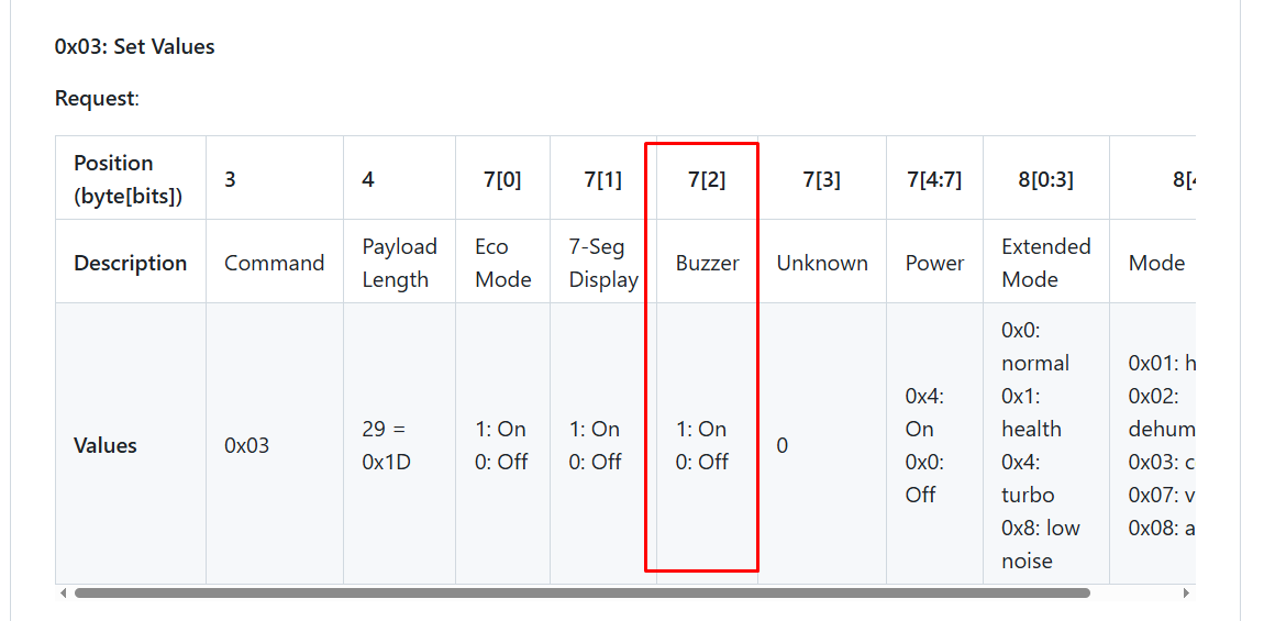

    dpIDs are useful for TuyaMCU, but here we have one binary packet, so dpIDs won't help. They can only tell you what to look for.
    There is some mute fan options mentioned in the driver we are porting, but I am not sure if it's the same as sound mute?
    A fragment of C++ code with the word Mute highlighted in a conditional and variable assignment.
    Or maybe, even better, this fits? Buzzer on/off:
    A table showing the structure of command 0x03 with parameter descriptions and possible values.

    Fan mode mute just makes the fan run slow so it’s quiet. Buzzer is the beeping.
