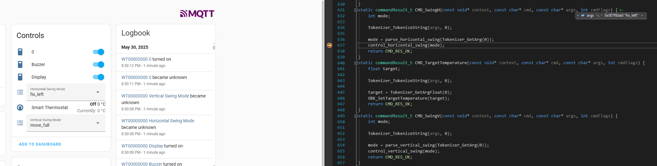

    well OBK certainly can see things sent by HA:
    Screenshot showing MQTT control panel on the left and a C code editor on the right.

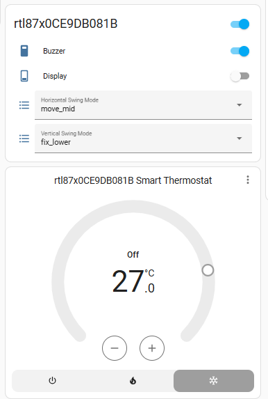

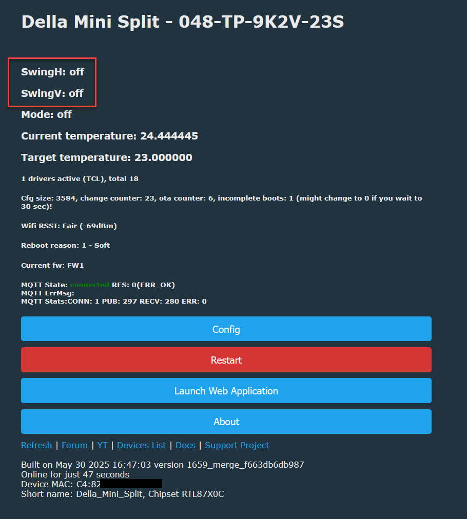

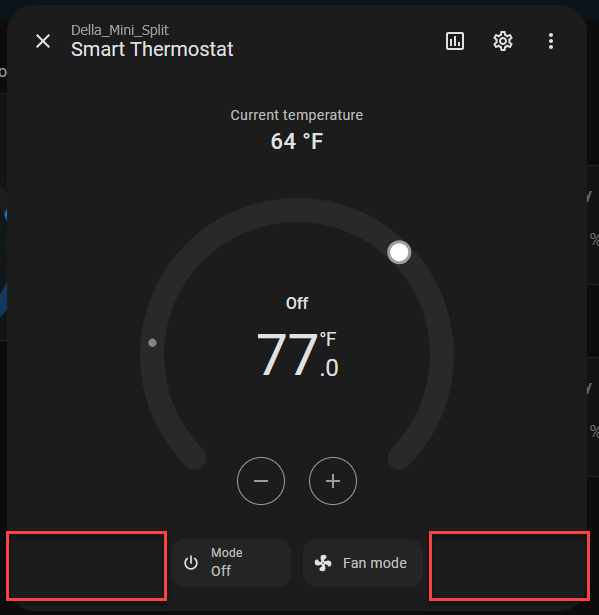

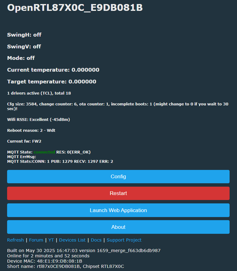

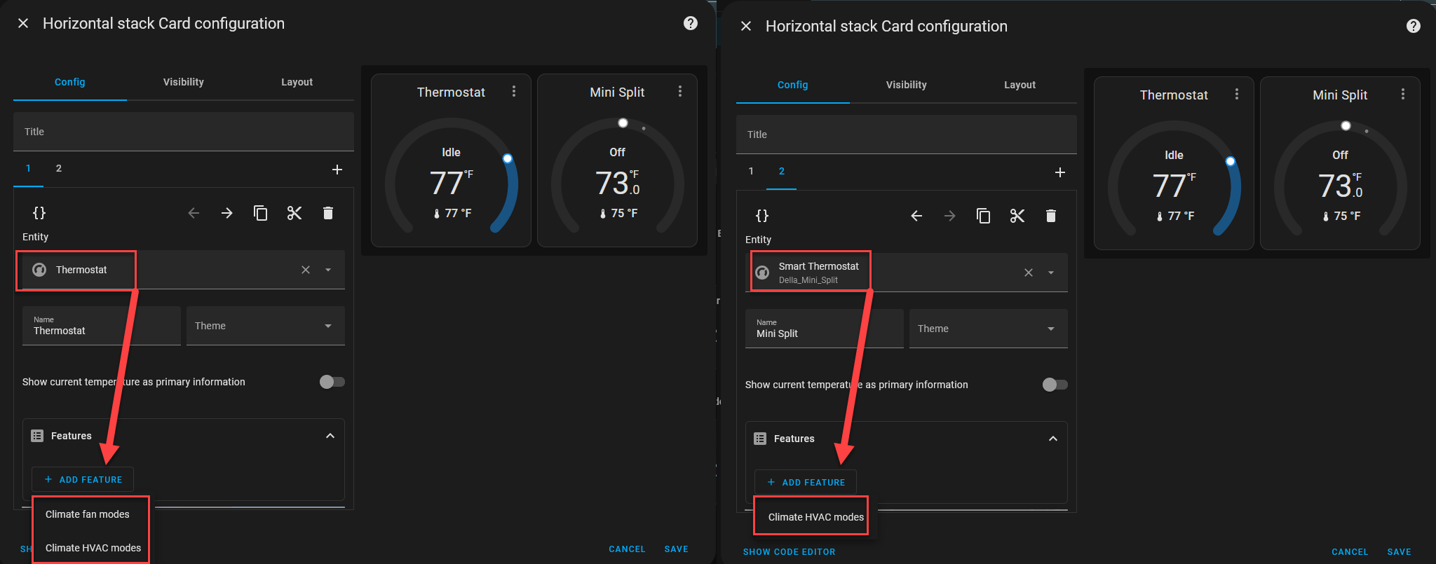

    Great to hear. I'm not completely sure about the code on the right, but the dropdowns on the left look perfect. I’ve also set up a few Node-RED automations with the mini split, and everything is working exactly as expected. I installed the latest OTA, and I can now see the swing positions in the OBK dashboard too. Everything’s coming together really nicely.
    OBK UI:
    Screenshot of the Della Mini Split control panel showing SwingH and SwingV set to off.
    Edit:
    I did notice that the swing options aren't being populated under extra features. Here's a side-by-side comparison with the options shown on my Ecobee for reference.
    Comparison of thermostat and mini split card configuration showing available feature options after clicking ADD FEATURE.
    Disregard that last bit. I forgot to kick off HA discovery.

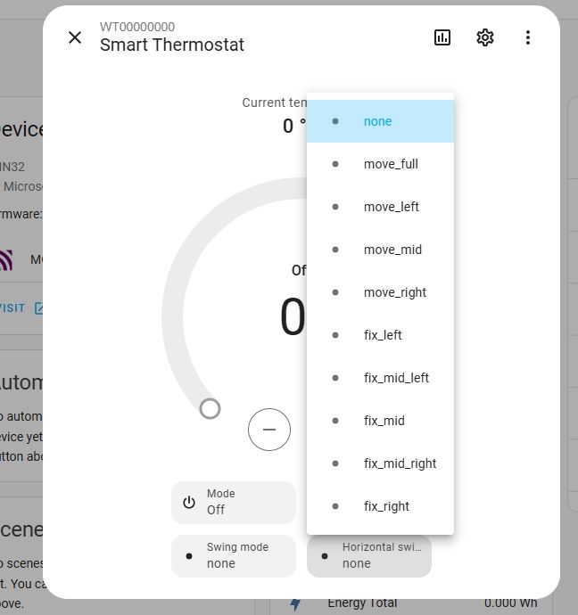

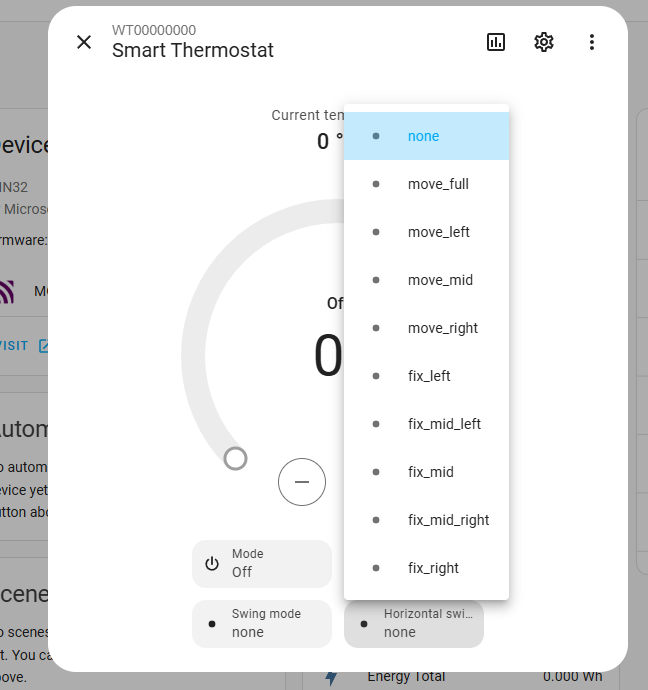

    There is still this code fragment in the original driver:
    				/* if (m_get_cmd_resp.data.hswing && m_get_cmd_resp.data.vswing) set_swing_mode(CLIMATE_SWING_BOTH);
    				else if (!m_get_cmd_resp.data.hswing && !m_get_cmd_resp.data.vswing) set_swing_mode(CLIMATE_SWING_OFF);
    				else if (m_get_cmd_resp.data.vswing) set_swing_mode(CLIMATE_SWING_VERTICAL);
    				else if (m_get_cmd_resp.data.hswing) set_swing_mode(CLIMATE_SWING_HORIZONTAL);*/
    Do you recognize this option from Tuya? Looks like we need a third dropdown?
    Can you also help us make the OBK gui for this device functional? For other users... and testing.

    Thanks for sharing that snippet.
    Regarding the swing options, I do not think we need a third dropdown for both swings together. Maybe just one for vertical swing and one for horizontal swing would be enough.
    I do not recognize this option from Tuya yet, but I will look into the logs that the mini split adds to OBK. Should I also try sniffing the data directly via the OEM TuyaOS to gather more information?
    I would be happy to help make the OBK GUI more functional for this device. Could you please let me know what specific things I can do to assist? Whether it is testing layouts, reporting feature behavior, or helping with the swing controls, just point me in the right direction.

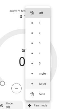

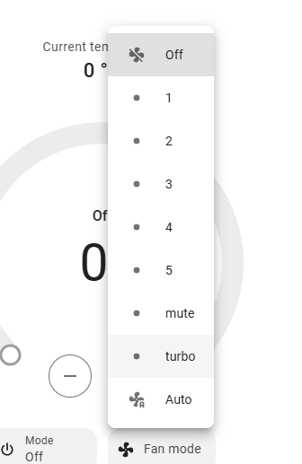

    Here is some logging information...
    Setting the fan mode to "medium" via the home assistant UI.
    This did not update the UI after setting it. The option stayed at "low".

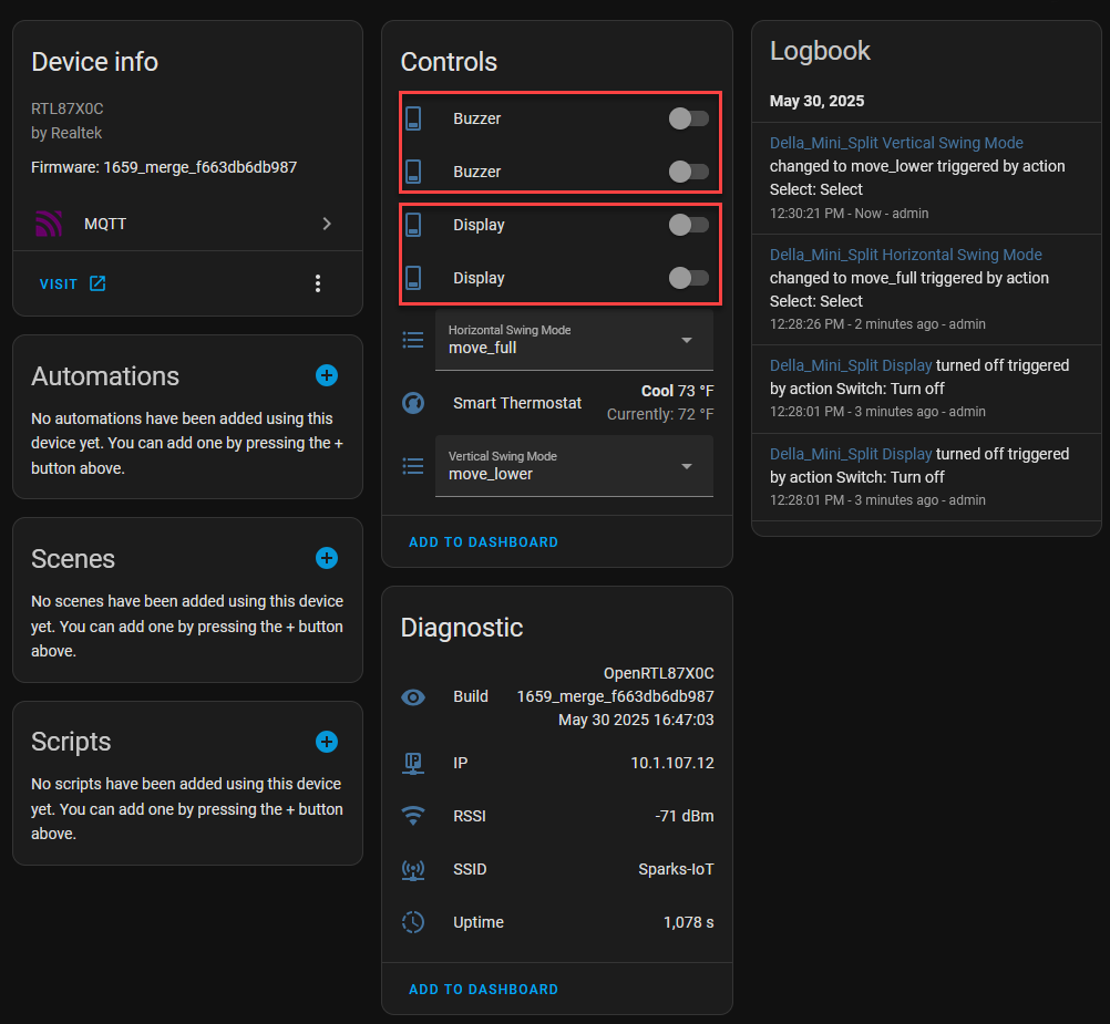

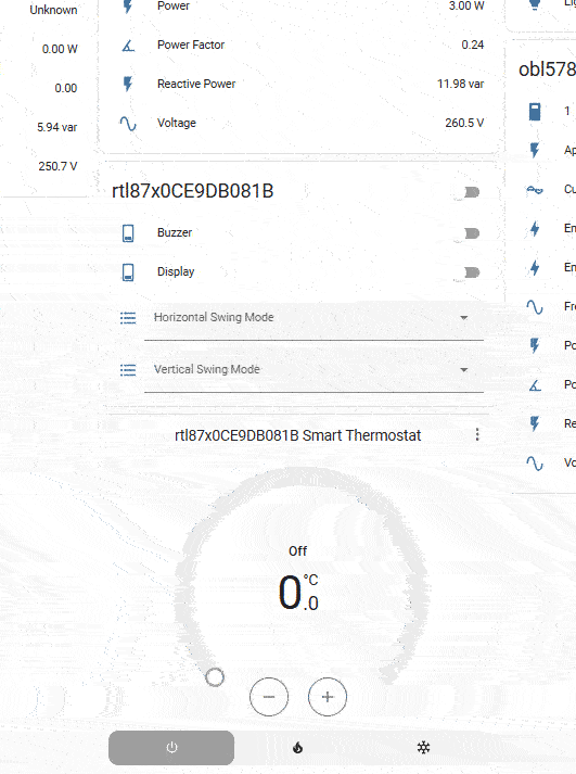

    Also, the MQTT device is showing some doubles in the Home Assitant UI:
    RTL87X0C device control panel showing options to toggle buzzer and display.
  • #128 21565204
    Posts: 14667
    Help: 656
    Rate: 12683
    Doubles are due to the lack of device removal between discoveries. This is because I had to change entity names a bit in the new OBK version, so now you have two Buzzer entities with the different internal names. I'm aware about that, but I don't think I can work around that. It's just that new users will probably have to remove device if they want to redo HASS discovery.

    Thanks for the explanation! That makes sense about the duplicates. I’ll be sure to remove the device before redoing the HASS discovery to avoid this.
    Edit: I disabled MQTT, then removed the duplicates and enabled MQTT. The deleted duplicates are instantly repopulated. Where should I be removing them from?

    doh. yes yes.
    pretty cool
    Smart thermostat control panel with temperature settings and operation modes.
    Control panel of OpenRTL87X0C_E9DB081B device showing status details and control buttons.

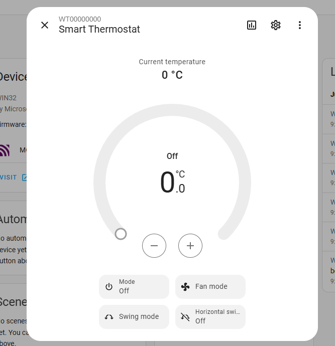

    Don't worry @divadiow , once we finish this UI, I will probably split the driver code into generic thermostat and into this specific driver, so we can do a DIY thermostat with any temperature sensor.
    You know, just connect DHT11 or DS18B20 and a relay... and let OBK do stuff.
    I also consider adding a simple work around for this driver to "simulate" TCL in OBK Windows Simulator, but this won't help with checking with physical device, that's why @dressyspider has to do testing

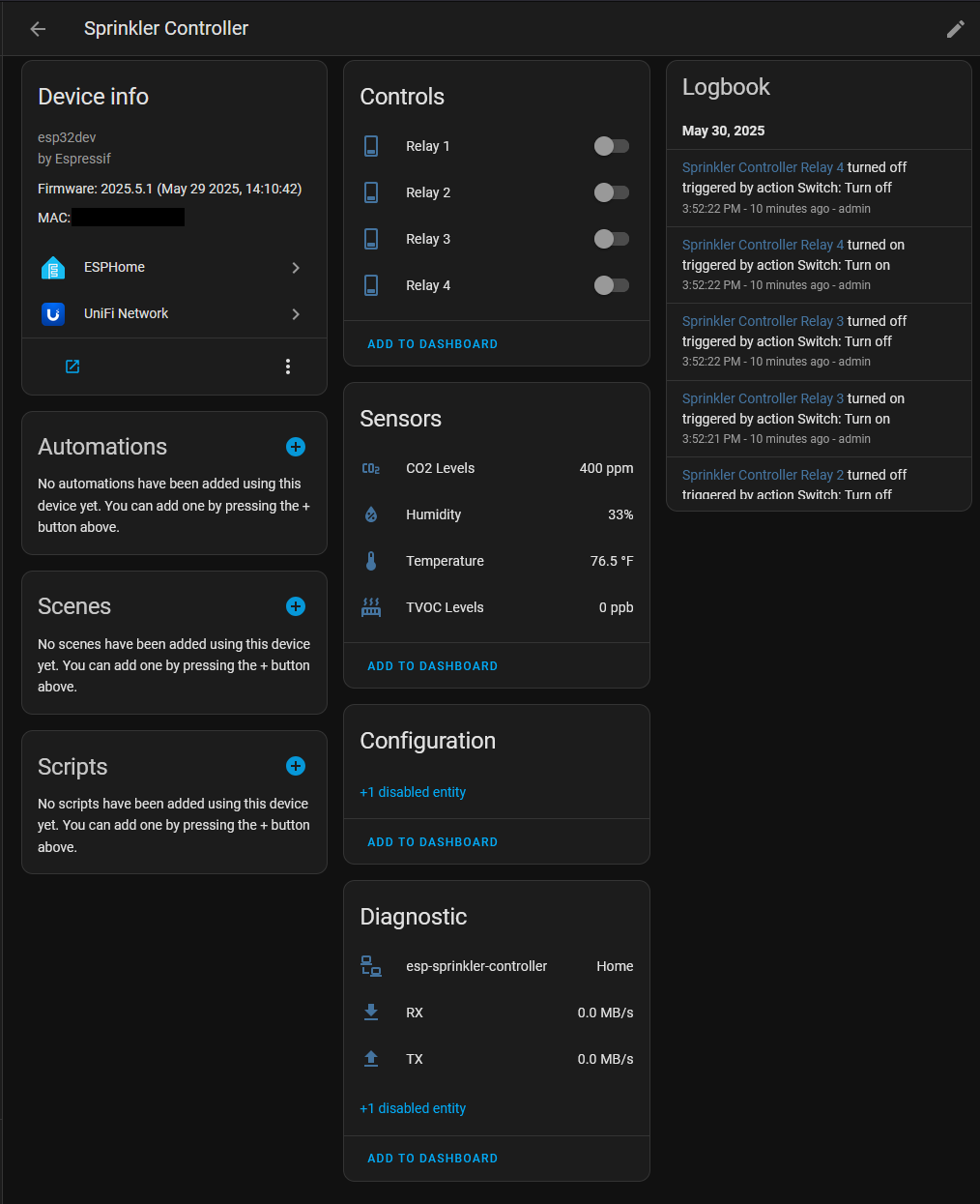

    My ESP32 sprinkler controller project is nearly complete and running ESPHome. I am just waiting on the enclosure and a couple of final components to arrive. I would be more than happy to start over and document everything if you would like a guide made from it. I am using this ESP32 DevKitC VIE board for the build. Mine will be relocated to inside the garage, that's why there are other senors.
    My sprinkler controller:
    Sprinkler controller dashboard with device info, relays, sensors, and activity log displayed.

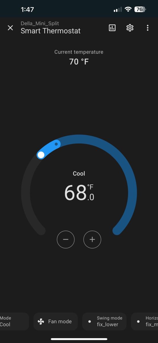

    Hey @p.kaczmarek2, last night I set the temp and swings via Home Assistant. I tried to set the fan speed as well, but the mini split did not respond when changing the dropdown. This was only the case when controlling via Home Assistant. Using the commands in OBK works properly.
    I will be able to grab logs in a couple of hours, but I just wanted to let you know.

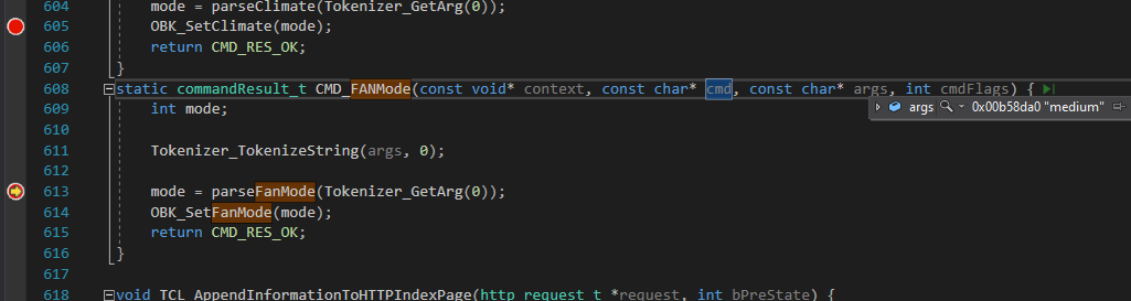

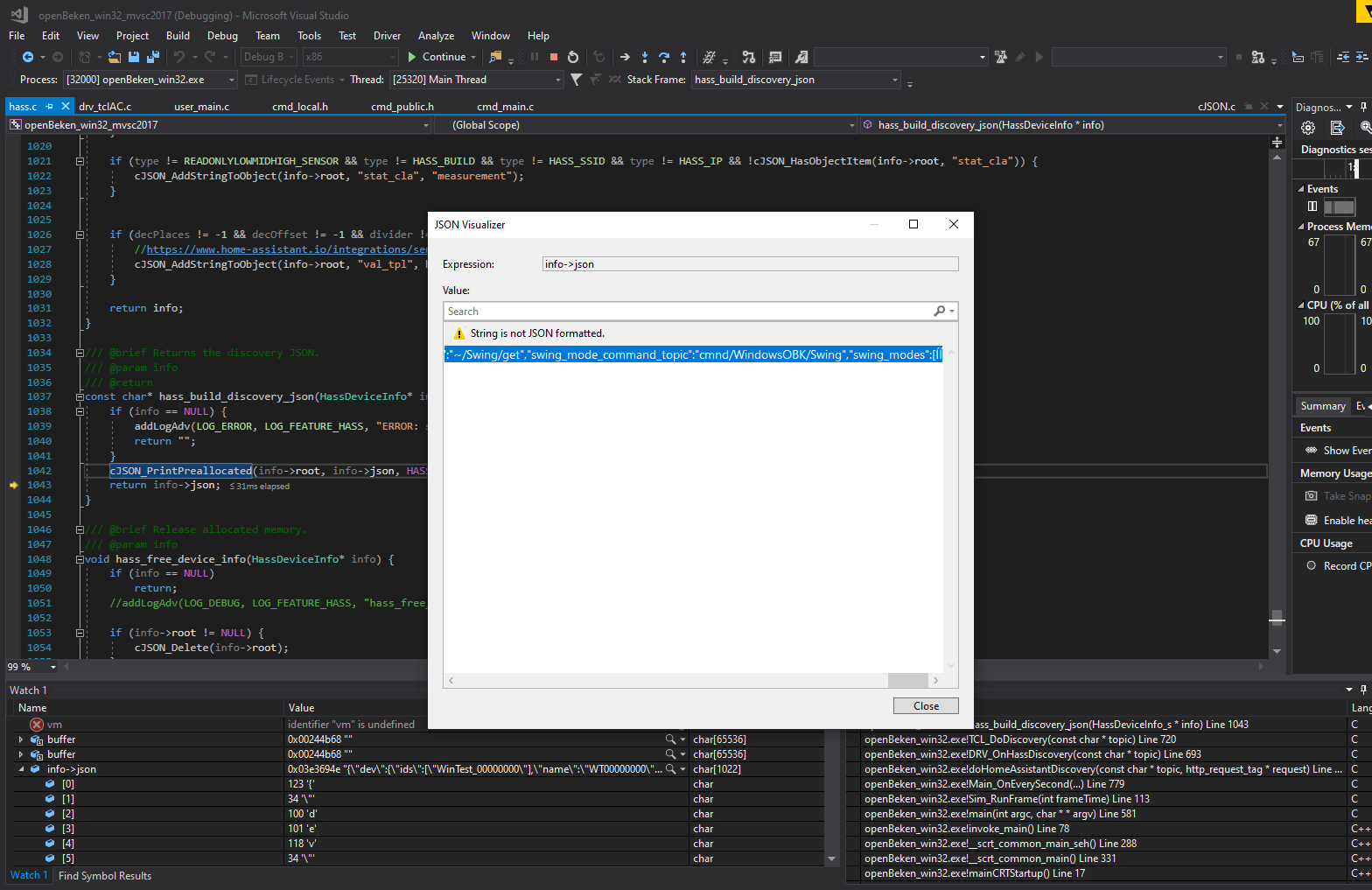

    This? I don't think I finished it, I must have forgot...

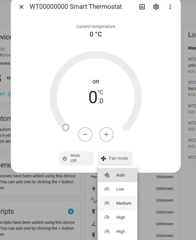

    Screenshot showing a code fragment in Visual Studio with the CMD_FANMode function written in C.

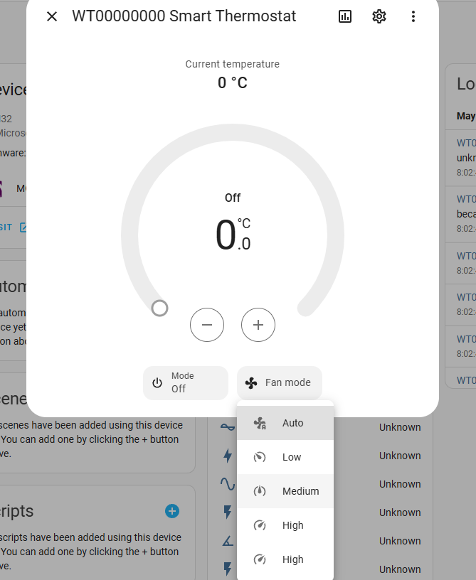

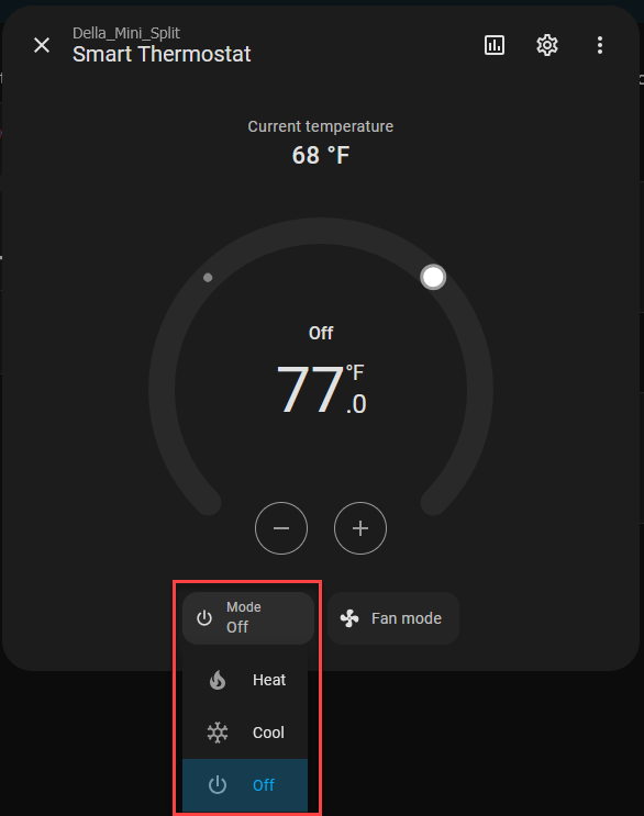

    It sends data:
    Smart thermostat control panel with current temperature 0°C and fan mode menu open.
    but I need to find a way to map this driver values to HA values.
    Added after 14 [minutes]:

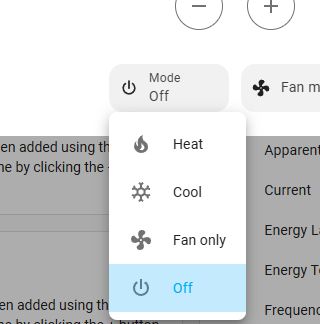

    I added matching modes:
    Fan mode selection menu with options: Off, 1, 2, 3, 4, 5, mute, turbo, Auto.
    Added after 21 [minutes]:
    added fix...

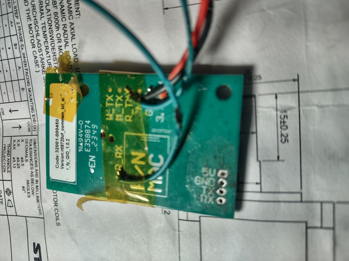

  • #144 21566741
    AbidingOhmsLaw
    Posts: 24

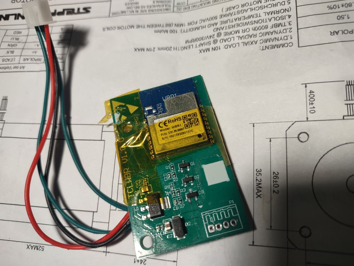

    >>21536969 Just a note:
    The dump I provided @divadiow was from a WBR1 module but it was slightly different from the one shown here. @dressyspider module has the USB style plug while mine has a hard wired cable with a 4 pin JST plug that connects to the main board in the indoor unit. My module has exposed pins for UART 0 and the boot pins so I was able to just tack solder a few wires to read the flash from chip. I was also able to get openBeken on it but ultimately decided to try a esp32 instead as I found another project that was using that for a TCL mini-split. I did not get that to work yet and was forced to set it aside due to work. With summer heat on the way I'm looking to get this going again and may switch back to trying the WBR1 with openBeken.
    Green PCB with attached wires, placed on a technical drawing sheet.
    Electronic module with wires and antenna lying on a technical document.
  • #145 21568769
    dressyspider
    Posts: 83
    Rate: 10
    Still, do more testing
    I think we're mostly in good shape. Setting the temperature and modes through the Home Assistant UI works, and setting it via Node-RED also works as expected.
    There are a couple of things that could make the control experience smoother.
    1. Adding swing controls next to the Mode and Fan Speed options in the thermostat card would be helpful. Right now, I have to leave the thermostat card and open the device settings to adjust the swing options.
    Della Mini Split thermostat UI in Home Assistant with temperature display and mode and fan controls, plus two empty boxes at the bottom.
    2. It would also be great to have a "Fan" mode included in the mode list. This would allow the system to circulate air without heating or cooling. Currently, I have to manually enter ACMode 3 in the OBK console to enable it.
    Smart thermostat interface showing current temperature, set temperature, and mode options: heat, cool, and off.
    I've also started writing a full guide for setting up a Della mini split with OpenBeken. It’ll cover everything from disassembly and flashing to the web UI, MQTT setup, automations, and more. I plan to post it within the next couple of days.
  • #146 21569144
    Posts: 14667
    Help: 656
    Rate: 12683
    Fan mode should not be a problem, I added this to PR.
    Device mode selection panel with options: Heat, Cool, Fan only, and Off.
    Regarding swing modes, I need to check. I was sure it's not possible to split them, but now i can see it may be possible, it's just that naming is counterintuitive,,,
    https://www.home-assistant.io/integrations/climate.mqtt/
    swing_horizontal_mode_command_topic is a correct key but swing_vertical_mode_command_topic not?
    ah it seems i need ha update
    https://developers.home-assistant.io/blog/2024/12/03/climate-horizontal-swing/

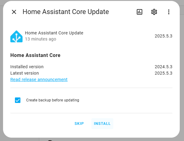

    Added after 7 [hours] 23 [minutes]:
    I am trying HA update for now:
    Home Assistant Core Update dialog showing new version 2025.5.3 available, with backup option before updating.
    Added after 42 [minutes]:
    Ah, this JSON is too long:
    Screenshot of Visual Studio showing C code editing and the JSON Visualizer with a JSON formatting error message.
    Added after 20 [minutes]:

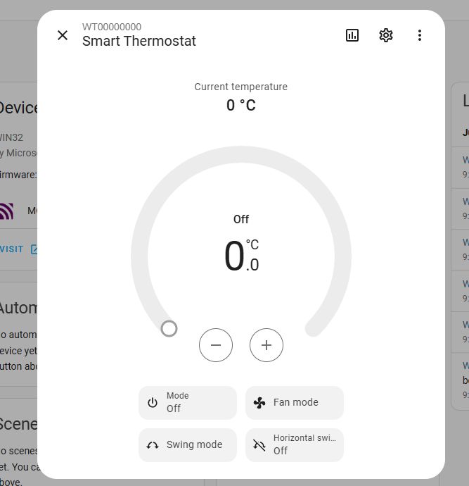

    Almost:
    Smart thermostat control panel showing 0°C and all modes turned off.
    Added after 23 [minutes]:
    Ok you can test that
    Smart thermostat control panel with an expanded horizontal swing mode selection menu.
  • #147 21569338
    dressyspider
    Posts: 83
    Rate: 10
    Everything appears to be correct. My UI is different in that you have to scroll right or left to get to the swings.
    Smart thermostat app screen showing current temperature of 70°F and set to cool at 68°F.
