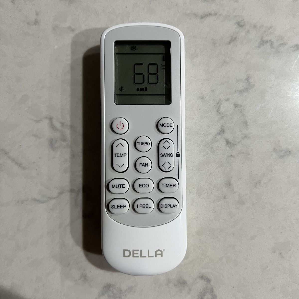

    Does this unit allow for temperature to be set from outside the OBK? For example, via IR remote or the buttons on the case?
    It does. It can with a very basic remote.
    Edit: It seems the remote has a slight delay when using the up or down buttons. The signal appears to be sent about one to two seconds after you stop pressing the buttons, rather than right away.
    Remote:

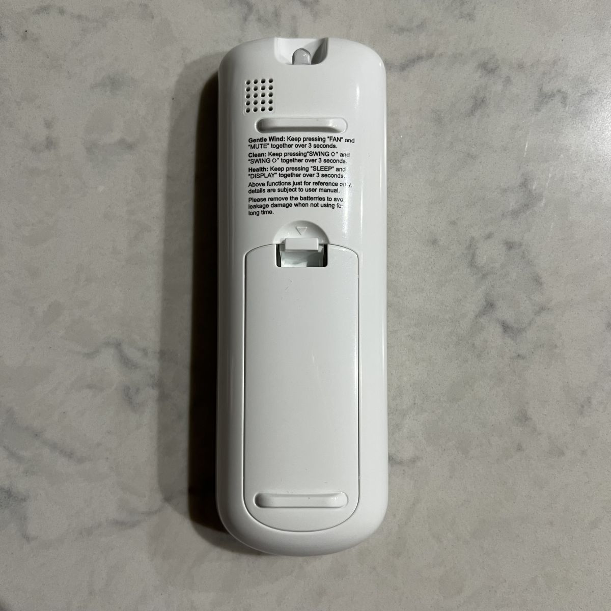

    Back:
    Back of a white remote control lying on a light countertop.

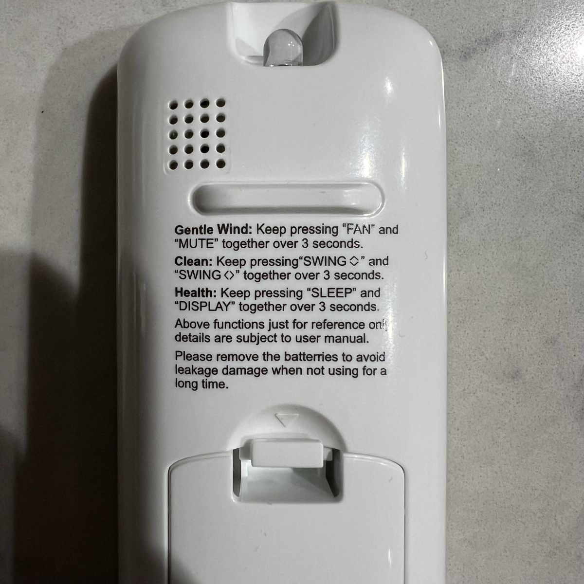

    Back (Close-up):
    Backside of a remote control with printed English instructions on a white casing.

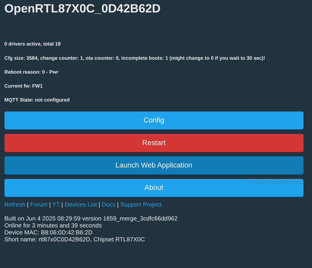

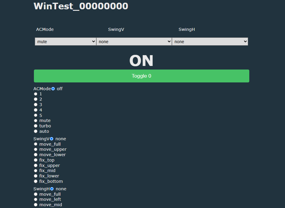

    OK, this is as far as I'm going to get today, I will put the module back in the unit tonight and work on the MQTT tomorrow.
    Request for Help – Flashing Della Minisplit WiFi Module (WBR3 on TCWBRCU1)
    Added after 2 [hours] 17 [minutes]:
    I lied, I did work on it some more. I got MQTT set up and in communication with HA then I tried to start the TCL driver with "startDriver TCL" and the module crashed and rebooted
    [ISR]Assert(( portNVIC_INT_CTRL_REG & portVECTACTIVE_MASK ) == 0) failed on line 443 in file ../../../component/os/freertos/freertos_v10.0.1/Source/portable/GCC/ARM_RTL8710C/port.c
    == Rtl8710c IoT Platform ==
    Chip VID: 5, Ver: 3
    ROM Version: v3.0
    == Boot Loader ==
    Aug 30 2024:04:22:00
    Boot Loader <==
    == RAM Start ==
    Build @ 08:29:49, Jun  4 2025
    interface 0 is initialized
    interface 1 is initialized
    Initializing WIFI ...Entering initLog()...
    Commands registered!
    initLog() done!
    EasyFlash V4.1.0 is initialize success.
    You can get the latest version on https://github.com/armink/EasyFlash .
    WIFI initialized
    init_thread(47), Available heap 0x1b130Main_Init_Before_Delay done
    Main_Init_Delay
    Main_Init_Delay doneWarn:CFG:CFG_InitAndLoad: Correct config has been loaded with 4 changes count.
    Info:GEN:PI
    N_SetupPins pins have been set up.
    Info:MAIN:Main_Init_Delay
    Info:MAIN:Using SSID [xxxxxxxxxxxxx]
    Info:MAIN:Using Pass [xxxxxxxxxxxxxxxxx]
    Info:HTTP:TCP server listening
    Info:MQTT:MQTT_RegisterCallback called for bT dellaUpper/ subT dellaUpper/+/set
    Info:MQTT:MQTT_RegisterCallback called for bT dellaUpper-ctl/ subT dellaUpper-ctl/+/set
    Info:MQTT:MQTT_RegisterCallback called for bT cmnd/dellaUpper/ subT cmnd/dellaUpper/+
    Info:MQTT:MQTT_RegisterCallback called for bT cmnd/dellaUpper-ctl/ subT cmnd/dellaUpper-ctl/+
    Info:MQTT:MQTT_RegisterCallback called for bT dellaUpper/ subT dellaUpper/+/get
    Info:CMD:CMD_StartScript: started @startup at the beginning
    Info:CMD:LFS_ReadFile: failed to file autoexec.bat
    Info:CMD:CMD_StartScript: failed to get file autoexec.bat
    Info:MAIN:Time 1, idle 0/s, free 101080, MQTT 0(0), bWifi 0, secondsWithNoPing -1, socks 2/21
    Info:MAIN:Time 2, idle 0/s, free 101080, MQTT 0(0), bWifi 0, secondsWithNoPing -1, socks 2/21
    Info:MAIN:Time 3, idle 0/s, free 101080, MQTT 0(0), bWifi 0, secondsWithNoPing -1, socks 2/21
    Info:MAIN:Time 4, idle 0/s, free 101080, MQTT 0(0), bWifi 0, secondsWithNoPing -1, socks 2/21
    Info:MAIN:Time 5, idle 0/s, free 101080, MQTT 0(0), bWifi 0, secondsWithNoPing -1, socks 2/21
    Info:MAIN:Registered for wifi changes
    Info:MAIN:Connecting to SSID [xxxxxxxxxxx]
    Info:MAIN:Time 6, idle 0/s, free 97888, MQTT 0(0), bWifi 0, secondsWithNoPing -1, socks 2/21
    [Driver]: set ssid [xxxxxxxxxxxx]
    scan report rssi: -64 bssid: 78:8a:20:4c:6d:04
    Info:MAIN:Time 7, idle 0/s, free 98240, MQTT 0(0), bWifi 0, secondsWithNoPing -1, socks 2/21
    Info:MAIN:Time 8, idle 0/s, free 98240, MQTT 0(0), bWifi 0, secondsWithNoPing -1, socks 2/21
    [Driver]: start auth to 78:8a:20:4c:6d:04
    [Driver]: auth alg = 2
    [Driver]: auth success, start assoc
    Info:MAIN:Time 9, idle 0/s, free 98728, MQTT 0(0), bWifi 0, secondsWithNoPing -1, socks 2/21
    [Driver]: association success(res=5)
    [Driver]: set pairwise key to hw: alg:4(WEP40-1 WEP104-5 TKIP-2 AES-4)
    [Driver]: set group key to hw: alg:4(WEP40-1 WEP104-5 TKIP-2 AES-4) keyid:1
    Info:MAIN:Time 10, idle 0/s, free 94768, MQTT 0(0), bWifi 0, secondsWithNoPing -1, socks 2/21
    Interface 0 IP address : 10.0.0.56
    Info:MAIN:Time 11, idle 0/s, free 96928, MQTT 0(0), bWifi 1, secondsWithNoPing -1, socks 2/21
    Info:MAIN:Time 12, idle 0/s, free 96928, MQTT 0(0), bWifi 1, secondsWithNoPing -1, socks 2/21
    Info:MQTT:mqtt_userName xxxxxxxxx
    mqtt_pass ********
    mqtt_clientID dellaUpper
    mqtt_host 10.0.0.111:1883
    Info:MAIN:Time 13, idle 0/s, free 93920, MQTT 0(1), bWifi 1, secondsWithNoPing -1, socks 2/21
    Info:MAIN:Time 14, idle 0/s, free 94096, MQTT 0(1), bWifi 1, secondsWithNoPing -1, socks 2/21
    Info:MQTT:mqtt_subscribed to dellaUpper/+/set
    Info:MQTT:mqtt_subscribed to dellaUpper-ctl/+/set
    Info:MQTT:mqtt_subscribed to cmnd/dellaUpper/+
    Info:MQTT:mqtt_subscribed to cmnd/dellaUpper-ctl/+
    Info:MQTT:mqtt_subscribed to dellaUpper/+/get
    Info:MQTT:Publishing val DellaUpper to dellaUpper/host retain=0
    Info:MAIN:Time 15, idle 0/s, free 94096, MQTT 1(1), bWifi 1, secondsWithNoPing -1, socks 2/21
    Info:MQTT:Publishing val OpenRTL87X0C 1659_merge_3cdfc66dd962 Jun  4 2025 08:30:00 to dellaUpper/build retain=0
    Info:MAIN:Time 16, idle 0/s, free 94096, MQTT 1(1), bWifi 1, secondsWithNoPing -1, socks 2/21
    Info:MQTT:Publishing val b8:06:0d:42:be:e4 to dellaUpper/mac retain=0
    Info:MAIN:Time 17, idle 0/s, free 94096, MQTT 1(1), bWifi 1, secondsWithNoPing -1, socks 2/21
    Did I flash the wrong firmware from the PR?
  • #161 21576724
    Posts: 14667
    Help: 656
    Rate: 12683
    Strange, it seems that the firmware is correct but driver start procedure crashes. I will check in a moment in my Windows OBK. I don't have realtek at hand. @dressyspider do you have also this crash? Very promising guide ,btw.
    Or maybe this crash happens when MQTT is not configured? Can you try with MQTT connected to HA already?

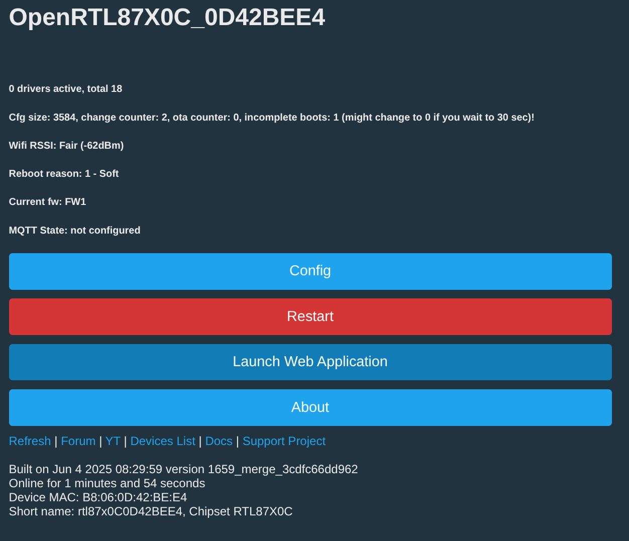

    Been tinkering,
    I did an OTA reflash of the firmware and confirmed that I still have the same issue, next I did an OTA of the latest release and that does not seem to have any version of the TCL driver but I did start the NTP driver without issue. So then I reflashed the firmware from the PR and verified that the NTP driver loads fine but attempting to start the TCL driver still crashes/reboots with the same error. I also verified the hash just to make sure my download did not get corrupted.
    Wondering if there might be an issue with the chip or the partitions, I did try to put ESPHome on it at some point. I have another module that I can try with (I have a dual unit) this one is still factory fresh.

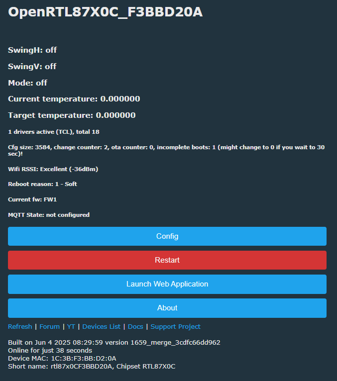

    OK so I flashed the stock firmware back and confirmed that it was working, then flashed the PR firmware, interestingly, on the first boot I got this

    Not sure what all the header check format this sector is about. Do I need to format that area did it do it when it booted? I tried the startDriver TCL agfain with the same results as before, Crash then reboot. Will try the other module after work to rule out a possible bad module issue.
    Added after 3 [hours] 23 [minutes]:
    Results from adding the firmware to the fresh board.
    Still got the "Warning: Sector header check failed. Format this sector" messages on first boot
    == RAM Start ==
    initLog() done!
    Warning: Sector header check failed. Format this sector (0x001f0000).
    Warning: Sector header check failed. Format this sector (0x001f1000).
    Warning: Sector header check failed. Format this sector (0x001f2000).
    Warning: Sector header check failed. Format this sector (0x001f3000).
    Warning: Sector header check failed. Format this sector (0x001f4000).
    Warning: Sector header check failed. Format this sector (0x001f5000).
    Warning: Sector header check failed. Format this sector (0x001f6000).
    Warning: Sector header check failed. Format this sector (0x001f7000).
    Warning: Sector header check failed. Format this sector (0x001f8000).
    Warning: Sector header check failed. Format this sector (0x001f9000).
    Warning: Sector header check failed. Format this sector (0x001fa000).
    Warning: Sector header check failed. Format this sector (0x001fb000).
    Warning: Sector header check failed. Format this sector (0x001fc000).
    Warning: Sector header check failed. Format this sector (0x001fd000).
    Warning: Sector header check failed. Format this sector (0x001fe000).
    Warning: Sector header check failed. Format this sector (0x001ff000).
    Warning: All sector header check failed. Set it to default.
    Warn:CFG:CFG_InitAndLoad: Config crc or ident mismatch. Default config will be loaded.
    Info:CFG:CFG_SetDefaultLEDCorrectionTabMain_Init_Before_Delay done
    Main_Init_Delay
    le: setting defaults
    Error:CMD:lfs is absent
    WIFI initialized
    I did not try to set up the name, wifi, MQTT, etc just joined the AP
    After getting on the AP I tried the startDriver TCL and got exactly the same behavior as the other board, crash then reboot.

    I've pushed some UI tests - i am testing dropdowns (outside refreshed div) and radio lists:
