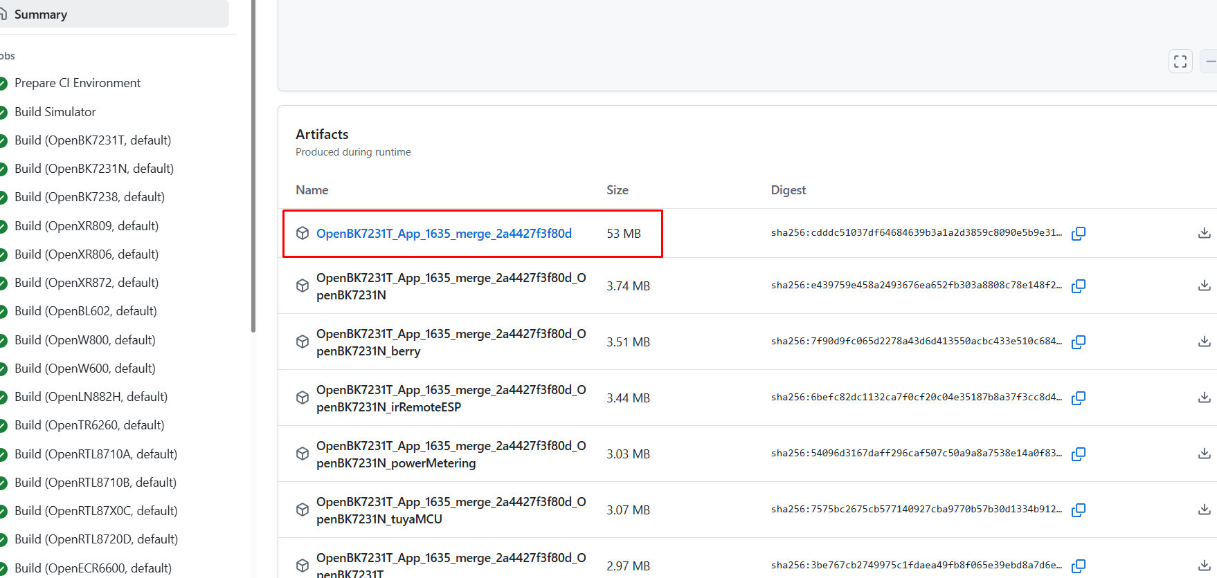

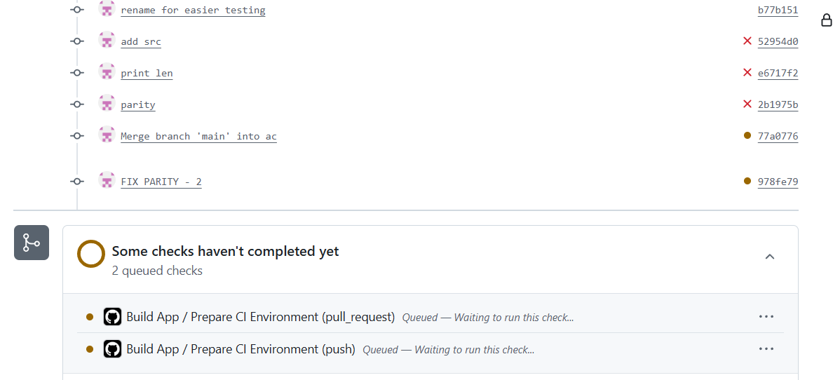

    Ah, sorry, you probably aren't aware about this, but when I link to PR, you can click the green check mark on the latest build, find "Get artifacts zip" or whatever is this option called, and download binaries for latest commit in the PR. That one should include the driver on the Realtek, unless I've missed which platform you use.
    Screenshot showing a list of downloadable artifacts from a GitHub Actions build process, with the “OpenBK7231T_App_1635_merge_2a4427f3f80d” artifact highlighted, size 53 MB.
    How well do you know C? I don't have this device on site so we need to work together through forum efficiently to test this and check if it runs. There might be still some strange issues..
    In a meantime, I can try to setup some simple self-tests for this driver (they run without device, on Windows or linux) just to see if the basics are working, is anything sent via UART, etc
    Btw, you don't need logic analyzer, you can capture traffic just by connecting UART RX line to the line you want to listen. Just make sure to set the correct baud.

    Thanks for the info and the tip about downloading the latest build artifacts. How do I apply the artifact zip? Is it just an OTA update or is there another method?

    You need to unpack zip and find OTA file for your platform. The main zip is 50MB in size and contains binaries for all platforms, including Windows simulator.
    Don't worry about C skills, you don't need to write code, maybe you can just give a sneak peak there to smooth testing process, ChatGPT can also help with basics.

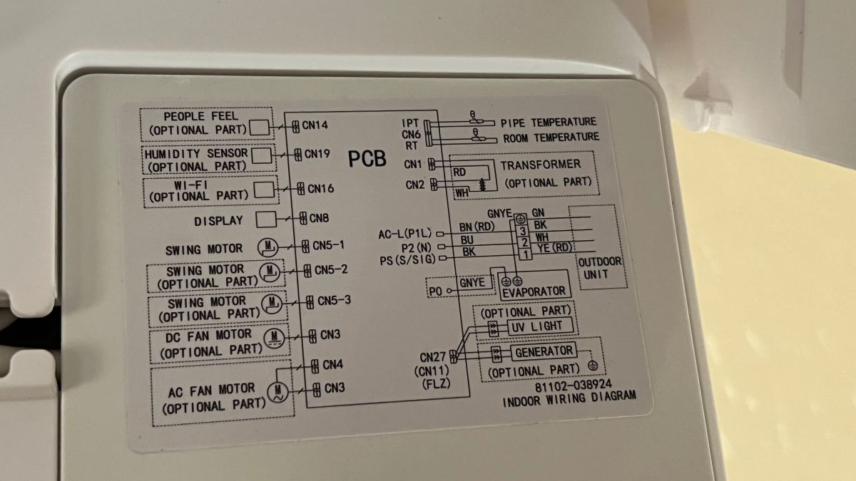

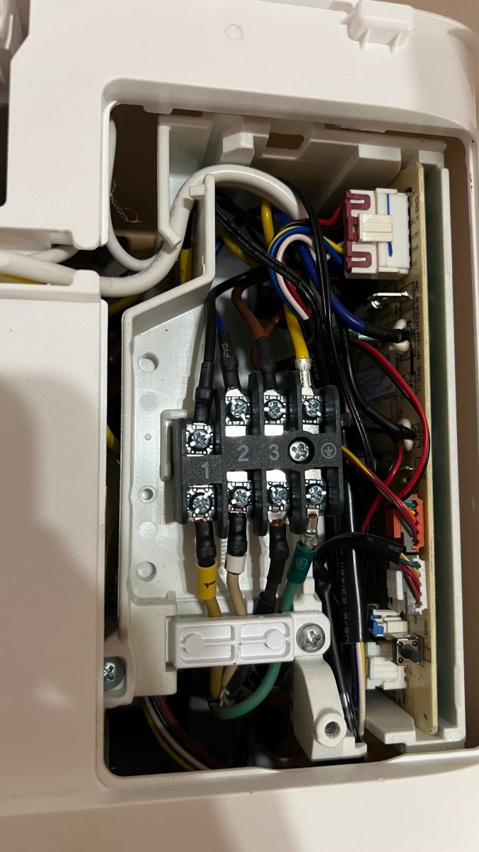

    Should I pull the system apart and get the chip make and model from the board inside the indoor unit? Looks like a pain to get to, but I’m thinking I should for the guide or teardown. What do you think?
    Interior of an electrical box with wires connected to terminals and a circuit board.
    Wiring diagram inside a device showing connectors, optional parts, and internal wiring layout.

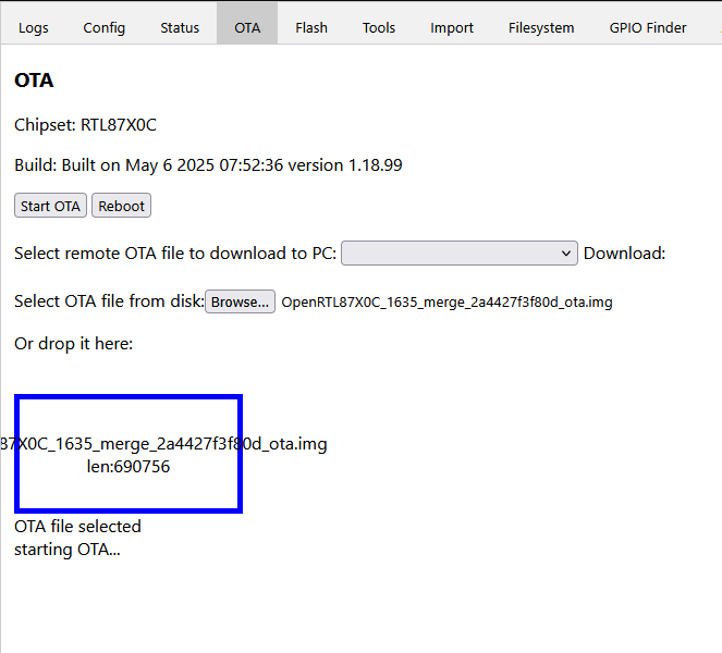

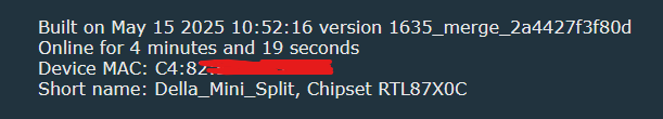

    Edit: I started the OTA update. It's been running for a couple mins and has not changed from this status.
    Screenshot of the OTA panel with a selected .img update file for the RTL87X0C chipset.
    Edit: I opened another tab and it appears to have updated, but didn't update the status of the update.
    Screenshot showing device details like build date, uptime, partially redacted MAC address, short name, and chipset.

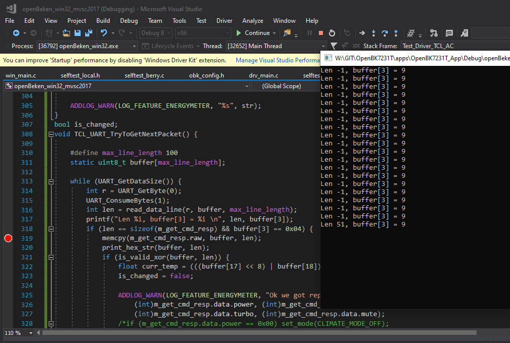

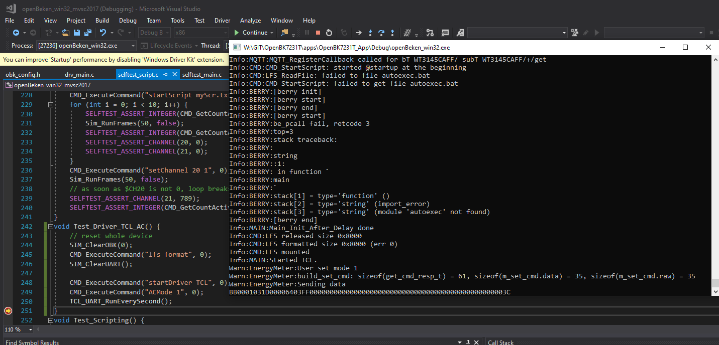

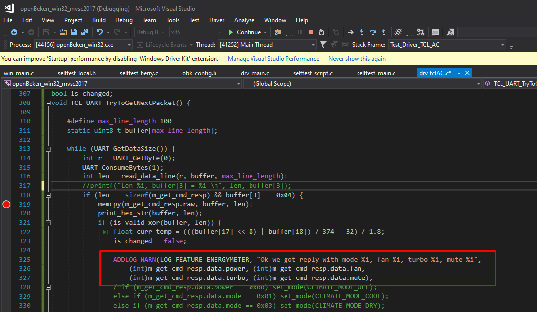

    So, I ran the current driver on Windows and got that:
    Screenshot of Microsoft Visual Studio with source code and a debugging console open.
    It sent:
    BB0001031D00006403FF0000000000000000000000000000000000000000000000003C

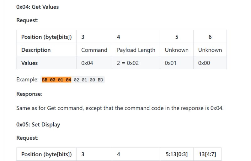

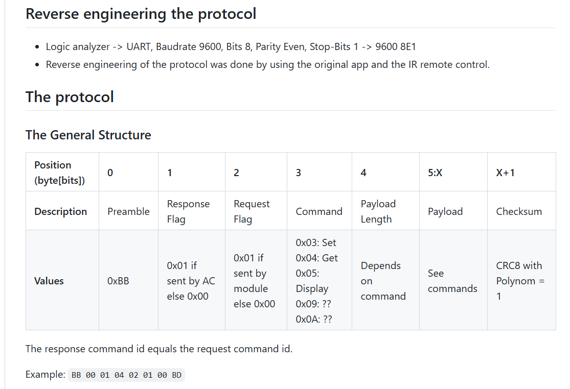

    I have TOTALLY no idea whether it's good or not, but @insmod linked to the site of adaasch which has this:
    A table showing the structure of a serial communication protocol frame with field descriptions and a sample data packet.
    So the header is matching...

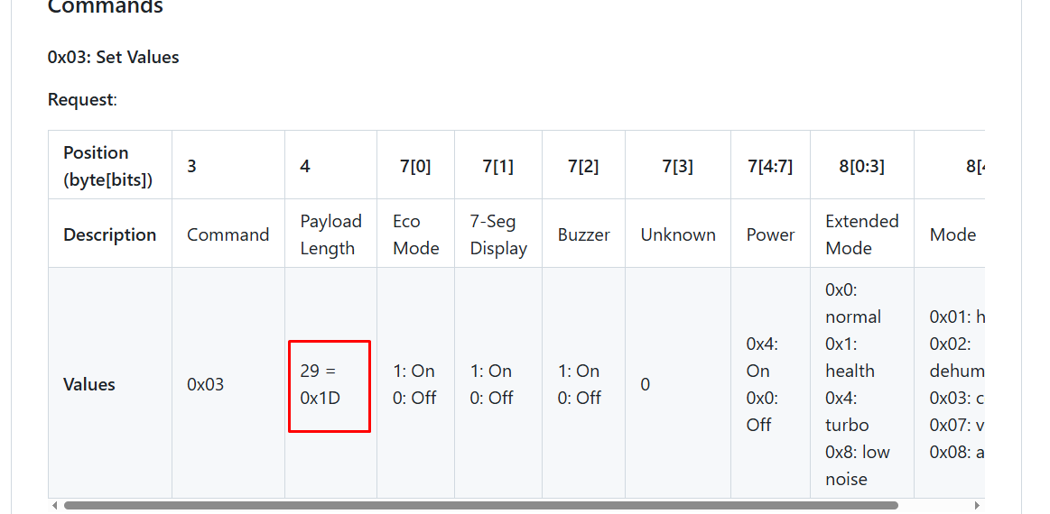

    BB 00 01 03 1D 00006403FF0000000000000000000000000000000000000000000000003C
    0xBB - preamble
    0x00 - sent by module flag
    0x01 - sent by module flag
    0x03 - Set command
    0x1D - payload len, matches here:
    Part of a table showing the structure of command 0x03 for setting parameters, with the 29 0x1D cell in Payload Length highlighted.
    So it seems to match the expectations, more or less, but I don't even know yet whether it's the protocol your device uses....
    UPDATE - I see you added things to your post
    So, first of all, remove autoexec.bat. TuyaMCU may conflict with this driver. Totally disable it. Then do full power off and on cycle. Fresh start.

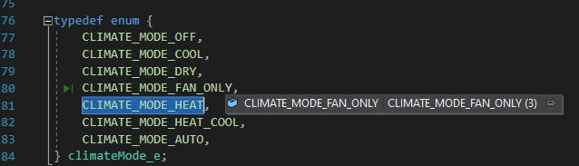

    If your OBK is working, then you can check if your device reacts to ACMode 0, ACMode 1, ACMode 2, etc?
    0 - off
    1 - cool
    2 - dry
    3 - fan only etc
    A fragment of C code showing an enumeration of climate modes.

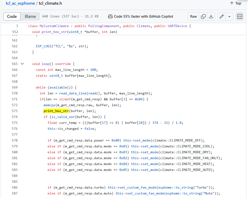

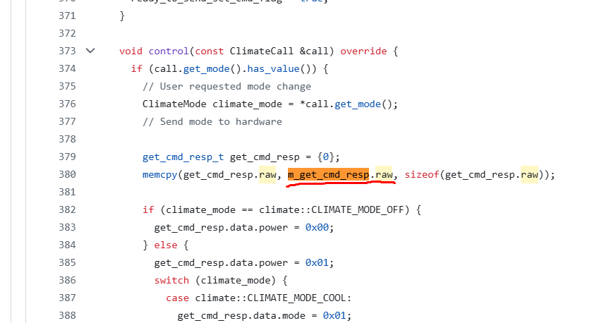

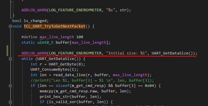

    Well, then I can see two options now.
    1. either this ACMode command works and @dressyspider need to check
    2. or the parsing is missing, because I can see they first parse state reply and then send it back
    Screenshot of a C++ code snippet highlighting a memcpy function call copying between struct raw fields.
    I will try to port a bit more in a meantime
    I kinda expected padding issues, I remember using #pragma pack a lot back in the day, but I'm a MSVC guy and it wasn't even for embedded. Also, all types in structs/unions are bytes here, hm so it should be ok.

    First try ACMode 3 (to enable Fan Only) and then try random values of FANMode
    A snippet of C code showing an enum definition for fan operating modes.

    I didn't port packet parse at first because I didn't like the way it's implemented. I have it now almost ported, but I still can't shake the feeling that is done incorrectly.
    Screenshot of source code in tcl_climate.h showing a loop processing UART data with a static buffer and conditionally parsing packets.
    @insmod do you also think that it lacks a "look ahead" mechanism, so if the UART buffer contains a half of a correct packet, it will just consume this half of a packet, instead of waiting for full data to arrive? In the rare situation that parsing is called during new packet arrival (in a middle of it, let's say).
    This won't hurt, since they request state update on every refresh (half a second), but still, not a perfect approach.
    I'm about to add parsing to PR, but that is without testing, I must find some packets to plug into simulator to see if it parses.

    Ok so it parses something:
    Screenshot of Visual Studio showing C code and a console window with repeated lines Len -1, buffer[3] 9.
    but it expects buffer[3] to be 0x04, and we don't have packet sample for that:
    A part of documentation showing the format of request and response for the 0x04 Get Values command, including a table and example.
    Probably I could create it myself, just update CRC manually, but maybe I will just push what I have and let @dressyspider do the testing on the device...
    Expected output is this print every second:
    Screenshot of Microsoft Visual Studio with a C code file open, and a section of code highlighted with a red box.
    added latest changes

    I tested the latest OTA from this build:
    GitHub Actions Artifact
    Steps Taken:
    1. Flashed OTA
    2. Restarted the module
    3. Ran: startDriver TCL
    4. Powered on the unit via remote
    5. Ran: ACMode 3
    6. Ran: FANMode 1
    7. Ran: FANMode 5
    8. Powered off the unit via remote
    Observation: Unfortunately, the fan speed never changed during testing.

    I see, so we need to check if anything is received at all.
    I added this line - print every second.
    Screenshot of a C code fragment with a highlighted function and a logging line.
    Update and retry.,
    hm maybe wrong parity?
    Added after 8 [minutes]:
    Logic analyzer -> UART, Baudrate 9600, Bits 8, Parity Even, Stop-Bits 1 -> 9600 8E1
    and we set:
    Code: C / C++
    I copied code from TuyaMCU but it has parity none, so obviously it won't work... need to change parity.
    @insmod you did porting to RTL, is 1 equivalent to even parity?
    Code: C / C++

    No, even parity is 2
    https://github.com/NonPIayerCharacter/OpenRTL...er/component/common/mbed/hal/serial_api.h#L49
    I remember there was an issue with CSE7766, there was even a pull request to check if it works. https://github.com/openshwprojects/OpenBK7231T_App/pull/1528
    We need a separate parity enum for OBK, so there wouldn't be such an issue again.

    Even parity is 2? Then wait, I need to change this in PR.
    So... that means the code in RN8209_Init is incorrect? There is UART_InitUART call with argument 1 but RN8209 requires even parity...
    Ok we will need to look into it, and I will try to update PR in a moment, but right now I'm testing PIR with user from germany so there will be a delay (to the morning at worst case)
    Added after 9 [hours] 24 [minutes]:
    insmod wrote:
    No, even parity is 2.
    I've pushed parity 2 now, can you check @dressyspider ? It will build for like 10 minutes from when I post this message, so take care, but probably you won't read it that fast anyway...
    GitHub commit history and CI status with failed and pending checks displayed.

    Info:MAIN:Time 201, idle 0/s, free 94336, MQTT 1(1), bWifi 1, secondsWithNoPing 132, socks 2/21
    Warn:EnergyMeter:Initial size: 61
    Warn:EnergyMeter:BB 01 00 04 37 04 00 32 AA 00 80 00 00 00 00 00 00 66 2B 88 00 00 00 00 00 00 00 00 00 00 66 FF 42 00 5A 2B 2B 36 00 00 80 00 00 00 00 EE 00 00 00 44 40 00 00 00 00 1A 00 00 00 00 97
    Warn:EnergyMeter:Ok we got reply with mode 1, fan 2, turbo 0, mute 0
    Warn:EnergyMeter:fan 02
    Warn:EnergyMeter:mode 02
    Info:MAIN:Time 202, idle 0/s, free 94168, MQTT 1(1), bWifi 1, secondsWithNoPing 133, socks 2/21

    Warn:EnergyMeter:User set mode 0
    Warn:EnergyMeter:build_set_cmd: sizeof(get_cmd_resp_t) = 61, sizeof(m_set_cmd.data) = 35, sizeof(m_set_cmd.raw) = 35
    Info:CMD:[WebApp Cmd 'ACMode 0' Result] OK
    Warn:EnergyMeter:Sending data

    Can you make a sorted list of which features are most important to implement now and how they work?
    I'm pushing two new commands - SwingH and SwingV, here is related enumeration (first option is 0, second is 1, etc, I hope you know):
    Code: C / C++
    So SwingH 2 is move left... whatever it means.
